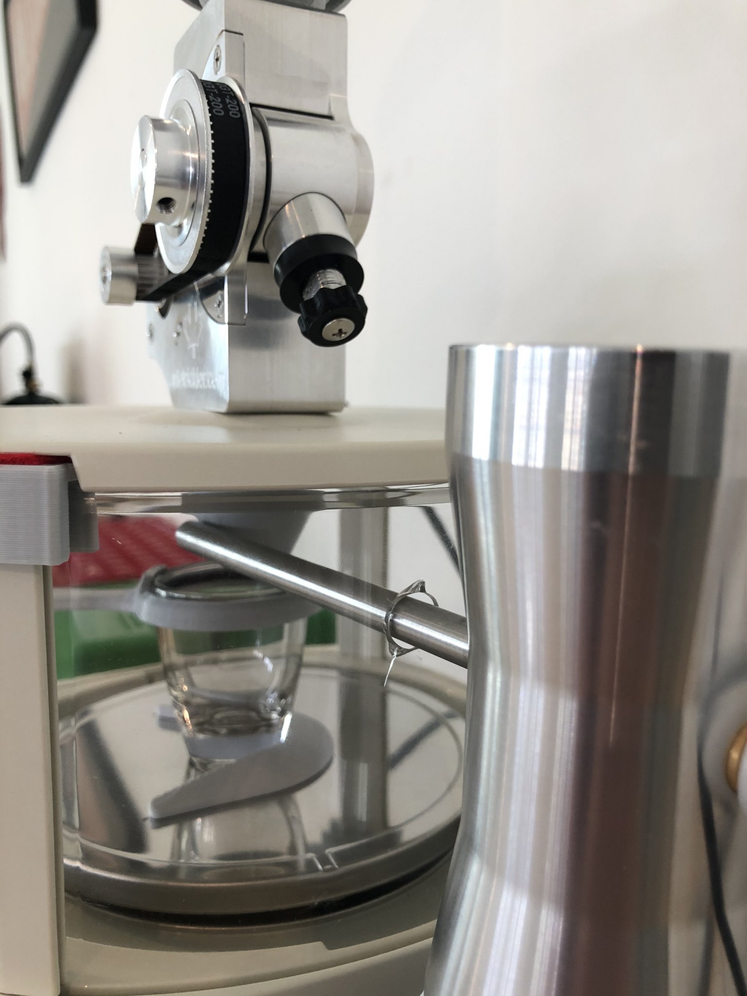

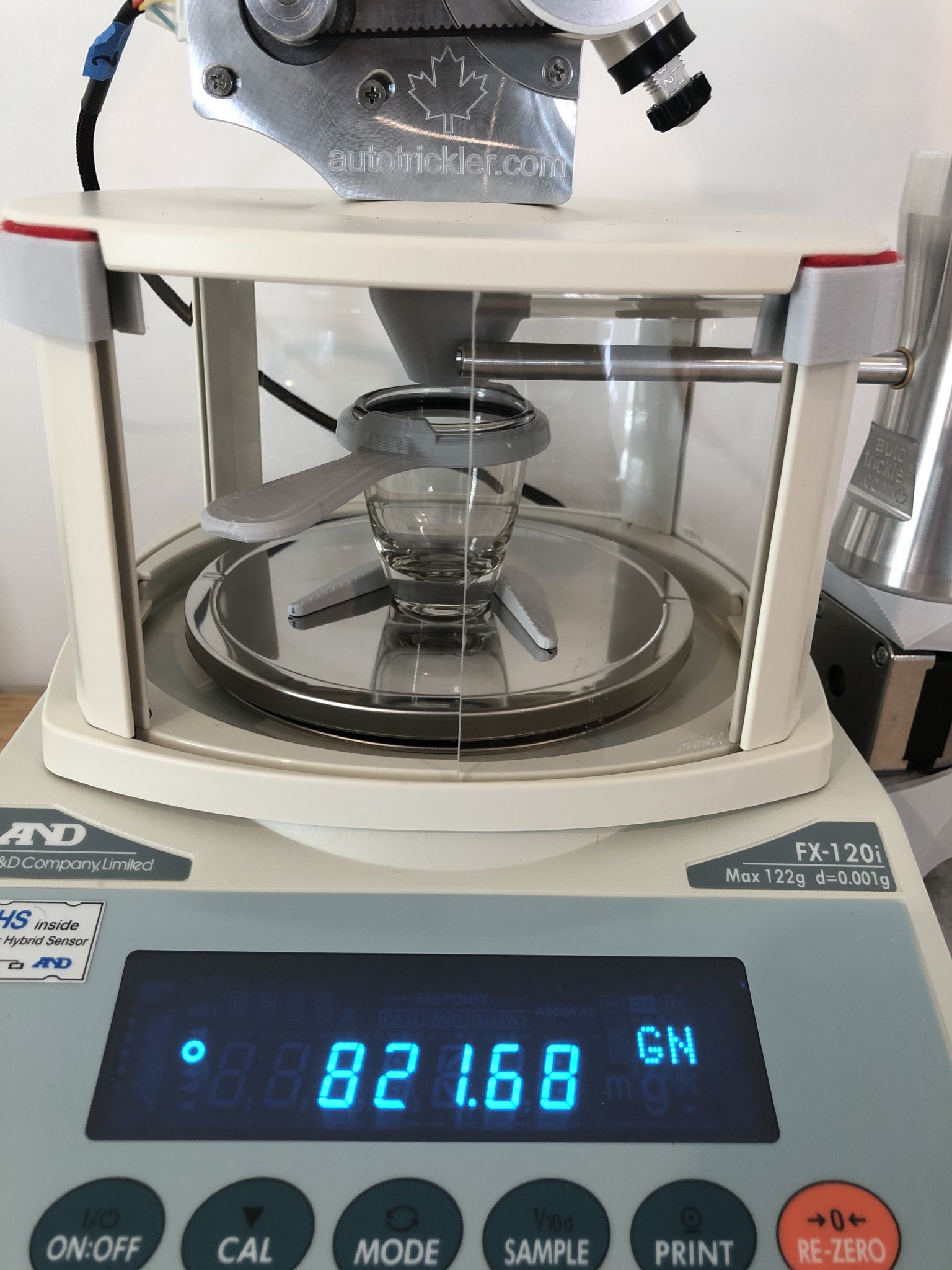

Cut the front panel in half and drilled a hole in the side for the Autotrickler.
Lots of good aluminum parts to replace the 3d printed stuff. I’m less likely to knock over the a.trickler, it also has much increased capacity. The plate and pan guides nicely. I also replaced the a.throw, not sure how necessary that was however. I went for it though.
I wish they did a billet a.throw housing so it was all aluminum, they said they didn’t plan on making a v3 a.throw housing.
The Area 419 accessories are nice. I have them all, and my wallet is still complaining.

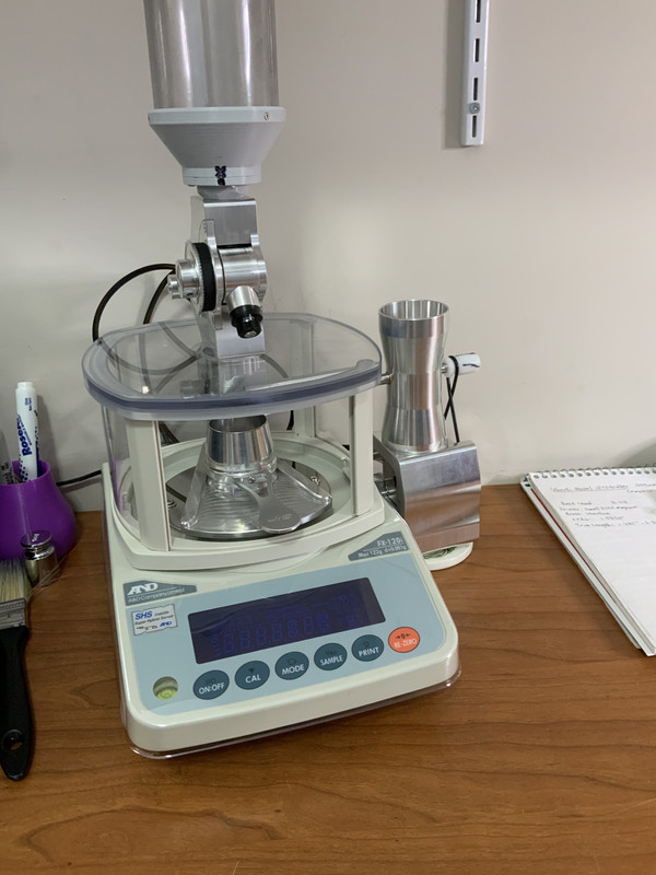

The Area 419 products are a nice touch. The clear lid is a much heavier design....and see through. The funnel is offset so the throws don’t bounce powder out of the cup. The cup is a much wider design so powder “splashing“ is minimized. The pan self-centres the cup and has an indent for positive positioning. The new heavier trickler mount won’t walk across the surface when the trickler operates. It stays put.
But my wallet still hurts.
