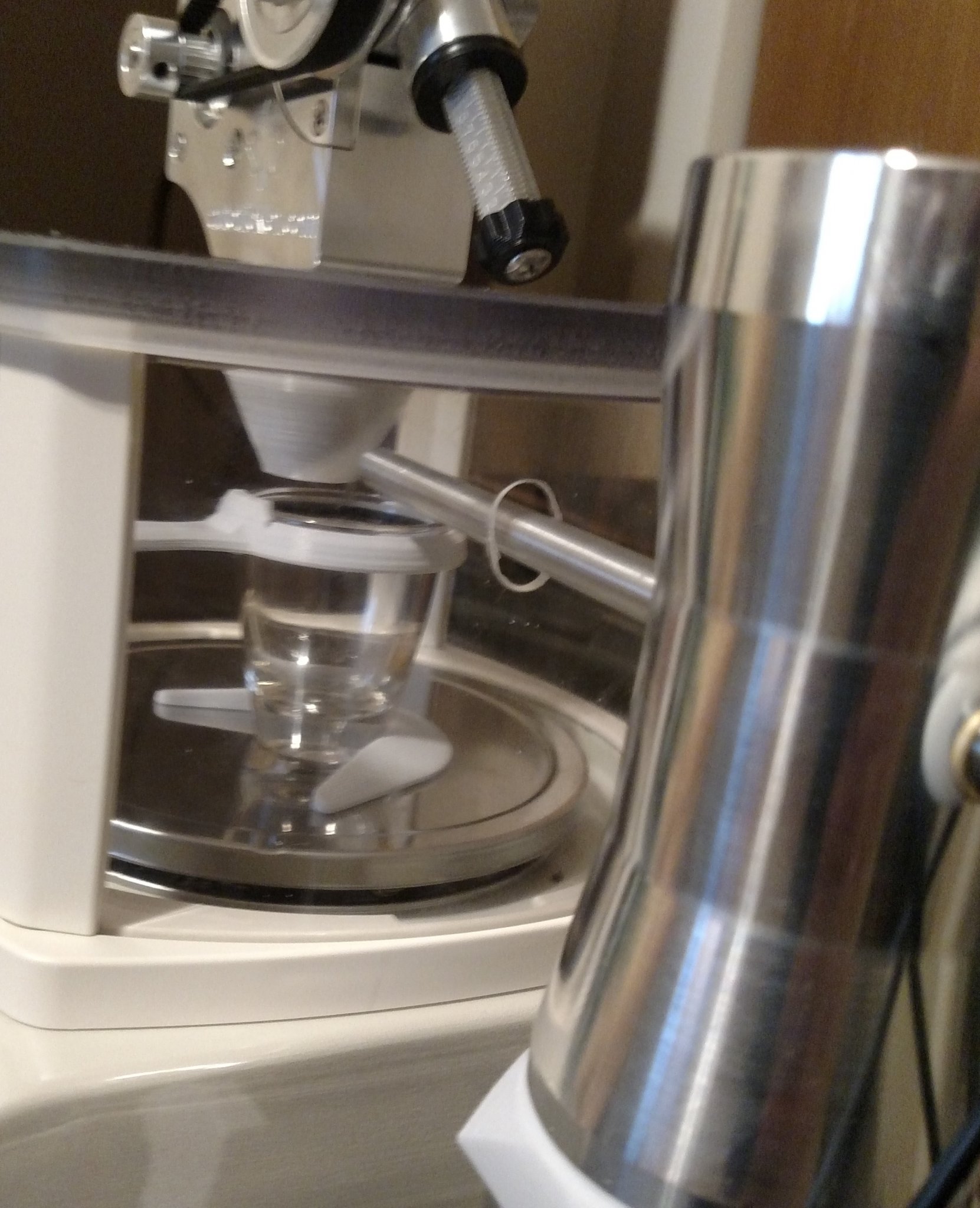

I need to measure and drill the third windscreen, how have you guys done it? Looks fragile.

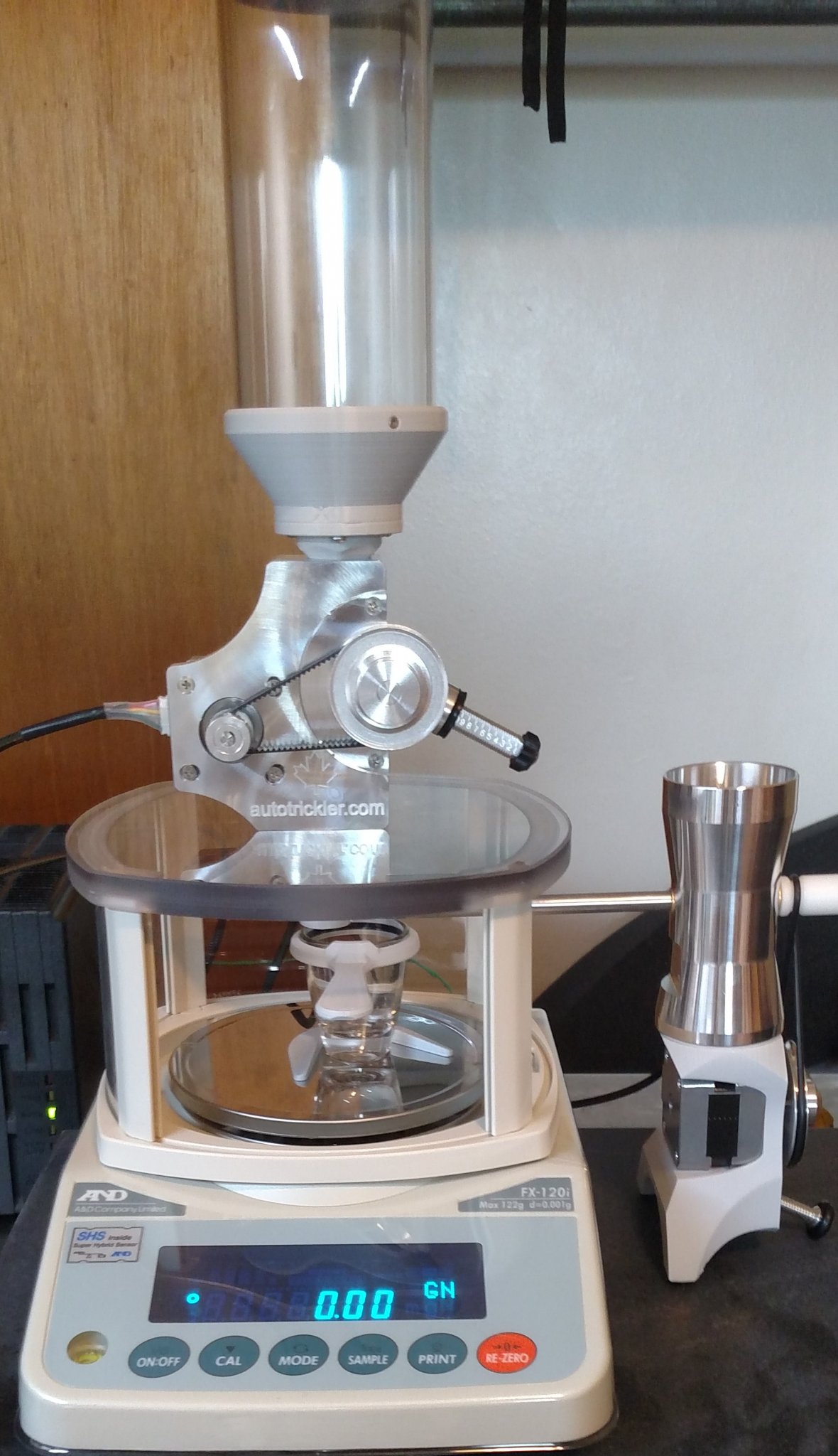

I'm looking for some input. Just got my new AutoTrickler and FX120i yesterday and so far I'm loving it. There is one problem/annoyance. The breeze break/draft shield has a super sloppy fit. And since the auto-throw mounts directly to this, the whole setup is kind of unstable and top heavy. Is this normal, or did I set something up wrong? See video below:
It doesn't look installed right. I disassemble and try again. It certainly is more sturdy than that.
Just got mine a month or so ago and it does not wobble that bad (I would check it again after it’s fully assembled as the throw has some weight to it as well). However I’ve read or seen that before and believe the “fix” was furniture felt pads stuck to the bottom of the plastic base.

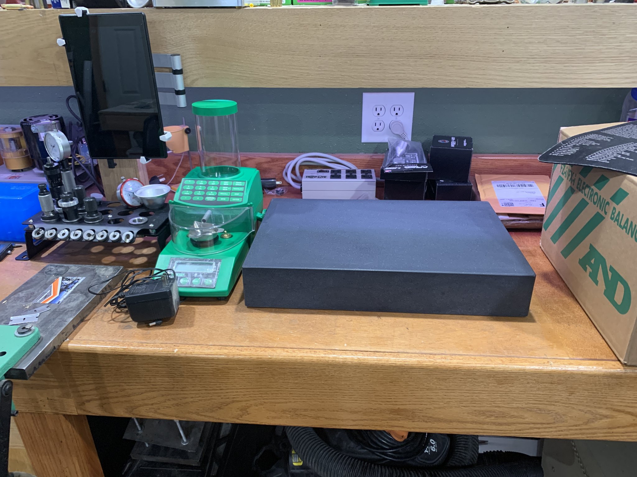

I purchased a granite surface plate off amazon https://smile.amazon.com/HHIP-4401-...&keywords=surface+plate&qid=1595959620&sr=8-2, it is a little overkill but my scale is rock steady.

Overkill is an understatement, that's an 80 pound hunk of flat rock. Your amazon driver is going to love you!
I tip him well, I get orders of hundreds of pounds of ammo too, and I live on a ranch in the middle of nowhere.....with some irritable bulls that get loose sometimes...Sigh, God's country! But I digress, like I said, the scare is isolated and stable as heck, nothing makes it twitch.
for a resting spot for a scale. you could easily get by with a class B granite plate and save money. those are only 97 shipped rather the 160 for a class A. B's are rated for .0001 flatness (if I remember correctly) which is far beyond whats needed for the scale.
and being a foreign made plate id even question its flatness, but should be plenty flat for our use.
Reactions: bunny too
You are correct, at the time I ordered it they did not have that option for the size I wanted.

This is the one I bought. It is definitely overkill I'm thinking about recessing it in to my bench due to the thickness.
You will be very happy with it, makes your scale solid as a.... . . well, solid as a rock. Check out Airy points, that is how you want to support it https://www.practicalmachinist.com/vb/metrology/square-surface-plate-airy-points-270949/, I used Teflon furniture buttons https://smile.amazon.com/gp/product/B07TMCR5HT/ref=ppx_yo_dt_b_search_asin_title?ie=UTF8&psc=1

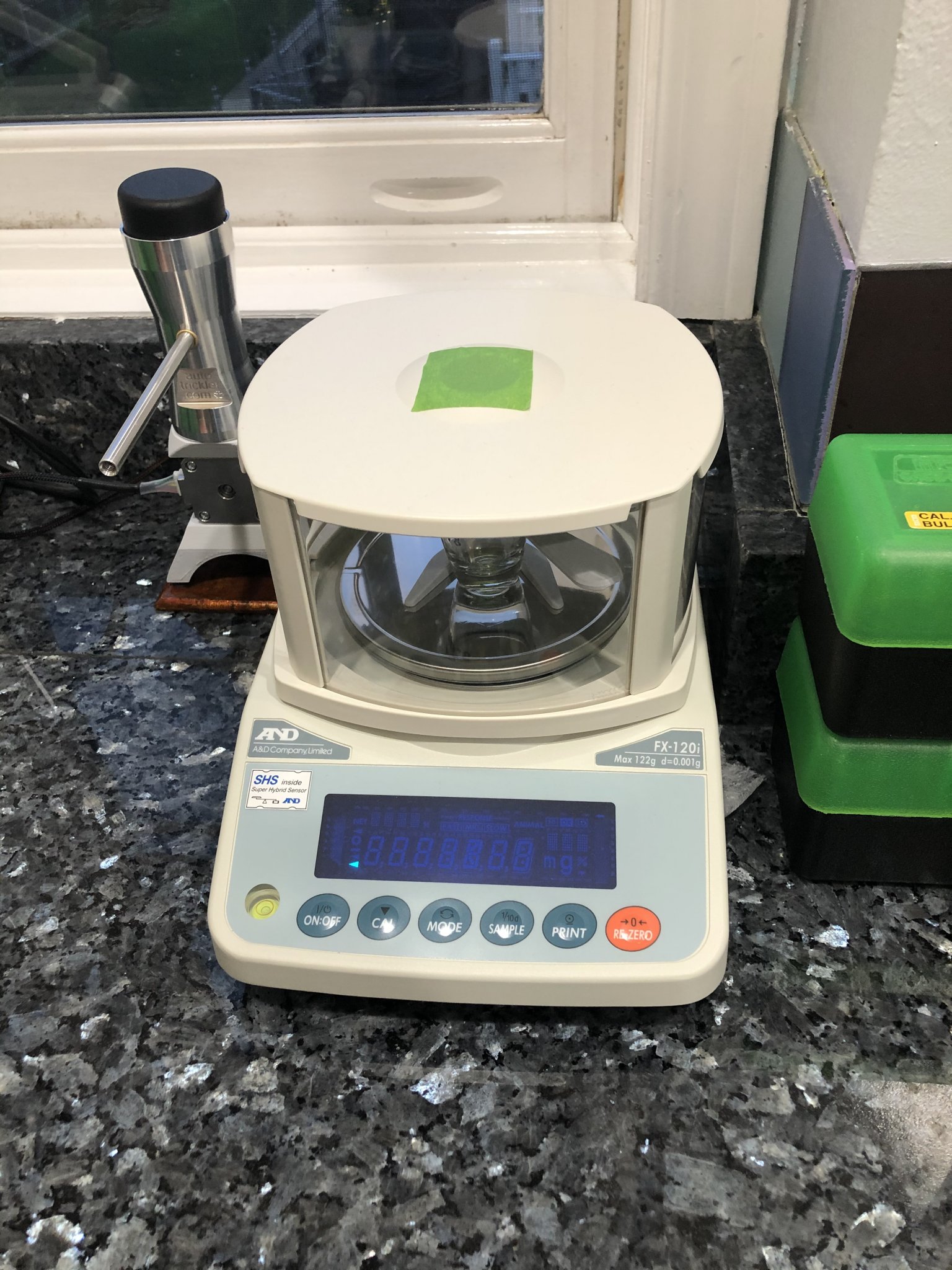

My A&D + AutoTrickler sits on a granite countertop in the office area that my wife converted into a reloading room😉. It is so stable that even with the washer/dryer running (approx 5ft away), the scale works with no issues.
