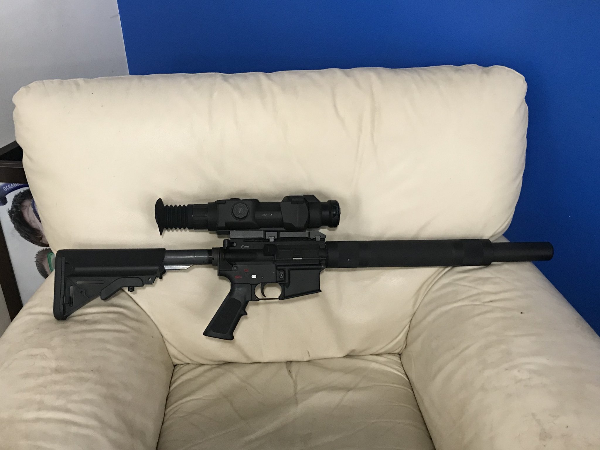

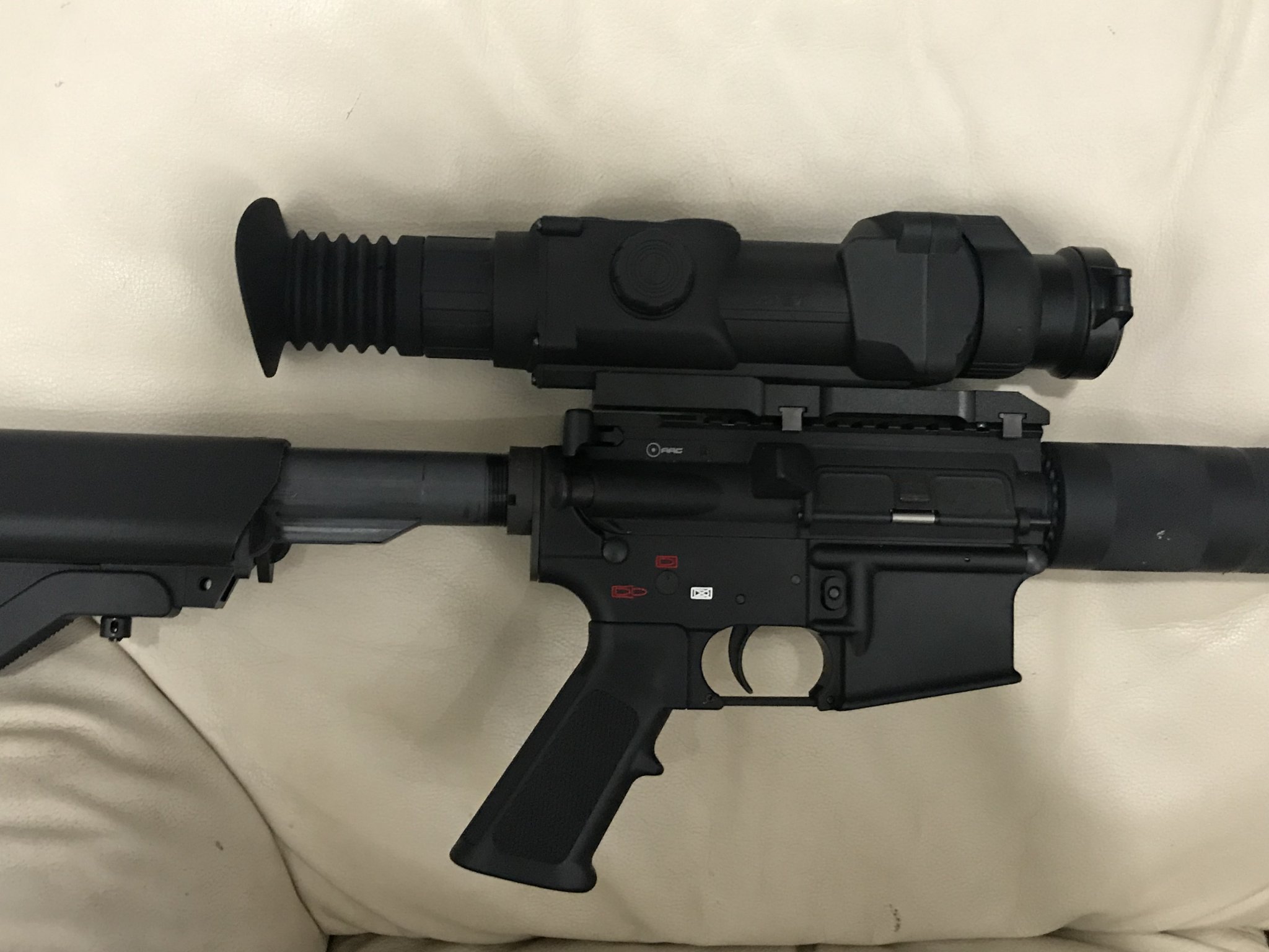

So here is kinda what I’m working with. I have a 9” 300bo with a permanently attached cyclone I had laying around.
I’ve read as much as I could and read that an auto loader is preferred because you maintaining sight picture.
I’m not a fan of the cheekweld, but it’s workable to say the least.
View attachment 6926241View attachment 6926242
