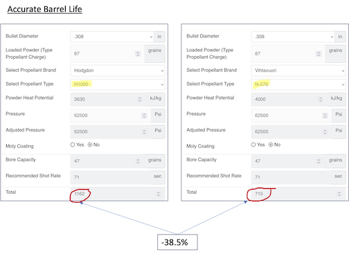

The simple switch to N570 from H1000 is modeled to reduce "accurate" barrel life by approx 40%

Here are some numbers for you all....and being as 243win was mentioned (I didn't go back and read everything) I'll start with this one.
On a ammunition pressure test barrel.... rarely does a 243win make it I'll say past 800-900 rounds.
Same with a 300wm p&v test barrel. Most are getting pulled at about 800-900 rounds. Rarely do they make it past say a 1k rounds. If they got one that went 1200 that is getting out of the norm.
6.5CM on a p&v test barrel about 1700 is tops. If they got 1900 rounds out of one they milked it pretty good. Compare this to a 6.5PRC where they have get anywhere from 400 to 900 rounds. An average is 650 for this round.
I forget what was a normal for a p&v test barrel in 308win but I want to say it was around 4k. The 308win round for bore size is about the perfect relationship. It's very easy on barrels. Take that 308win and neck it down to 6.5mm or 6mm and you can see what happens above. Same thing happens when you take that 30cal barrel and chamber it in 300wm.... your basically doubling the amount of powder that goes down the bore.... which in turn leads to a shorter barrel life.
Any of the big 30 magnum rounds like 300wm, 300 Norma etc... looking at it from a accuracy point of view (not a pressure and velocity spec point of view).... I'll say 1k tops. If you got a 1k out of them that was great.
300 Norma pressure and velocity test barrels where they are trying to meet a .65moa accuracy requirement with box ammo (I think that is for either five or ten... 10 shot groups) they are pulling the barrels 500-600 rounds. After this round count they are on borrowed time so they don't want to trust the barrels anymore and will put a new one in service. They are going thru 10 barrels a month in this caliber.

or better yet (and I'm not picking on ammo makers here just using for what we see) is when an ammo makers calls and says, "hey we're looking to shorten up cleaning time....what do you think of using ss bore brushes and abrasives?"
Part of my answer was.... knock yourself out... you will be buying double the amount of test barrels!
