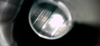

I ran across this thread about barrels being made with bad metal. I bought a desert tech srsa2 with two barrel converson kits. 6.5 CM and 7 Mag. During break in I cleaned them with wipe out. During bore scope I noticed etching near the chamber. Sent both barrels back to desert tech and they replaced both barrels and threw in a free muzzle break. What issue with Metal could cause wipe out to etch a barrel> I was using the spray in wipe out that you would leave in for an hour then clean with patch. I still use wipe out and accel with no noticable issues in any other barrels. Could have been premature fire cracking. Maybe 40 rounds max on both barrels.

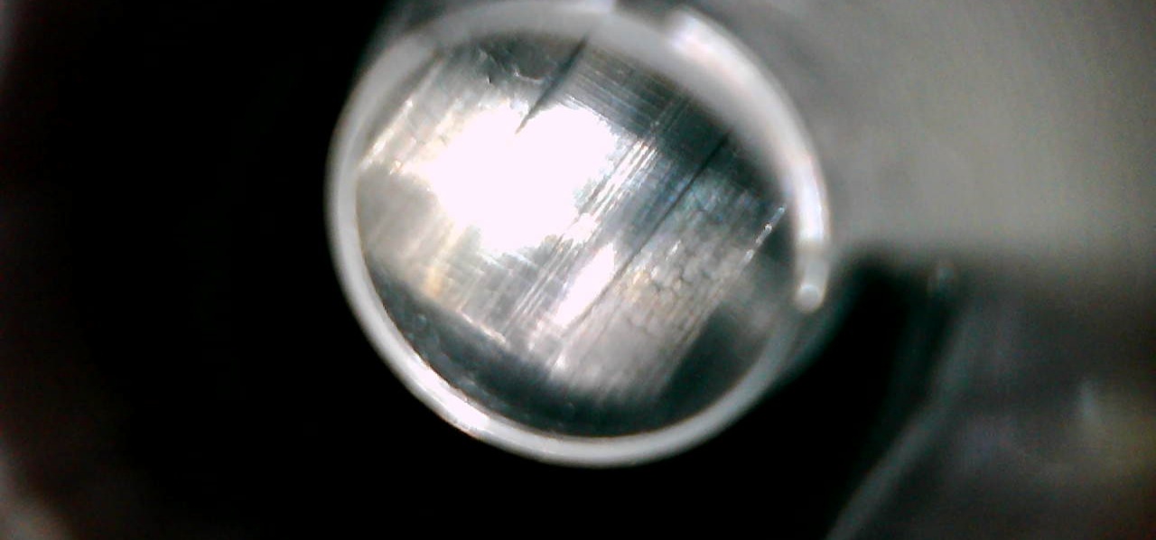

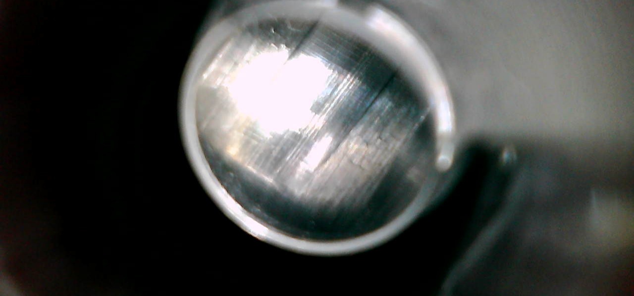

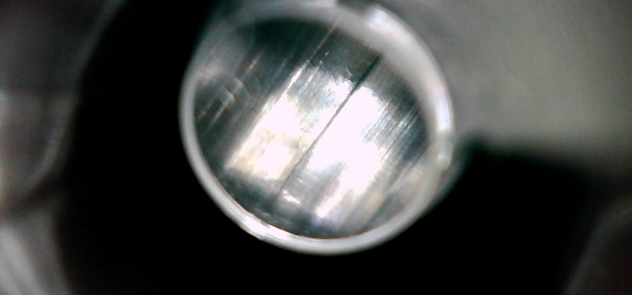

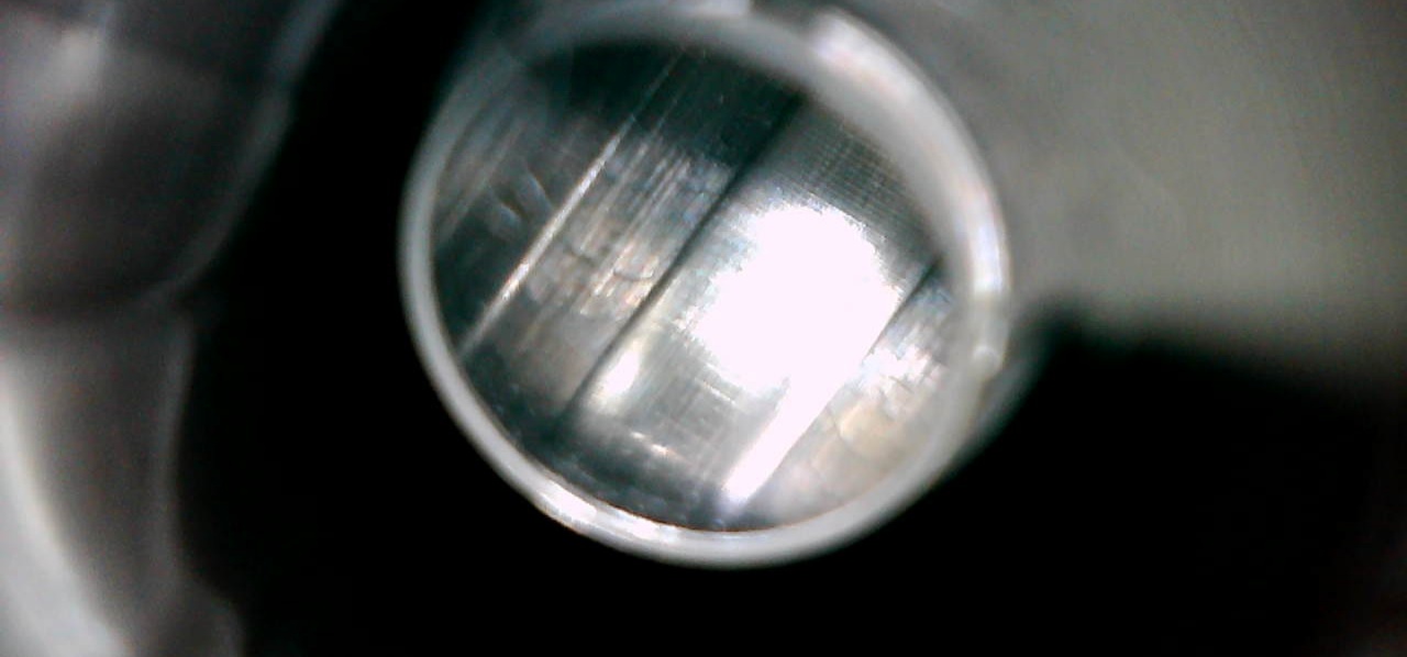

Got any pic's?

This was after a few rounds. They made it right, replaced, I am not knocking the company. Just curious why???
No I know you where not knocking them. GTG!
Looks like fire cracking starting in the throat area. Hard to tell from the pics if there is any etching per se.
The cracking is on the lands right in front of the throat correct? If so that's all I see off hand.
Are you seeing something different some where else?
It extended 3 inches down from lands. Started after Only a couple rounds fired.
