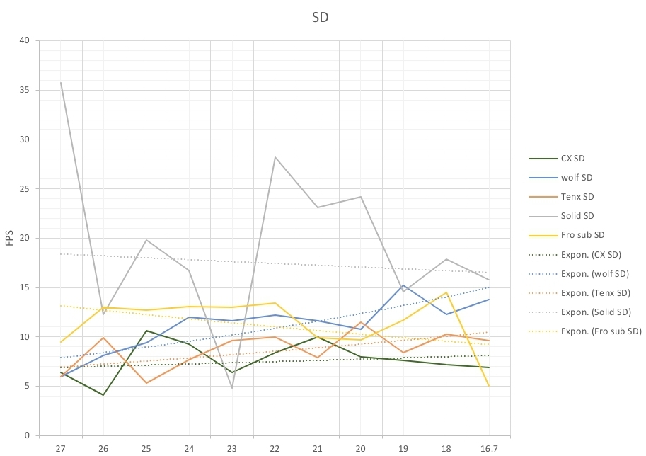

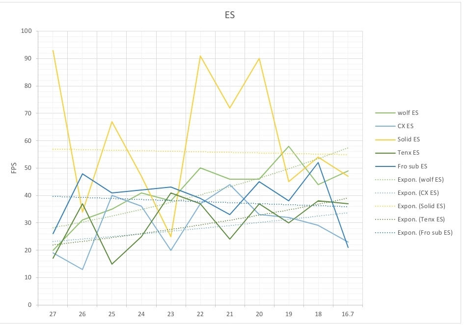

Gleedus Jesus 1st, Family 2ed, Shooting 3rd Full Member Minuteman Sep 7, 2020 584 356 Ontario, Canada May 23, 2021 #101 May 23, 2021 #101 Interesting change with the Eley brass.... Reactions: Geno C.
Geno C. Dirty Carnie Full Member Minuteman Oct 24, 2007 7,050 16,157 41 Wautoma, WI May 23, 2021 #102 May 23, 2021 #102 A very noticeable increase in consistency Reactions: lash

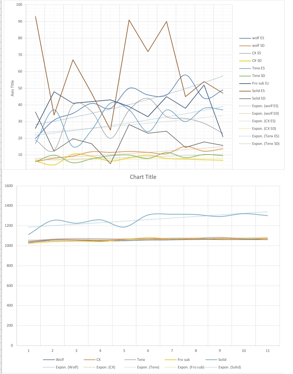

Gleedus Jesus 1st, Family 2ed, Shooting 3rd Full Member Minuteman Sep 7, 2020 584 356 Ontario, Canada May 23, 2021 #103 May 23, 2021 #103 its kinda messy I can break it down different if you wish. Reactions: Geno C.
Geno C. Dirty Carnie Full Member Minuteman Oct 24, 2007 7,050 16,157 41 Wautoma, WI May 23, 2021 #104 May 23, 2021 #104 Spread the vertical scale out on the lower one?

Rob01 Moderator Staff member Moderator Full Member Minuteman Jul 9, 2001 18,279 15,687 NC May 24, 2021 #108 May 24, 2021 #108 .22 ammo with 90+ ES? How many rounds is that? Those are some super high numbers.
Mike Casselton No, I just wear the T-shirt Full Member Minuteman Nov 25, 2007 12,316 24,559 Lithia, FL May 24, 2021 #109 May 24, 2021 #109 Am I seeing what I think I'm seeing on the first sheet? Across the entire test: 1st shot = lowest velocity. 2nd shot = highest velocity. 3rd shot in the middle.
Gleedus Jesus 1st, Family 2ed, Shooting 3rd Full Member Minuteman Sep 7, 2020 584 356 Ontario, Canada May 24, 2021 #110 May 24, 2021 #110 Mike Casselton said: Am I seeing what I think I'm seeing on the first sheet? Across the entire test: 1st shot = lowest velocity. 2nd shot = highest velocity. 3rd shot in the middle. Click to expand... Yes 3rd is average
Geno C. Dirty Carnie Full Member Minuteman Oct 24, 2007 7,050 16,157 41 Wautoma, WI May 24, 2021 #111 May 24, 2021 #111 No, it’s just the lowest and highest speeds, to see the extreme spread. Then the average. And finally the SD. Mike Casselton said: Am I seeing what I think I'm seeing on the first sheet? Across the entire test: 1st shot = lowest velocity. 2nd shot = highest velocity. 3rd shot in the middle. Click to expand...
Mike Casselton No, I just wear the T-shirt Full Member Minuteman Nov 25, 2007 12,316 24,559 Lithia, FL May 25, 2021 #112 May 25, 2021 #112 Ah, gotcha. I still use an optical chrono so it doesn't give the highest/lowest, just velocities/average/ES. Reactions: Geno C.
