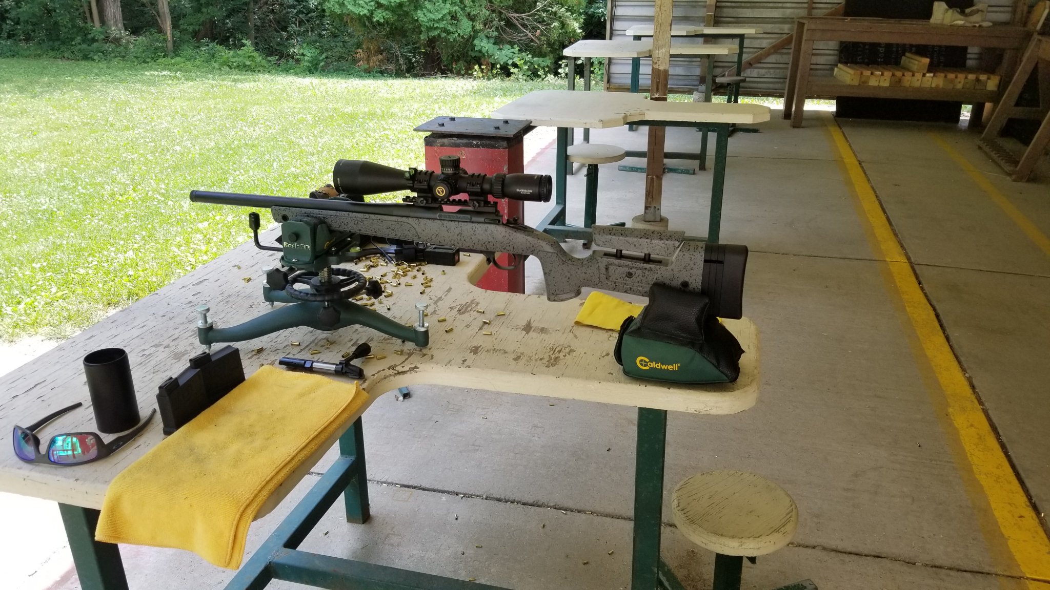

I won my b14 on a $20 raffle and didn't know anything about it. Thought about selling it as I have never tried any type of competition shooting or really much more than a couple range days a year before hunting season. I decided to keep it and see what the fuss was about and to use it to teach my young kids to shoot. My thought being that why not learn on a very good platform. Long story short-ish I threw on an old Nikon monarch I had sitting around and shot a little at 50yds yesterday. The picture shows the first 20 rounds through the gun. 5 to sight in and 15 in the yellow. Cci standard velocity. No issues at all in the 100 rounds we shot, I really enjoyed the light trigger pull too.

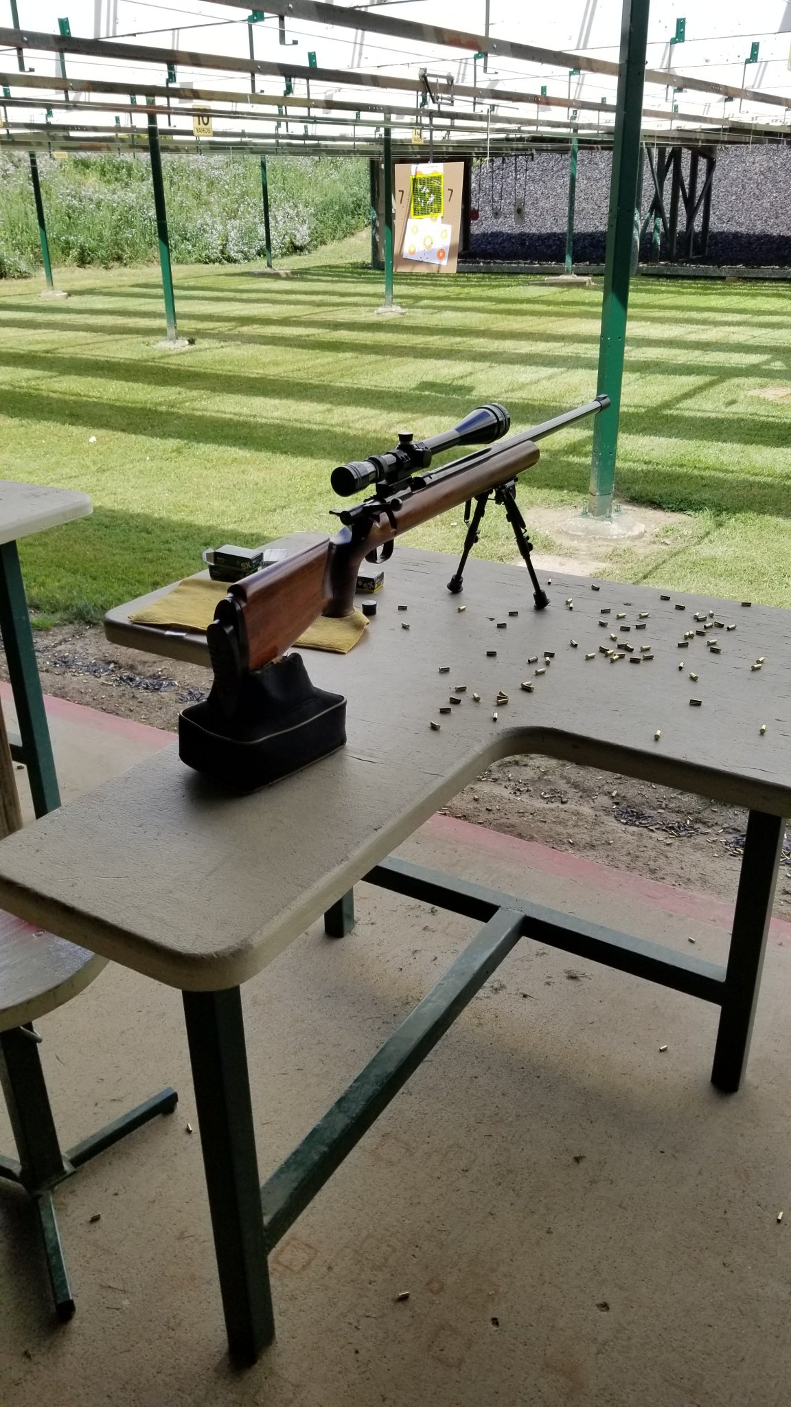

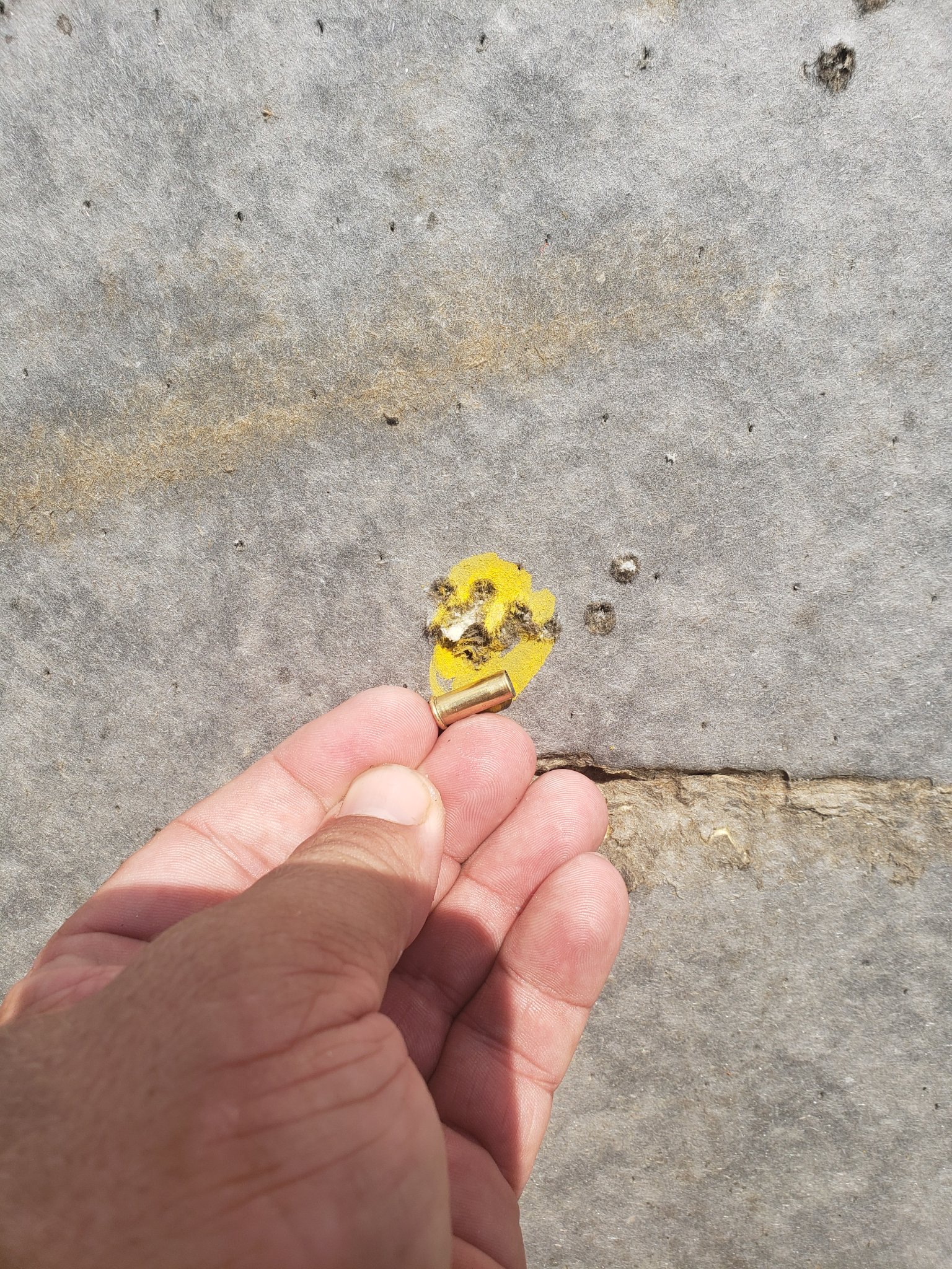

I was originally at the range for a fun shoot that we are doing it's a shoot at your own pace at 25yds. So I was using my Anschutz for it but decided to try the Bergara for one target. It was a little hard with the Bergara because the Athlon Midas BTR doesn't focus down that low. Both were shot with the same lot of Center - x.

Did a reshoot with geco auto match today
WOW!!!
5 - 10shot groups at 55yards
All stay on 1/2 dots

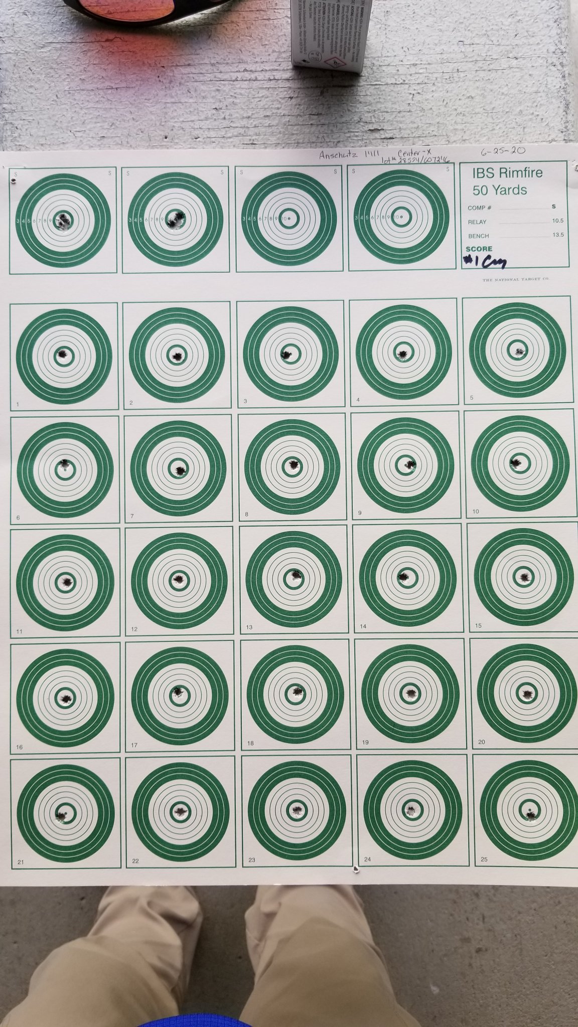

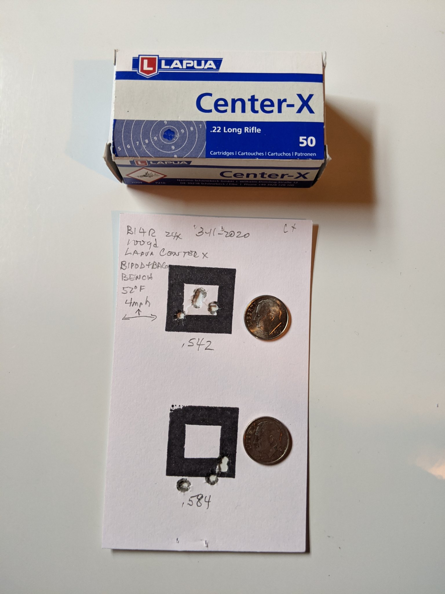

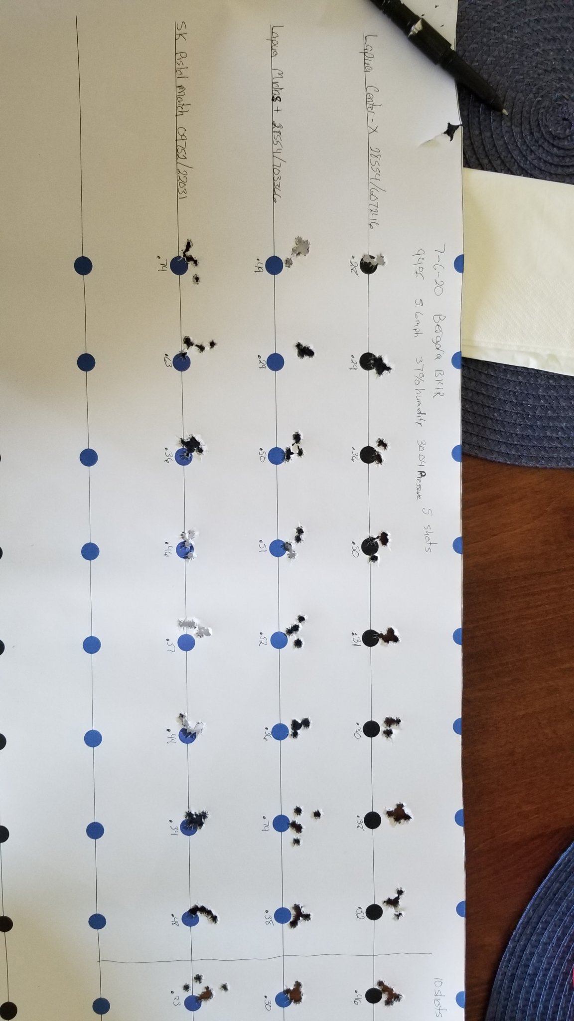

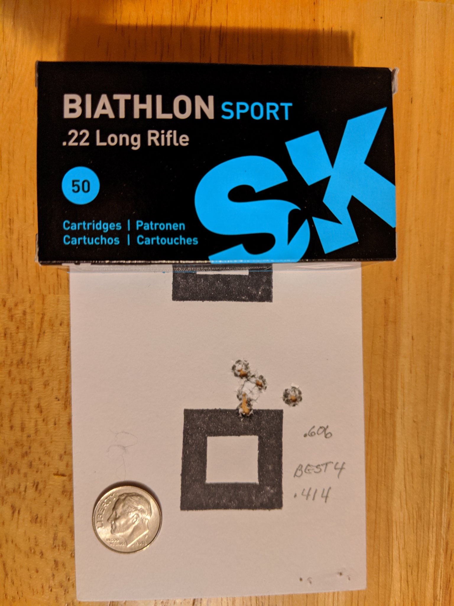

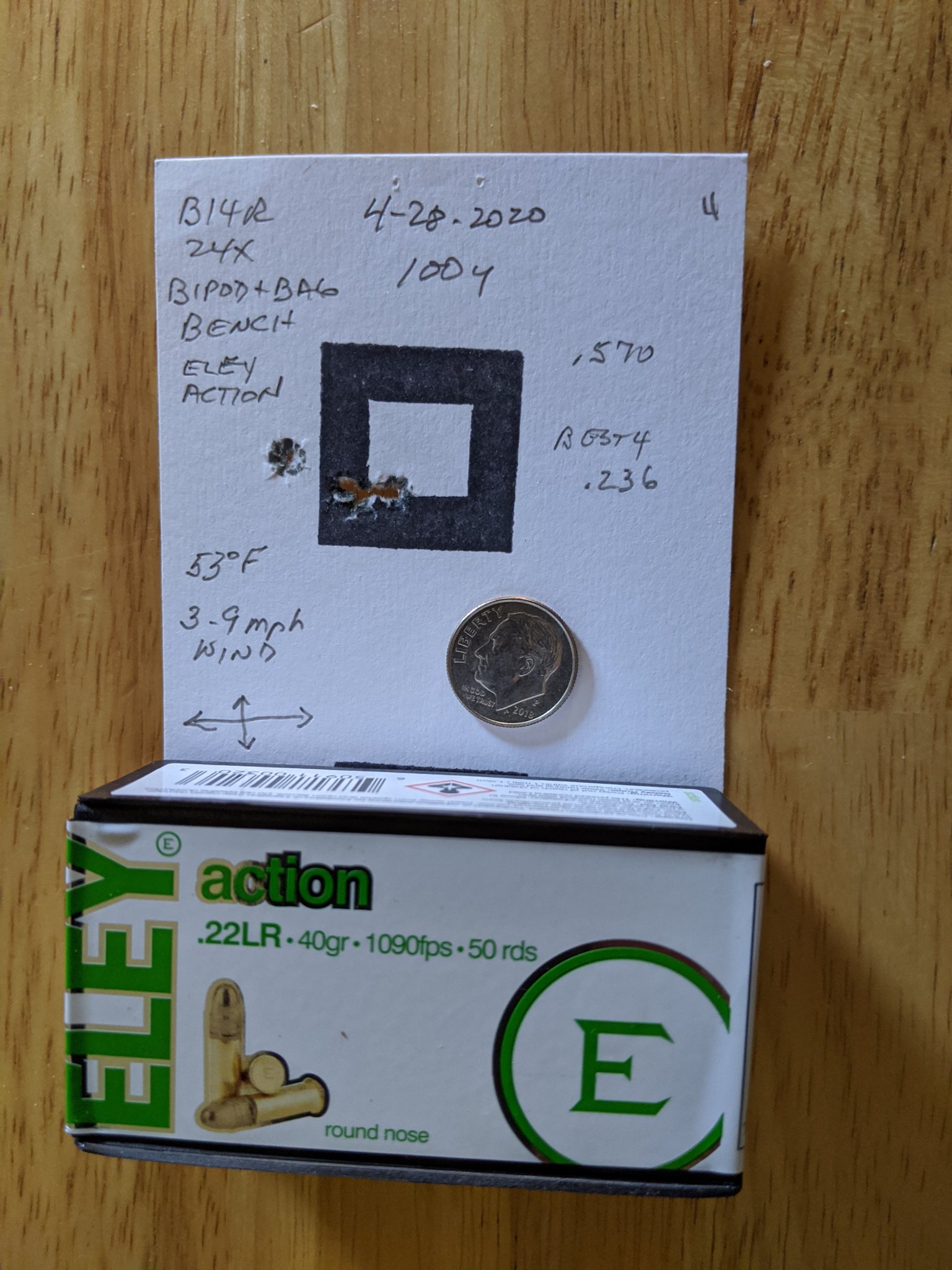

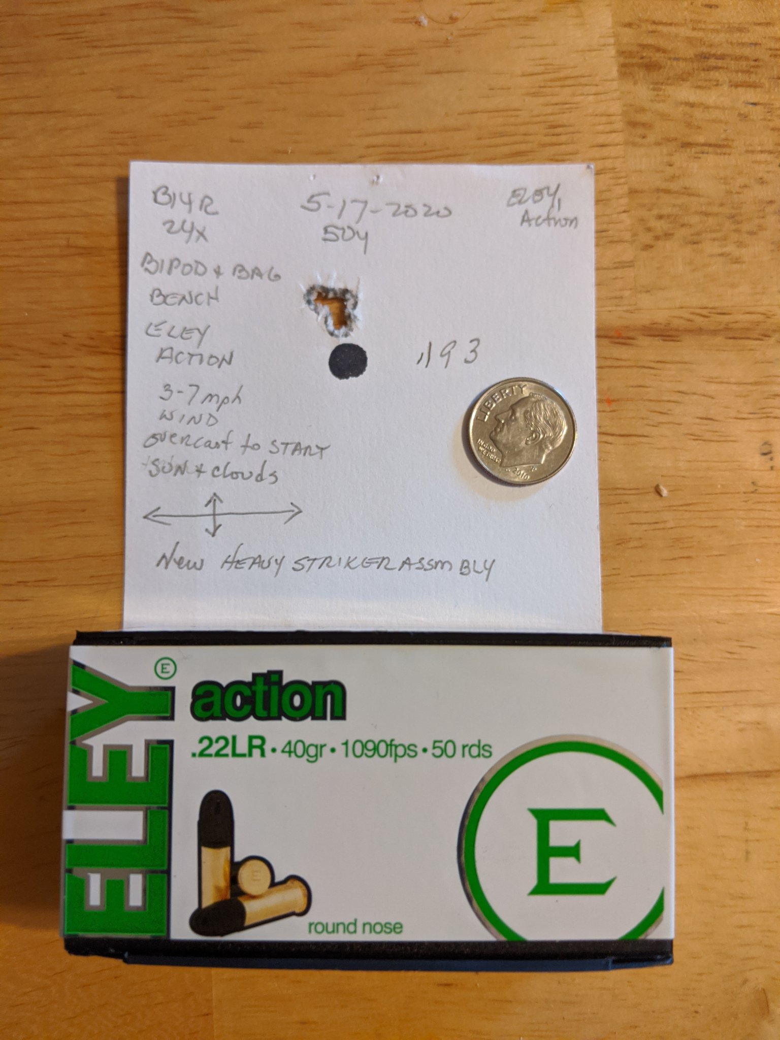

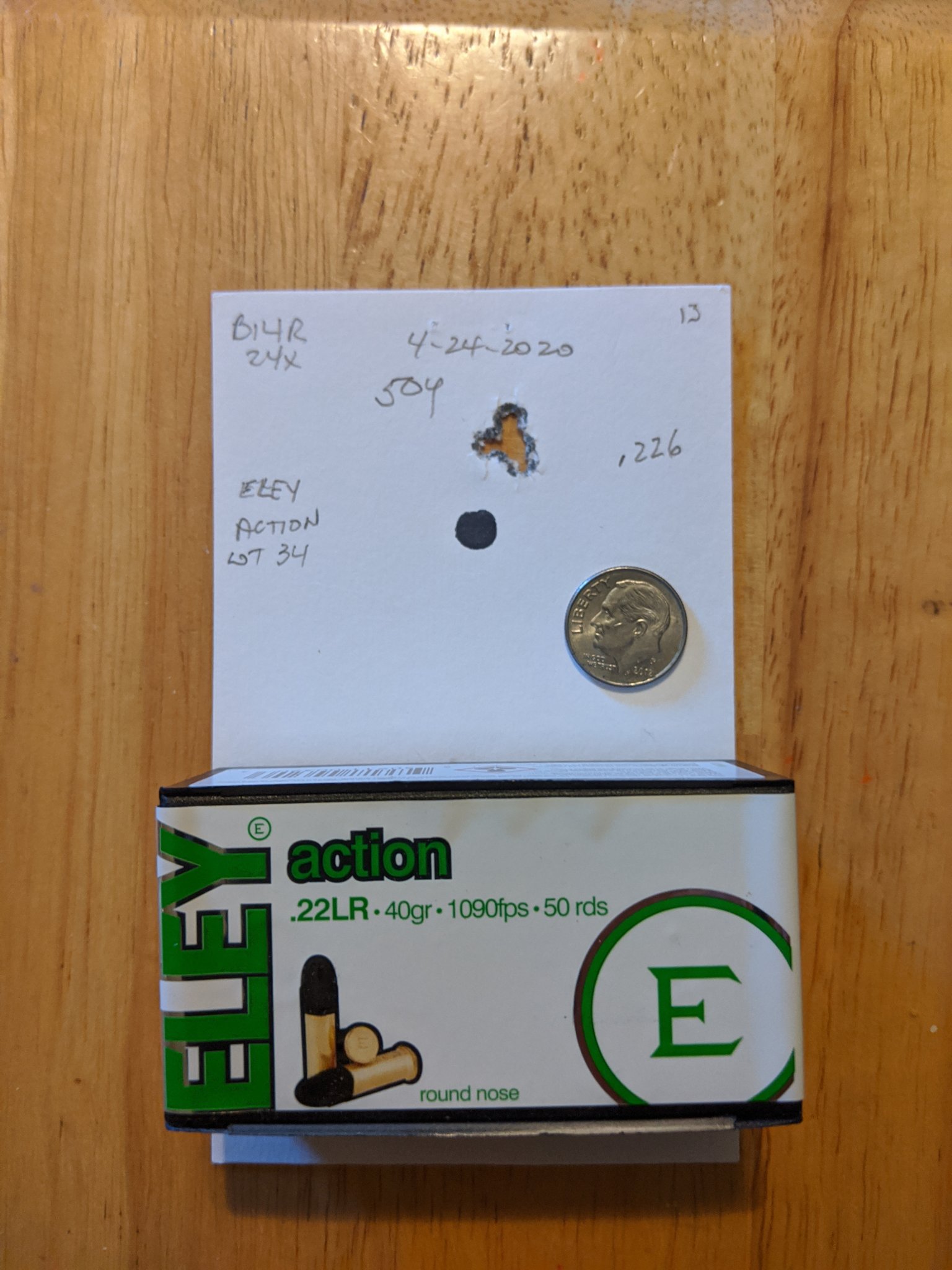

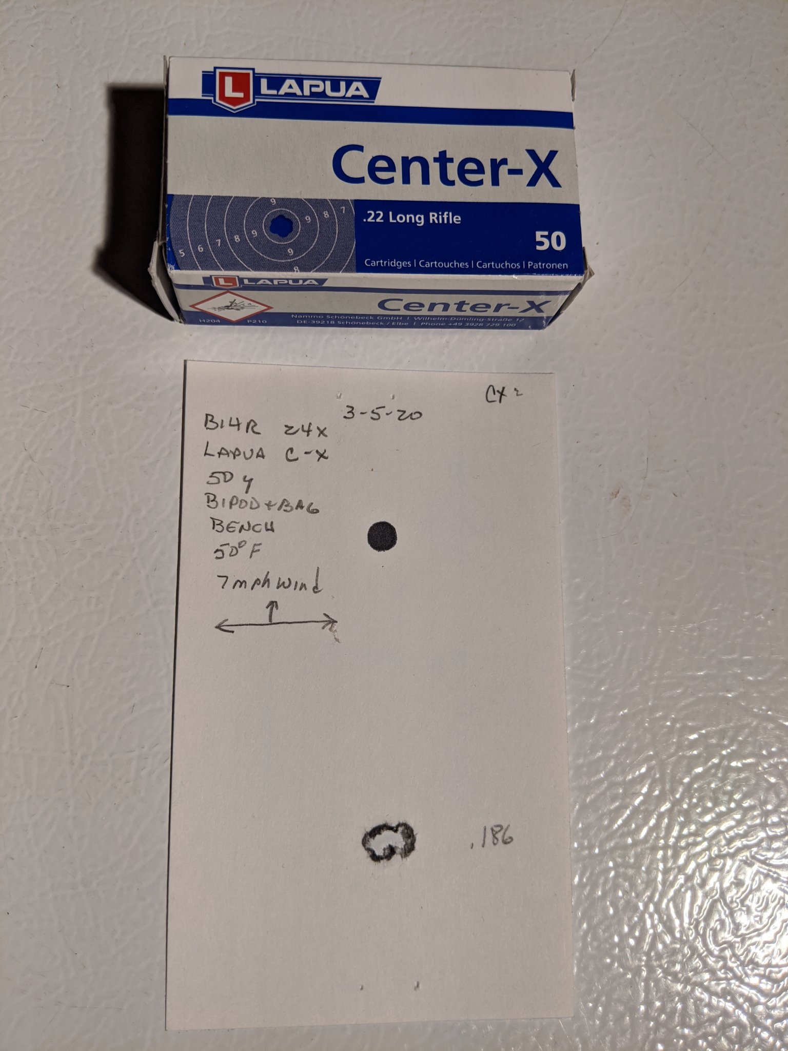

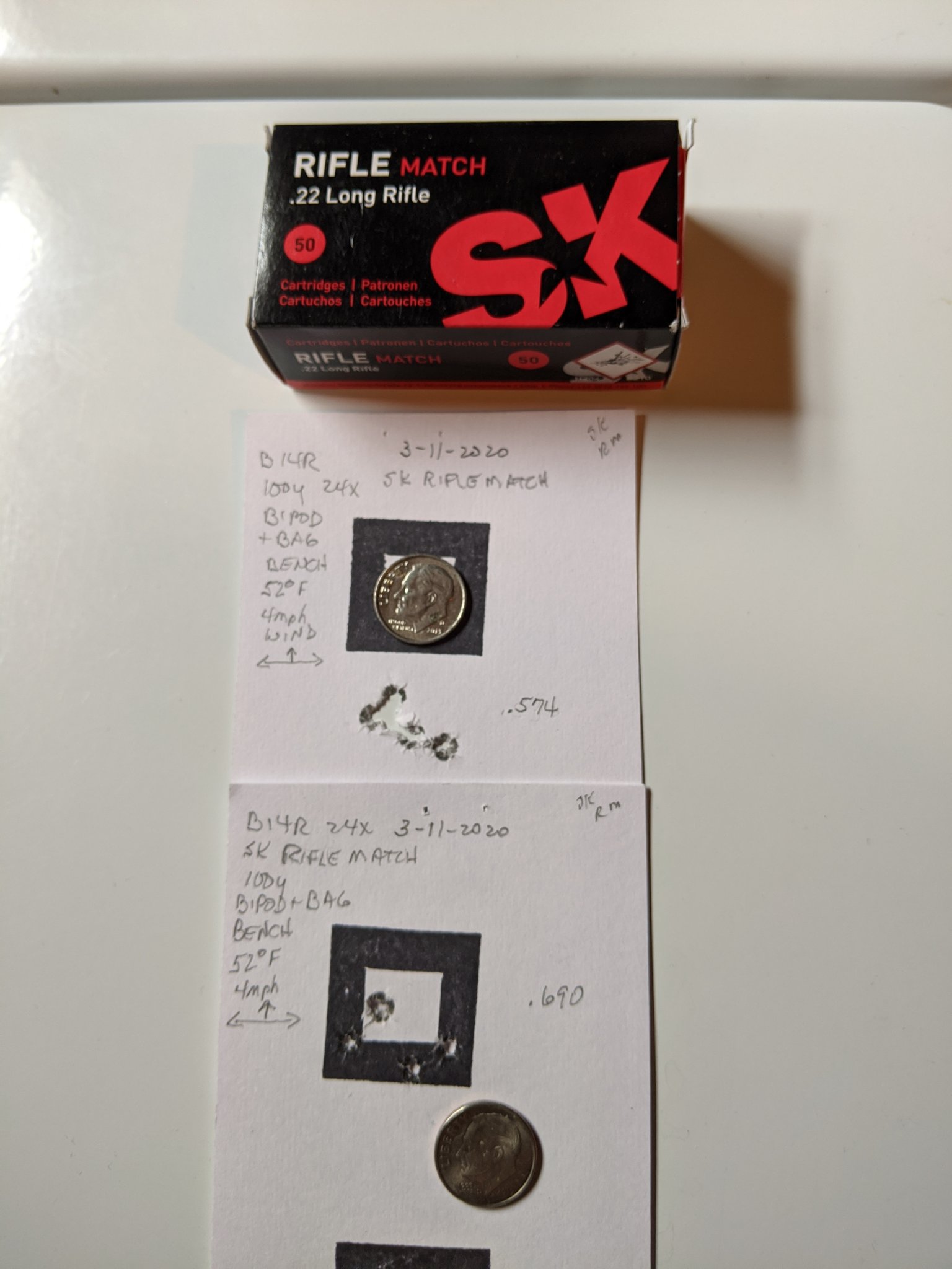

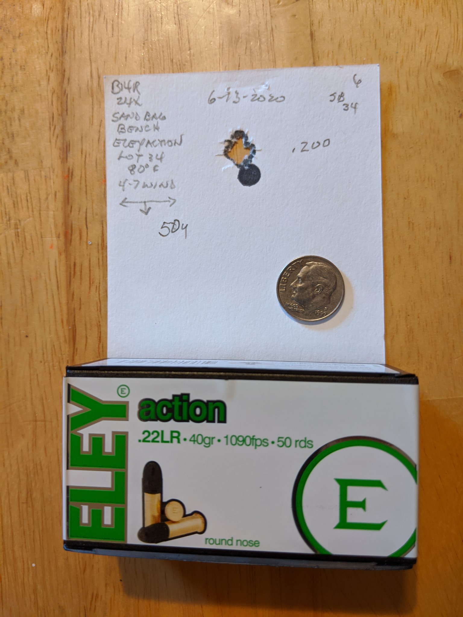

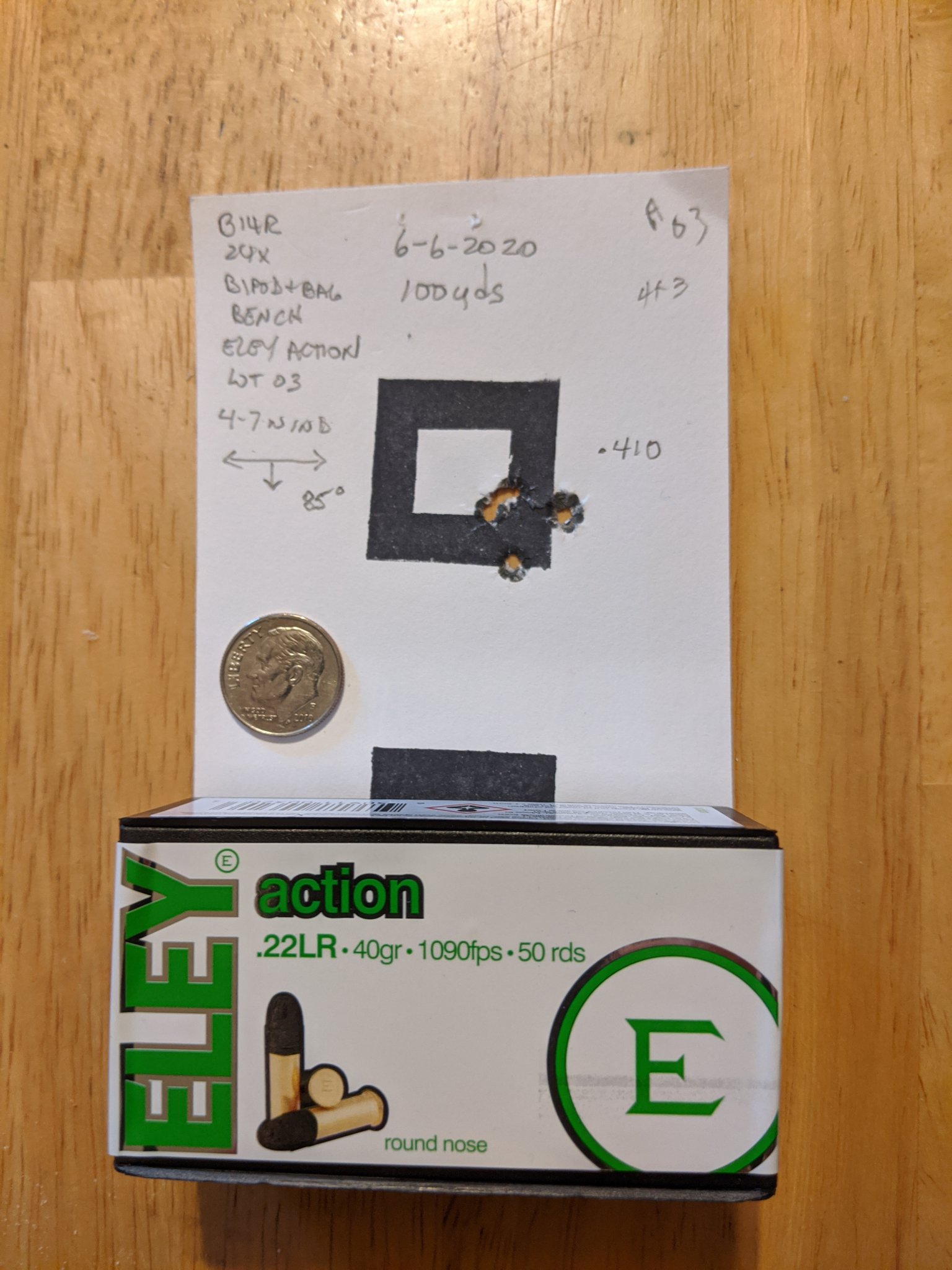

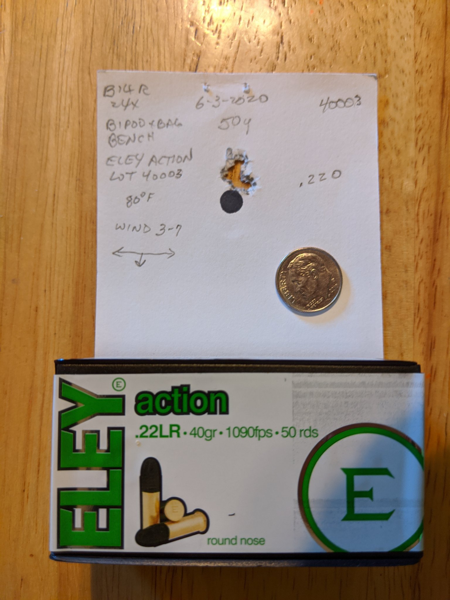

For those of you on the fence about the B 14-R, I'll post some pics of groups I have shot with mine. Conditions have not been great this spring, but occasionally I get a day that isn't too bad. I'll start with 100 yd groups. I'll start another post with 50 yd groups.

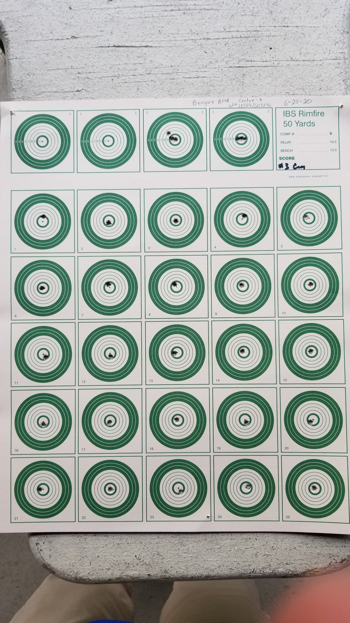

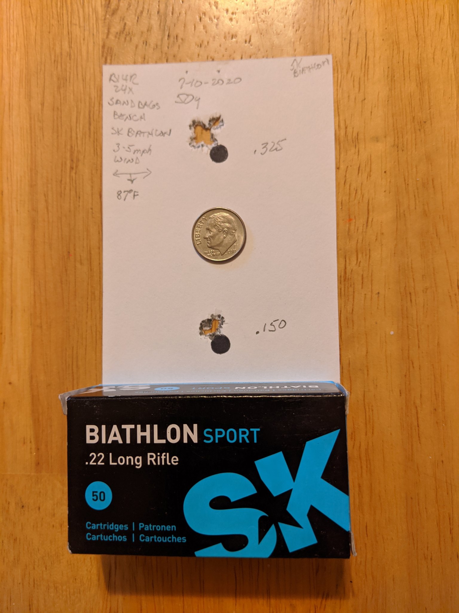

As promised here are some 50 yd groups I shot with the B 14-R. Unfortunately the conditions didn't hold for the top group with SK Biathlon and consequently the group enlarged. I'm sure that had the conditions held, or I read them correctly, the top group would have been much closer to the bottom group. I have more, but I think you get the idea. I'm mainly shooting NRL22 so I'm trying to keep ammo costs down, but enjoy the Bergara. Still not too bad a shooter even with my near 70 year old eyes. I'm really pleased with the shootability and the consistency of this rifle. Would buy it again!
What ammo are you having the best luck with?
As vaguru showed
Pretty much mirrors mine at 100 an 50
Yards with centerX
Midas+ does a little better
However (don’t laugh me down)
Because I tried some geco auto match.
By all reasonable thought this stuff should not do well,
But hanging around 3/4” at 100
An one big hole at 50yard

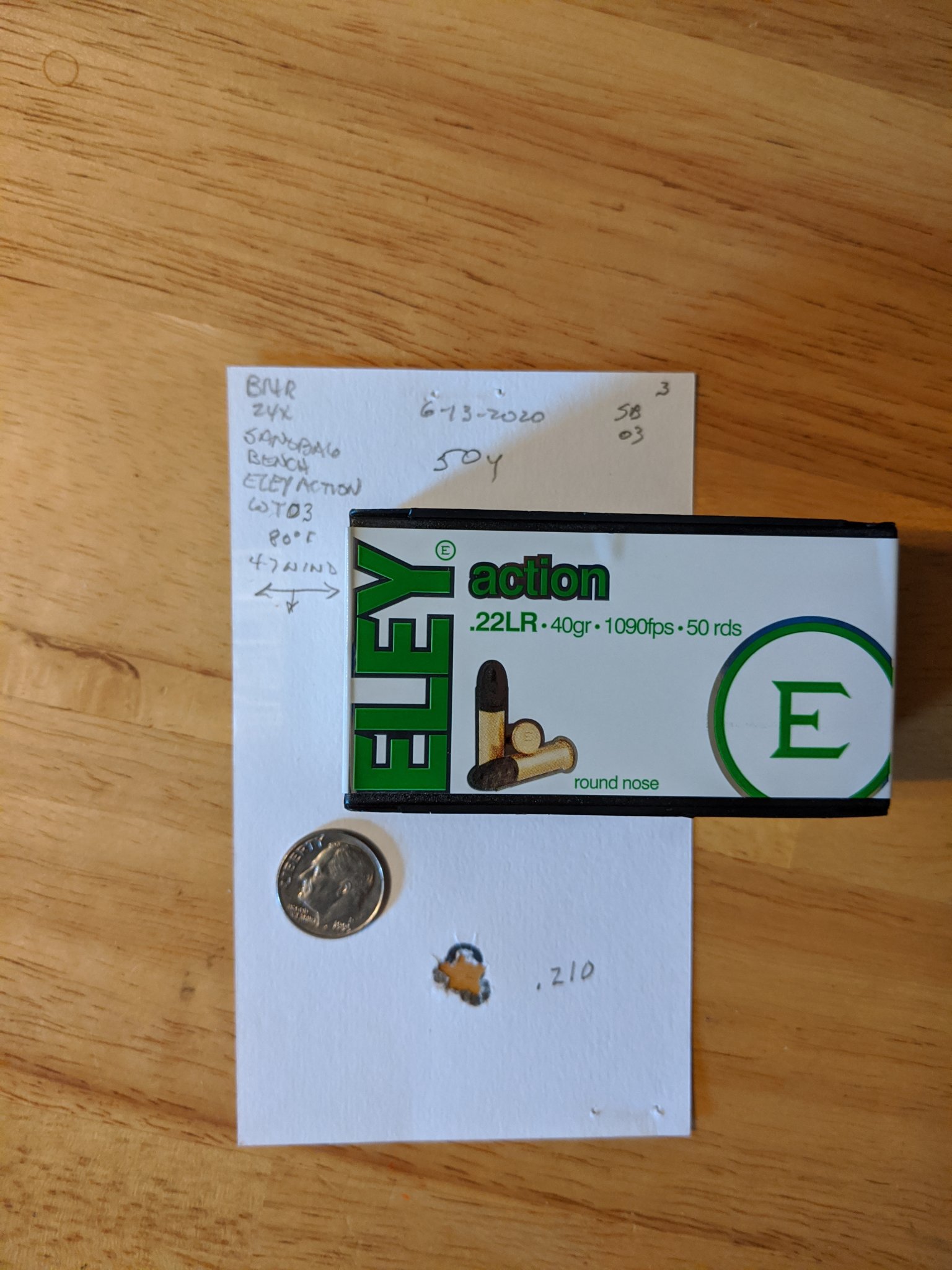

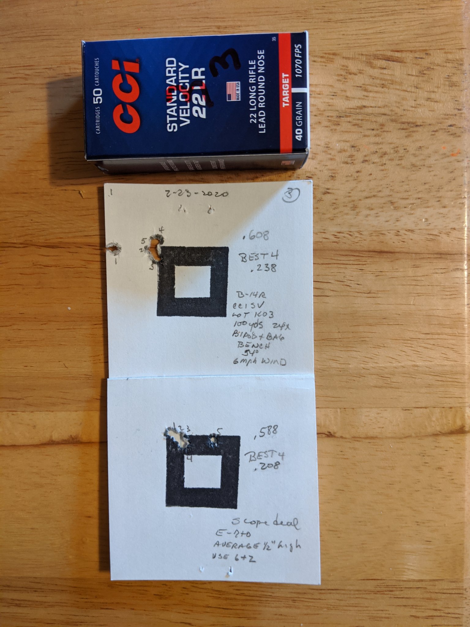

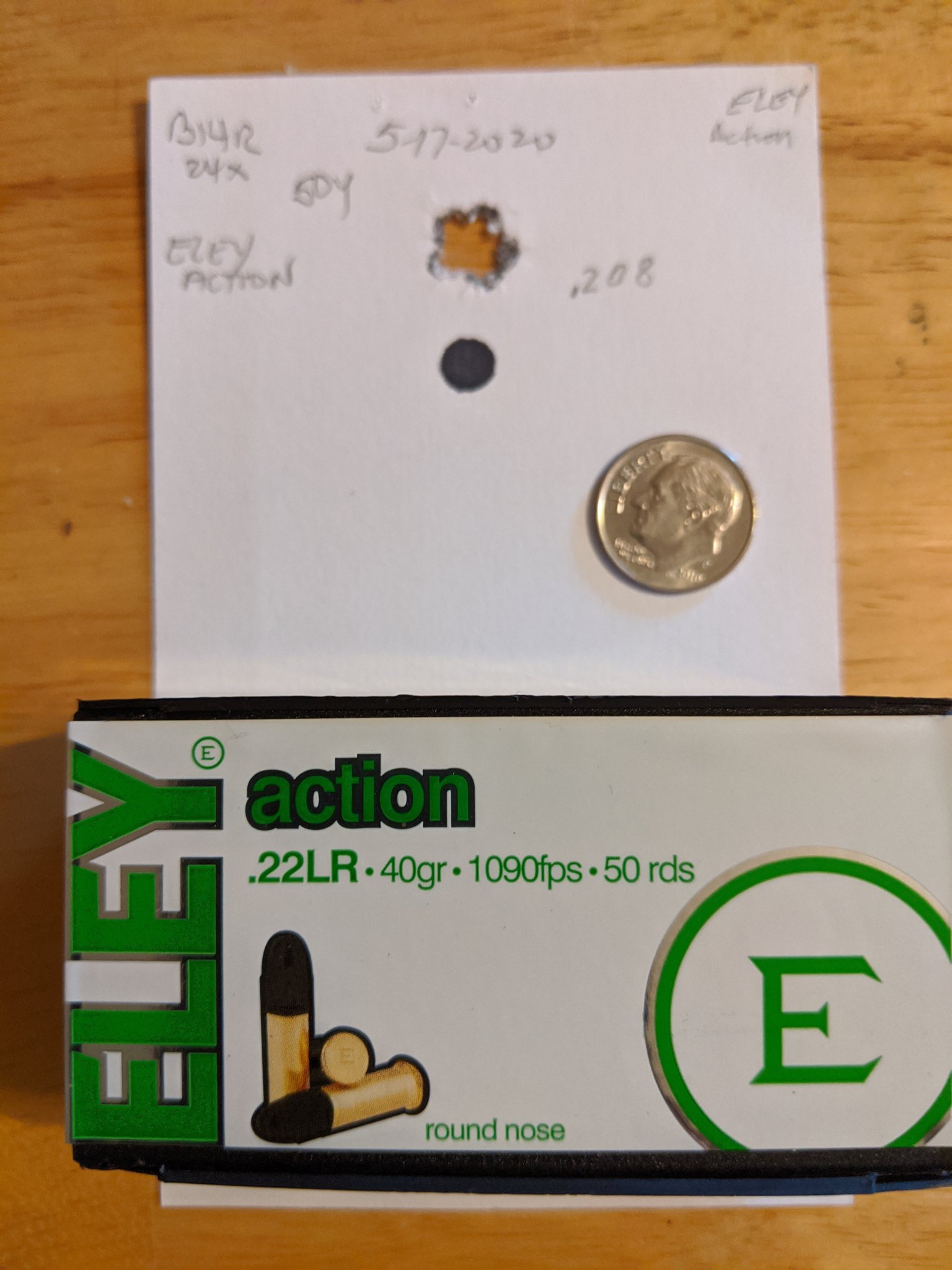

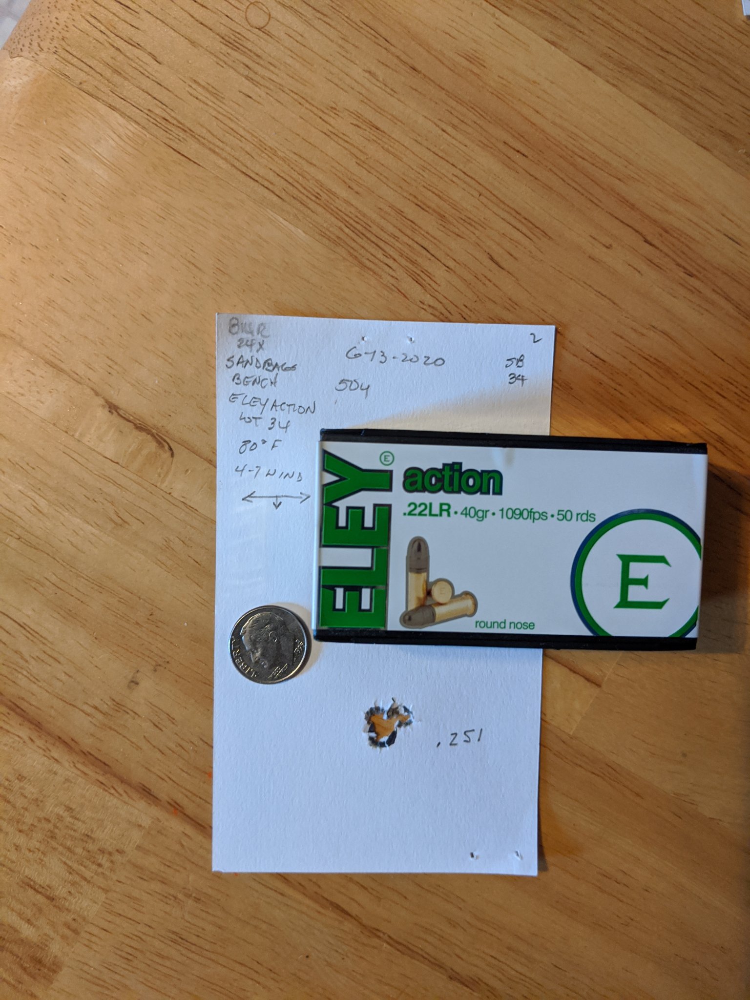

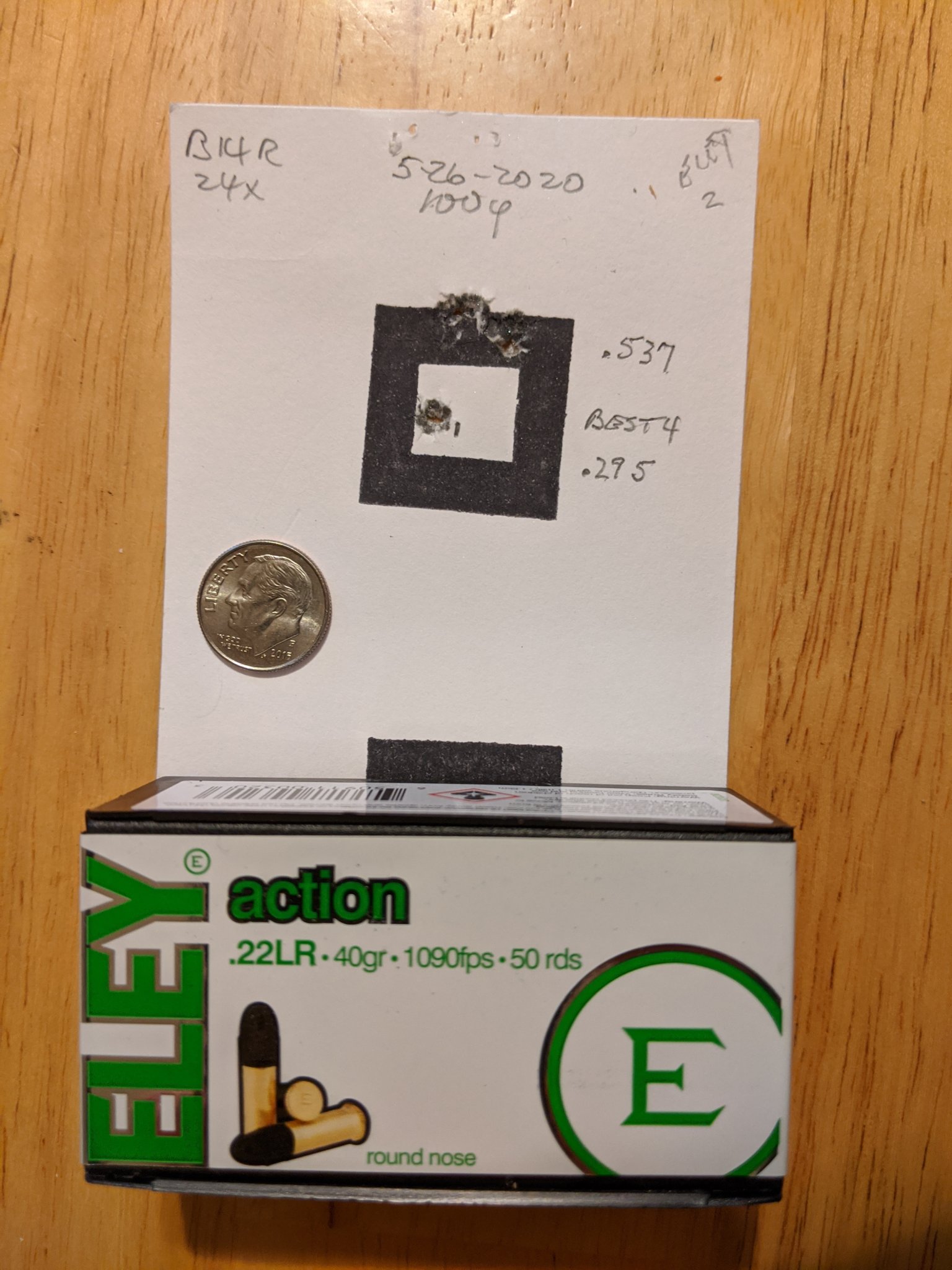

This will be a lengthy report because I want to show a few photos and explain what might be important to you, the reader. This is not organized and will be written as things comes to mind. This assessment should not be taken as an indicator of how all B-14R rifles will perform; this is how mine performs, yours may be better or worse.
Well, the wind finally stop blowing a constant 15 mph with crazy gust from time to time. Today while shooting I noticed that some rounds and different brands had a pop/crack even when using the Sparrow. They were clearly breaking the sound barrier. Everything I shot was subsonic, temps were around 50°. The temp was the only thing I could think would cause this as I have never experienced this before. Not sure if that contributed to the many "stray" rounds I had but I seemed to have had quite a few. Many of the 5 shot groups were ruined by one round and it wasn't always the 5th shot either. Didn't get any photos of the rifle but will post some showing essentially what it looked like today.
I hope and believe the rifle will shoot better than the targets show. Sample size was with nine different brands of ammo that didn't include any Eley. At some point, I will be playing with the torque settings on the action bolts. Today all targets were shot on 20 in/lbs. *EDIT* ONE PLATE WAS SHOT WITH CCI SV AT 40 IN/LBS. Eventually I will use CCI SV and see if the rifle has a "sweet spot". It took 60 in/lbs on my Wheeler FAT wrench to break the bolts loose when I removed the stock for trigger work."
