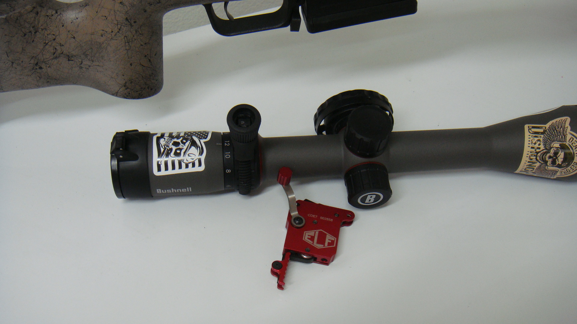

I know KOD has tried a bunch of triggers, I ordered myself a Jewell today.. so hopefully within a week I’ll have some info about it. I’m sure it will function as all jewells do.. I’d like to get into the ounce range on mine.
I also bedded my action in Devcon, in the factory HMR stock so hopefully that will make an improvement. Seems like the loose fit to the stock was really sloppy to me.. I didn’t have any issues with the rifle, just when I attempted to turn the trigger down I discovered how loose a fit it really was. I’ll get some groups at 50 or 100 yards after the trigger is installed.

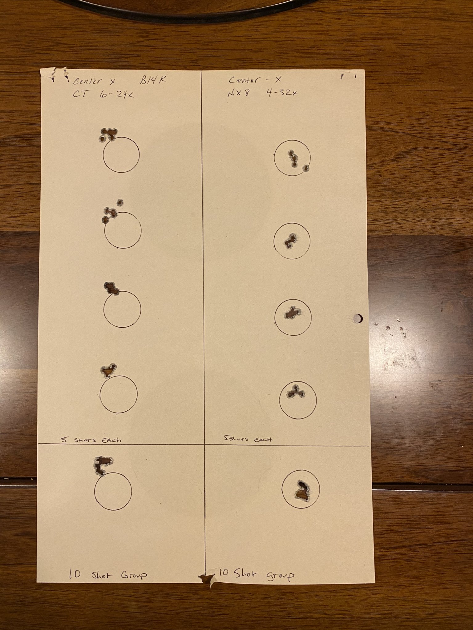

If nobody has a problem I will start putting the info from my B14r Carbon in with these instead of the topic I started. The Jewell trigger worked great For I’m guessing 250 rounds today. Conditions switching I really need to set up some flags instead of guessing what it’s doing at time of shot. Used 50 in/lb today.

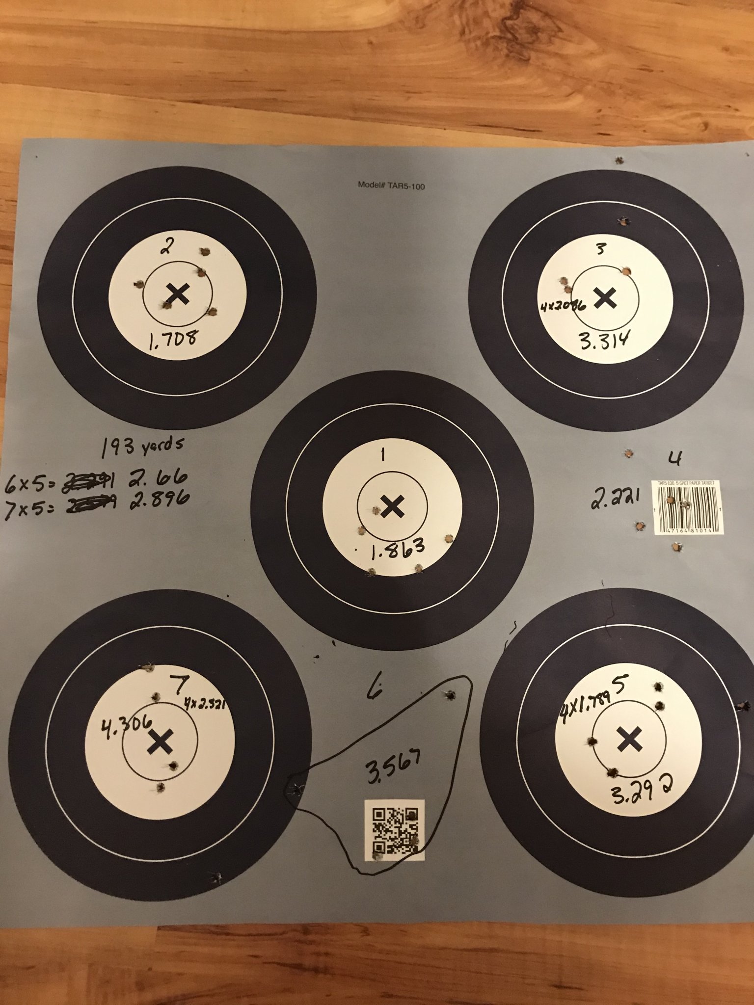

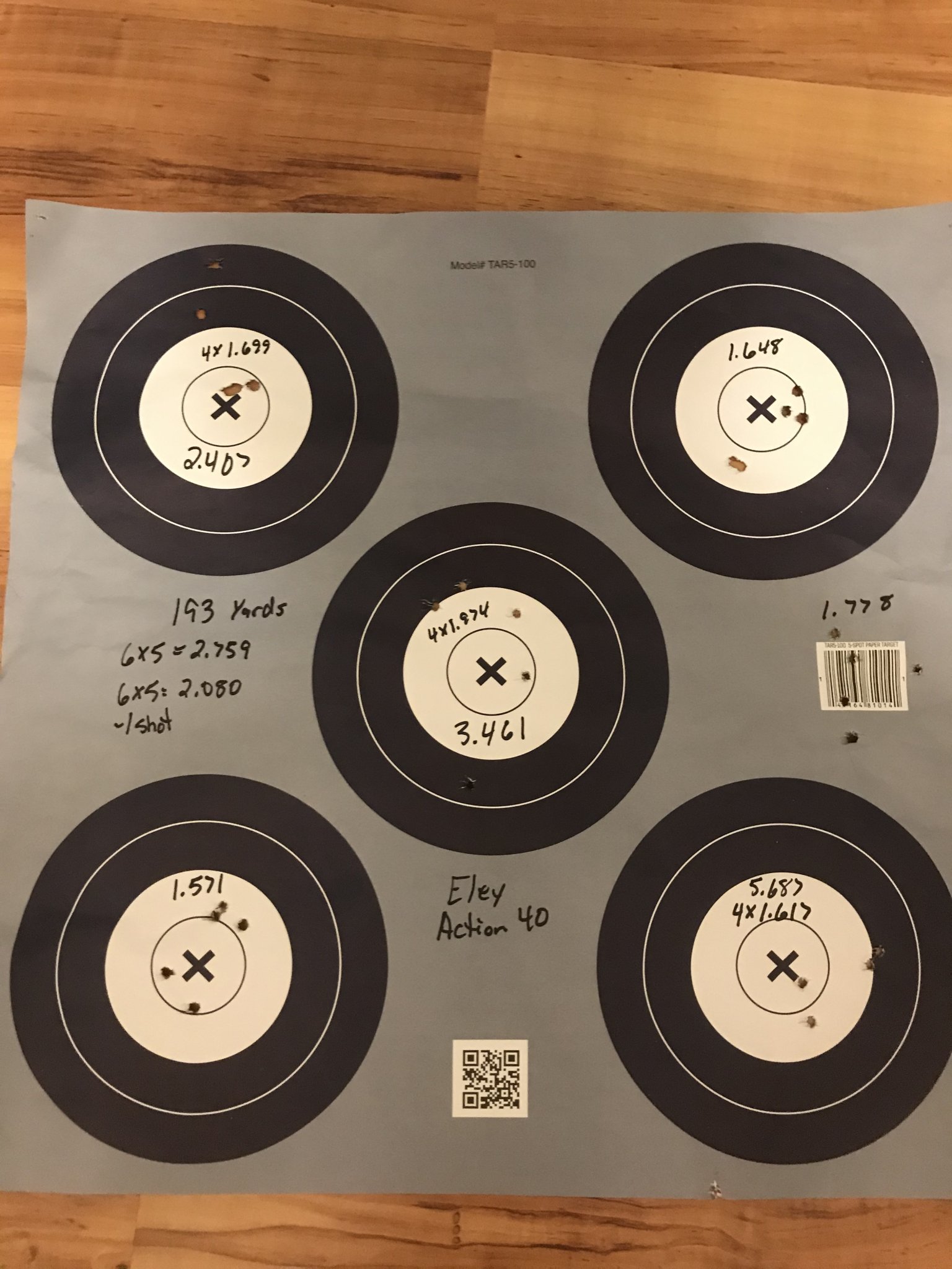

193 yards Eley Action. Targets 5 and 6 wind got me. Pulled the very last shot on 7.

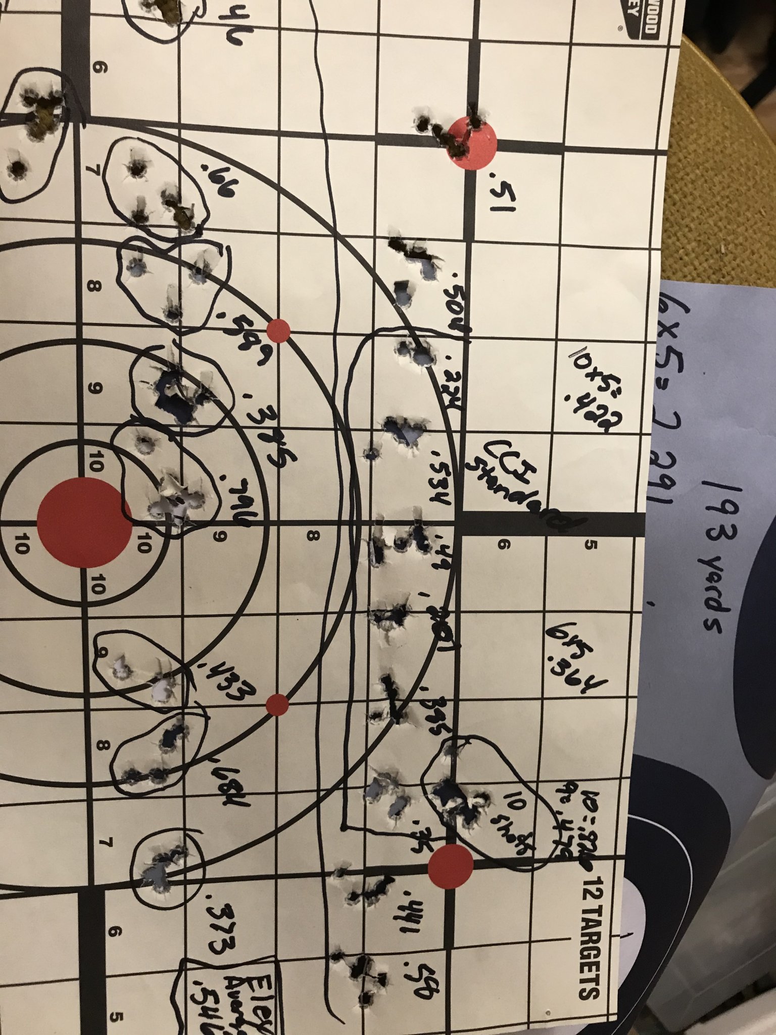

Had a pretty good string on a 10x5 at 50 with an old lot of CCI standard. .422 10 group average with a 6x5 of .364.
