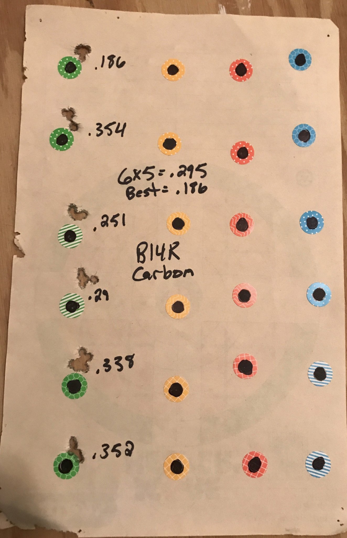

Did a little 200 and 300 yard practice this weekend.
Glad to see a new post. Things have been quiet on the B14.

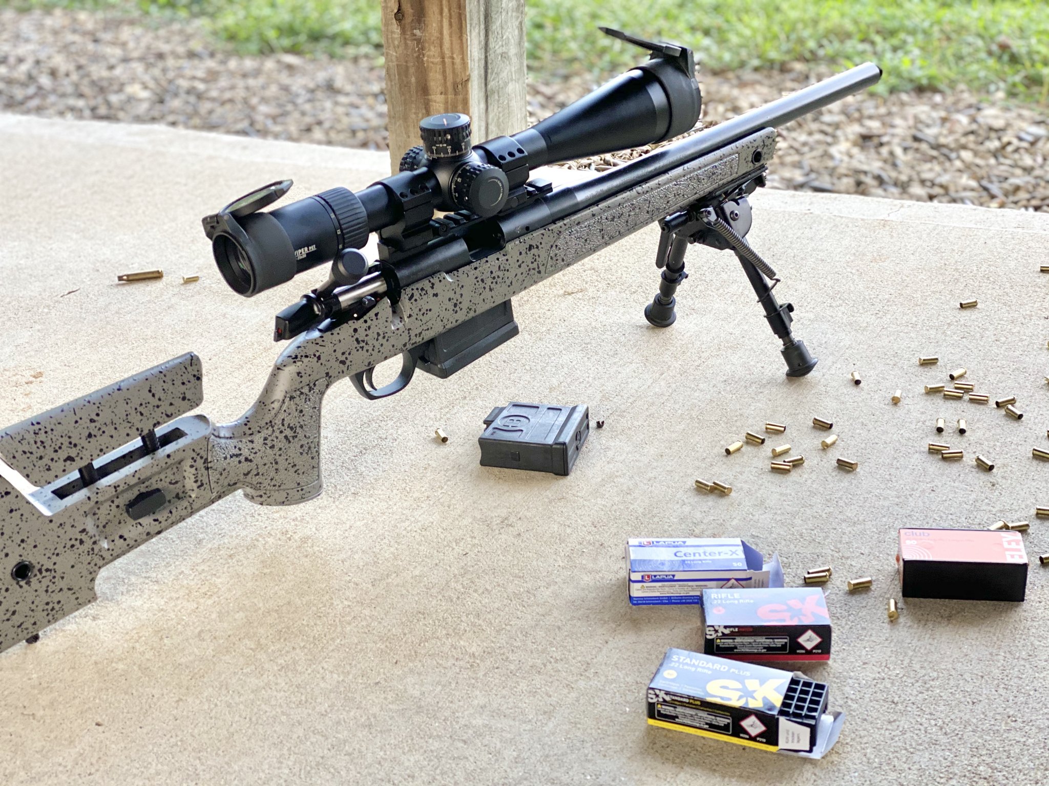

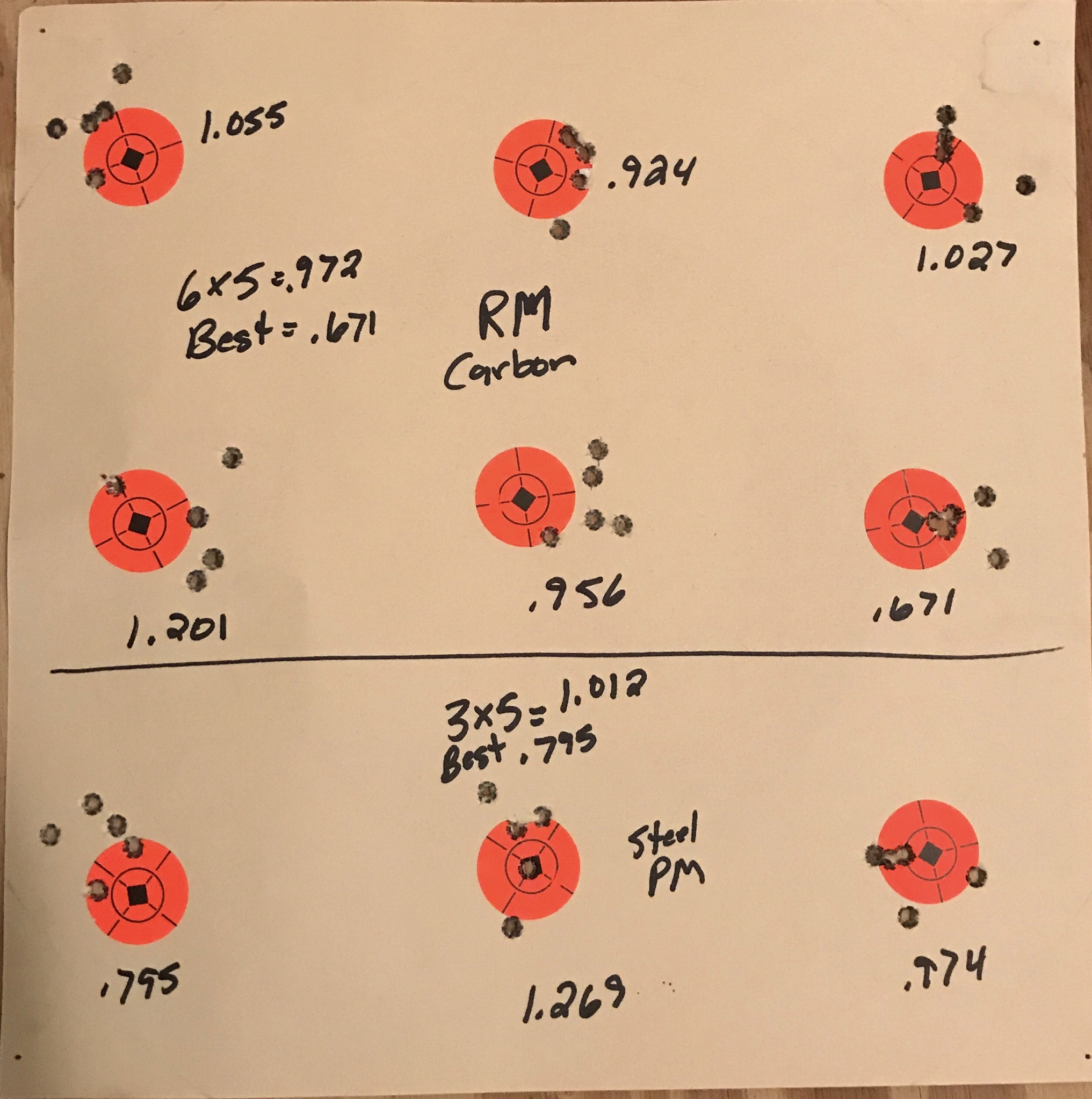

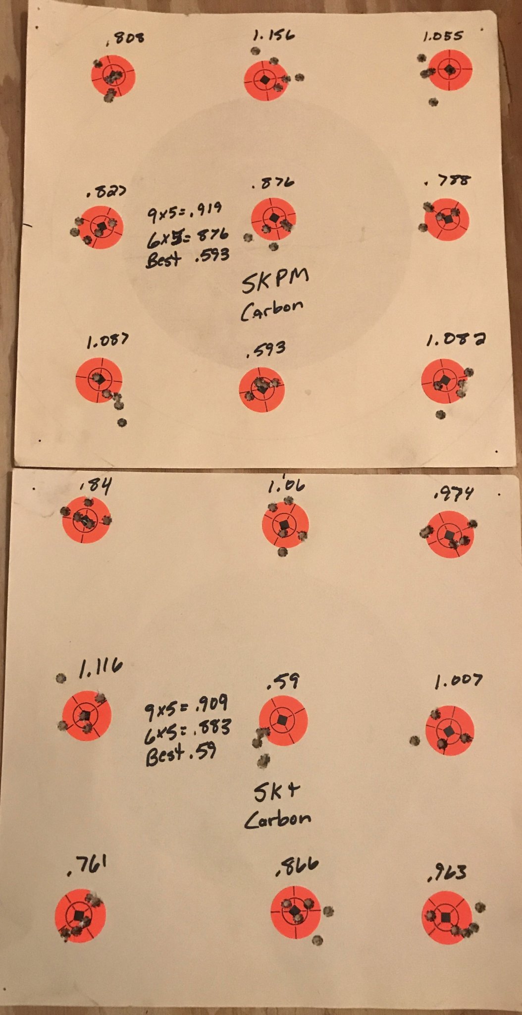

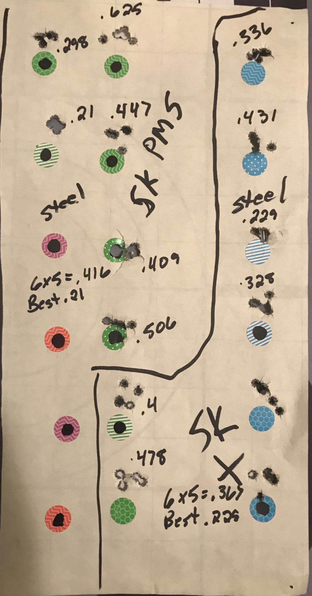

Finally got around to shooting a little better ammo (At least for me) out of both guns. Shot a few different SK ammo types plus my normal stuff. I’m starting to think that the carbon setup is slowly pulling away from the steel one. Or at least with the ammo I have tried. The Carbon gun just seems to have less flyer. Both shoot pretty good even with various bulk Rem/Win/Fed. May have to do some 6x5s with them just for fun to see the numbers. Think they will be under 1.5 average. Here is some targets I shot in the last few weeks. Most of my range time is spent shooting at 1in shoot and see dots on targets left on target boards, bullet holes at 100 and dirt clods at the 200 yard berm. I find it more fun.
Carbon—51 and 101 yards. For some reason my range has target boards at 23/51/76/101/193 Yards.
8E539AD0-94A0-4923-9AD2-F6387F1E06F4.jpegDE32C785-610A-49A3-B129-2F86D254A100.jpeg0812C0D3-E545-4F35-A7A9-2A0BA0568A38.jpeg
Steel-Only took picture of the 51. Did do a 7 group target that was almost exactly 1in with SK+ at 101 so nothing special.
Tested some more SK. Carbon gun liked PM Special and did just ok with the RM. Steel gun looks like it does a hair over an inch with everything. Going to just start bringing it and my CZ to the range till I get it figured out. 101 yards

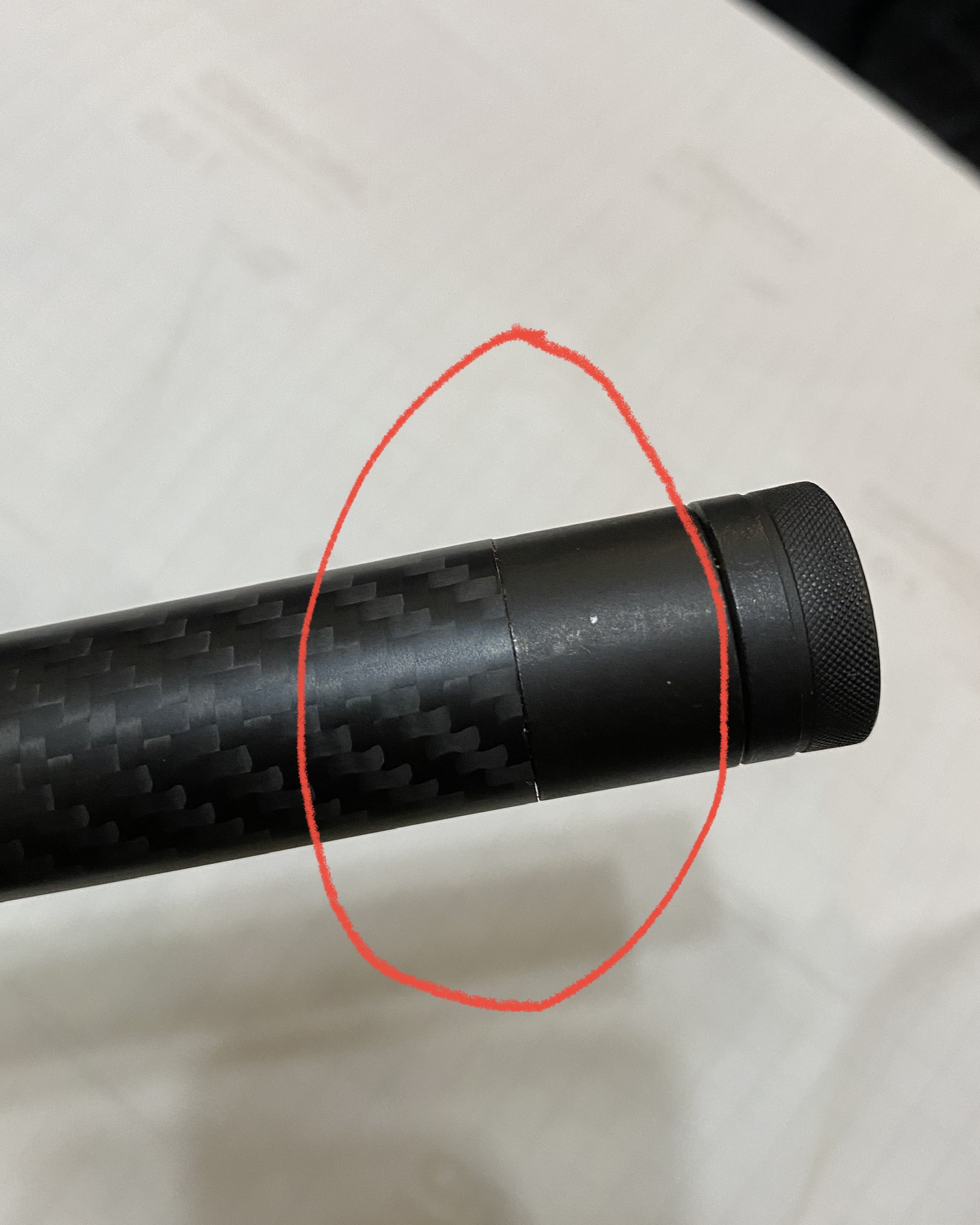

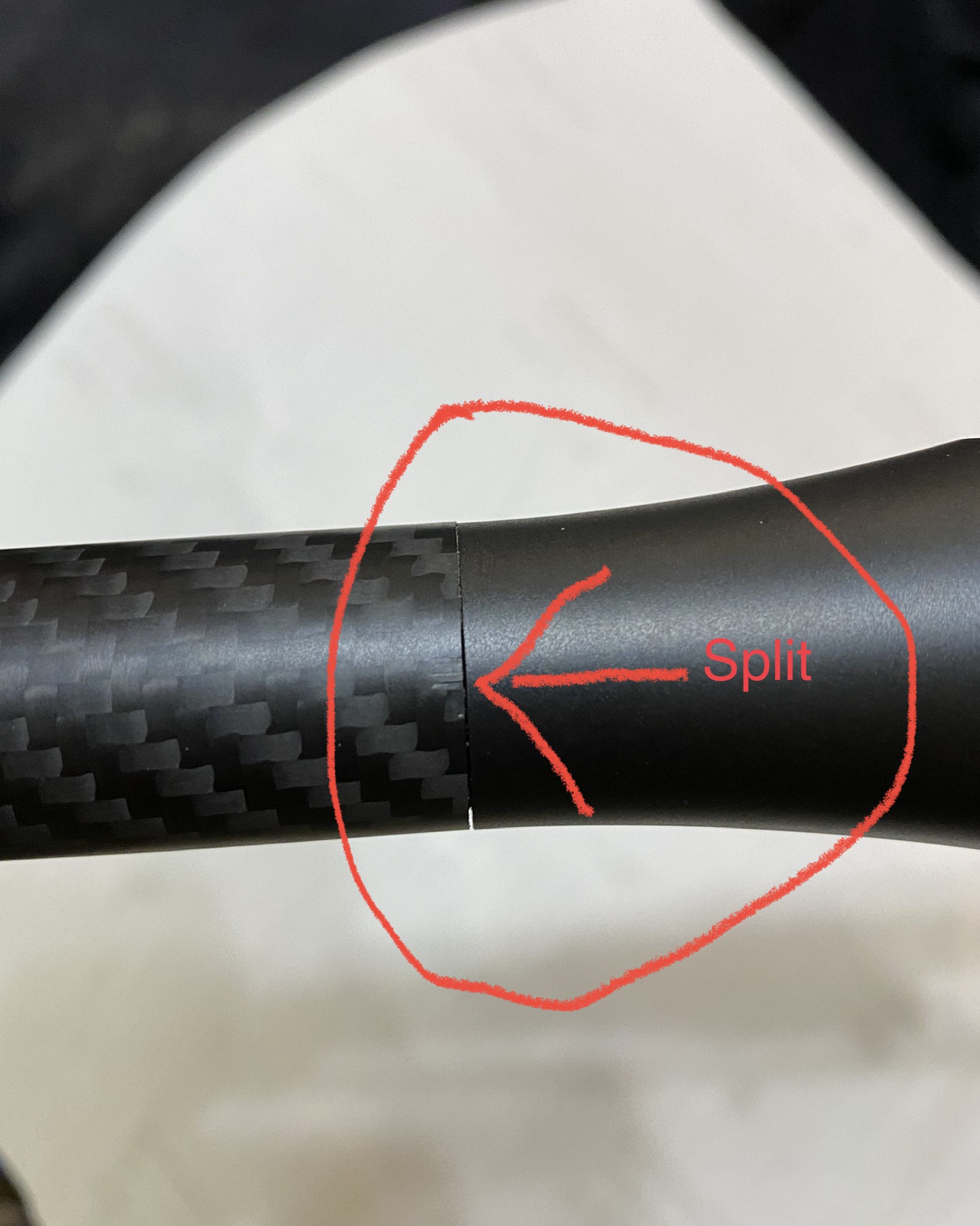

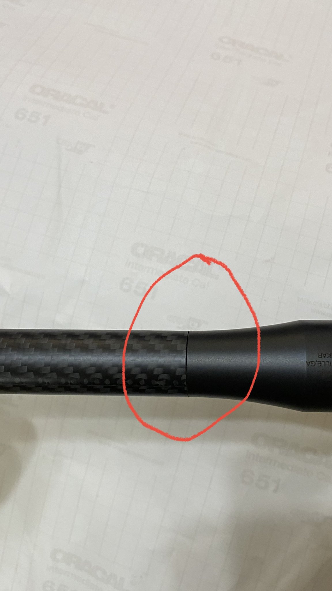

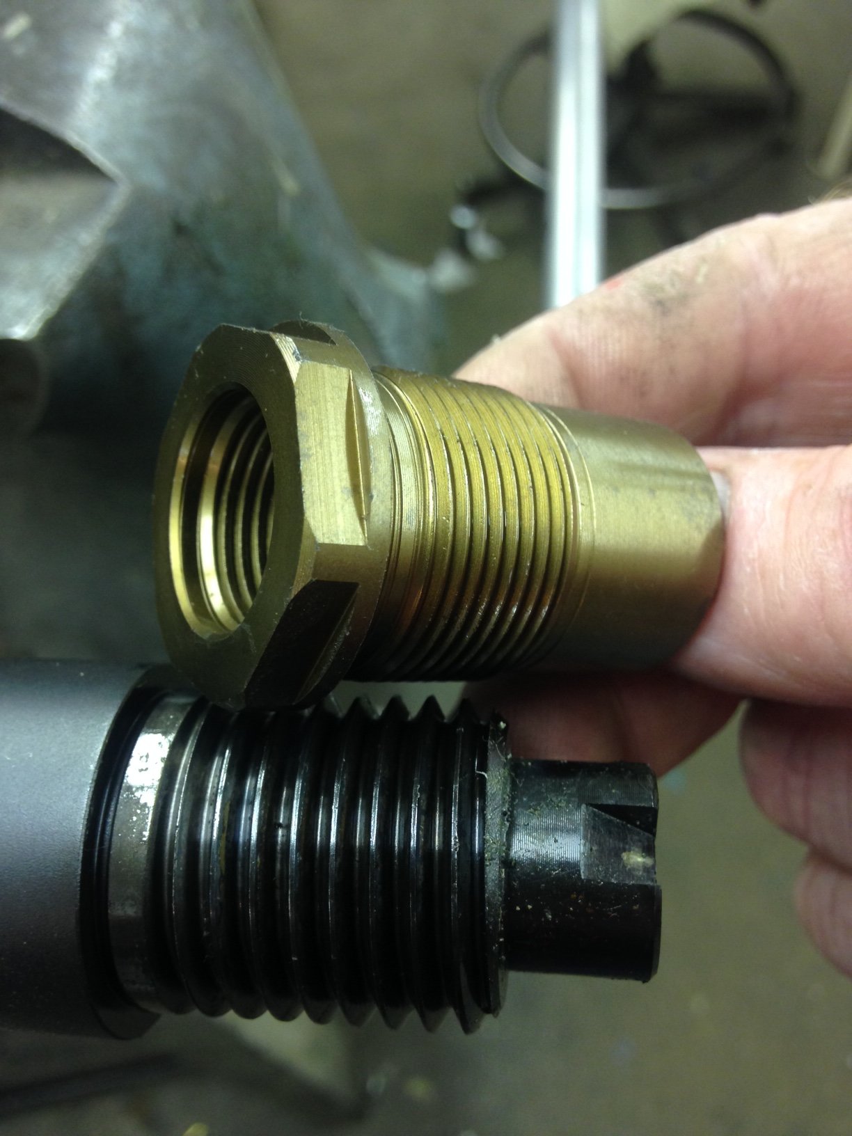

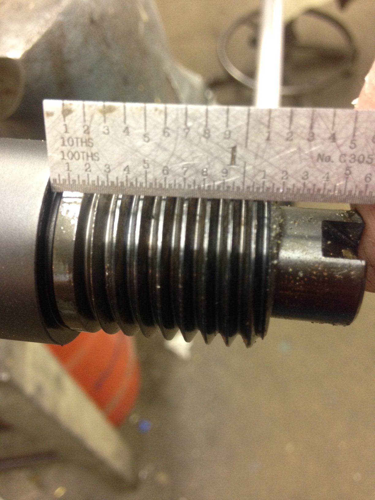

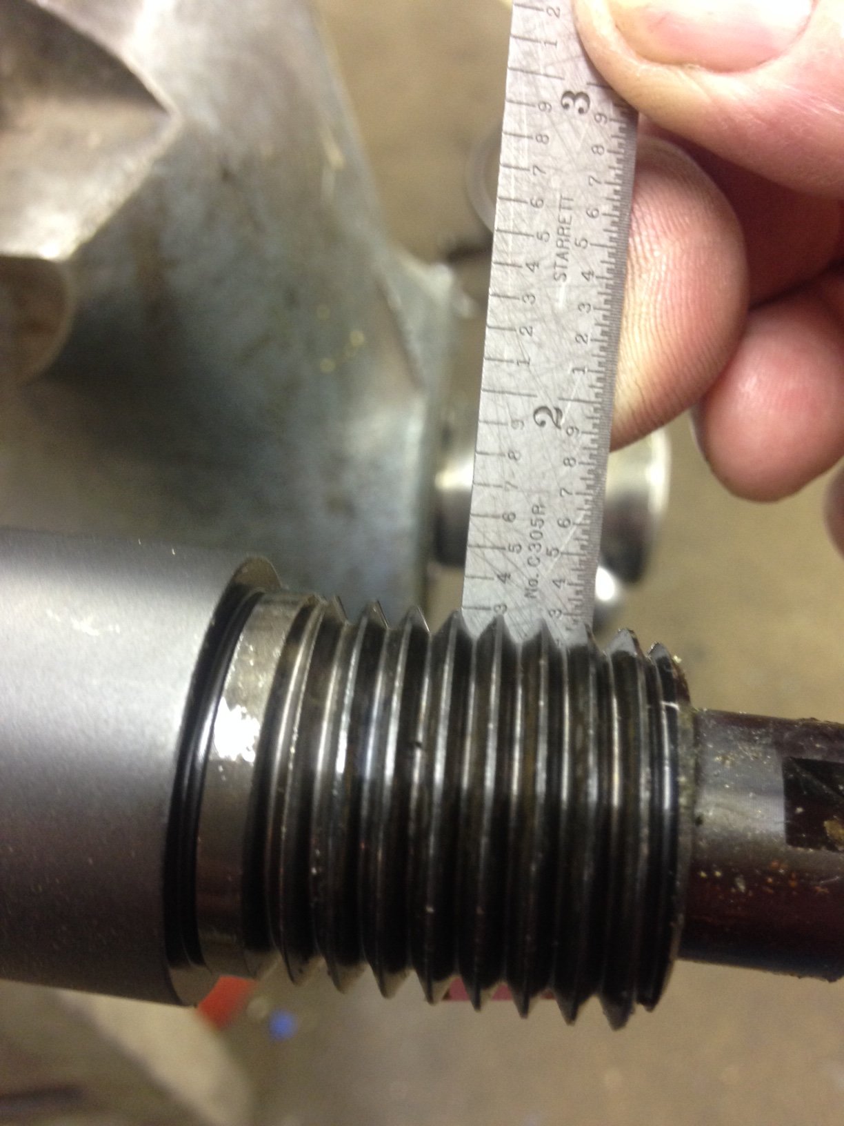

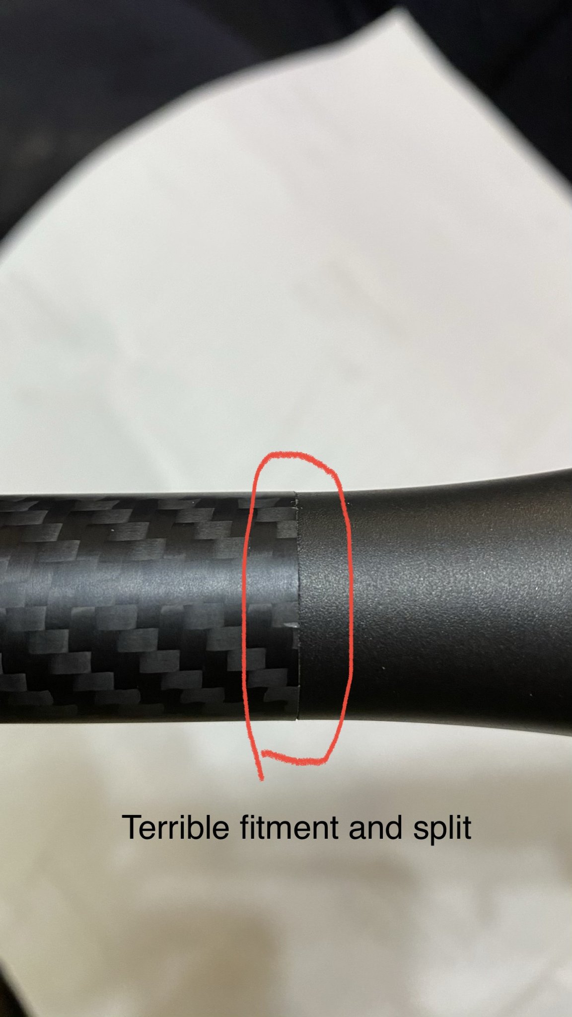

Had an issue when trying to run a suppressor on my B14R Carbon. When attaching the suppressor, I'd have extreme POI shift. 10+ mils, and groups opened up hugely. I tried 5 different brands/models of 22lr suppressor with similar results that varied per can. Those with larger bore diameters shifted less, which led me to believe it was baffle strikes. I've experienced this exact same thing with other carbon tension barrels of this design, such as volquartsen, and others. The shoulder on the barrel is comprised of a threaded nut, that is tensioned against a carbon fiber sleeve. Sometimes, that nut gets off axis from the bore, so when you tighten up a suppressor, it will pull it off axis. Other times the tool used to interface the two holes in the nut, damages the two holes, and causes a bit of material to stick up which will contact the suppressor before full lockup. This is not specific to bergara, but rather can happen with any barrel of this design. Without the suppressor attached, the rifle shot great.
With the barrel setup true to the bore in a lathe, you can face off the nut, and square it up. This solved the issue 100% and I can now attach a suppressor with only a couple tenths of a mil of shift, (which is very minimal) and the groups are nice, just as they are without the suppressor.
Before:
After:
I bought a B14R Carbon online and just got it today. Because of your post I checked the barrel and my suppressor with an alignment rod and it was way off. So, thank you! I probably never would have checked. The fit and finish of the carbon to the barrel is absolutely terrible. Here are some pics of what I got.
Sorry you're dealing with that, but glad I helped.
I first had this issue with a carbon tension barrel long ago... like 15-18 years ago. It stuck with me since. ;)
I emailed them about it. Hopefully I’ll hear something back before the weekend but I doubt it.
Please keep us updated. I am still struggling to choose between the carbon and steel barrels, but I want to shoot with a can, so this is a big issue for me. I'd also like to know what they are going to do about the poor fit between the carbon and the barrel.
This is a big issue for me as well, because I planned on primarily shooting it with a can. When I used my alignment rod I could feel it hit at least three baffles in my can.
I actually received a quick response from them this morning. They emailed me a return label and repair ticket, but they told me it would be a 4-6 week turn around. Needless to say I was quite unhappy about that news and replied saying so. I received a prompt call from them shortly after my reply. They upgraded my shipping to overnight but still 4-6 week turnaround. They told me it’s because this is a busy time of year for them with hunting season coming up and between CVA and Bergara they only have three gunsmiths on hand for repairs.
They are going to make it right, but it’s just aggravating to buy a new rifle and have to send back immediately.

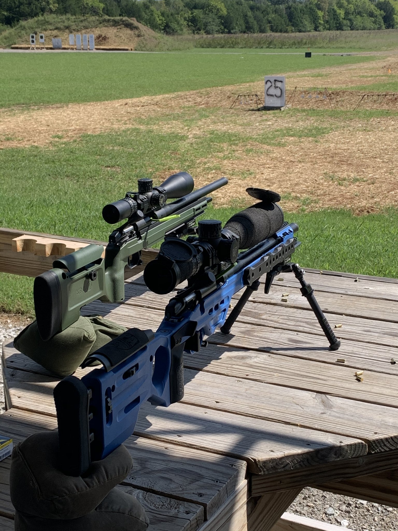

Took a friend out to shoot 1K with his new 6.5 today. Broke out my Bergara at the 200 yard line for fun. Didn't do too bad, decent waterline with CCI SV, holding one mil, and small gusts blew to 2mils. Two inch dot.
So I shot my first rifle match of any kind yesterday (NRL22) with the B14R. Came in 6th which for my first match I am more than happy with. There were 3 Bergaras in the top six. Such a great rifle for the money I couldn’t ask for more.
RFutch,
Did you or your friend see a significant improvement in anything by switching stocks? I have two Bravo stocks and two MPA Hybrid chassis, improvements were mainly ergonomics going from a hunting style to a pistol grip tactical style. Not sure how much of an improvement "if any" I'd see over the B14R stock.
Just ergos I’d say. I liked the grip of the HMR stock but Everything behind that felt odd to me. Like it was too low or something.
After shooting this match I am wanting to add more weight though. Mike is 11 lbs now and I could definitely see where a few more would help. My buddy’s weighs almost 20 lbs lol.
How do the mags work in both the Bravo and MPA? I'm thinking about getting the MPA because I will eventually get a Gen 2 Vudoo or the Deuce Ultimatum. I already have a Bix & Andy trigger not being used so it's not like I'd be "wasting" money by buying a 700 footprint chassis/stock.

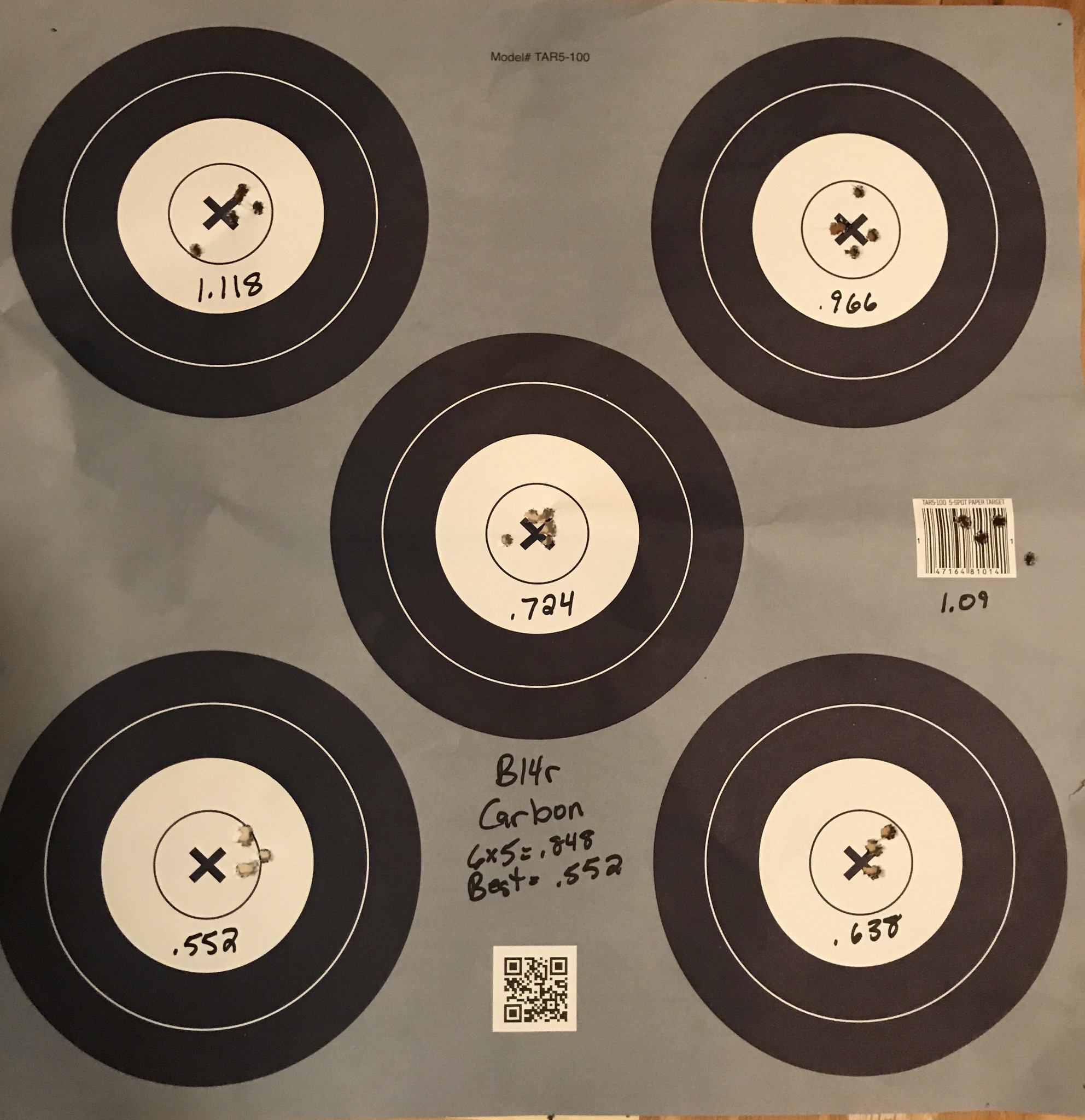

Initial results of having mine for a little over a week.
50yd, 5 and 10rd groups, Center X
50yds
SK Match top 2 groups
SK std + remaining
50yds
SK std +
SK match. The hot rounds were from ammo that was left out in the sun.
100yds
The wild groups of SK and Center X were fired during gusts from N-S. I was curious to see the dispersion.

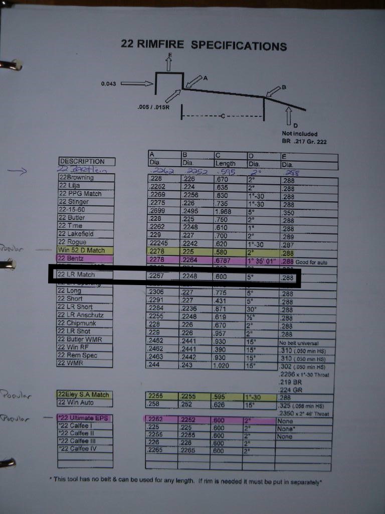

Talked to Mark Penrod this morning. As expected after slugging the B-14R barrel it's no wonder it shot they way it did. Mark said the slug started out good but the further to the muzzle it got the looser it got until it almost fell out at the end. Sounds like Bergara used the wrong end of the barrel.
Overall he said he was very impressed with the quality of the B-14R. He commented on the Elftmann trigger, that it was very good. The stock was good but could possibly be made better by bedding. He was very impressed the the receiver and bolt. I'll make a decision later on for what to do "if anything" about the stock. For me, I really like the factory stock and how it feels. BTW, this is the first Bergara B-14R he has laid his hands on.
He sent me three photos yesterday showing the receiver end of the barrel. The adapter shown below will be used to install a new barrel. That will standardize the threads for if I decide later on I want a different barrel it won't be so expensive nor difficult to change. Barrel wise, I have decided on the Shilen Ratchet, .920 straight contour barrel. Length will be probably somewhere between 24 and 26", just wherever the tightest spots ends up being. Chamber choice, he said he said he recommended using his reamer and that was what he was using on his Shilen Ratchet .920 barrel. From the way he talked I believe it might be close to the 22 LR Match chamber as shown below in the black outline, but I'll find out for sure next time we talk. The other options he offerers, I haven't decided on. Mark Penrod is also a competitor. He placed 18th out of 71 at the Shilen Challenge a few weeks back.
Once more decisions have been made I'll post it here.
KOD, may I ask what the reasoning is to machine an adapter for a smaller diameter barrel (at the breach) and not going the regular step of machining a one piece barrel?
Mark Penrod has the Shilen barrels on the shelf and can turn this project around rather quickly instead of months if he had to find a larger blank and turn it down. Plus this way is a lot cheaper. Now that I think about it I am concerned how it's going to look. I thought orkan might touch on the cosmetics as a reason he wouldn't do it but he didn't.
