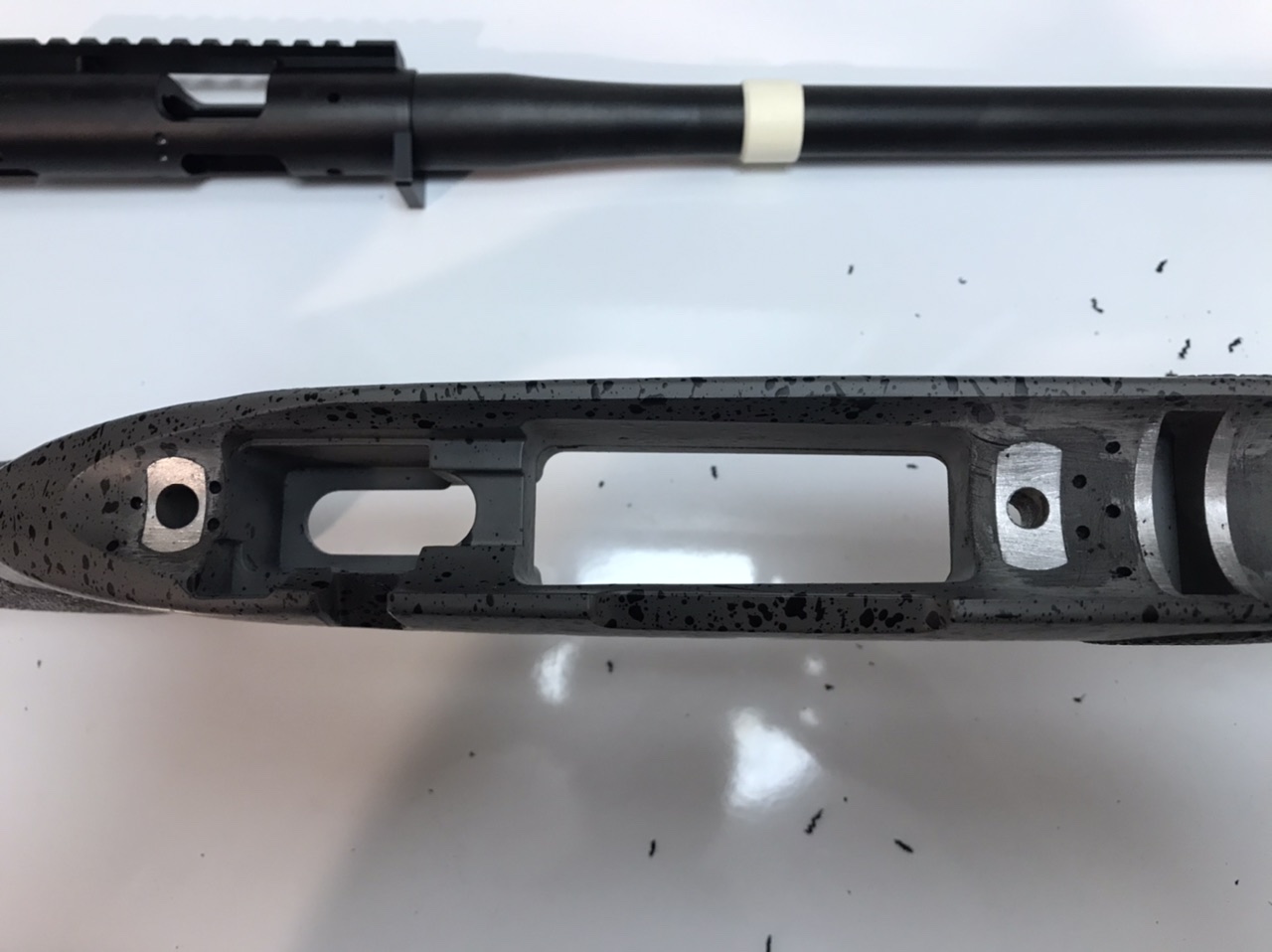

I haven't posted in this thread for a while. Have been shooting the B14R with similar results to those posted previously. I decided to try my hand at glass bedding the HMR stock (first rifle I've ever attempted this on myself).
Has anyone else done this and what were your results? I'll try to get mine to the range tomorrow to see if there is any appreciable difference.
And a pic mid process last night; roughed up the area around the recoil lug recess, front action screw and rear tang removing the factory paint from the aluminum bedding blocks. Also drilled 5 shallow holes between the recoil lug and forward action screw and 3 around the rear tang hoping that would give the epoxy something more to adhere to.

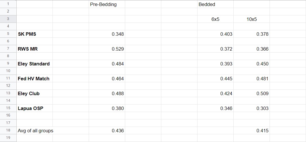

So results from bedding the HMR stock on my B14R are.....inconclusive.
These are the averages of 5 round groups measured CTC at 50 yards from the same lot of ammo, measured in inches.
Some are better after bedding, some are worse. Something interesting happened with the Eley club - In the six unsuppresed groups of the bedded rifle, 4 measured under .3 CTC (.293, .183, .277, .277) and two of the groups were complete crap, .933 and .965. The same lot of ammo before bedding had a similar trend, two groups out of 10 measured .840 and .965 and the rest of the groups were notably better in the .372 - .683 range. Obviously in this case the "good" groups after bedding were considerably better than the "good" groups before bedding.
I think more testing is in order.

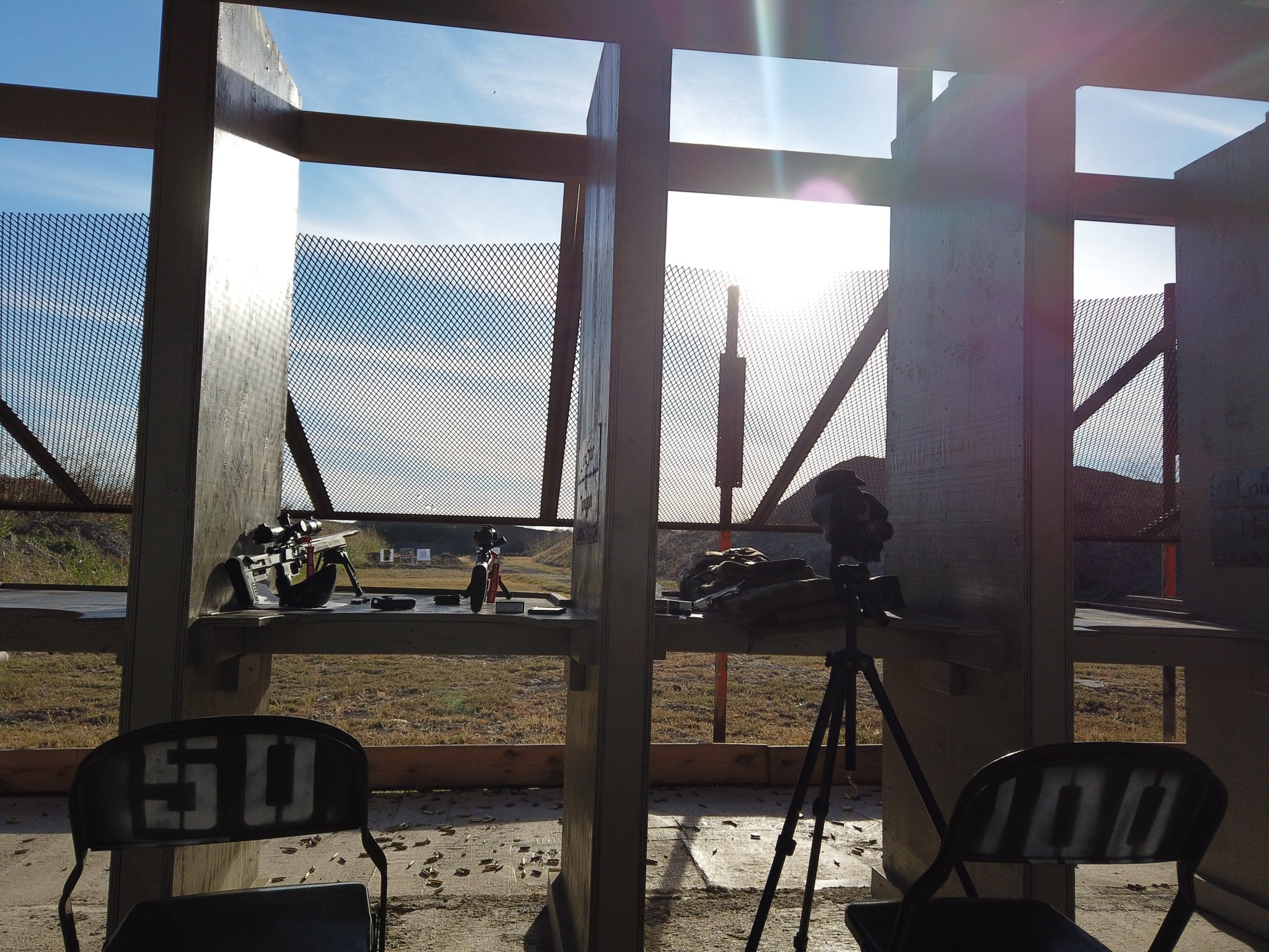

Below are the test targets from yesterday as well as a pic from the shooting booth.

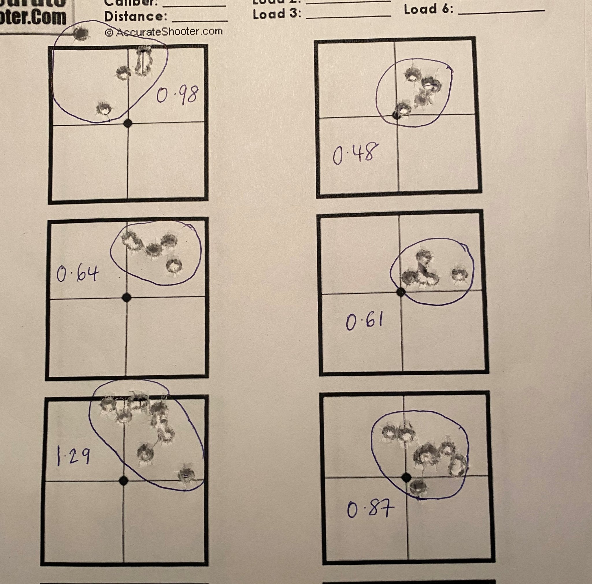

So my club held our last 100yd rimfire varmint shoot of the season on Sunday. It was a chilly 50 degrees and raining but no wind (Michigan fall) considering the last time I shot the Bergara it was it was a good ten degrees warmer so I wasn't sure how my lot of Center - X was going to perform. So we set up(bipod and rear bag for me) and shot our course of fire which is 6 shots on 5 targets the first target wasn't great but held the 10 point area with one round that was on the edge then the rest fell into place and I shot my first 300 score. Here are the targets with the second being a .74" group. The one shot on the first target I was actually holding for the lower x ring. Set up is Bergara B14R with Crimson Trace 6-24x56 ffp
20201004_155011[1].jpg20201004_155000.jpg20201004_154950.jpg20201004_154941.jpg20201004_154924.jpg

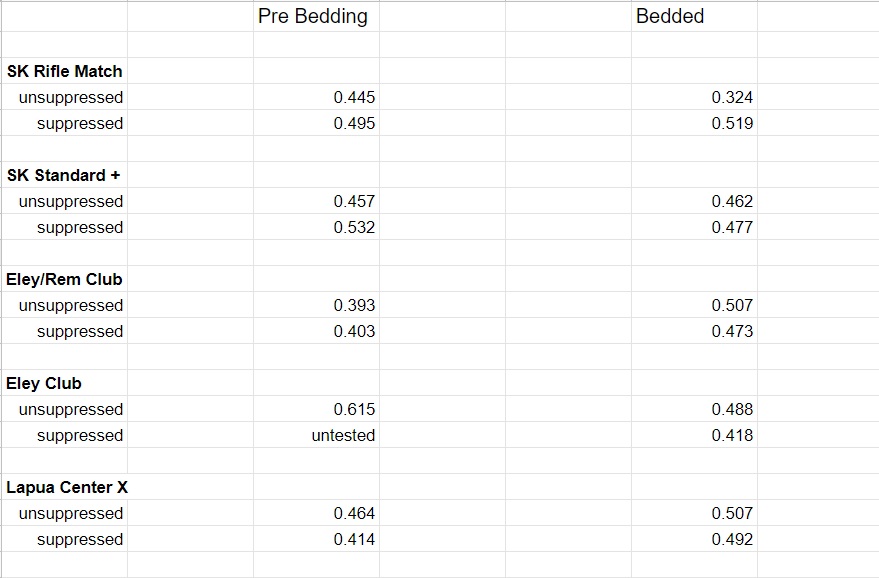

More results from the B14R, post-bedding of the HMR stock. I can update this post later with pictures of today's targets if anyone cares to see them, otherwise I'll just post the numbers (average of all groups measured outside to outside in inches minus .222"). Everything today was shot indoors at 50 yards unsuppressed. I started by shooting 4 groups per ammo type at one target for the sake of settling in the barrel for each ammo then a 6x5 on a separate target.
The majority of the bedded averages are better than before bedding with the noticeable exception of SK Pistol Match Special, however the ammo wasn't from the same lot so perhaps the lot I shot before bedding was just better. Otherwise everything else is from the same lot.
Technically I shot my best 6x5 today with Lapua OSP at an average of .257" and best group .184", but it was the last 3 groups of the first target and first 3 groups of the second target so I don't really count it :LOL:

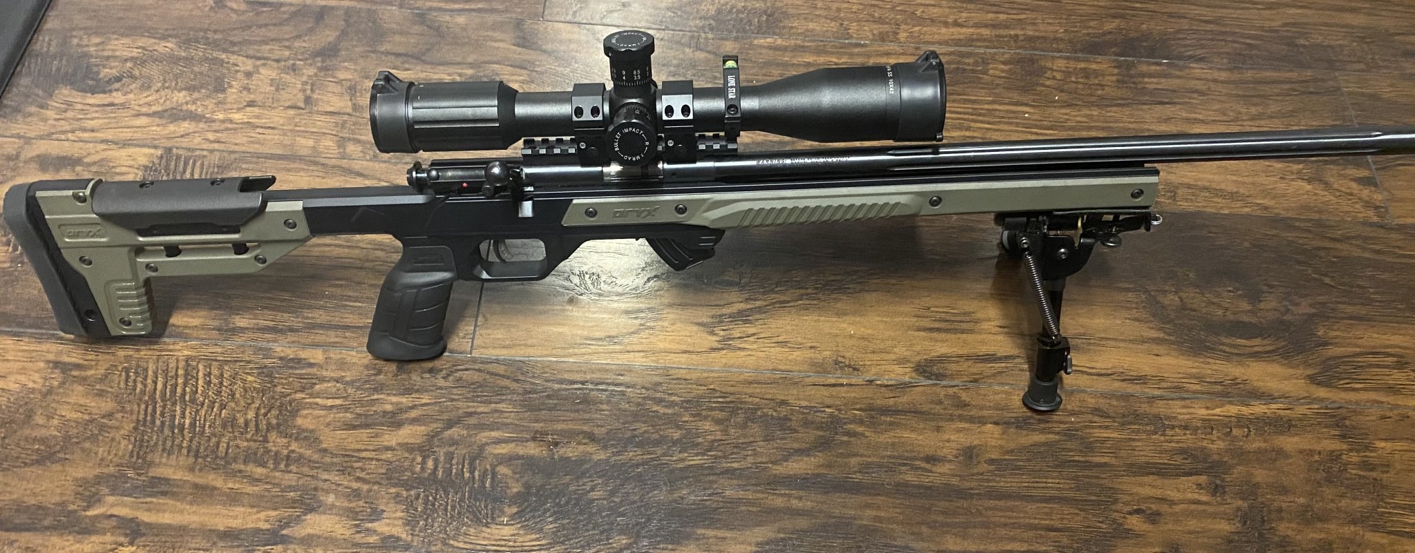

I'll post some groups with Eley Contact, Force, Minimags, and AE 45gr on tuesday.
Had a good day at the range today, fired some Eley Contact, Eley Force, CCI Minimags, Aguila Extra Velocity, and American Eagle 45 gr. All the targets were shot @ 50 yards. I shot two separate 5 round groups and 1 ten round group. I did 20 rounds with one the B14R first (Left side) and then 20 rounds with the Savage Mk II in a Oryx Chassis (Right Side). The B14R Carbon has a NF 2.5-10x42 and the Savage MKII has a SWFA 10x42.

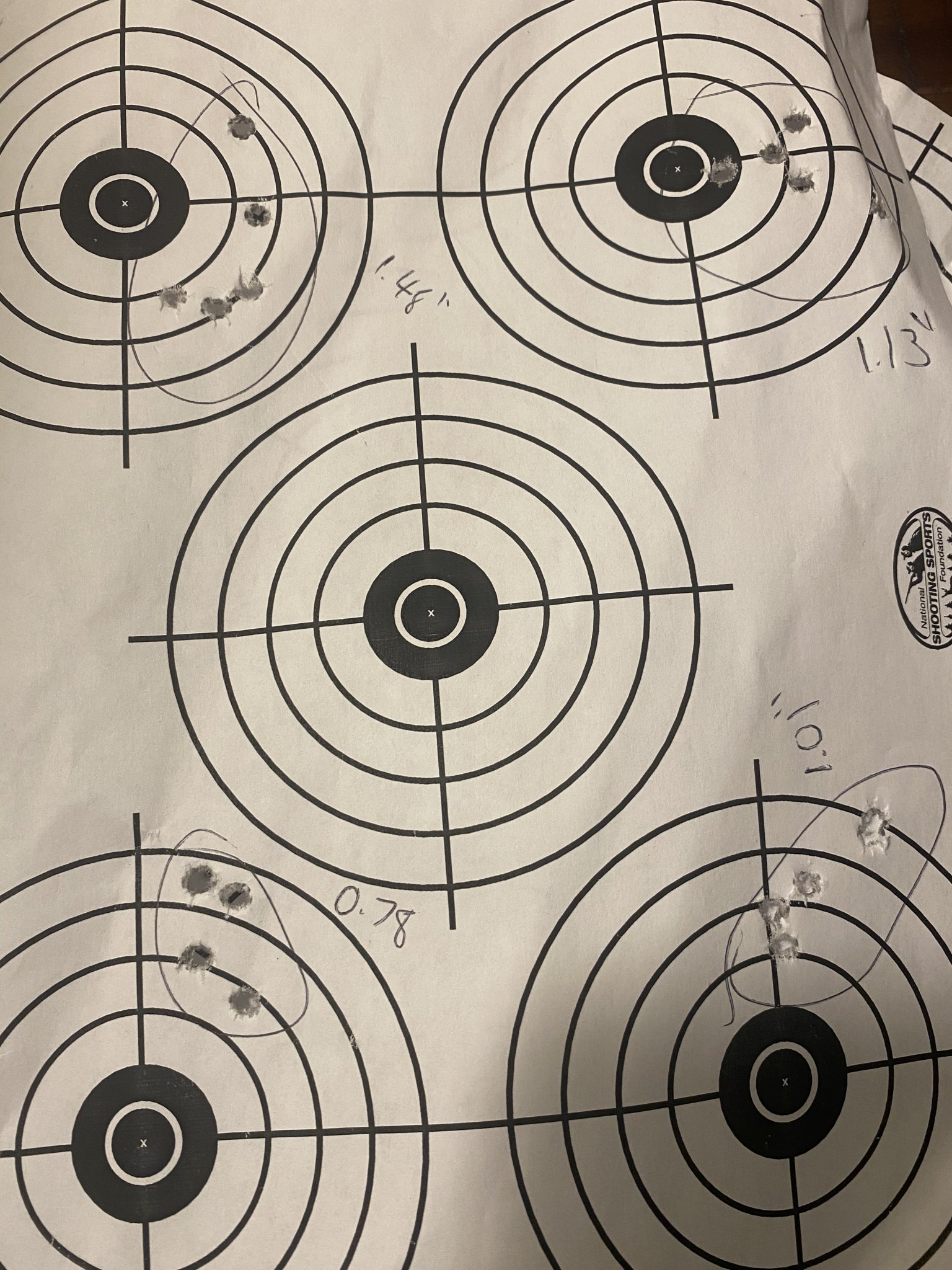

Little bit less of an exciting today as the range as very busy so I wasn't able to get through as many strings as fire as I wanted. But I did have time to hit the 100 yard with some match grade ammo (Lapua Center X).
Same rifles, Savage MKII (SWFA 10x42) and a B14R (NF 2.5-10x42). All shots were taken off a bipod and with rear bag.
Next order of business will be trying different torque settings on the B14R Chassis, as of right now its running at the stock torque settings. Savage MKII is 20 inch pounds on front and rear screw.
This was very surprising to me at 100 yards with my cheap old savage.
Top two rounds were with a suppressor and bottom two were without. Again elusive flier on the bottom left target.
View attachment 7478842View attachment 7478843
View attachment 7478844View attachment 7478845
What’s the factory torque for the B14’s? I’m just wondering because everything I put in a chassis get 65in/lbs and seems to shoot good.
