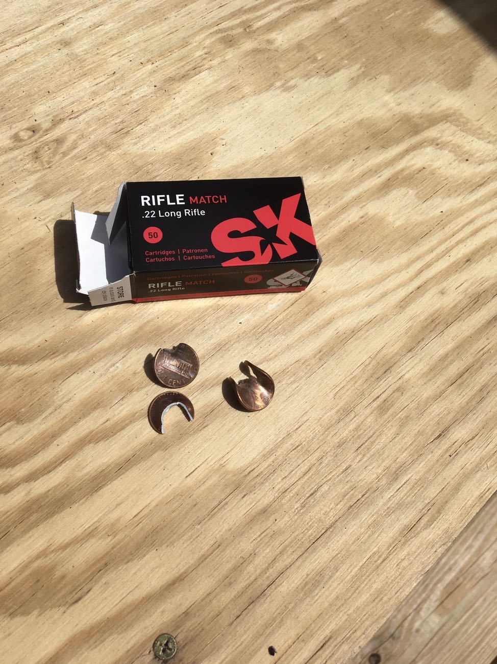

Picked up my BXR yesterday. Sure enough the Bergara mag would not drop free even after 10+ reps. Turned out that rear plate was 0.011” wider then on the Ruger. Five minutes with a sanding block and problem solved.
OFG
Glad you got one. I didn’t sand mine, just popped them in and out while burning 200-300 rounds and it drops free now. Keep us posted with your thoughts on the rifle. I love mine and hopeful yours will be flawless too.

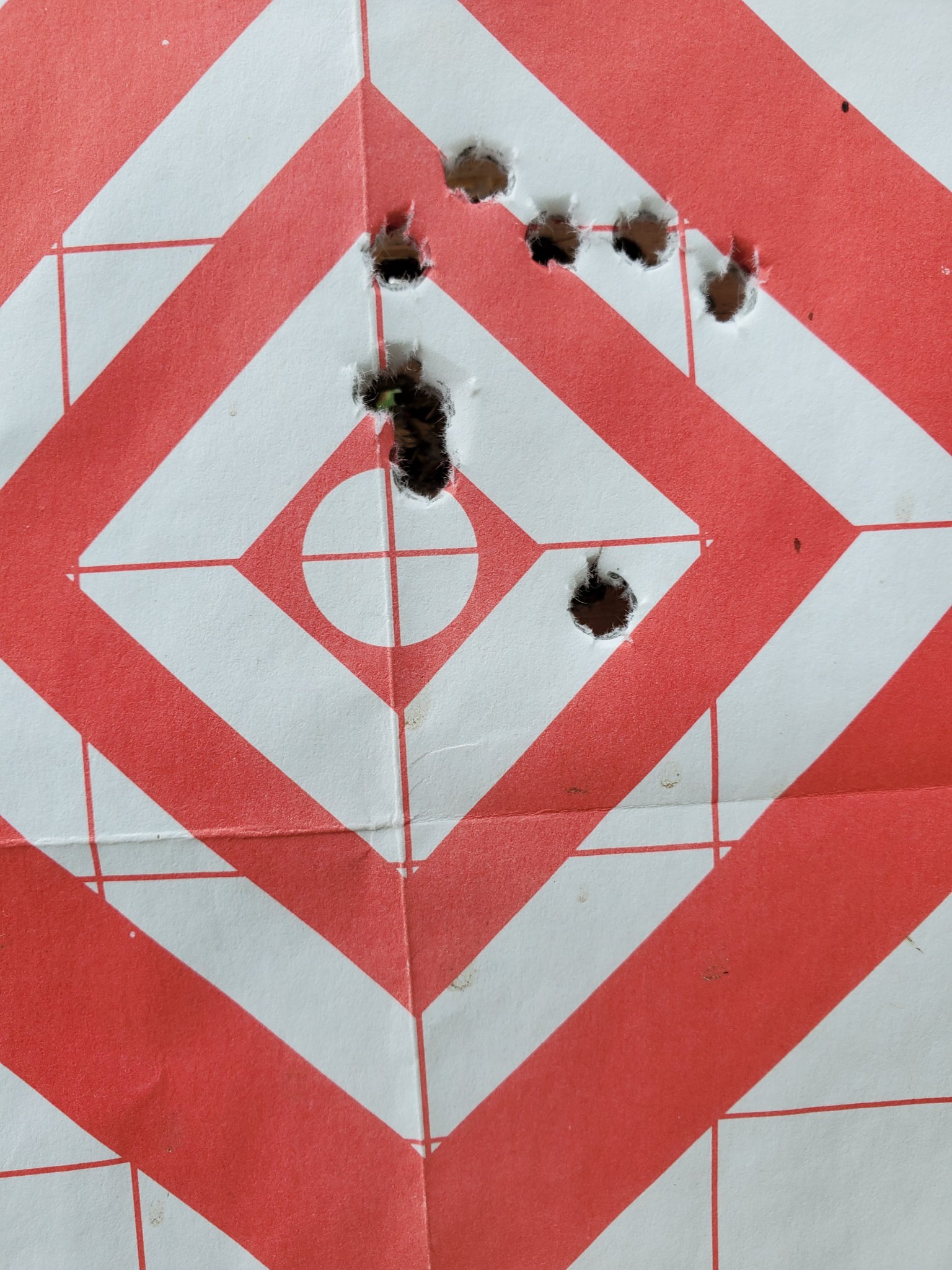

Finally got to the range today. Loaded 7 Ruger brand and the included Bergara mag with CCI SV. All the Ruger mags were flawless. With Bergara mag, last round FTF. Could be due improper re-assembly by me. Will revisit that.
CCI SV not going to be competitive. Sure the thread protector working loose didn’t help. Will do ammo testing next week.
Trigger is very much like a double/single action. Much better then the Ruger 10/22 OEM trigger, good but not great. When allowed to just reset all together different - much better. If it could be tuned for the “single action” pull all the time the two stage KIDD would not be incoming.
