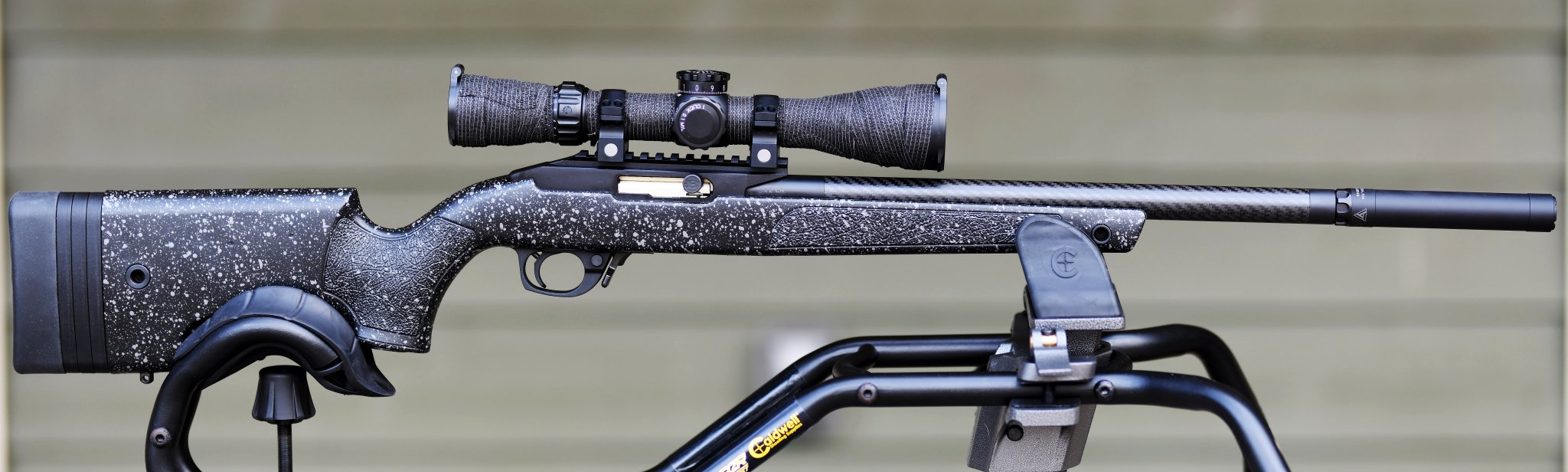

No, it takes some relieving of the inner chassis at the front of the receiver. Like 2min with a dremel and is good. Mine also needed an extra shim to keep barrel from contacting at bottom. I used a 1/4 fender washer between chassis and receiver and is all good. It is a nice combo.
Cool! That is a sexy rig right there👍👍
What's the weight difference on the KRG compared to the factory stock? Does it feel heavier? more/less balanced?
I'll be humping mine around for squirrel season so didn't want to add too much weight.
Factory stock with that scope was 7lbs and change.
With the Bravo is a hair over 10lbs including the KRG ARCA Rail.
It is tail heavy but with the MLok weights (.8Lbs total) it just balances at the mag well.

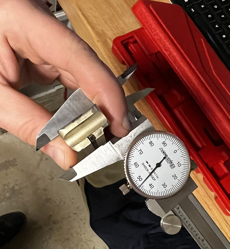

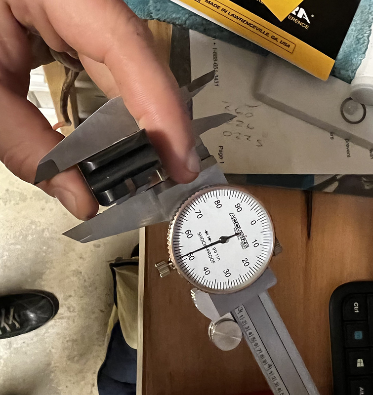

Swapped the stock bolt back in and it was perfect so I pulled it back apart and found this...
Stock bolt
Kidd bolt
Five thousandths is enough to bind the action.
Well, I think we've got it figured out. Shalee mentioned something about the offset of the rod pocket in my receiver and that appears to be the problem. The spring is making contact with the bolt and binding it up.
