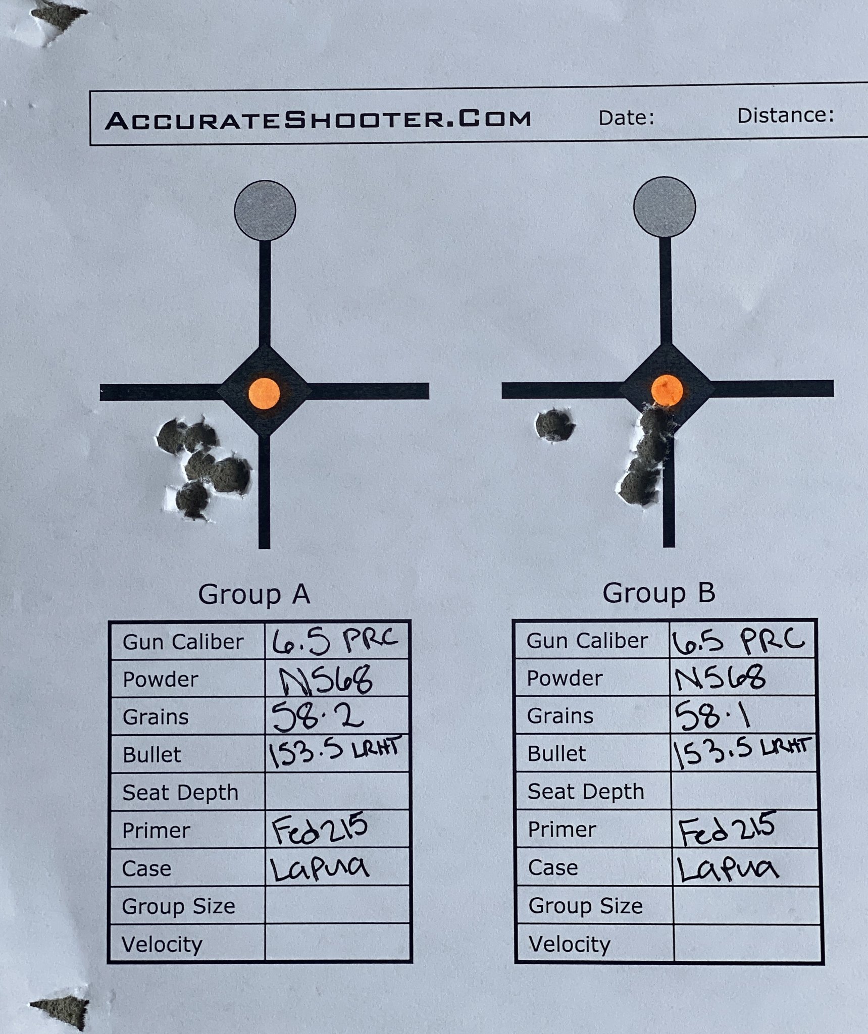

Berger 6.5mm 156g EOL, 153.5g LRHT, & 144g LRHT Load Data for 6.5 PRC
I should add a couple of things to my post above...
65*F 70% 900'elev
The 153.5 LRHT has enough nose length variance that 2.965 COAL will result in a few rounds that completely impede reliable feeding in my short action Accurate Mag. They all fit, but those few will bind if they tip once they've slid forward. Hopefully 2.950 COAL feeds reliably.
@H&H Precision Outdoors all of these loads are >95% fill, so I'm not worried about burn efficiency. If I feel like I'm having issues, I'll switch to 215M. I'll have to look at my GRT file to see where the actual fill % is though
@Rocketmandb @Rio Precision Gunworks maybe you guys know about this
215m might give you better results like your looking for, and I plan to run 215's in mine to start. Also with the 153.5 LRHT, according to Berger their seeing 56.1g's of H1000 to be the Max Load giving them around 2883 FPS.
N568 is - 2943 fps
N570 is - 2981 fps
Your barrel is 24 or 26"?
Forgot to add that... I'll add above too
25" CFW 1:8.25-7.5" left hand gain twist, 25rds on barrel @ start
Pretty happy with the velocities so far, given the barrel will probably speed up. Using the 210Ms because SDs are more important to me than velocity. Not making any conclusions until barrel is sped up & the brass is on it's second firing. I will probably give some VV a shot though.

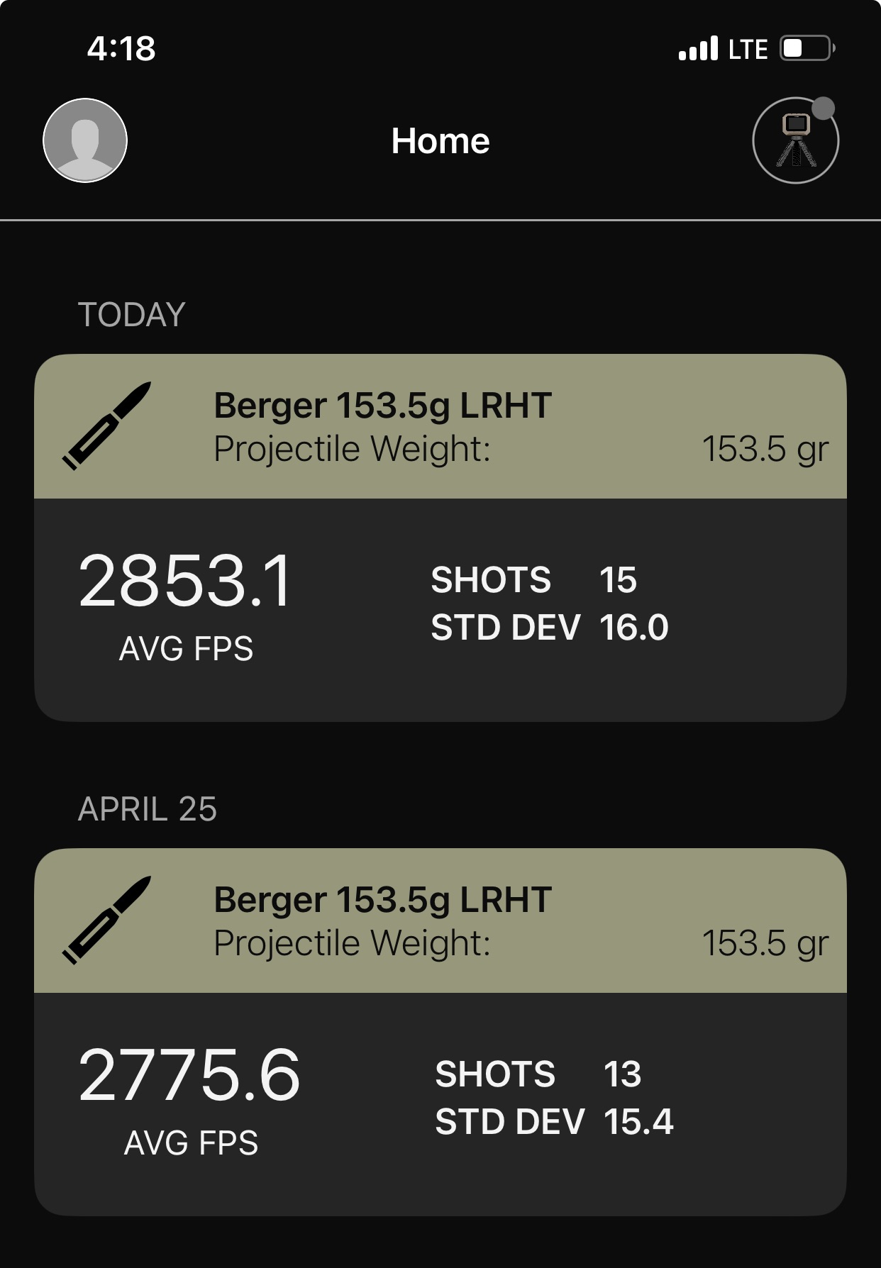

I actually started my process with my 6.5 PRC. Shot 90 rounds this past Thursday, and have an average velocity out of 13 rounds of 2775.6 fps, & today I sent another 50 down the pipe, & my barrel has finally sped up!
26” Bartlein Heavy Palma
Lapua Brass
Fed 215 Primer
57g of N568
153.5g LRHT
Reactions: Overclok79
Lapua Brass
Fed 215 Primer
57g of N568
153.5g LRHT
Your results are quite a bit faster than what I'm getting. Maybe my barrel will speed up too, right now it's about 80fps lower than your first outing.

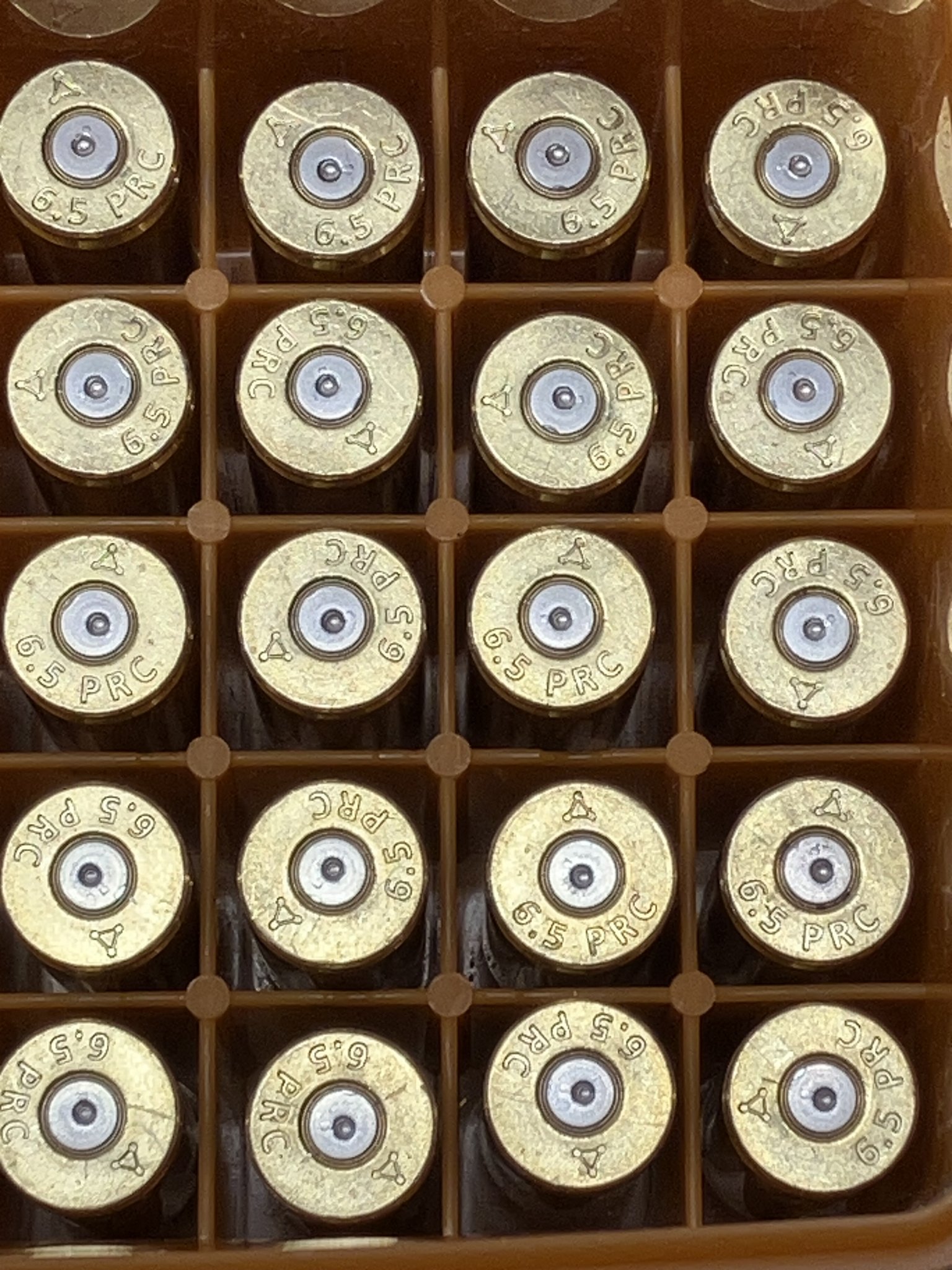

Here is some of the brass from today:

What action are you running? Looks like a big horn or one with mechanical ejection. Looks like ejector slot marks on edge of primers and brass. If so, that is a warm load, very near or over max. I have run a similar load and it was right at max. I have since backed down to 2955 with 57.4 of Retumbo.
Wow. Good eye. Yes, I am running a TL3.
Those marks are very faint and I would say only 50% of my cases have them. I am using this cartridge for ELR, so a warm load is my goal. I want as much performance as I can safely get, however reliability is still my #1 priority. Since I am now well over 3000 FPS, I am probably going to back down to 57.5 gr.

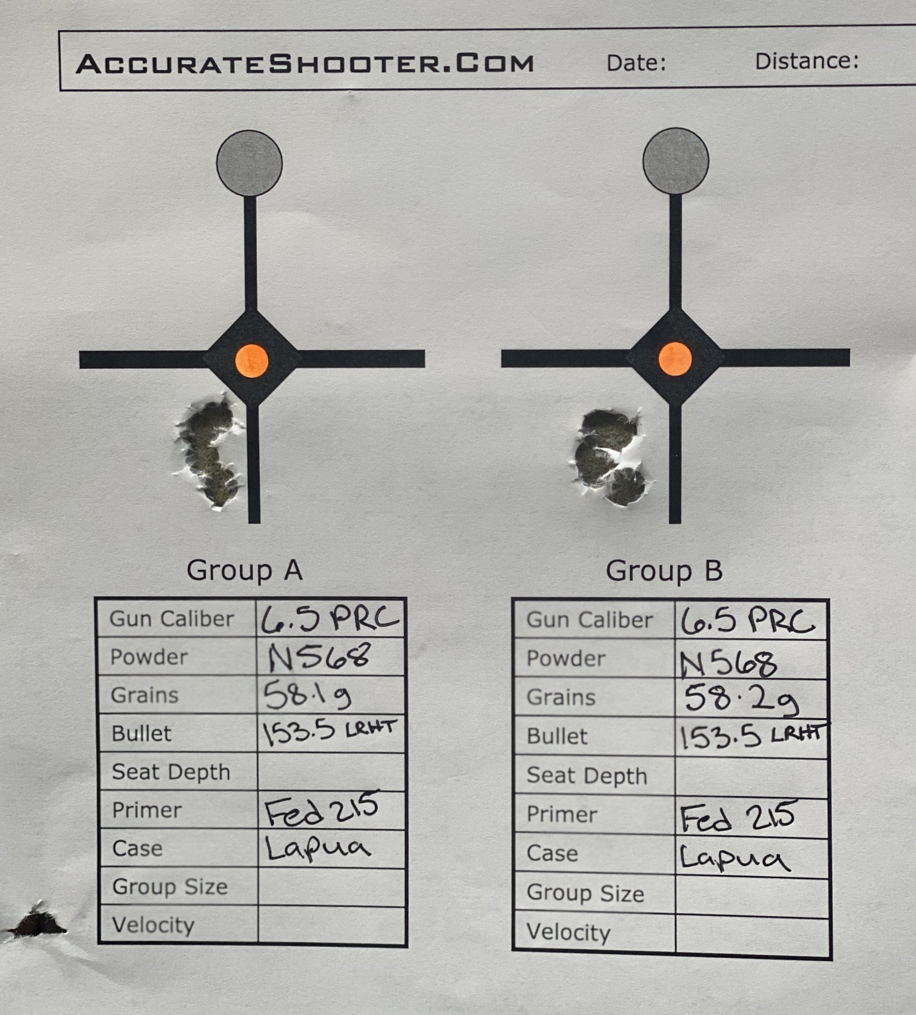

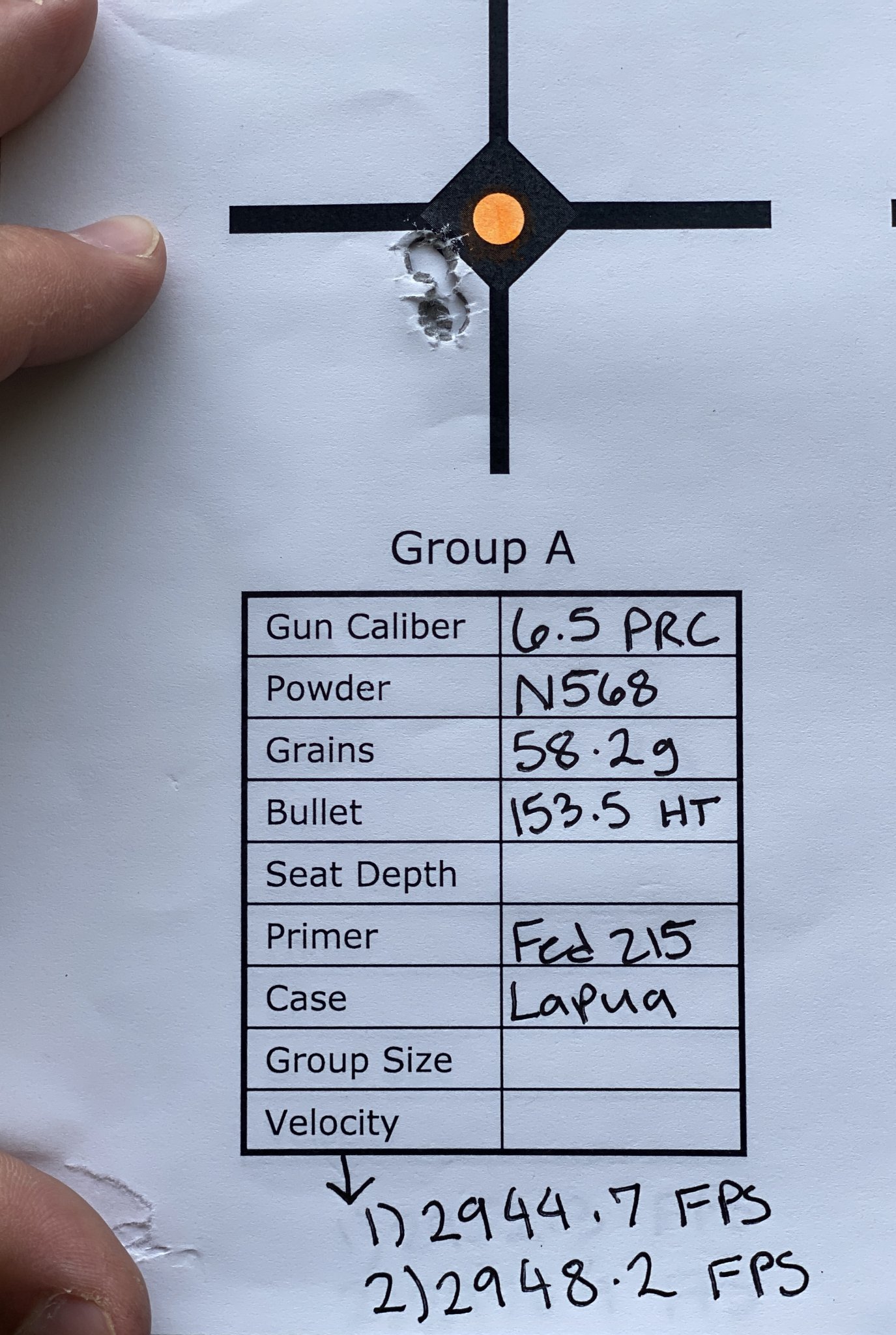

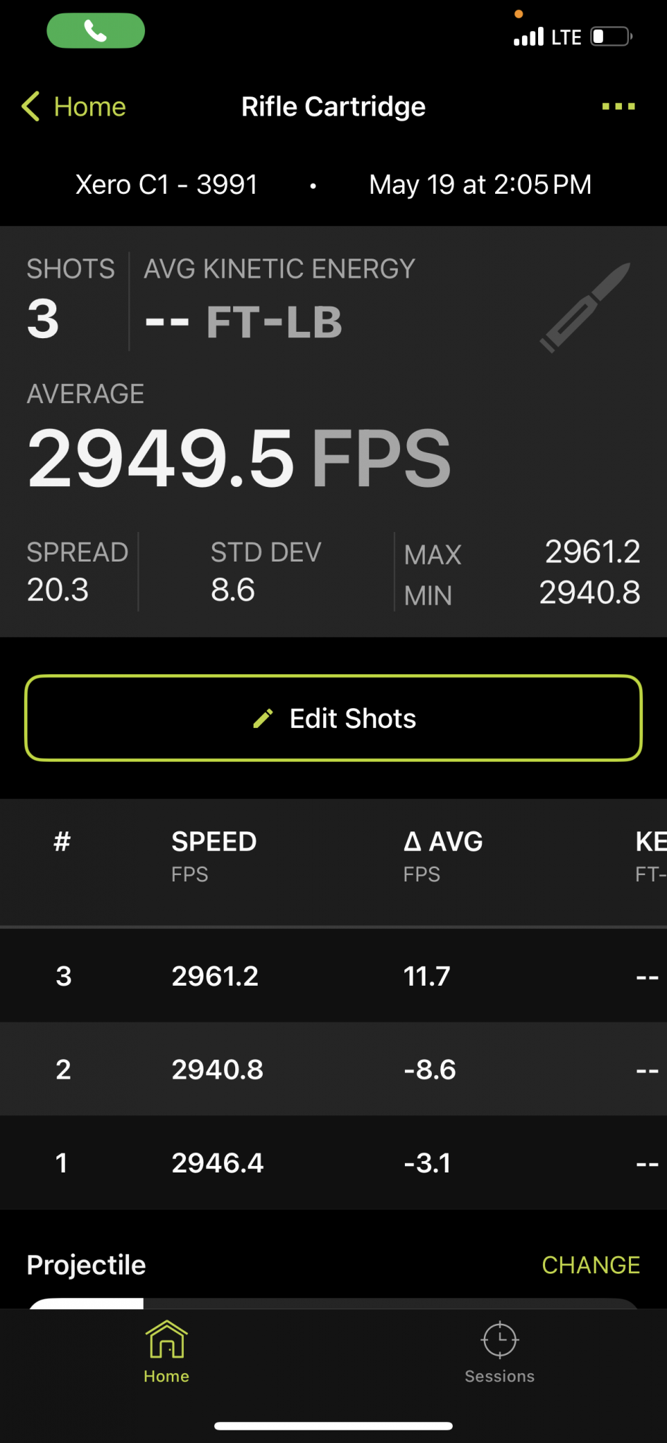

Found a good velocity node between 58g of N568, & 58.2. Shot #1 w/58g’s gave me 2946.0 FPS, & shot #2 w/58g’s gave me 2940.6 FPS. Next shot #1 w/58.2g’s gave me 2944.7 FPS, & shot #2 w/58.2g’s gave me 2948.2 FPS. I went and tested x5 shots with 58.1g’s & 58.2g’s and have great results with 58.1g’s of N568 with two test of each with x5 shots. Thinking 58.1g’s is my choice, & now onto seating depth testing, so here are my results:
Alright here’s the final recipe for my 6.5 PRC load:
Brass: Lapua
Bullet: Berger 153.5 LRHT
Primer: CCI #34’s Military Primers
Powder: 57.9g N569
CBTO: 2.3125 / .020 Thousandths off the lands
Group size: 0.2095
Muzzle Velocity: 2949.5 FPS AVG

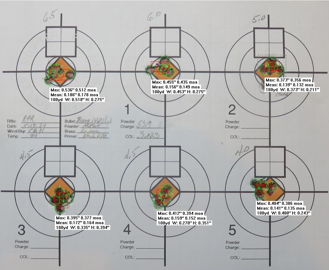

Yeah, I know the following is not the thread's listed projectiles ( do have 153.5's, but not finished load development yet with them), but I thought some viewing here might like to see what some 140 Hybrids did for me out of my RPR (fooling with tuner adjustments 6.5 to 4.0). 5 shot groups (a couple 3 shots groups were in the .0's, but then the following 2 didn't follow ;)) :
Edit: Powder was not N565, it was H4831SC
Nice target man, great 5 shot groups. I Plan to load my recipe up again and shoot a few 5 shot groups, and see how many I can put into one ragged hole like my 3 shot group above. Once I do that, then it will be time to test at distance.
Reactions: straightshooter1
Thanks.
Last August I did find a load that looks very promising for the 153.5's, where I got 5 shot groups very much to those 140 hybrids. But I haven't really tested the load to really see if I can get those results on a consistent basis. I had loaded 57.4 grs of N565 (COAL 3.096 :eek: - .020 off lands. . . nope, it doesn't fit in mag). Out of m 26" barrel that gets my MV at ~2,980 fps.

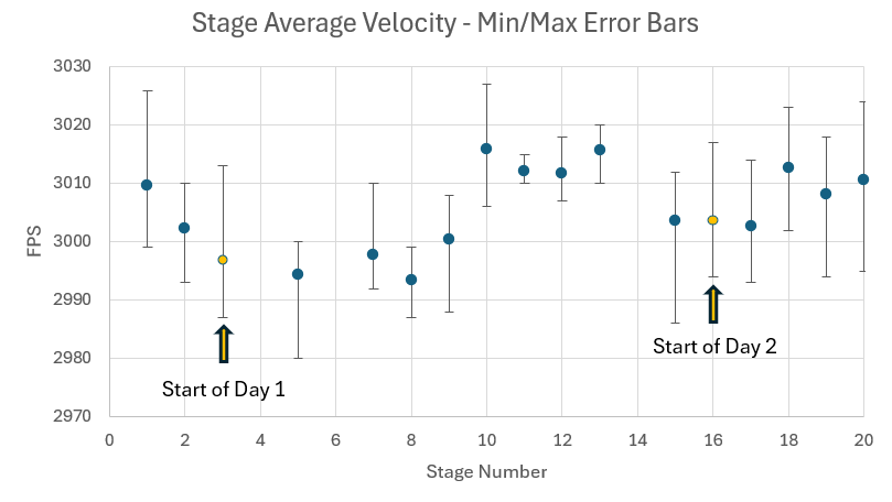

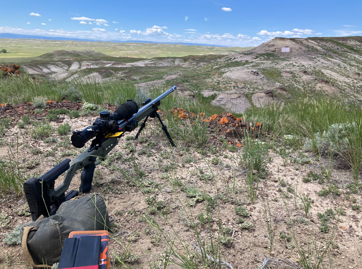

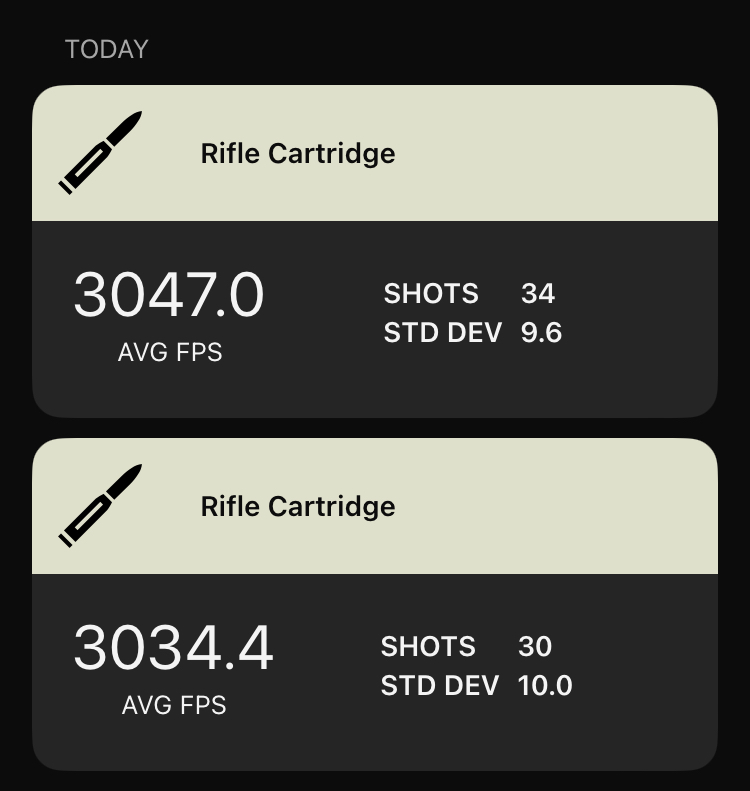

I finally got around to process my data from the Nightforce ELR. That match kicked my ass, but I had a ton for fun! The rifle performed phenomenally and I was definitely the weak link. Up until this match, I had very little experience shooting past 600 yards and dealing with high winds. I shot ~50% of the winner's score and that put me right at the top of the bottom 3rd. Hopefully I do better next year!
I got great velocity numbers on practice day
My load:
A mix of 1x fired and 2x fired annealed ADG brass
57.5 gr of H1000 measured on an FX120i to +/-.02 gr.
CCI BR2
153.5 Berger hybrid seated to a CBTO of 2.244" which gives a COAL of 2.950"-2.960"
28" Bartlein barrel with around 300 rounds on it at the start of the match.
Over the two match days, I fired ~120 rounds and chronographed ~100. I forgot to turn the Garmin on for a few stages lol. All set in done, my gun averaged 3005 FPS with an SD of 10 and ES of 47. I'm pretty happy with those numbers considering we saw temperature swings from the low 60s to the mids 80s over the course of the day. The yellow dots are the stages I started on each day and to me, you can see the average velocity increase as the day goes on and the temperatures heat up. The error bars show the min and max velocity of the sample.
