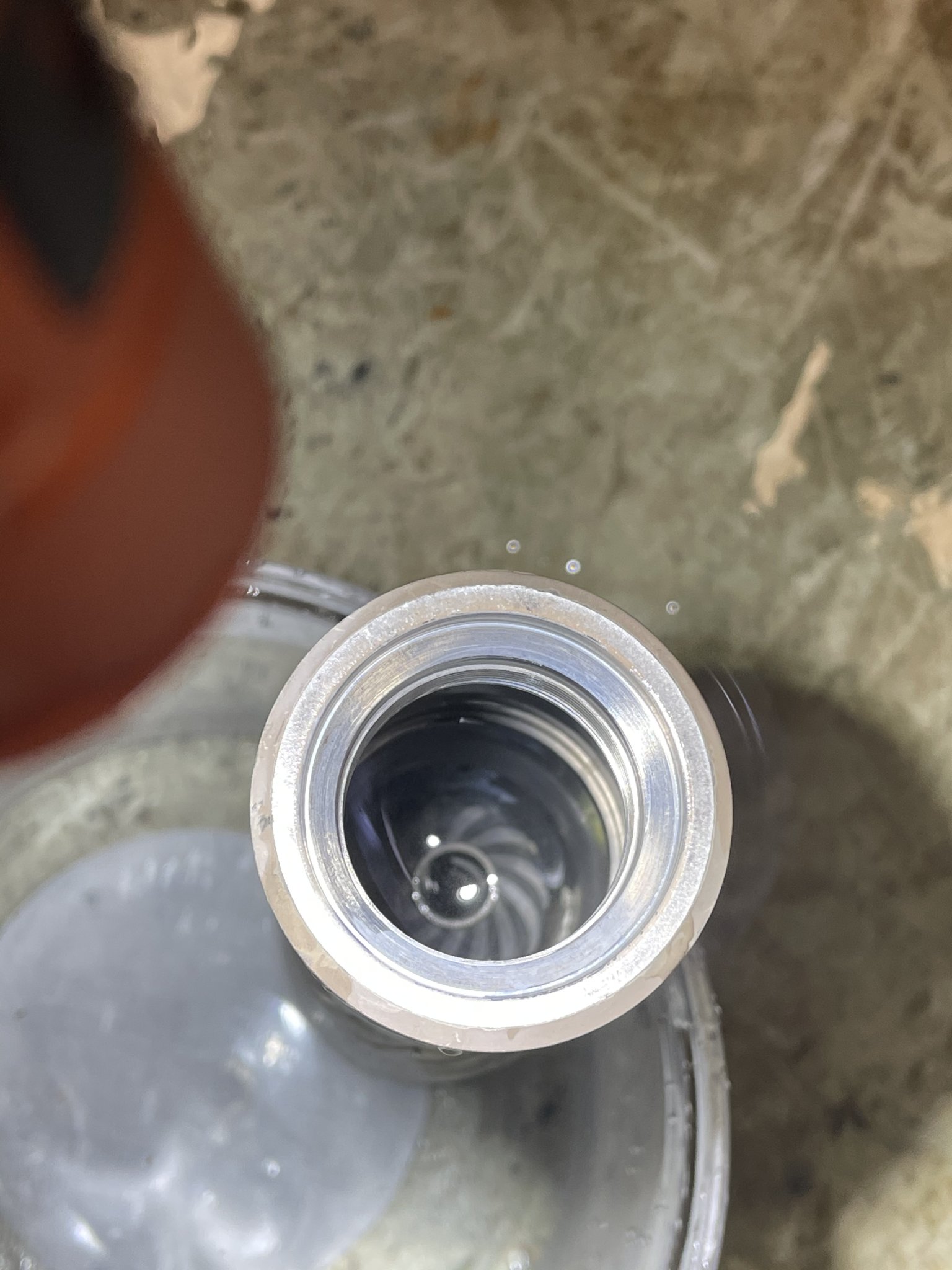

If you scroll up you can see how I set up the sonic cleaner. Three silencers and two AR-15 BCGs in a glass pan filled with Break Through. A gallon of tap water in the sonic cleaner outside of the pan. No damage to the silencer sprayed on finishes. The phosphate finish on one BCG and OPS Inc can (not pictured) are chaukie. I don't think they are damaged either, just absolutely spotless and oil free. The first silencer in the picture series is a TBAC U7.

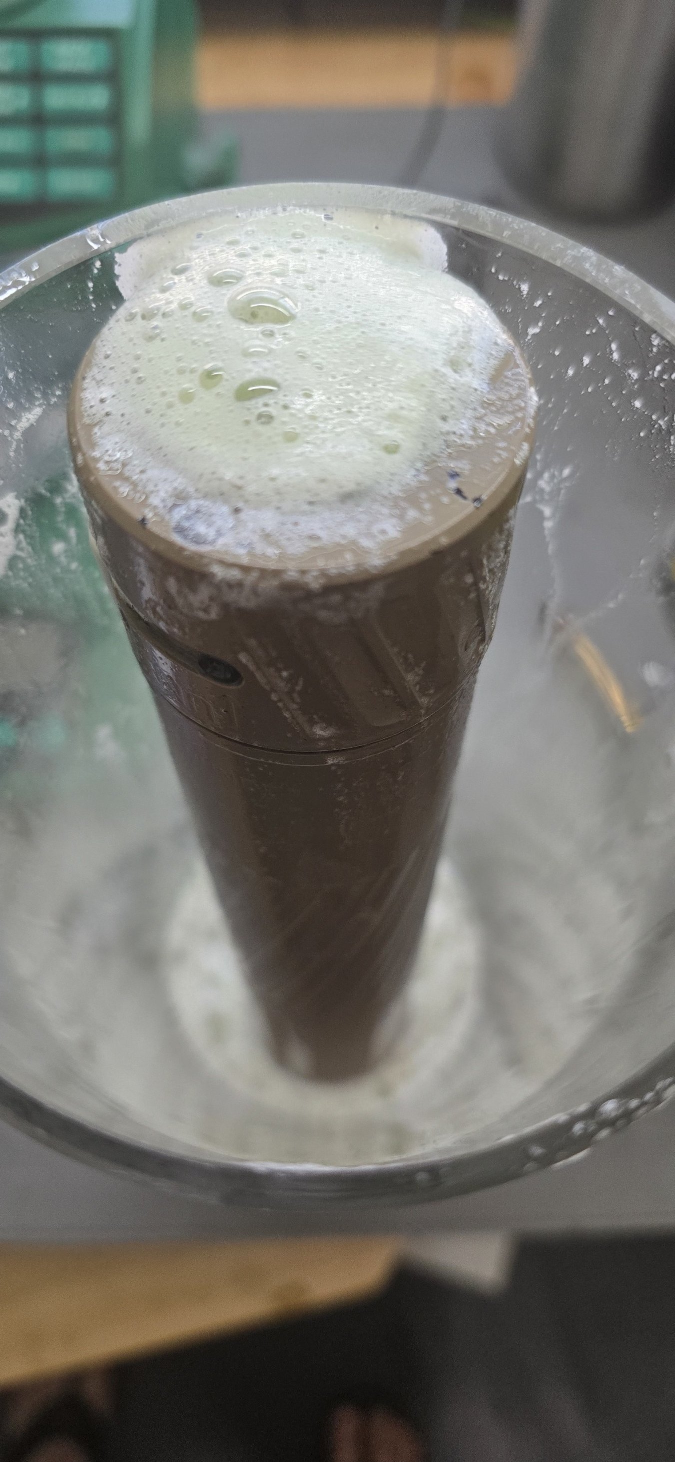

I soaked a silencer plugged at one end for 4 days, two hours in the ultra sonic cleaner is about the same, if not better.

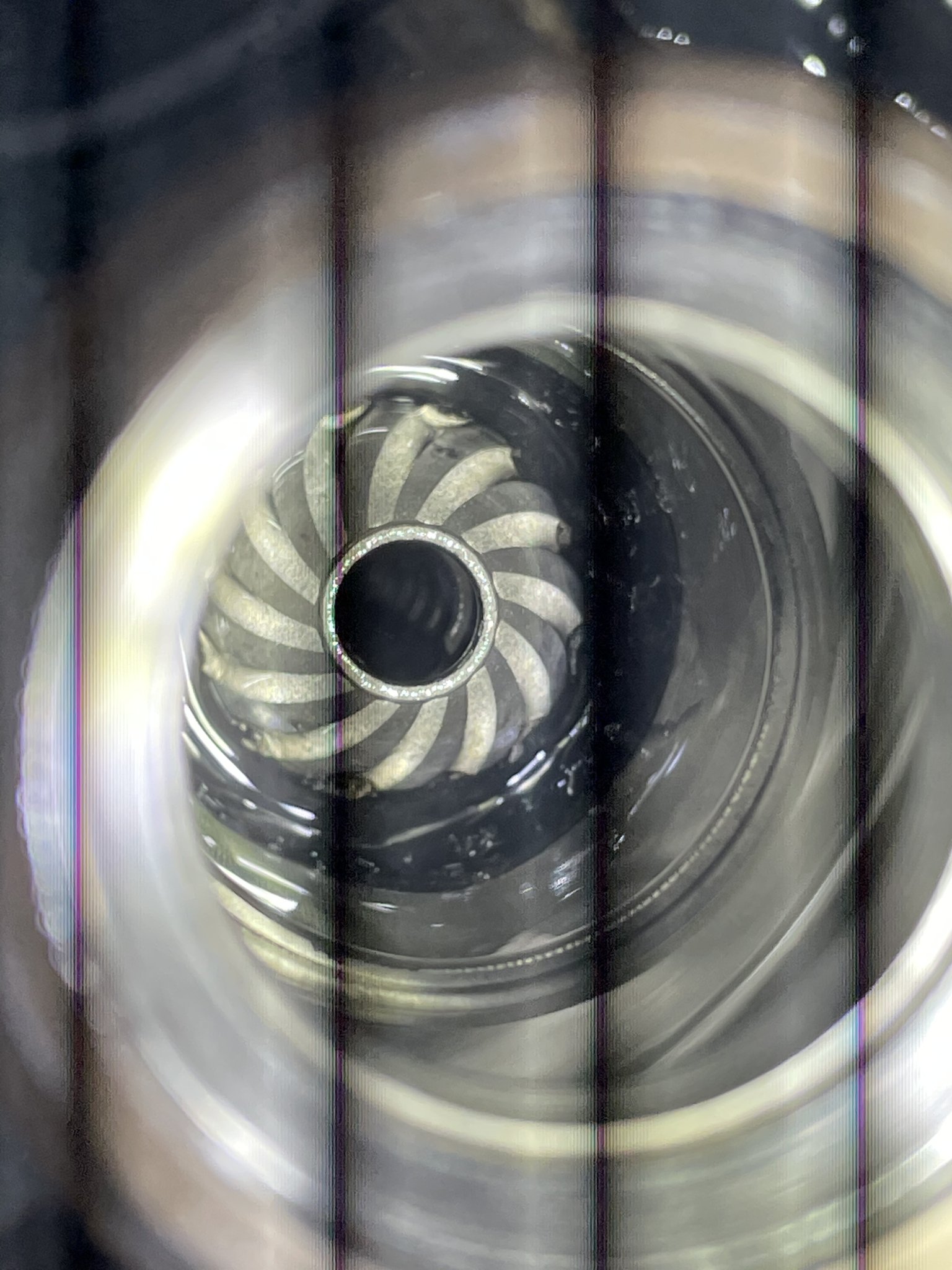

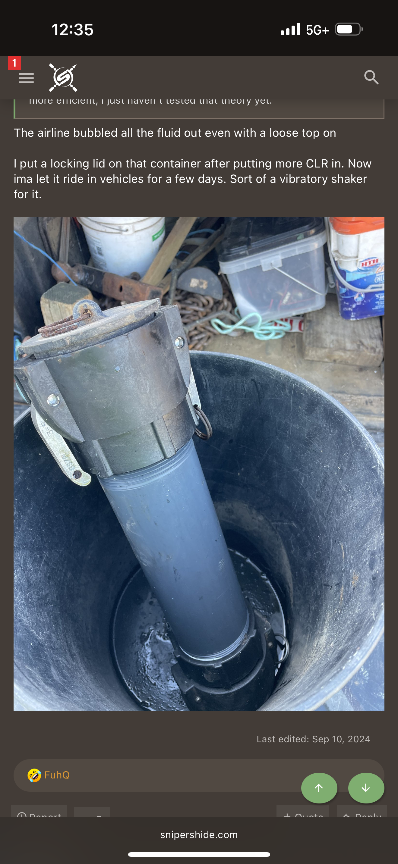

Well. Riding around in a vehicle for a few weeks sitting breech down in CLR seemed to really soften up the fouling. Rinsed with hot water got a lot of junk out. Then hit with the bore tech washer kit and got a pile out. Check out that giant chunk that came out.

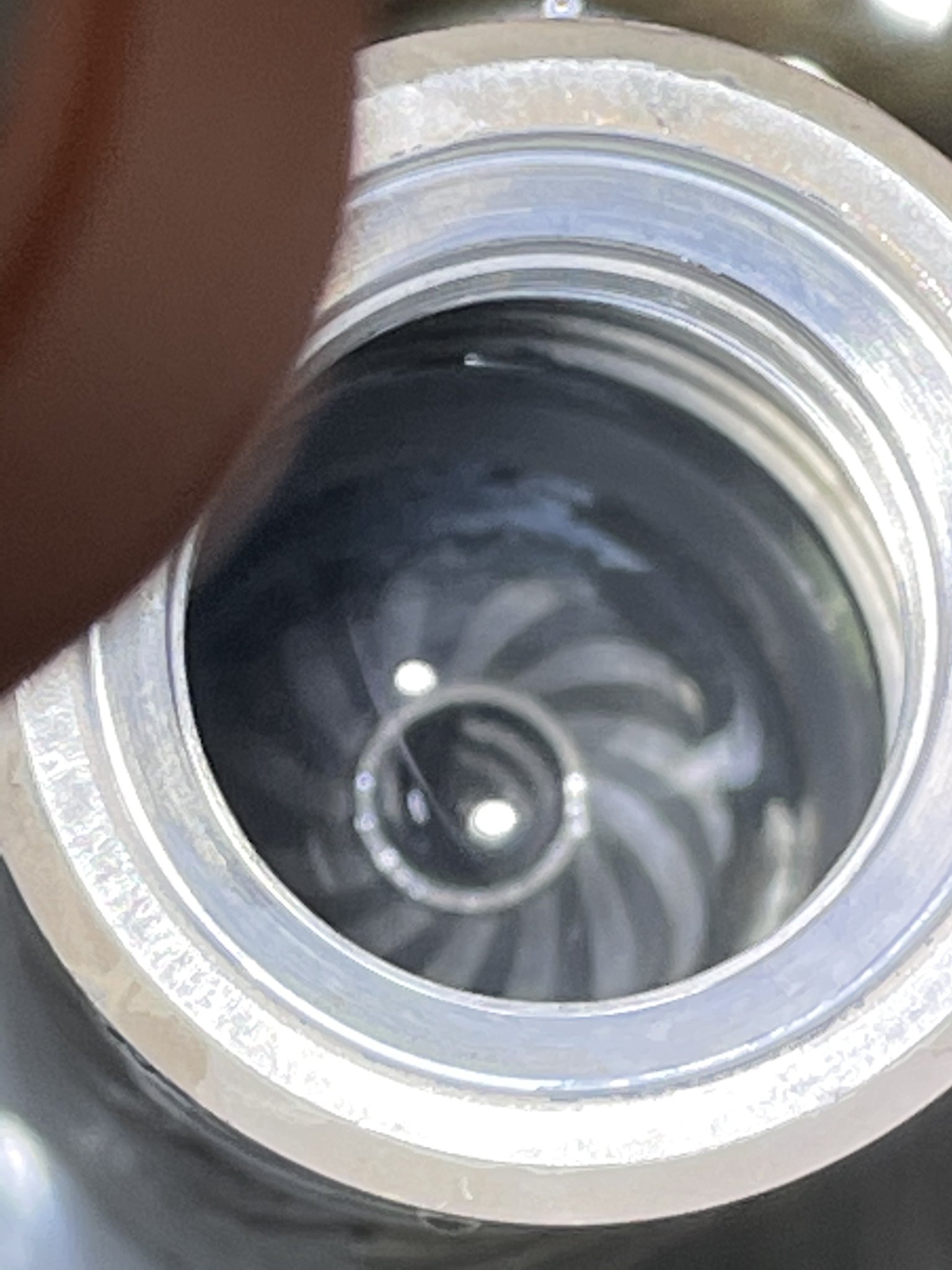

Think it’s 95 percent clean. Will repeat the CLR soak maybe get the unltrasonic out of the box I never used yet.
I think the bore tech needs to have the jets angled to get down in the k baffles more

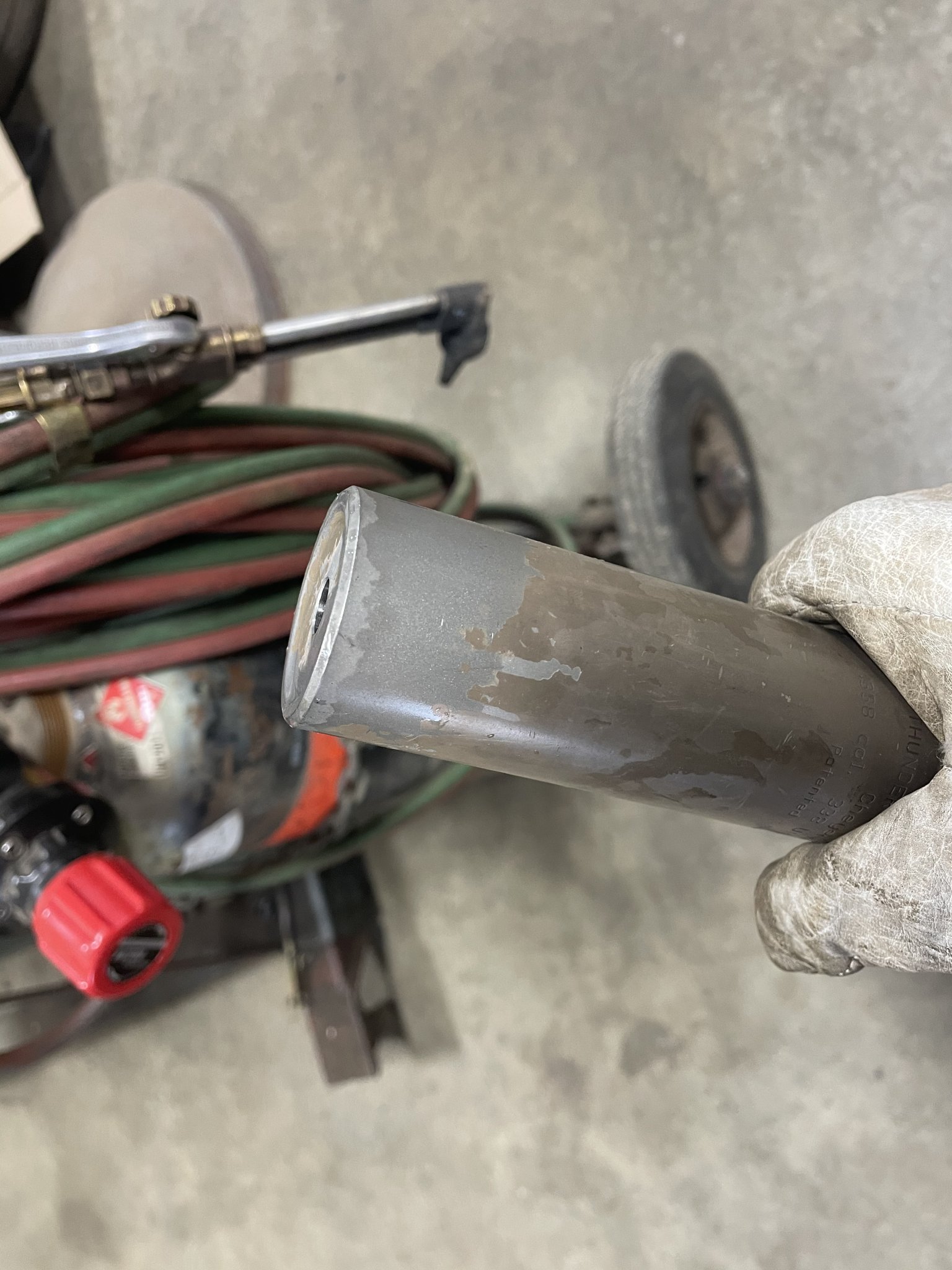

Finally got a bad weather day to finish this thing. Been riding around in the back of my car in CLR. Cerakote a little more matte but who cares. I’m certified in Krylon anyway.

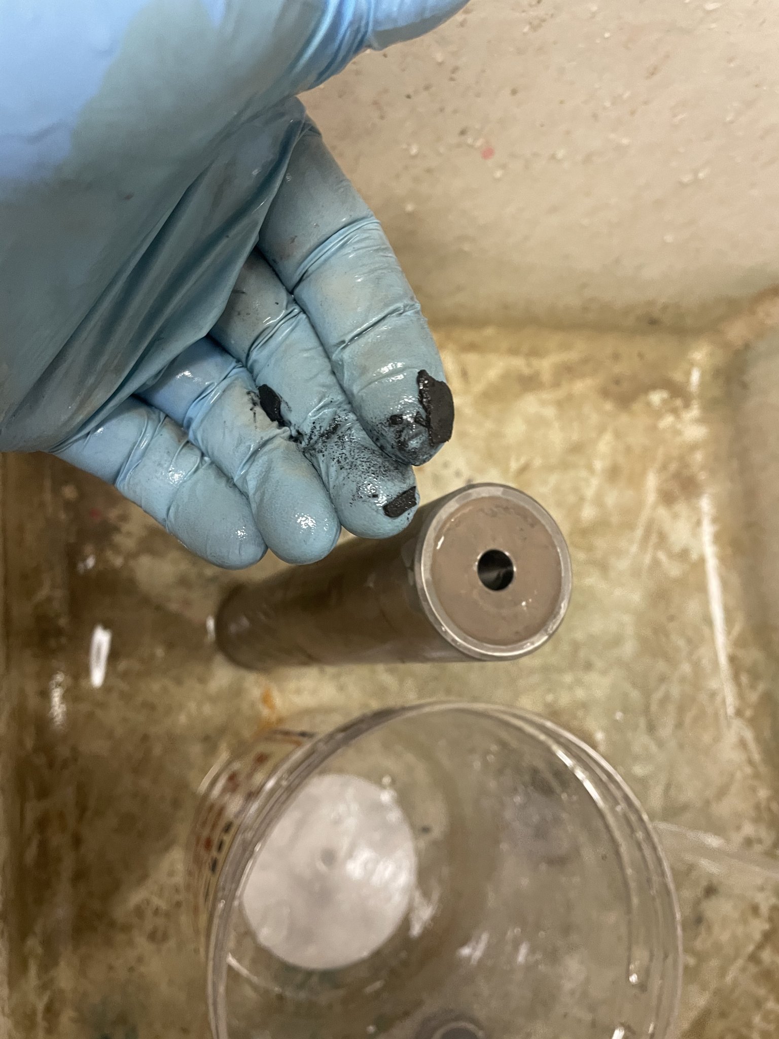

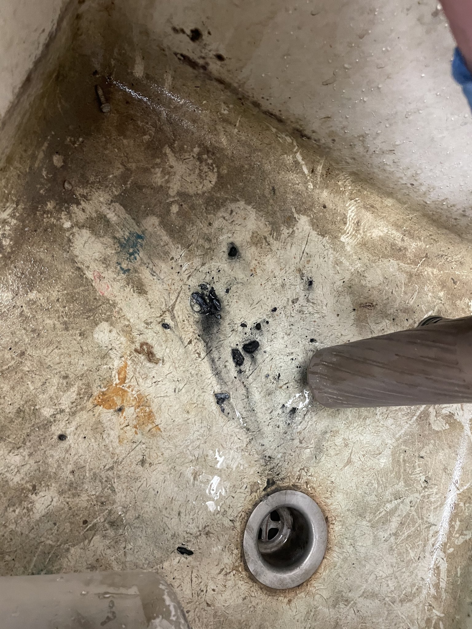

Tried hot water and banging on sink. Surprised all the stuff that came out

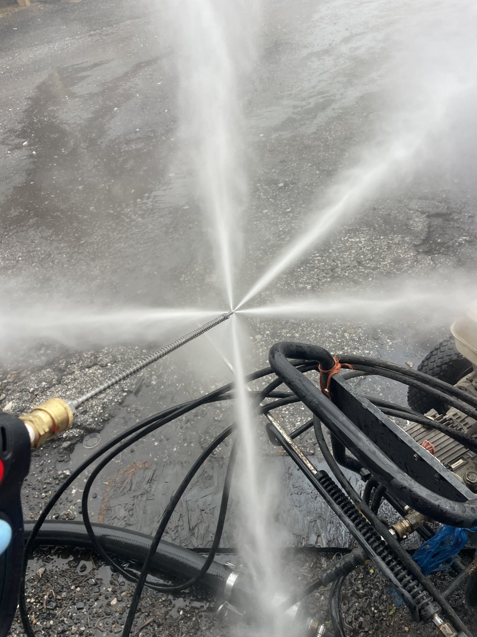

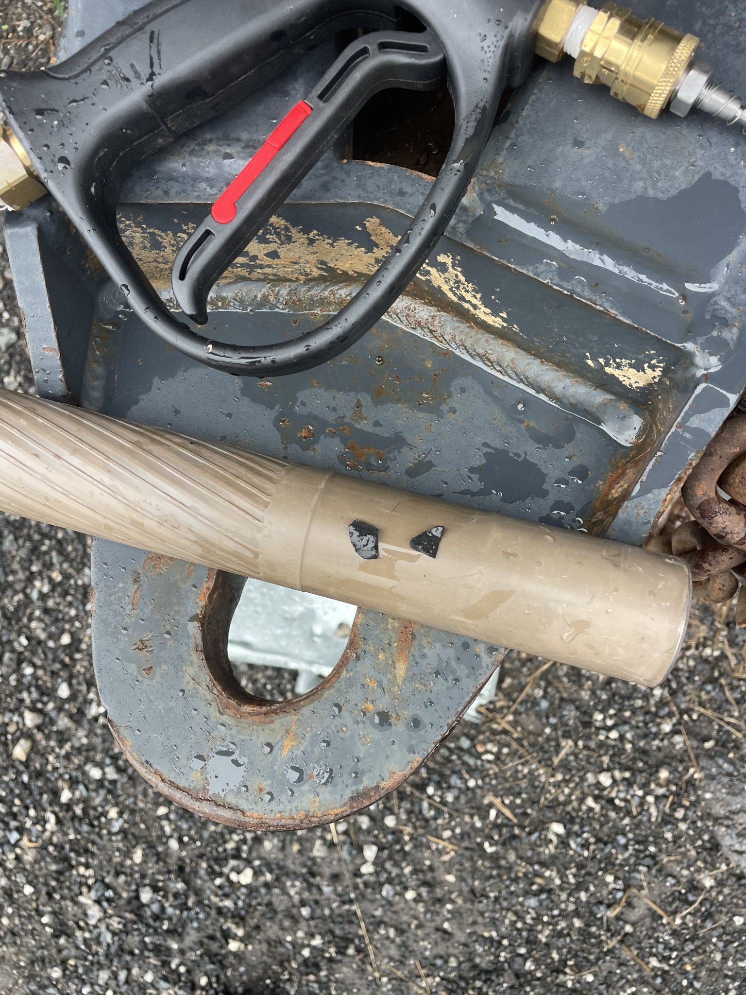

Think the power washer attachment should get it perfect.

1) Get a big glass jar, big enough that your suppressor will fit in it.
2) Go to the grocery store and buy white vinegar.
3) Go to a pharmacy and buy and equal amount of hydrogen peroxide (equal to the amount of vinegar)
4) Fille the glass jar with a 50/50 solution.
5) Submerge your suppressor in it and let it soak for three or four hours. Could be longer, depends on how much carbon buildup you have.
6) Wear chemical resistant gloves like Nitrile.
7) Using metal tongs, remove the suppressor and let the liquid drain back into the glass jar.
8) Rinse the suppressor in water.
9) It will likely be as clean as the day you bought it.
10) Seal the lid on the glass jar. You can reuse the liquid several times. I typically take it to a disposal site because it is so inexspensive.

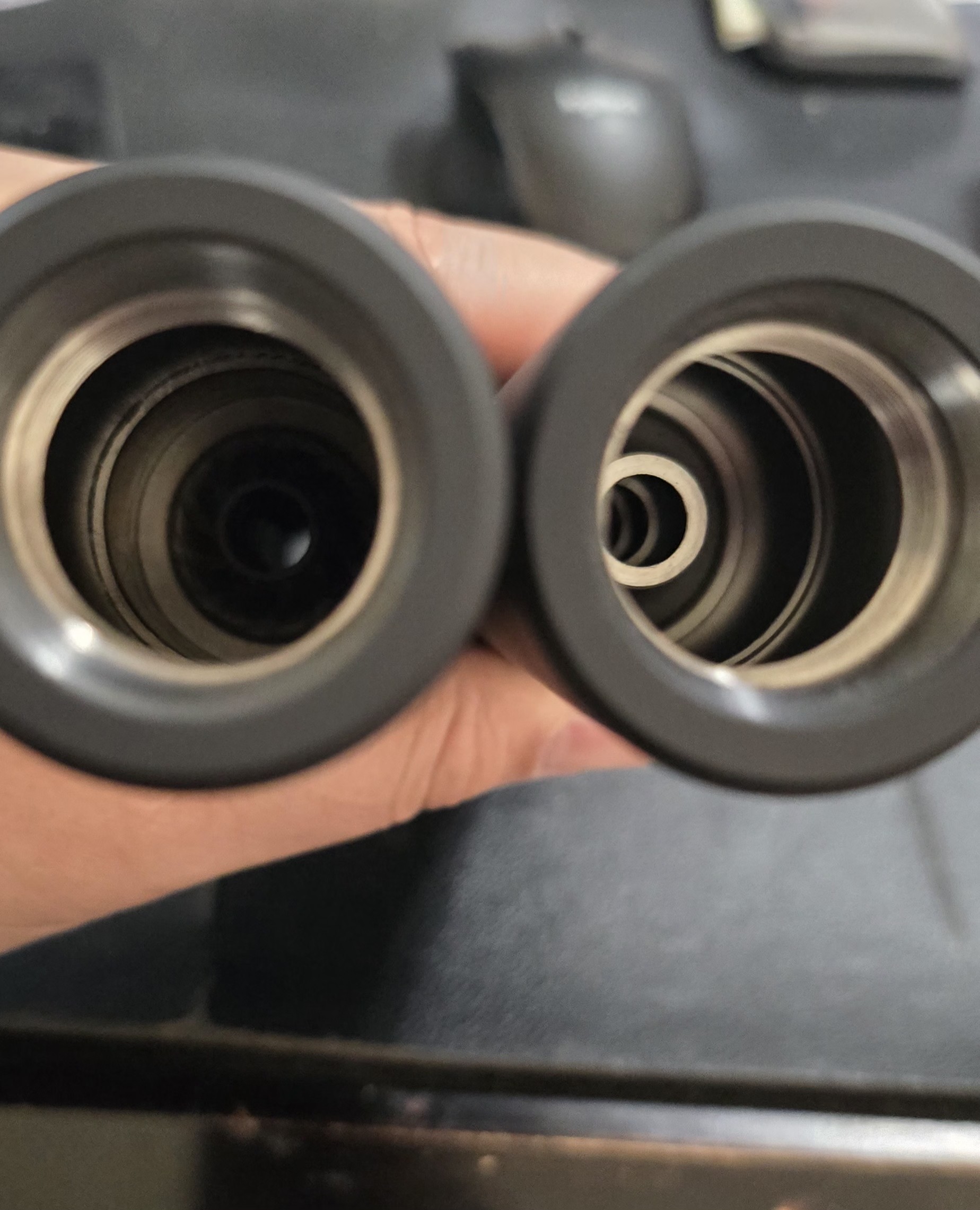

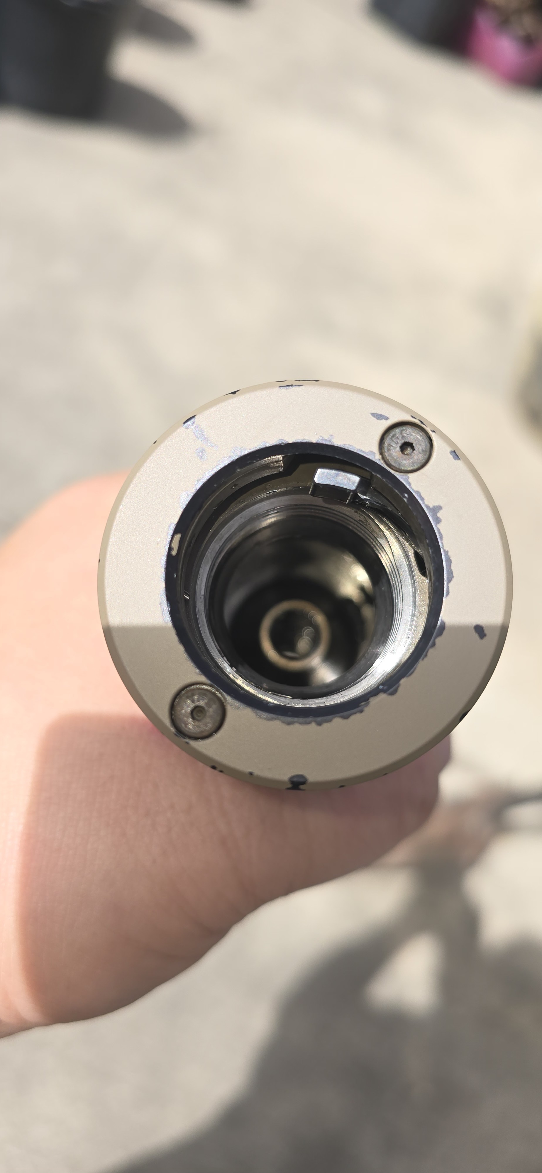

Did this to my 338 Gen 2 a couple months back after sending in my Ultra 9 to be cleaned and 30P1 to be recored, CLR soak for 24 hours and pressure washed it. Didn't use the Boretech wand, just a simple pressure washer gun I use to wash my cars with. Did run my borescope down the suppressor and it does get the vast majority of the carbon out, down to the metal.
TBAC cleaned Ultra 9 on the left, Recored 30P1 on the right. It's a huge difference IMO

Did you miss the whole post about mine that I soaked the piss out of. And power washed it. And it’s still dirty af
I guess you’re just special? Lol JK
Seriously, I doubt your carbon is any different than anyone else, leave it in a bucket for a week, completely soaking in a large volume at least 1 gallon of CLR, maybe agitate it every now and again, and report back
Or, follow the suggestion to send it to thunder beast for a “professional Cleaning” inspect it after it returns and ask them what exactly they did to clean it and we will all learn something
ETA: the whole plug it with a cork and fill it with CLR. It doesn’t make any sense to me. You want a large volume of acid because it’s probably going to get neutralized. That’s why I think you need a 2 1/2 gallon bucket with a gallon or more of CLR in it fully submerging the suppressor.

Didja even read the thread ?
Road around in my truck for prolly a month
I admit that I got a little lost in three pages
What volume of CLR were you using in that contraption? I know you’re mixing in circulating it but what is the total volume of CLR in circulation?
