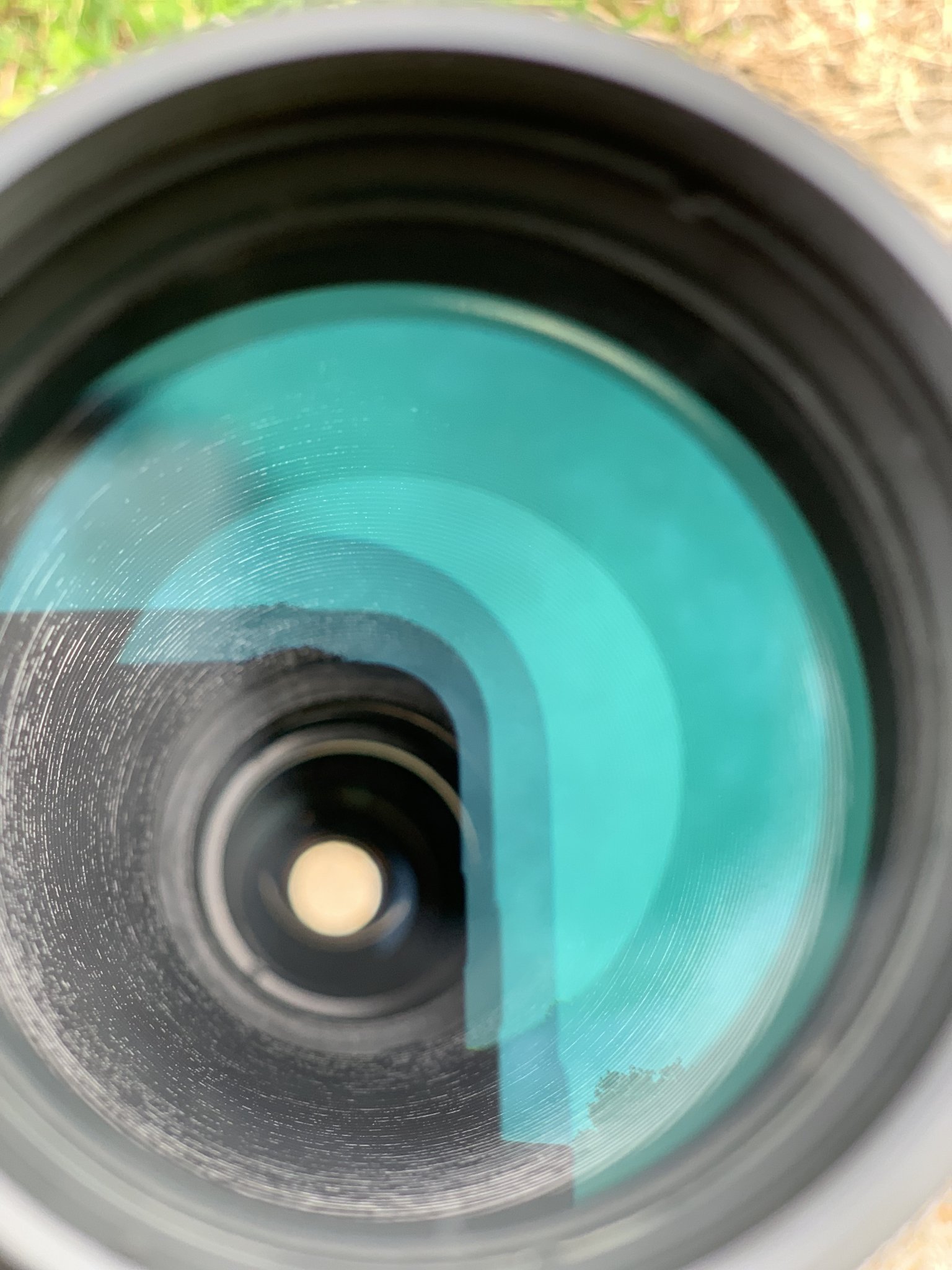

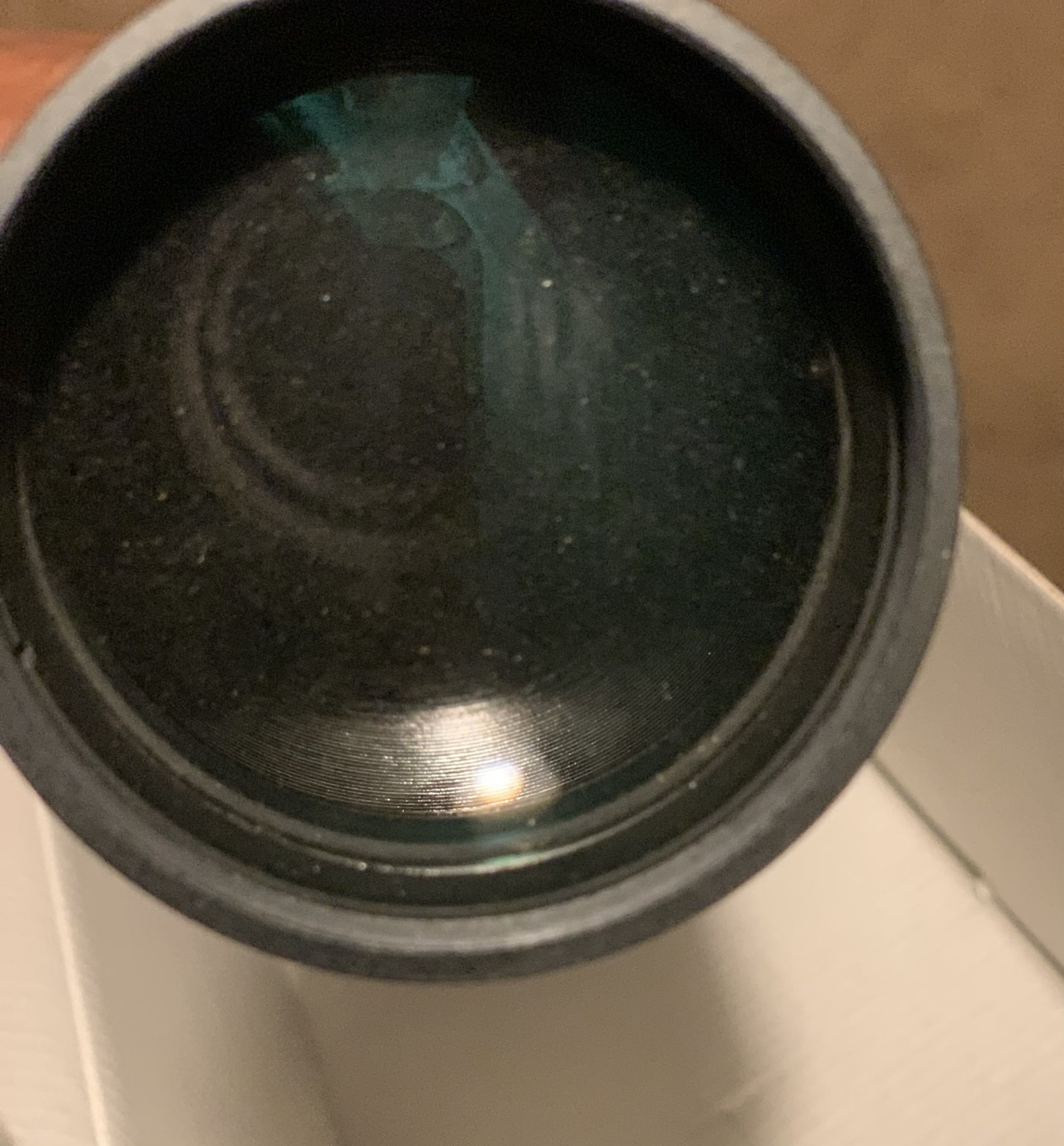

@Convex Thank you. Your suggestion seems really logical. I took a couple photos under artificial light and couldn’t quite catch the layer of grime the way I wanted to. It also appears as it the objective lens may already be scratched. I figured if it’s not too bad I can still hit the timber and knock around the woods with it once I get it cleaned up.
That's really funny!! I know the feeling!! U do a pic trying to hide something, SO it shows up perfect.
Do a pic for the express purpose of showing the crud and it hides from U!!
A few scratches won't seriously degrade the performance of the optic, so if you have a tech U can find who'll do this for you many of them are cool enough to do it at the counter demonstrating how they do it.
Then nothing is added to the scratches already there.

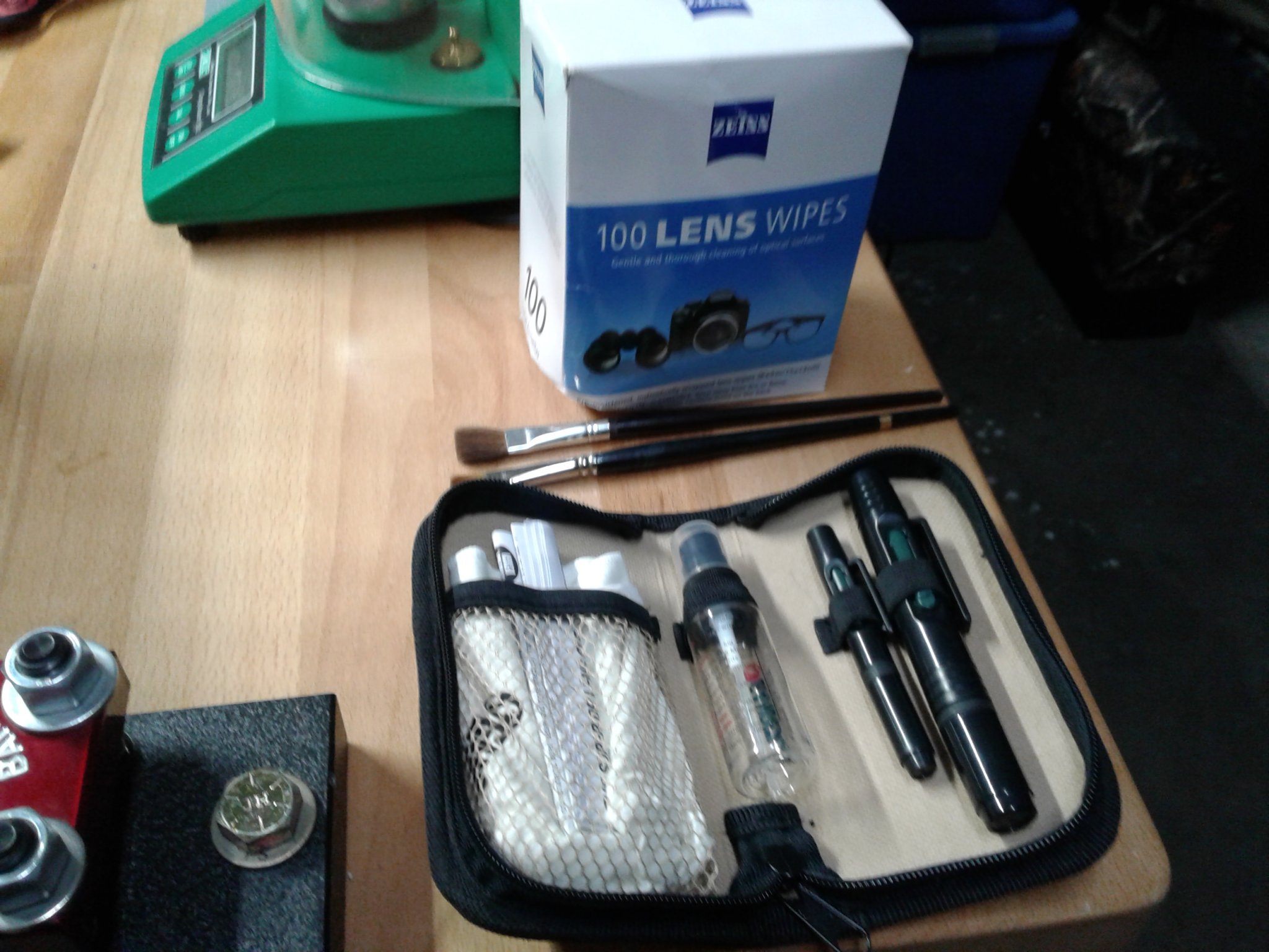

I touch lenses as absolutely little as possible but when I do its 99% ISO and q-tips followed by a soft clean lens cloth.

Got it done with 91% Isopropyl alcohol, q-tips, a blower bulb, a lens brush, and a lens wipe.
