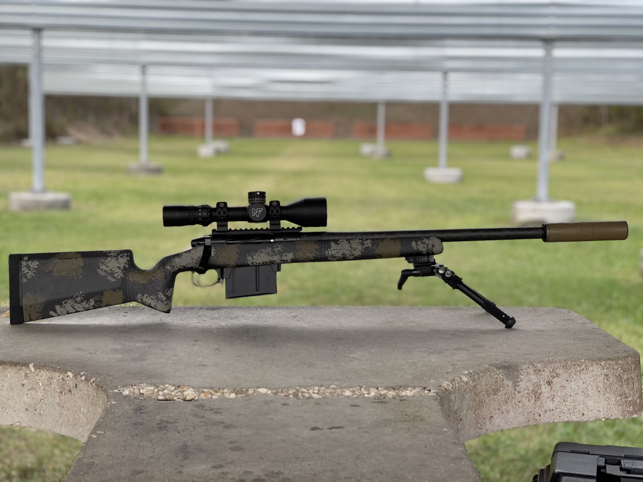

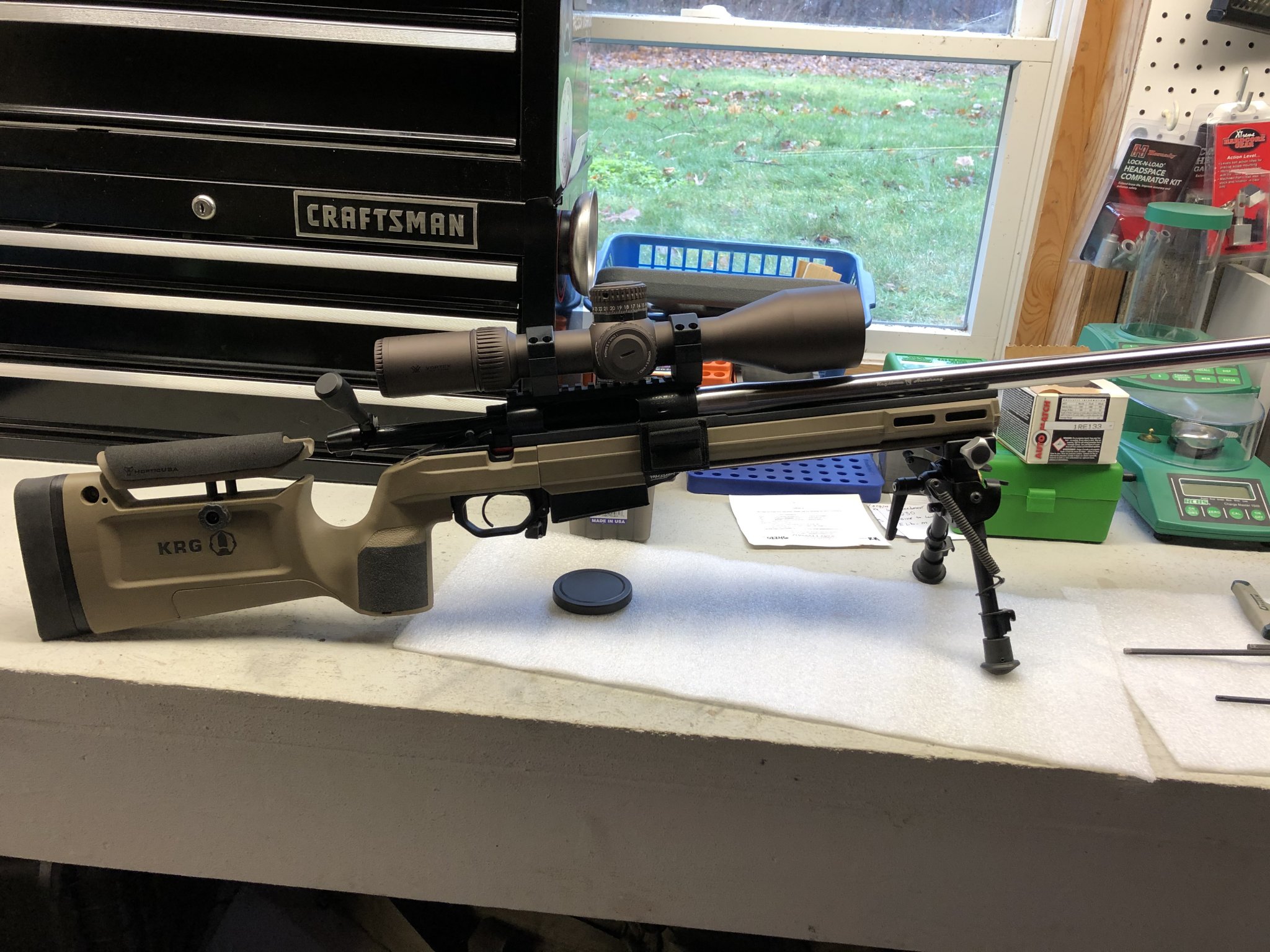

Bighorn Origin Build Thread
My wife's origin built for NMLRA long range inline matches
.40 cal muzzleloader
K&P barrel finished at 26 inches by Bestill Creations
Krg stock
Burris XTR

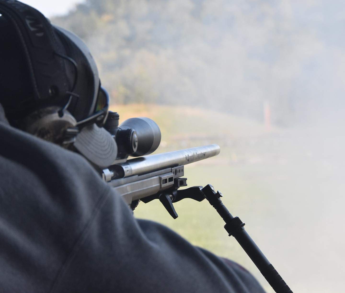

Launching 275 bullets at 2450 using Blackhorn powder. No smokeless aloud at Friendship. 13.5 min to 500 yrdsView attachment 7443813
Care to enlighten on this? What was needed to turn it into a muzzleloader?
Yeah, need to do a thread on them. This is second one, mines in .45 launching 325s. Using an arrowhead rifles breach plug that uses large magnum rifle primers. The modules are same bolt face as .308, so works in centerfire actions.
Snap modules under extractor to load and nice thing about Origin action is they fall out the magwell when you work the bolt. I just catch em and put em in a tray beside where I shoot.
Oh yeah and mines a 6 Creed chambered by Bugholes in about 4 minutes. Heres a half assed pic of mine at a match making smoke

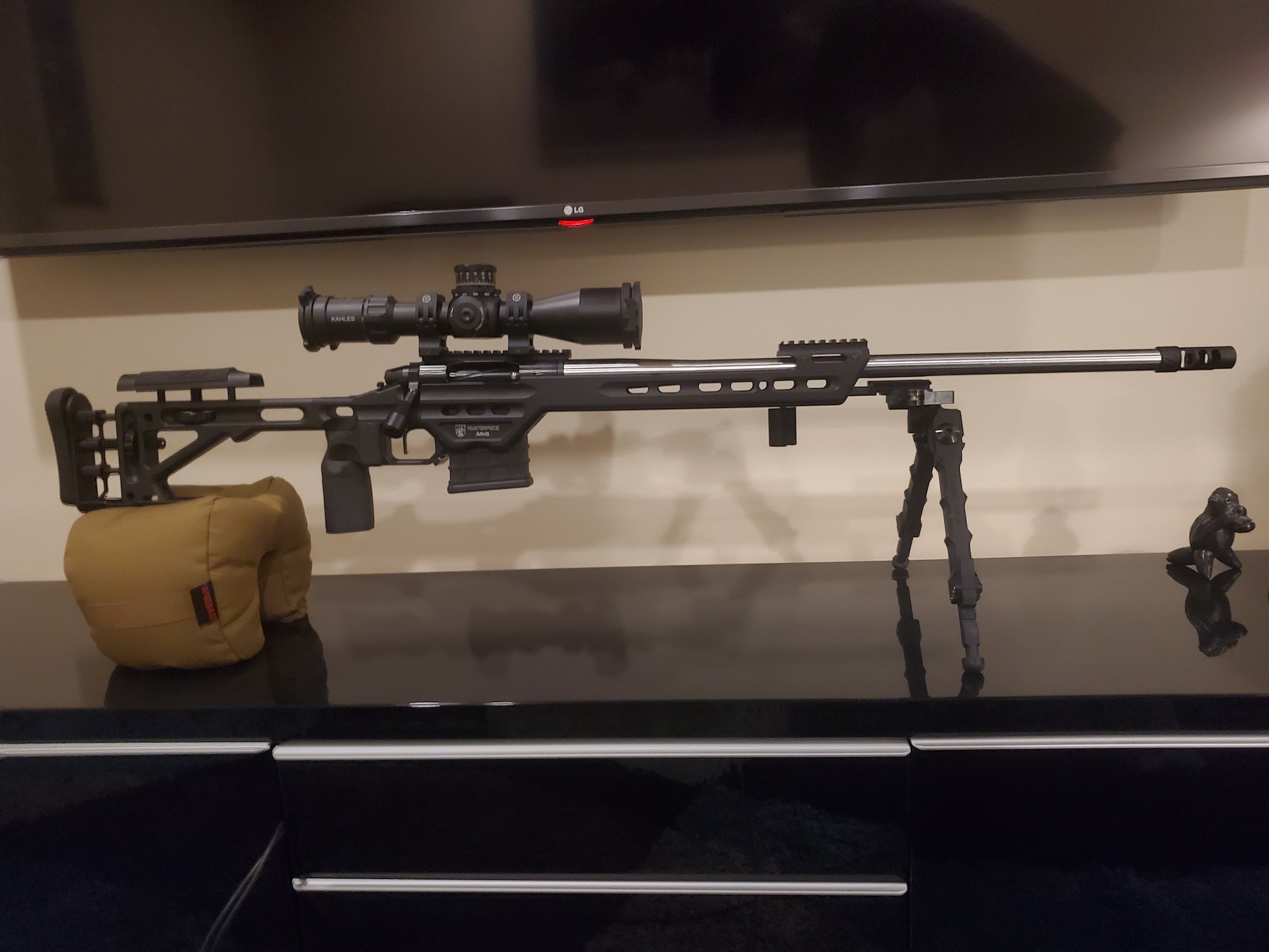

Why the M24 contour? I’m trying to figure out what contour I want for my 6 BR, thinking medium Palma or marksman as of now.
If you’re going to use your rifle for PRS go as heavy of a contour as you can fit. I have a proof comp contour in 6 creed and a bartlein heavy varmint in 6 bra. I run my origin action in a KRG bravo chassis.

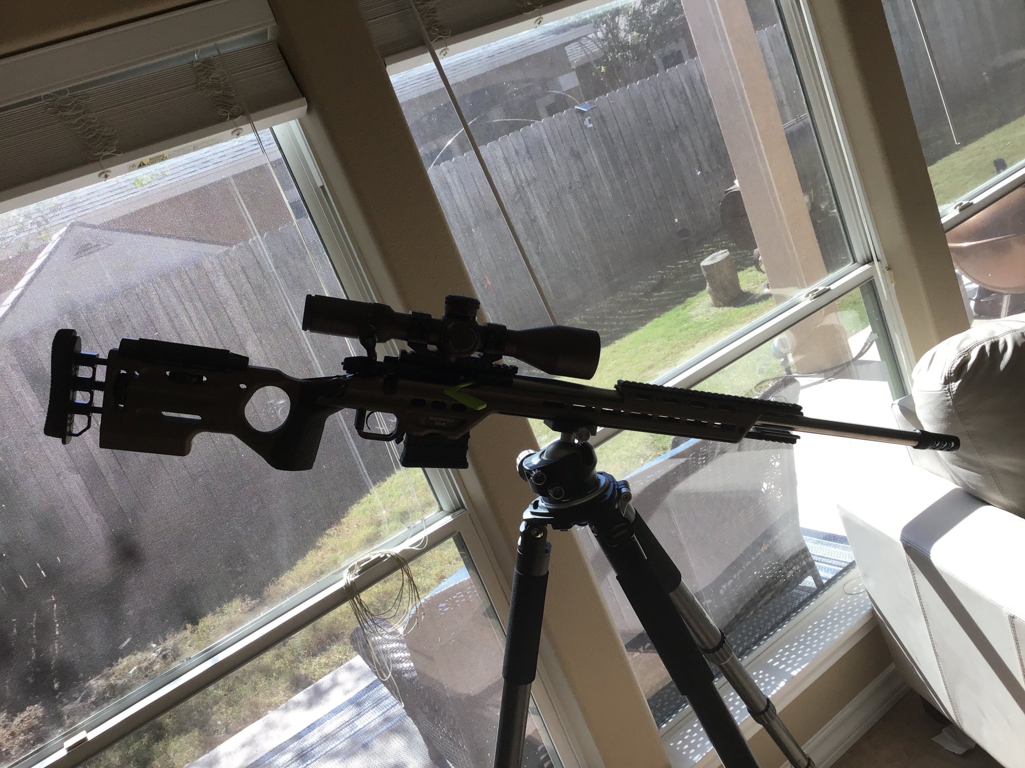

Anybody running a SL with their Origin? Any issues? Am I correct to order a rail specifically for use with the SL? Any other info you can pass on before I put a deposit down would be helpful. Thanks.

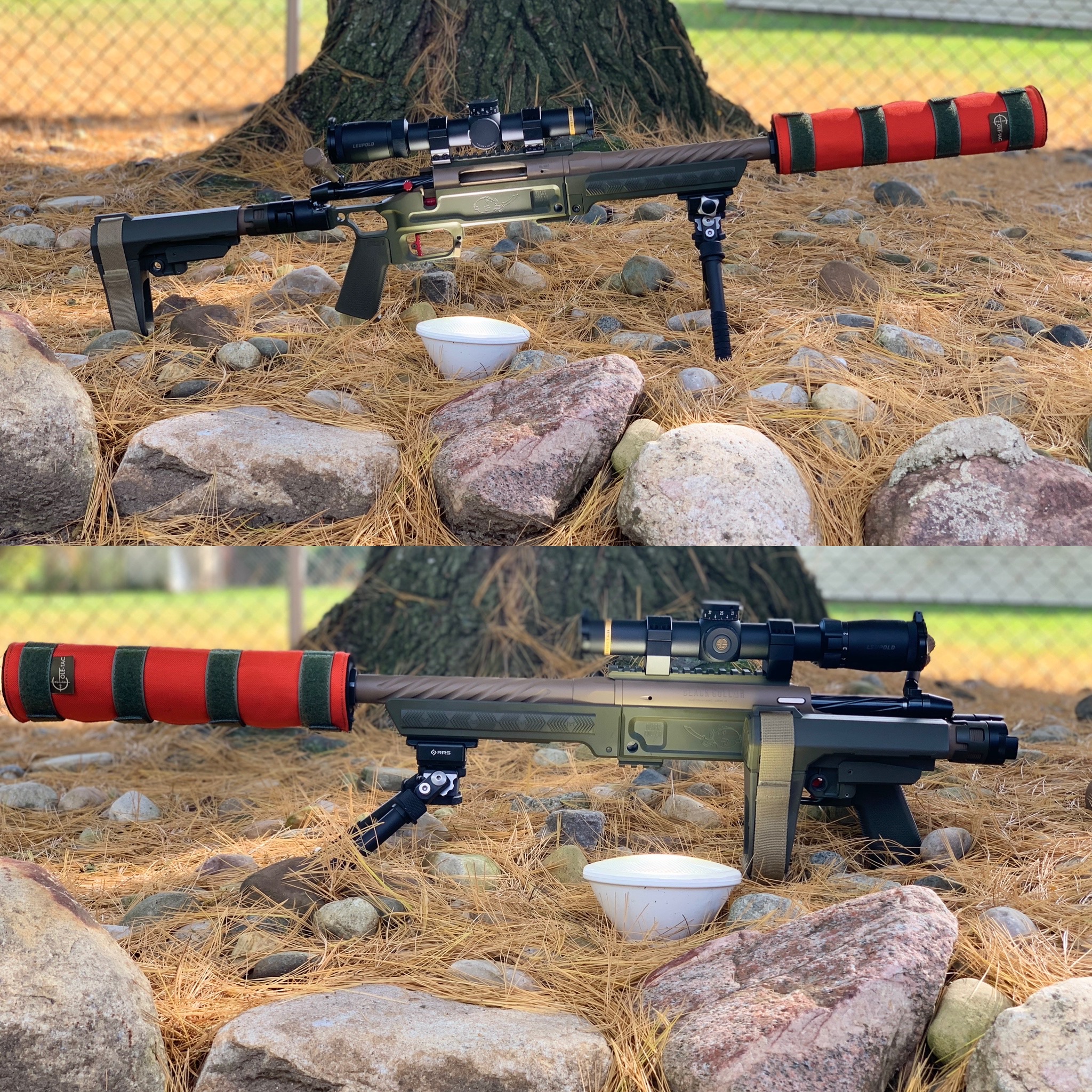

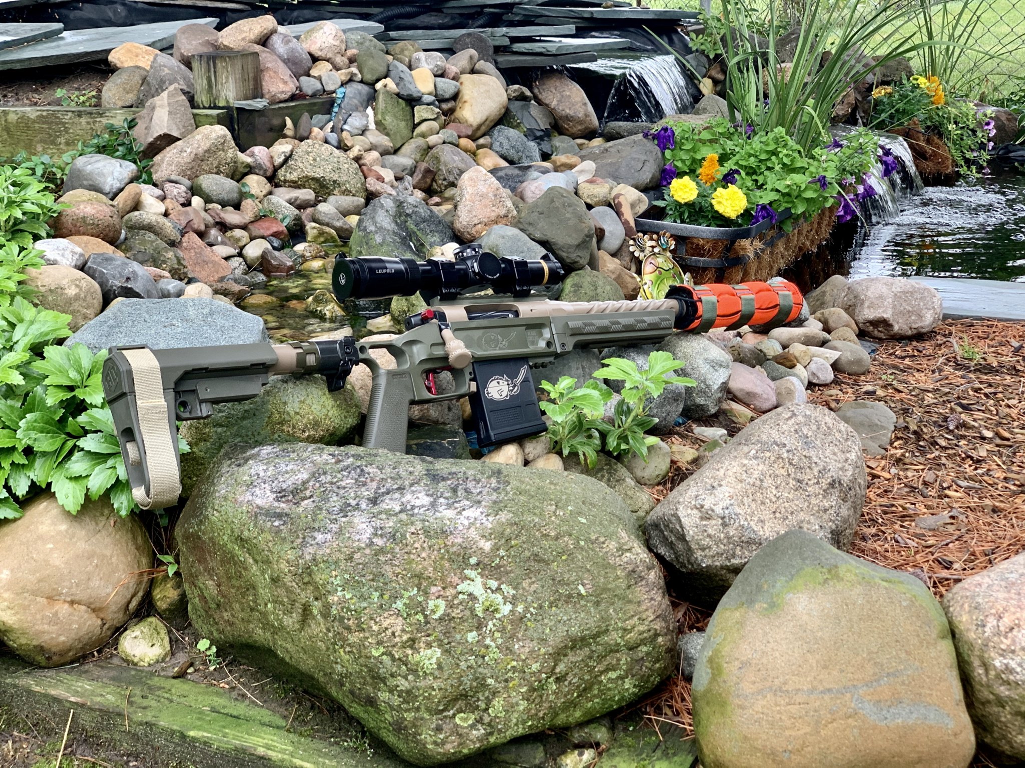

Got my origin over the summer after ordering a complete build from black collar arms. 10” 450 bushmaster pistol

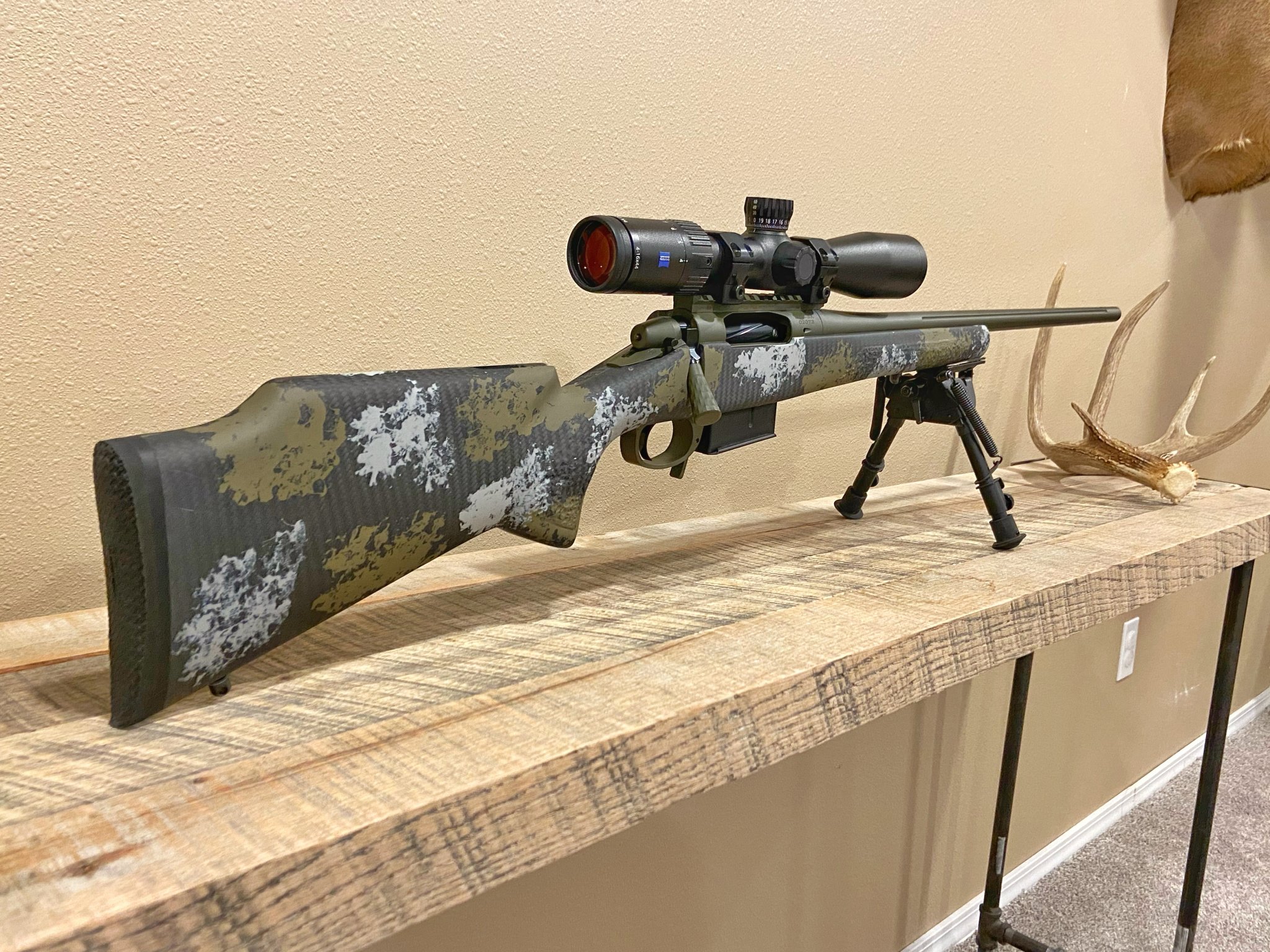

Post your Bighorn Origin builds here.
Mine is another masterpiece by Jon Beanland.

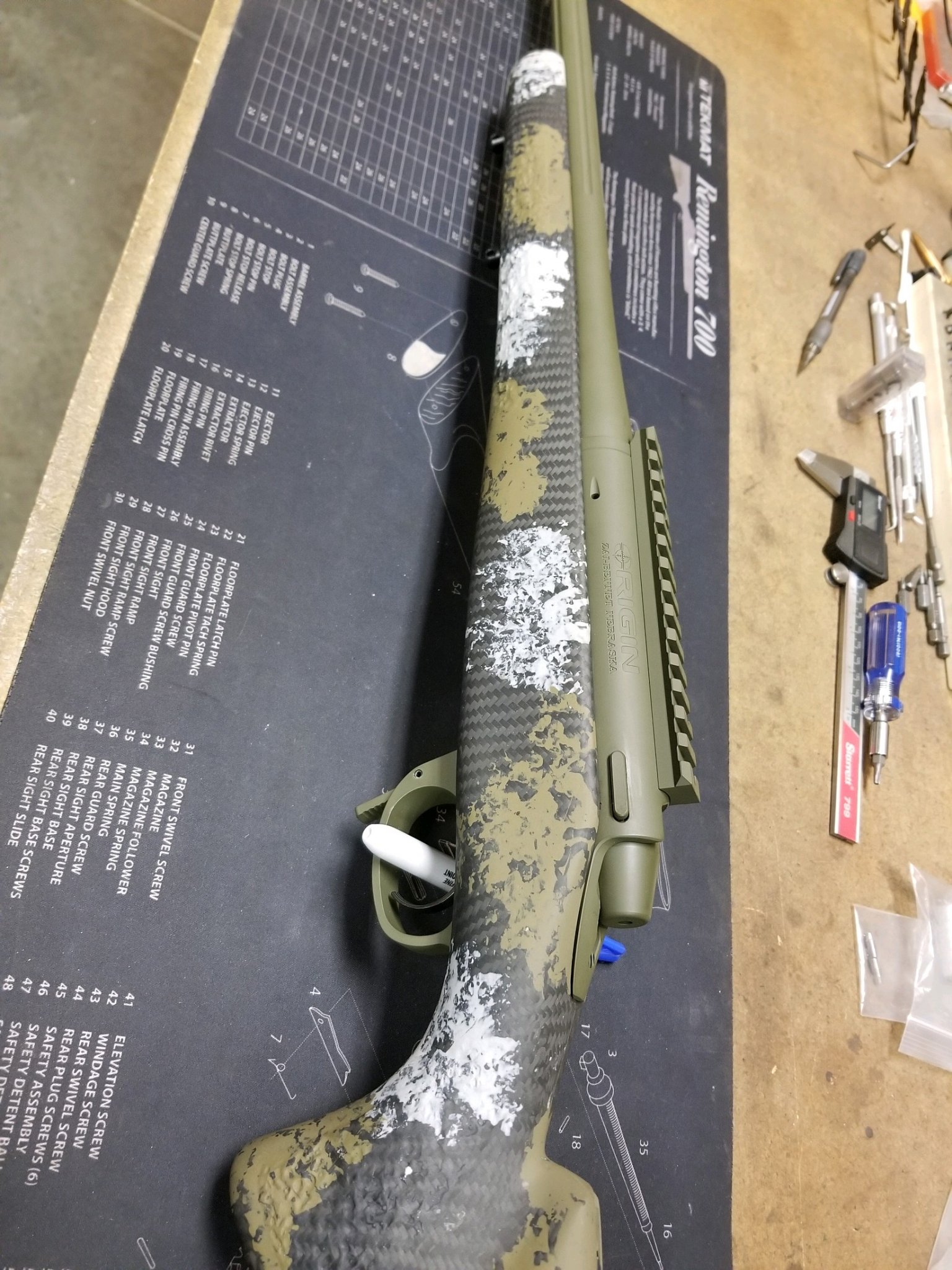

Bighorn Origin
#3 Bartlein 5R chambered in 6.5 Creedmoor finished at 24”
McMillan Adjustable Game Scout in Desert Carbon Ambush
Triggertech Diamond
APA Bottom Metal
Bighorn 20 MOA rail
SWFA rings
Bushnell 3-12 LRTSi
Flush cups on left side.

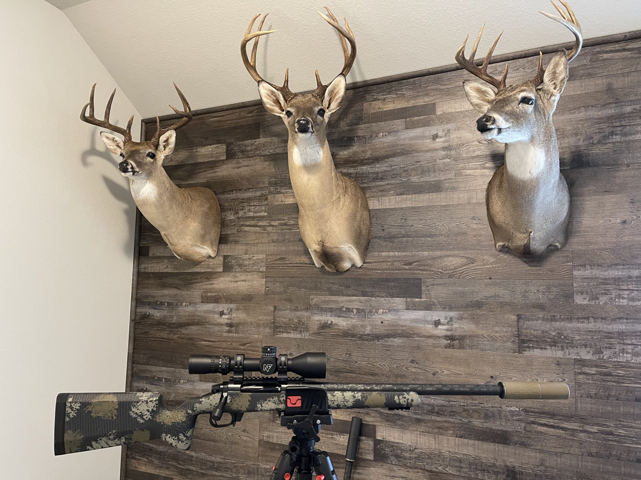

Load development was easy. Wind was unusually calm so I decided to do it at 500. Not picky at all. Biggest group of the day was the 130gr Berger AR Hybrids at .632 MOA. Best was 42gr H4350 behind the Berger 140gr Elite Hunter. That went .498 MOA. Five 5-shot groups with 5 different loads averaged .555 MOA at 500 yards. Taking this one for Caribou in a couple of weeks.
John
I picked the best charge from my 500 yard load development and put 5 rounds on paper at 100 today to make sure I had a good zero. Wind was gusting hard and bench was really wobbly or it would have been better. Made a .1 adjustment and reset the zero indicator. Battery ran out on my chronograph so I made a guess on velocity and took it to 820 to use the velocity truing function on Ballistic AE. Group was 4.5” low at 820 so I put that in Ballistic AE and it determined true velocity was 2790. Fired one more group at 820 using 2790 velocity and it was centered on aiming point. I think we’re ready for Caribou.
John

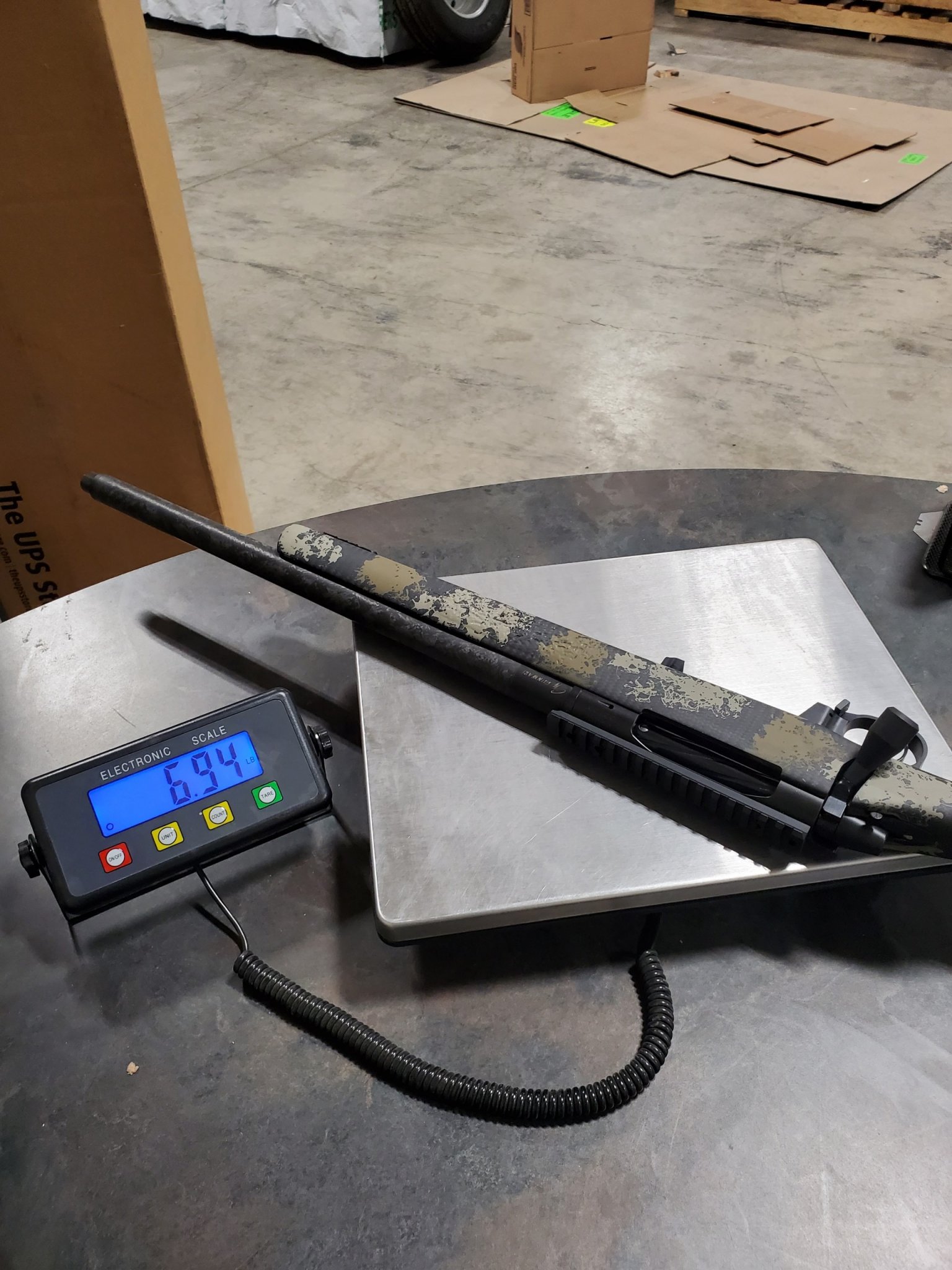

What does it weigh?

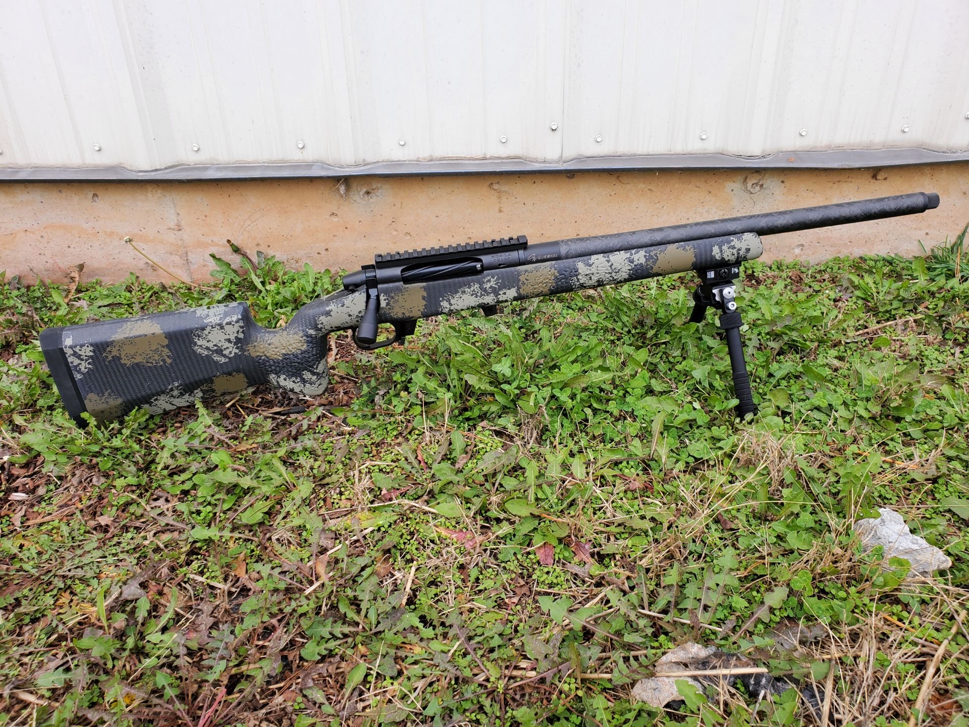

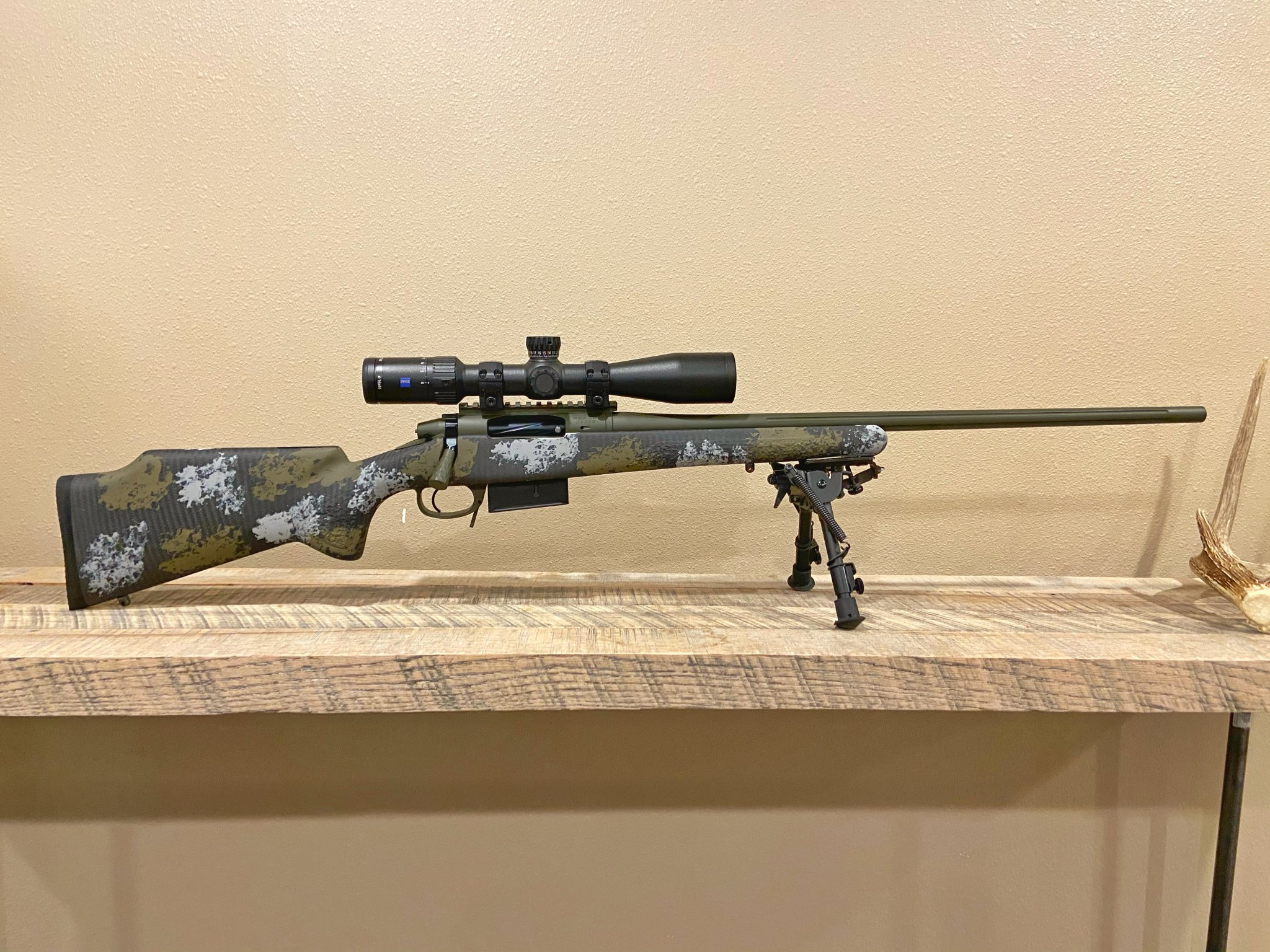

22 Creed Picked up today!
Bartlein #3 1-7.7 finished at 24”
Manners EH2 Elite Tommy Bahama
TriggerTech Special
PTG M5 flush DBM
ZEISS V4 4-16X44
Zeiss Precision Ultralight Low rings
OD Green Cerakote
Beyond pleased with how it turned out!
Great looking rifle, I love the pattern! What about your cheek weld? Looks like you would need a pad/riser?
Quite possibly, those are low rings also. I usually use Talley Lightweights but decided to use the rail that came with it. Kind of wish I went the Talley route now. Oh well, we'll see how it feels.

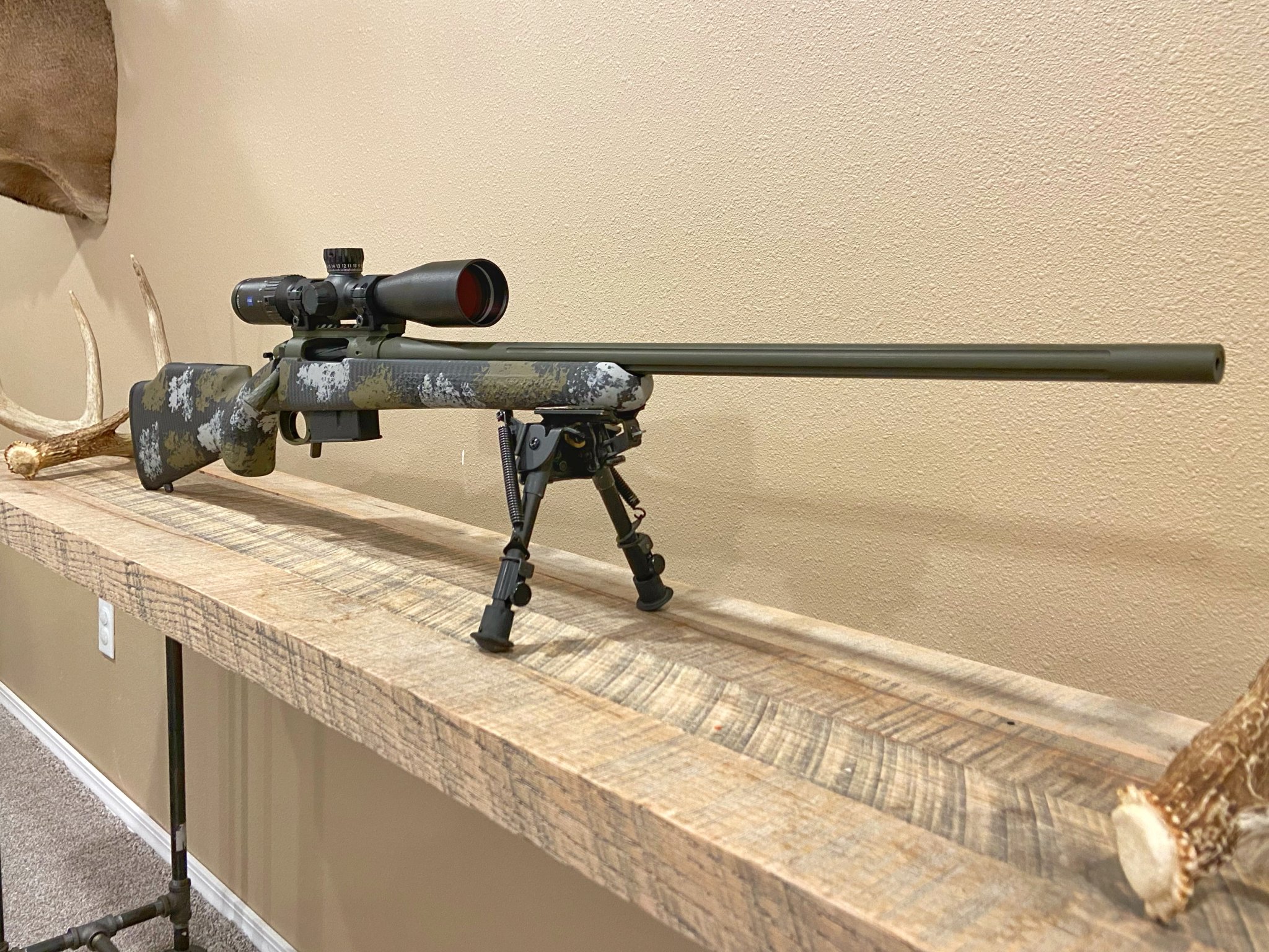

Had Gunware build my dream hunting rifle recently. Bare rifle was just shy of 7lbs, total weight was right at 10lbs.
Bighorn Origin long action magnum
Proof carbon fiber 20 inch 1-10 twist 300 Winchester magnum
Manners Eh1 stock
Hawkins Precision long action DBM CIP length
TriggerTech special trigger
Nightforce NX8 2.5-20x50
ARC M10 Rings
Silencerco Omega 30 can
