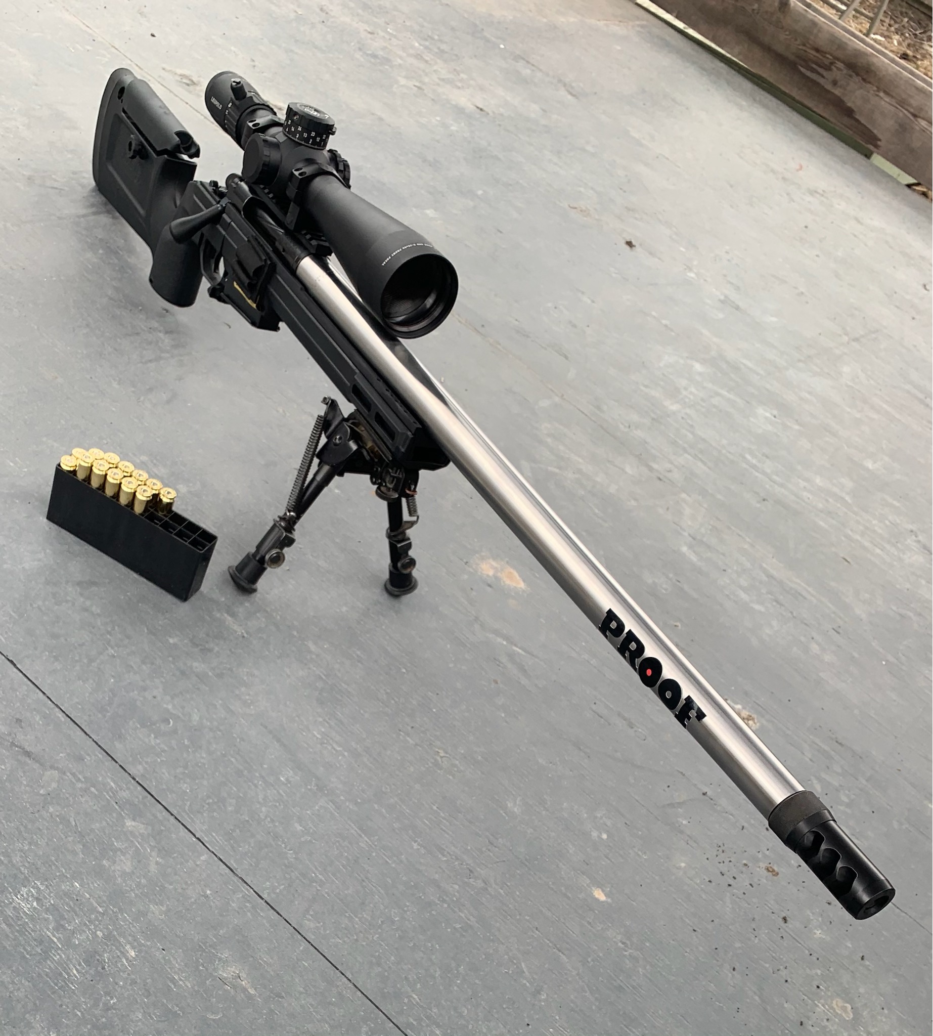

Zermatt/Big Horn Origin, 22" Bartlein Carbon Fiber 223 Wylde. Trigger Tech Diamond, KRG Bravo, Deadair 5/8x24 Keymo brake.

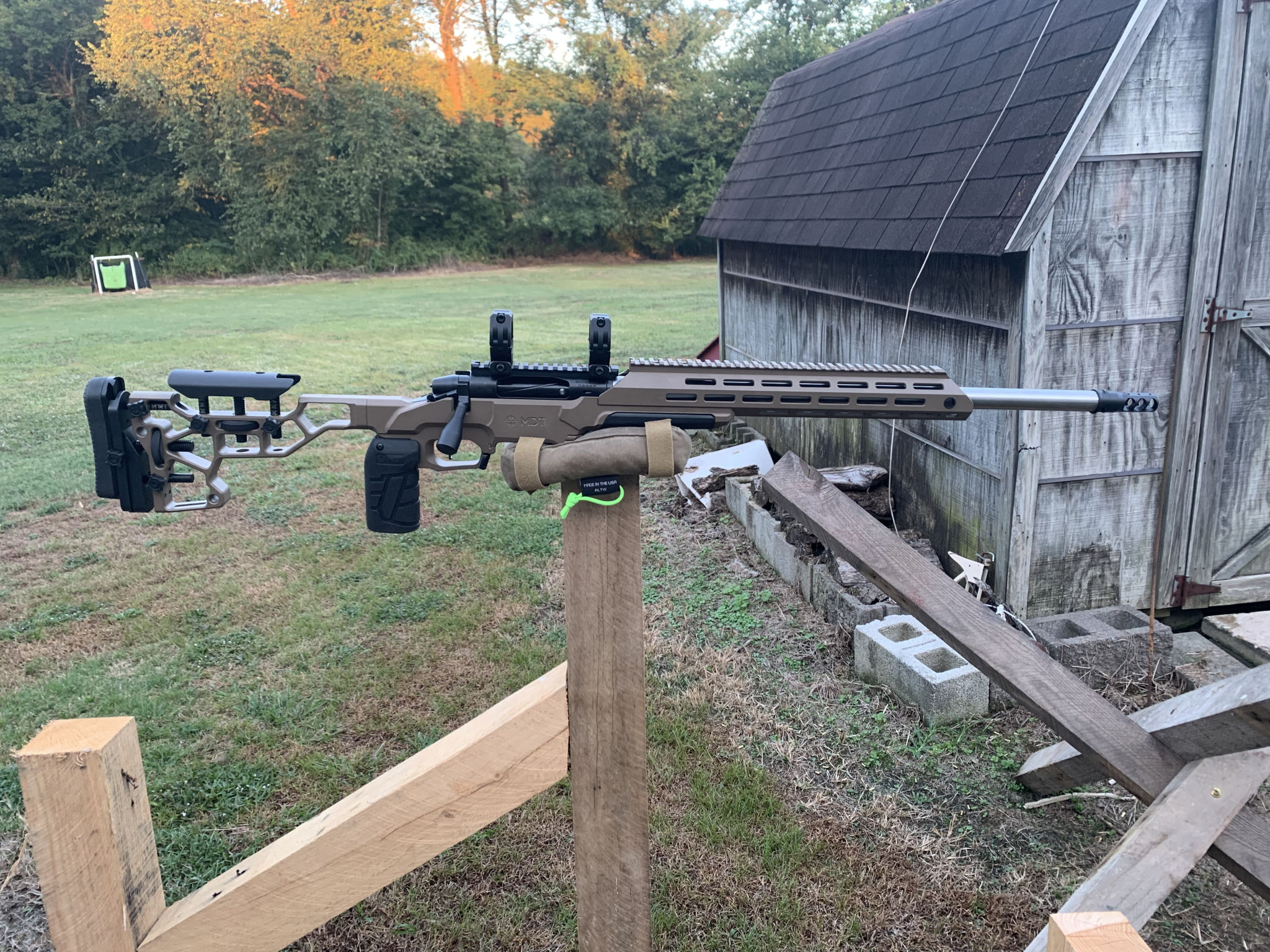

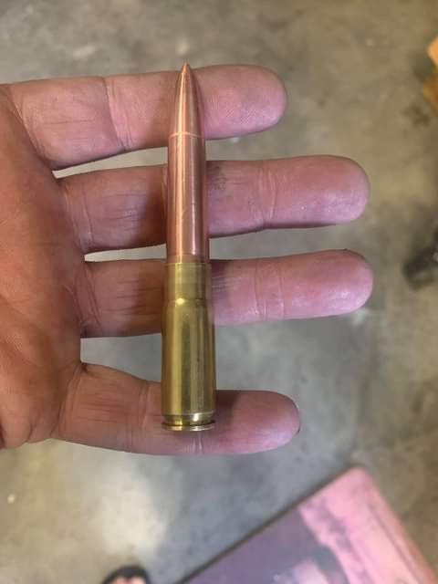

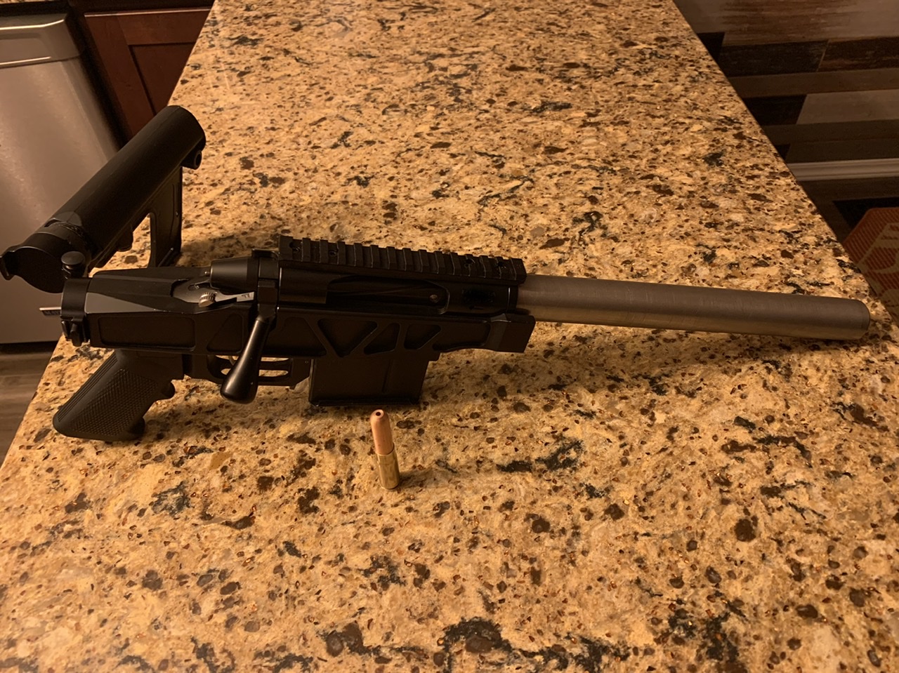

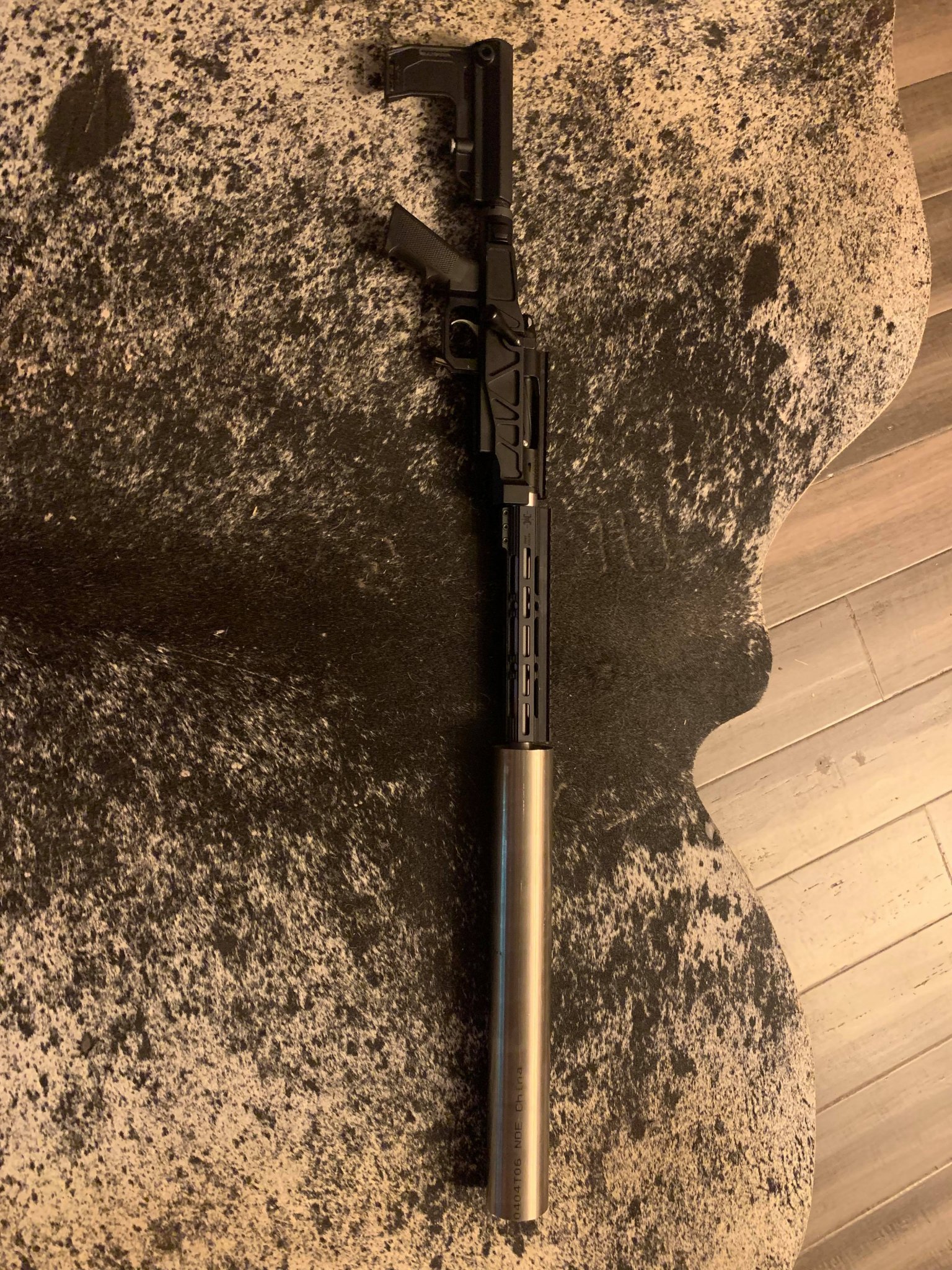

And I finally got the silencer tube for the 458 SOCOM above. Still need to build the guts but this is how it should look. It may not look straight because it is just the tube laid there, I haven't built the end caps yet.
ETA: That is a hand made bullet to get the weight for stability calculations. It is 3” long and 850 grains and out of a 10 twist it would be stable (barely). I will likely use the 600+g bullets from a manufacturer though.
I am also going to shoot my 575g bullet. It is a hammer.
What's that thing gonna be used for?

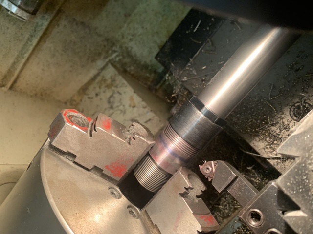

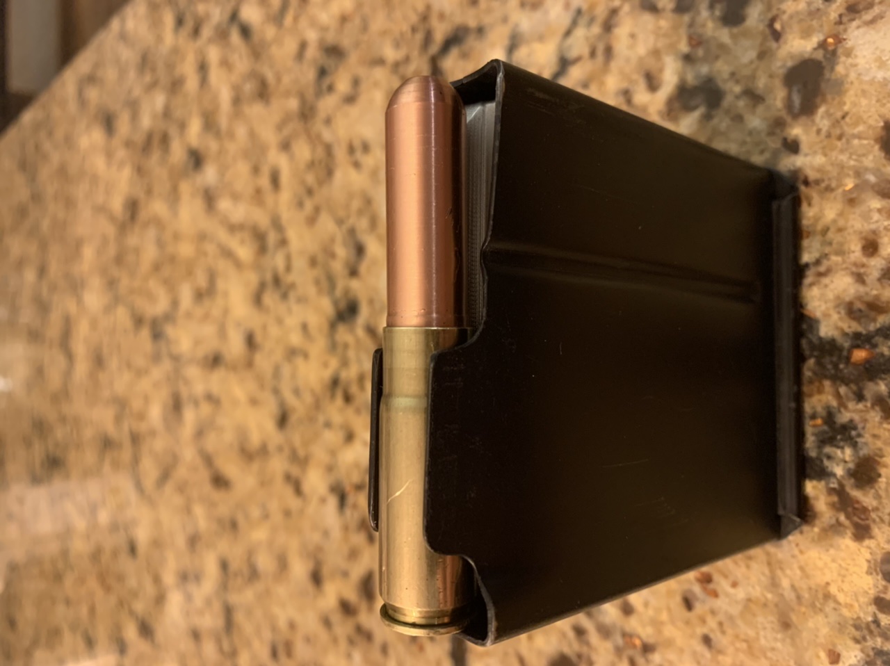

I also threaded the OD of the barrel to accept a standard AR barrel nut. I screw the barrel nut on, torque it down and then install the handguard. Any standard AR handguard will work.
Next is to thread the muzzle 3/4”-24 and make an adapter to go from 3/4”-24 to 1”-14. The silencer is actually for my 50 BMG which I threaded.

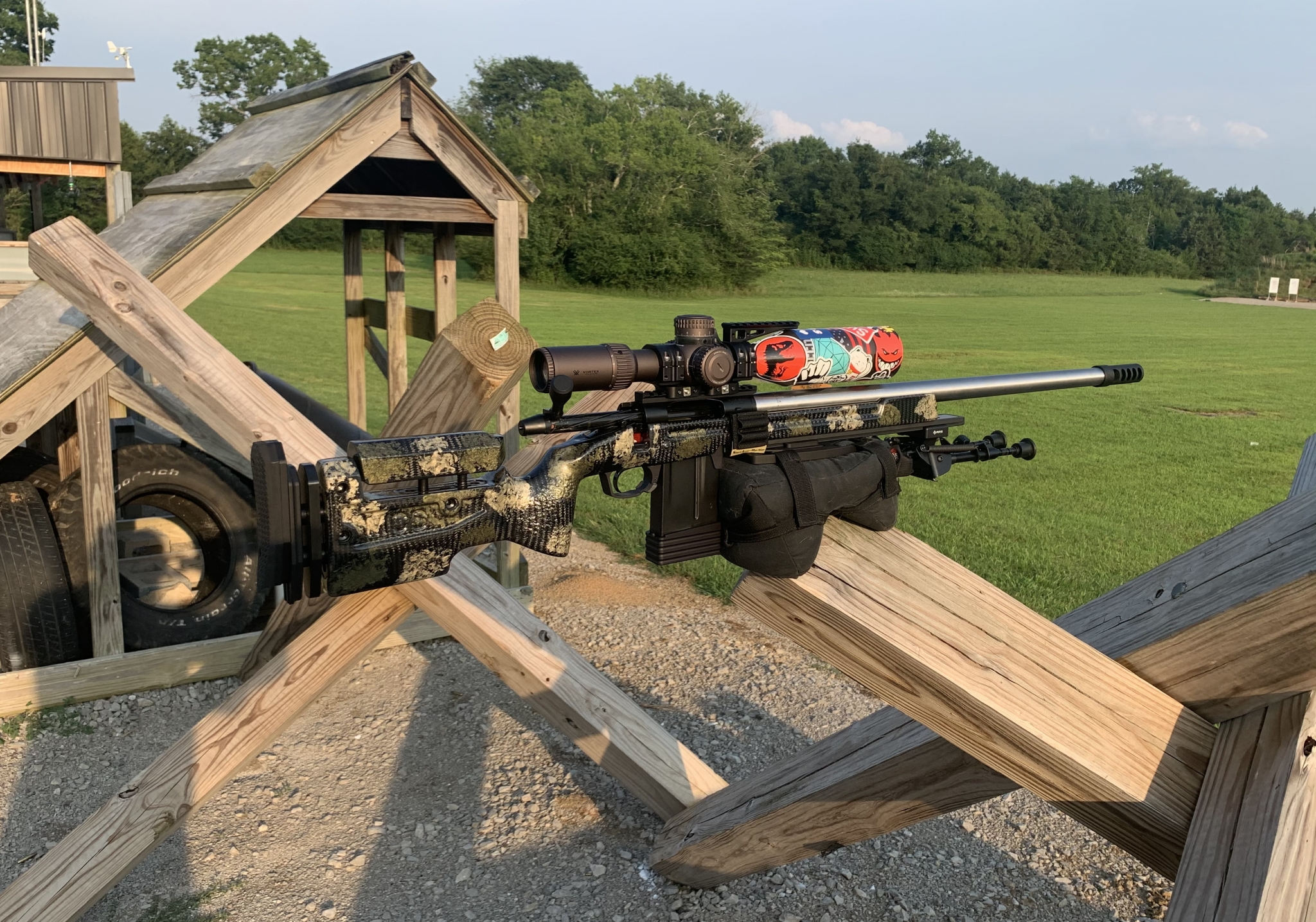

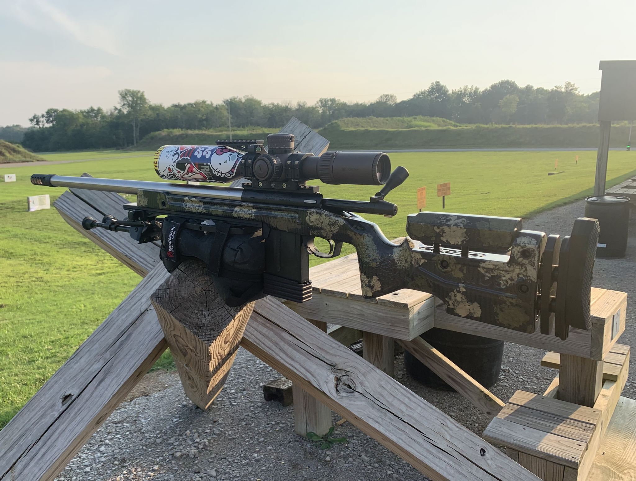

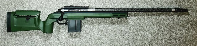

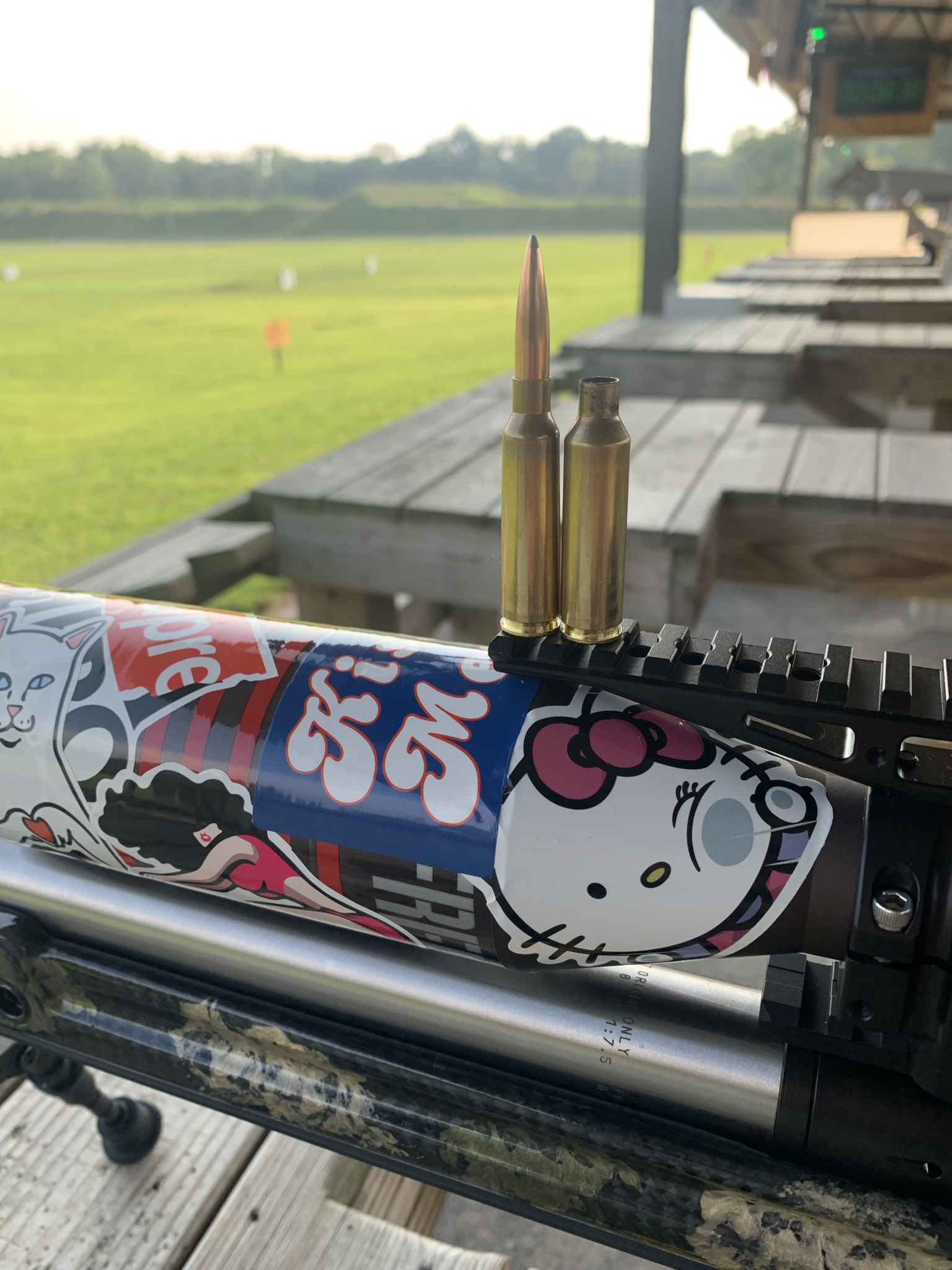

New to me Origin build in "sixty-two fitty" ...for 300rds anyways, then it'll be a 6CM. (Lapua 22-250 necked up to take a 6mm bullet, then fire-formed into 6mm Creedmoor. Just because Lapua doesn't make 6CM LRP brass doesn't mean you can't.)
Origin
Manners PRS-TCS GAP Metallic high gloss
26" 1:7.5T Proof competition contour
TT Diamond
Insite Heathen

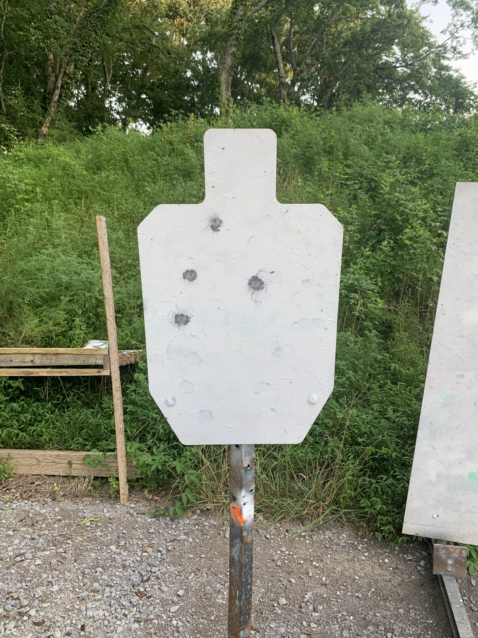

Before anyone says "what an idiot" to using up barrel-life to fire-form... Hear me now, believe me later, it's not so bad, here's what 10 rounds at 750 yards off a Shmedium and tank-trap looked like:
...and here's what rounds #47-50 out of the barrel looked like, 4 for 4 at 1250 yards:
"sixty-two fifty" >-> 6CM:

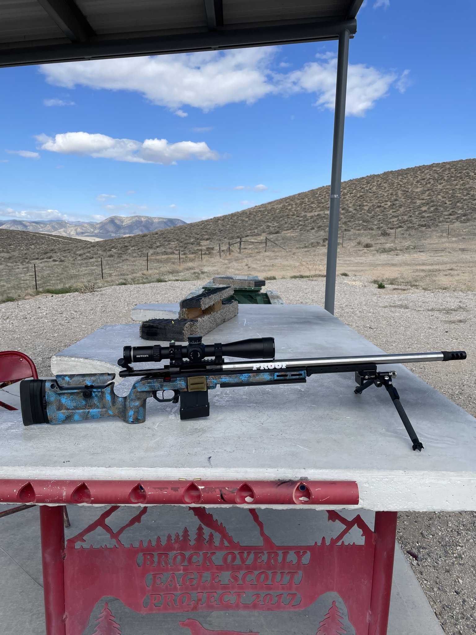

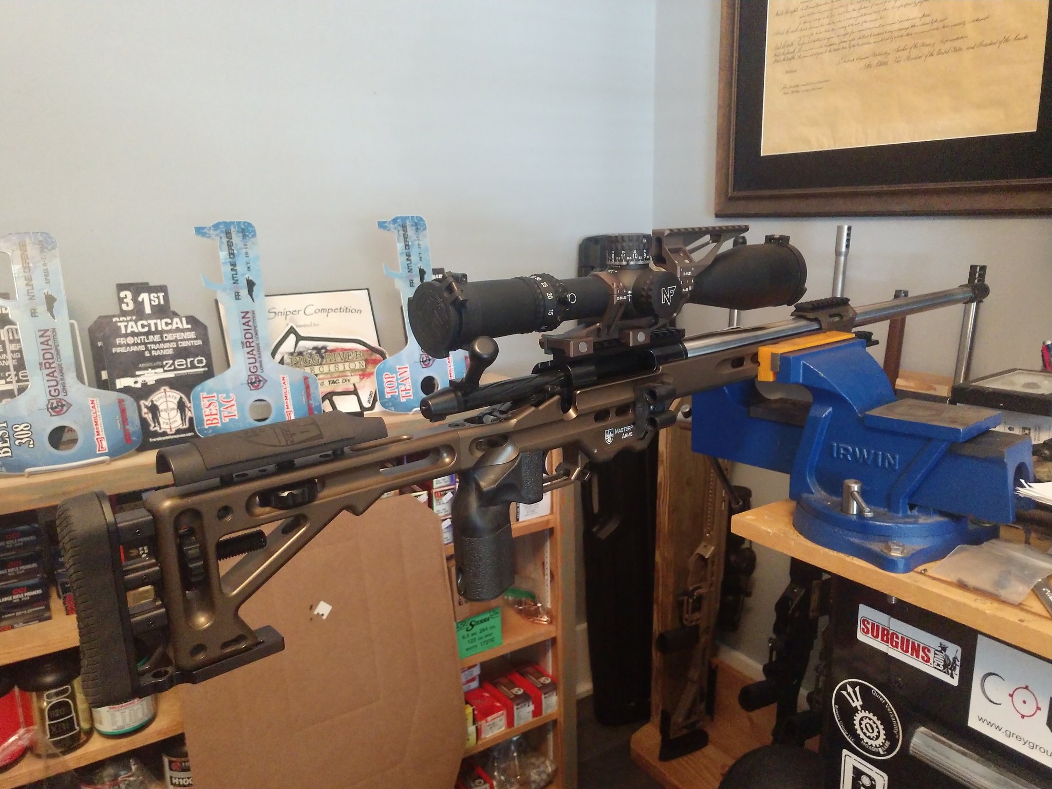

Thought I better post my recent Origin transformation. Started life as a 6.5CM in a Bravo and now a 6BRA in an MPA Matrix and boy is she a shooter😍

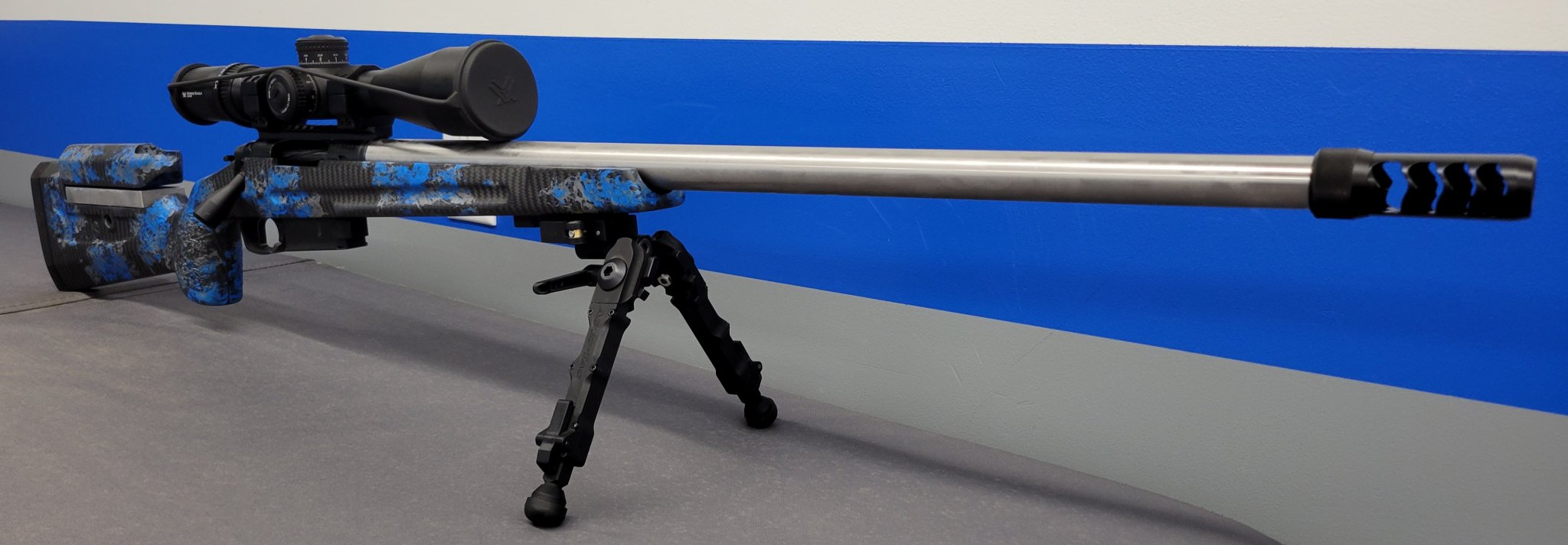

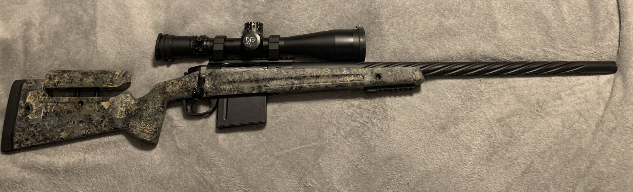

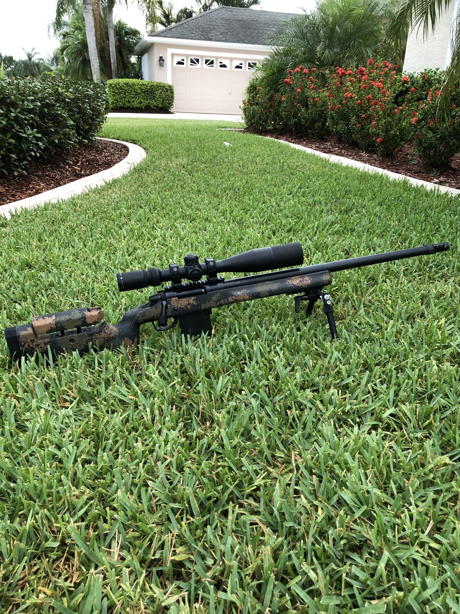

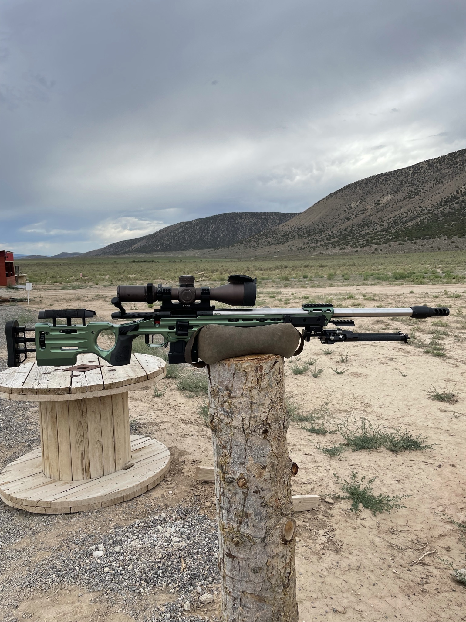

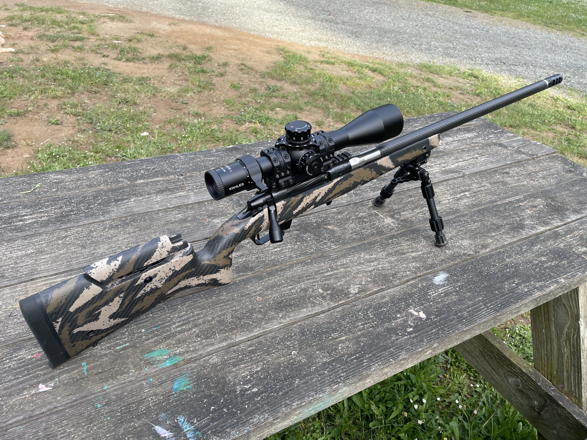

Changed up the rifle a bit and added some weight pulled off the proof 26in carbon and went 28in steel with a new brake and some additional weight courtesy of a steel plate between the comb
Orgin action
28in benchmark by straight jacket 6.5cm
Trigger tech primary
Area 419 sidewinder
Manners prs mini chassis
Accutac bipod
Vortex strike eagle
Seekins rings

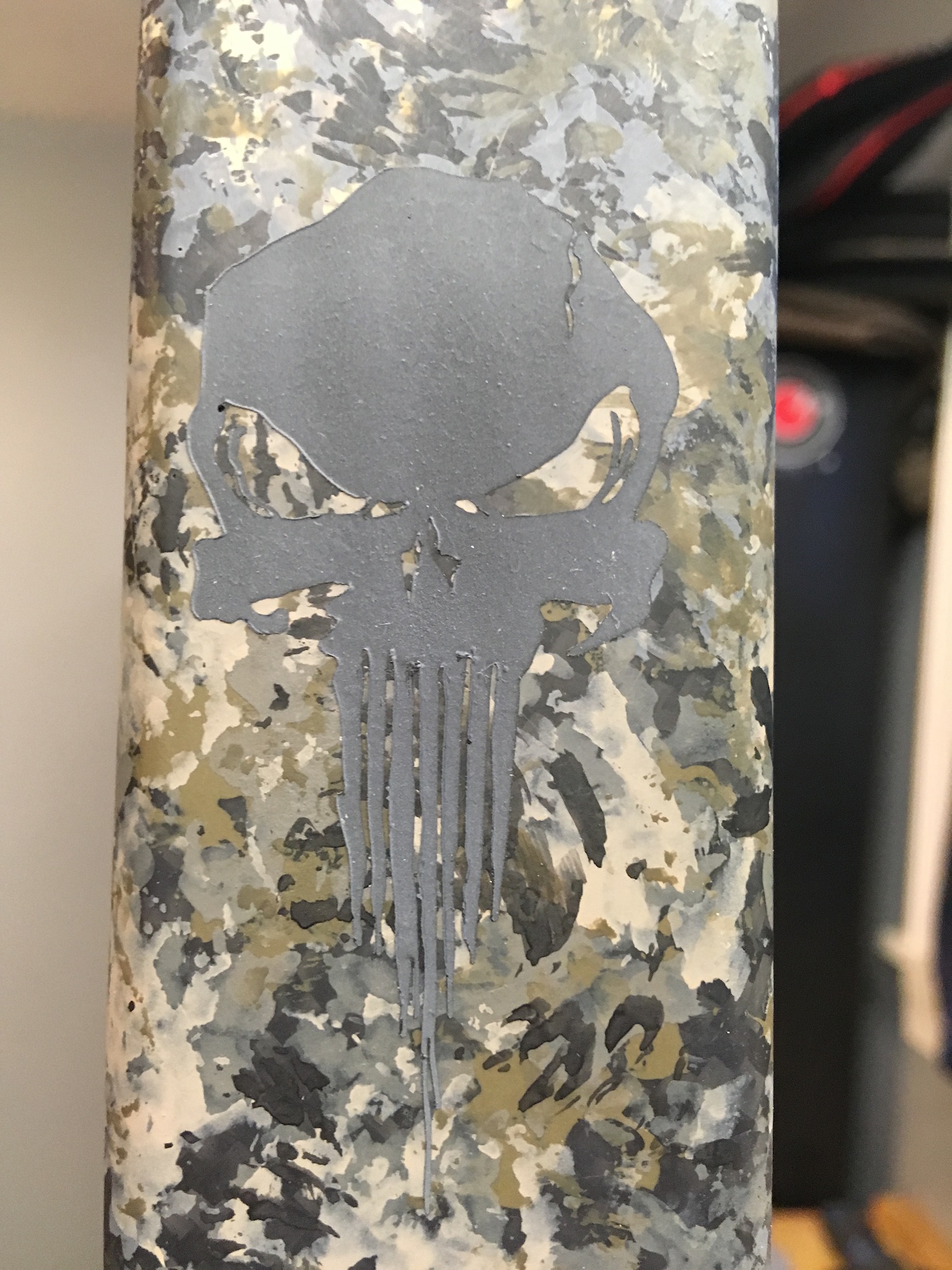

Camo is just a sponge pattern I did over the factory sponge. Natural seal sponge cut a bit to feather the edges. Just have all the colors you want in little dishes (I use new glass ash trays from dollar store). Start sponging in random areas and continue subsequent colors until the gun is covered. It will look fairly “blotchy” at this point. Now you continue to layer the colors overlapping. This is where feather the edge of the sponge gives the effect.
