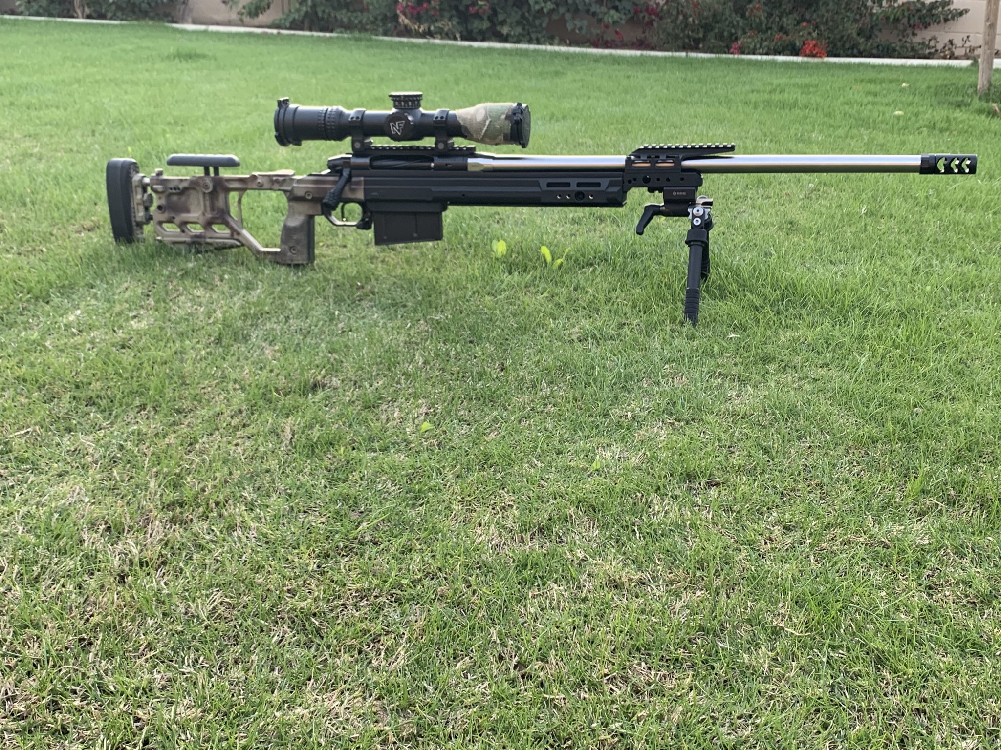

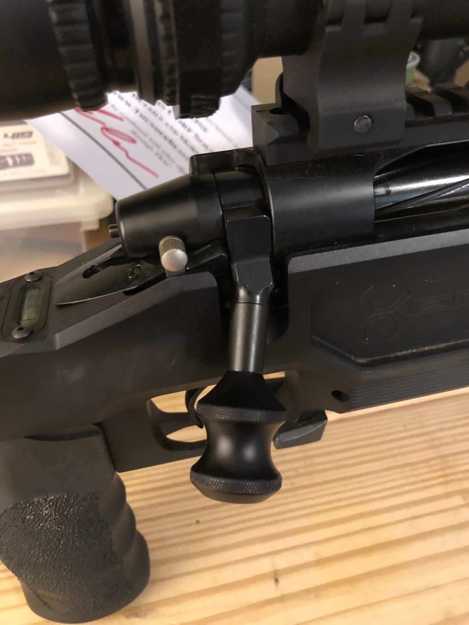

Bighorn Origin Build Thread
Well its finally done!!!
Origin 308
18" proof
Manners CS-2
Apa bottom metal
Apa 34mm .950 rings
Steiner t5xi 3-15x50
Triggertech primary
What bolt thread pattern did you order as I don’t see the 1/4 x 28 on the 419 site?

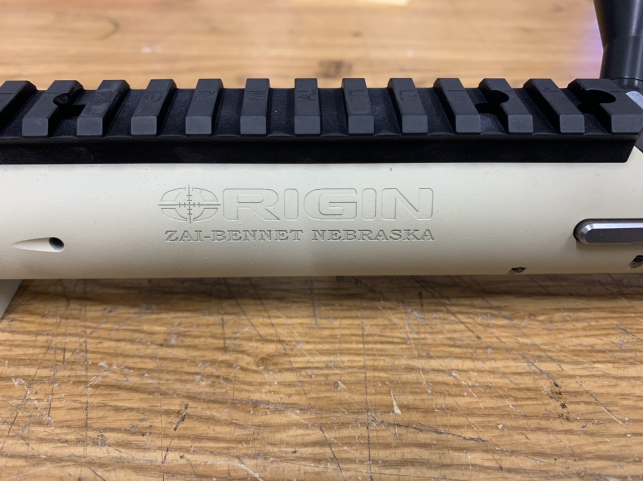

Just threw this together last night. Took some parts off my Origin SA to finish the build.

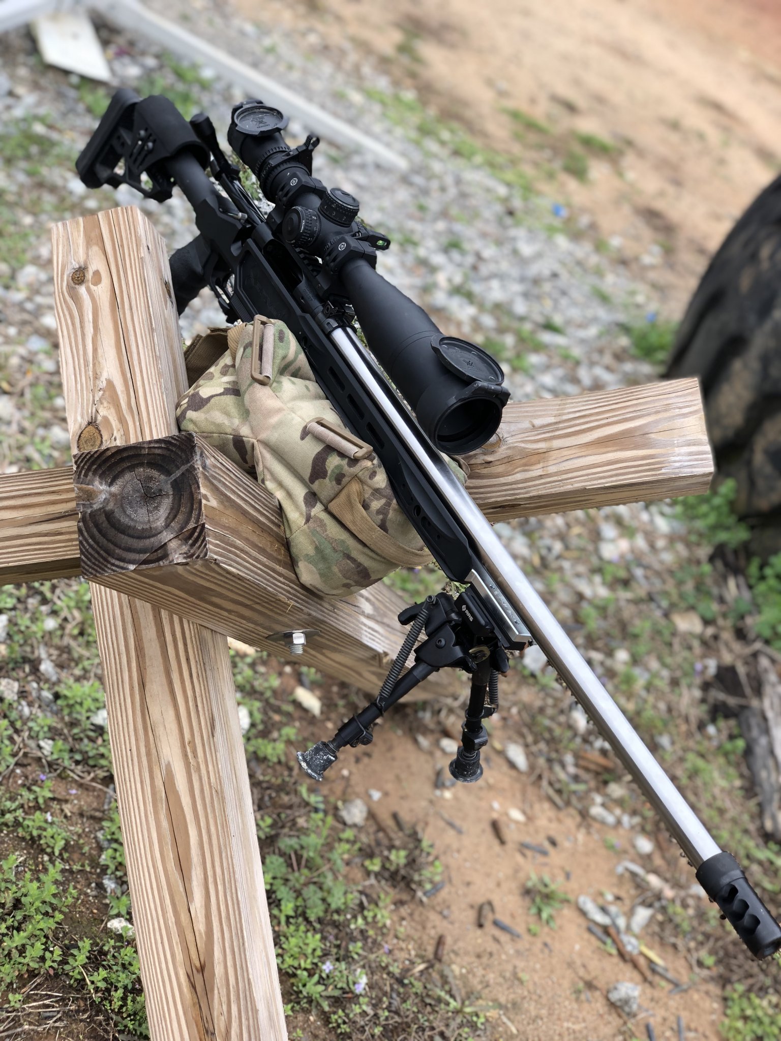

ORIGIN LA
24” Xcaliber sendero contour, 9tw 300wm prefit for now.
PVA Jetblast
Tt Diamond
KRG W3 folder, arca rail, spigot w/nv mount
Atlas CAL G2 on a RRS BTC pro mount
4-16x ATACR for now.

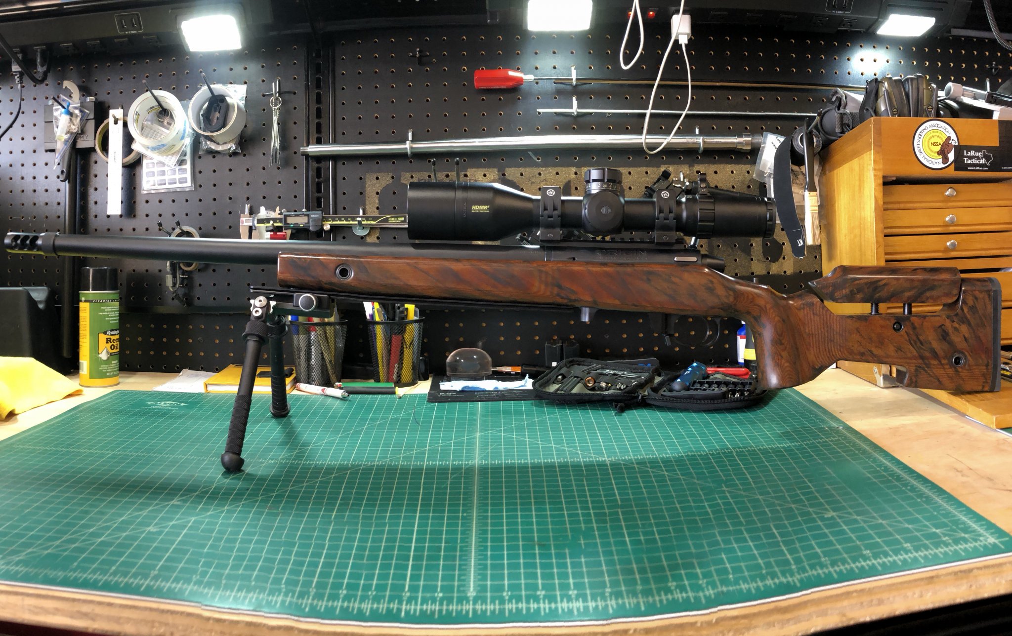

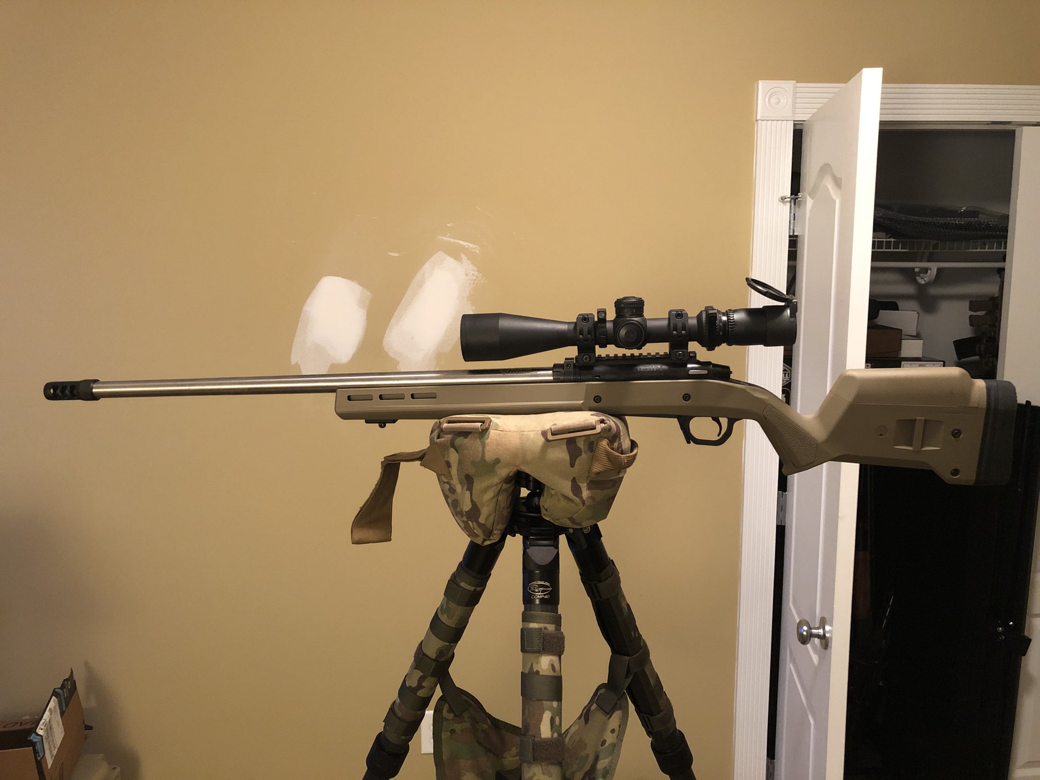

Origin Long Action
HS M-24 Stock
PTG Bottom Metal
Rifle Basix Trigger
Sightron S-Tac 4-20x50
X-Caliber 27" Varmint weight 1-7 Twist ........ in 270 Winchester

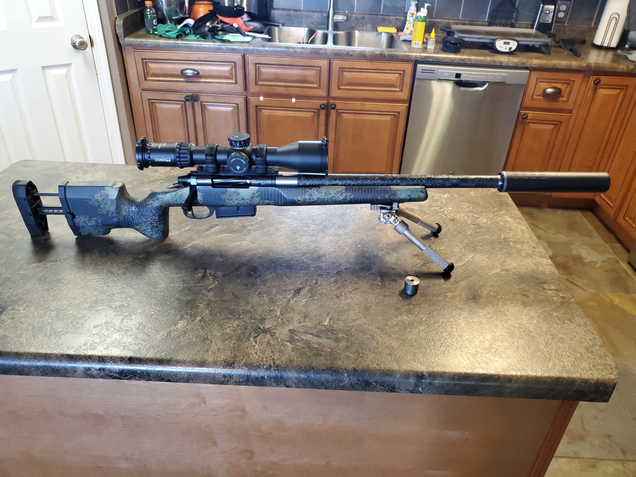

1:8 Bartlein barrel (finished at 26”) (6.5CM) spun up and timed (shouldered, no barrel nut), MPA brake, Bighorn Origin SA, fresh coat of Benelli Sand cerakote. tT Diamond not shown. Now just waiting on the big brown truck to deliver the JCS carbon fiber tactical adjustable stock.

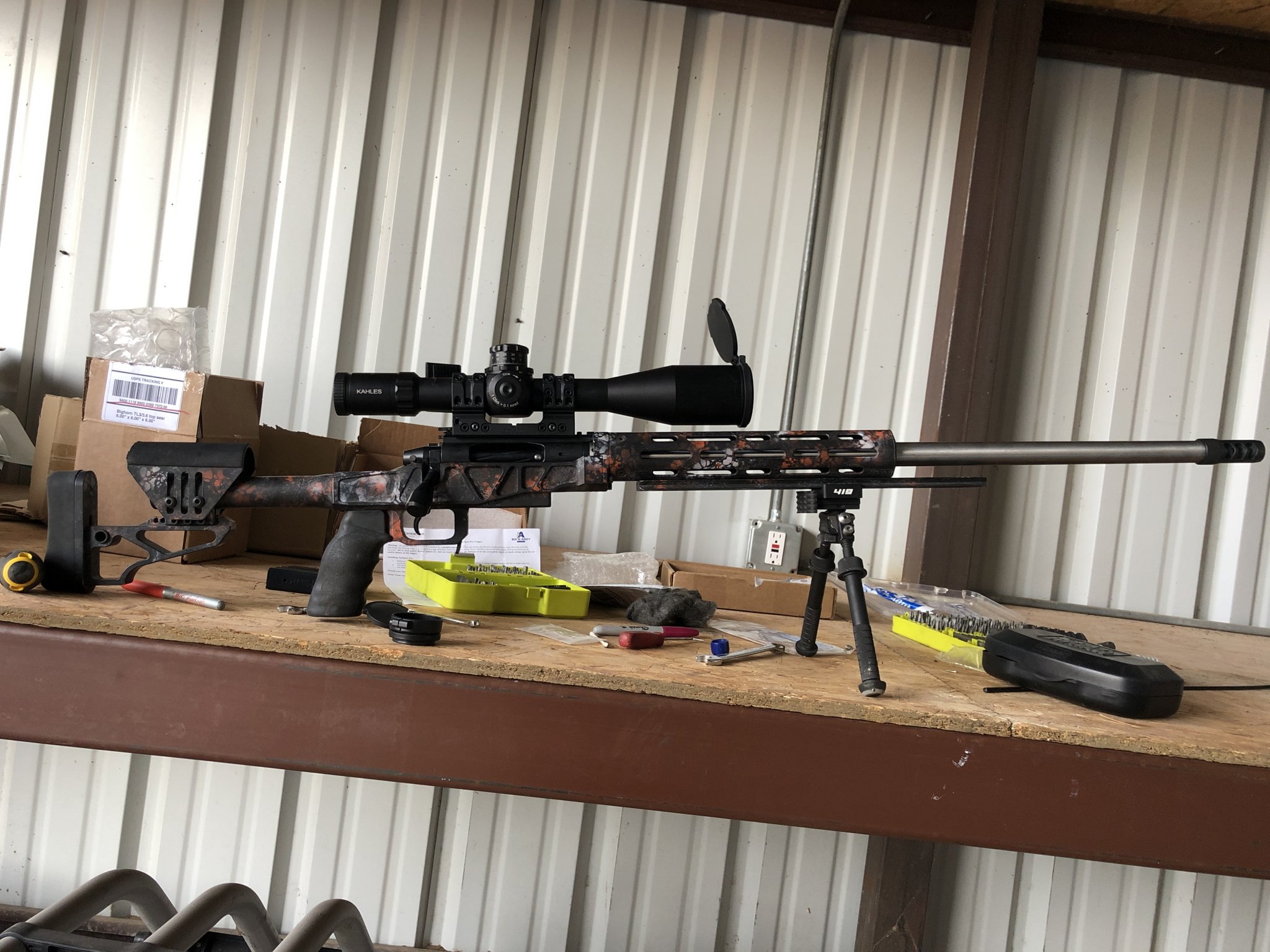

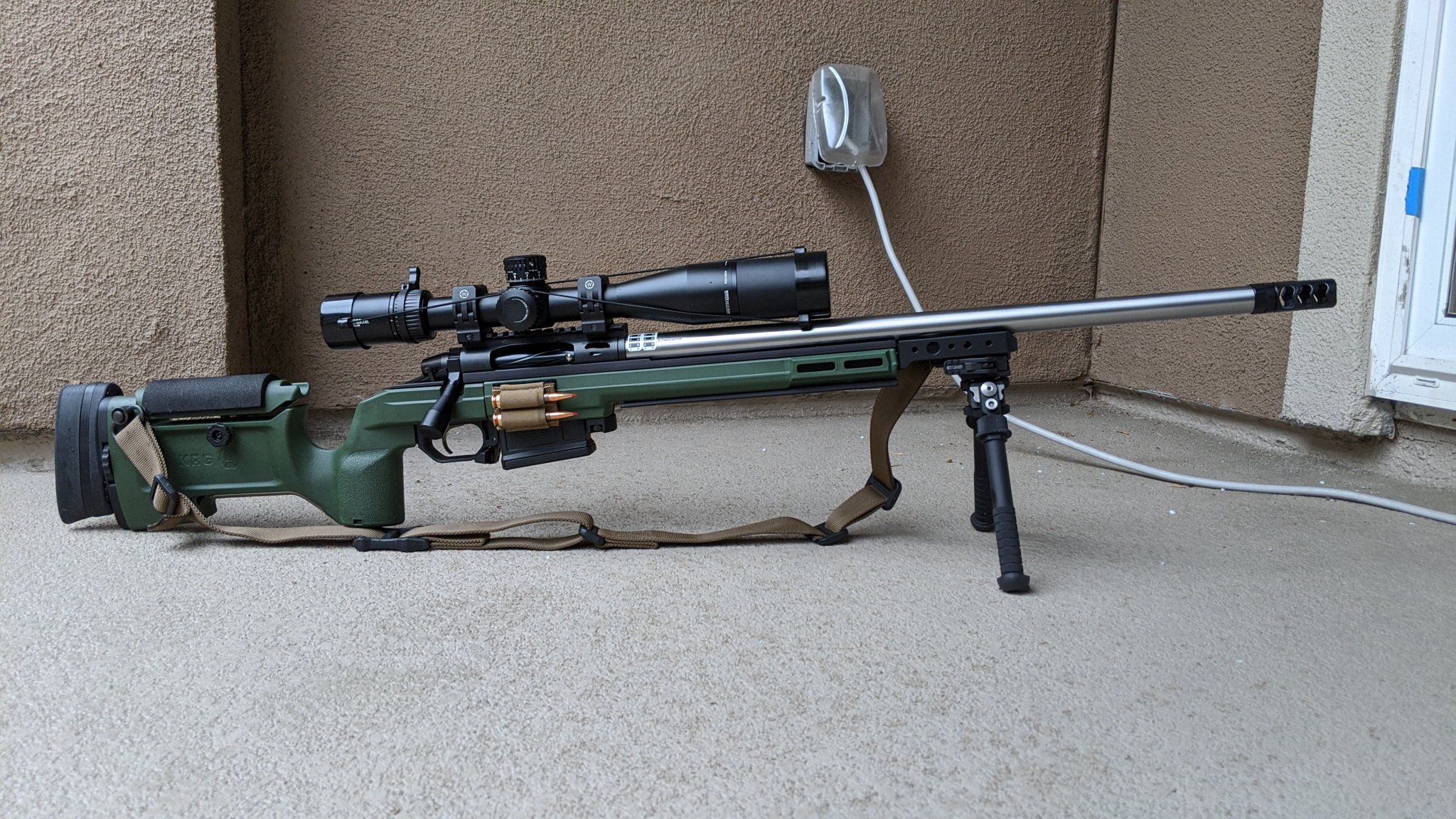

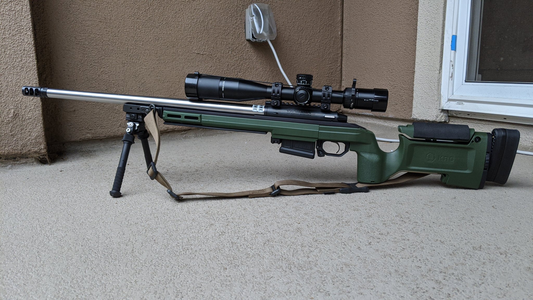

Just finished the wife’s build... well kinda still needs her own scope.
BH Origin
X-caliber 6 br savage prefit
BH 12 point nut
Cadex 2 stage
Hell fire brake
Xlr carbon chassis I picked up in the Px

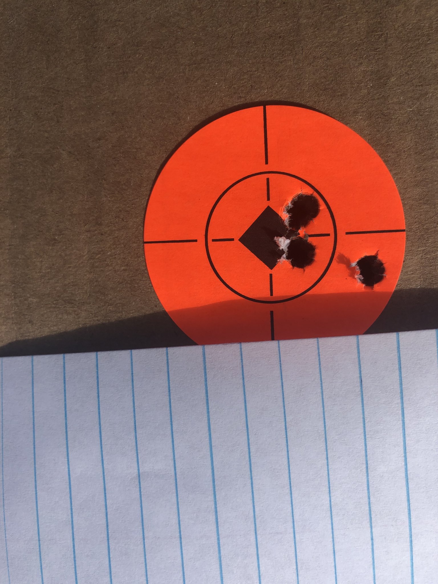

The last target pic is 7 shots, the first 3 out then a scope adjustment then the next 4 in a ragged hole. All shot by my wife. Pretty proud and really happy with the x-caliber’s accuracy for the first 15 rounds and just a random load of 30 Gns of varget and 105’s just off the lands with virgin lapua brass.

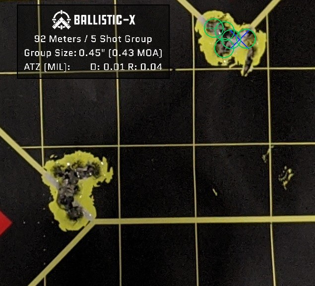

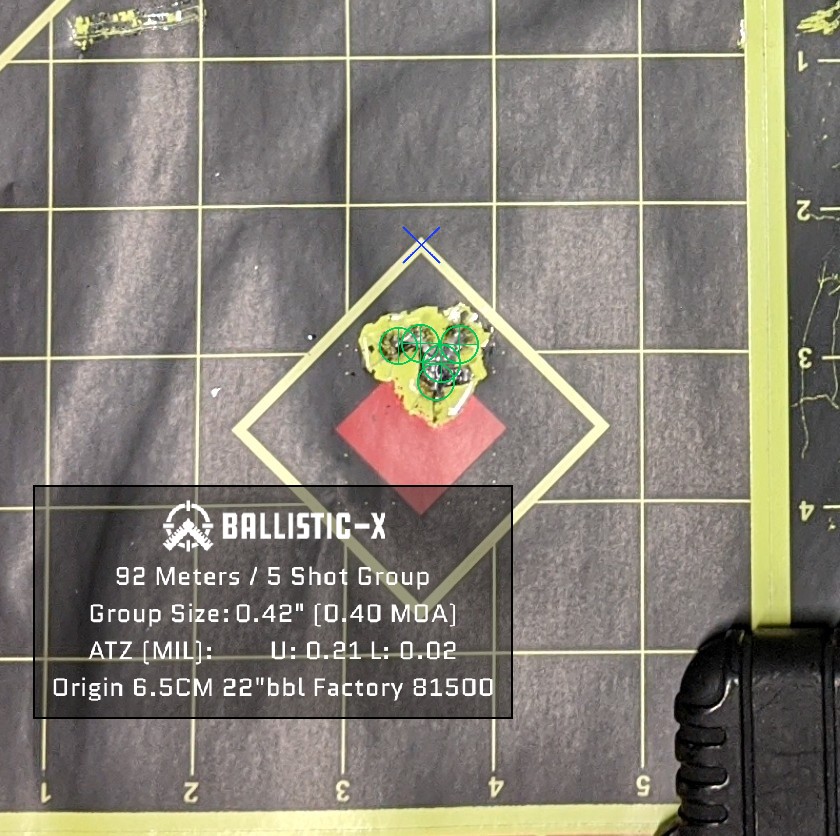

Thanks @kriller134 ! nothing special...this was a budget build. Including optics (no bipod) total build was roughly $3200.
Origin SA 308 bolt
20moa rail
TT Diamond
Vortex PST Gen2 3-15x44mm
ARC X-Low rings (0.79" - Love the low look and looks like i have about ~2.5mm-3mm of bell clearance)
M24 22" bbl
KRG Bravo with some goodies. ARCA rail, spigot, adjustable butt stock, barrier stop.
Cheek piece - neoprene 1/4" from Amazon, this was sold in 12"x12" - 4 pieces. I'm still using the 1st piece.

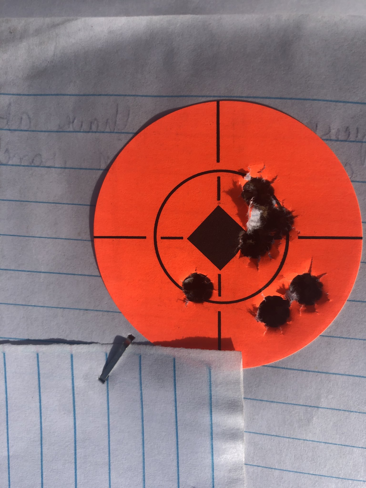

Total 120 factory rounds 140eldm 81500 shot 1st time out.
