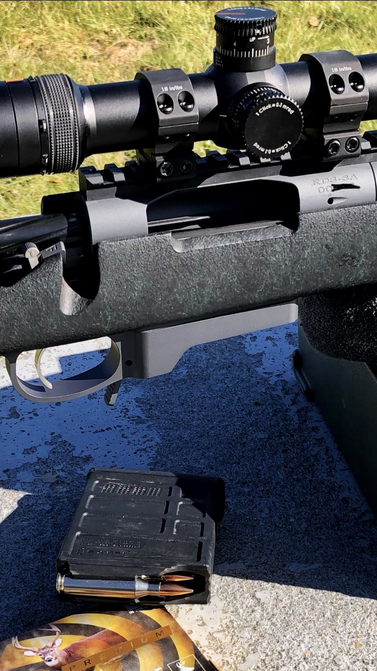

.300win for the time being. Also have a 7 Saum barrel for it but don’t really have the time so I put it in the PX. I’ve had this one built since Bighorn released them and haven’t taken it out.
Compared to a Stiller Tac300 I used to have, I like the Origin LA more. I also had a Surgeon 1086 LA for a bit, and while bolt lift/ close was better I feel like the BH offers more. I have a SA Origin also (that’s now boxed up for a temporary storage) and this long action feels a lot better. I timed my short action to a TT Diamond and this long action has had nothing done to it but a few cycles and operation feels smoother.

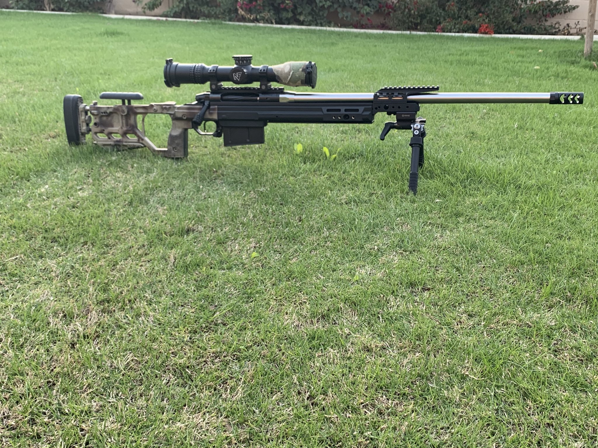

I have the Origin LA Mag. Built a 6.5PRC off of it. I wanted the longer action length so as not to be hampered by COAL down the road - if needed, and given previous experience with the 6.5-284. That said, if I had to do it all over again (6.5PRC), I'd go SA with a Wyatt's cut. I'd also opt for the SR3 or a Defiance Hunter, again with the Wyatt's cut. The loading/ejection port on the Origin, IMHO, creates a loading 'challenge' when used with BDL-type bottom metal. Again, JMHO. The SR3, and certainly the Defiance Hunter, have a much more open ejection/loading port and thus afford more access for top loading. If you chose to use M5 DBM, the point is mute.

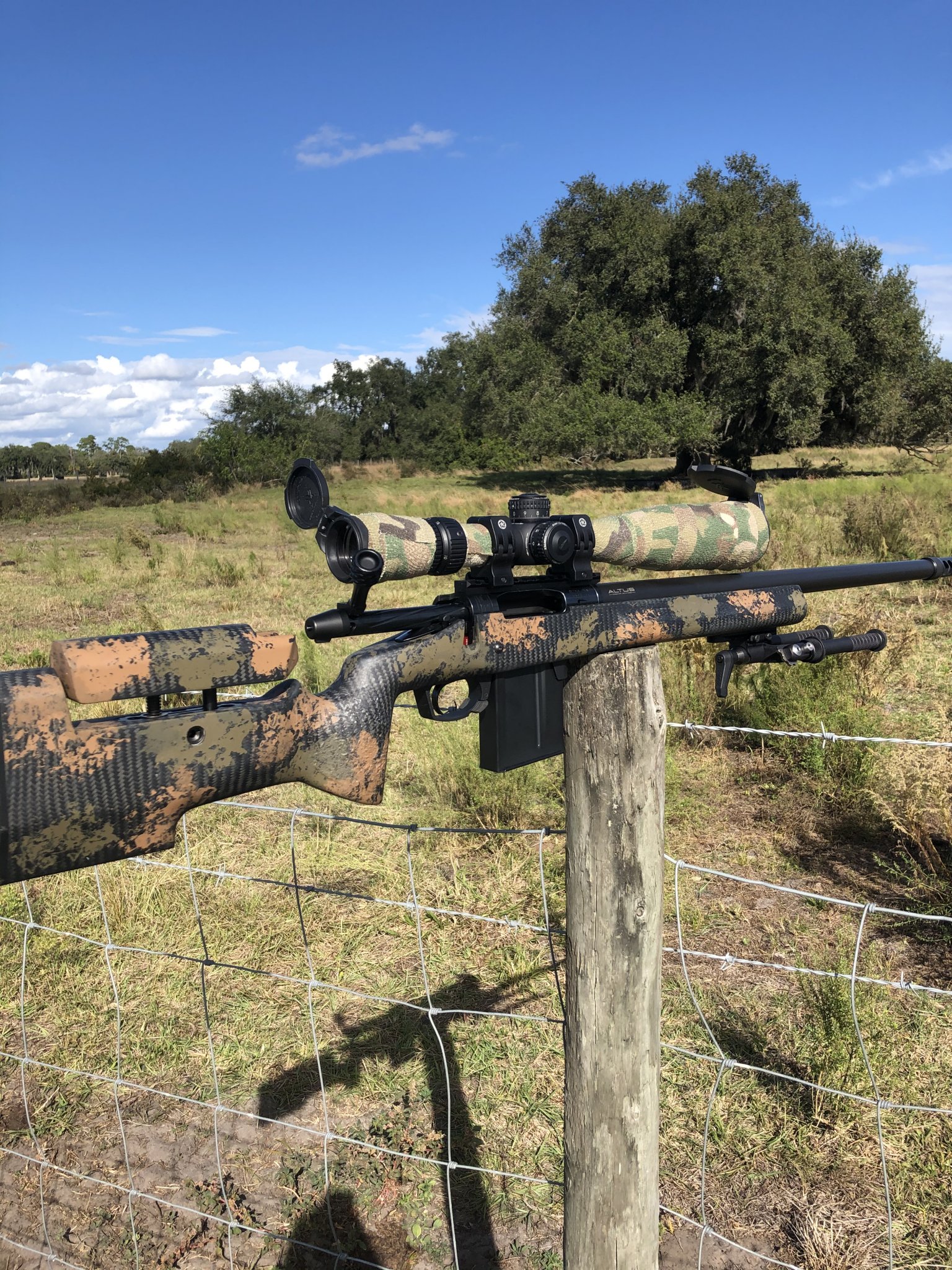

This is what an Origin looks like in an HS Precision. Although I’ve not had any issues with ejection with the .243...
Not a magnum per se. 6.5PRC on an Origin LA mag.
And to clarify, if I ejected the fired round slowly, it would 'hang' on the 'extra' material of the stock (true Rem 700 inlet). If I ejected the fired round rapidly, it ejected fine. I took the time and put the stock in my vertical mill and milled out the excess material. No big deal.
That's more than likely why you ran into the issue while those shooting standard cartridges didn't. The .545" diameter case just needs more clearance than a .474" diameter case would.

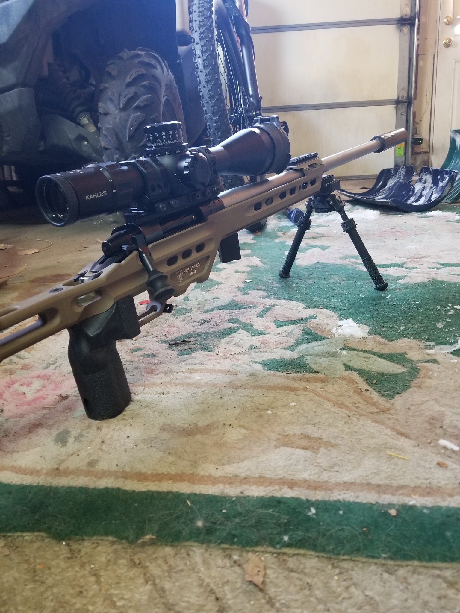

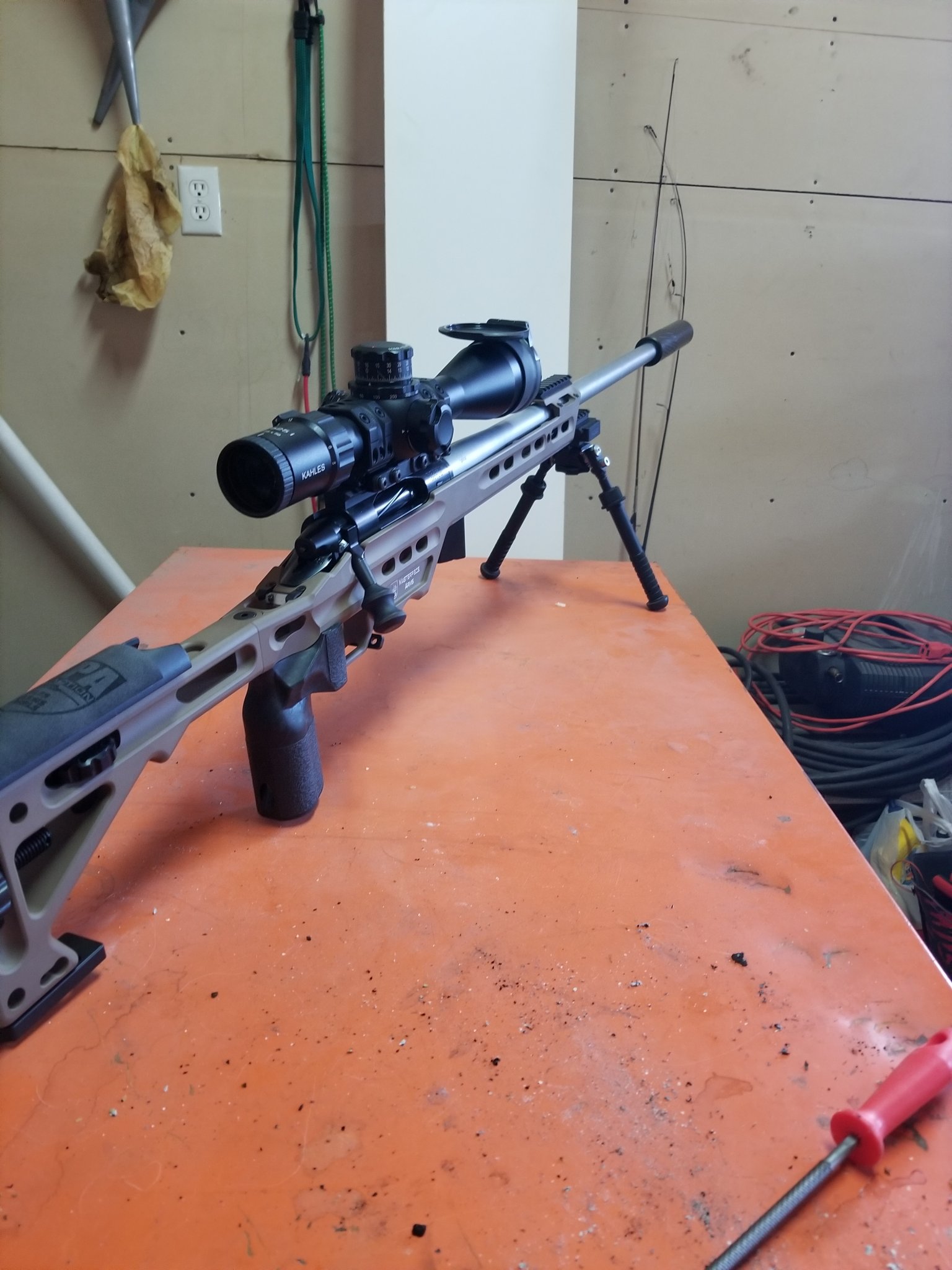

Big horn orgin s/a
6.5 creedmoor built by fritz at mile high shooting accessories
Trigger tech special
Bartlein 26" 5r heavy palma
Area 419 bolt knob
Mpa competition chassis fde
Thunderbeast ultra 7
Kahles k525i skmr3
Spuhr sp4001 mount
Atlas prs with area 419 arca adapter
