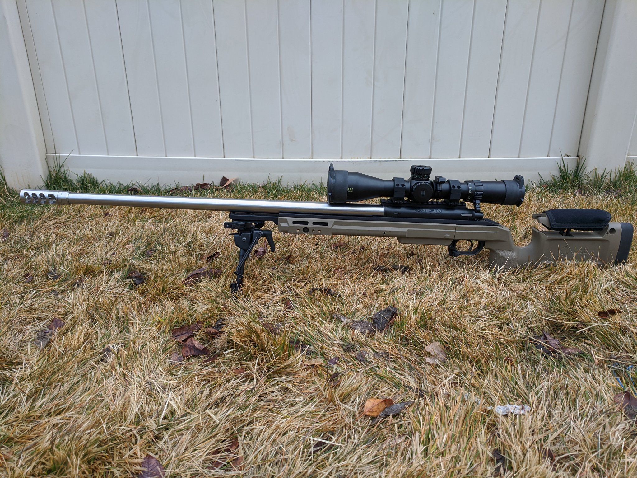

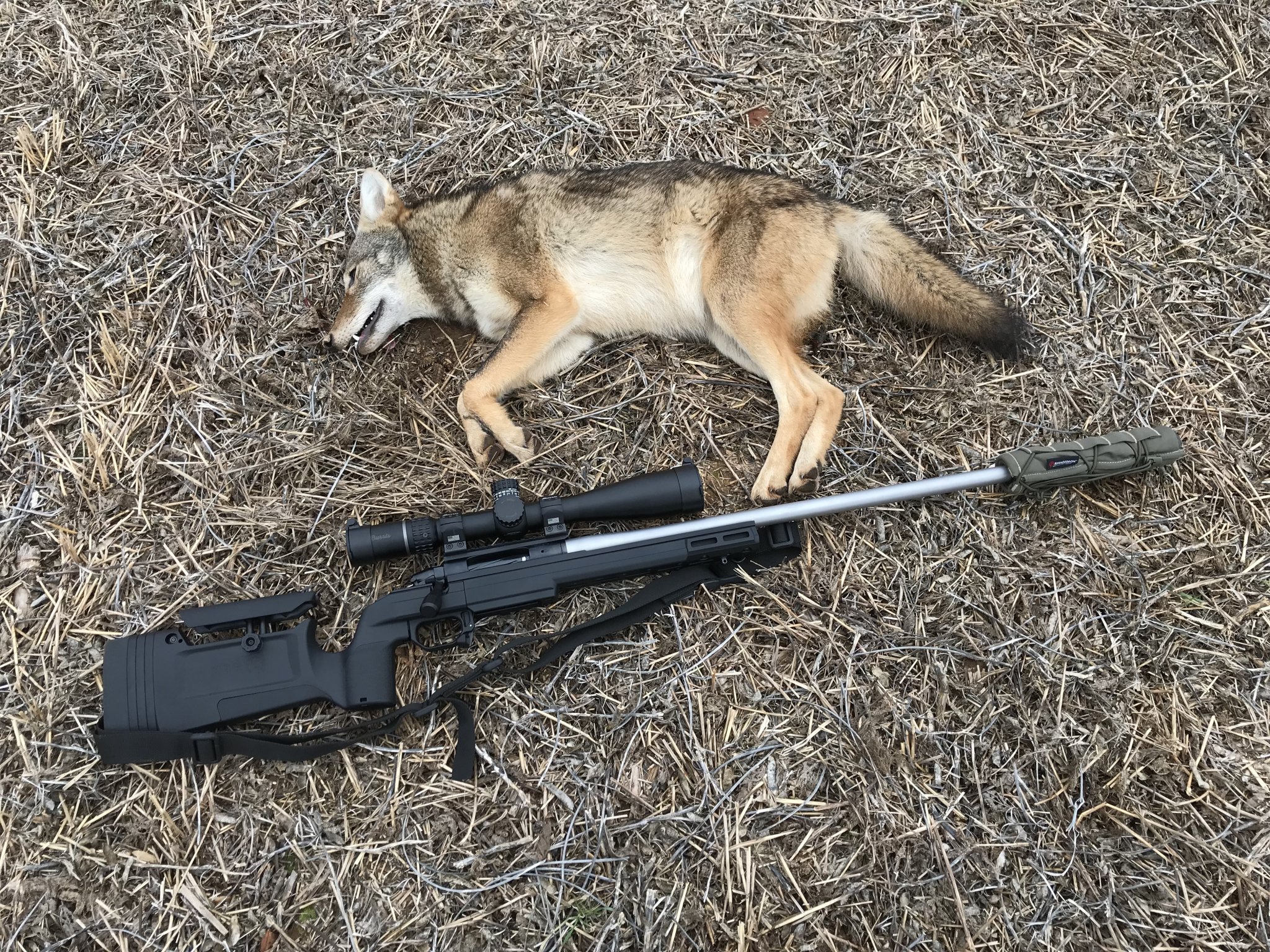

Finally got my Triggertech, so have a complete rifle. This is my budget Origin build.
Origin SA 6.5CM
Bartlein HP @26"
KRG Bravo
SWFA 10X Superchicken
Triggertech LE Special
Hope to have some range time over the Holidays,
Slainte,
TM6

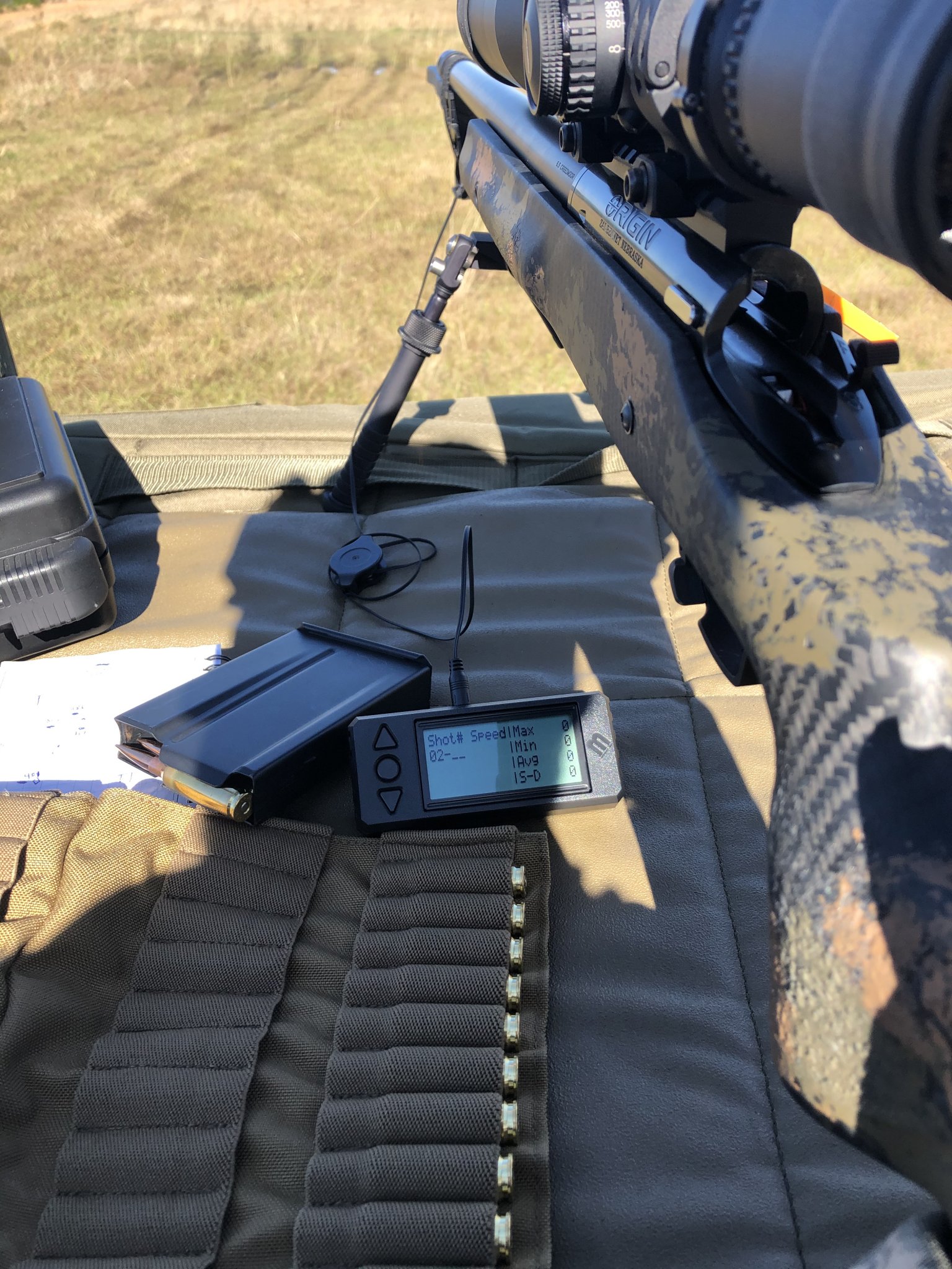

Not a magnum per se. 6.5PRC on an Origin LA mag.
And to clarify, if I ejected the fired round slowly, it would 'hang' on the 'extra' material of the stock (true Rem 700 inlet). If I ejected the fired round rapidly, it ejected fine. I took the time and put the stock in my vertical mill and milled out the excess material. No big deal.

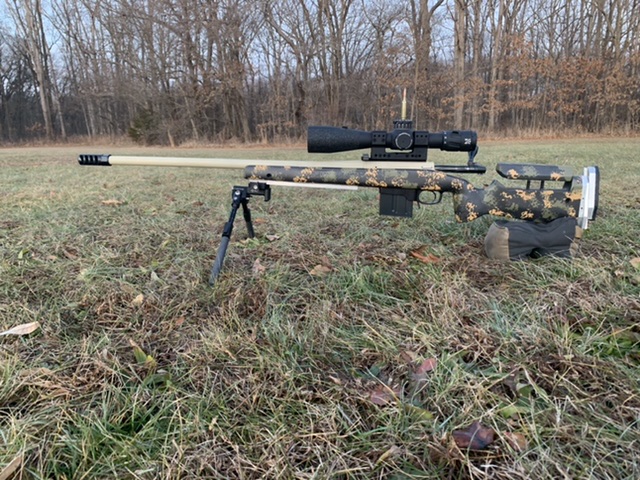

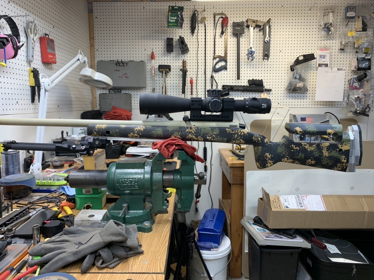

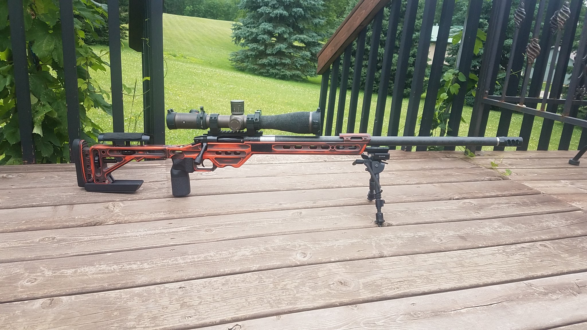

Origin S/A
TT Diamond
Bartlein 26” 1:8 Sendero contour Shouldered (6.5CM-saami spec’d reamer)
MPA brake
CF wrapped stock-modified with Arca rail and adjustable butt plate by Aces and Eights Firearms
MDT Clye-Pod (long legs)
Spuhr
Zero Compromise 527
PTG bottom metal
Benelli Desert Sand Cerakote
15.2lbs with empty metal MDT AICS metal mag.
Also have a Proof CF barrel spun up in 6.5PRC for next years elk hunt.
All work done by Aces and Eights Firearms.
(Sorry for the shitty pic. This was taken at 12:45am after I finished mounting the scope. I’ll edit with better pics soon)
Edit: New pics added

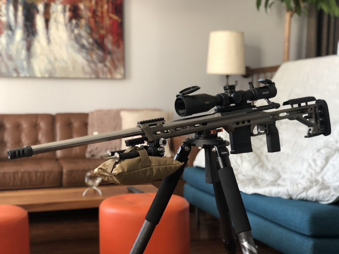

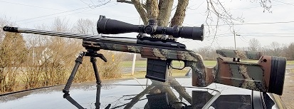

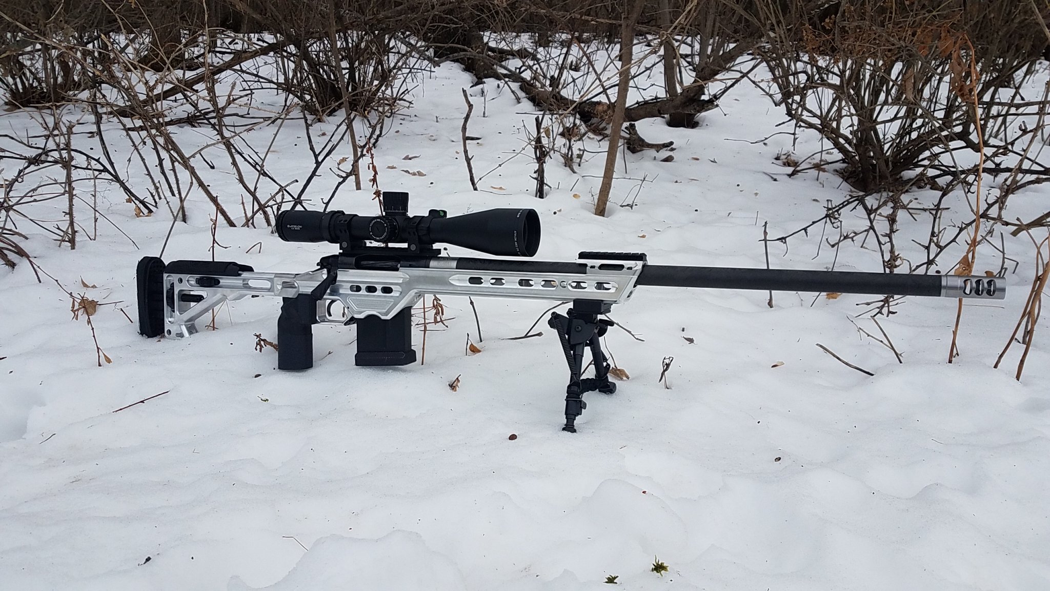

Should have posted this a long time ago, but here's mine:
Bighorn Origin
MDT ACC
Vortex Razor HD Gen II
Seekins Precision rings
TriggerTech Diamond
Proof barrel from Straight Jacket Armory in 6.5 Creedmoor
Silencer Co Saker
Ckye Pod
Cheapskate Precision bag rider and 2-round quiver.
I also have a 2nd Origin now in a KRG Bravo for my 223 and for my future carbon fiber barrel for hunting season.

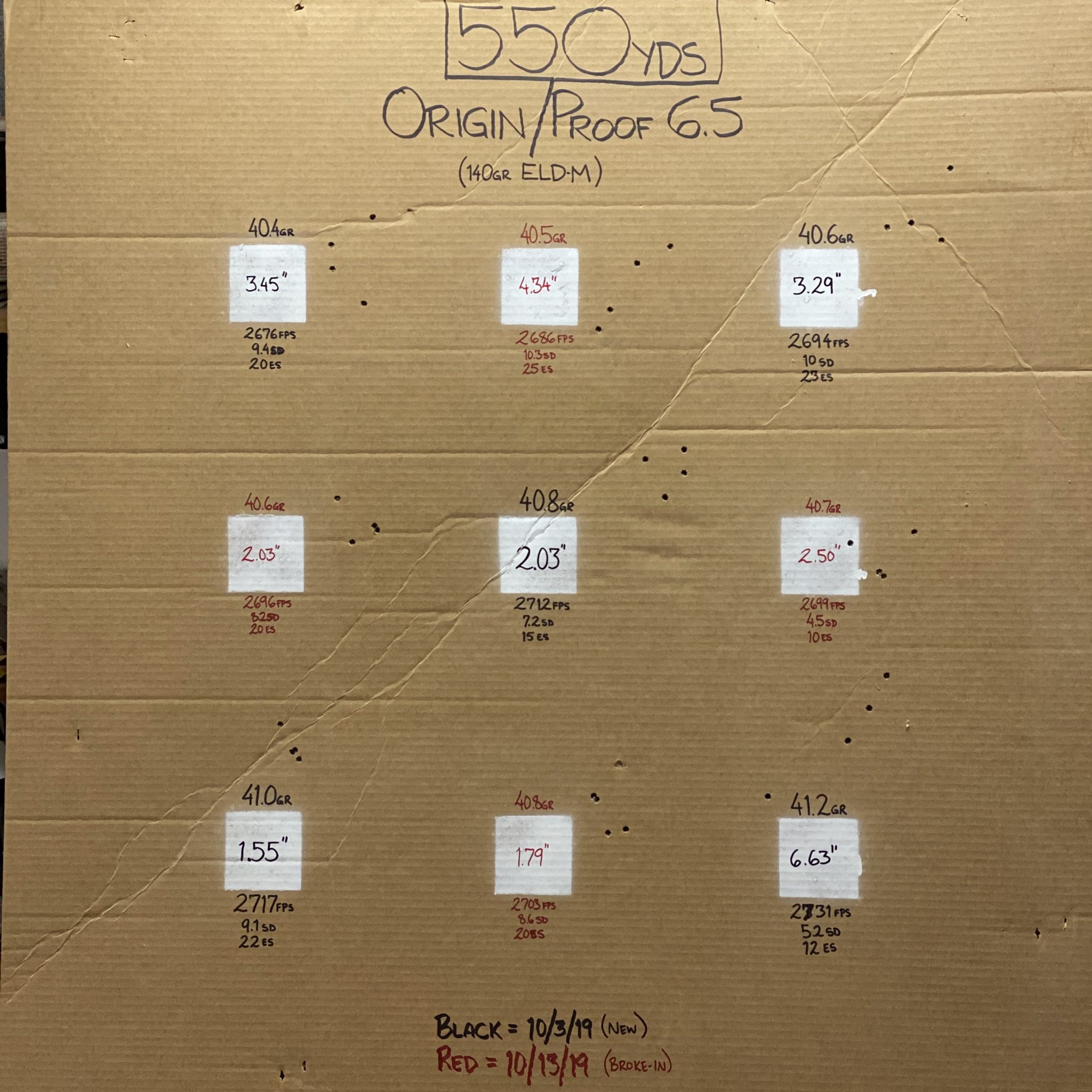

Here's a picture from my initial load development tests at 550 yards:
8/9 under 1 MOA
5/9 under 1/2 MOA
This thing can shoot

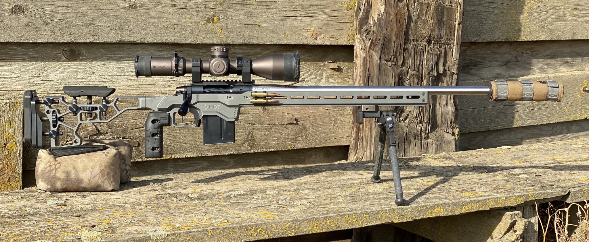

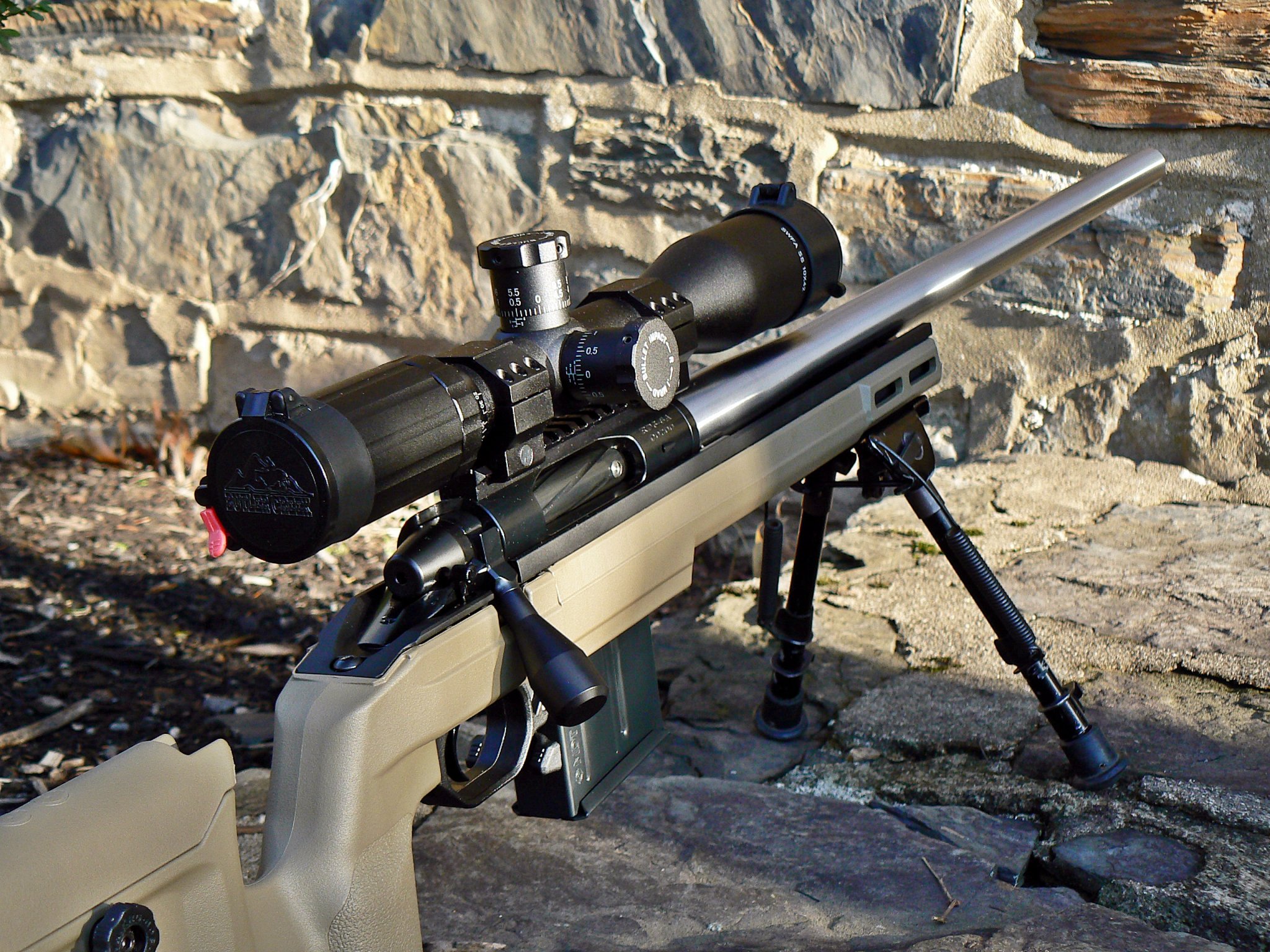

Just received my origin sa.
Just waiting on the triggertech special
Jcs composites adjustable tactical
Straight jacket armory prefit 6.5x47L 24" medium palma
Seekins rings
Area419 hellfire
Running a athlon midas tac 6-24x50 mil/mil

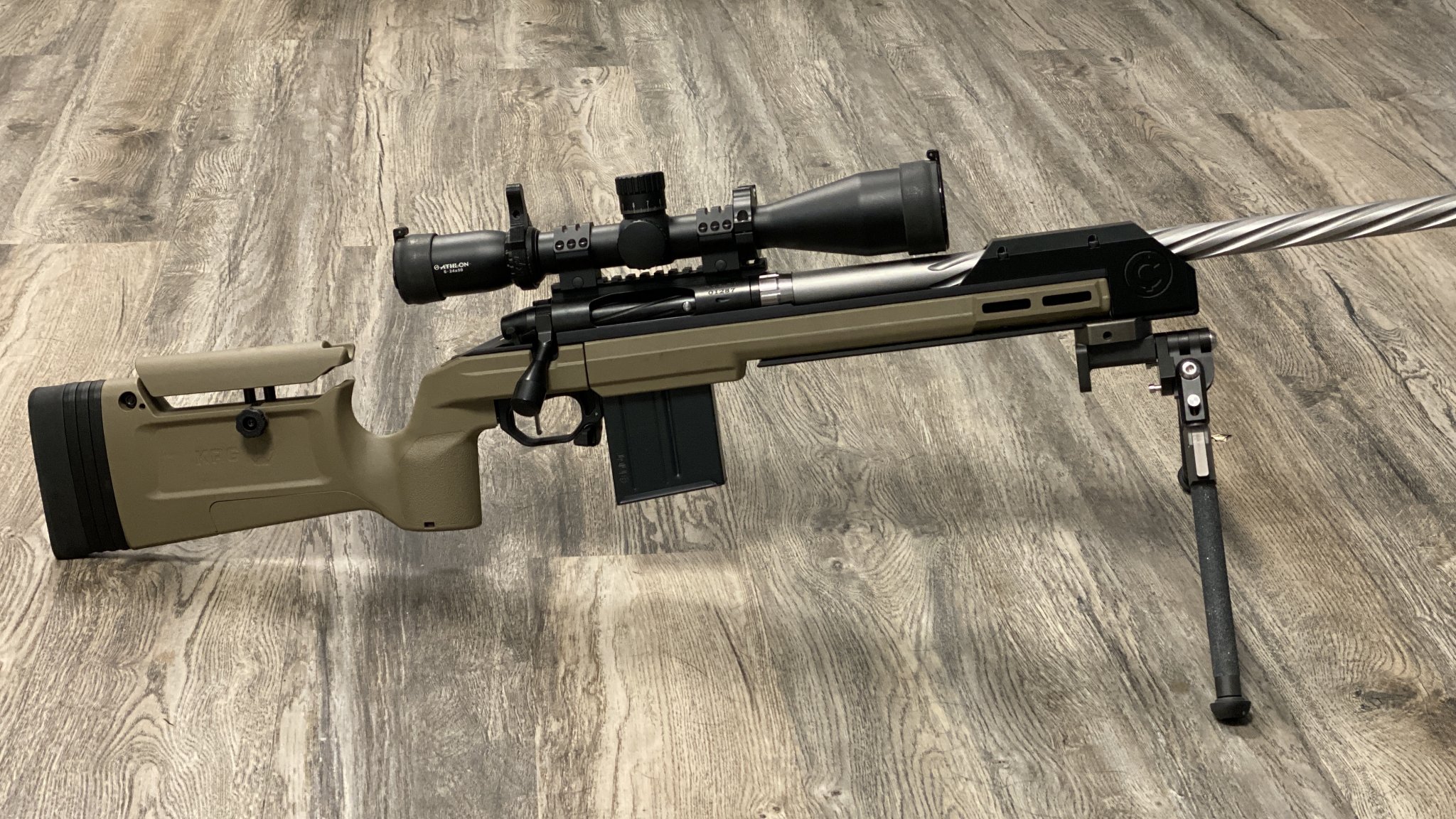

Tagging in, I have an origin ordered and a carbon 6 barrel prefit (300 PRC) on order. This will be my first ever custom bolt action. The waiting game is horrible.
I'm at 12 weeks on my barrel. Ordered it at the same time as the action, which only took a week. Fair to say, the Origin has been cycled a few times and is broken in well.

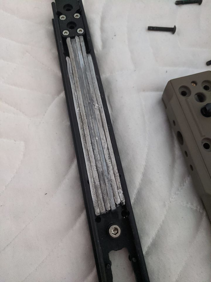

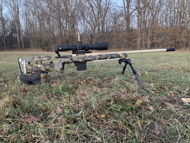

Finally have my 300 PRC build complete. I'll let you guess what the hold up was. ;) All told, comes in at 21 lbs. Added some lead to the Bravo.
Bighorn Origin
26” PVA M24 barrel w/PVA Shockwave brake (300 PRC)
KRG Bravo Chassis
Triggertech Diamond Trigger
Bushnell XRS II

Where did you hide the lead
Lead shot in the grip cavity, butt stock cavity, and behind the recoil pad (about 4 lbs). Lead decoy weights on the bottom part of the foreend. About 6 lbs total for around $38 and it's easily removable. I had to modify the decoy weights a little from what the picture shows so the action would seat properly, but it will give you an idea.
