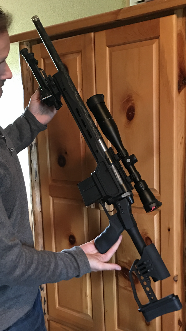

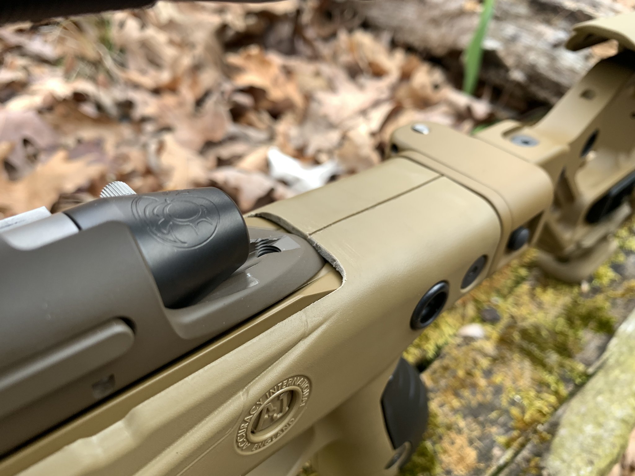

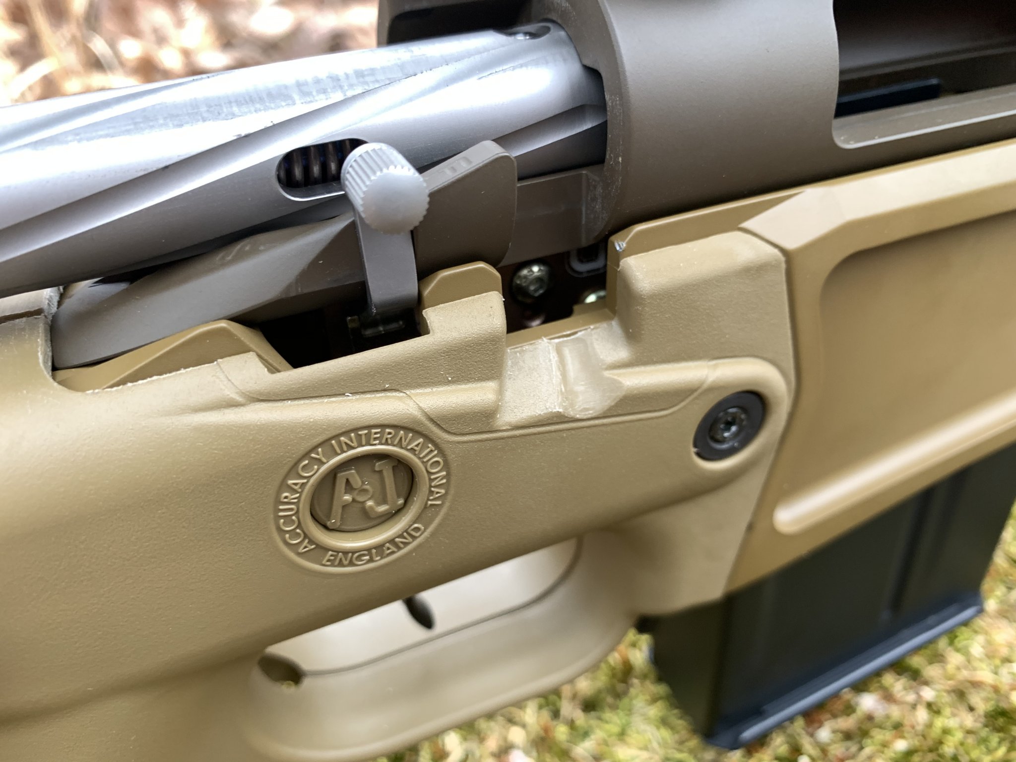

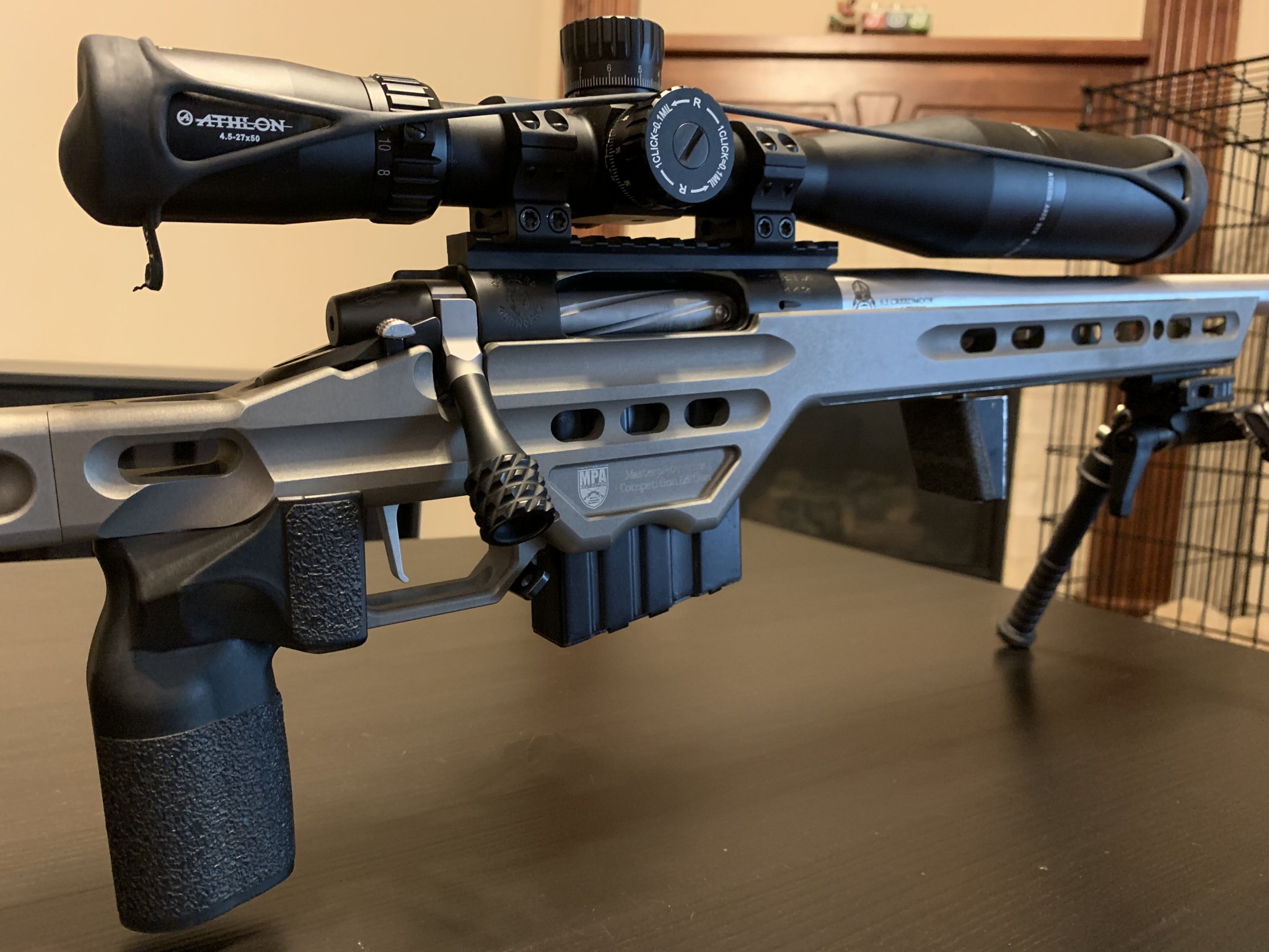

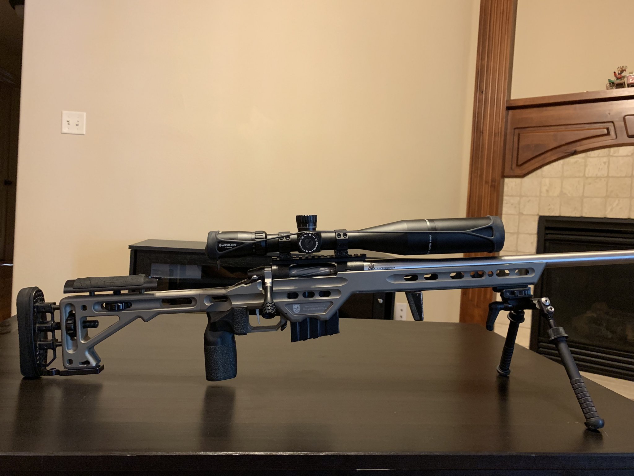

Yes I do. No, it requires relief at the tang and bolt handle on the skins.
Relieved with a rotary tool and sanding drums carefully until a piece of paper won’t get stuck at any point from bolt body down, like relieving a barrel channel that’s contacting. Take down the high spots until they’re not there.
I don’t have a milling machine so I used files and the same rotary tool to relieve the skins where the tang is too long.
Clears bolt handle nicely when folded.
I love the combo. This chassis was purchased from Mile High back in March. Recoil lug clearance was checked and is sufficiently deep and makes 100% contact across the TL3’s lug. Great shooting gun.
Thank you!
If the aesthetics are something you're concerned about, you can polish the nitrided bolt body and it will be just fine.
@b6graham just helped to make my mind up. The black on black is every bit if not more so attractive. I was just getting ready to preorder but am hung up on tang. I imagine medium as most I see are such.

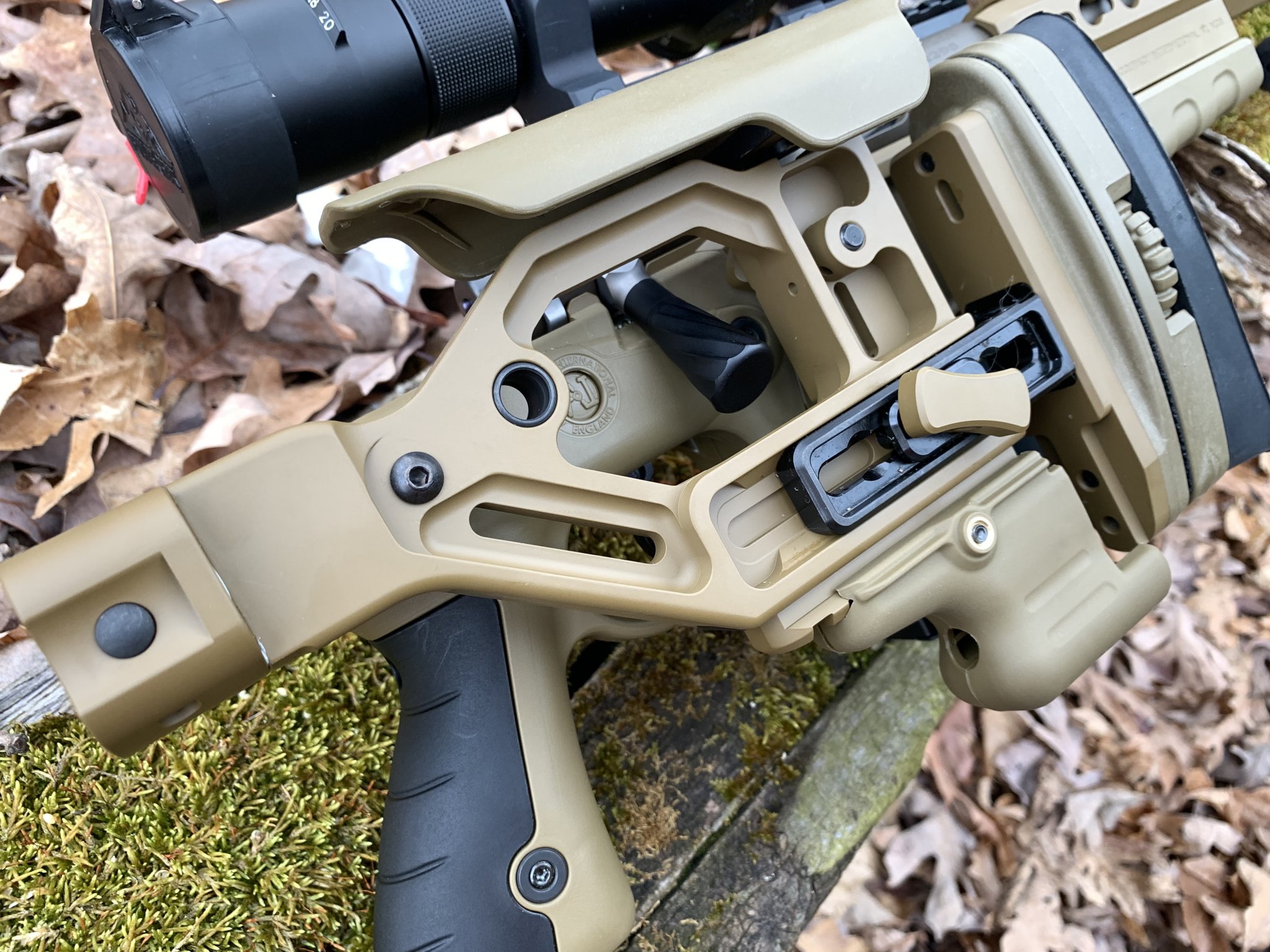

I have another AX chassis / TL3 question: My chassis arrived this week and it came with a taller scope rail to clear the full length Picatinney rail running down the top of the fore-end. However, the holes in this taller rail do NOT line up with the holes in the Bighorn.
I can't use this rail now. If I stick with the standard scope rail from BH, and remove the full length Picatinney section from the chassis, my scope still makes contact with the barrel shroud.
I either need a taller scope rail, or remove the full length Picatinney section and go without, but with taller rings.
**Does anyone make a TL3 compatible tall scope rail that will work with the AX chassis forend rail?
I’m so happy I’m not the only one who’s attempting this. You will need a custom rail. Talk to Short Action Customs. Mark said he can do a rail that will give you a continuous one. Either one or two piece.

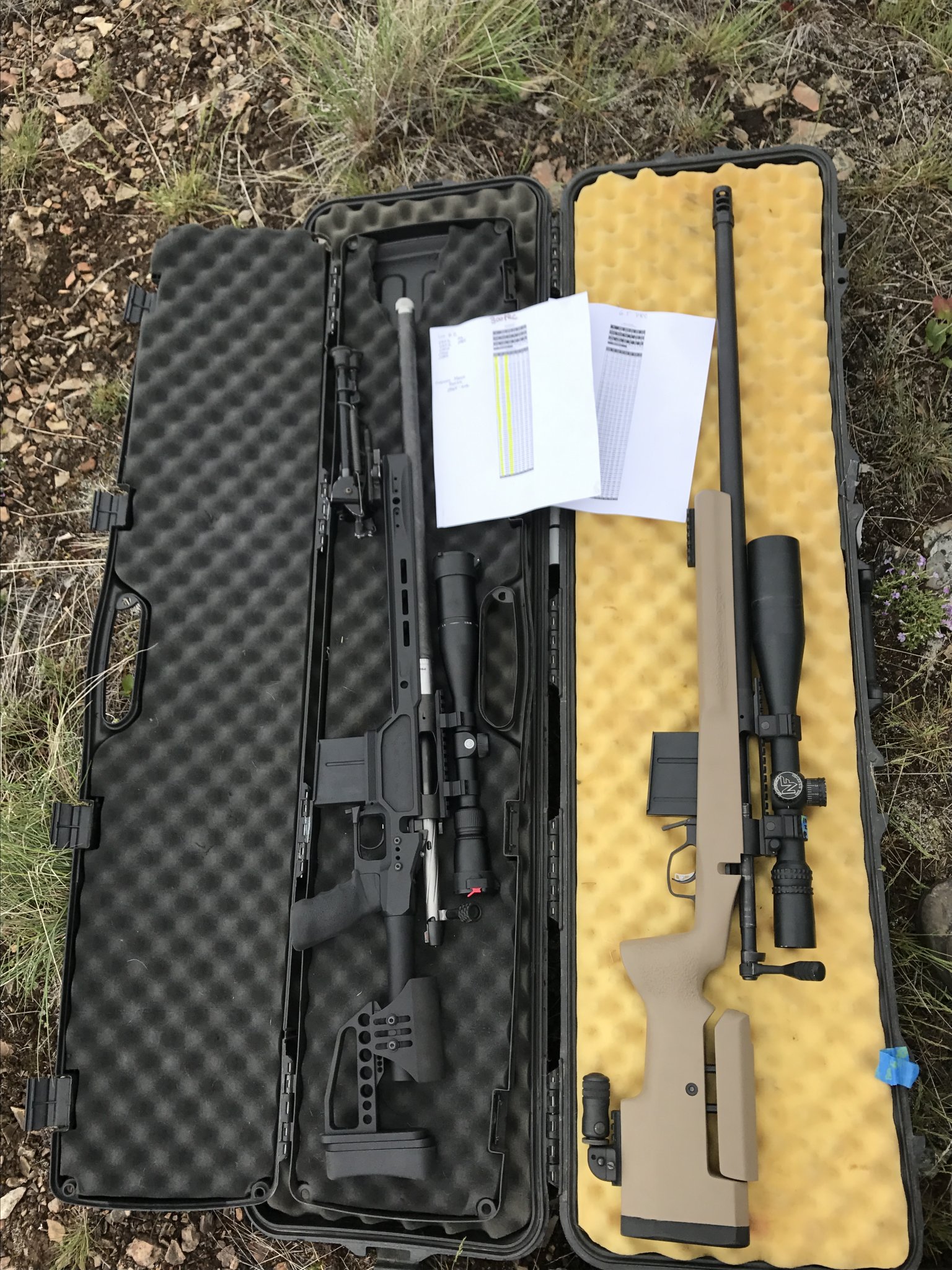

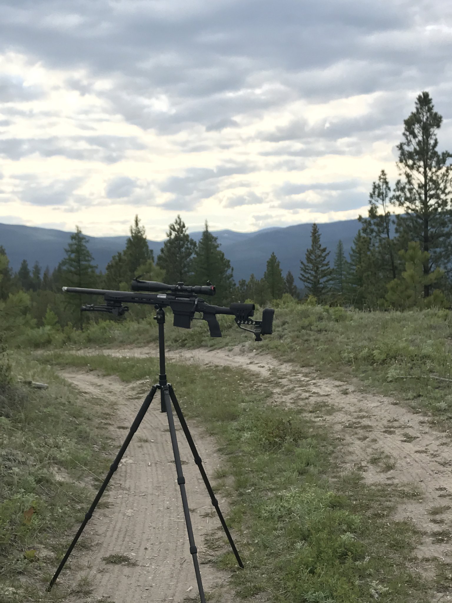

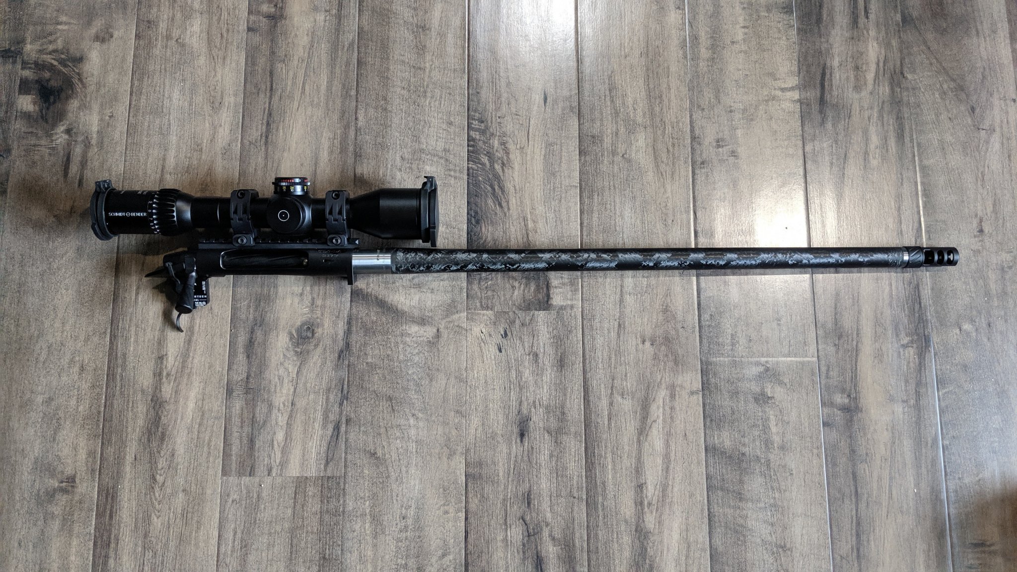

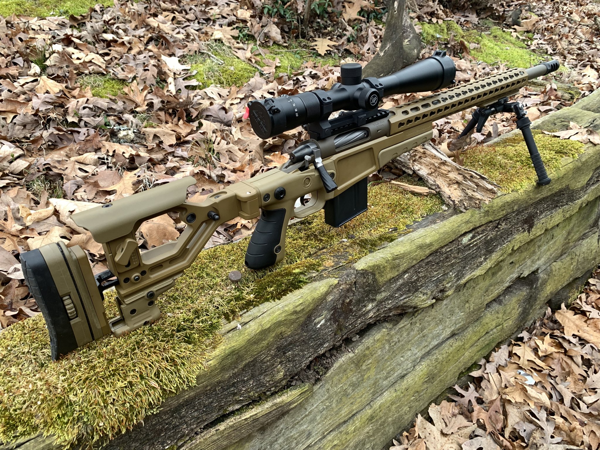

Finished my TL-3 6.5prc a few weeks ago. It's going to be a dual purpose rifle for precision and hunting. It's in a XLR Envy chassis, 22"sendero-Proof barrel, trigger-tech. My plan is to put this barreled action into a manners MC-5 for hunting and switch the barrel and stock for the rest of the year for precision shooting. Still trying to decide on glass?

Looks like a good deal. Been leaning toward 3-18 mark 5 ? Trying to keep it light as possible for hunting.
I’d put a very strong vote in for the Vortex Razor AMG. Very very good dual purpose optic and comes in at 28oz. Granted the 6-24x might not be ideal for short range hunting scenarios. But it’s just as good in the field as it is shooting a PRS match. It does both equally well.
