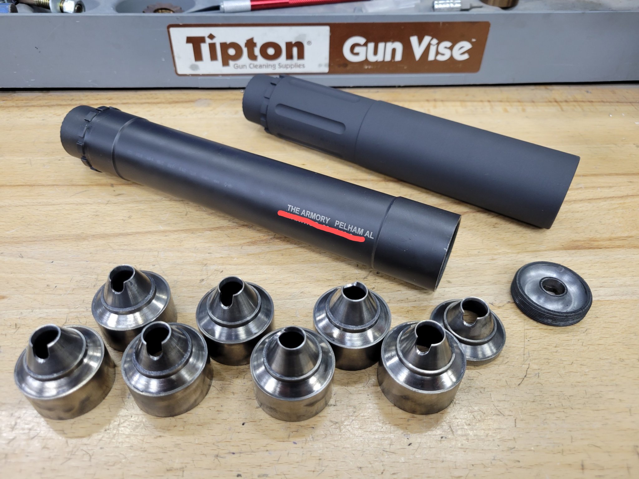

Just got 2 cans back from Ecco. Very nice work and the whole process was great. I'd have em do what they did on one of mine and put a bravo thread on the back so you can run whatever mount you want to. They also took a Ti form 1 can I had that was "modular" and put a new baffle stack of their own on it. Tubeless and it's nice! Excellent work and I think from the time I sent it until I got it back was like 2 weeks total. Definitely who I'd email.
(PS: email is the way to go to get initial info but even that isn't fool proof, probably because of the amount of volume they get)
The best thing to do is email jerrica and tell her you want to send them a can to work on and get her to send you the instructions. Then write in detail what you want done and Nick will then call you and go over it if there's any questions. Nick is a cool guy and was very easy to deal with, and he is actually in the shop so he knows exactly what he's talking about.

nick is the one that responded by email friday. this was his recommendation:
“We can upgrade your Evo to a booster that uses SilencerCO/Rugged pattern pistons and 1.125-28 Alpha threaded mounts & adapters.”
guessing that will screw into the back of the evo and replace the aac cap and piston? i didnt email back until yesterday.
this is the evo9-cqc can and about an inch shorted than the evo9 so i hope it doesnt add to much length. i love this little one. it is louder than the big brother but not by much.
