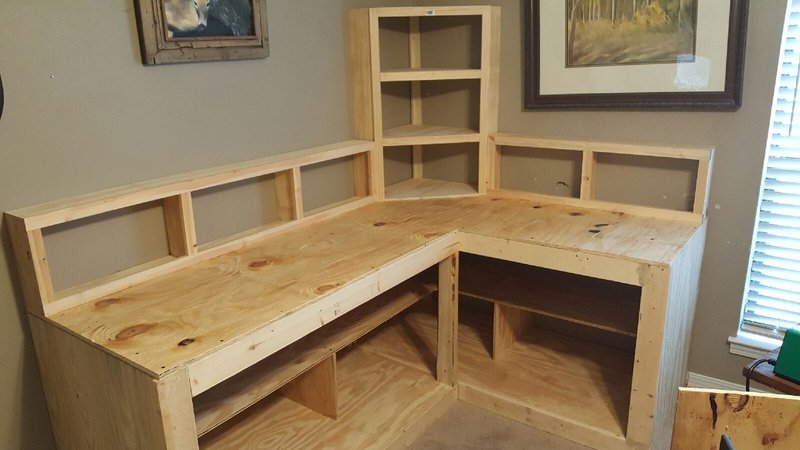

    Ok so here's images of the 4th bench I built over the past month for a dedicated gunsmith bench. Its built the same way as the bench you are asking about GreenBlood10 but I took the recommendation of another forum member and went a different route for the top to test out. Instead of sandwhiching 3/4" Oak and 3/4" MDF to make a solid top, I bought a solid core door which is 1.75" thick and heavy as fuck. The solid core 32" wide door from Lowes was $62 vs about $140 for 4x8 sheets of MDF and 3/4" Oak plywood. We will see over time how well the solid core door vs the oak plywood holds up. Not shown in this picture but I nailed trim boards to the edges just like my first bench and a trim board across the back that sticks up 2" to keep things from rolling off the back of the bench. Framing is mostly 2x6 with 2x4 used for the bottom shelf. Cedar posts all bolted. I secured the top to the bench by running screws through my cross supports up from the bottom into the door. Make sure to use screws that arent too long, otherwise they will pop up through your work surface.
    Once the weather brakes and I can have the windows open I will be staining and putting 5 coats of clear on it but for now I just threw some work bench top rubber matting to protect the bare wood.

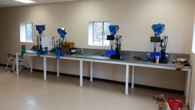

    I built a bench out of steel and bolted it to the floor, and put a stainless steel top on it. It cleans up really nice and is pretty much bomb proof. I also put together some heavy duty shelves behind where I took the picture to hold components and ammo, and built some closets to store powder and tools. I really don't like having everything "out" all the time, so I just pull out the powder, bullets, primers, etc that I need to load and put it all away when I'm done. Obviously you need a little room to do this, but it works well. I epoxy coated the floors as well, which turned out pretty good for my first try. Not a huge fan of the color after I put it down, but it sure works well.
    I think if I were to scale everything back, I'd have just a Redding T7 with two toolheads, and a couple XL650's set up for small and large primer. That's really all you need to crank out a ton of ammo... though, automated 1050's sure come in handy lol.

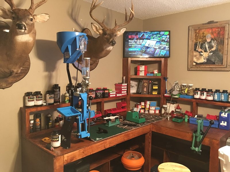

    My buddies bench he just built, I'm using him as a ginny pig. It works so well!
    My wife thinks I only have 3 guns
    how did he make that top? that's some nice jointery on the ends of boards. I am planning on doing a laminated top like that by ripping 2x6 in half, then jointing and planning to size. going to try and make it 10'x36" so I don't want it too thick as ill never be able to lift it to get it on the frame!!

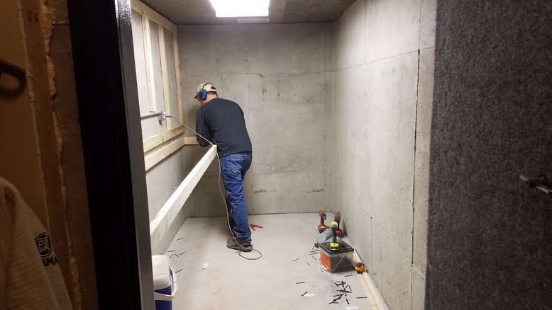

    Got the teenaged son of one of my high-school buddies to come over this morning and help with the rest of the ceiling. Got the white up in the side that will be the reloading room. Finished the green. Needless to say, the insulation is 100 percent in place. I estimated it pretty well. Out of all that insulating... I had 4 feet of 16" R19 left. Just enough to poke in around my windows and edges! WINNING!
    [IMG2=JSON]{"data-align":"none","data-size":"full","src":"https:\/\/scontent-lga3-1.xx.fbcdn.net\/v\/t31.0-8\/17038470_1094024050744241_5839841015218243665_o.jpg?oh=bd886363f59556efc5e752ed55264be4&oe=5970C395"}[/IMG2]
    Also got my track lighting in. LED. Between these and some bench lights, the room ought to be well-lit. Oh and the three giant windows!
    Starting next weekend, the Shiplap starts going up on the walls. I should get the walls on the reloading room itself done next weekend, though not the floors... Trying to decide if I want to do soft white pine on the floors... or spend some extra money and go with Southern Yellow Pine. I think the price delta is a no-brainer. Southern Yellow Pine it will be.
