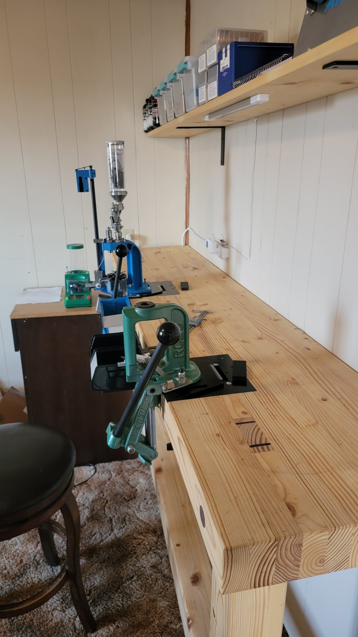

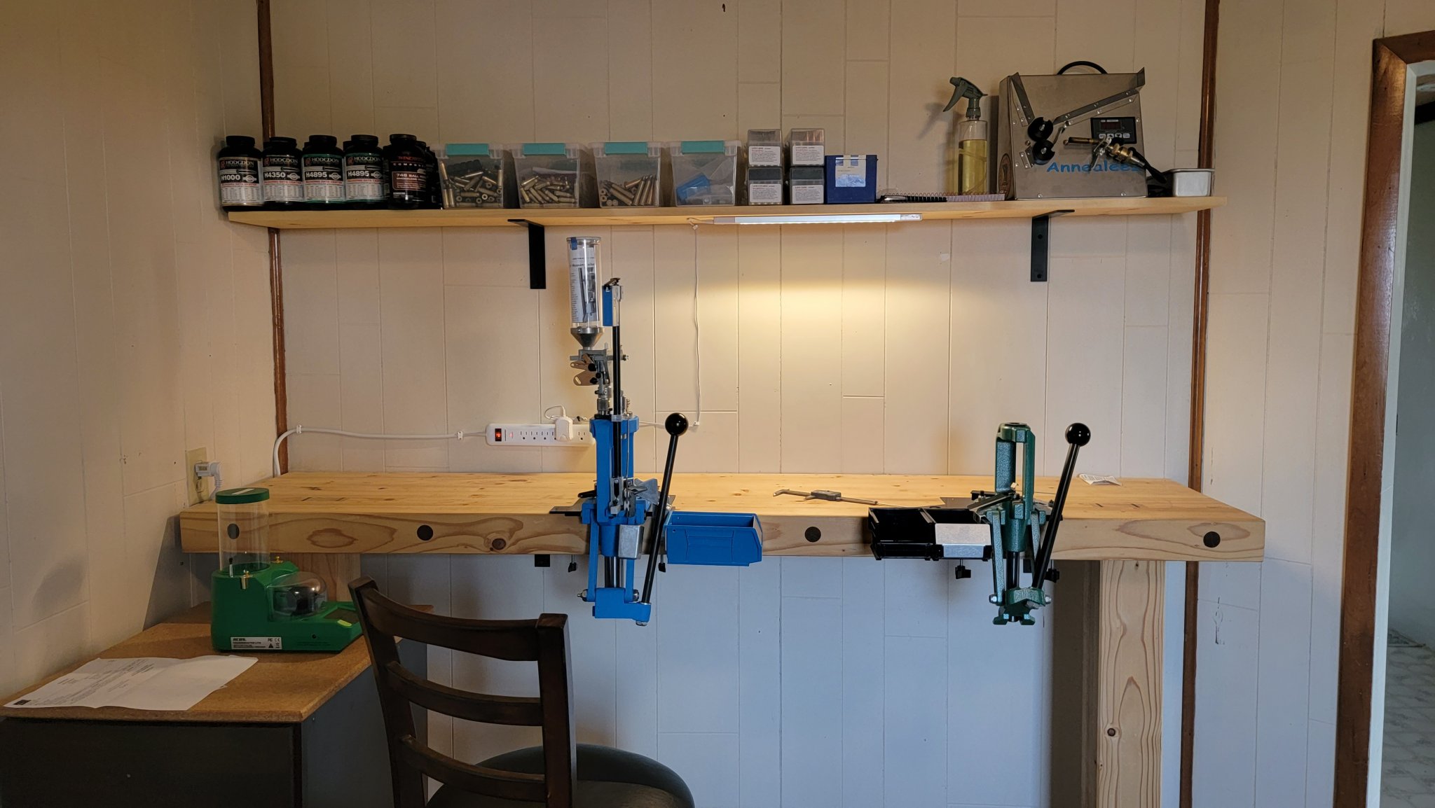

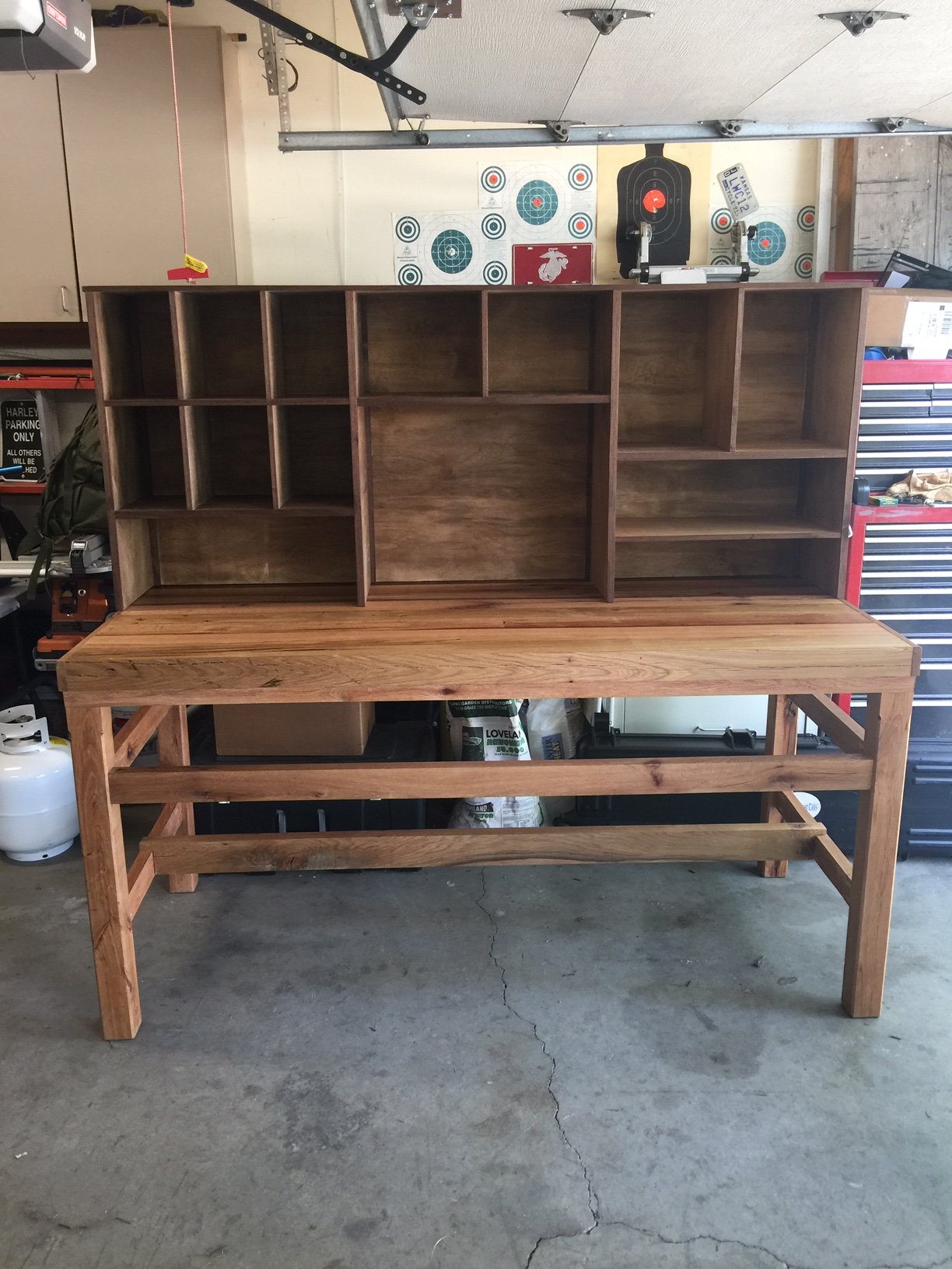

update on #695. Got the shelves built. 2x12s on 1” pipe pedestals and the back secured to each shelf. It doesn’t move.
Looks great man. I really like the look of the brackets and plan to do the same.
How do you like the solid door top? I’m debating between that and double 3/4” ply (w/ the top sheet being BC).
Reactions: BKSSNIPER
I went with the door because it was cheaper than a sheet of cabinet grade plywood at the time and my ability to cut a straight line is debatable, haha. It appears that the door has went up in price now, like everything.
Well that’s where you factor in the cost of some new tools. If you aren’t buying a new tool with each project, you’re doing it wrong. 😂

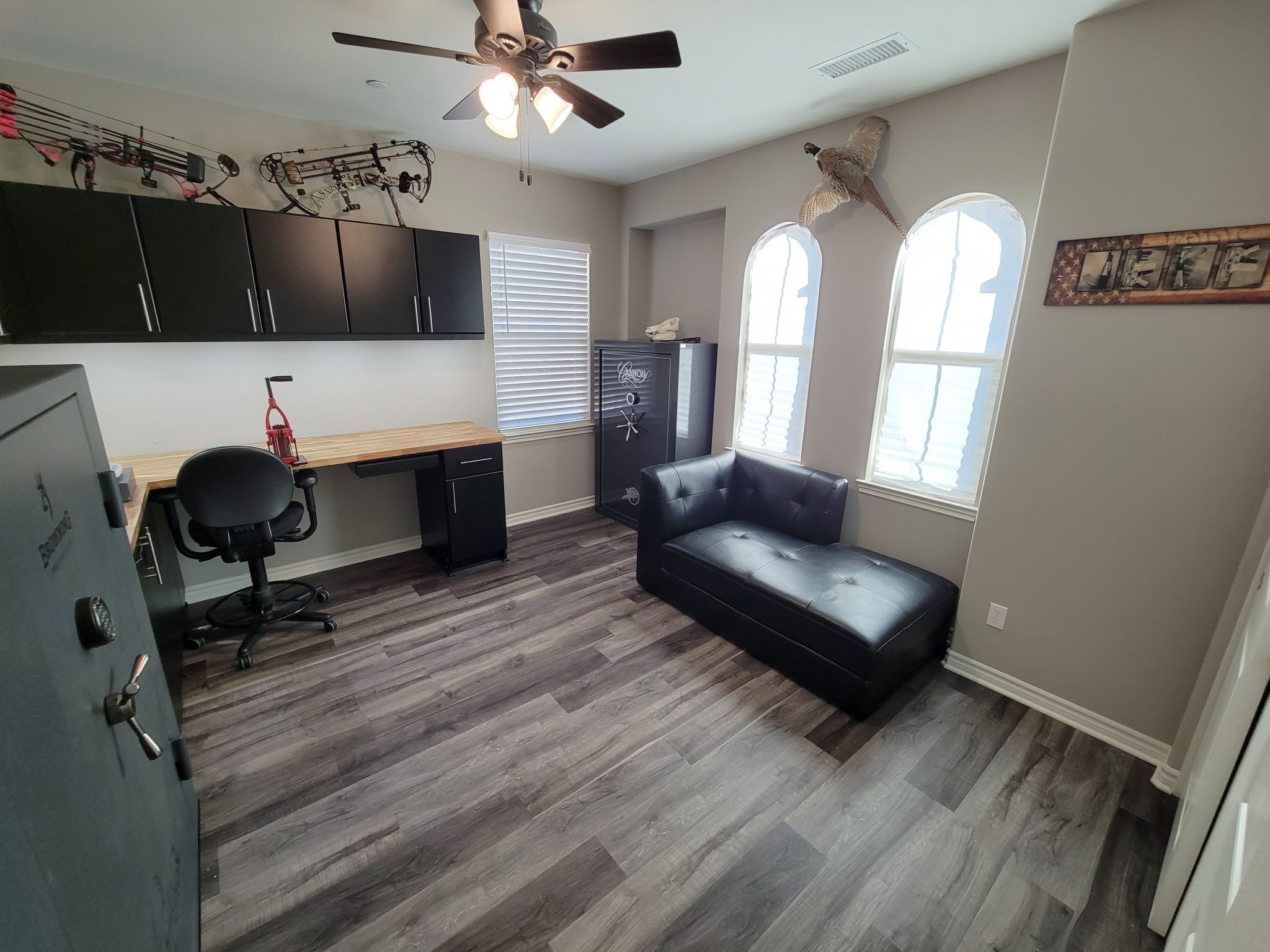

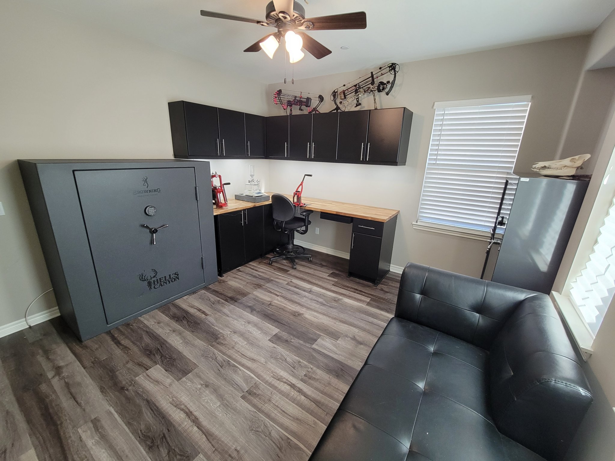

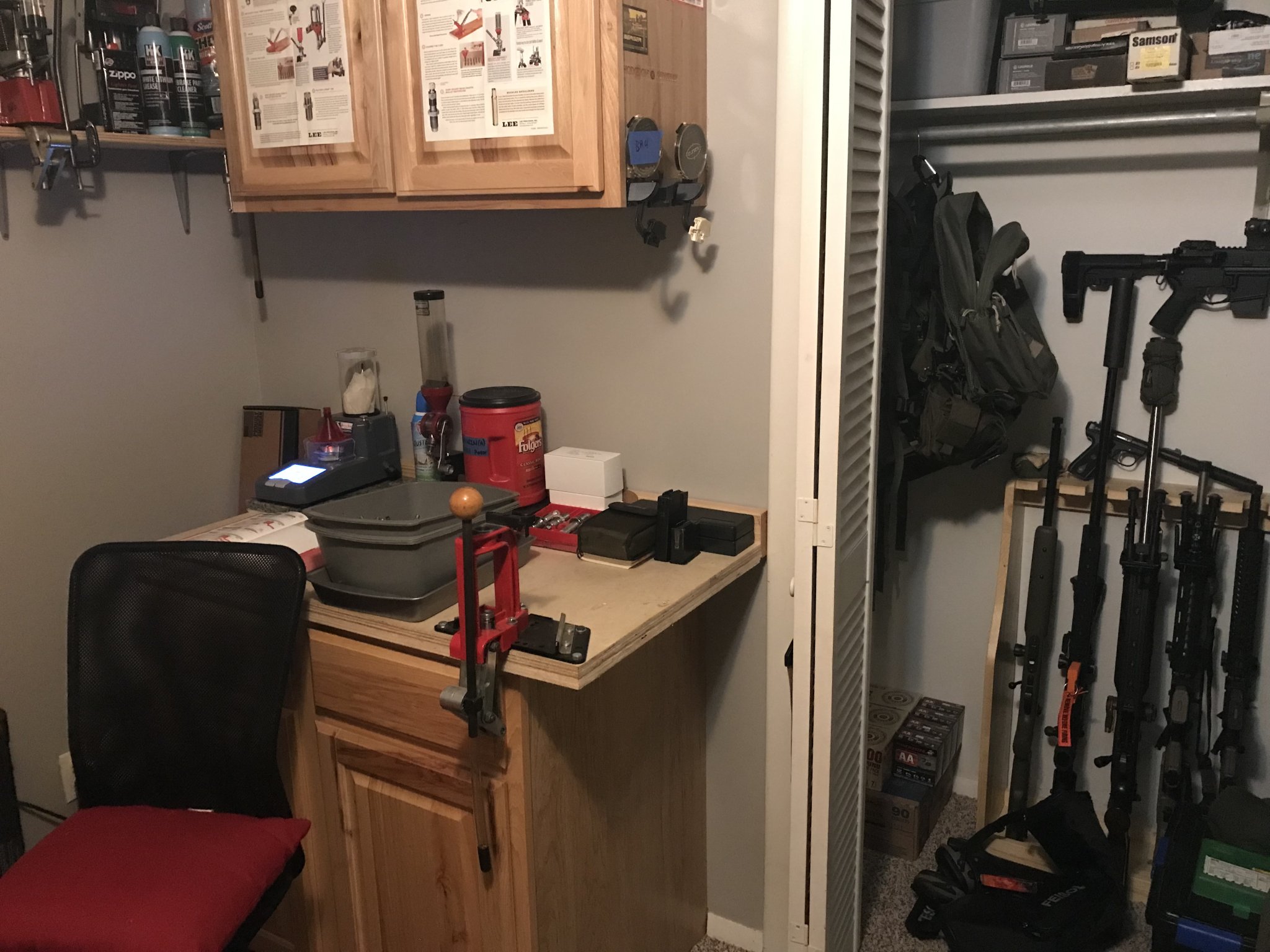

Finished up my new room. I have a few small things left to do. I just need to do some minor wiring and install my last inline fabrication mount to store my other press. Pretty happy with everything

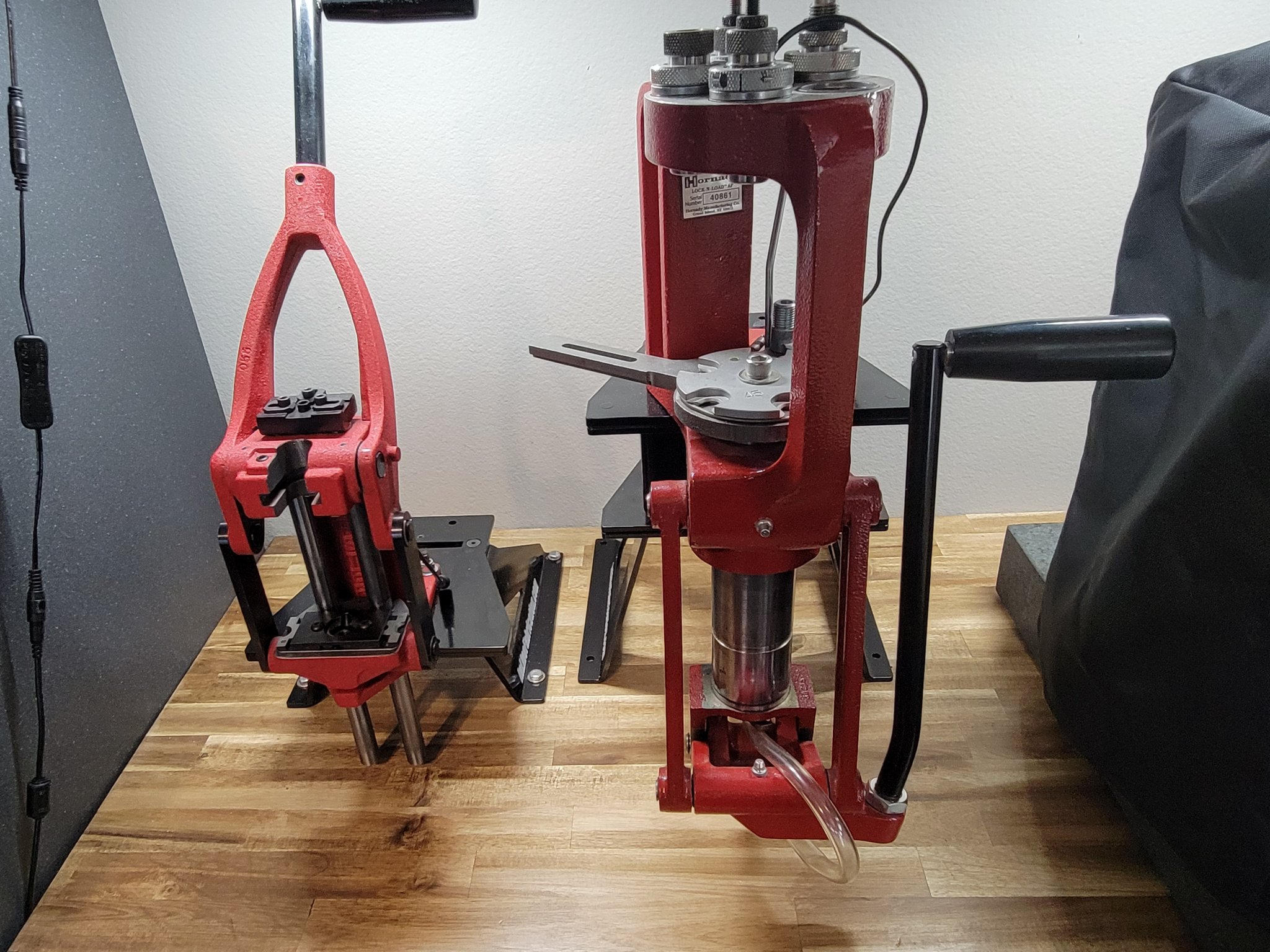

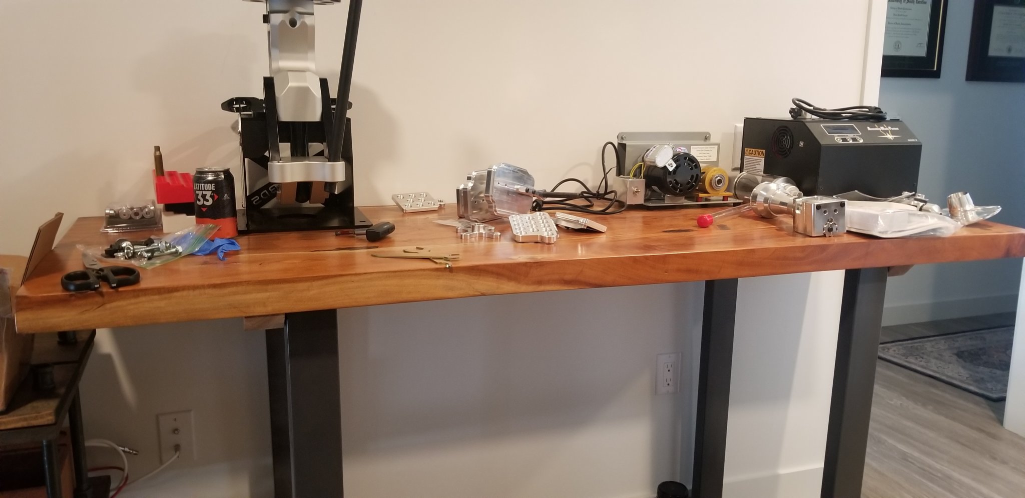

Gents,
Starting my reloading chapter of my life, life in an apartment but have a dedicated room for my office and 2A habit. I have setup a 6x2x3 reloading bench, and I am now beginning to design how I want to lay it out before I bolt things down.
I want this small bench to double as a reloading center and also a small work space for basic rifle work:
Here are my raw/open thoughts I need your help on:
1.) 419 Zero bolted just to the right of where it is now, with enough space for components and gray ops rack to the left;
2.) (not pictured) Autotrickler v3 to the far rightof the press (where the other components are):
3.) I want to put the heat generating compontents (AMP II and case trimmer, pictured) on a mobile cart that I can tuck underneath the bench, and can unplug as needed, and setup to the right of me when sitting at the bench.
4.) Anything flammable is kept in OEM containners, plastic lockers in another room.
Thoughts?

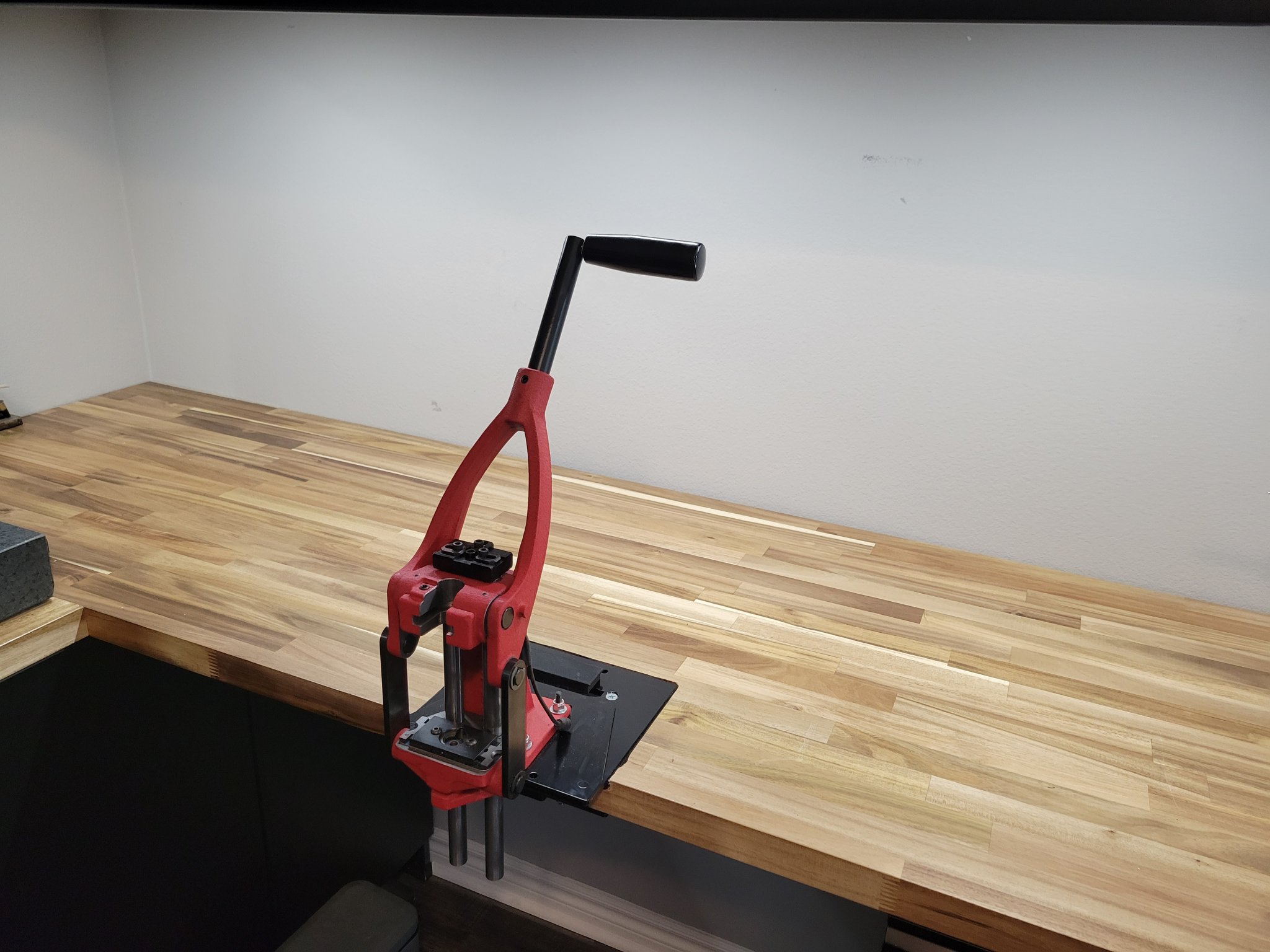

My best advice is to simulate loading before you mount. My old reloading room looked like it would work good but my press was not in the best spot. Also the inlinefabrication qc mount is cool. I just set my bench up with two stands to store my presses and a flush mount on my bench top. This allows me to use my bench to load and move the press out if the way if I need to work in my guns.
I do appreciate the 419/big dog and similar setups as it allows me to push it further back on the table and still manipulate the press. I need to do some small troubleshooting to shim the bench, just some slight wiggle still.
The bench is tall enough for me to stand at and/or high sit at (with a stool), so there is enough storaget here to kick a cart underneath.
In essense, I am channeling my wife's needs for "tiny home" living and trying to go as high end/organized/small foot print as possible.

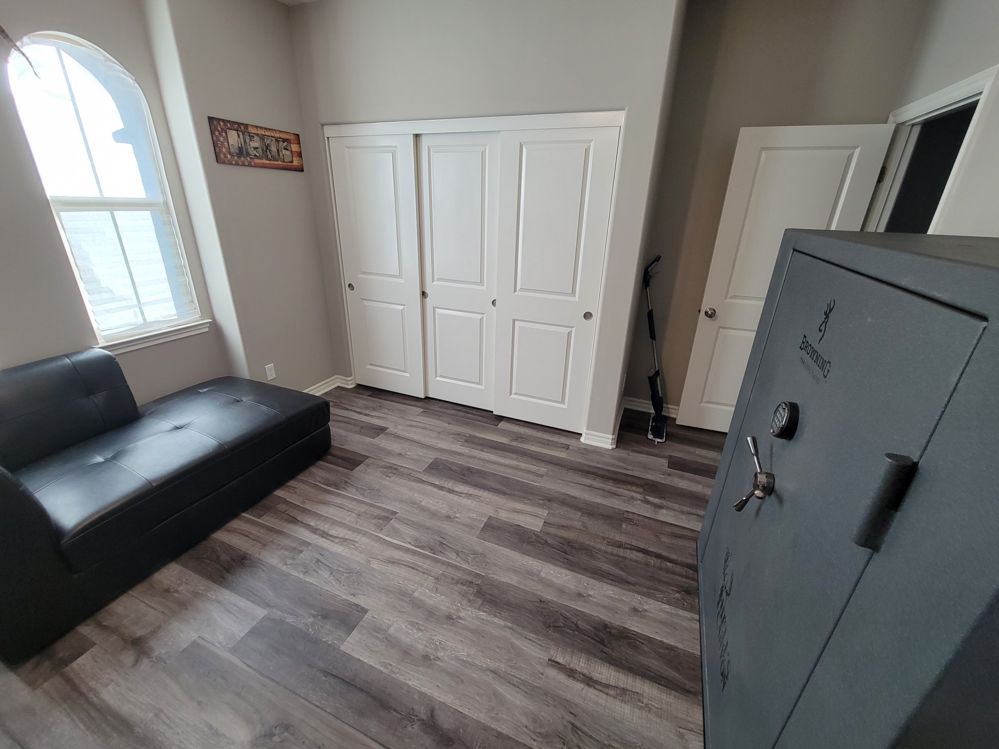

That's an amazing reloading room. The only thing it's missing is a nice leather couch, a beer fridge and a large flat screen on the wall so you can watch college football while a couple of hot Russian hookers does your brass prep for you and grabs you a beer when you get thirsty.
Just saying.
Reactions: JustSendit
Just saying.
Those are in other rooms. 😉

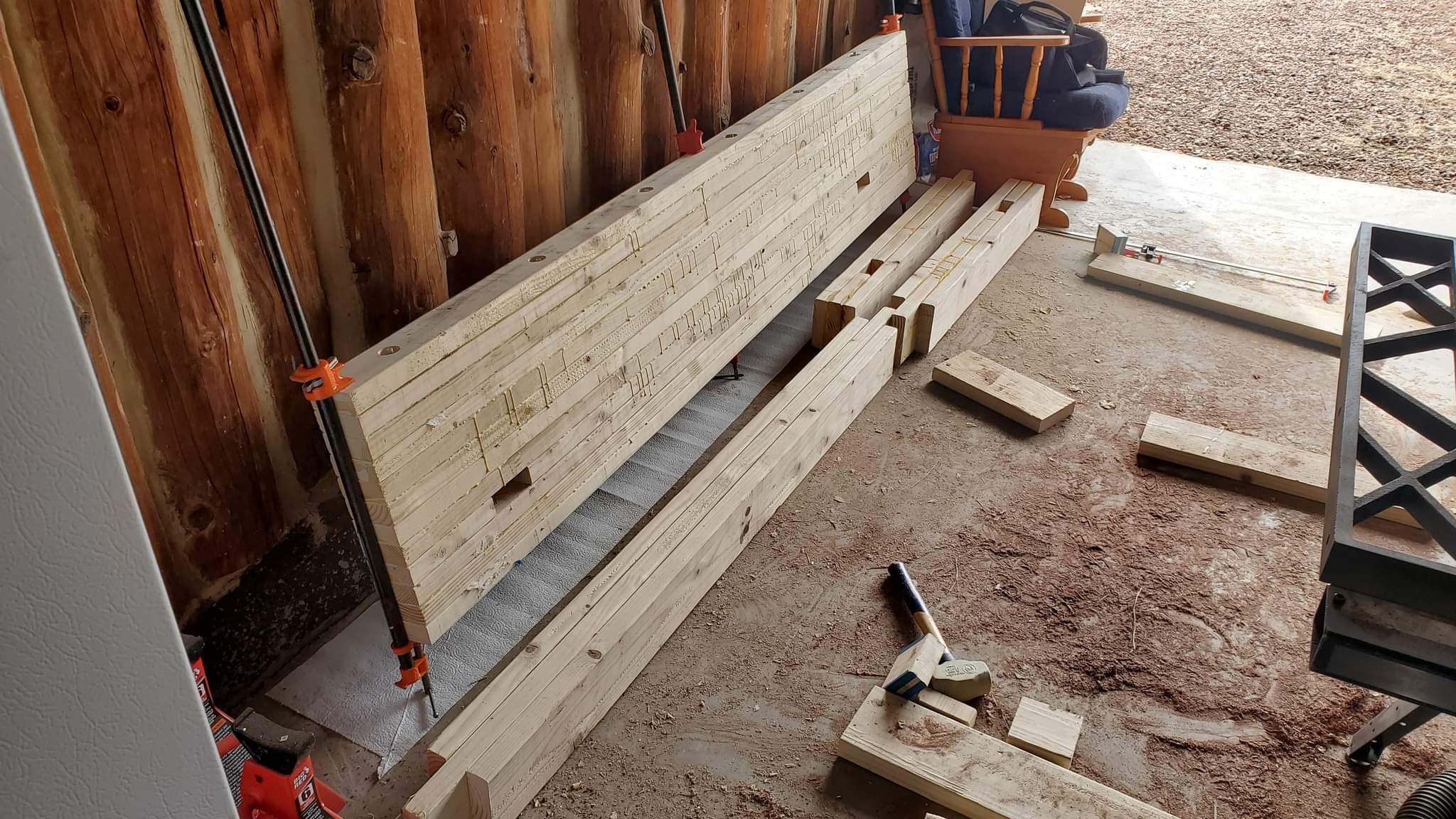

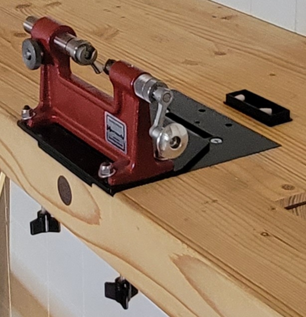

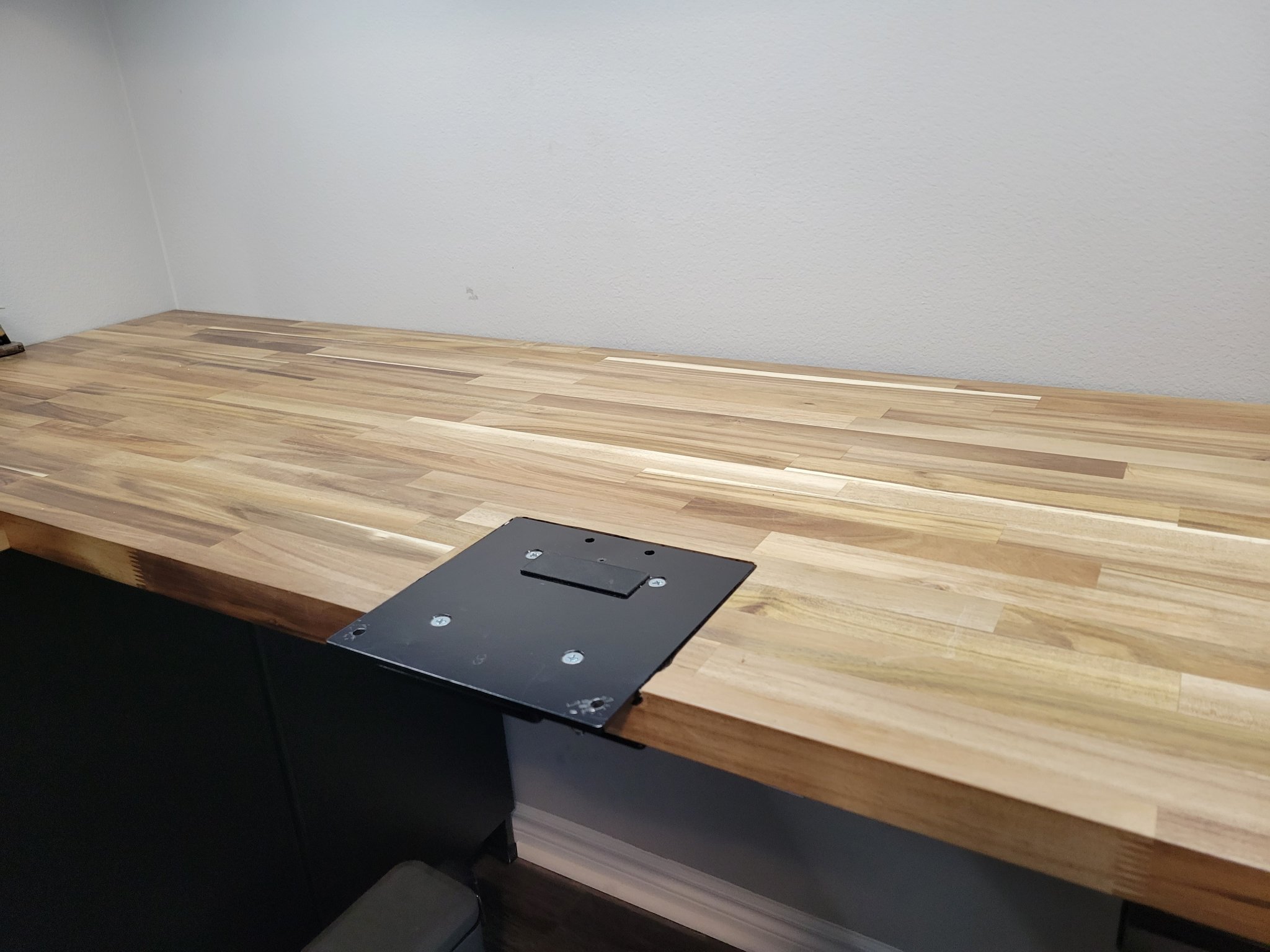

Yup, there's also threaded rod with nuts on either end under every plug.
Where the heck did you find straight wood? When I purchase wood and it needs to be straight, I feel like I am unbending ribs on a sail boat hull, just trying to get it straight. Get the best you can find home and it is the definition of a compound curve :rolleyes: Feel like I am stringing an English Longbow. (Quarter sawn wood just isn’t to be found)
Reactions: M1A1Abrams
Pipe clamps! A lot of them. It really is insane what they are passing off as lumber. Not too long ago it was called the cull pile.
