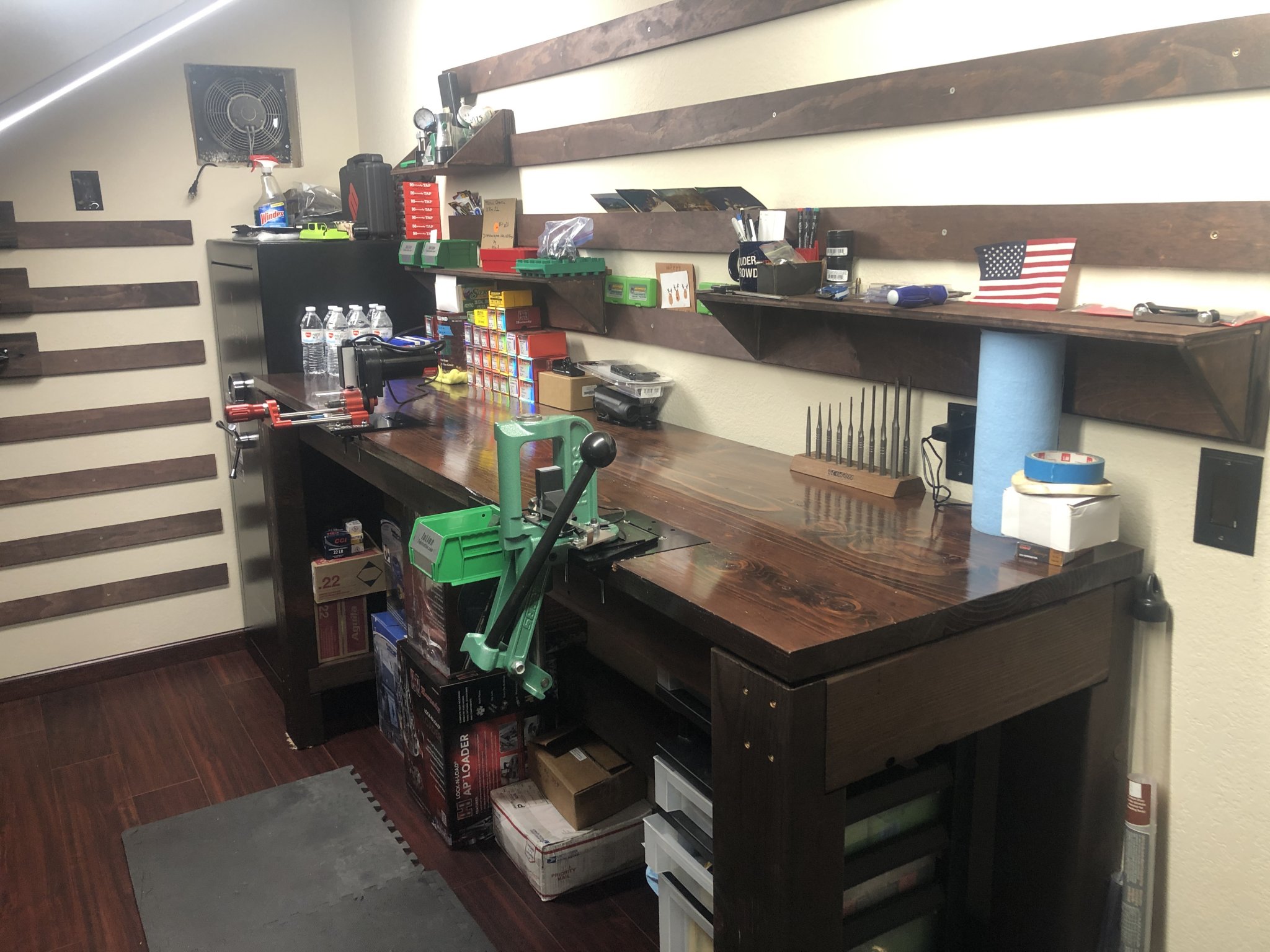

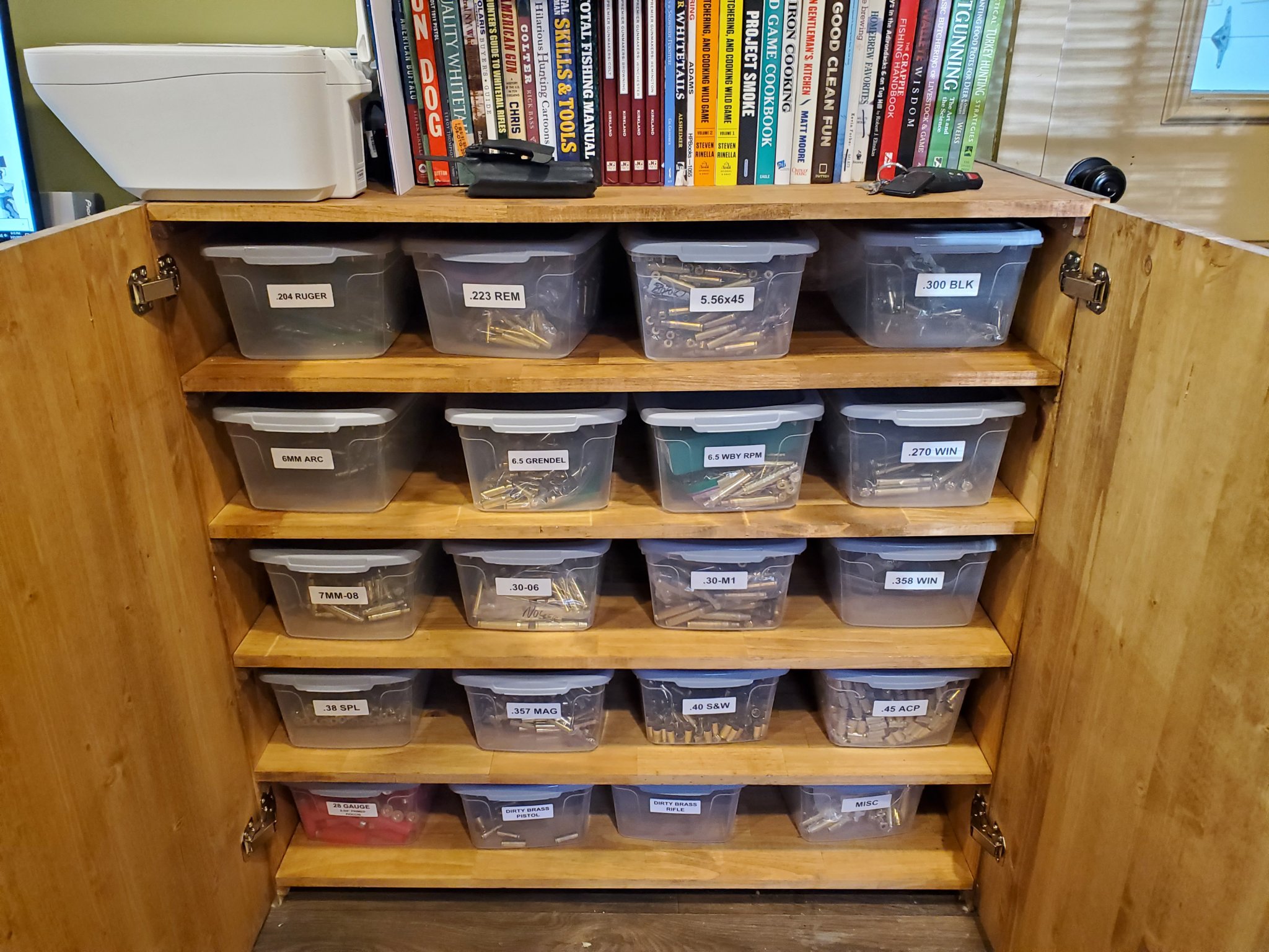

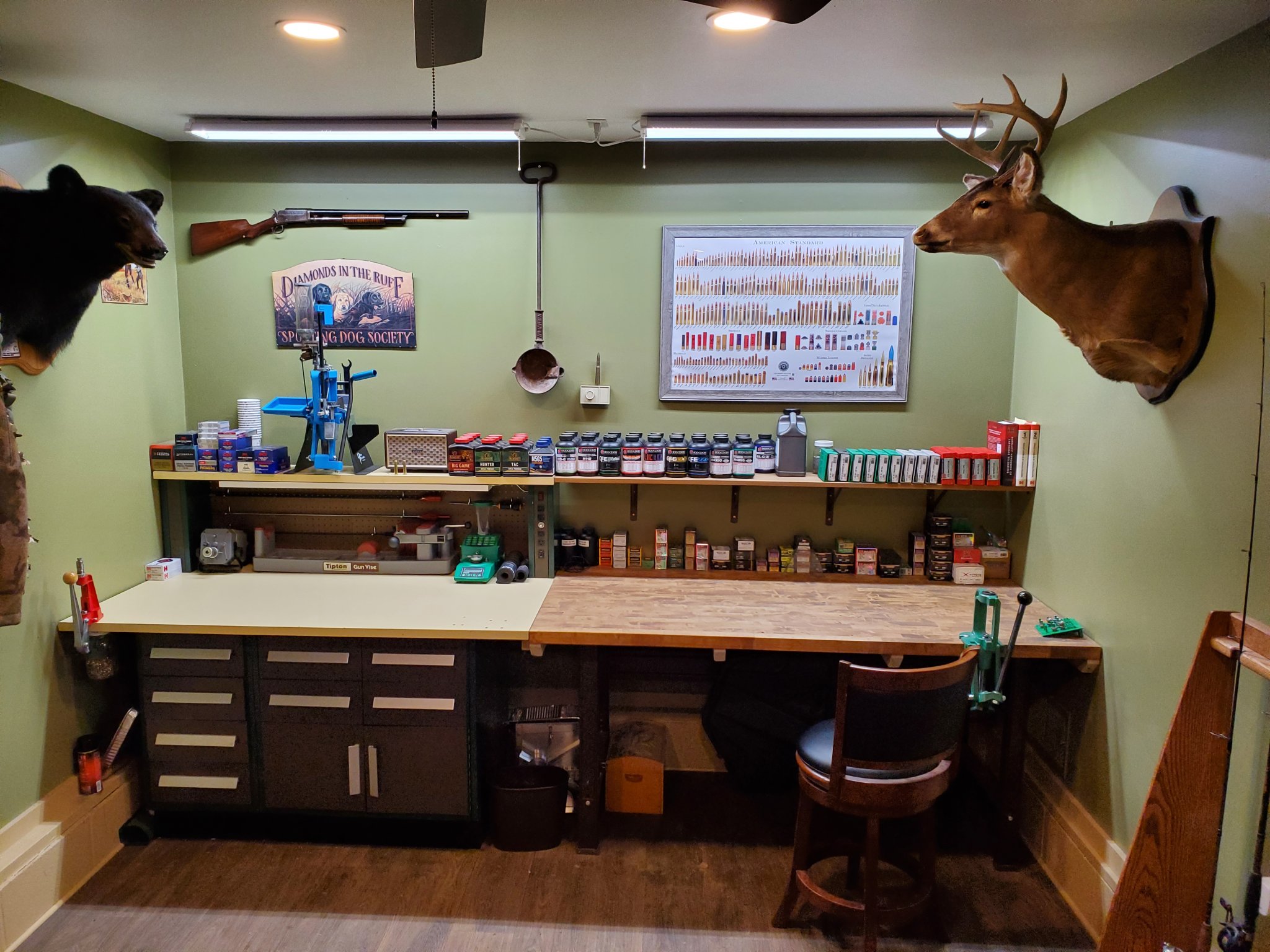

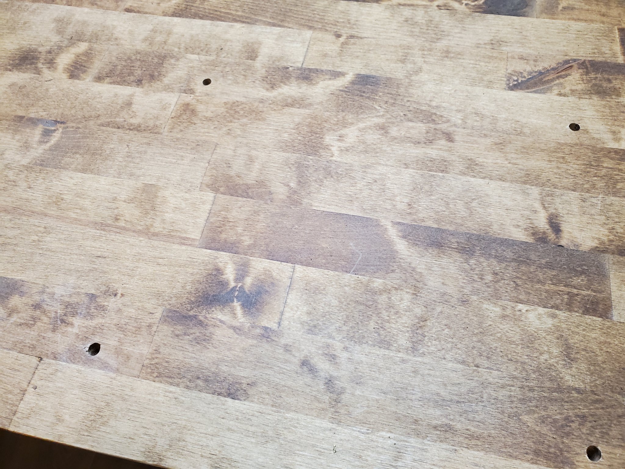

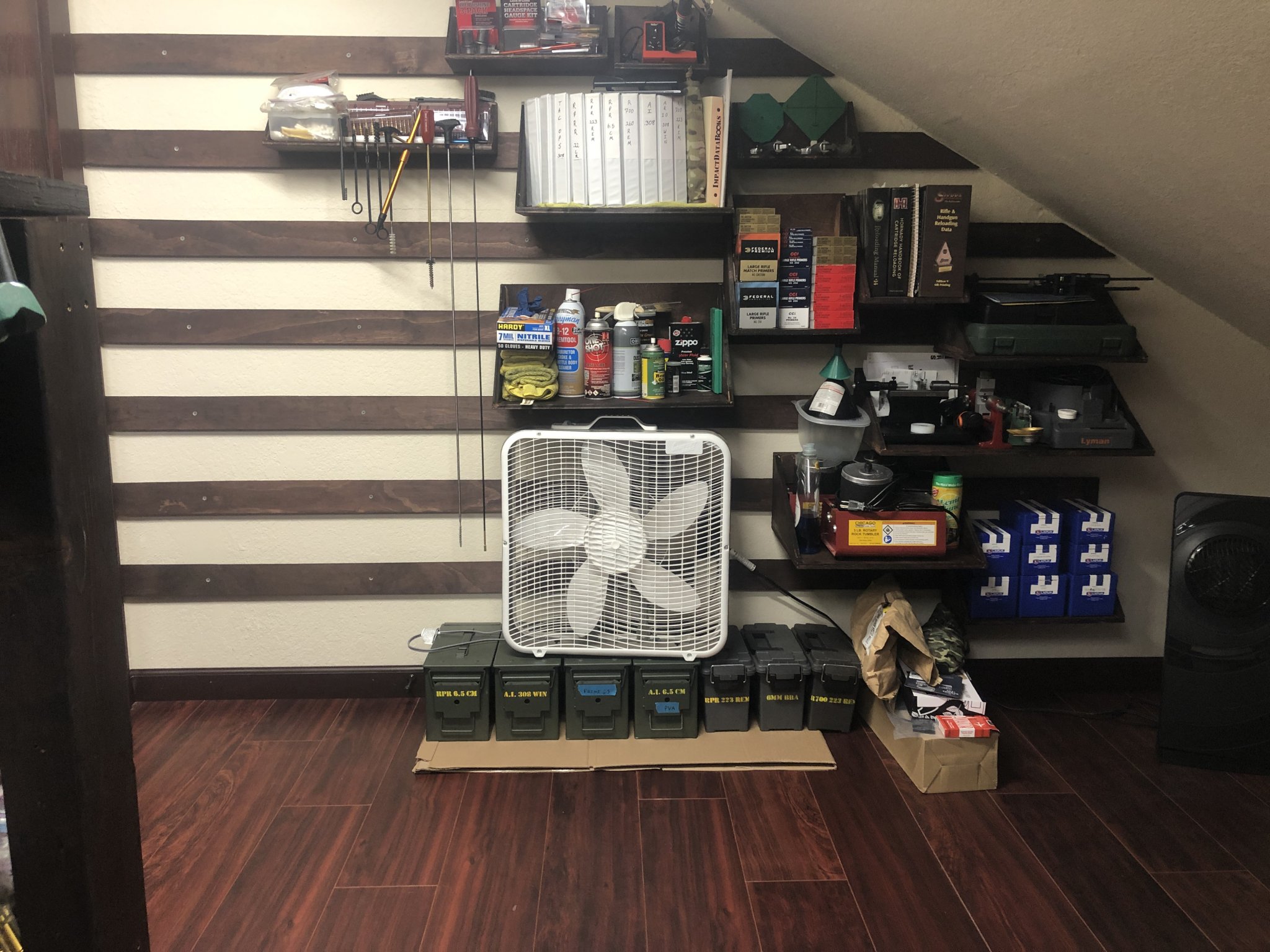

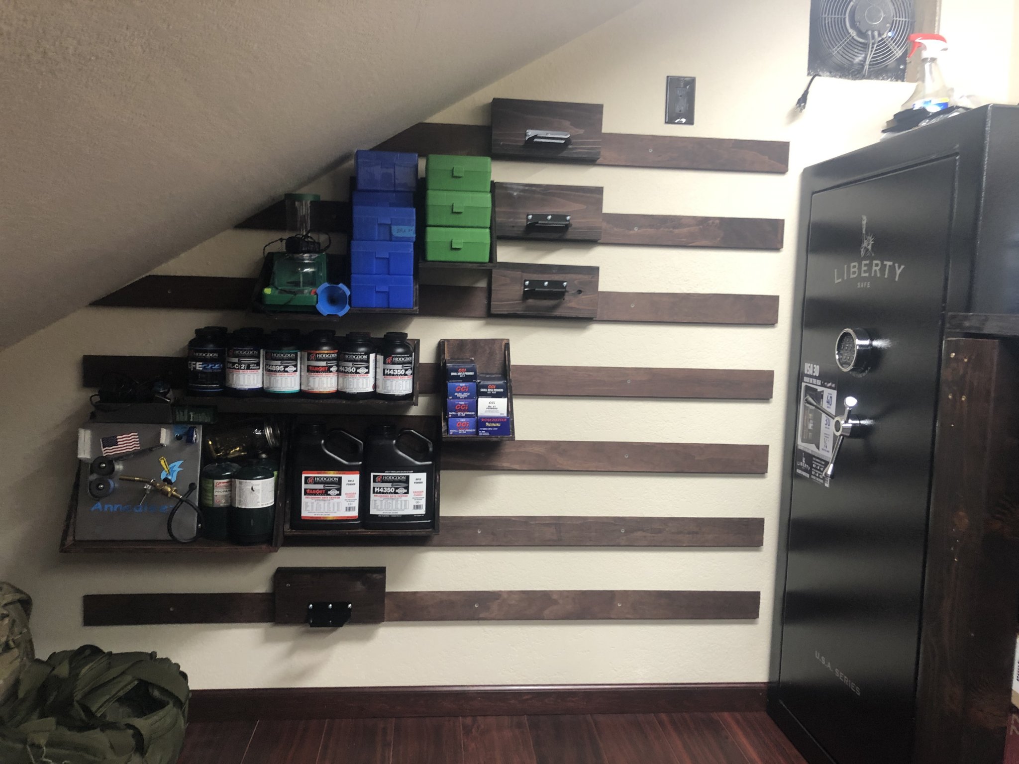

New to the forum, wanted to share / show off my reloading bench. Still a work in progress as my reloading develops. Left side is the "dirty" side, for rifle cleaning, de-priming, case trimming. I made the table on the right from a frame off of craigslist and a butcher block top from Lowes. It's all tied in tight to wall studs for rigidity. I used under mounted t-nuts for mounting my Dillon, Bench Primer and Super Swage. Also built this cabinet for brass storage but its running out of capacity quickly as I start loading for more cartridges.
Propane next to powder?
Good catch. Though I wouldn’t suspect the propane to spontaneously combust, I have moved the powder and primers for at least some peace of mind. Another plug for the flexibility of French cleats.
on that note, the house previously on this grounds had been taken out by fire so I’m sensitive to such a thing.
thank you for the fresh set of eyes 30cal!

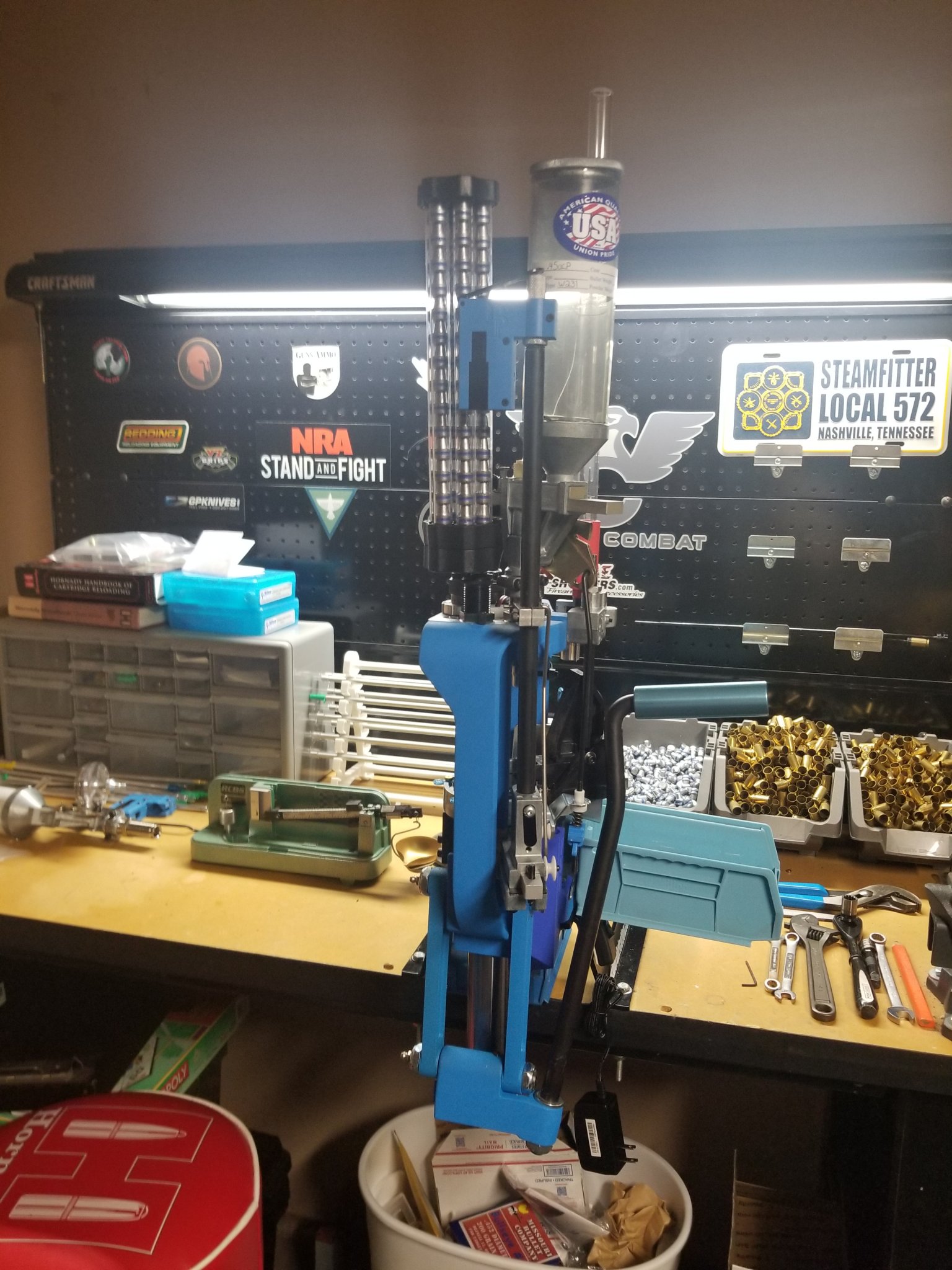

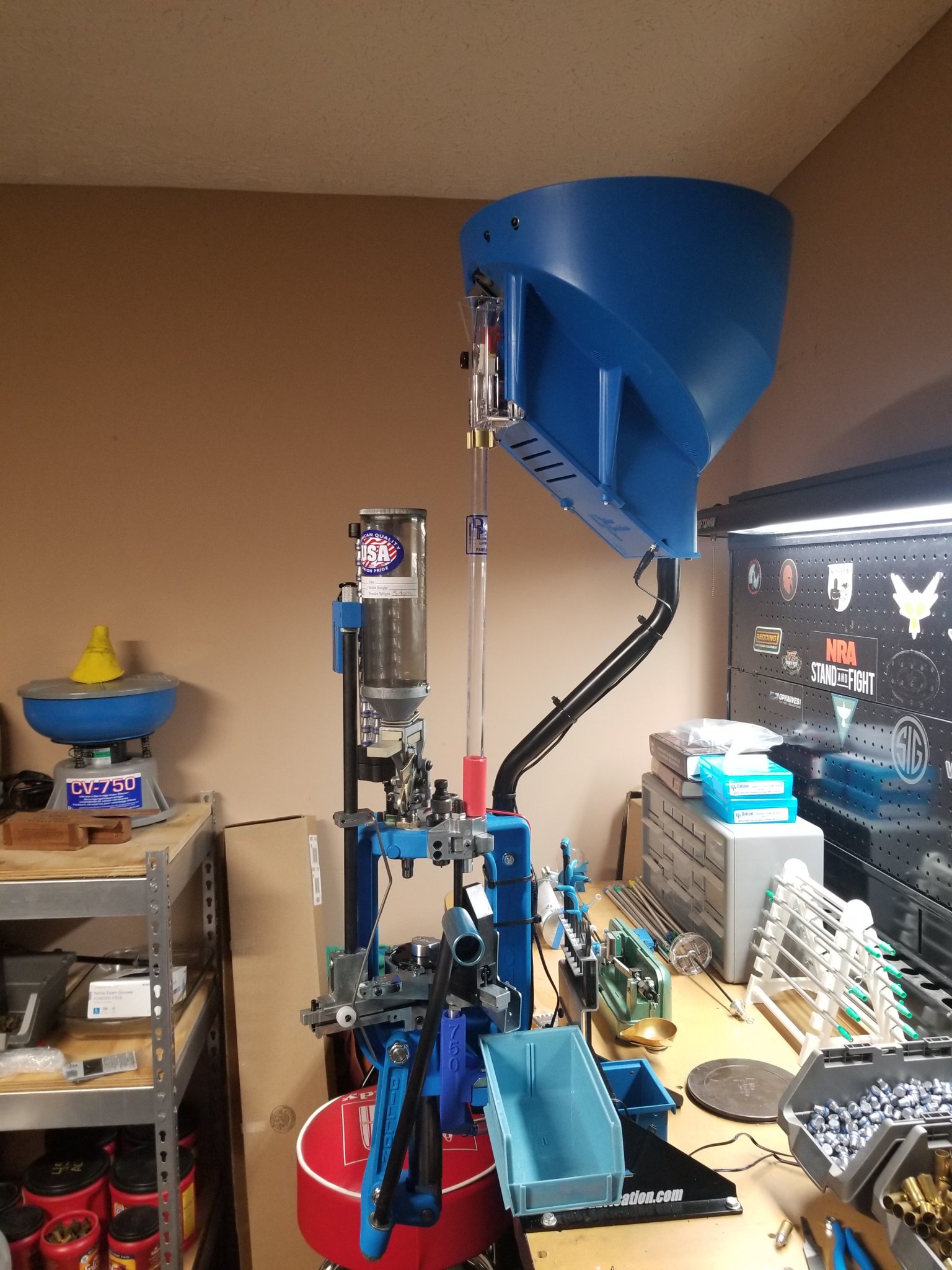

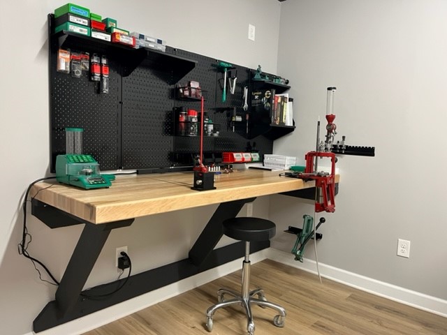

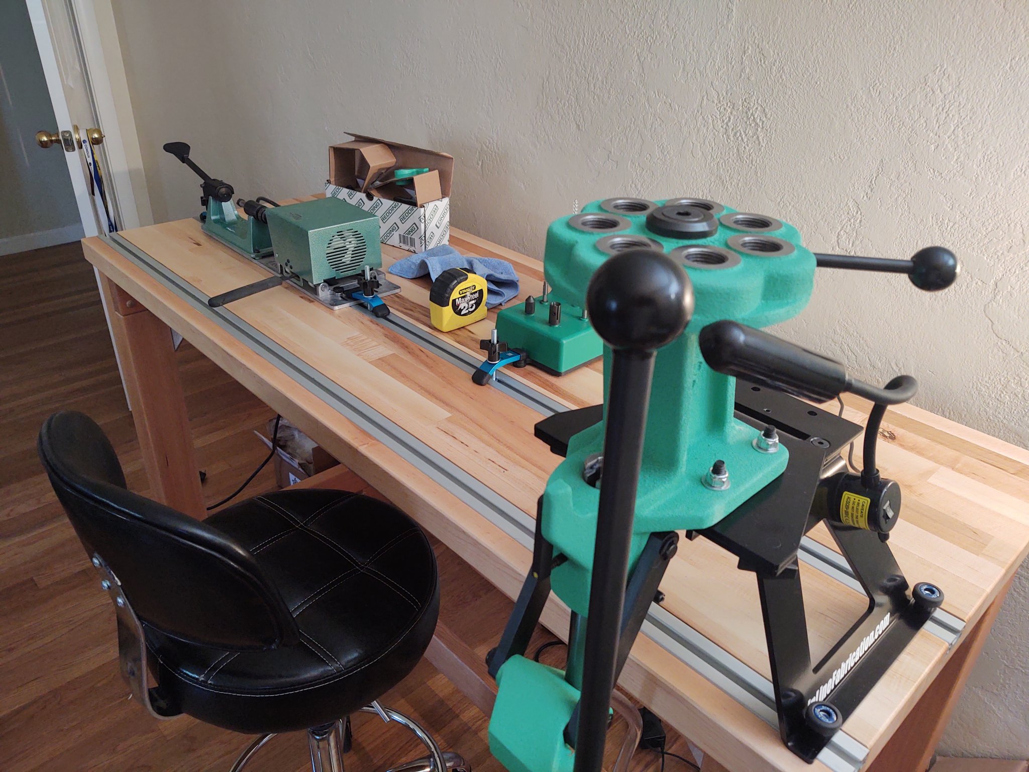

My bench is a work in progress. This is the 2nd one I have built and is a little bigger than my last one. The lightswitch was put in to control LED lights above the bench. Since this picture has been taken, I have installed two flush mounted power strips. One in the back next to the dies for thinks like tumblers, scales, trimmers etc. The second one was put just to the right of the press for chargers or other random things so whoever doesnt need to crawl under the bench to reach the outlet. I have bought a Chargemaster Supreme and absolutely love it compared to the other powder throw.
Next major upgrades will be giraud trimmer and zero press. Trimmer will be soon since case prep is the worst.

Wow ... that's friggin' beautious !!!
Reactions: M1A1Abrams
I really like the French cleats. Where did you find the plans/specs for these and the associated shelves?
Thanks! I just watched a bunch of YouTube videos and decided on the dimensions. Ripped the cleats on a table saw using 3/4 inch plywood.
I measured each piece of equipment or groups of tools I wanted shelves for and made those out of 1/2 inch ply. It’s pretty functional in that whatever I happen to be using the most at the time I can mount right in front of me at the bench.

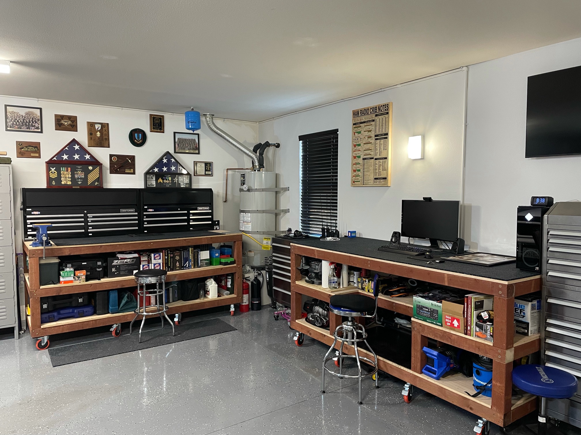

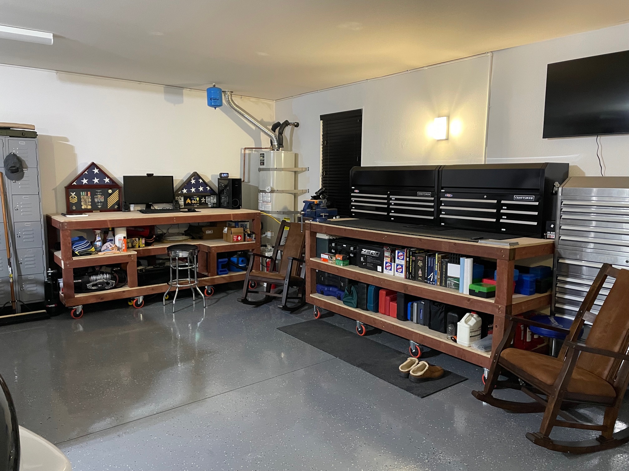

You know how it is. If you spend enough time in the wrong place at the right time. While it makes the shadow box look good at the end of a career, it's hard on the family situation. I think I made my last revision for a while. I switched stuff around because the wall with all of the outlets had the wrong bench in front of it so I switched it up and figured I would make a small military section. The ham radio station will be to the left of the computer when I get it all moved over and my LE dive stuff is on the opposite wall. Kind of my regular hangout these days. Just need a beverage fridge and it should be about done.

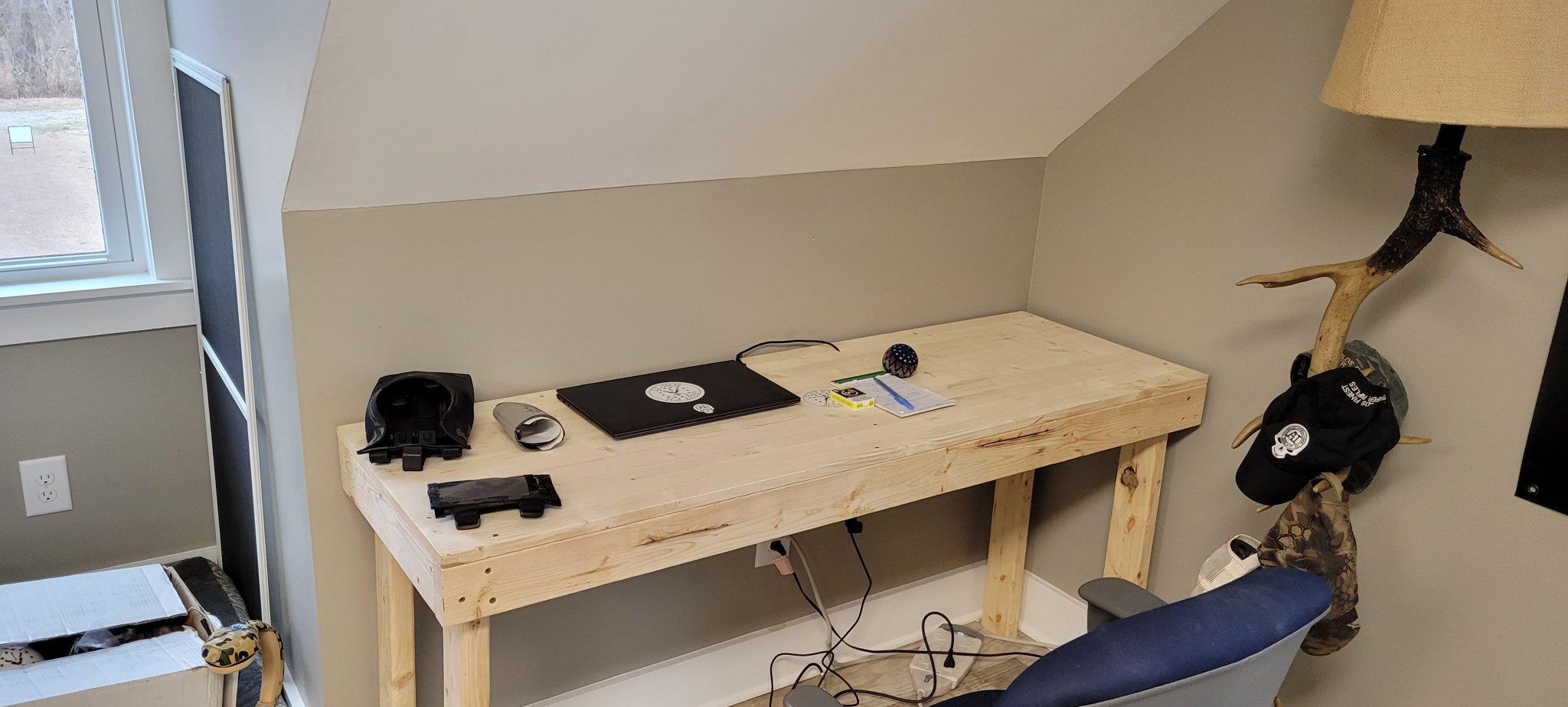

I went and changed it up again. Built another bench a few days ago but added a cutout so I could sit at the computer.

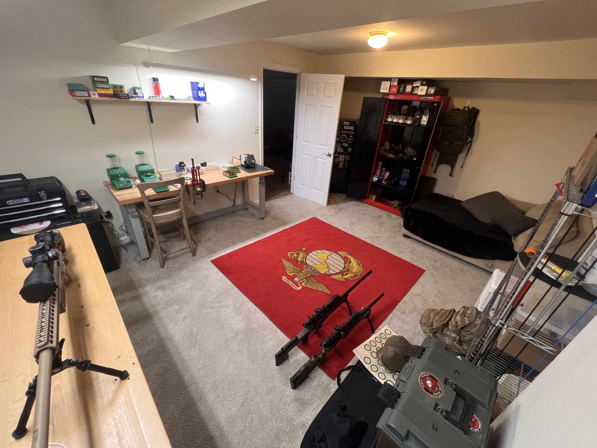

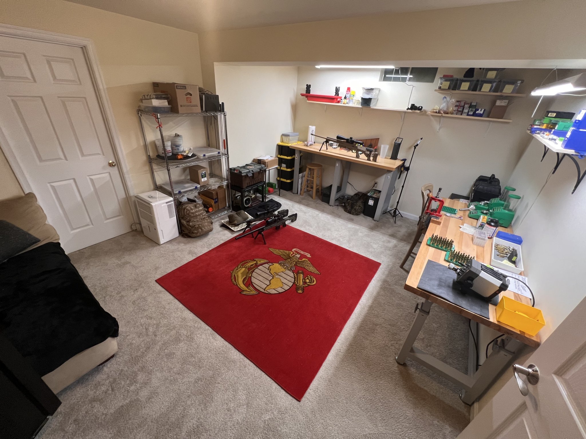

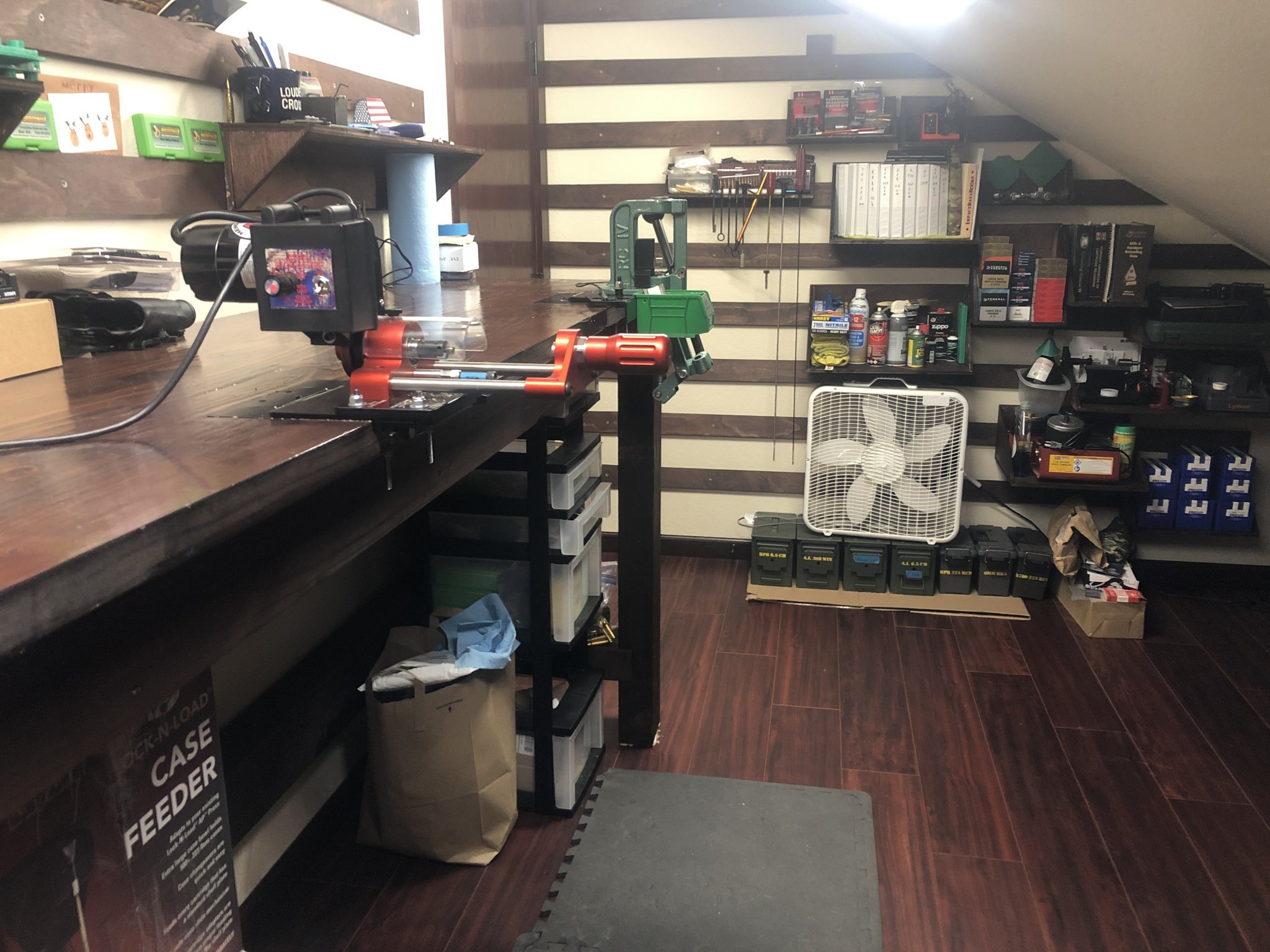

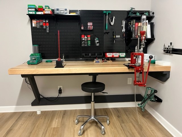

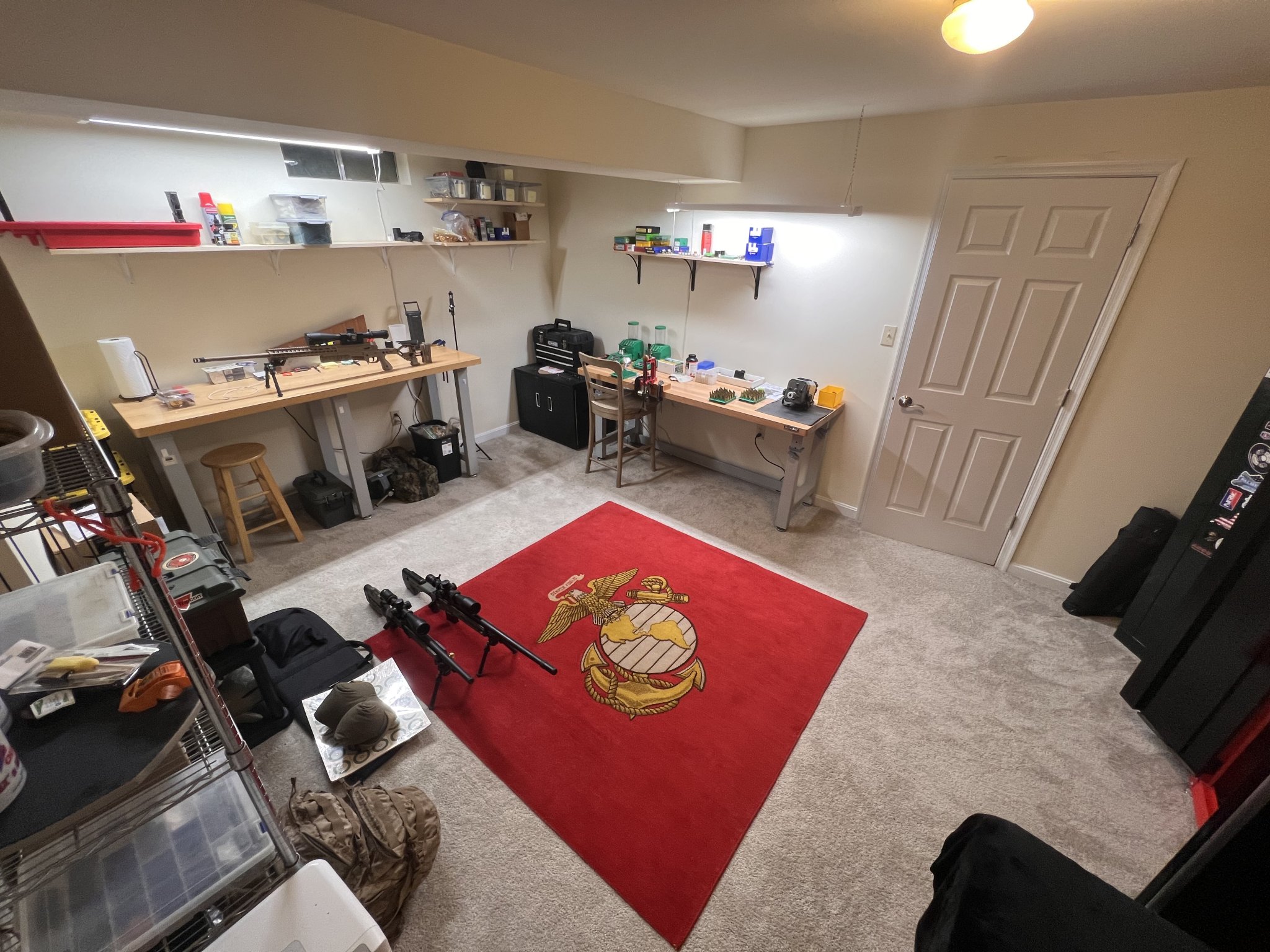

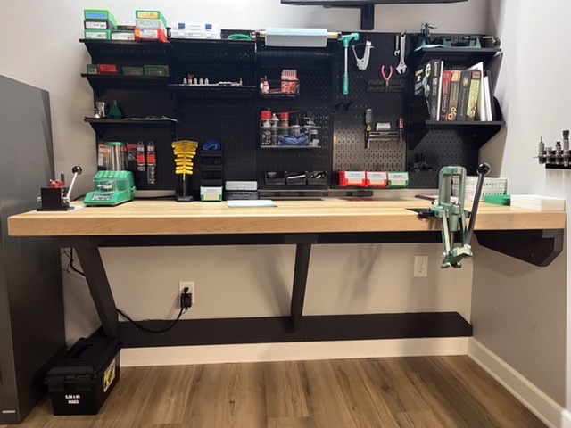

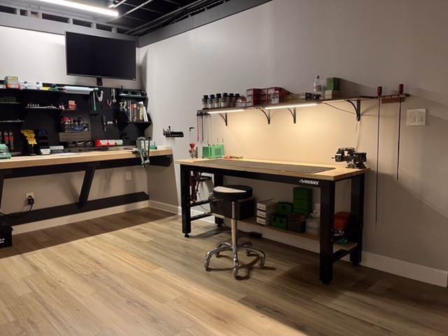

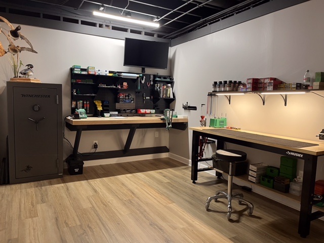

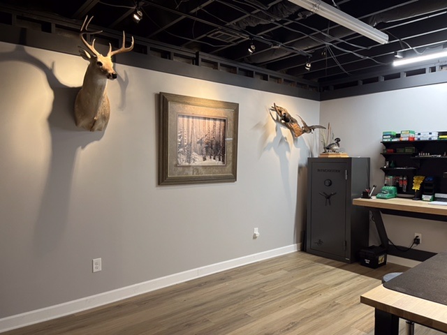

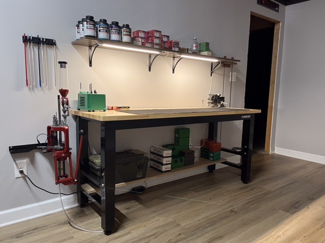

Finally got the new room finished after a PCS move to NoVA. Since I’m divorced now, I can do as I please in this house 😂
Moved from AZ and had everything setup in the garage. Between the heat in the summer and the constant blowing dust, it was a mess to say the least. Now that I’ve got a basement with this extra room, all is right. Added a workbench for reloading only, leaving the other one for maintenance, etc. Thinking about upgrading my press but this Lee has made some great ammo over the last 12 years…we’ll see.
Only downside is the safe had to stay in the garage since it’s too big to make it downstairs. Hopefully the goldenrod will be enough to fight off the humidity here.

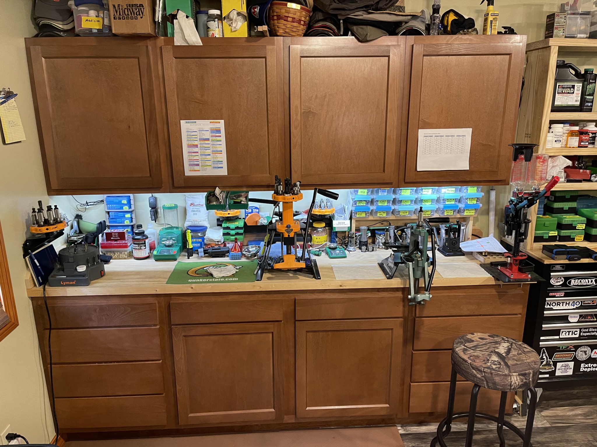

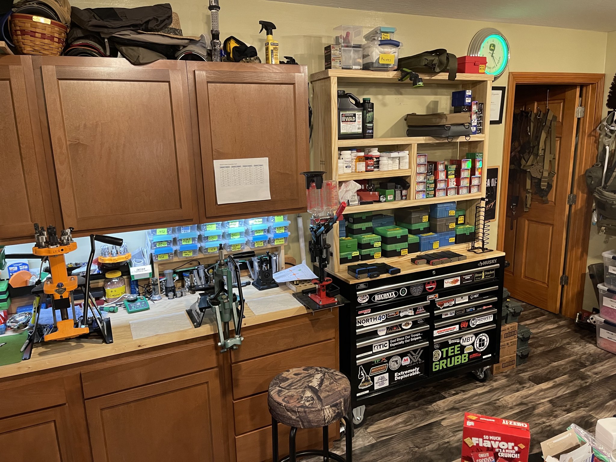

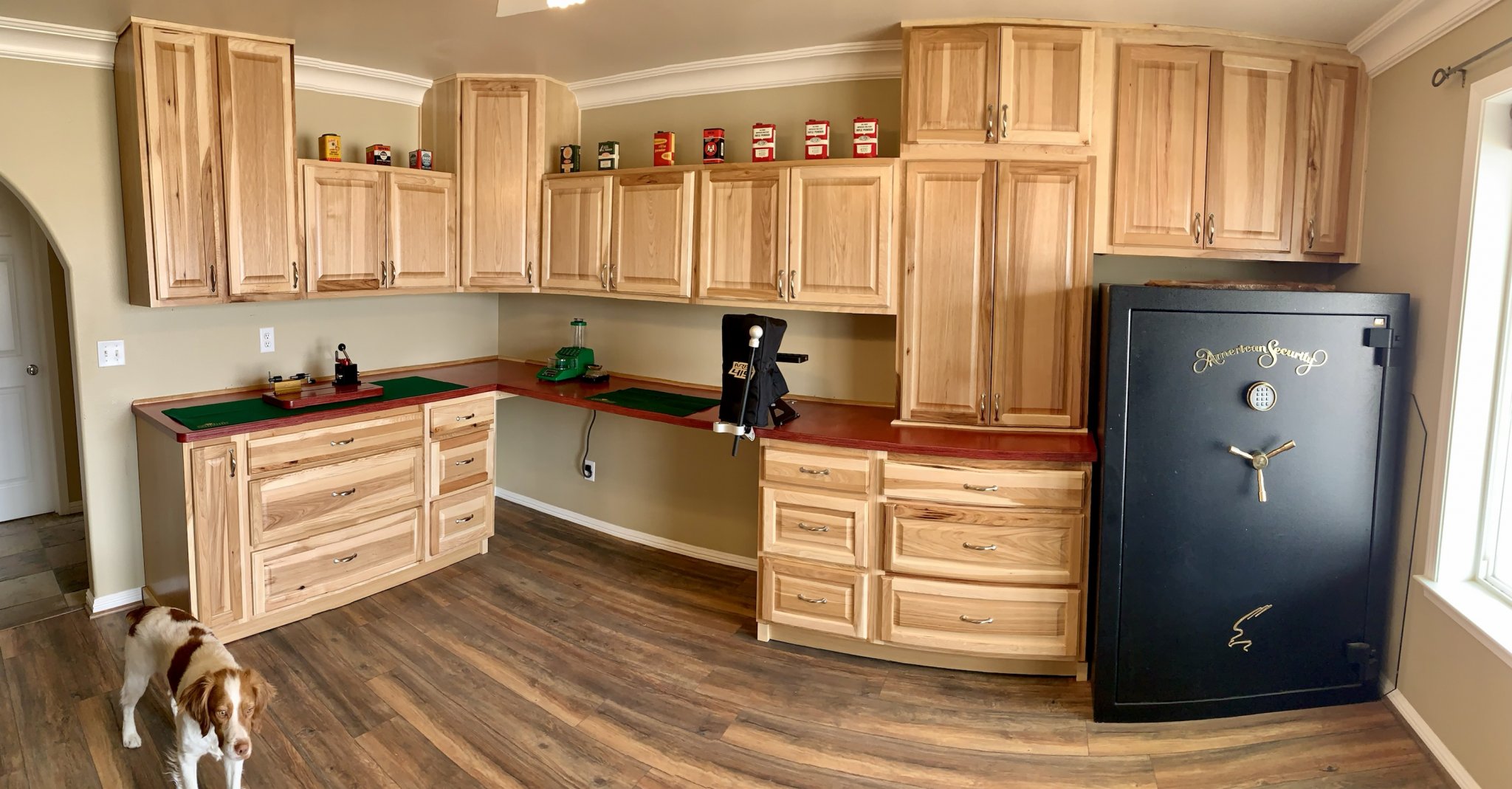

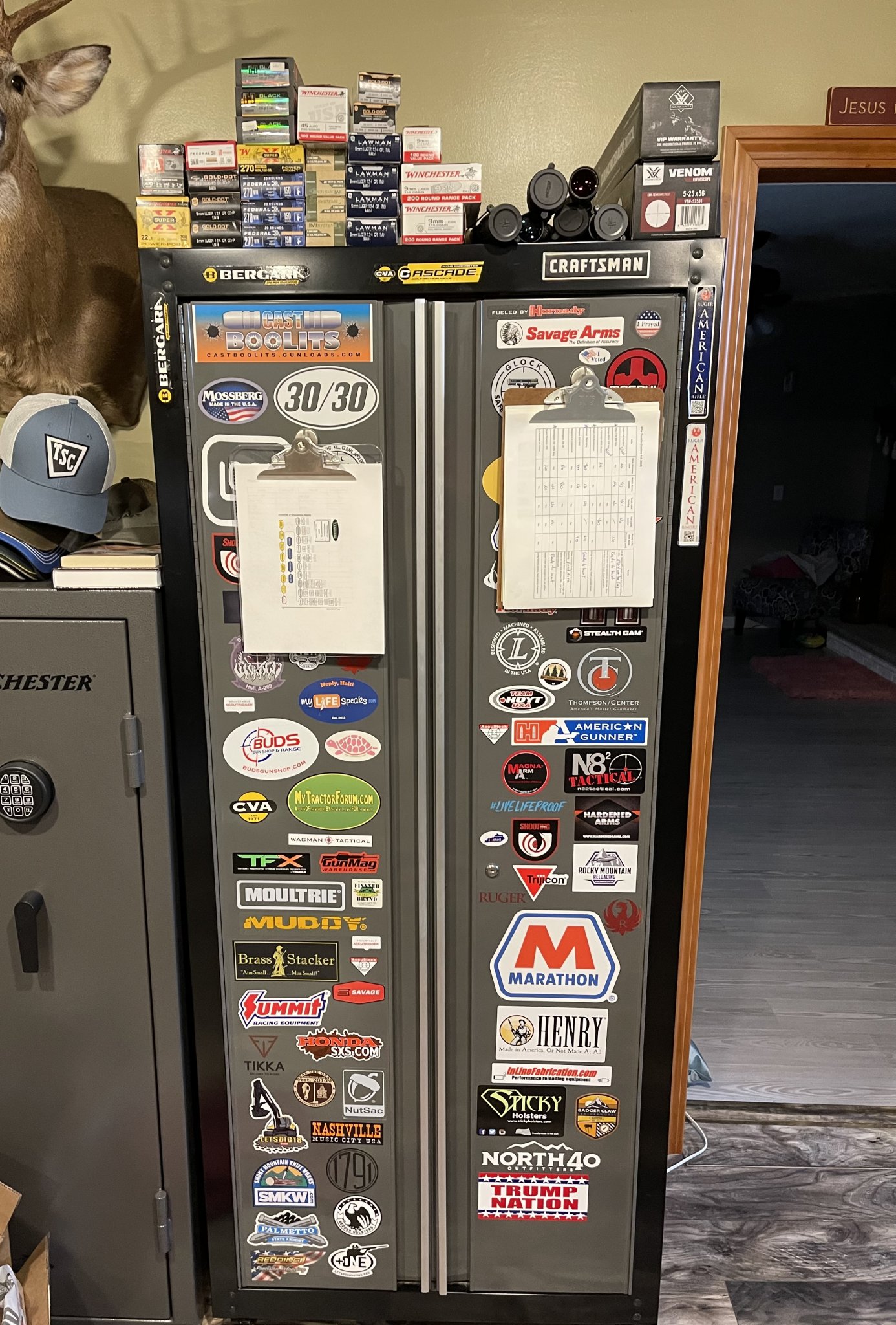

Mine has been a work in progress for years. I put the cabinets in when I built the mancave addition and have adding and changing it since then. I have another bench also, but it’s so junked up I didn’t put it in. The cabinet is powder and brass storage.
I’ve been contemplating getting this same Craftsman metal cabinet for my reloading room but wasn’t sure how well the limited number of shelves would hold up to stacking weight on them. What do you store in yours and does it work well?

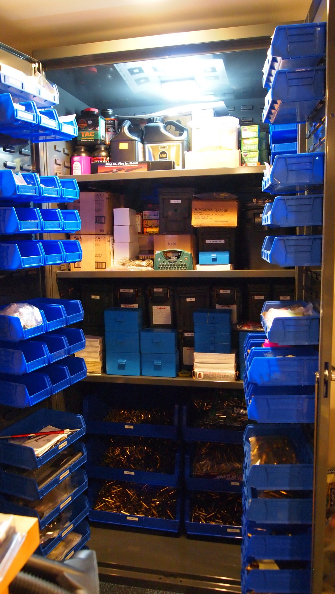

My opinion is not a statement on the Craftsman cabinet.....just offering an option.
I bought one of these....
And it has been fantastic.
Shelves and bins hold tons of weight.
I have 2 craftsman cabinets in my garage and they will hold a ton of weight. You'll be challenged to stack enough stuff on them to push their capacity. 1 more shelf being included would be nice though.

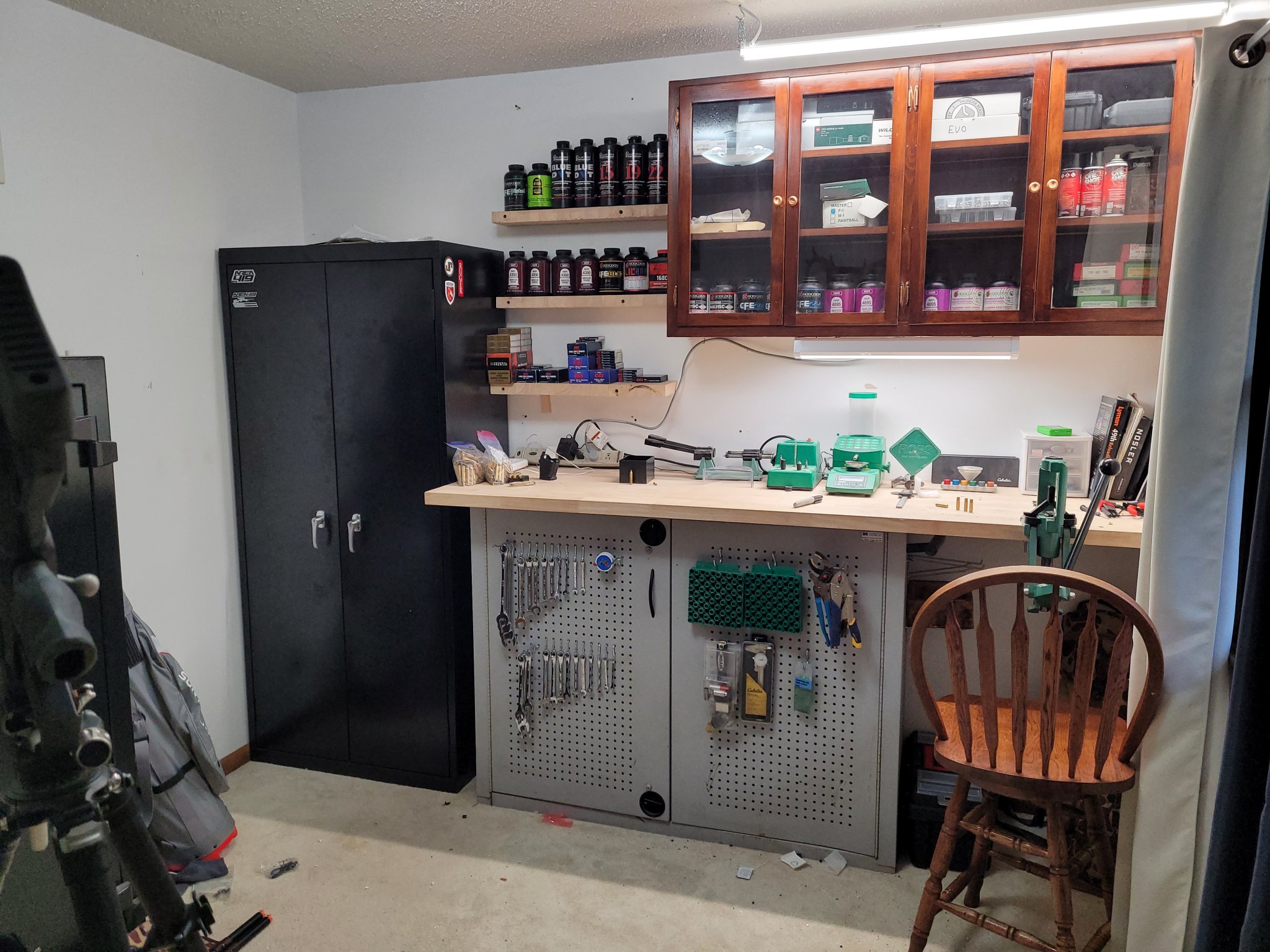

I have a few Steel Cabinets USA and they are a quality product. You can find laptop charging stations on ebay or at gov surplus for cheap. The one under my bench was less than 100 bucks and way heavier than any garage type steel cabinet.
