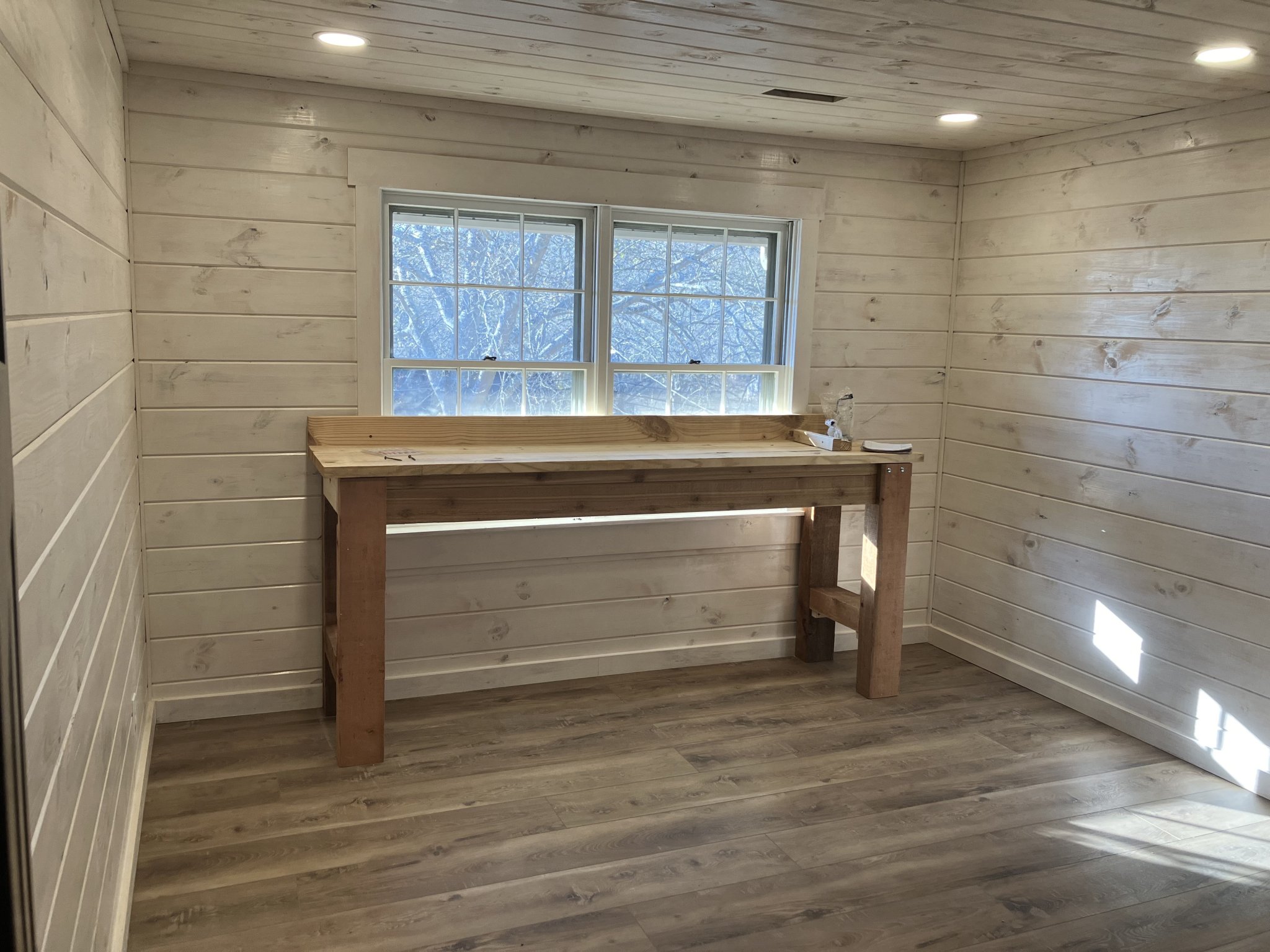

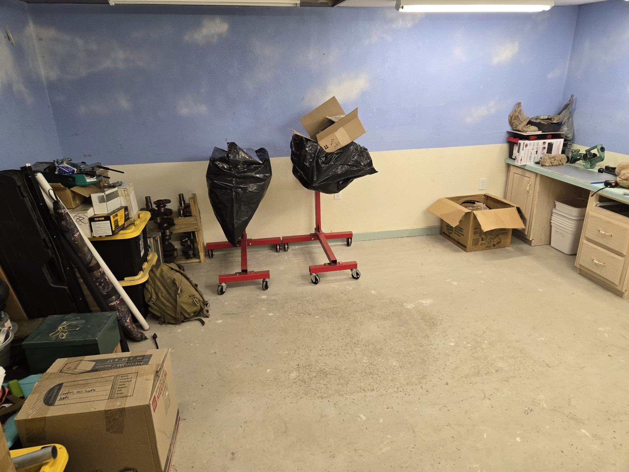

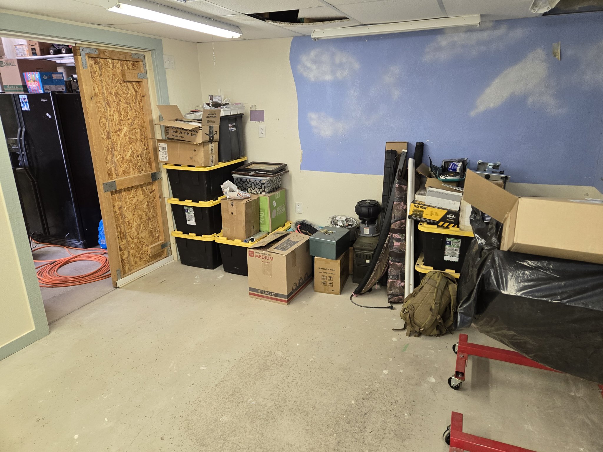

So because AJ called me a slacker... because I took last weekend off to go and pick up a live cannon in Cheboygan (no, really...) instead of working on my reloading room.
Here's a couple of pictures of today's progress. Got the pocket door in (decided to make my own 'barn door' not buy some Chinese thing from Home Depot. And insulated about 1/3rd of the ceiling and got my ceiling panels up. Instead of sheetrocking, I'm going with metal roofing. Looks great. Goes up in a snap. No taping, no joint compound, no sanding, no painting. Damn this stuff is GREAT for interior spaces! $22 a sheet 3 x 8 at Home Despot.
I'll have the ceiling in by tomorrow in one of the two rooms and I'll get the wall insulation up on the dividing wall. By the end of next weekend, I'll be starting on planking the walls. Progress... lots of progress!

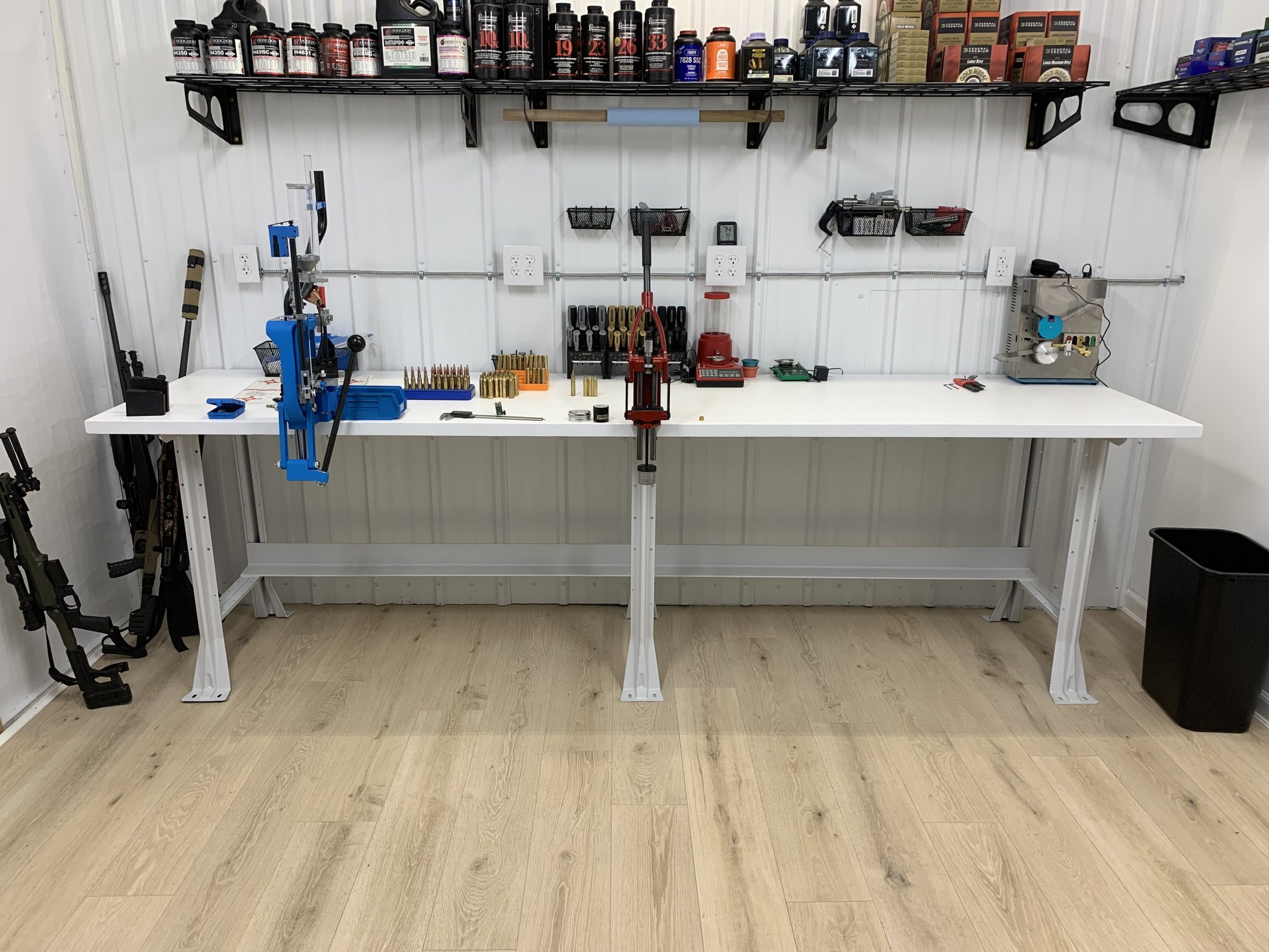

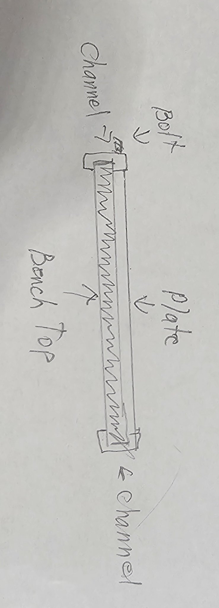

This is what I'll do next ad to not have holes. Final design may change, but concept is the same especially for heavy work and presses.View attachment 8535557
You know I don’t know what we arr do up tight about these holes every hole I have seen mentioned is for a bolt that holds a vice or press or other tool I have 1 vice and 2 presses mounted with bolts through holes that are the filled with bolts permanently so no more hole right problem solved if you want to secure something like a case trimmer mount it on say a piece of 3/8 plate and clamp that to the table you only need that once in a couple weeks or longer so you can remove and store it anything else?
The end
The end
i'm not ocd about this, just like a clean, smooth and 100% usable work surface.

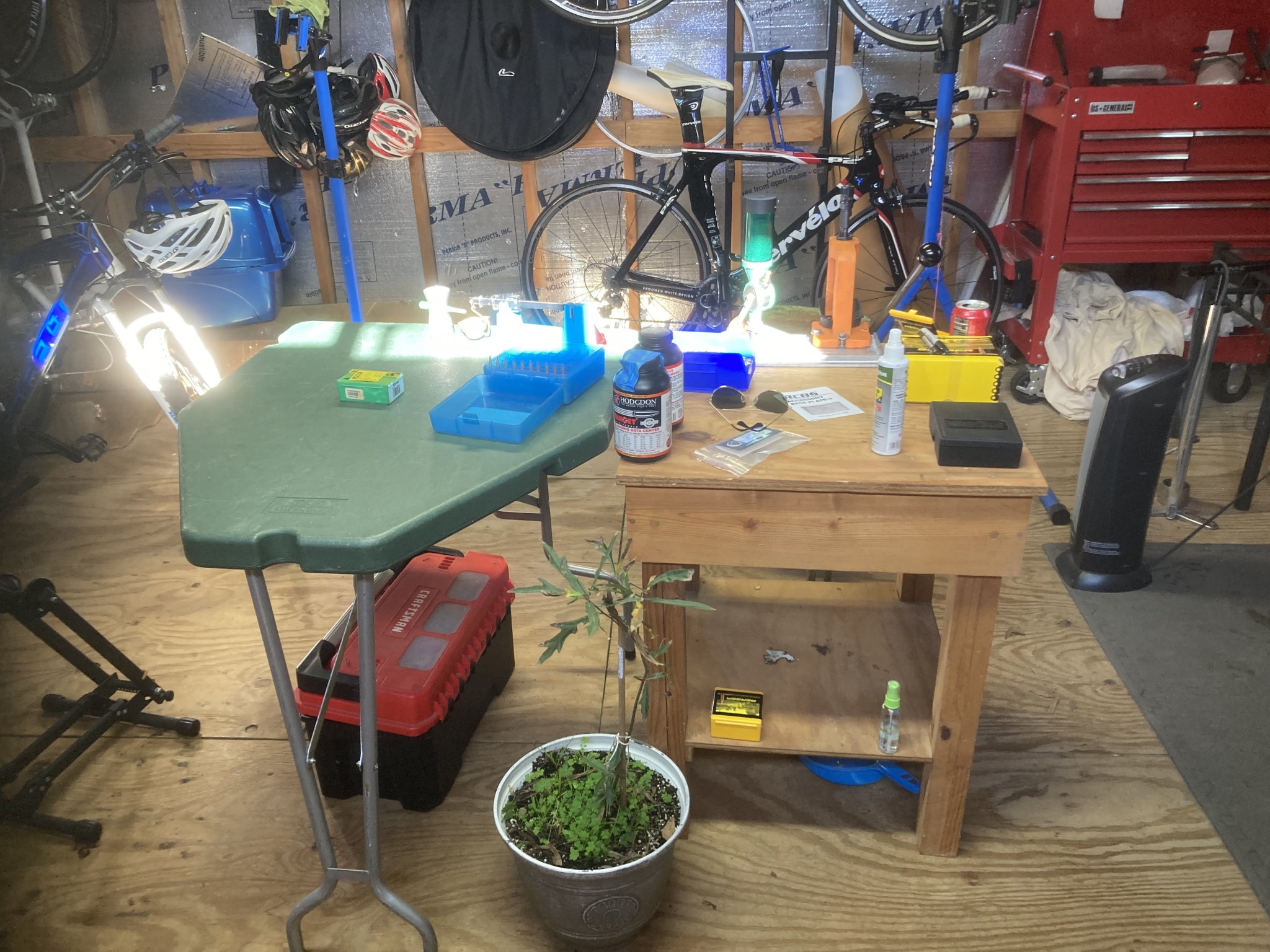

in 2016 when we built the bike shop, I envisioned it being a bike shop and a reloading shop. The lighting in it is good and being a wood structure, it seems warmer in cool, damp weather.
I have a table, I built for my drill press that I am proudest of. Obviously it is the right height for a drill press but a bit low for loading. Still, a nice looking work table. Very usable with a low seat or stool. I am not using my drill press much anymore, so I plan to move it to my regular work bench. then move the drill press table into an open area of the bike shop. Attach an RCBS tool plate and start moving much of why reloading to that area. Pictures to follow.
Might be time to move some bikes out. got some that I simply will not be using much anymore. My road bikes and time trial bikes are what really matter. The old mountain bikes, not so much. IK do have a couple of downtime bikes that I restored. Might be time for them to be a display at some commercial bike shop. priorities
But my first major restoration, I would hate to see it go.

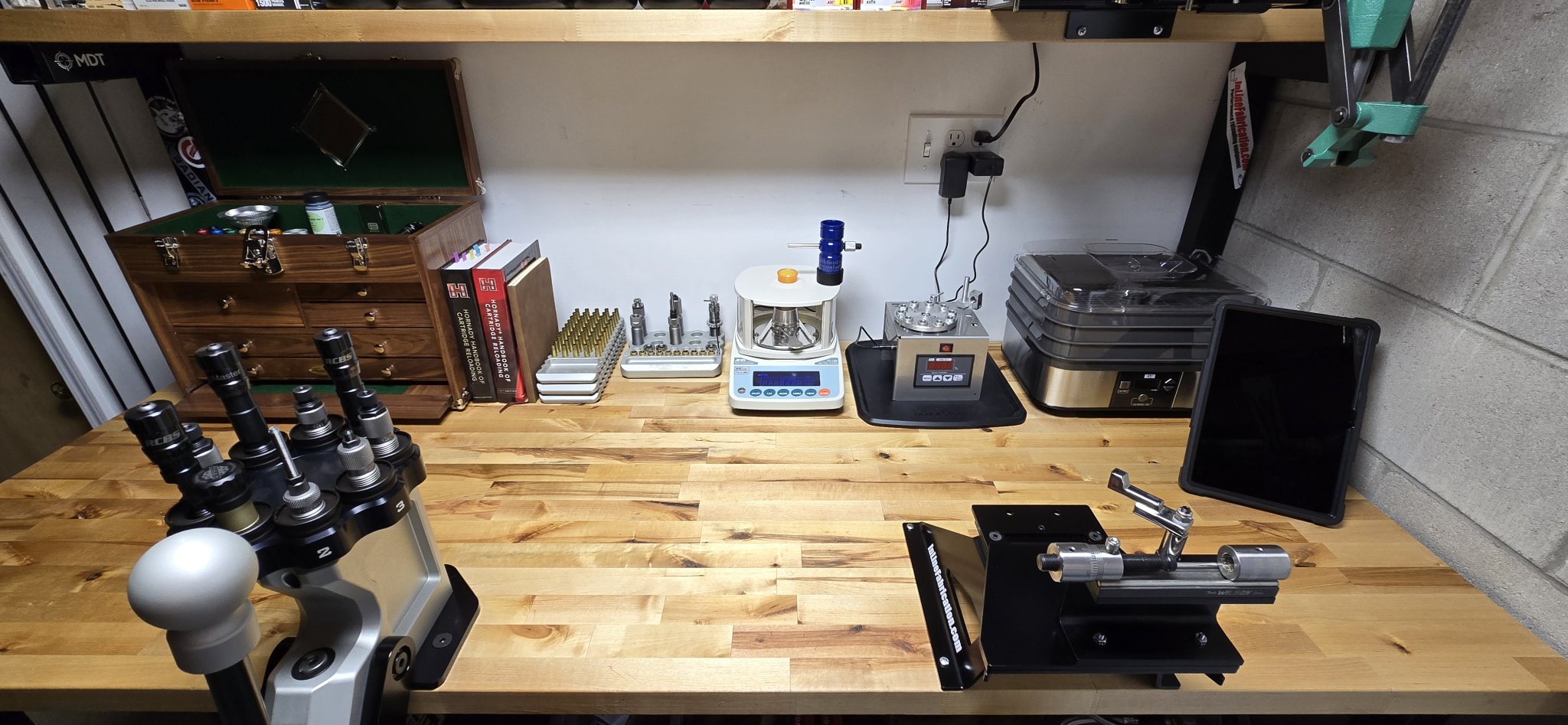

Been 4 years since I posted pictures of mine. (Post #648) And that is where I stopped because shortly after that, prices sky rocketed and things became unobtanium. Now that you can buy things again, I threw money at the bench this past Christmas. So I'll update my bench here next weekend.
