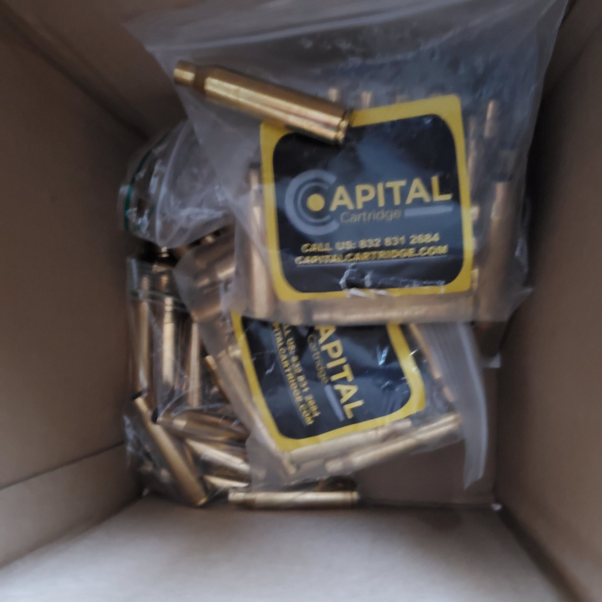

Here's where I purchased some of the 338 Lapua mag brass.
But found a better deal with 300 Norma brass pull downs, at American Reloading.

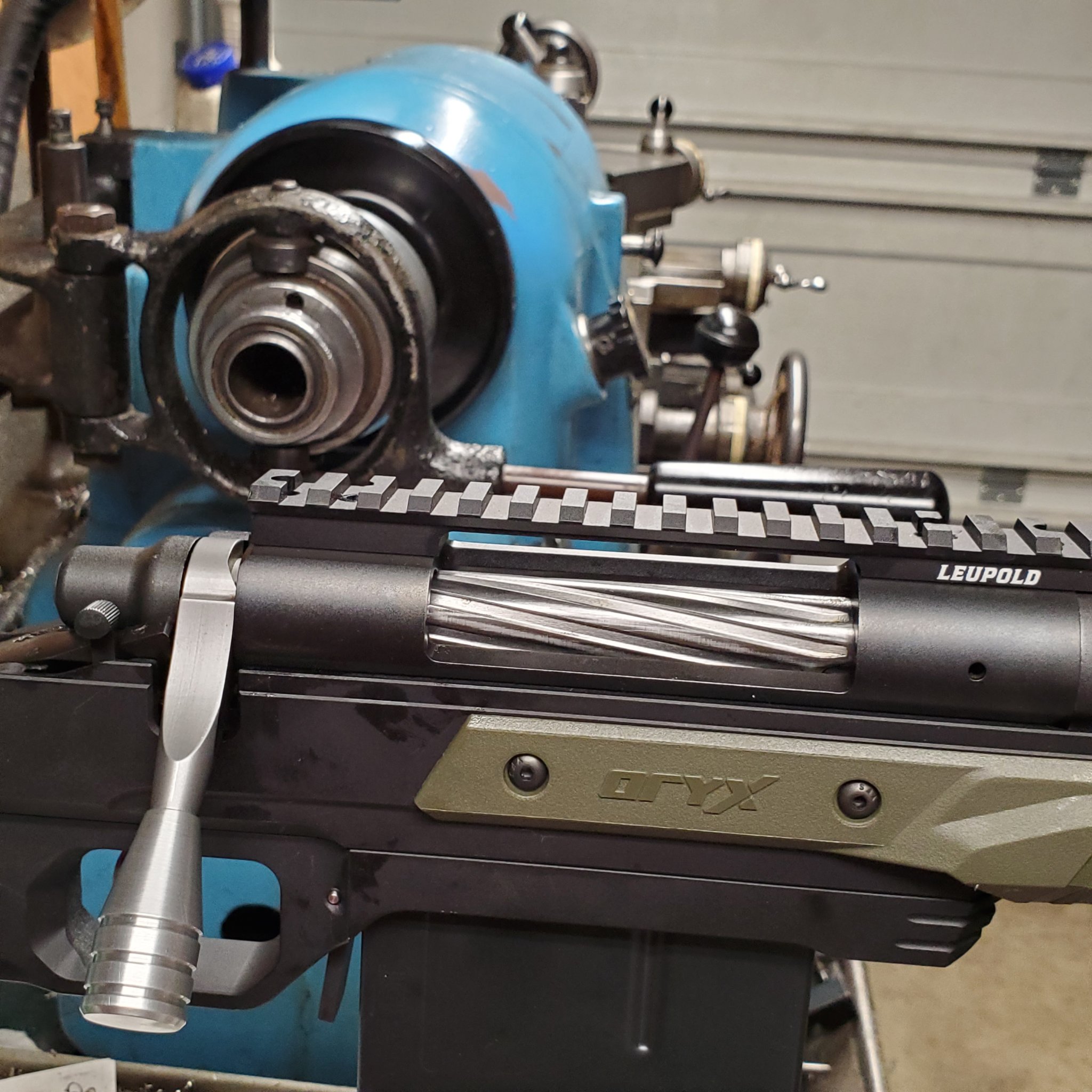

I made mine from the above Rem 700 in 300 WM action $540 out the door for a new complete rifle,... fitted a 338 Lapua Mag bolt to the Rem 700 action, and chambered the McGowen 10 twist .510 barrel, I purchased 2 blanks with fast twists the other is 6.5 twist 338 for the 8.6 Blackout project. Modified a MDT 3.715" mag to fit the alum chassis.

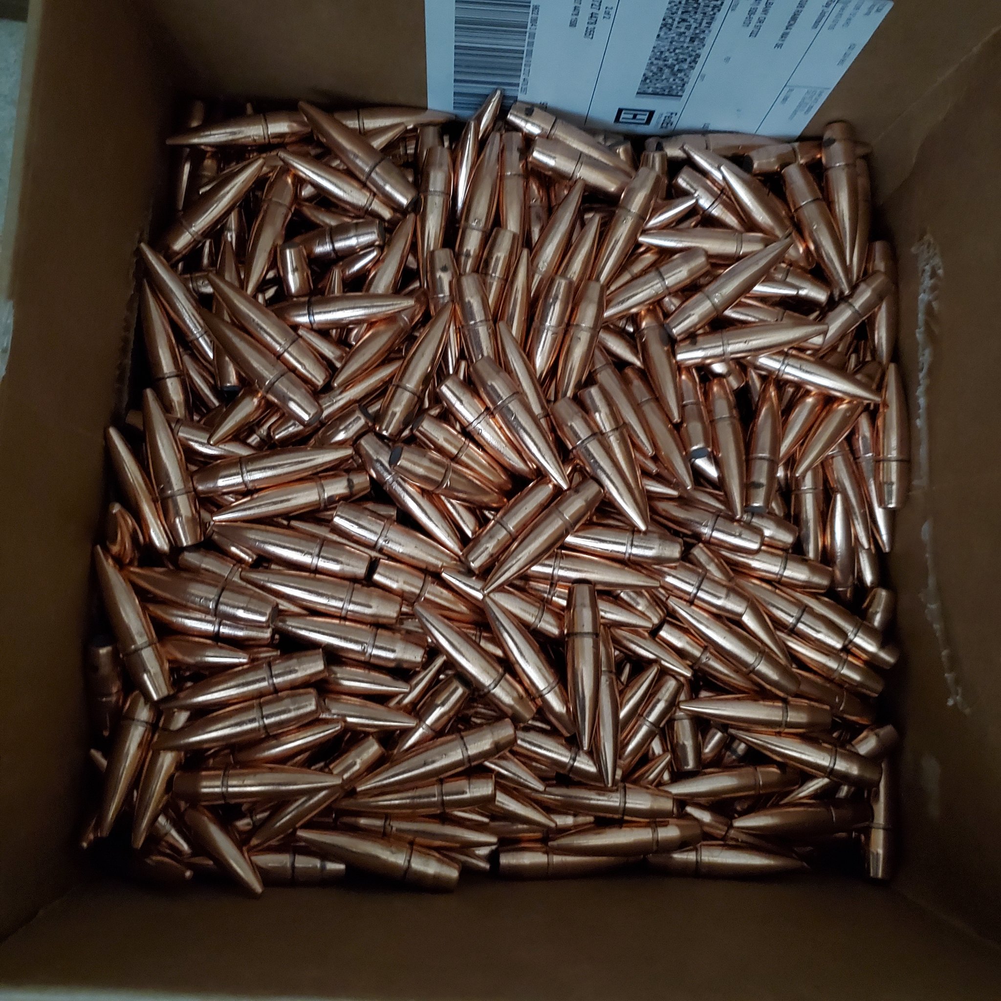

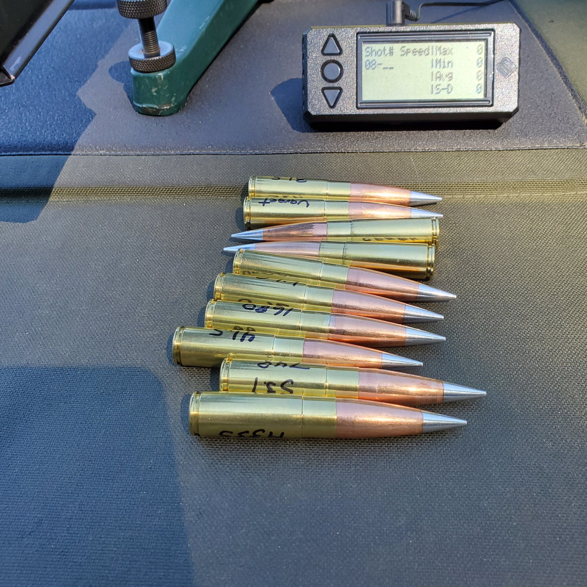

Huge subsonic 1100 fps, 1002 gr bullets only lose 180 fps from 0 to 1000 yds, and arrive with 2000 ft/lbs at 1000 yds.

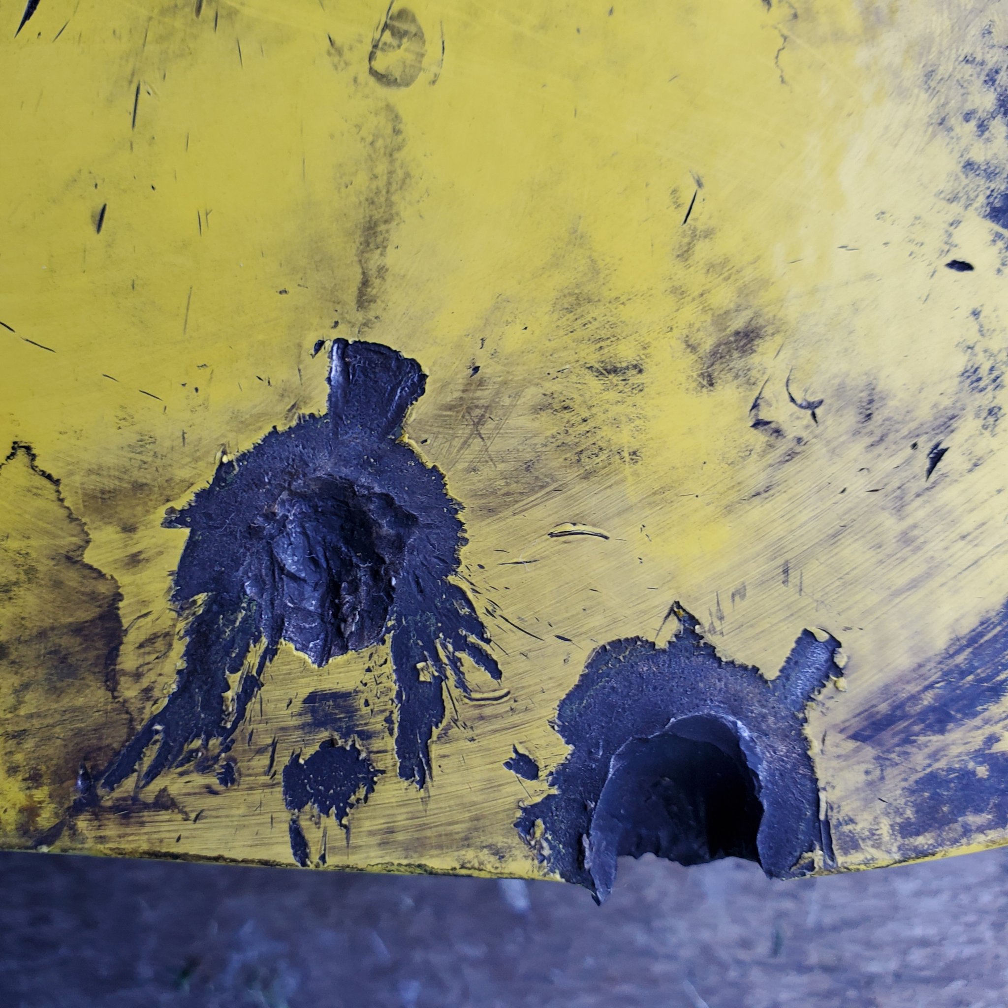

At just 1200 fps to 1450 fps the 620 gr APIT start to penetrate through 3/8" AR 500 armor plate at 100 yds...and detonate on targets at like pieces of 2×4 wood sending them skyward with a flash and loud bang.

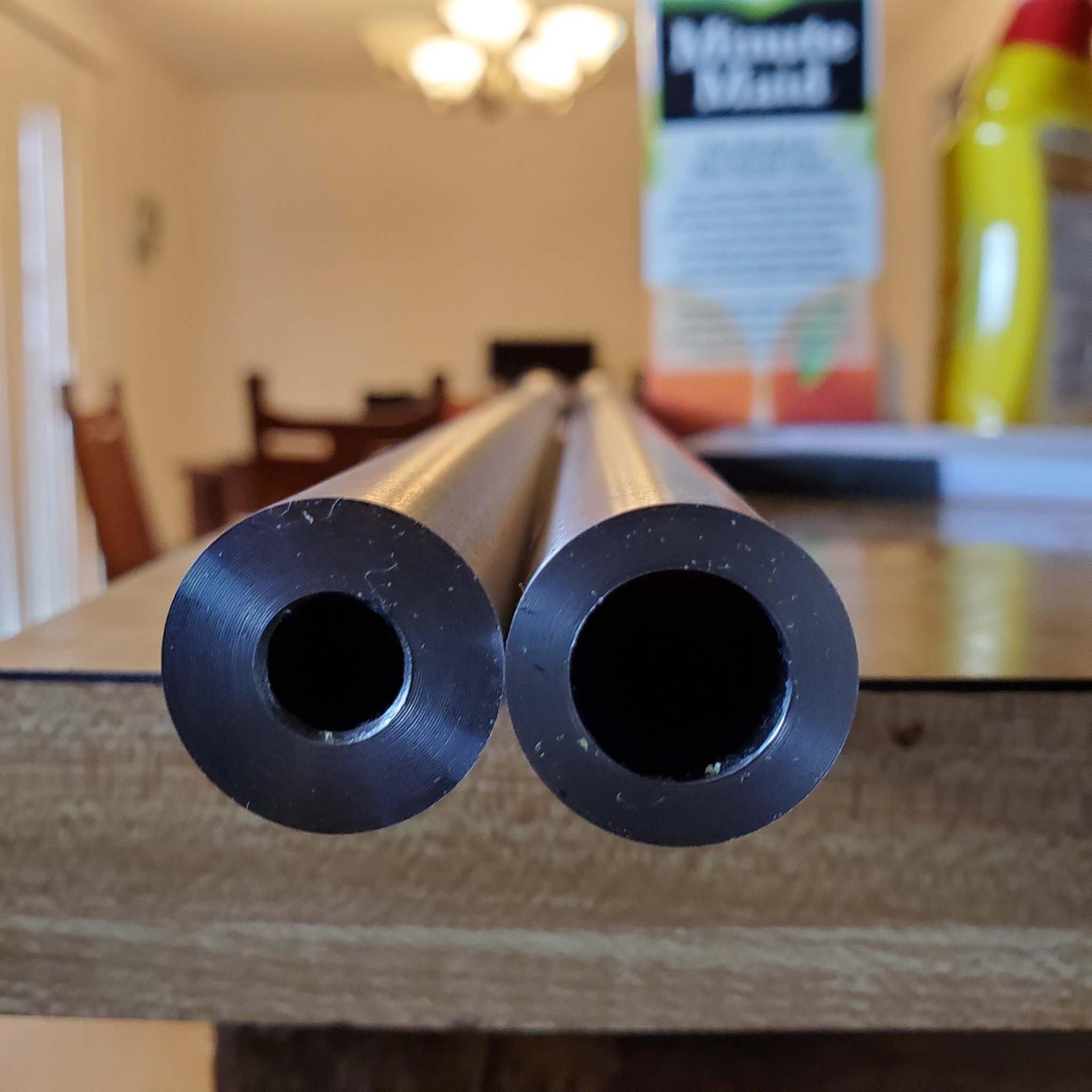

I used my finish reamer to make the cartridge gauge, and to make the brass go- gauge... a gunsmith will be happy to build ya one...but doing it yourself saves1/2 to 2/3 the cost, and no waiting.

Cheap military pull downs around 45 cents ea.
I resize them, so it's actually fairly cheap to plink away.
I made mine from the above 300 WM action $540 out the door for a new action, fitted a 338 Lapua Mag bolt to the action, and chambered the McGowen 10 twist .510 barrel, I purchased 2 blanks with fast twists the other is 6.5 twist 338 for the 8.6 Blackout project. Modified a MDT 3.715" mag to fit the alum chassis.

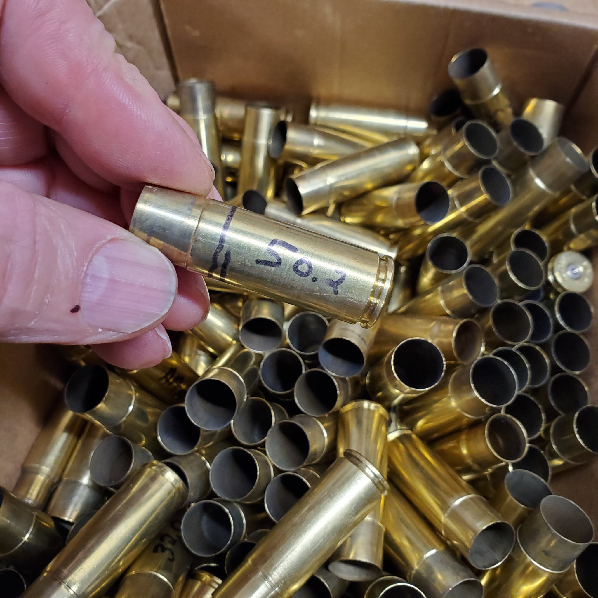

These are fired cases, most were fired in one day, about 150 in this box... quite a few were supers like this 50 gr load...and with the heavy bullet it starts to become an elephant rifle...but no where near my 416 Rigby, and these can be shot from the prone.

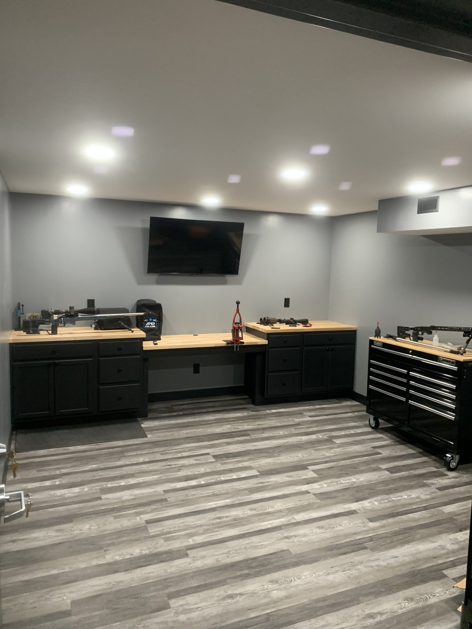

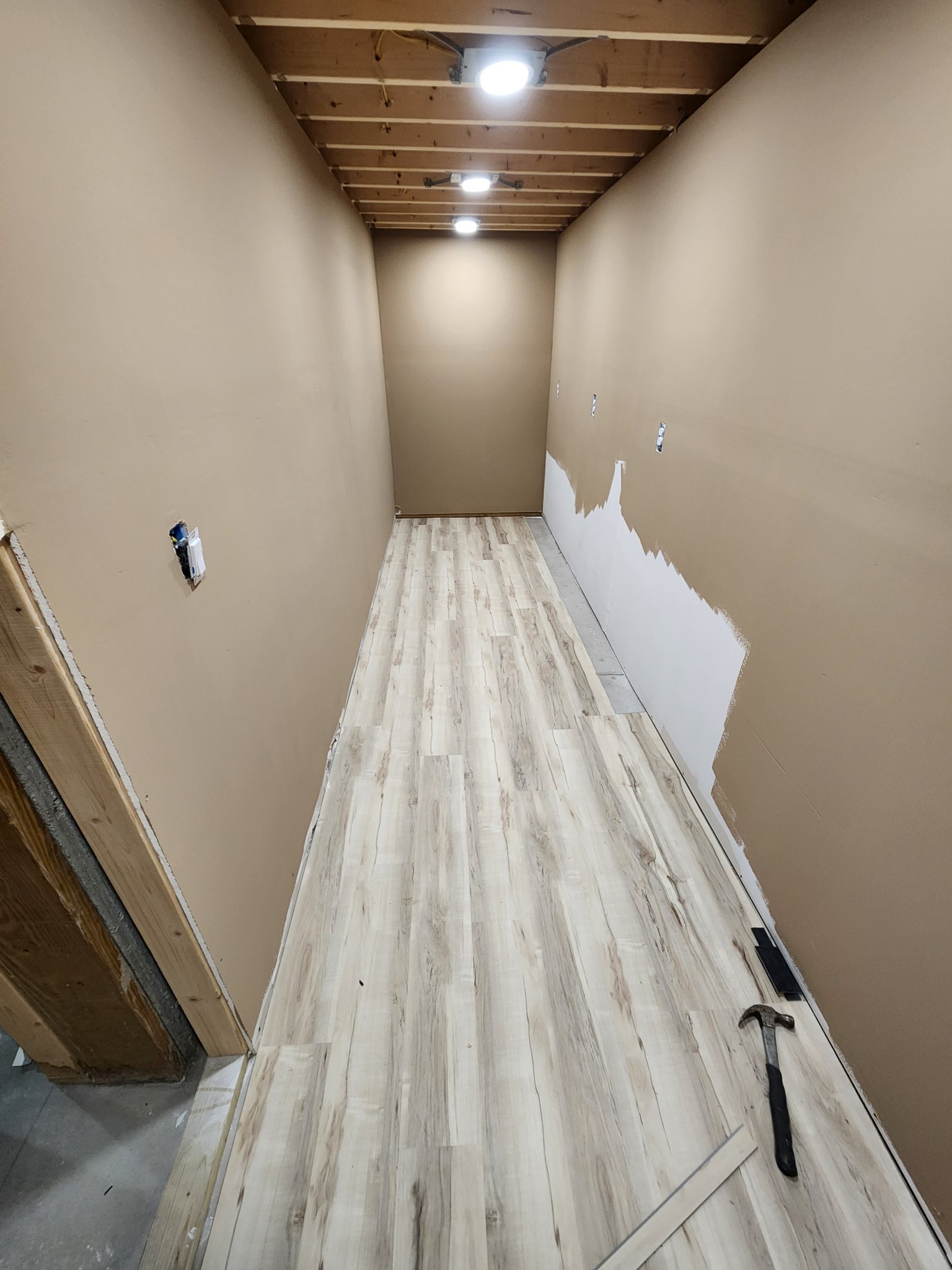

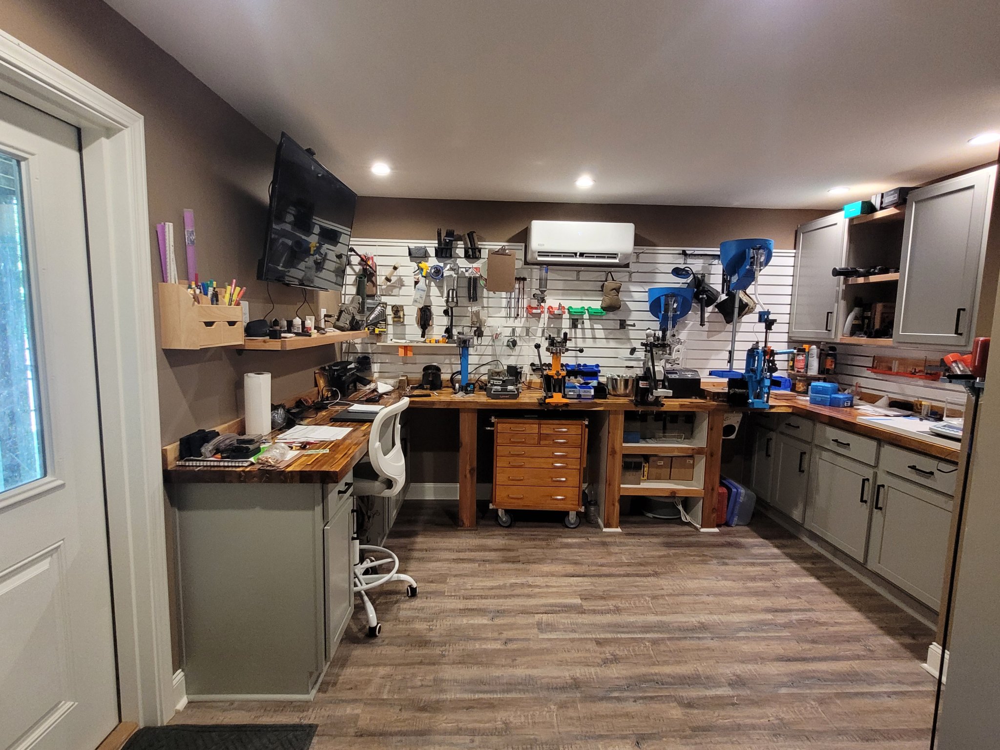

I'm horrible about taking photos while doing a project. I had a 6x20 room made that was going to be filled with dirt when they built my house. It has 8 foot ceilings, poured walls, and a concrete roof. So I studded it up, used some of the leftover banged up drywall from our build and went to town. Installed 5 canned led lights and three outlets. I have some cabinets that were messed up in shipping that I'm going to place where the white paint is then butcher block the top. I plan on putting a storage rack on the other side to hold all the bigger items like hunting gear and gun cases.

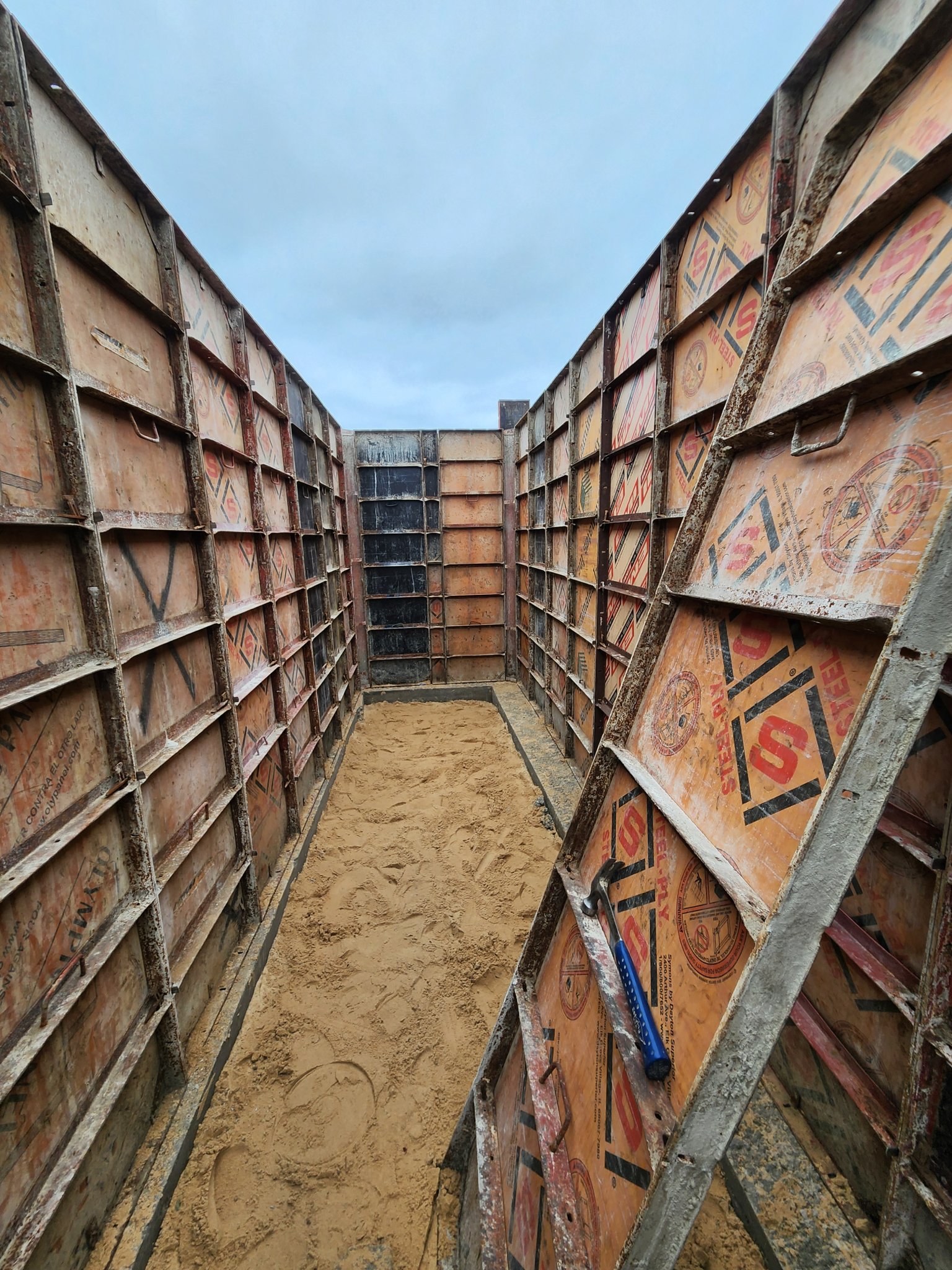

It was supposed to be filled with dirt???
Yup. It was the footings for the house and the entry way that they were going to just fill with dirt then cap with concrete. I thought that was a waste of space so when we set the form, we sectioned off the door port. Then built the walls and roof, rebarred the crap out of it then poured concrete for the entry way.

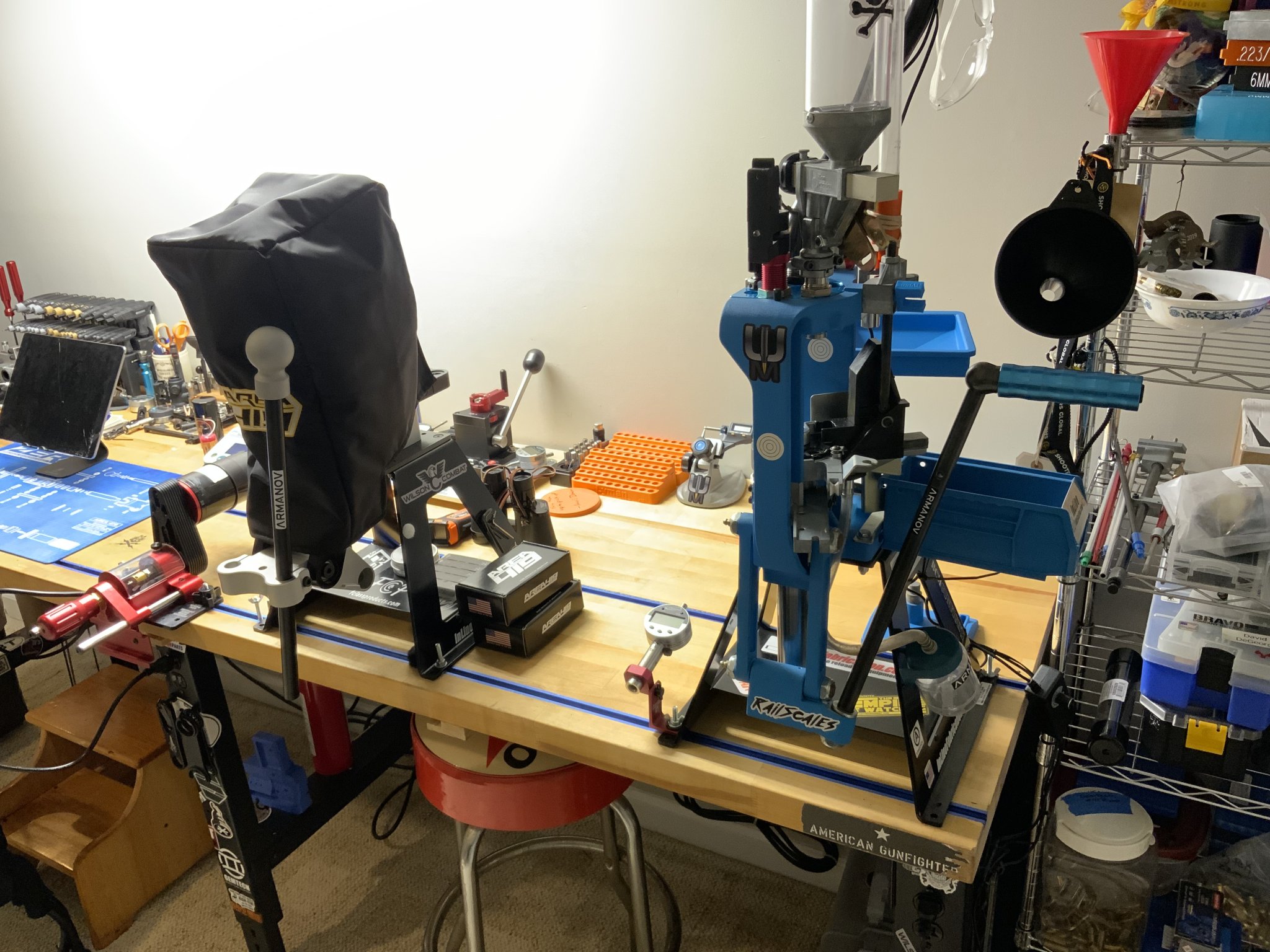

can you share some more details about the T tracks? What is the distance between two tracks and specifications of each track...thanks for the help !
Harry,
Measure all of the things you think you want to mount. Find a sort of average.
Then, you will want to mount your things to a plate or board that is then attached to the T-track.
By finding an average, you won't have one plate be waaaay too big or one waaaay too small. But the plates (or piece of plywood or whatever) can then have a universal mounting distance to the T-track. Plan so that the big thing isn't overhanging too much and the small thing isn't too far inboard.
EDIT: if you have small things, you can mount 2 on one mount and just turn that mount 180 degrees. Actually, you could do a square of the T-track mounts and even mount 4 things on one mount.
DRB

I guess you have to router it in?
Will that work in plywood? My reloading bench is 3/4" birch plywood, unfinished.
Yes, router a dado. You will want to double that 3/4" plywood just because you will want to attach the T-tracks securely using screws. The bottom of your groove will leave in the neighborhood of only 1/4". You could use CDX as the bottom layer, glued (use a glue trowel) and screwed together. Hide the screws by going from the bottom layer into the top layer. Avoid screws where you will be routing the groove. Have the track in hand before you decide to route a groove too deep or not deep enough.

i decided to use t-nut and not a track system as so powder doesn't get in there. now there are a bunch of holes in my work top.

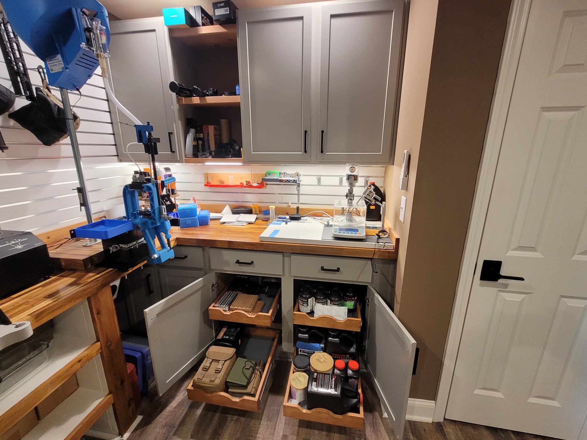

I heavily considered tracks but ultimately decided on using flush mount QC plates from inline Fab. I can swap stuff out easily if I want to and don't have the tracks in the way of my other stuff nor the junk that constantly falls into them. Much easier to keep clean. However, I had room to have 4 of those plates and even another spot i could easily put one. If I had less bench space tracks would probably be the way I went with it.
I found these pull outs to be pretty handy too.

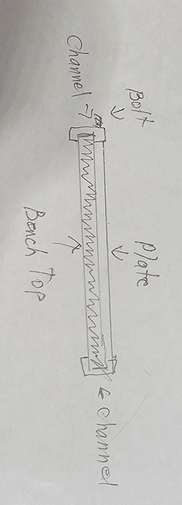

Well, if you want no holes in the bench, mount the reloading press or vise or whatever on steel plates.
Put the steel plate (with the whatever attached) on the bench’s right front corner.
Use strong F-clamps (like Bessey) to hold it onto the bench. Their steel-worker clamps are super super tough. The rear clamp would have to be a deep-throat clamp, maybe like this:

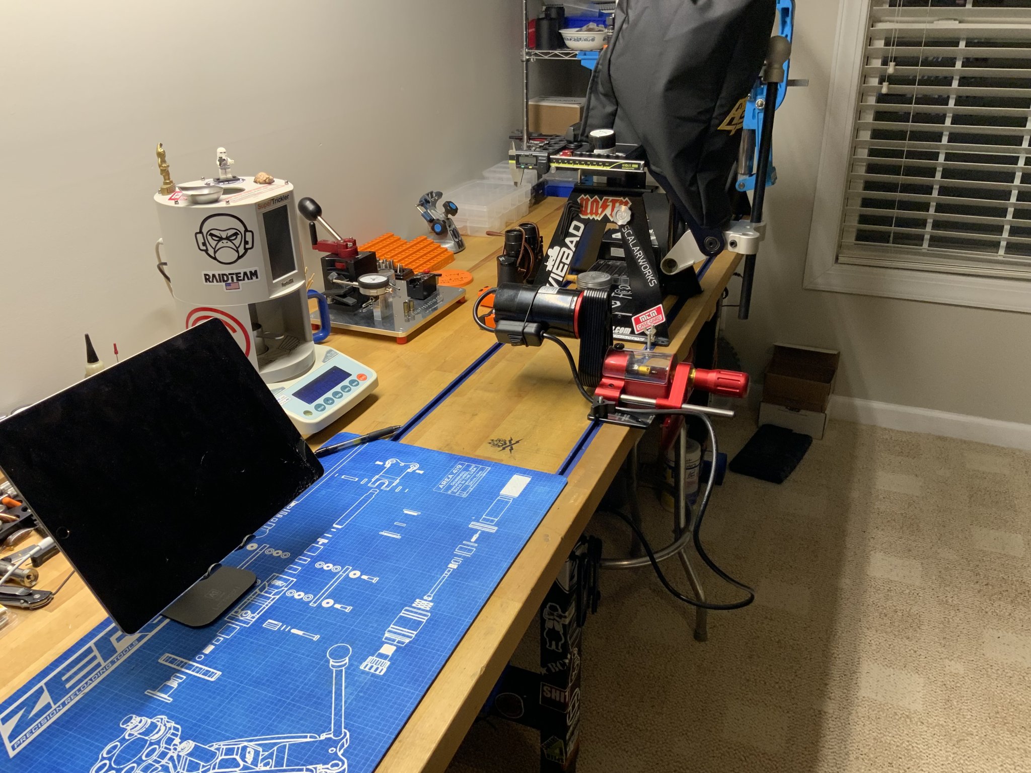

I've used the RCBS bench primer for nearly 10 years now. I set up my benches with the Inline Fabrication quick change system. I have their flush mount, top mount and riser bases. They aren't cheap, but very high quality. Here's a link to their website.
Inline Fabrication
I use and love the inline fab system. With this I’m able to swap accessories when needed. I use it for 4 presses, a regular vise and a barrel vise.
Another advantage comes to mind, if a shooting buddy uses the same system you could swap accessories with him.
You could also have base mounts at the range, in your trailer or motor home.
