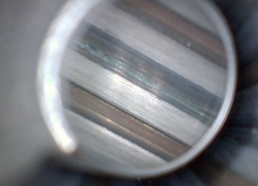

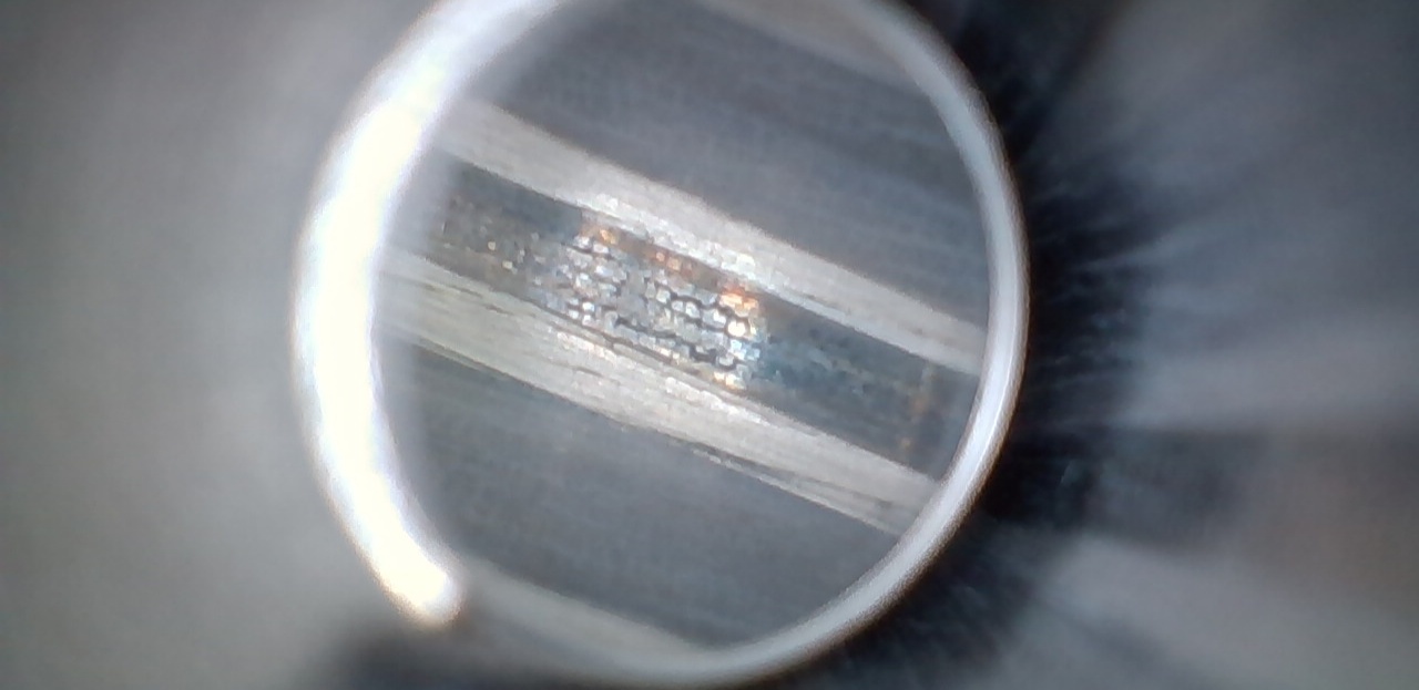

I thought when bullets get smashed onto the lands, that carved distinctive, rectangular, grooves into the bullets. I guess I assumed the wear across the width of the lands of the rifling would be even. The first time I look at the barrel of my Tikka T3X Varmint .223 with my new borescope, I see these stripes of wear down the middle of the lands (photo 1a). Each land has a wear stripe in the middle. It gets more pronounced towards the muzzle (photo 2a). I'm not worried or anything. The rifle shoots great. I'm just curious if this is normal? I mean, the bullets don't wear the lands evenly across their width? Things that make you go... "Hmmmm..."

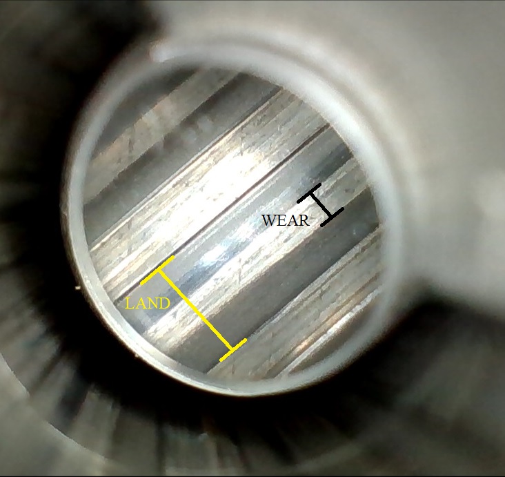

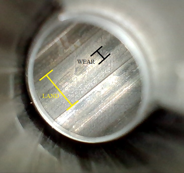

It isn't easy (for me, at least) to show what I'm seeing with the borescope. The captures are stills and it's easier to see what I'm talking about live. Also, the worn stripe is more reflective than the rest of the land on each side of it. On the previous captures, I tried to keep the light off the wear stripe. I also turned the light to its lowest setting to try to reduce the glare off the worn area. I'll include one more capture here and explain a little more what I'm seeing.
In this capture, you can see the whole land, and a groove on each side. The lands are wider than the grooves in my barrel. You can see that the wear "stripe" is more reflective. The center of the image is the angled mirror, but below and to the left of the mirror, you can see the barrel itself. You can see the same lands and grooves there, they are just distorted by the camera. Even outside the mirror, you can see the wear stripe in the center of the lands.

You have it backwards... The lands are the raised portions the grooves are the depressions fyi

So, it doesn't matter, except I'm just curious if someone else who has experience with a borescope has seen the same thing on their rifling. If it is normal wear, why would it wear so unevenly and in such a way? The grooves show even wear, but not the lands. I thought I understood how a bullet deforms over the rifling, but I guess my assumption was wrong. I wonder if someone knows the physical reason why this happens, or if my situation is unique. I was hoping for some enlightenment from the repository of experience within SH. Not a big deal. Sorry to be a bother.
As others have said, that skid looking mark is the center of the groove, not the land. You’re mislabeling your pictures. Yes they all look like that. What would lead you to believe its wear? Run the scope back the the end of the freebore, where the lands start in front of the chamber. This is the area that takes a hammering which eventually kills the barrel.

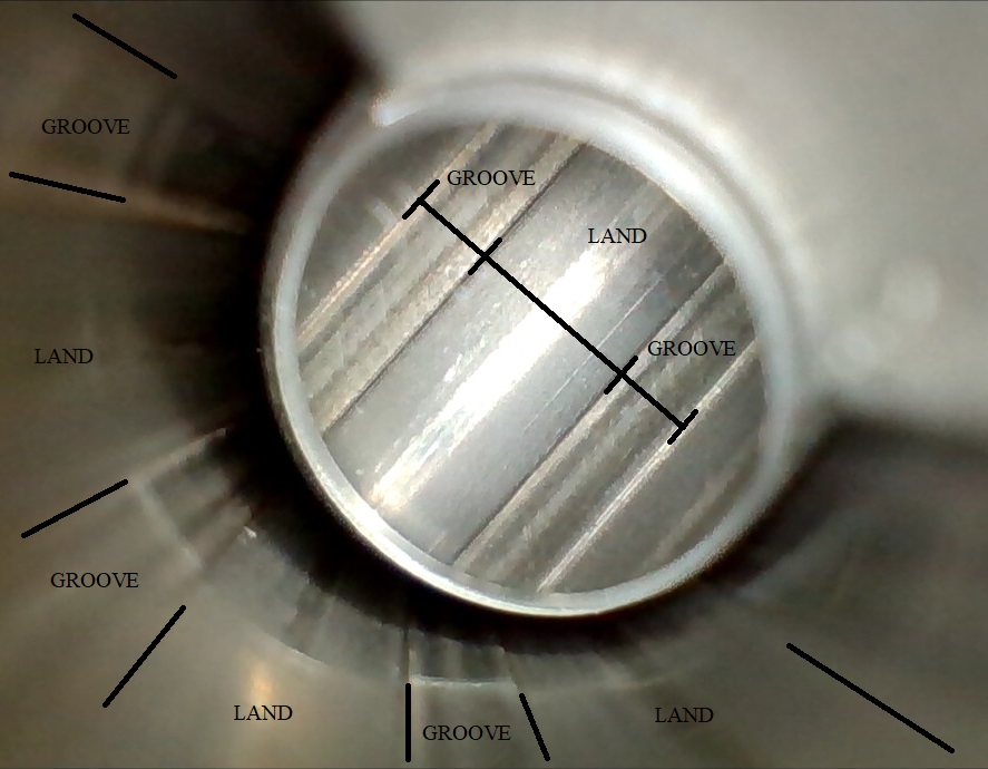

When I'm wrong, I'll fess up to it. I looked again, and you are correct. The area I labeled as the lands, are actually the grooves, and vice versa. When I look at the borescope even now, I still see it reversed. However, I chased the rifling back to the leade and I can see that the narrower areas are the lands. I learned something here and it is appreciated.

So, if anyone would hazard a guess, and then I'll leave this topic alone.... Why is the center of the groove more reflective than the area on each side? Could this be part of the manufacture of the barrel? Could it be uneven wear - that the bullet presses down with more force in the center of the groove, polishing it like I see? Something else? I get that this is normal, and I'm really not worried here, I'm just curious about what I'm seeing.

Okay, on to your question. Yes, the answer is this:
The bullet deforms from original diameter of .224” to help fill the grooves as heat and pressure form the base to fit.
