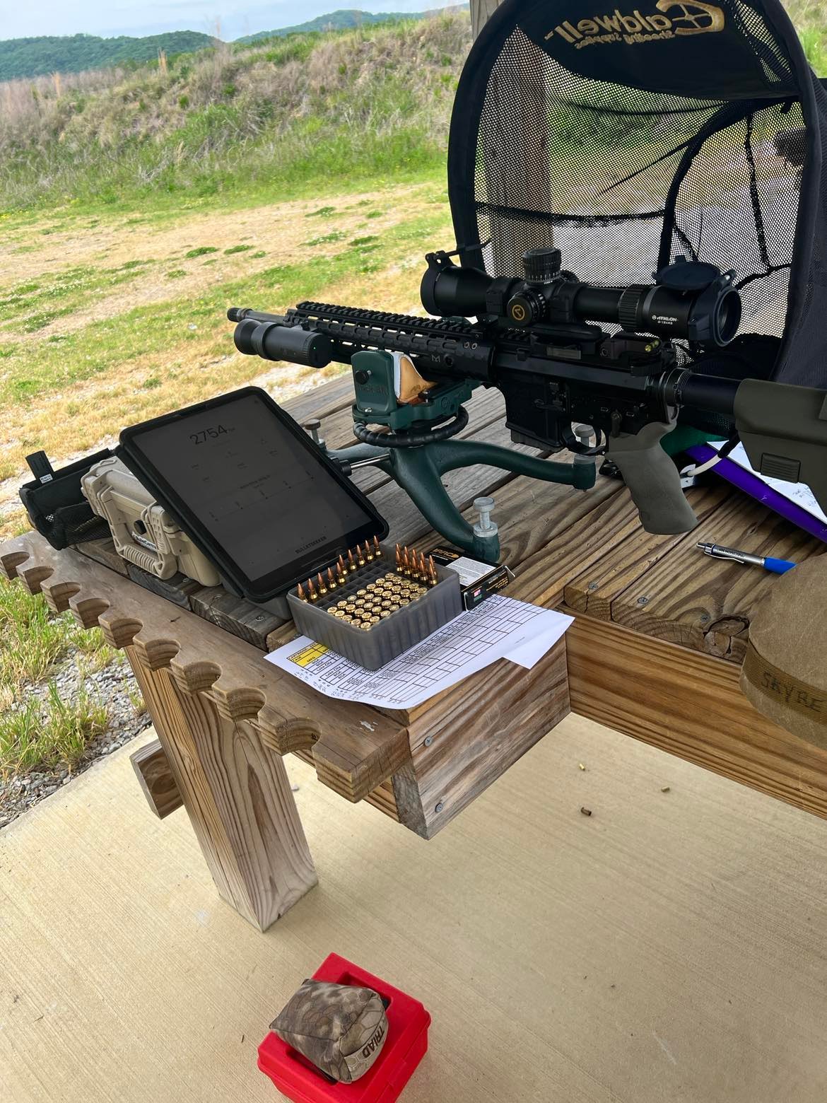

Received my BS4 this past week and went out Sunday and spent three hours doing load development on my LR.308. Had to put a small picatinny rail at the 9oclock position to hold the BS4. First shot – nothing. I was not going to admit this, but it was my fault it did not pickup the first shot (I put it on backwards). Did not miss a shot after shooting 90 rounds of load development.
NOTE: Ensure you set the setting in the switch off after (sec) to enough time. The factory setting is set at 300 seconds. I switched mine to 3,600. Will probably set up to 10,800 (3 hours). After 3 hours on it being on, battery was still over 50% charged.
The only thing I had a problem was the quick discount would come off after maybe a dozen shots (recoil maybe to much). I do not like the quick discount mount that came with it. Looking at finding something better.
Then I hooked up my magneto speed V3 to it and test velocity test on some extra ammo I had on hand. The BS4 was anywhere from 10-15 fps slower than the MSV3.
Really like the APP (had it on my iPad). Recommend installing app on something bigger than a cell phone (easier to read and keying in the information). I was smart enough to set all my strings (13 in total) ahead of time with the relevant information (i.e., Load information).
Nice thing is after shooting, you can go and review everything.
Recharging the MS4 took less than 1 hour. Next time out I will take a battery pack and see if the MS4 will function with the battery pack attached to it.

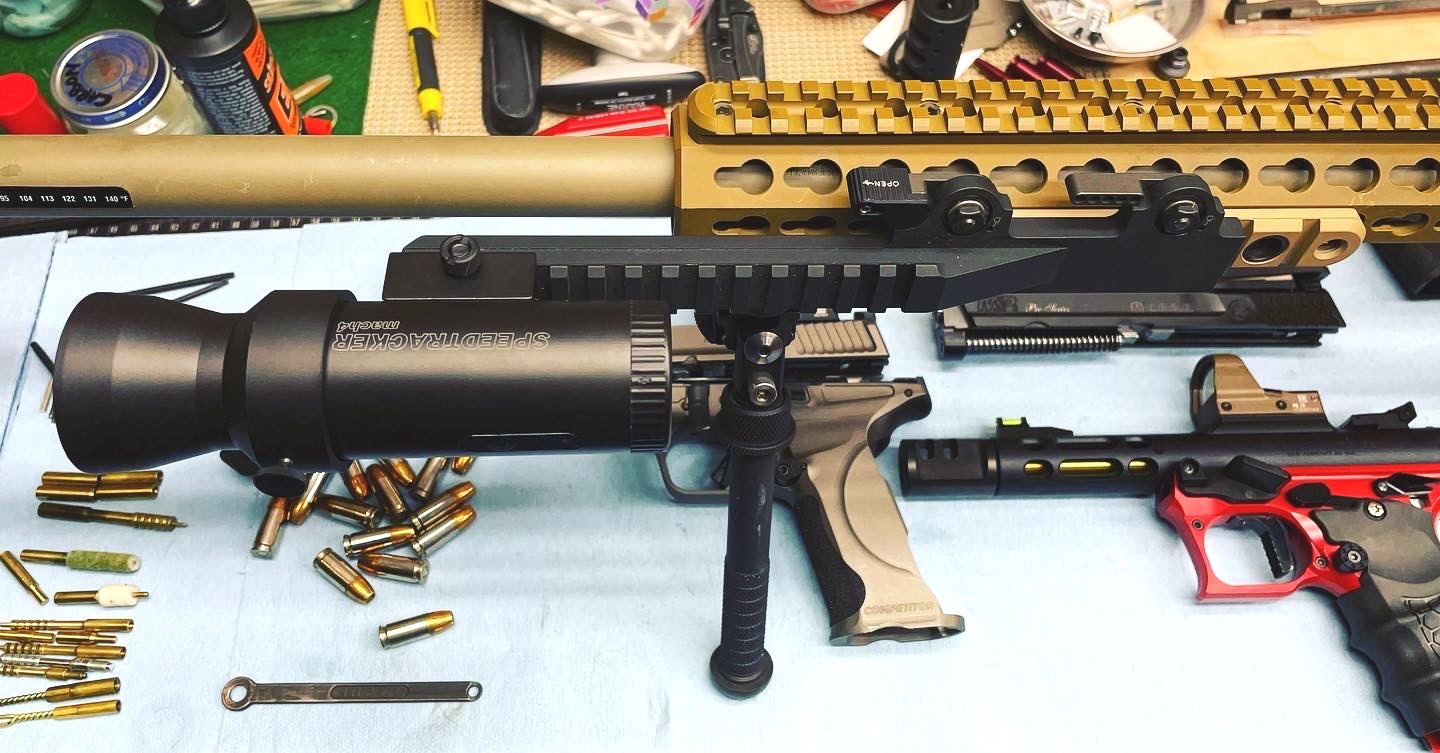

I am making some accessories for the speed tracker to extend the utility, will post once i test them on the new unit.
* am also a Speed tracker distributor so might not be unbiased:rolleyes:

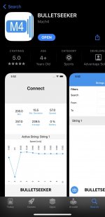

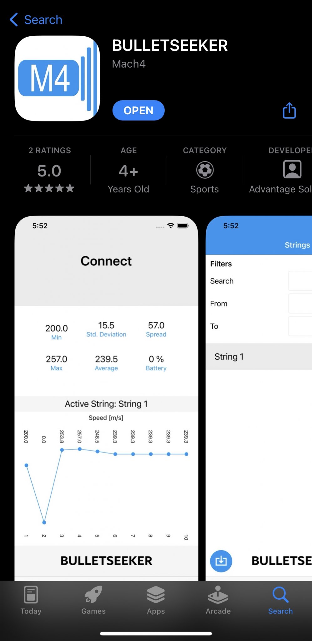

App is called SpeedTracker Mach4 and looks practically the same as old Bulletseeker app.

IF you are using a BULLETSEEKER. Please use the M4 BULLETSEEKER APP with ANDROID devices.
IF you are using have an APPLE product with iOS you can use the NEW SPEEDTRACKER M4 App or the previous M4 BULLETSEEKER APP
For SPEEDTRACKER, ONLY use the new M4 APP on both Android and iOS devices.
The NEW M4 App for SPEEDTRACKER also works with iOS on BULLETSEEKER.

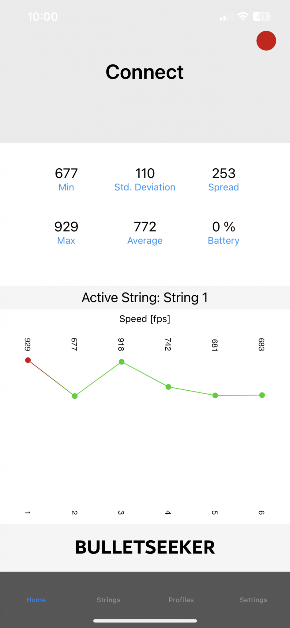

I set mine to measure some center fire .308 and .338 lapua magnum. I got abysmally low MV. Like 700 fps. Went home and tried it on my ruger precision rimfire. Got over 800 fps.
Going to go to the range again to try getting measurements again.

I took my BS out to the range last Saturday and it gave weird readings for my 5.56 or .338 Lapua magnum. Like 700 and less fps. It did pick up my friend’s RimX shooting Wolf .22lr. And had SD of 10 with fps over 1k

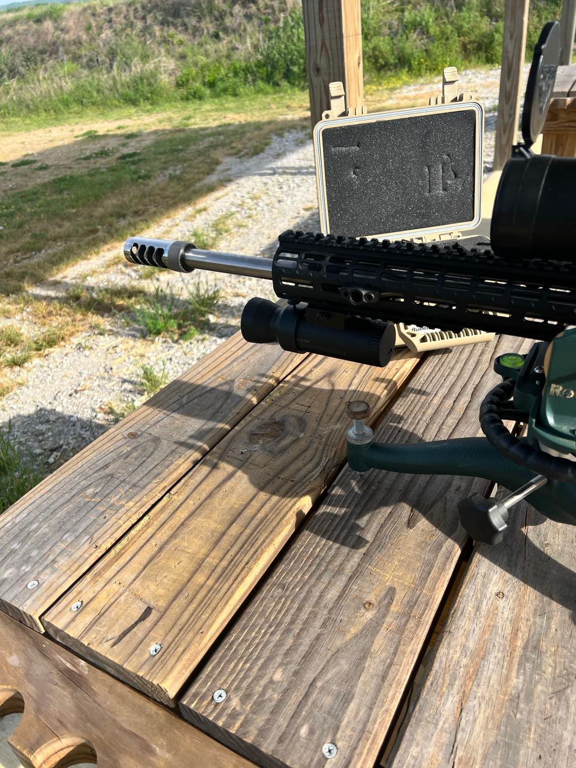

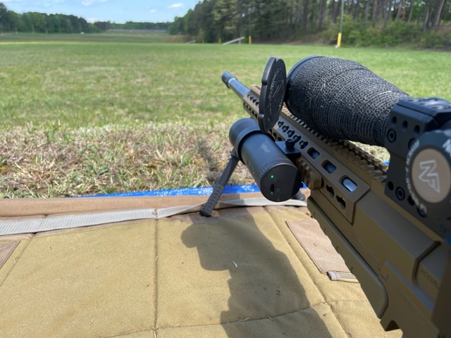

First picture shows the BS4 mounted under the handguard of a .308 AR-10 (PIC Rail).
2nd Picture shows the BS4 mounted on the side on the of the handguard on a .223 AR-15 (pic rail).AR-10.jpgAR-15 mounted on Pic Rail on the side.jpg

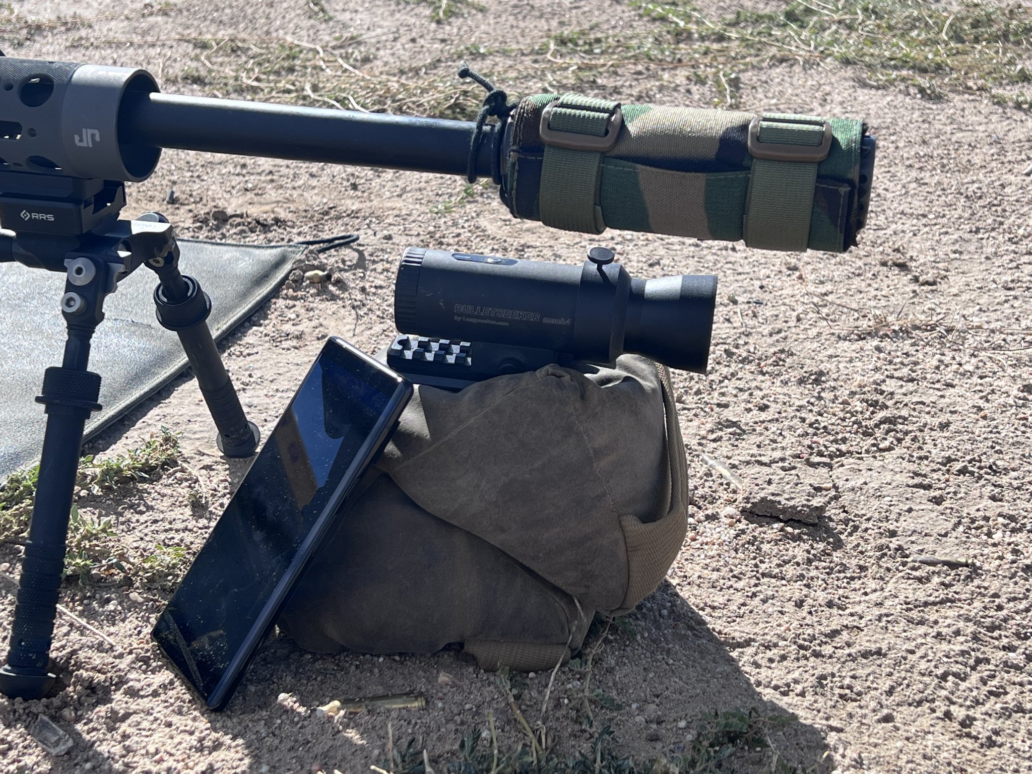

I used a friend's unit out at Quantico last weekend and was very impressed, even though the unit was mounted so far back due to my rail setup that we were only getting 40+ detections with the 300PRC. Decided to order one from Midway Monday (which was a bit cheaper than from SSD) and it arrived today. Hope to have it out for testing and use shortly. From the stock sticker on the unit, looks like Midway received the unit on 4/14. Unit is number 03532 FWIW and came with firmware V2.8.
For those with longer barrels and missing attachment points, you can do other stuff like putting a tripod under the barrel and what not, really simplistic stuff to get the unit in line with the shot
This method worked well, and you can do the same thing with a tripod. I thought I had a picture of it, but putting the rifle on a tripod and then the bullet seekers on a tripod under the barrel was pretty good too
