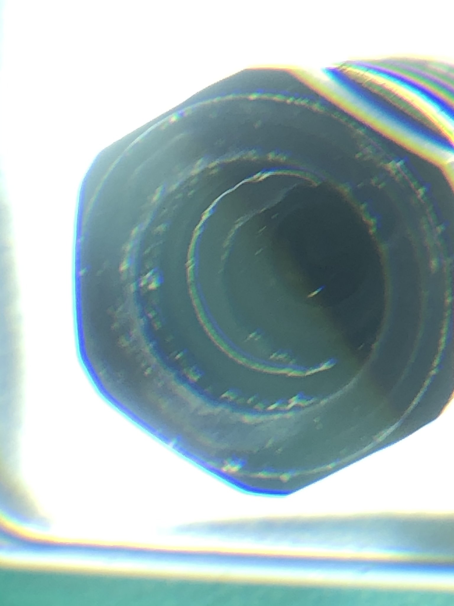

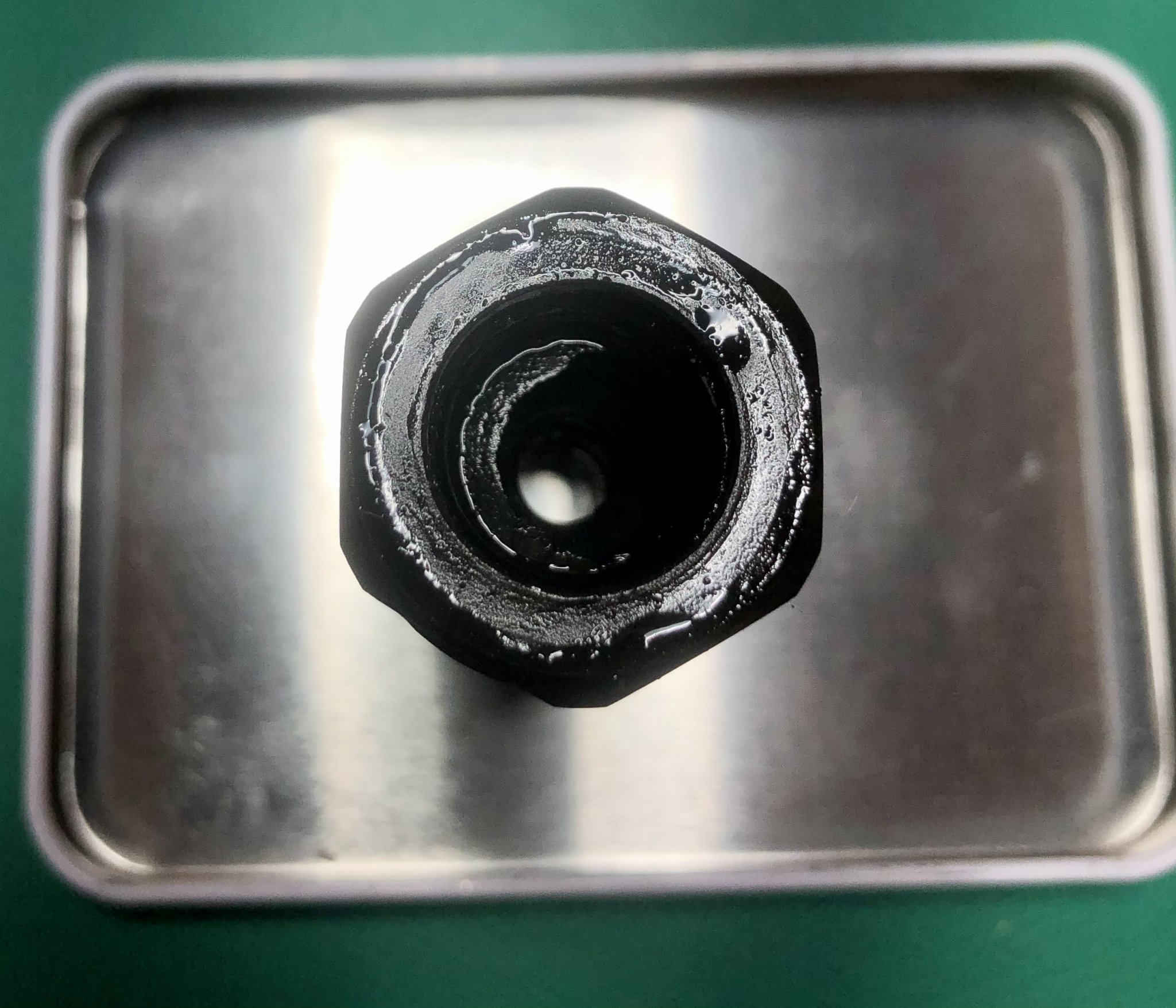

I realize this is an old thread. Have some useful pics to share, i think:
MPA DN3 brake (newer version) on an MPA in 6.5 Creed shooting mostly mild loads of H4350. Thick (0.1”) chunk of hard baked-on carbon from 5 to 12 o clock position, pressing against the crown.
Probably installed this new brake about 6 months ago, so maybe 500 rounds without taking off the brake. Obviously waited way too long. 😊 Reason/excuse: Have a separate barrel tuner on the gun (which works very well), so i was reluctant to take it off, wondering if when reinstalled it would be in exactly the same spot as before. A tiny change in tuner rotation makes a big difference yo group size. Managed to get multiple groups in the 0.1-0.2” range with 135 Atips after tuning exercise. Recently the gun went back to shooting 0.3-0.5” groups with the same load. Maybe this was the cause... i guess carbon buildup deflected the gas preferentially in one direction.
Question: Have you guys seen this before? How often do you take off your brake? Best way to clean it (eg dunk in CLR)? I used an ultrasonic cleaner, same home made solution i use for brass cleaning, and it worked ok.

Amazing photos. Makes your skin crawl.
On your center fire rifles, how often do you take off a brake and clean it? I assume if you never ever clean it, then at some point bad things will start happening!
I am starting to think that dunking the brake plus the last inch of the barrel in CLR might help, and leaving the barrel upright in a tin overnight might help, then take the brake off completely every 200-300 rounds.
Also wonder if an ultrasonic cleaner will do a good enough job cleaning the brake and the crown - without ever removing it... 😊

My other brake did not cause a lopsided buildup of carbon. Pretty evenly fouled. This one did not have a symmetrical buildup at all. All on one side, and there was a lot of it.
Will go shoot both rifles, and see what happened to the zero of the two guns.
Will be interesting to see if groups have opened up or not, and if the tuner will need adjustment...

Have done a quick test: CLR works well to remove carbon from a stainless steel brake and a staiarrel.
But CLR is NOT safe to use on blued Chrome-Moly steel barrels or brakes that have been melonited. It discolures the steel.
So beware: Do not use CLR on any of the blackened steel components. CLR is good for all the shiny stainless steel components.
you're just soaking the whole brake in CLR? Safer than "the dip" method?
Erik Cortina posted a video about soaking a stainless steel brake in CLR overnight. Works well. But CLR is not safe for anything except stainless. Ask me how i know that.

Btw i removed the brake and after stripping off a fair sized chunk of hard baked-on carbon in front of about half of the crown, and then putting the cleaned brake back on (as best i can tell at the same thread position), the 100 yard zero changed by 1.2 MOA.
Very much doubt that the carbon removal changed my zero that much. Must have mounted the self timing brake at a different position.... probably one thread less or more than before. 🙁
Anybody had the same experience?
