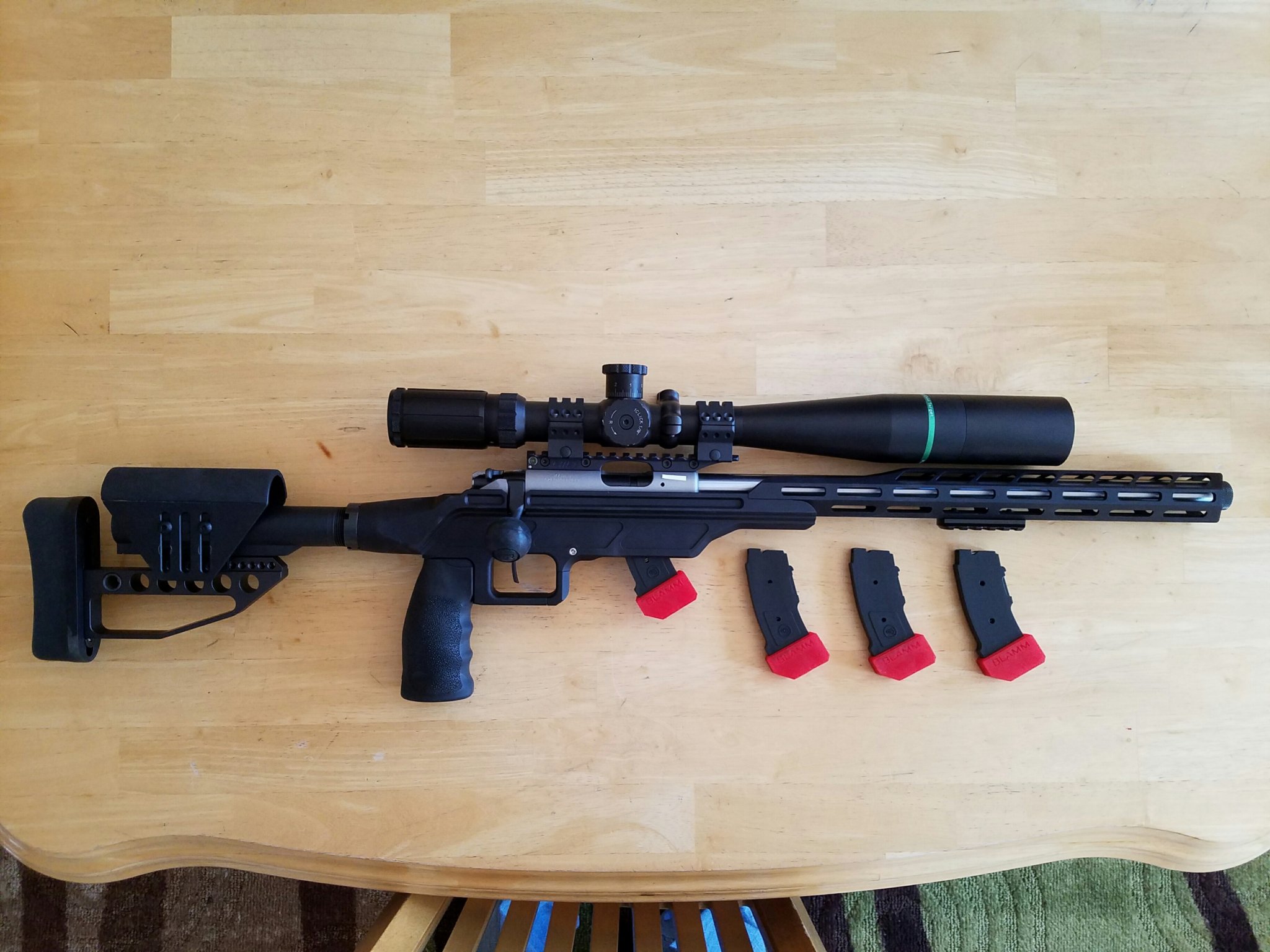

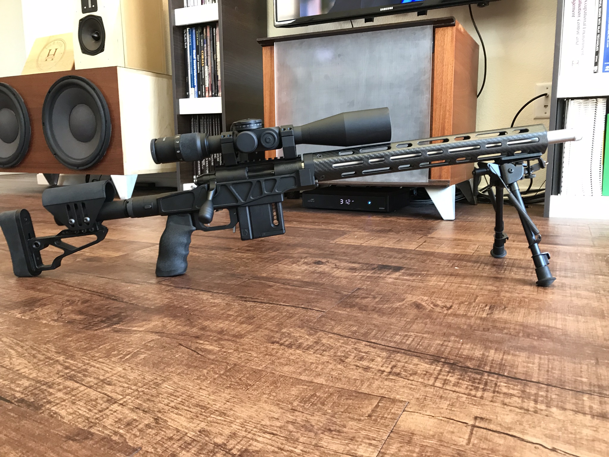

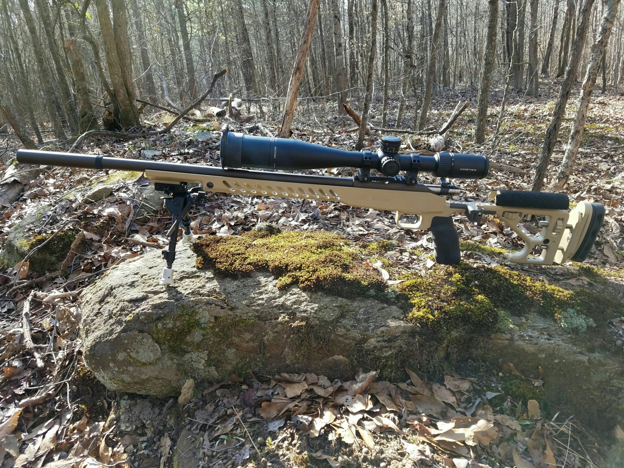

I went with a Rigid Alloy chassis

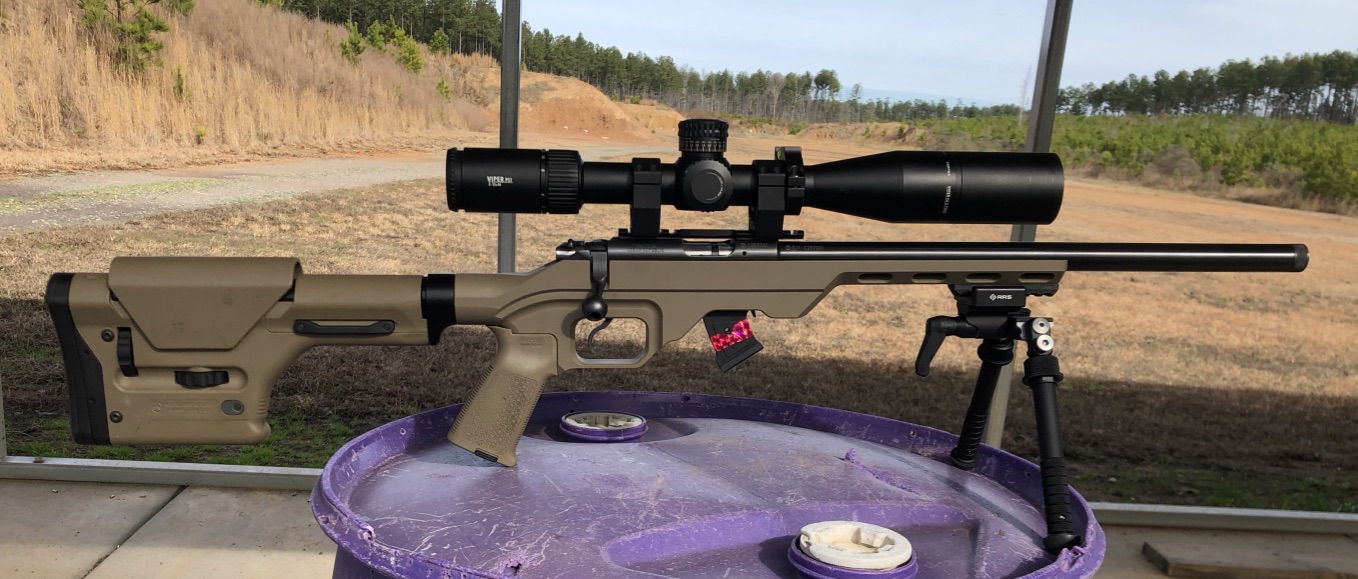

Here's a photo of my 455 in MDT LSS-22 chassis with Magpul PRS buttstock. Grip is standard AR-15 (Magpul here). I am willing to sell the chassis/buttstock; just haven't gotten around to making much effort. If interested, PM me and I'll give more detail and a price (which I don't have off top of my head; probably $450 +/- for both).
Ergo vartical overmolded. Seems good but I like it. Firs this chassis better than my go to Hogue fingergroove type. I'd like to try a MDT vertical style sometime also
Excellent, thank you. I have a regular A2 style but wanting to try a vertical with fingergrooves. Just placed an order for it

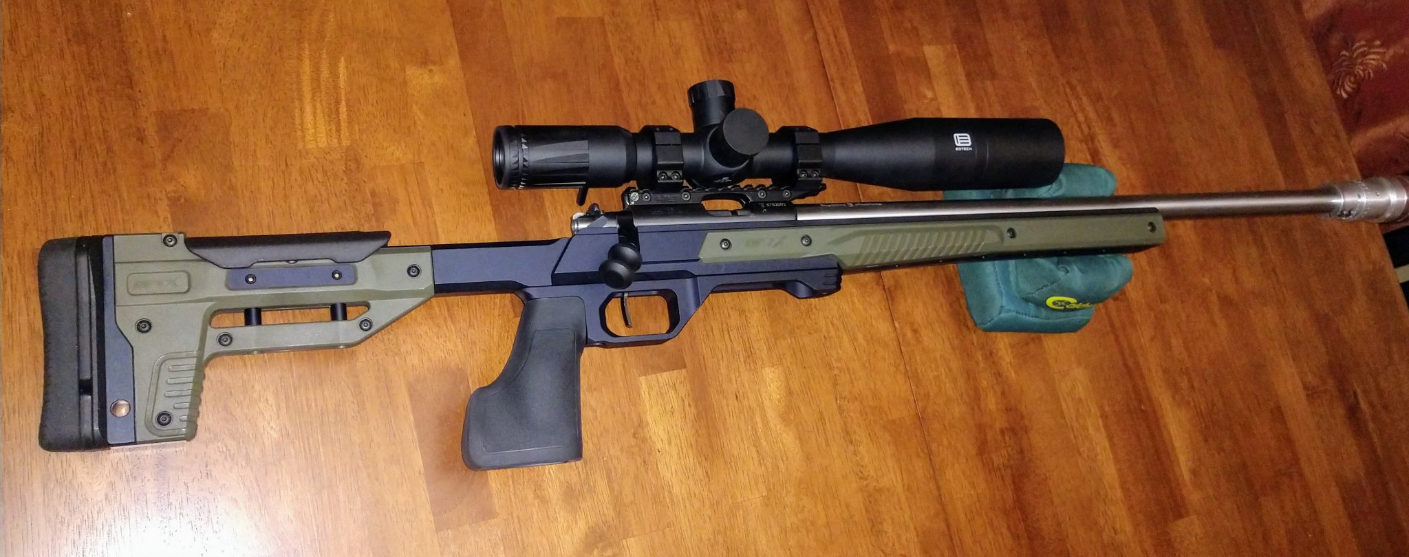

Check out the MDT Oryx. I have one on my 455. They have an Arca rail that fits the angled forend and the price is great. I really like the Rigid Alloy too. A lesser known one is Indian Creek Design MoFo chassis with a machined Arca foreend. I have a KRG Bravo on a Howa and I like the Oryx a small bit more.

this has to be the only photo or place ive yet seen the 455 in the oryx chassis. how are you liking it. aesthetically i like this best out of all current options for the rifle. its currently in the OEM thumbhole stock that love the look of but hate the feel of.
been lurking here for years. had to sign up because i finally have a question.

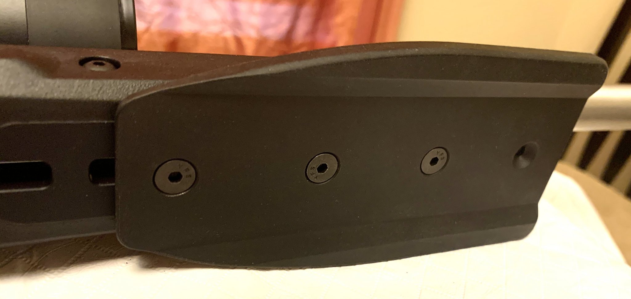

I’m still loving it. The only minor faults are the lack of a folding option(just to make cleaning the bore a little easier) and I would prefer the foreend to be completely flat. I had to do a little work to get a M-lok bag rider to fit. I recently added front and rear bag riders for a bench setup and it is very comfortable. The standard grip is nice but the TLC grip makes it perfect. It has remained rock solid.
i like the fact the stock is fixed, no moving parts or buffer tube to deal with. all i care is that it can take a harris bipod. how is the balance, i never go to a gun range and shoot on private property. most my shooting is standing, kneeling, prone or using my offhand to rest against a tree and support with my forearm.
I’m not sure how the balance would be with a regular barrel. It’s definitely front heavy with the 24” barrel on mine but that’s an outlier. Good point on the folding stock. It’s a solid piece of aluminum front to back.
May I ask what front bag rider you used. I just ordered a ORYX for my rifle. I did some searching and really didn’t find anything I liked. I have a co-axial front rest and want to use a 3” flat bag. thanks,
GG
GG
I have the XLR M-Lok one. I had to mill off the front M-Lok tab so it would sit flush, but that will never be visible and won’t affect anything if I use it on a different rifle. I could have added a screw to the front hole and used the sling swivel hole, but I wanted it flush with the front.

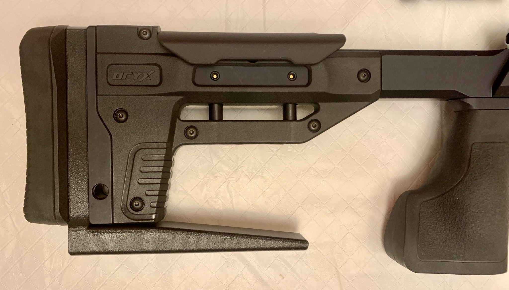

did you paint the removable pieces. if so can i get a full view or it. the OD green or whatever it is, has been part of my conflict of interest as id rather it all black
I bought the black panels and like how it looks much better, I’m not a fan of OD green. I read here or somewhere that they take Rit Dye well, which I could have done in hindsight.
well i was torn between having a stock imported or the oryx for only $50 more. now seeing it in all black my mind is made up. wonder if i can order it without the OD green if i contact them. One more thing, is that a 455 in the photo. if so what trigger is that. i love straight blade triggers
It’s a 455 with a Keystone Accuracy barrel. The trigger is a Scar 2 stage. It is probably the best feeling 2 stage trigger I’ve used. It’s a true, safe 2 stage that I beta tested a while back and have been using ever since. It’s set up at 6 total ounces right now and breaks like glass.

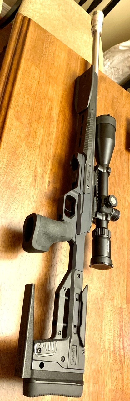

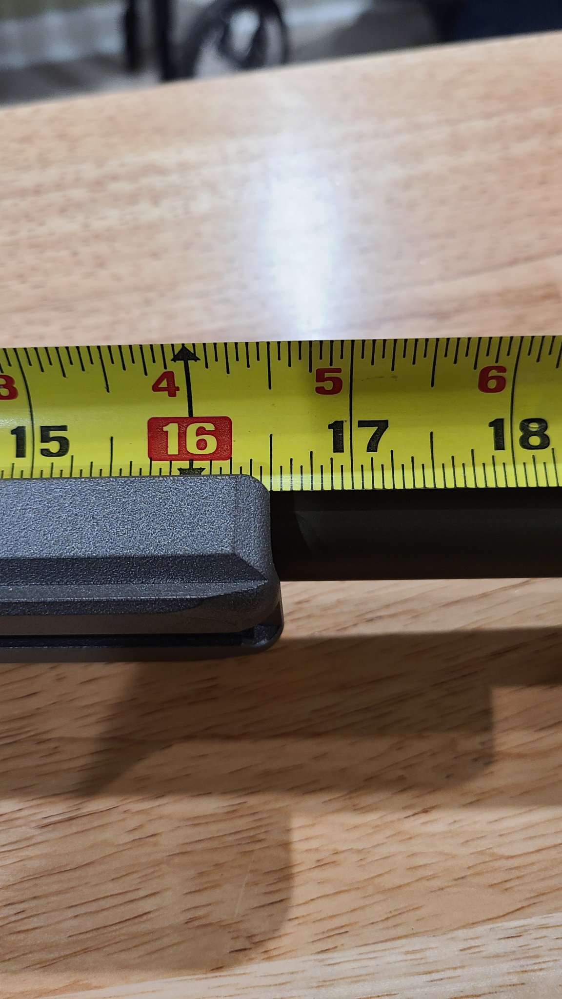

Appreciate the quick response. Looks like an 18 inch barrel would clear by ~1.5 inches. How do you like the chassis and what torque do you have action screws? Not sure if any are provided with chassis - video I saw on one indicated no specs were provided.
I think I have mine at 25 in/lb, but it's been so long since I screwed with it, I don't remember for sure. Either way, it's worth playing with different torque settings on the front and rear action bolts and see if you can get any differences out of the groups that way.

I like it and it's twin which is a centerfire chassis. I built it as a rimfire trainer that mimics the other one but since then, for various reasons, I have begun to shoot rimfire more than center fire.
If your going to use this as a PRS/NRL22 set up I can give a couple of tips from what I learned. Biggest issue is balancing it.
If you're changing the barrel use the heavier choice. That barrel is an .850 dia. I should have got .910. The one in the Pic has all the bells and whistles for adjusting the butt stock, that's awesome but you'll have to counter weight the forearm to offset all that steel hardware. So save money and get the more basic butt stock.
As far as action screws, their included.
As far as torque, experiment, find what yours wants rimfires can be picky.
