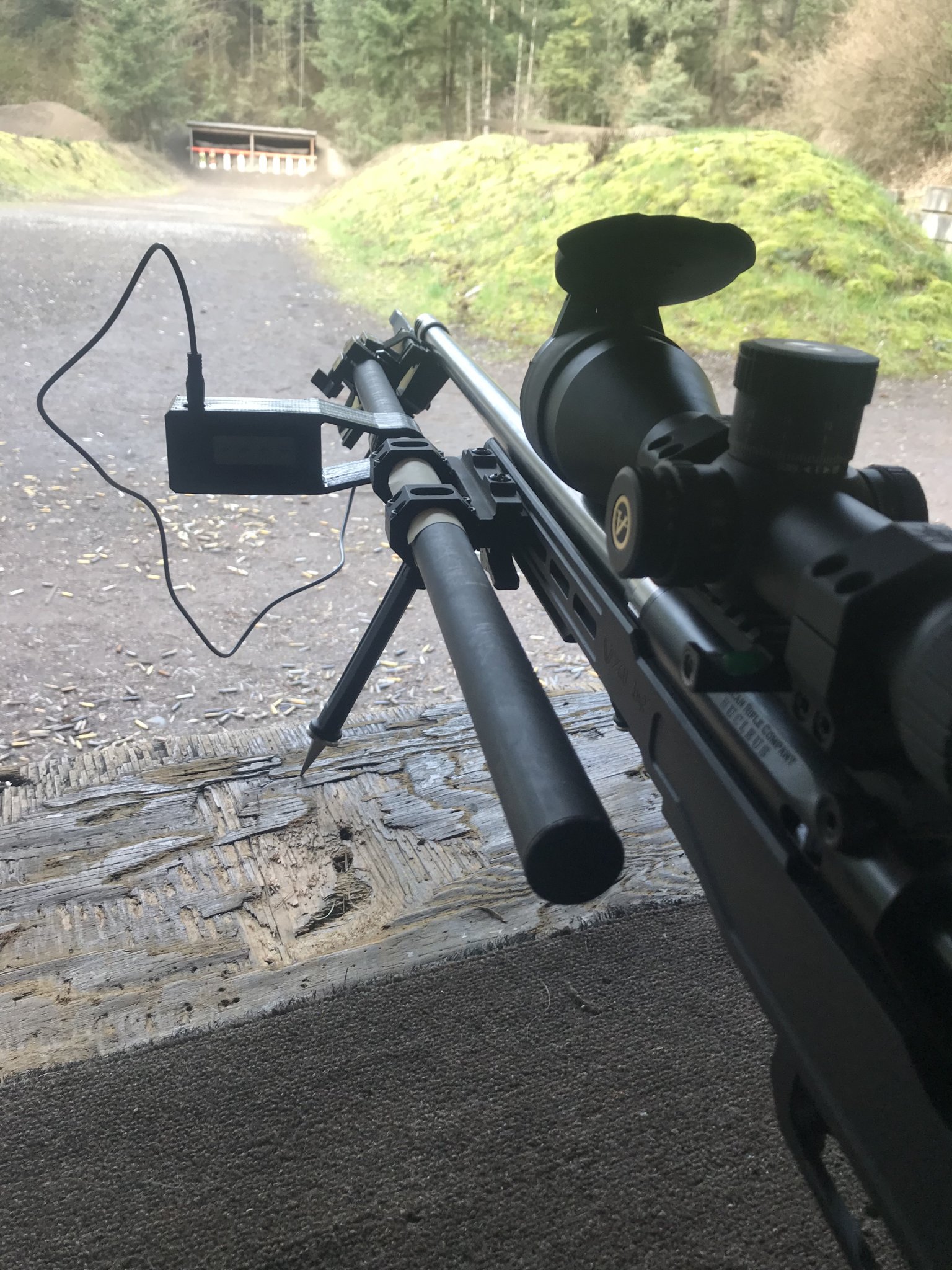

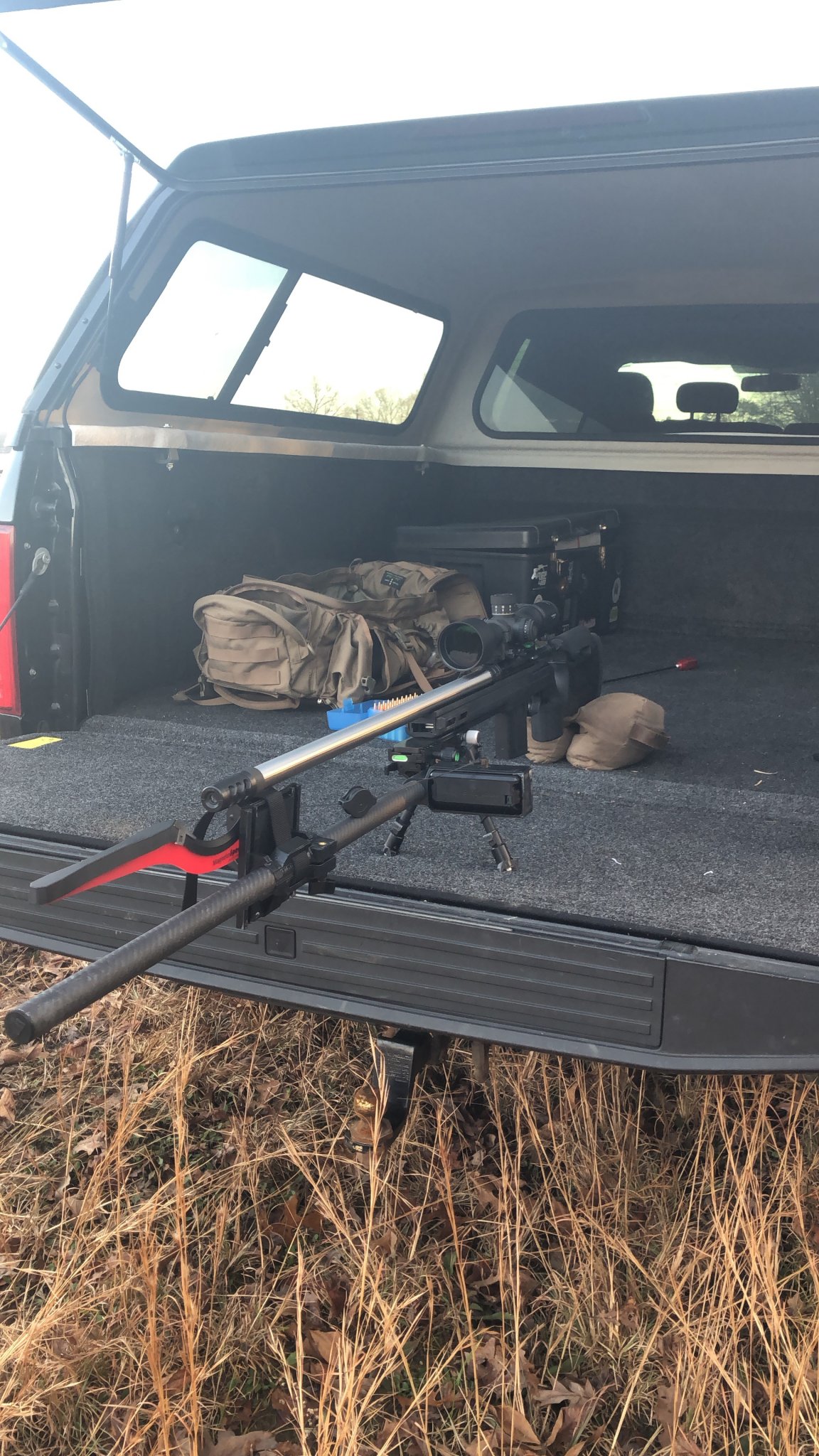

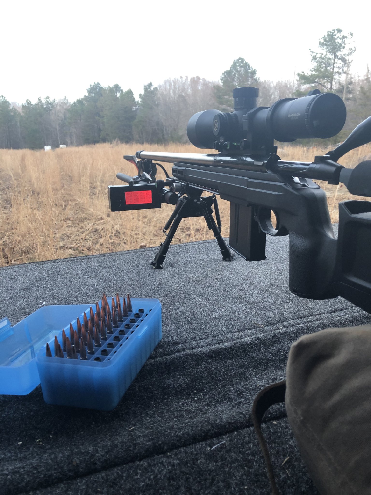

magnetospeed v3 with wiser mount
easy on and off - no POI shift to worry about. can use it anywhere.
