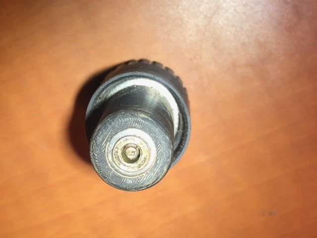

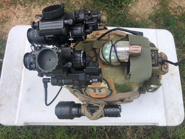

About 3-4 years ago, a friend and I made some COTI plugs that run on USB batteries. I went through all my pics and I don't have a good pic, maybe I did a while back but I don't now. And all my plug related stuff is packed in boxes, since we're moving.
Here's a crappy pic. I'll make a better one, once I get a chance. They do work fine in the field, I've got two of them and have used them for years.
We made about a dozen for "friends and family". And we have the solid works drawings files. What we need is someone to print the parts. If you think you can print the parts, PM me and we can discuss. The first step would be to make two prototype sets of parts, then send then we will assemble and test. We'll repeat that if needed until the testing is successful and then we can do a production run.
The big key is have a regulated cable as the COTI's want 3v ... so we have to step down the voltage in the cable, but that's the cable. All we need is someone to print the parts for the plug, we can do the rest. The guy that printed the parts originally isn't interested in printing any more parts.

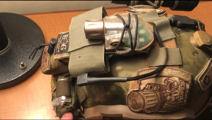

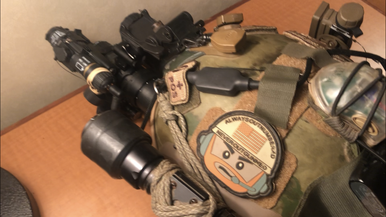

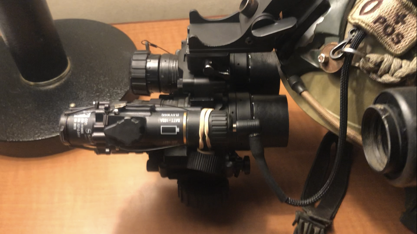

would CNC metal caps work? Joe, reach out to our mutual friend. He recently developed another accessory for the COTI & ecoti (one that allows it to clip infront of a Nightvision clip on) (Pvs24/24LR, UNSSR & PVS30) anyway he is set up with a world class gunsmith/ machinist that could probably churn these out.
Wig is the designer and person who had these plugs and cables made.
I was a field guinea pig tester.

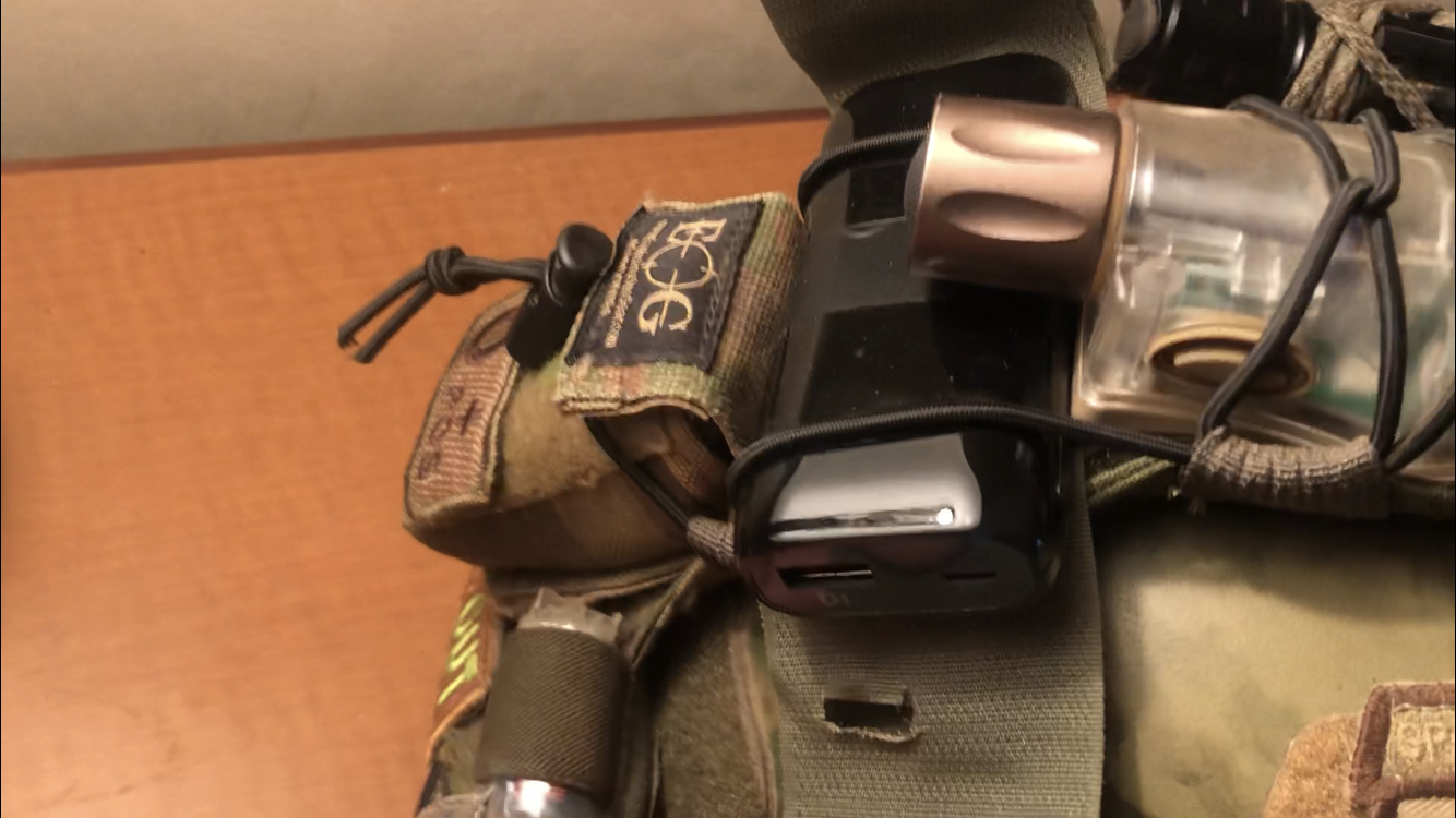

They work extremely well. With a Anker Candy Bar rechargeable battery I am getting about 20 hours continuous run time.
I just take the original battery cap and rubber band it around the plug so that you can still use conventional CR123 batteries at any time for redundancy emergency battery backup if need be.

A CNC cap, with a through hole to mount a DC jack. Then a spacer with a DC voltage regulator installed to take the place of the battery. Now you use a DC to USB cable.

Well, I've been reluctant to post about these until we thought we had a path to make more, but alas, no path to make more has panned out, so I'm actually going to post in hopes maybe someone CAN help.

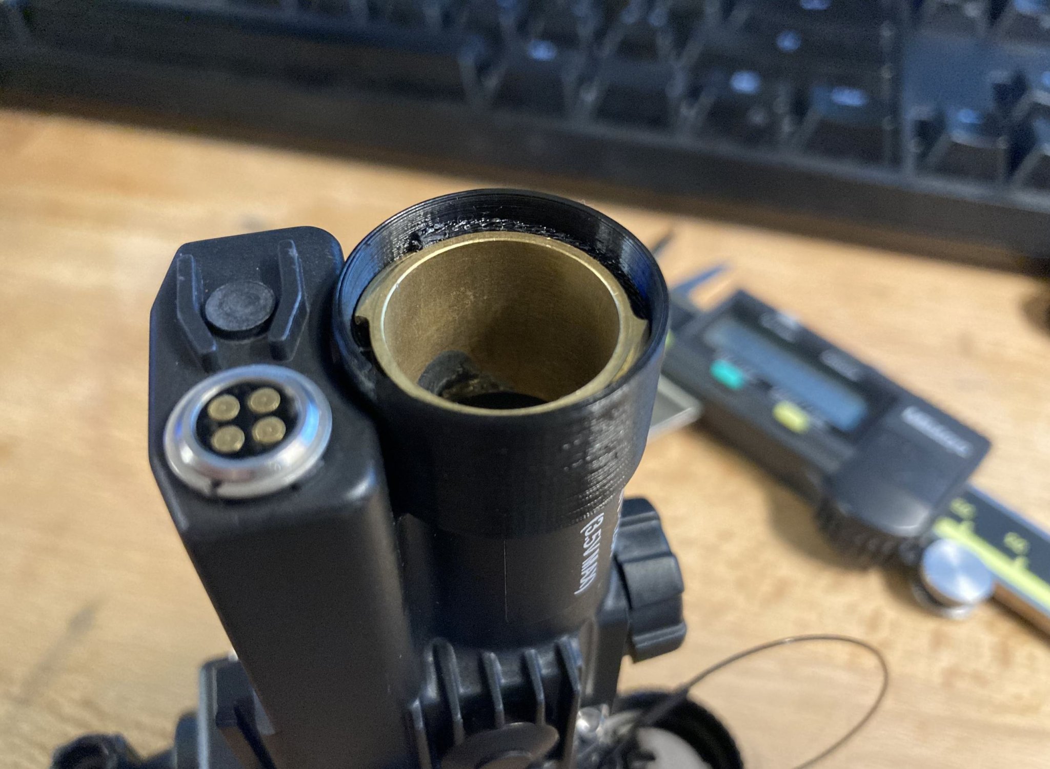

Now that I've wrapped up my project for the external battery adapter for Trijicon REAP-IR, decided to move to see what I can do for COTI.
First step is try to duplicate the weird ACME-like double-start thread, 3D printed to test fitment:
Next step is to look into down regulating the voltage, I think I want to have the voltage regulation built-in and give it USB-C so you can just use any power bank.

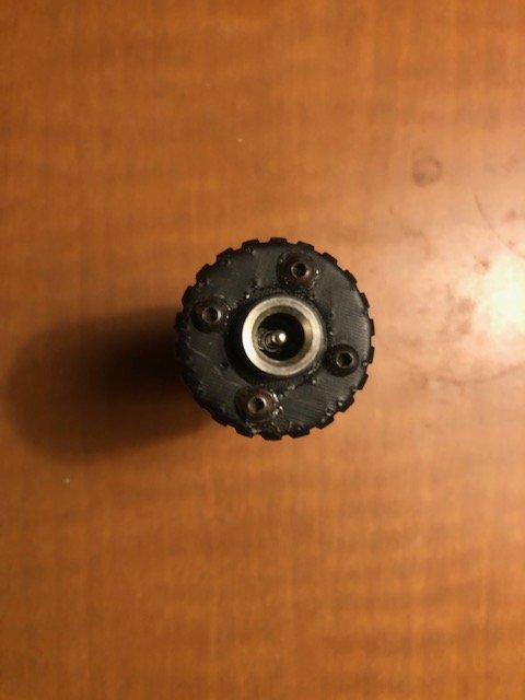

Current plan we have working with Wig is to put the regulator in the cable and use a standard DC plug. The DC plug is more secure than and USB plug. When I get all the printed parts here I'll look into putting the regulator into the cap assembly. That would let you use a standard USB to DC cable of any length. The downside is each cap assembly would be more expensive with the addition of the regulator. Plus/minus for every possible solution.
It lives !! :D
It lives !! :D
Absolutely BEAUTIFUL.
You guys did a fabulous job on these. And at a very fair price. 😀
This is a game changer for COTI owners.
