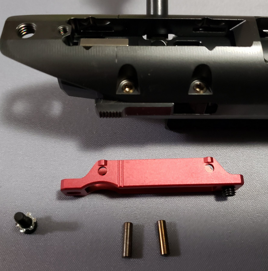

2 were contacting the action and you could not pull down after it latched. The 3rd had a little up and down play after it latched.
Are you running a mdt acc elite by any chance? Gbmaryland gave me the tip of adding the plastic dowels in the maxwell and it's helped alot. Still some hiccup on the 7th round every so often.
Yes that is an ACC elite in the pic. What kind of hang up were you having?
Mostly bolt going over my 6mm gt rounds. It also hung up like yours where the bolt stops at an angle on the case. After installing the dowel, it only does that to me every 8th mag on the 7-8th round. Typically when feeding from the right side of the mag.
The other thing I had to do was add a washer to the rear screw… this way, the rear screw didn’t protrude through the action and impede the bolt. (Forgot about that…)
Don’t forget to adjust the mag latch so that it just holds the magazine in with minimal / almost imperceptible amount of play.
The next thing that might cause some interference, make sure you’ve adjusted the trigger/bolt interaction.
Per @TheOE800 I learned that the front screw on the trigger hanger will make a huge difference in how hard the boatlift is, and how much the bolt is pressing on the trigger itself during use.
That interaction could also be pushing on the bolt up causing feeding issues… (especially a trigger tech).
Take the action out of the chassis, loosen the rear bolt on the trigger hanger, adjust the front bolt until, with the bolt cocked, when you raise and lower the handle, you see no perceptible movement of the firing pin/hammer assembly at the rear of the bolt.

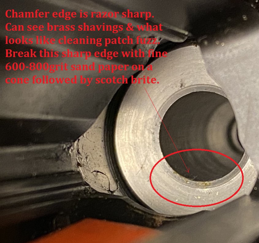

I can't feel it at all just running the bolt normal on a bench. 308 with AW's, however I checked it to ensure the issue below didn't apply.
The below picture is on an ARC Nucleus. Still very similar CRF. At least a dozen of us Hide members picked these up on a special 4th of July deal.
Most had same Rock Creek barrels & there were multiple complaints of poor feeding or hang up as you described, mine included.
What I figured out is outlined below: The CRF bolt doesn't gain control of the round until it pivots level while entering the chamber.
First I tried smoothing the extractor claw to help ease the case in. Helped a little, but the case pivots on the sharp edge @ chamber entry. If that edge is sharp, you'll feel it hang as it wants to stop forward motion. After putting a tiny polished radius on that edge it was night and day. Literally everyone that's ever run rounds through it comments how smooth it is.
In the age of CNC chambers I think this important little detail can get overlooked. I'd bet the reputable builders are aware and address this, but when we just screw it on in the garage it's easily missed.
This is important to a reliable feeding AR also. Same deal the case has to pivot on that point while the head drags across the bolt face/ejector. If you ever look at a Craddock AR barrel you'll immediately notice the mirror finished radius he puts at the chamber entry transition.
This applies to all ARC CRF actions.

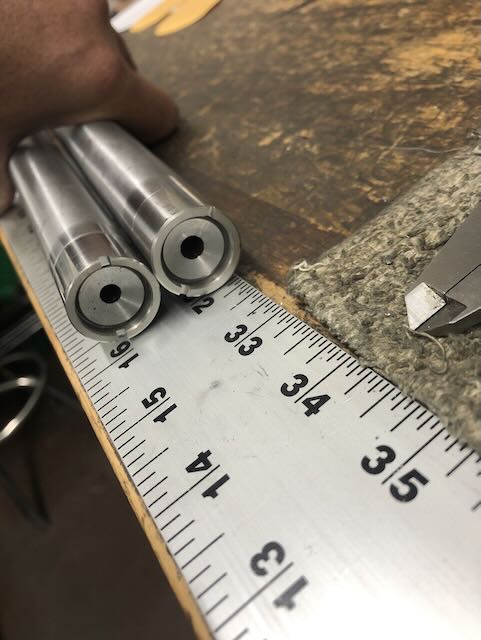

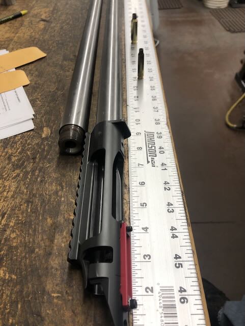

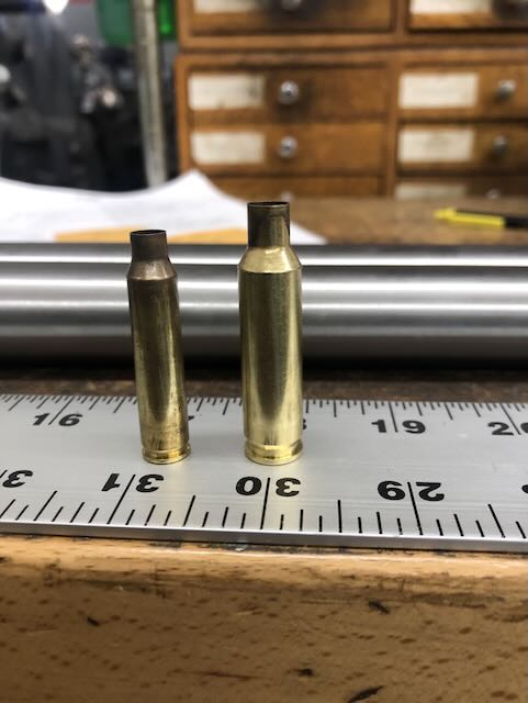

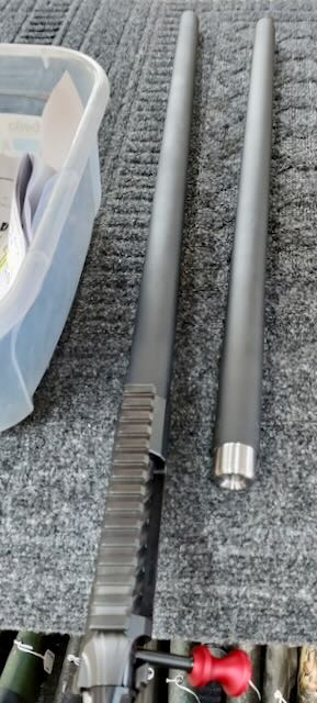

I had ARC ship the action, bolt faces and action wrench to LRI. LRI chambered two 24" M24 barrels for me in 6.5 Creedmoor and .223 Wylde.
I made the decision after exchanging a few emails and speaking with them. LRI wanted the action in hand to properly fit the action. As I was told, close enough is not good enough. Although this may no longer be a requirement since they have fitted more barrels for the CDG.
One of the deciding factors is that they test fire the action and barrel to insure that it functions properly.
LRI is good about keeping you updated as the barrels move thru the shop. Below are pictures that they provided at different stages:

Trivially easy improvement. This post was worth its weight in goal. Is it enough to hit it with like 1200 wetdry on a dowel and just ease the sharp edge?
Got a use what you have, but I'd recommend 600 first to take the edge off.

Every edge leading into a chamber should be broken and polished smooth. This is just something that should be automatic.
