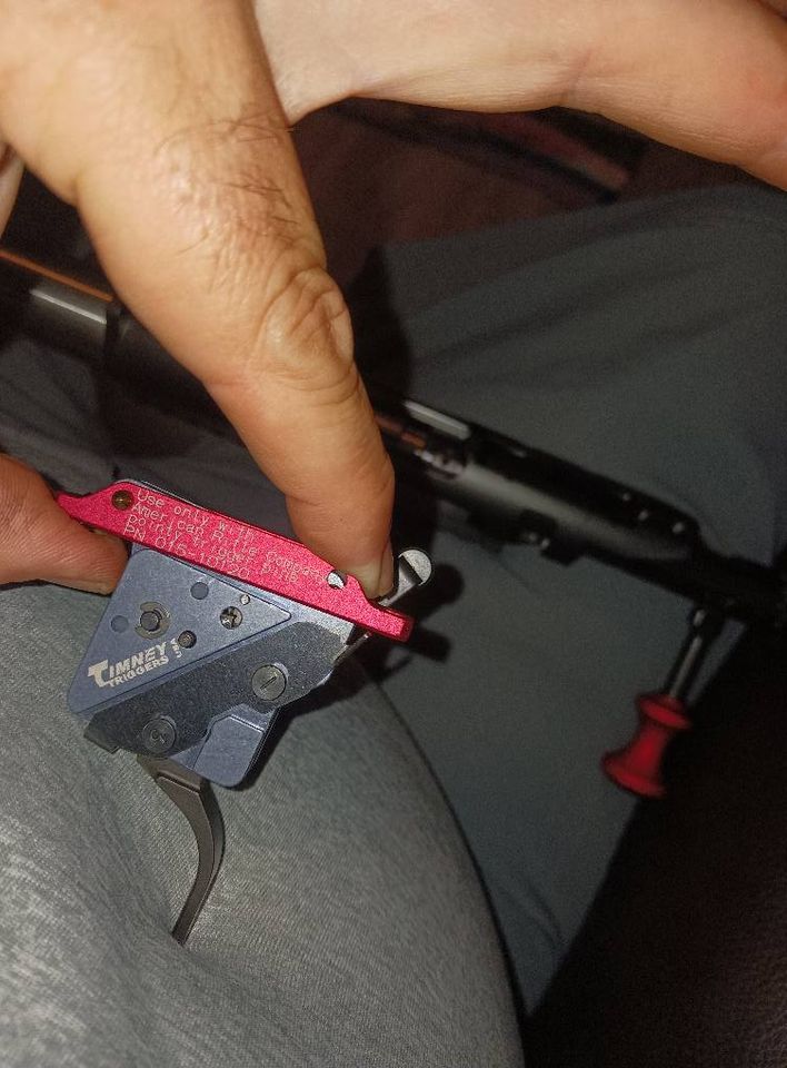

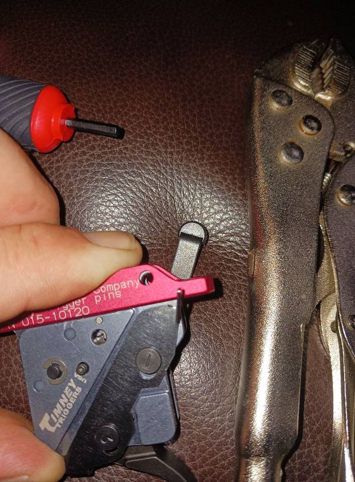

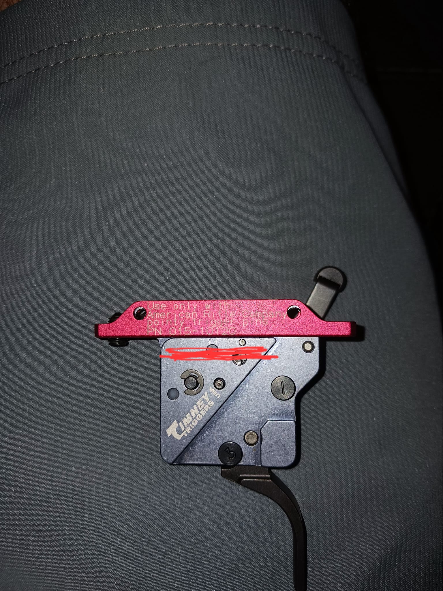

Anyone have hanger to trigger fitment issues? Never had an action with a hanger and this timney won't fit. Do I need a different hanger or would it be safe to remove some material from the hanger?

First step is to make sure it is properly orientated to the action.
You need to remove the bolt release from the trigger, it's not needed with the CDG.
I dont think it has anything to do with the release, the hanger is hitting the shelf on the trigger.

You still should remove the bolt release as the CDG doesn't have a trigger lever operated bolt release like a factory 700 action. You may not be able to insert the trigger into the action with the bolt release sticking up from the trigger, there's no cut in the action to accommodate the bolt release lever like on a factory Remington 700 action. Even if it did fit with the bolt release lever on the trigger I wouldn't want it loose and flopping around.
You will need to clearance the trigger hanger as needed depending on your trigger. Many aftermarket triggers are larger than a factory Remington 700 trigger, and they're all larger in different areas-- bumps on the housing, larger safety lever with different bends, extra safety linkage, etc. Every brand is different. Just grind/file the hanger as needed and don't take too much.

And what was the deal with being able to use one… You have to modify the trigger hanger?
Original trigger hanger needs a bit of extra clearance made for the safety lever. It looks like the new hangers with the clearance cut will fit as is, but I don't have one to test fit.
You also need to remove material from the front of the thumb stud on the safety lever so it will fully disengage, it hits the action in the fire position and can hang up the sear in the trigger.

Exactly what I did. Got the dremel out and clearanced the hanger and ground the front edge of safety knob off, all good now with medium sear. Love me some BnA action!

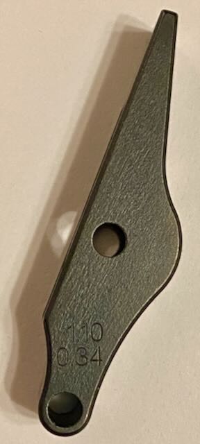

Anyone can mesure their Xylo mag latch ?
Just curious mine is at 2.025in and I wonder if I have the standard length or the +30 thou
Are there any numbers on the side of the magazine latch?
1.10 and 0.34 are engraved on the side of the standard length latch. ARC measures the latch from the center of the pivot pin hole to the top of the latch where it impinges on the magazine.

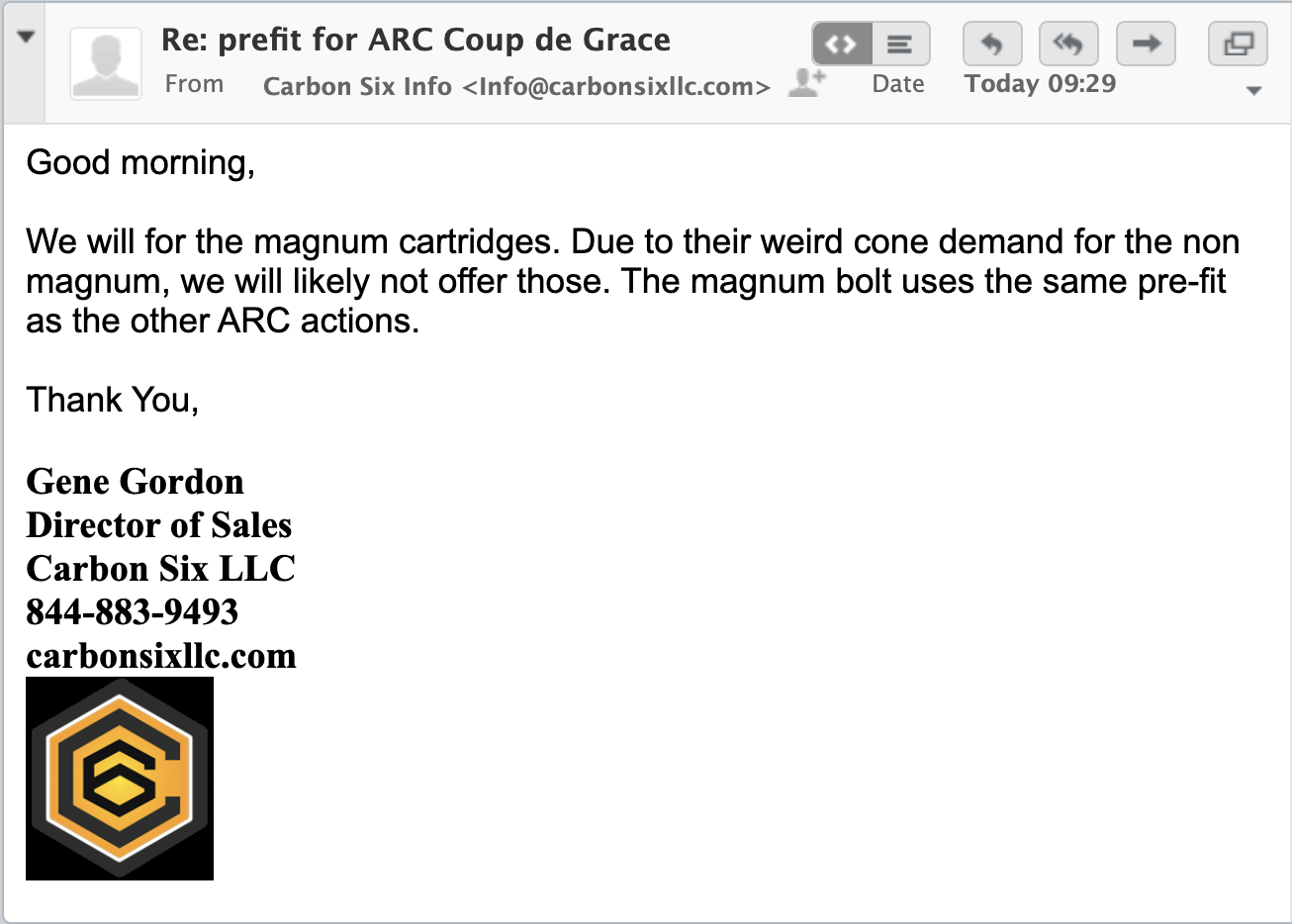

Well ... looks like CarbonSix pre-fits for magnums but not the SA CDG's ...
Carbon Six just lost any chance at my business in the future. If they don't want to make one they should not. But to characterize the cone print as "weird." It makes it seem that they are too dumb to read a print.
Mine measures 2.026" & is std. Works perfect with AW & CDG.
They lost my business after my family bought several barrels that had various issues. Of the 6 barrels I’ve seen 3 had bad chambers, two pressure out several grains below what the rest of my rifles do and the 6th I haven’t shot enough to know if it’s good or not.
I’ve dropped them for X-Caliber, so far the one shoots great and the other two will be tested in the next month or two.

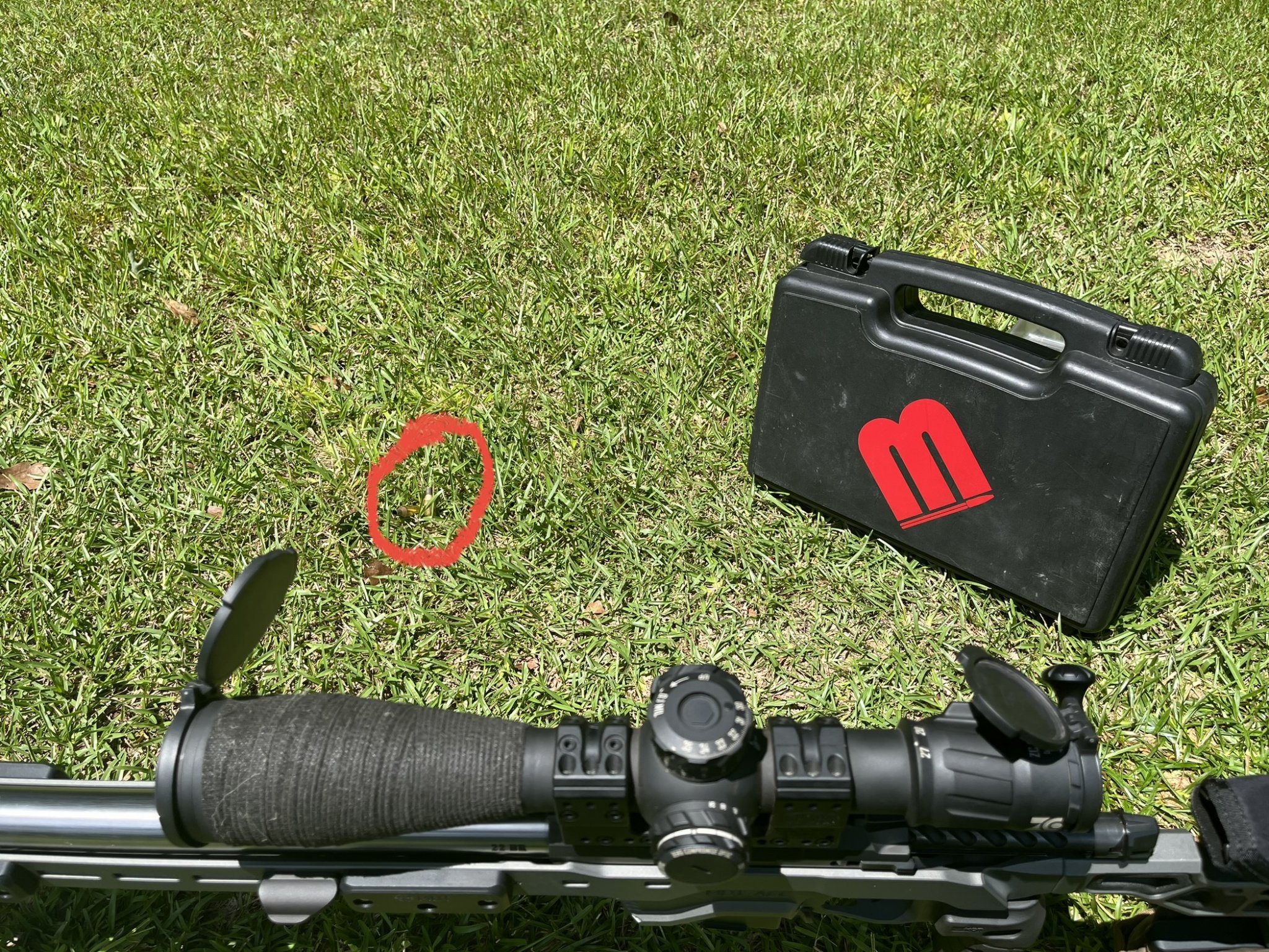

Anyone else have having their brass coming out forward? I’ve tried slow and tried fast and same result just distance from rifle changes

That’s what I’m use to but unfortunately it’s ending up between 1 and 230. Normally I wouldn’t worry about it but being a comp rifle I’ll lose more brass than I’m willing.
Yep my 308 is doing that. I have a new/spare ejector lever on the way from ARC. Nothing wrong with the original, but want to modify one to see If I can bring ejection pattern around to at least 3 oclock.
I'll post results here.
At least I’m not the only one. What’s your plan on modifying the ejector? I’ve called ARC and left a voicemail today, so hopefully I’ll talk with someone tomorrow.
Change the angle of the dangle. Small changes.
Mine only does it noticeably when on the clock running it pretty fast.
It ejects fine but there were like a dozen 308's shooting Tac class & I had to leave any brass laying till end of match if it ejected in front of the line.
My precious RWS brass.............oh the agony.
Seriously though, not that big a deal. Just figured I'd get a spare and see if I can tweak the pattern around a bit.

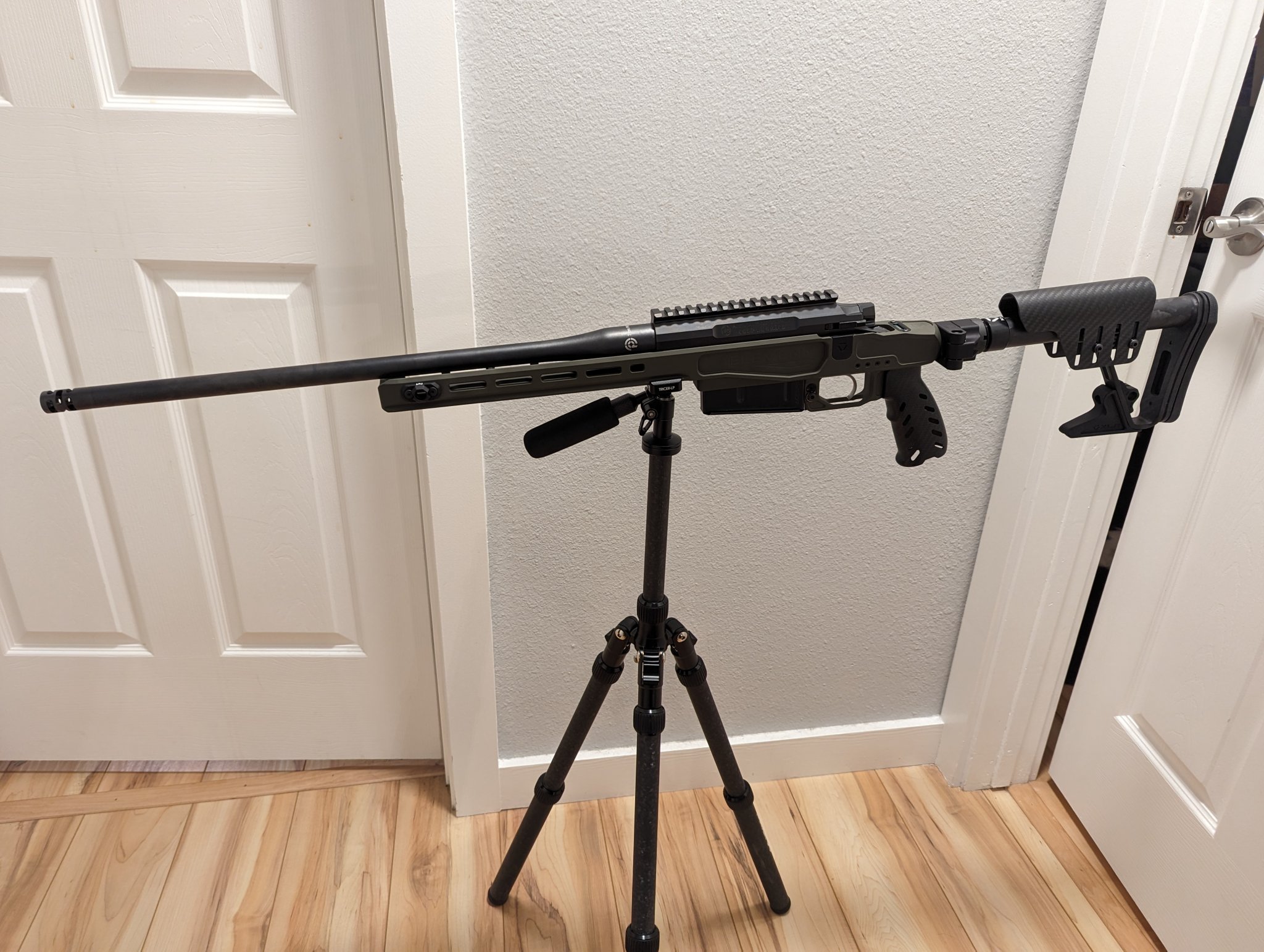

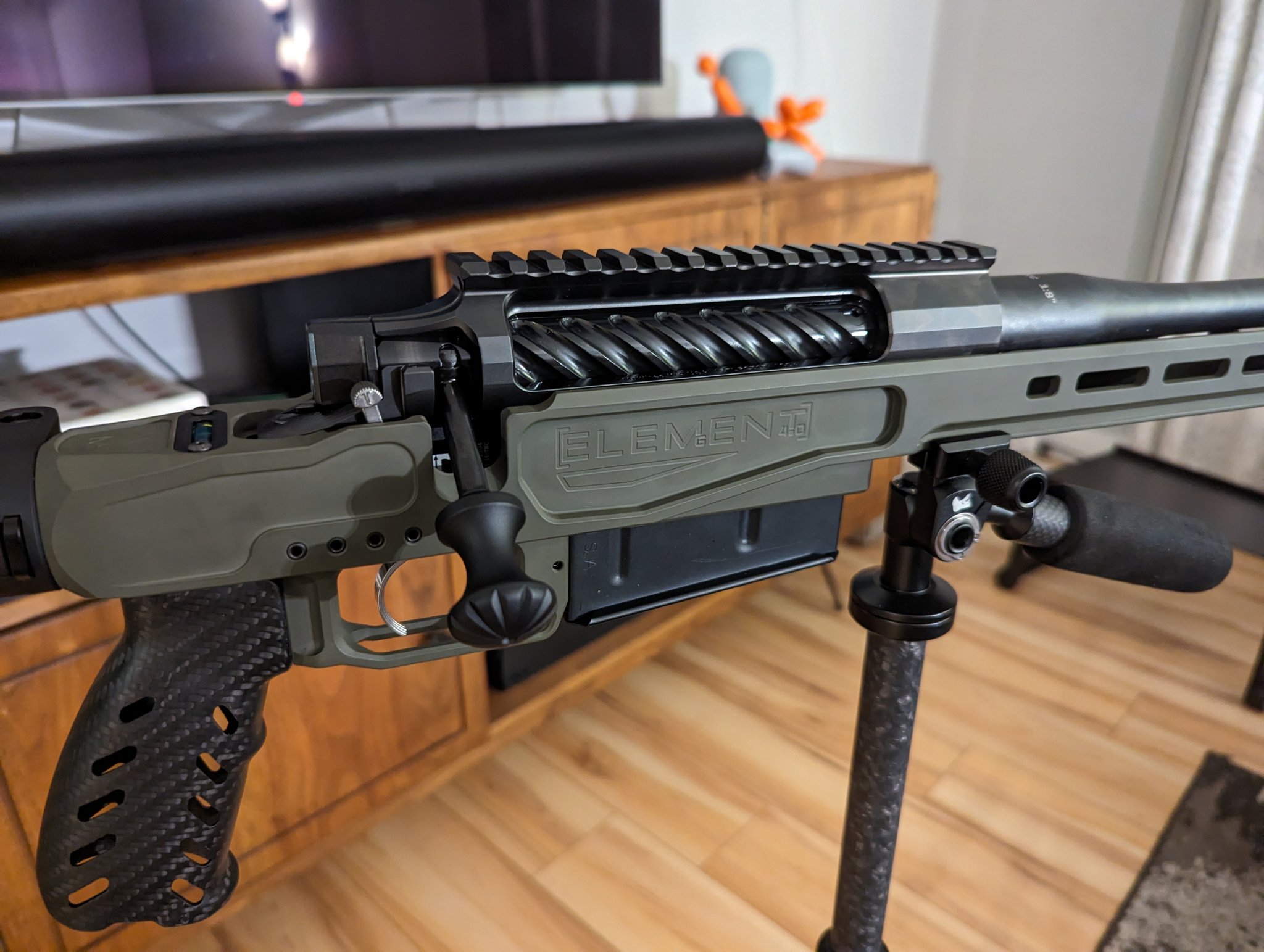

I assembled my rifle after receiving my action in the mail - everything came together more or less alright.
- LA RH .535 bolt CDG
- preferred barrel blanks - 20 inch taperless .750 contour - chome moly blued blasted. 7mm PRC
- XLR Element 4 MG
- trigger tech primary
Torqued the action to 100 lb feet - extremely dismayed to see the action easily close on the no-go gauge (manson reamers). Has anyone else here had similar issues?
- XLR Element 4 MG
