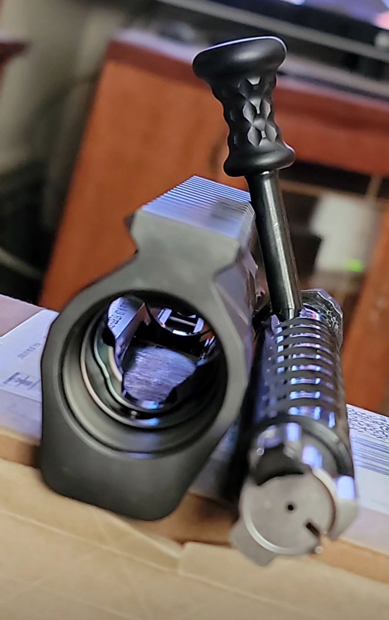

I assembled my rifle after receiving my action in the mail - everything came together more or less alright.
- LA RH .535 bolt CDG
- preferred barrel blanks - 20 inch taperless .750 contour - chome moly blued blasted. 7mm PRC
- XLR Element 4 MG
- trigger tech primary
Torqued the action to 100 lb feet - extremely dismayed to see the action easily close on the no-go gauge (manson reamers). Has anyone else here had similar issues?

Does it close on a field gauge?
I don't have one - I tried the trick of adding a layer of scotch tape to the bottom of the no-go gauge and it did not close - although I'm trying to avoid becoming the next Kentucky ballistics, ideally I'd have a way to confirm if the headspace is unsafe with an actual field gauge.
You don't need a field gauge. Measure the thickness of the Scotch tape and add that to the size of the no-go gauge. Then see if that number falls within SAAMI spec.
Not all no go gauges are the same. Chances are if you buy a different no-go gauge from a different manufacturer, it will not close.

Seat your bullets into the lands and fire form your brass with less than book max load, a couple of times if necessary to get full growth. Then just size .002” from there.

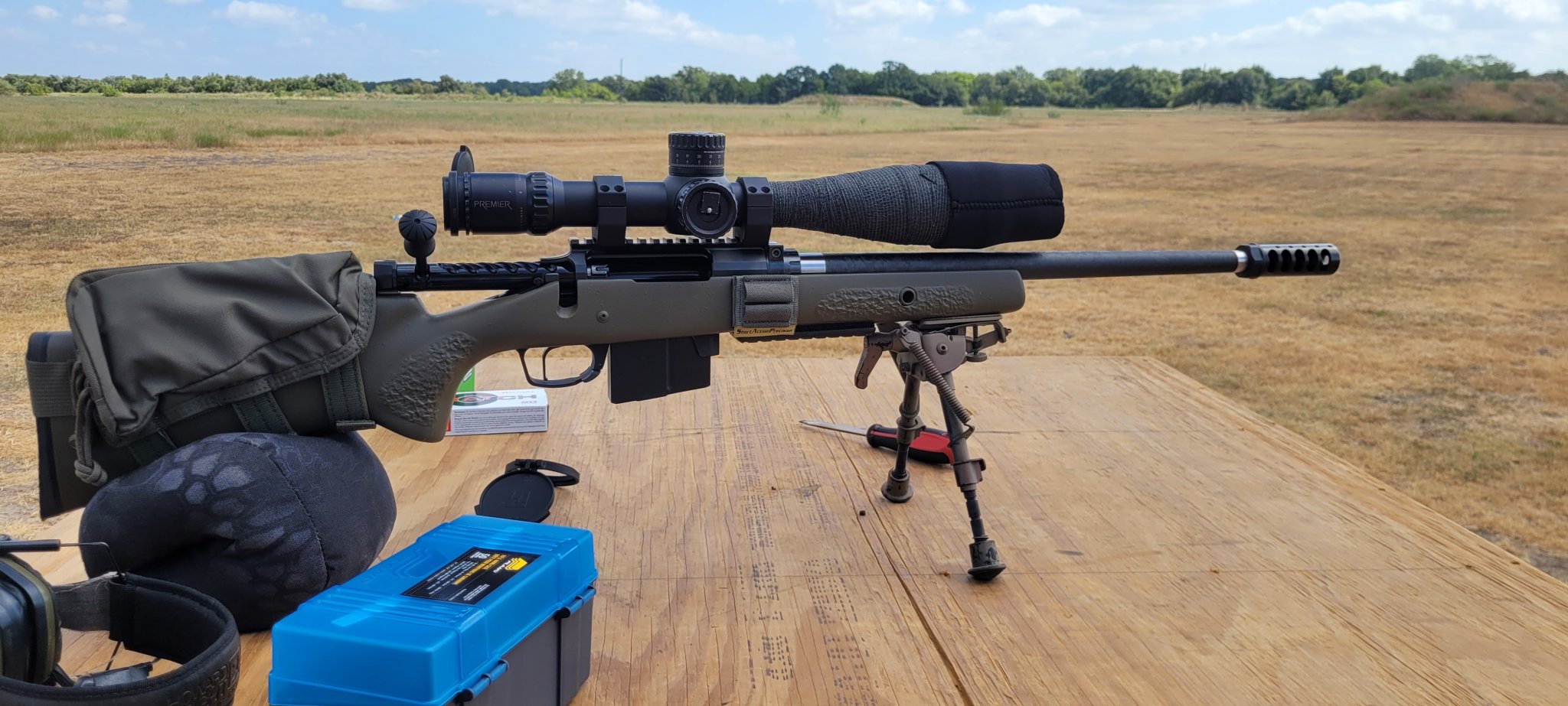

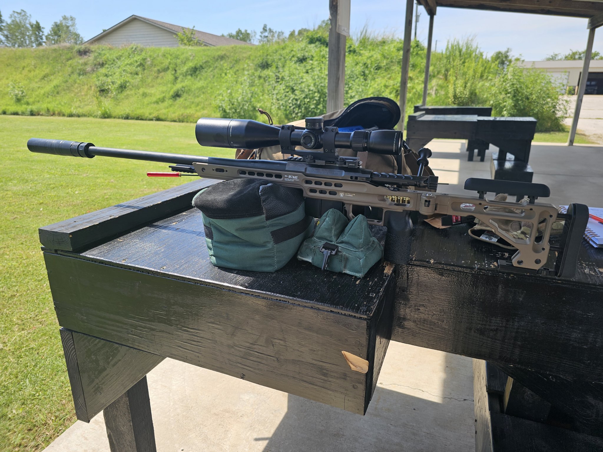

Got my build out today for break in. Super happy with it. Coming from all ARs, shooting the light trigger and bolt gun was a learning curve. Sub MOA groups for the last couple of groups. No adjustments to anything. AW mag fed perfect with the MPA chassis. Probably gonna need a non cantilever mount. Gonna do some 87gr VMAX load dev this weekend.
Thank you to everyone here for their expertise and help.

Yeah dude get some proper rings for this build and watch your sub-moa gun turn into a sub 1/2 moa.
https://vortexoptics.com/vortex-precision-matched-30mm-rings+vx_ring_height-87~inches
https://masterpiecearms.com/shop/mpa-ba-bolt-action-mount/
Reactions: monkeypunch
Yeah after getting behind it, that mount won't work. But, it was in the parts bin, so I gave it a shot.
This bolt world is new to me. But, already addicting. I didn't touch the adjustments on the TT diamond, and it felt crazy touchy
But, the more I shot it, the more comfortable I got. This gun is 12.5lbs, and by far the lightest rifle I shoot with a magnified optic. I didn't realize how different it would feel from my 6.5C gas gun.

You might be better off with a 2 stage Trigger tech if you’re used to gassers. And for the 2 stage models, you don’t need a Diamond, the Primary is low enough and having that bit of a wall might help you with trigger control. Just food for thought, you can easily sell a Diamond for close to what you paid.
I’ve moved all my center fire precision bolt guns to 2 stages except my 22LR RimX still has a TT Diamond which is quite nice for the KYL challenge and for shooting tiny tiny groups.

I'm using the 2 stage Diamond now.

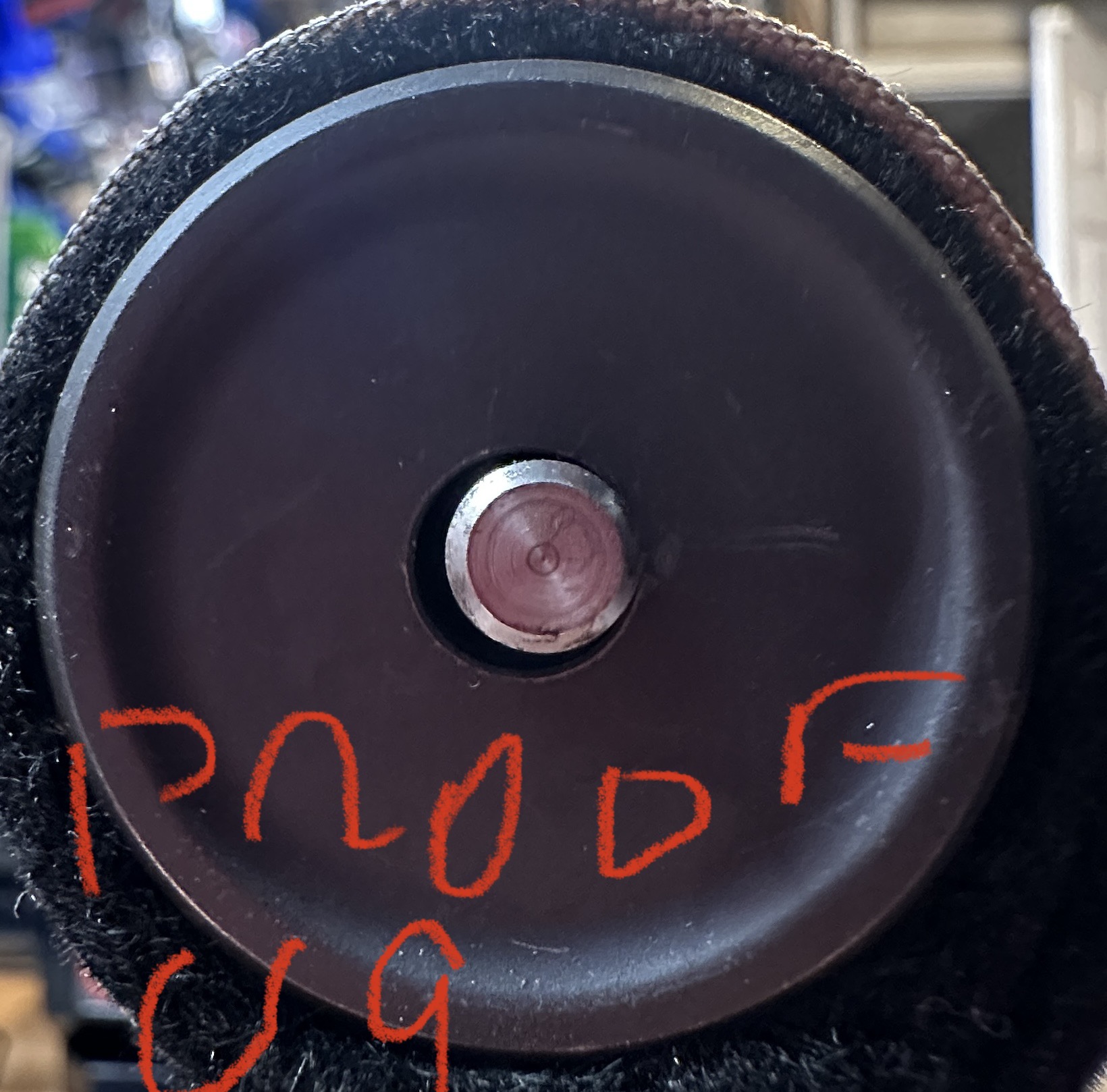

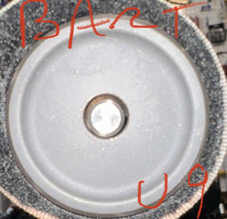

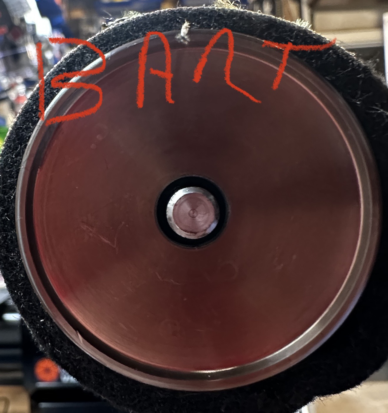

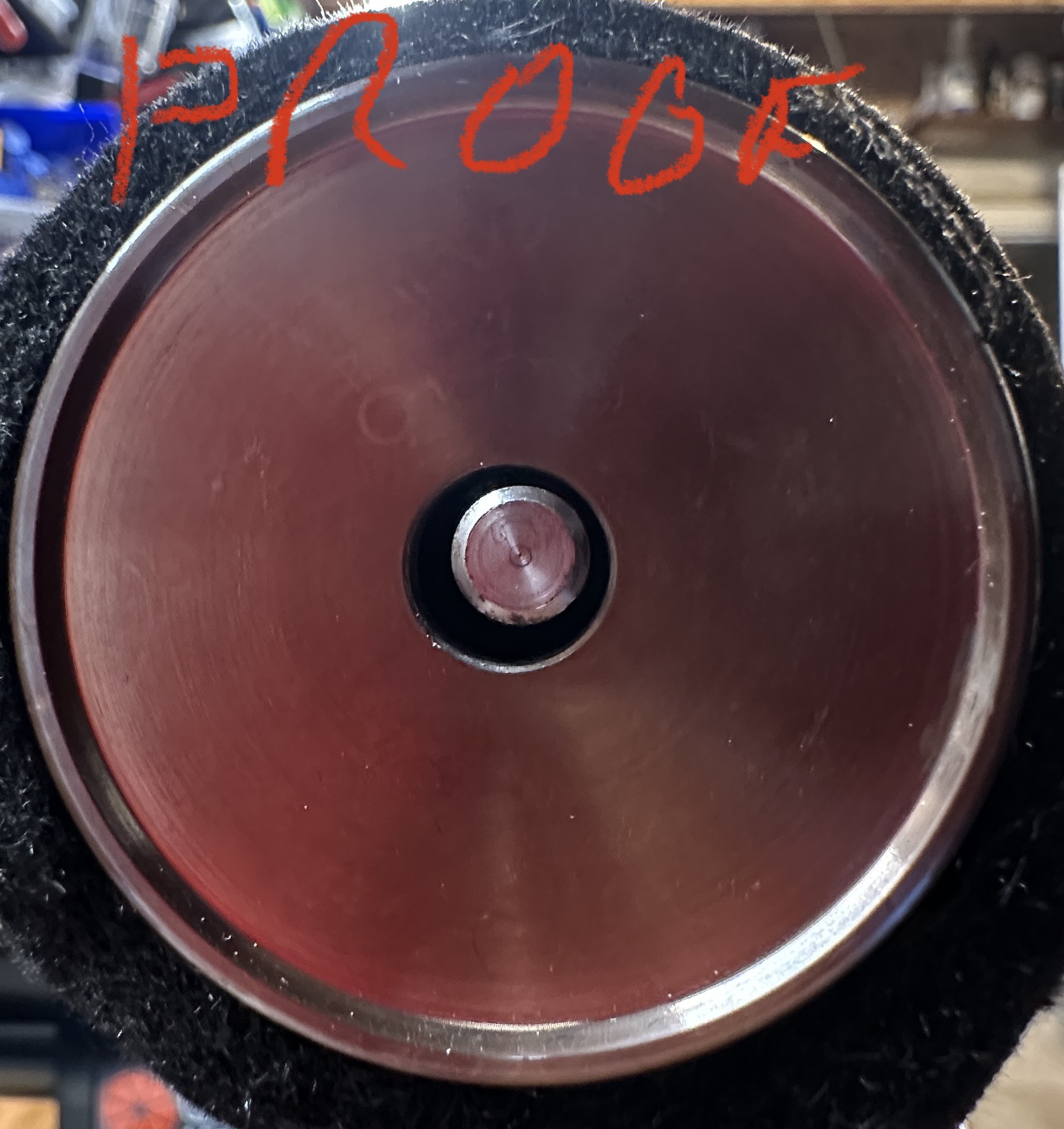

NOTE: I just received a message from the gunsmith, they're ordering me a new barrel. As such, everything below is OBE; it still happened, but they are correcting it.
Ugh
Well, the barrel saga continues… looks like the jig they used to hold carbon fiber barrels slipped and the gunsmith attempted to re-cut the threads/crown the barrel… resulting in .0035” worth of run out. They are in saying in their email to me that the run out was at the end of an ultra7.
And things are still messed up…
Using an alignment rod and comparing a prior barrel, they did for me you can see a clear difference.
The photos are marked proof and bartlein with proof being the barrel they messed up…
The two suppressors are a biscuit and a Ultra9. It’s pretty clear that it gets a lot worse with an ultra nine because it’s 6.5 and 9 inches long. (whereas the other one is 30 caliber…)
Note that this was all with the same exact hardware… so it’s fine on one barrel and not on another.
Ugh
Well, the barrel saga continues… looks like the jig they used to hold carbon fiber barrels slipped and the gunsmith attempted to re-cut the threads/crown the barrel… resulting in .0035” worth of run out. They are in playing in their email to me that the run out was at the end of an ultra7.
View attachment 8207356View attachment 8207357View attachment 8207358View attachment 8207359
I’ll probably open another thread for this but I had previously posted and this is the current outcome. Since this is after the second time they had the barrel, I’m just venting.
Ah, question....last two pics of "U9". First one of the Proof looks like a 30 cal...lots of room around the .264 alignment rod. Last pic is U-9 on Bartlein and the alignment rod is a very close fit in the end cap exit hole.
6.5mm cal Ultra 9 vs. a shorter .30 cal Biscuit I think he said. Length and bore tightness exacerbate the issue.
Ah yeah...first two pics are indeed the 30 cal Biscuit but the last two are supposedly the 6.5 U-9 but as you can see one has far more clearance around the rod than the other??
Because one’s the fucked up barrel and the other isn’t.
Read what I posted carefully, please.
The 3rd picture is, I believe, the U-9 on the fucked up Proof. Clearly its off center and clearly there is a LOT of room around the rod...that is, the exit hole is significantly bigger than the rod no matter if the rod is centered or not.
The fourth picture is, I believe, the U-9 on the properly threaded/shouldered Bartlein barrel. It is not only centered but there is very little clearance around the rod. Sort of looks like the 3rd one is still a 30 cal can and the fourth is a 6.5 can while I believe GB's intent was to show identical stuff on the two barrels.
I may have misunderstood, but these pictures seem to indicate that the same can was used on both of the last two pics based on exit hole size vs rod.

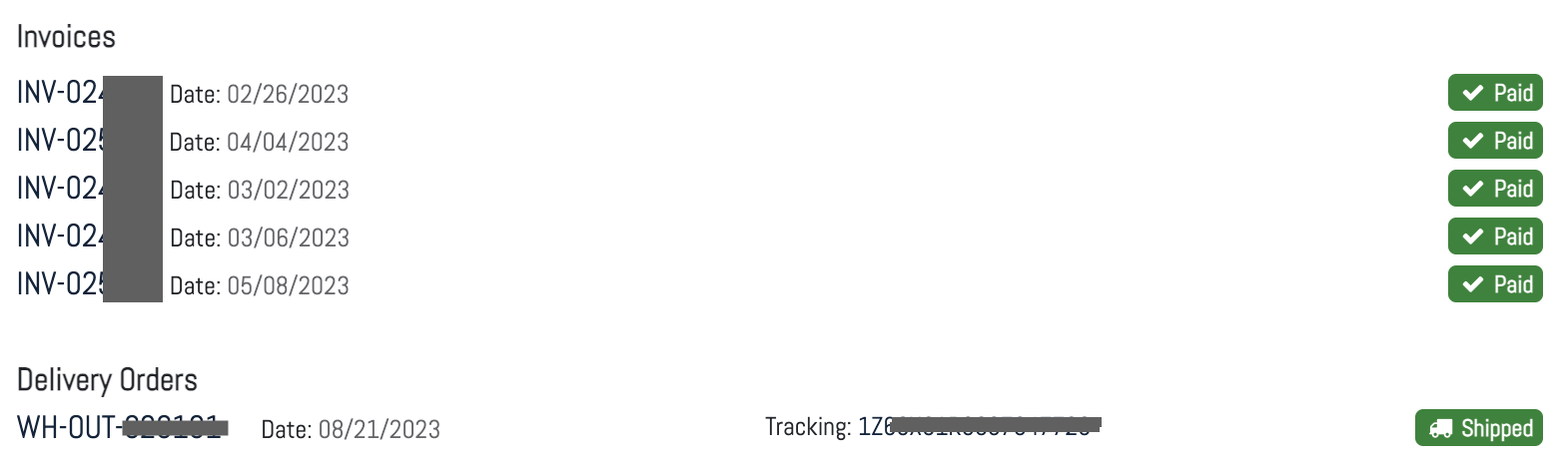

Received my RH/LA/.473/30 moa today - what a tank, can't wait to get it together.
I can confirm that it is nearly a drop in to a Cadex chassis, but may need to put a small flat spot on the rear of the trigger hanger as it is right against the rear action screw boss.
Anyone else not get all the parts?
Ordered a LA with .585 and .535 bolt faces and a wrench.
Got the LA and .535 only
You might check your order online. I asked to split my order a while back and they shipped chassis and wrench. The system showed I still had pending parts. That might be a quick way to see if you have another shipment coming. That, or a call to Bella will probably sort it out too.
