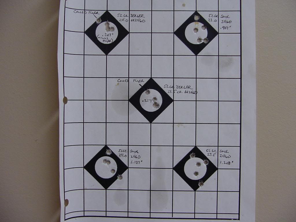

Pic#2> Top left to bottom right, Berger 24.0gr AA2460 .207 minus called flyer, SMK 23.0gr AA2460 .907", Berger 23.5gr AA2460 .217 minus called flyer, SMK 24.0gr AA2460 1.137" and SMK 23.5gr AA2460 1.208". Found out that while the Bergers LOVE the AA2460, the SMK's HATED it!!
