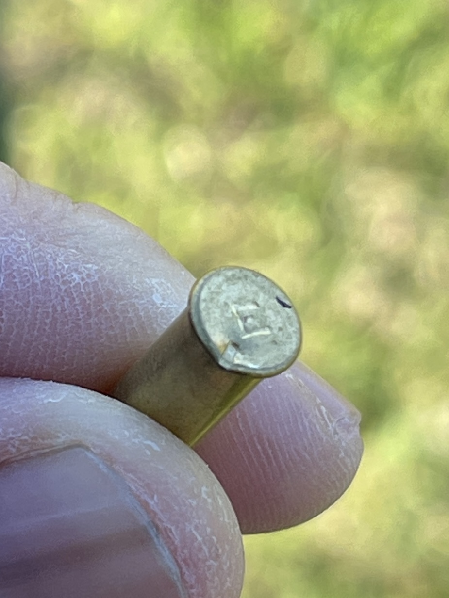

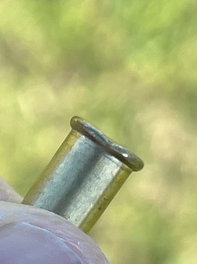

I agree and I don't. It's true of all firing pin mechanisms that it should only hit as hard as it needs to. But I would rather that it err on the harder side, as I see light strikes in rimfire in cold weather all the time from some high end actions. And a good argument can be made for consistent ignition based on the firing pin strike. There's even some who believe you should reshape your firing pin to move it away from striking the outermost portion of the rim. I've seen RimX, Vudoo, and a CZ457 all struggle with light strikes shooting matches through the winter. I do agree there's such a thing as hitting too hard, I just don't know for certain that's the case.
I dont know that it's deforming the rim and causing it to stick. In looking for a reason for the sticking brass I thought it a possibility and mentioned it here in case someone has ever had that happen and wished to offer feedback. But its just a theory as the brass does look to be softer with the Lapua. It's the only difference I could find. But I may be missing something.
The Nevius chamber has .030 of bullet engagement. It will feed and extract an unfired round unless I cam the bolt down. At which point it won't extract it unfired. The chamber is cut to spec with the base of the cartridge at .073" from the datum face and .043" headspace. I've already gone over the reamer made for me by Manson, it all appears correct.
So it's a head scratcher as to what is going on here. It would be nice to tackle the feeding issue first and get a magazine tuned and running.
If you have any thoughts on what I should be looking at next, I would try them..

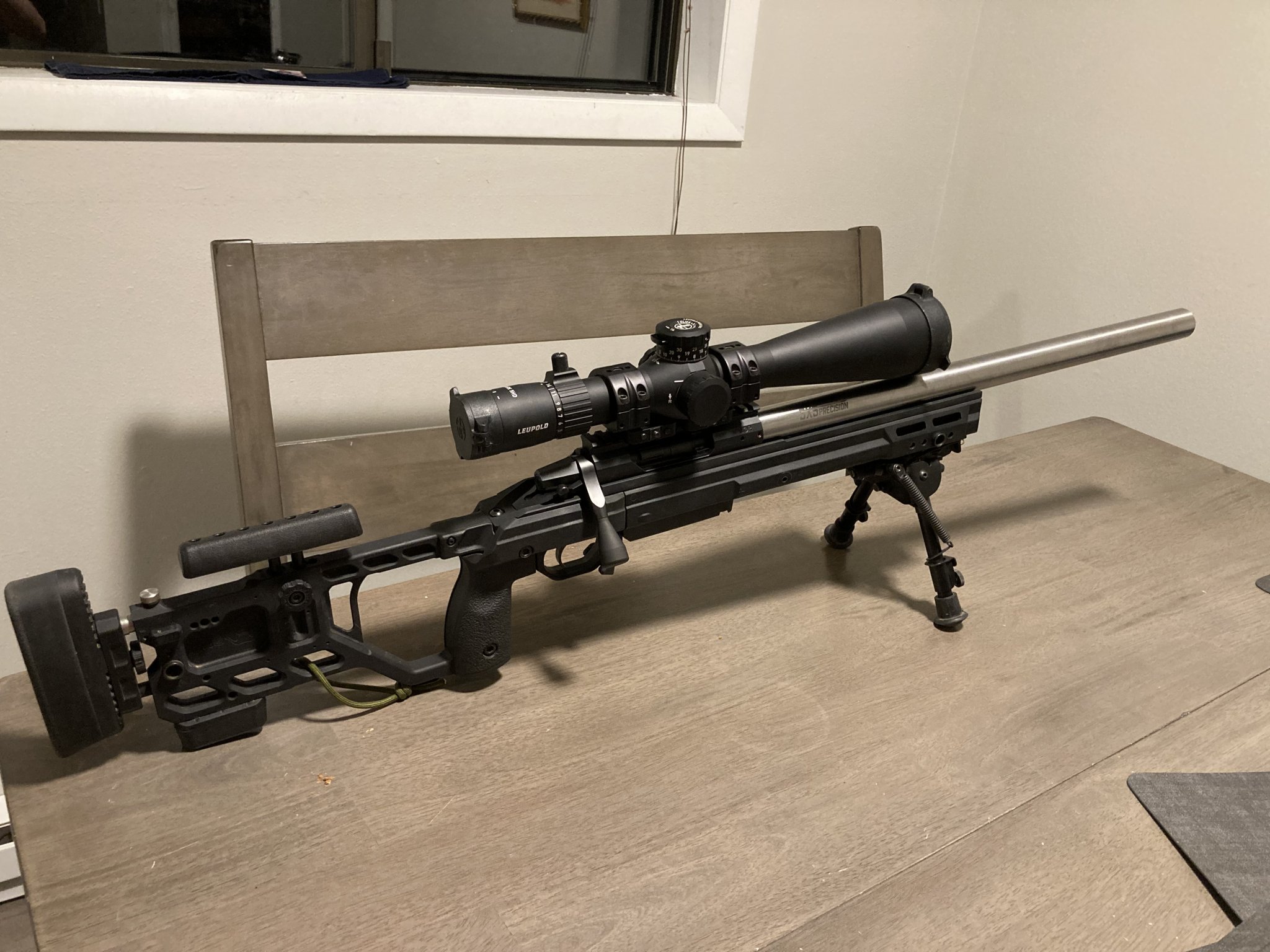

I'm a few bricks into this build. Accuracy is phenomenal (my most accurate rimfire), reliability is very good. I like the 60 degree throw. I think its a great build.

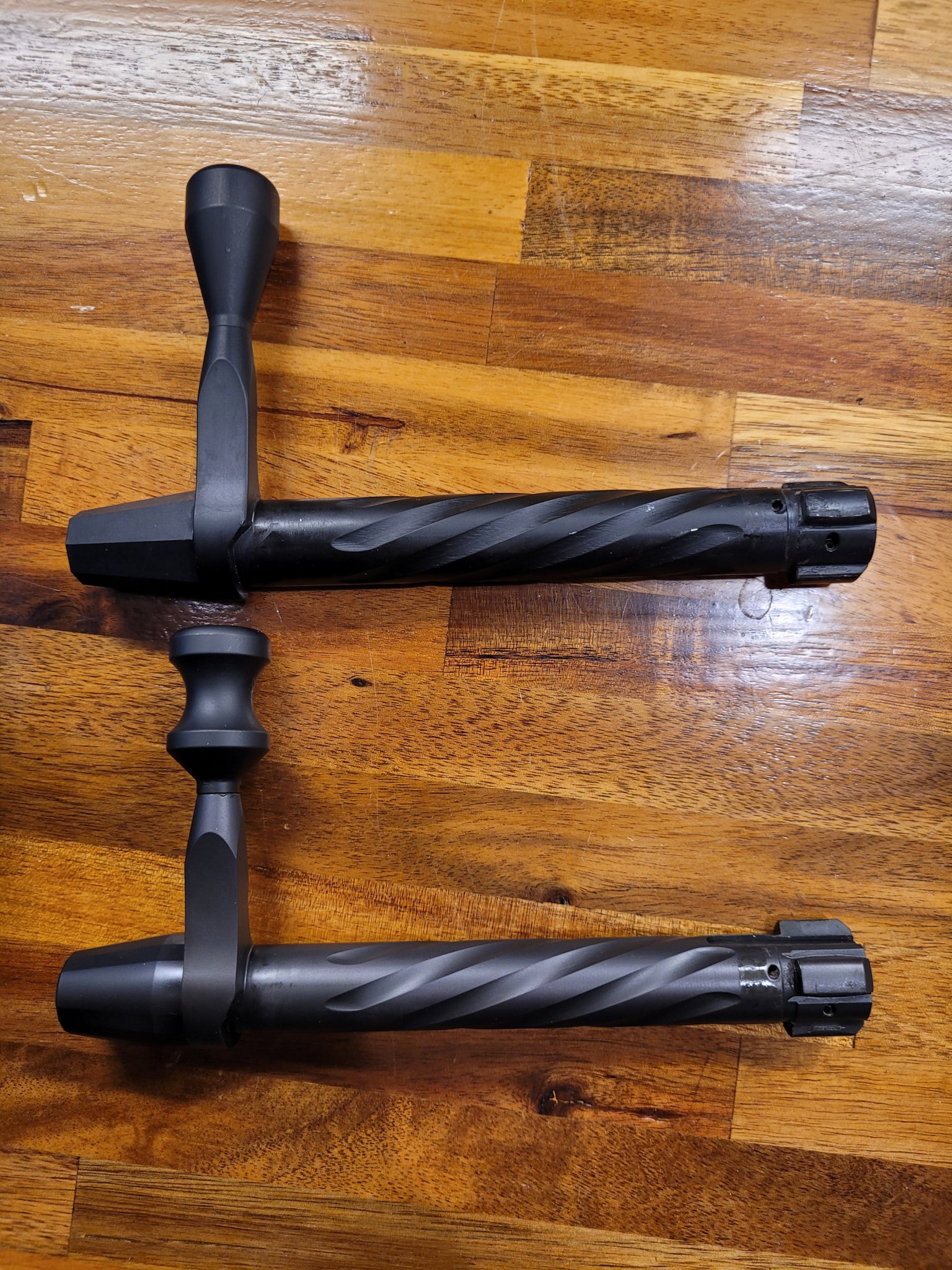

I have heard that the bolt in the Valor and Zeus are interchangeable wonder if this can drop in a terminus 🤔…..
Unless you have one of the first run Zeus's (with the .750" diameter bolt) then I would highly doubt it. When Joel changed the bolt body to .725", I believe he tightened the action diameter as well as the cocking piece height. Then again, I've never had a Zeus at the same time as a Curtis to try the interchange...@BuildingConceptsllc I believe you have both. Can you confirm a Valor bolt won't fit in a Zeus ?

The Terminus bolt is .200 smaller so it will go in the Curtis Valor but the Valor won't go in the Terminus. As you can see, they are pretty much exactly the same other than that difference in bolt diameter. I run several barrels between the two and can interchange them however I want to. I generally don't but I've shot em all on the 3 actions and they all space perfectly.
Thanks for double checking...so that looks like a no-go on the 22lr conversion fitting :(

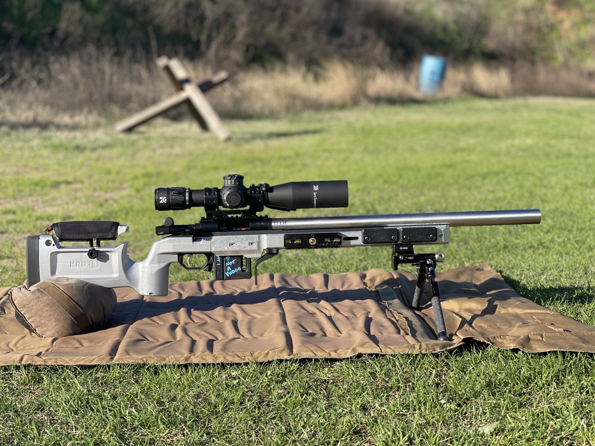

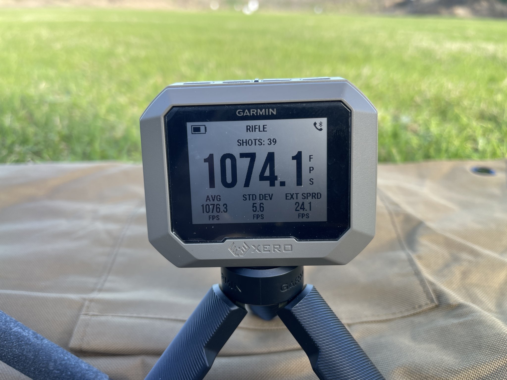

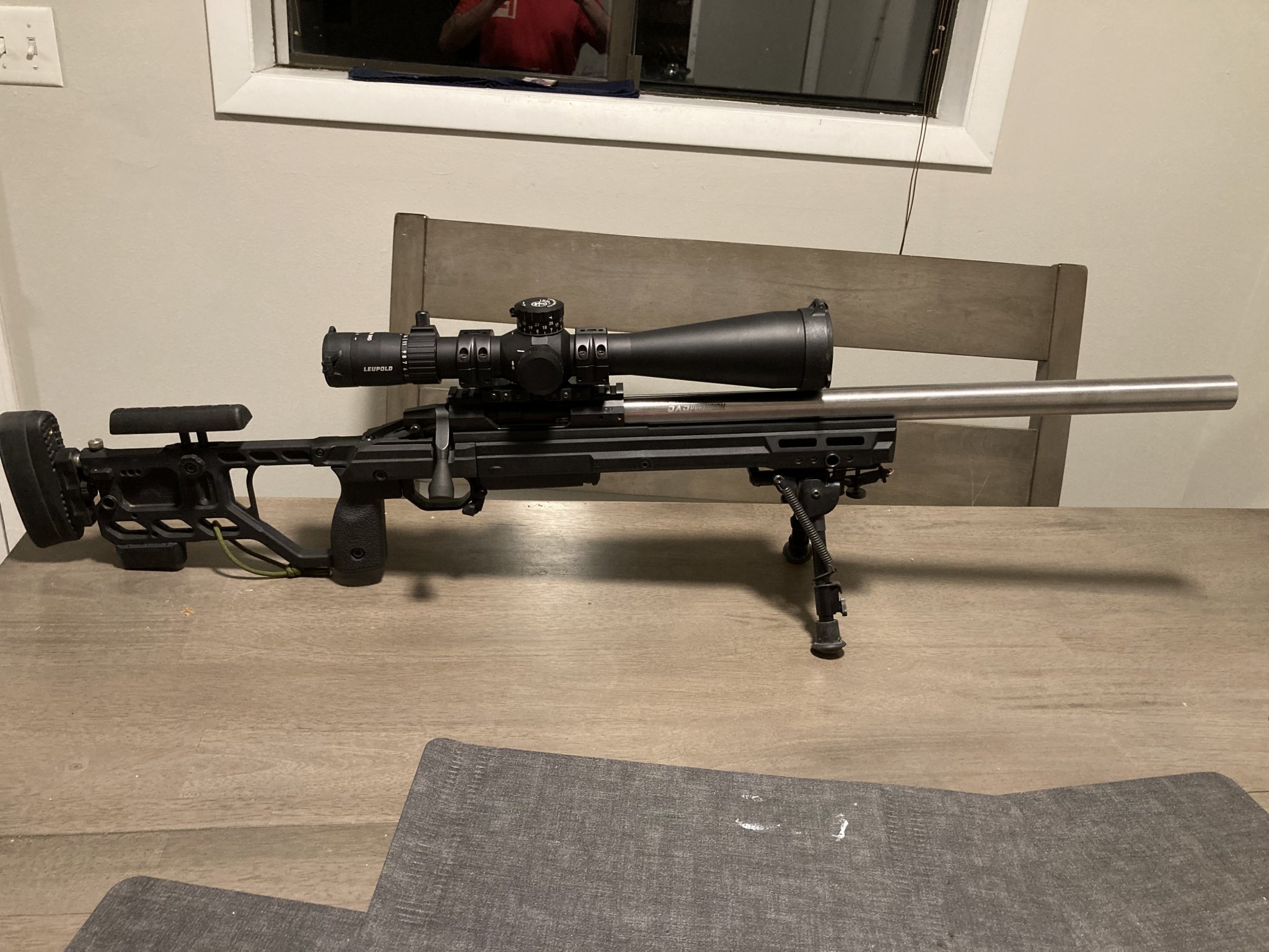

Took my new DI Precision build out to function test with various lots of random ammo I had. Zero issues with normal round nose ammo. Everything fed, fired, and extracted as Birddog said it would. The only thing it did not like were feeding the flatter Eley style bullets. I gave up after a few rounds. I also took the match ammo from my RimX and ran about 75 rounds through the Curtis. Zero issues with the Eley semi auto benchrest and it hammered.

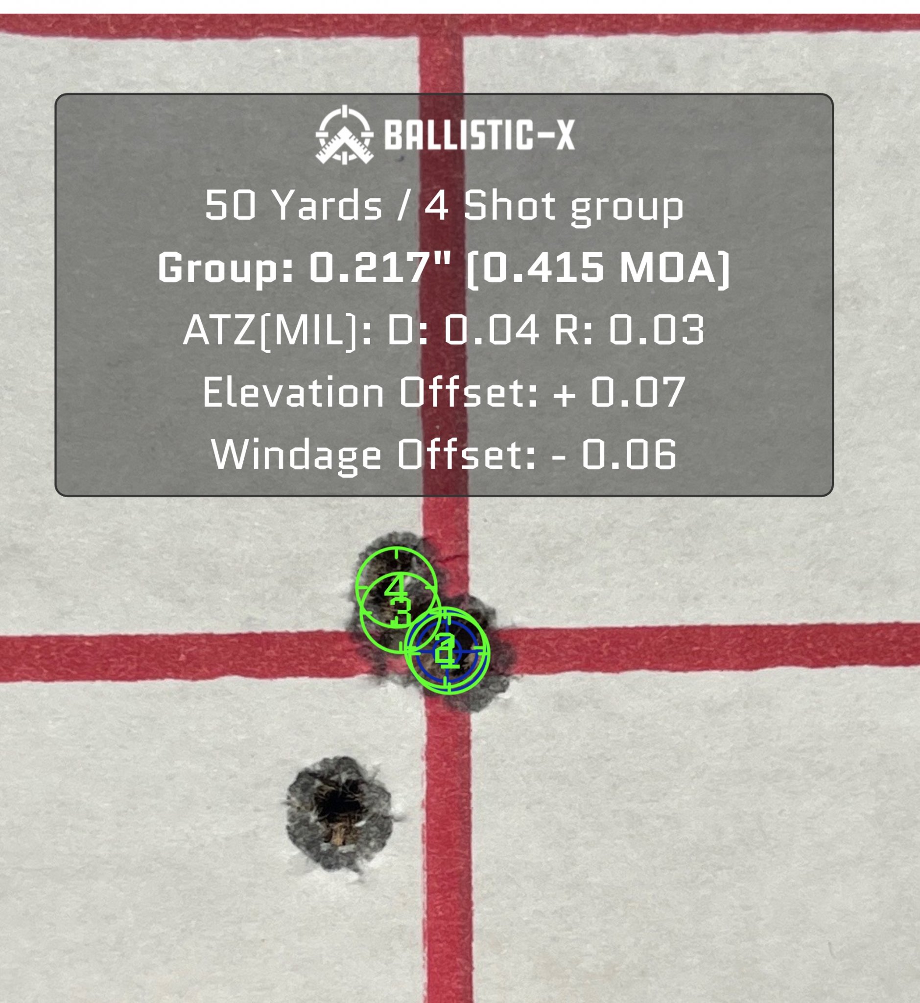

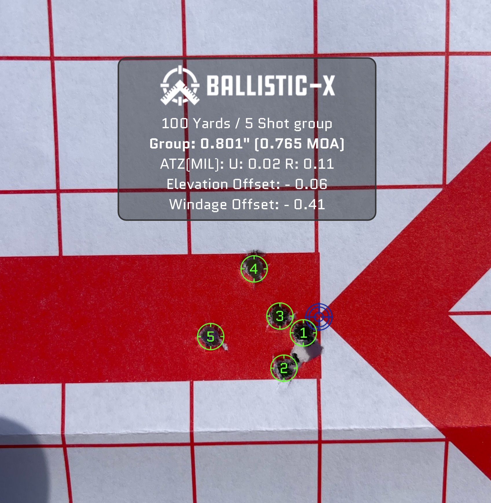

The accuracy potential is definitely there. I managed to cluster 4 rounds and called the 5th down below which opened it up to little over 1/2” at 50y. Chrono numbers were great as well. I know it’s not a 5x5. So far I’m happy with the work and accuracy of the build. Wind was about 7-8 mph at the range. Time to start lot testing. Barrel is a 23” Krieger.

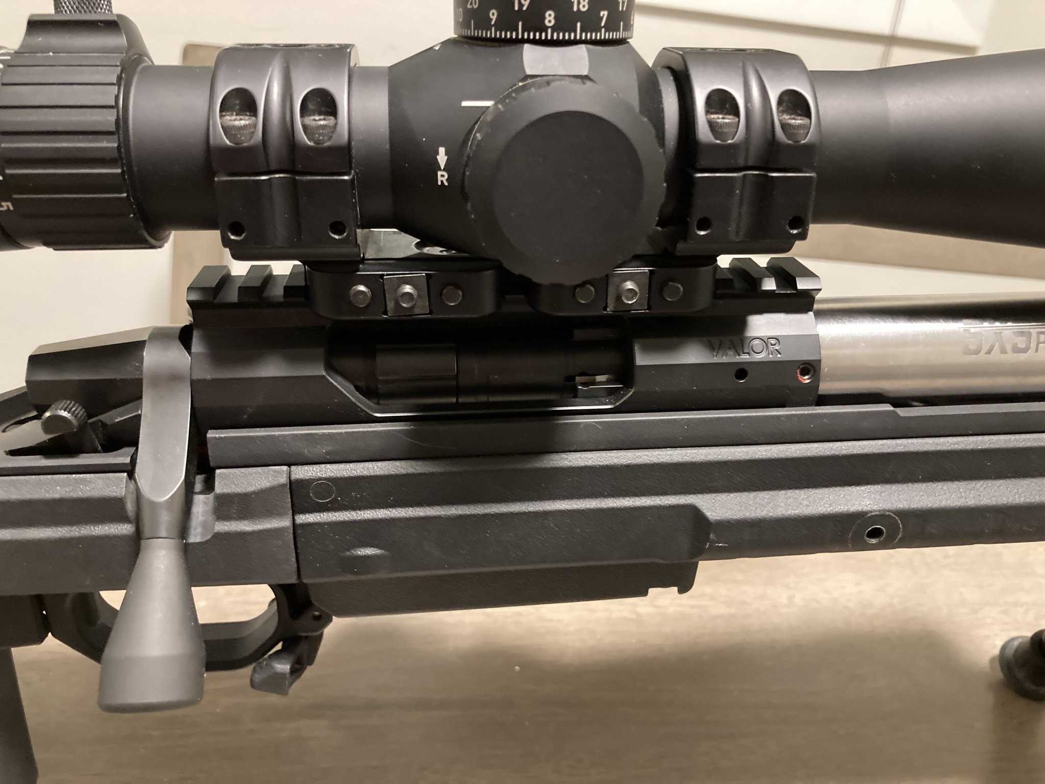

Just received my valor from the FFL. Chase didn’t send a mag or the ejector with it so it will be another little bit. I might get impatient and single feed it so I can shoot it lol
I’m not convinced my Timney will cut it. I’ve heard it’s hit and miss with light primer strikes in a Curtis so we’ll see. That and my mag catch might be too shot. I’m thinking I’ll have her up and running in another month. Fingers crossed!
All in all, I think we’re going to get along just fine…
