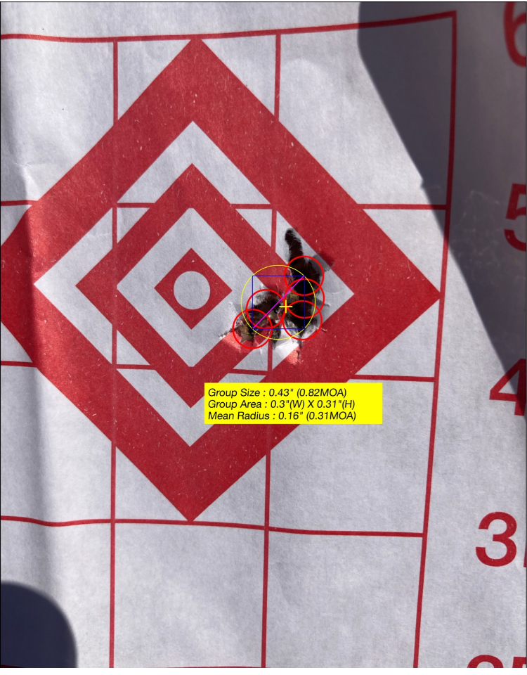

Working well for me so far. First group I was able to shoot. Plan on doing more in the next week or so.
