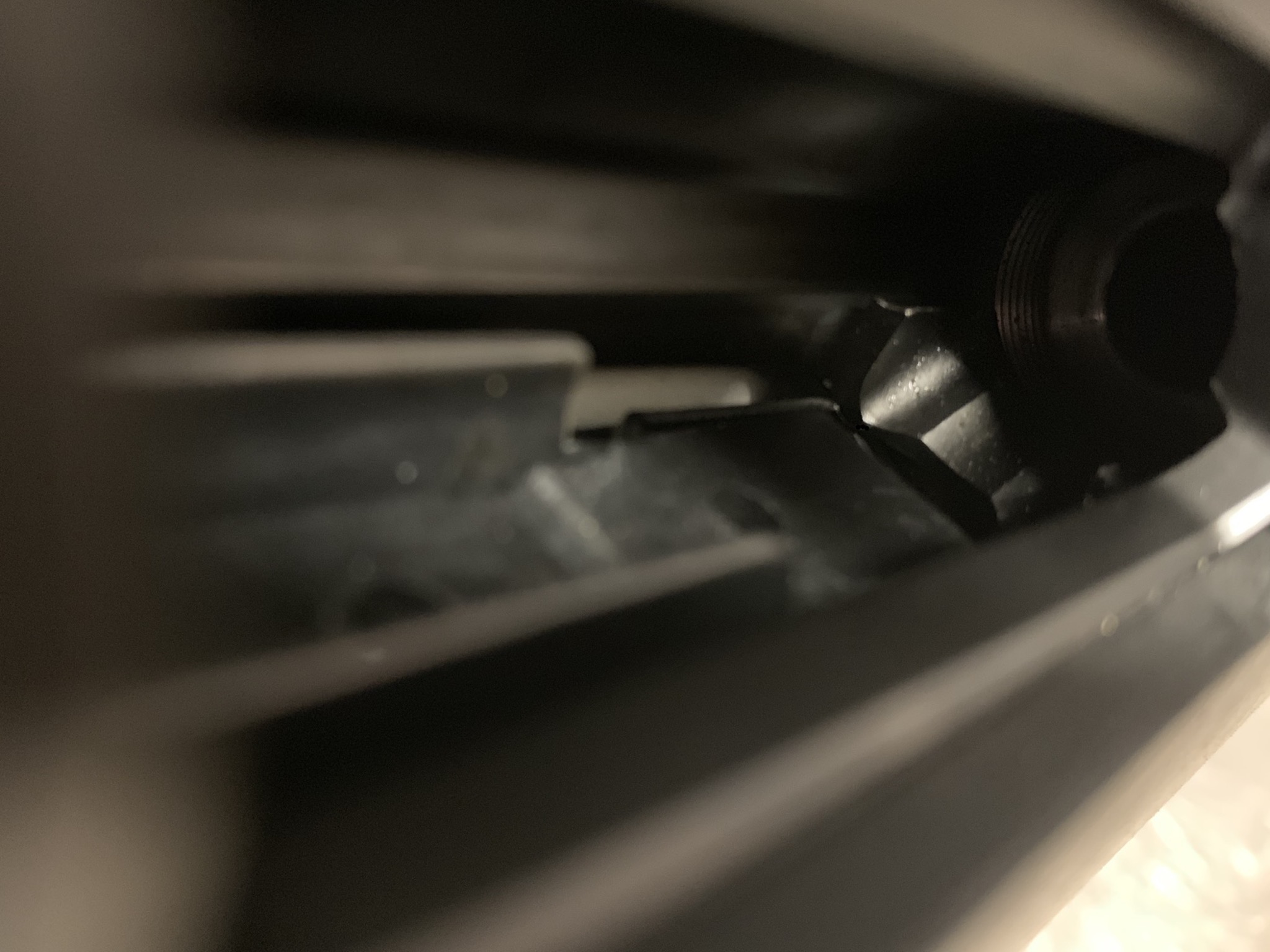

@amf_247, when you say you get a double feed from your AW magazine - the top two rounds are getting pushed forward at the same time from the magazine lips as you close the bolt?
That’s correct. I’m currently playing with lip adjustments and removing the mpa mag block to see if it helps
I just watched the MPA video on the mag block insert, and it appears to be designed to prevent AICS mags from sitting too high in actions with AW (wider) mag cuts. You shouldn't need it when running an AW mag.
I completely understand that and yes my AI mag runs ok. Not great but it works.
I have not been able to use the AW
It sounds like the AW magazine is sitting too high in the action. The feed lips of the AW mag make contact with the a notch running on either side of the mag cut out in the action. If you widen the feed lips they will engage this notch sooner and the mag should sit lower. Did you get your AW new, or used? If used, prior owner might have bent lips in for some reason.
The mag was brand new. My fear is that it’s a chassis issue. Dunno I’m gonna call MPA tomorrow and get their take.
Thanks for the help either way
I too qm having trouble with feedind with my aw mags in my mpa ba chassis. Ive played with the lips and filed the bolt catch a little
If you’ve got the first run of Vectors you may not get the AW mag to run without a lot of work. They changed their AW cut along the way. I’ve got both versions. One will feed from any mag I throw in. The other not so much. It stays in an MPA with the mag block using only AICS mags.
My vector is from the pre-order. I ended up grinding a little off my mag latch and adjusted the feed lips. 3 of my aw mags feed flawlessly and without dragging on the lips or follower. I have 1 mag that will not comply .

Update: filed my mpa ba chassis mag catch and my vector feeds flawlessly from 3 out of 4 of my aw mags. The 4th one is being a pain. Itll just be a last resort mag or whatever.

AW magazine had to be filed to fit. Right side chambers perfectly while the left kicks too far to the right about half of the time.
I wouldn't have recommended you file the AW feed lips. Bend them. It only takes a very small change to correct the issue you have. Myself and another Vector shooter (6.5 and 6 Creedmoor) had the same issue and slightly bending the last 0.5" of the feed lips outward corrected the problem. Try the MPA magazine tool or a pair of parallel jaw pliers.

I filed the catch on the mag not the feed lips. Iota outdoors installed the pillars in their stock for a standard rem 700 action footprint. problem is I had to do some inletting around the lug area to even get it to fit. Way to narrow and a little short on the inletting g for the Vector. Something definitely seems amiss.
