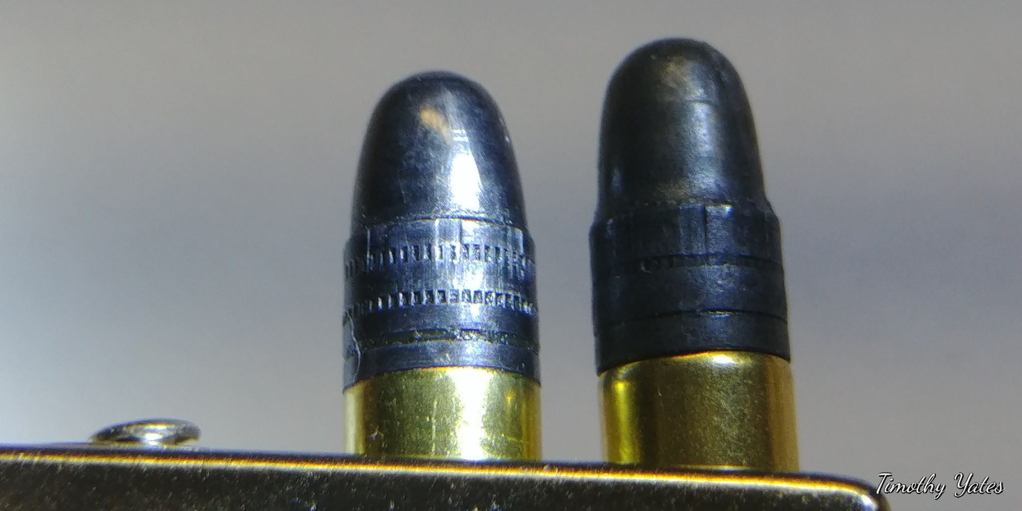

I would say it's nothing to be concerned about. The CCI SV bullet profile and driving band is IMO just a tad longer than a lot of other ammo. It's hard to see but in this photo I believe it shows the CCI "top" being longer than the other. Not longer in OAL but the section that engraves the rifling. My rifles are the same as yours when it comes to taking a little extra effort to close the bolt on CCI SV.

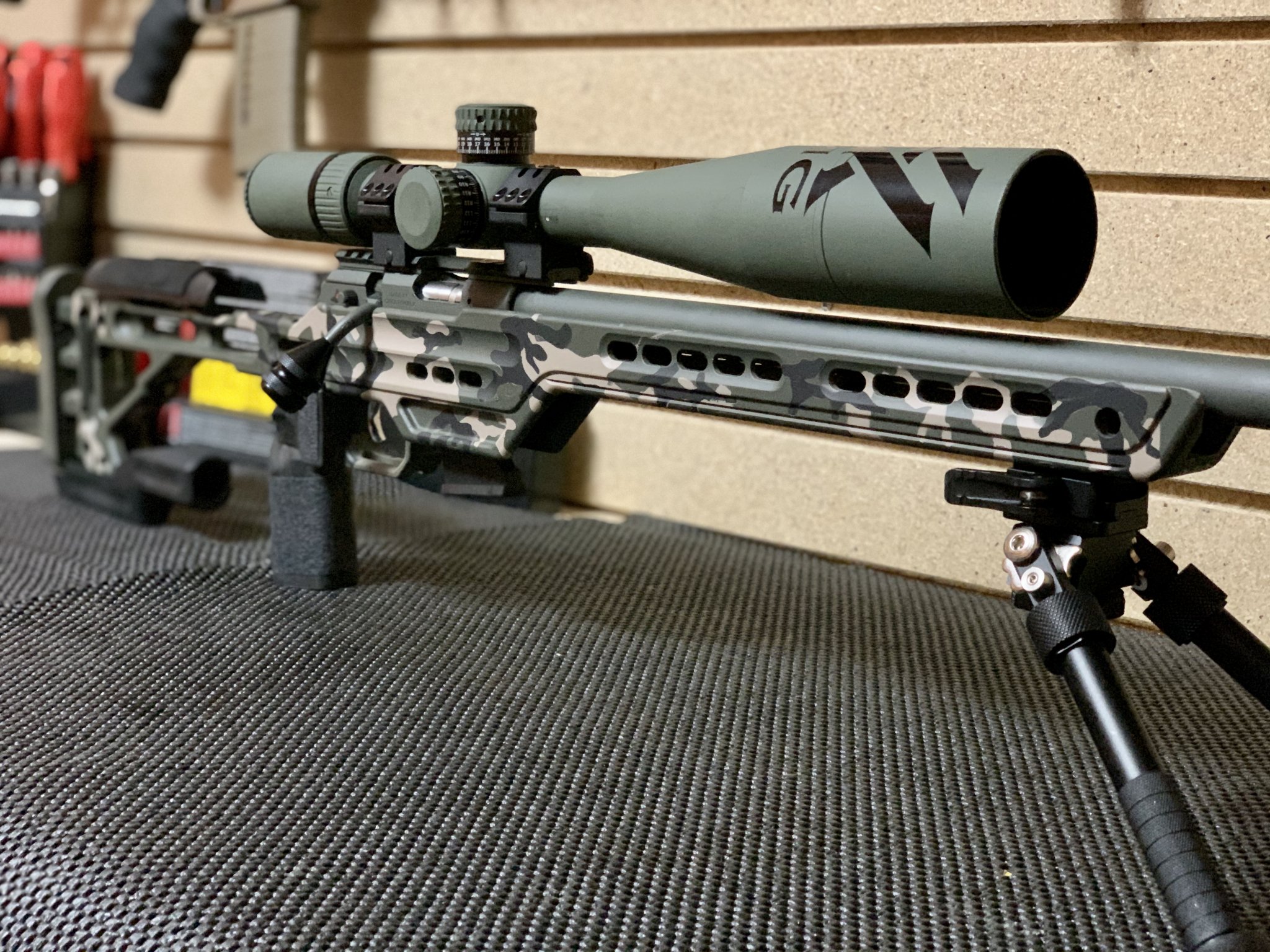

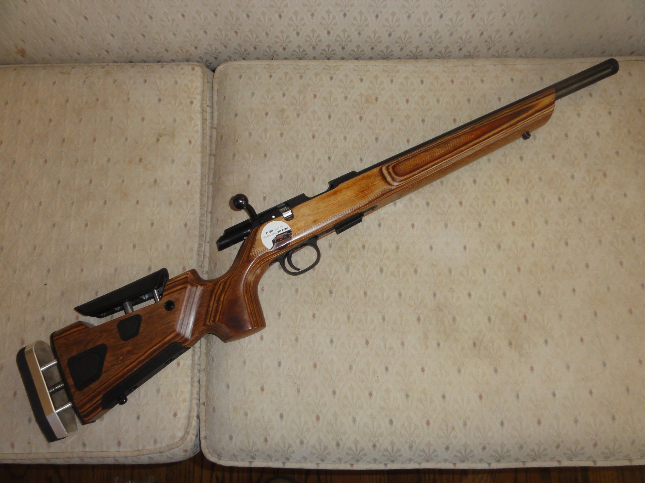

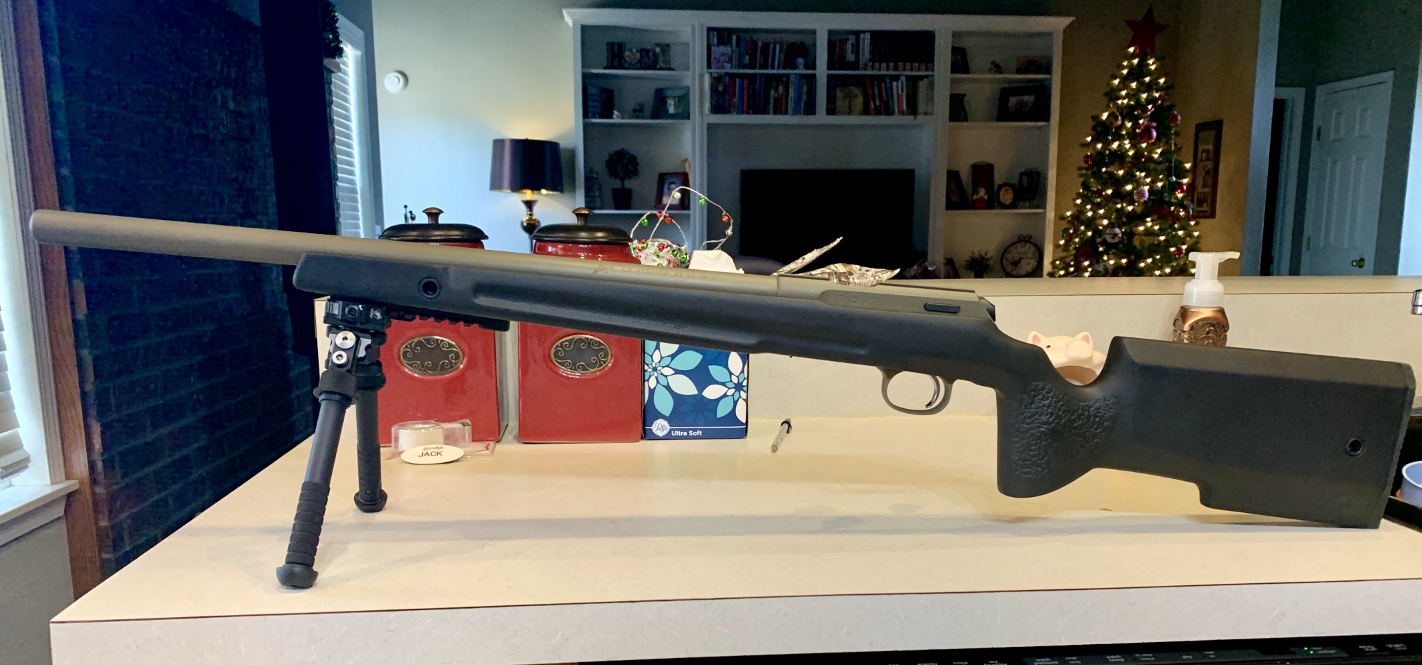

I prefer the simplicity and appearance of the VPT's Manners stock over any chassis I've ever seen. Whether shooting offhand, prone, off rests on a bench, or whatever, the Manners stock just fits me to a 'T'. Granted, the VPT stock doesn't have an adjustable cheekpiece, but considering how low the scopes on my 457s sit when using a BScar rail & low rings, I don't need one. I realize that one size doesn't fit all where stocks are concerned, but it'll be interesting to see the price point of the new chassis 457 vs that of the VPT, and then how the chassis sells compared to the VPT.
Flatland1,

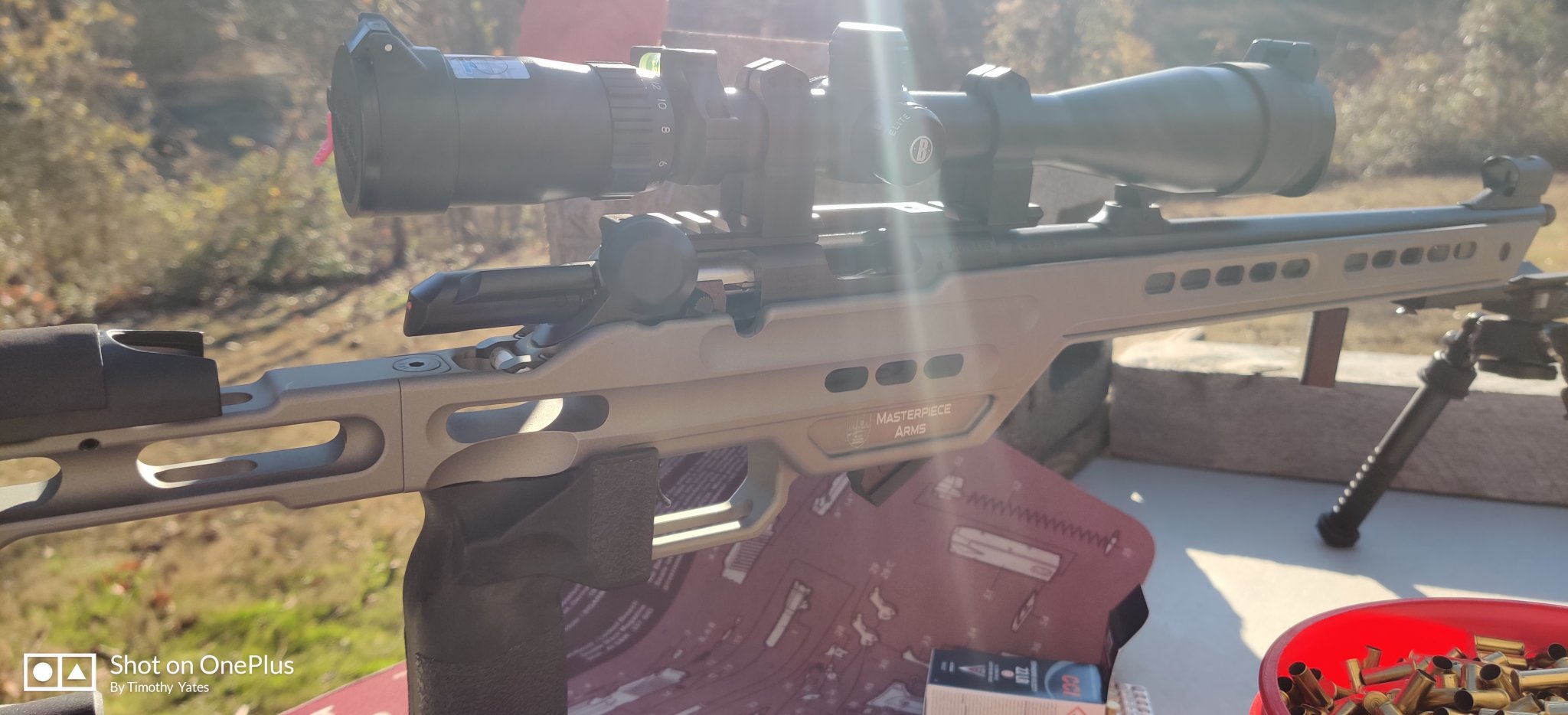

Are you well versed in the Manners lineup? I looked at Manners stocks and like their MCS-T4. Concerns are, can I buy one that is readily available or do I have to wait on it to be made and final price when I add an adjustable cheek riser.
With the alternative of the KRG Bravo and its price point, I'm not sure the extra expense of the Manners is warranted. It appears at this moment neither offer the 457 inlet. This reply is not intended to be argumentative but if I could be educated on the Manners by people with first hand knowledge I'd be grateful.

you can buy 457 stocks from manners that are readily available under the ready to ship tab on their site. yesterday when i was on there, i saw 2. they are the VPT stock though. you can special order just about any of their stocks to be inletted for the 457. you would just have to wait the standard 6+ months or so for the stock. unfortunately, the way the online stock builder is set up, you would need to call them direct to get it ordered.
i have heard a bunch of chatter that the krg bravo for the 457 will be out after the first of the year

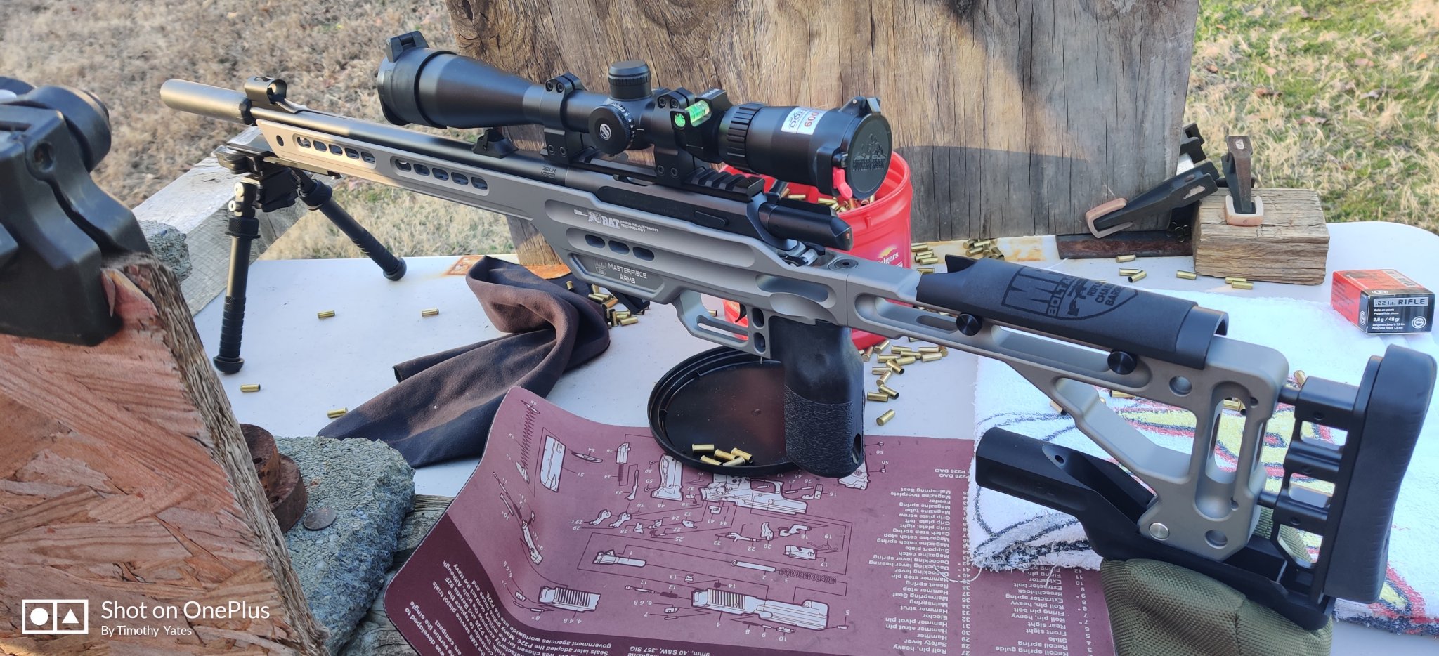

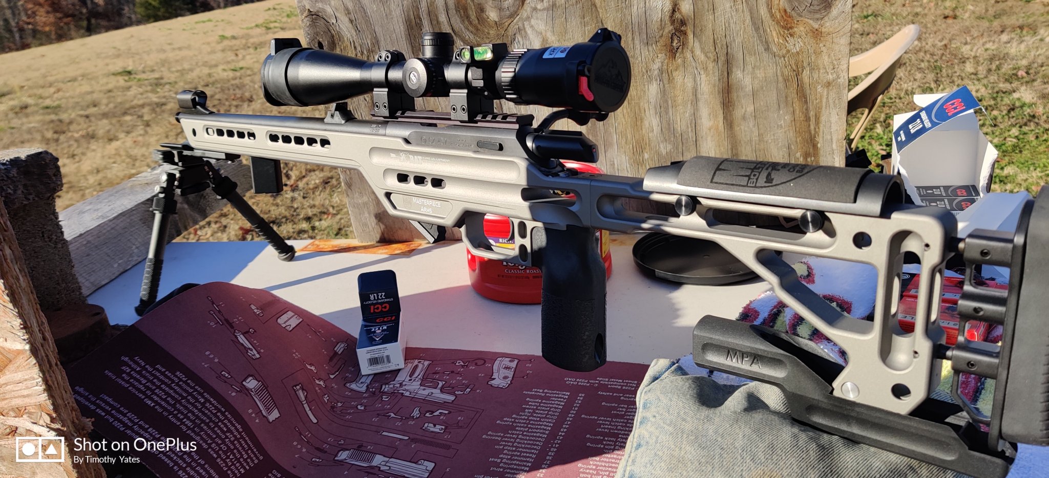

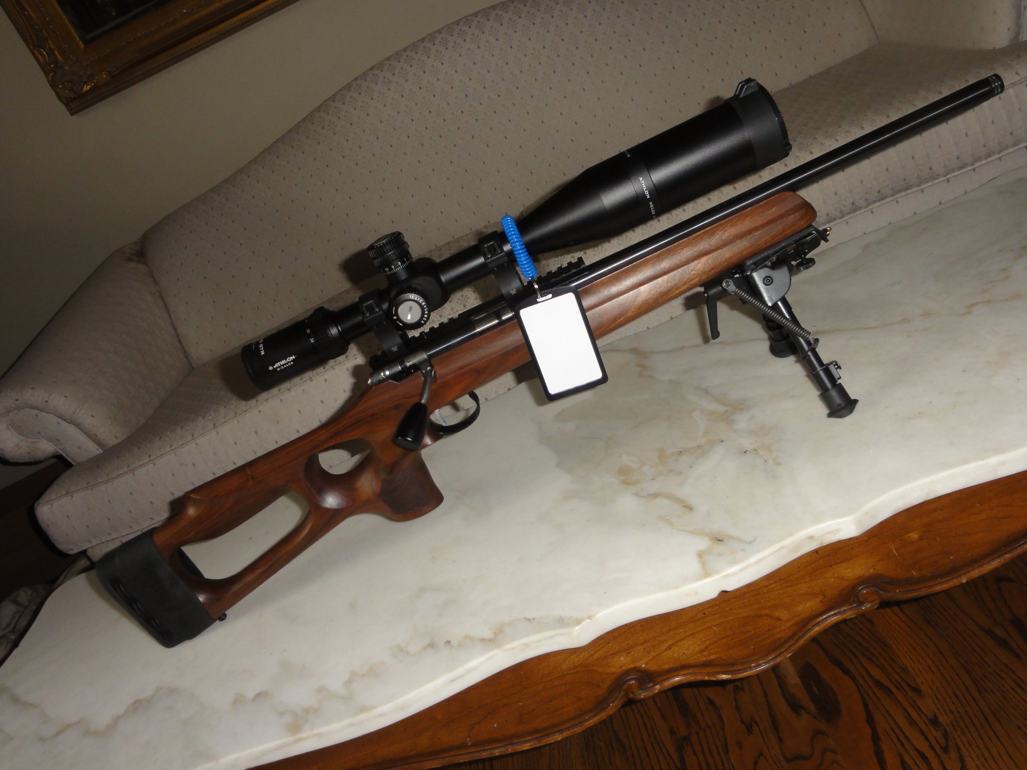

I've got 10 Manners stocks - six T4As, three PRS1Ts (including the one on the VPT), and a V-22 sporter in an EH2. The A in the T4A stands for adjustable cheekpiece - four of mine are on Bighorn TL2 & TL3 short actions, the fifth is on a M70, and the single T4A Elite was on my 1st V-22, before I replaced it with the PRS1T that's on it now. The two adjustable PRS1Ts are on V-22s, and the one that came on the 457 VPT has the solid vs adjustable cheek piece. I prefer the PRS1 stocks because they're nearly a pound lighter than the T4As, and even a bit lighter than the one Elite T4A w/carbon fiber shell. As I mentioned, by using the BScar scope rail & 30mm low rings on the three CZ457s, I don't need an adjustable cheekpiece to get a good cheek weld in prone on the 457 VPT.
The only rifles I own that I'd consider buying a chassis for are four built on Howa Mini actions. One of them is in a McMillan Game Scout stock, and it's tolerable for prone use. Another one is in a Boyds ProVarmint with adjustable cheekpiece, which is fine, except for the weight. Another one is in a B&C #1003 stock, and it's also usable in prone. The one that's really a PITA prone is in a Boyds Prairie Hunter stock, and it flat won't work in prone. As scarce as a light weight prone stock is for the Mini action, a chassis might be a good choice for them.

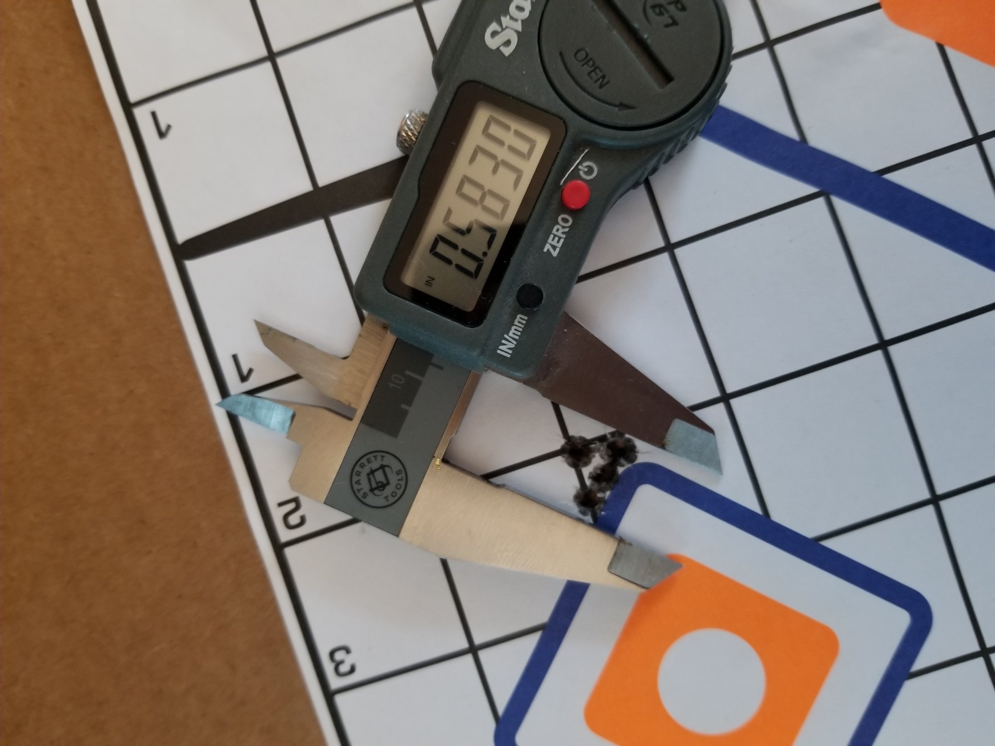

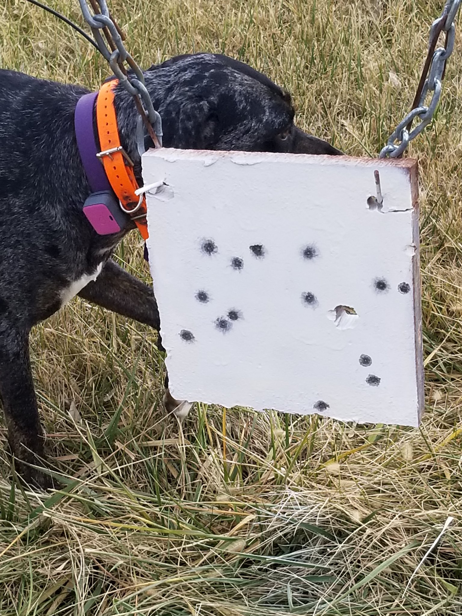

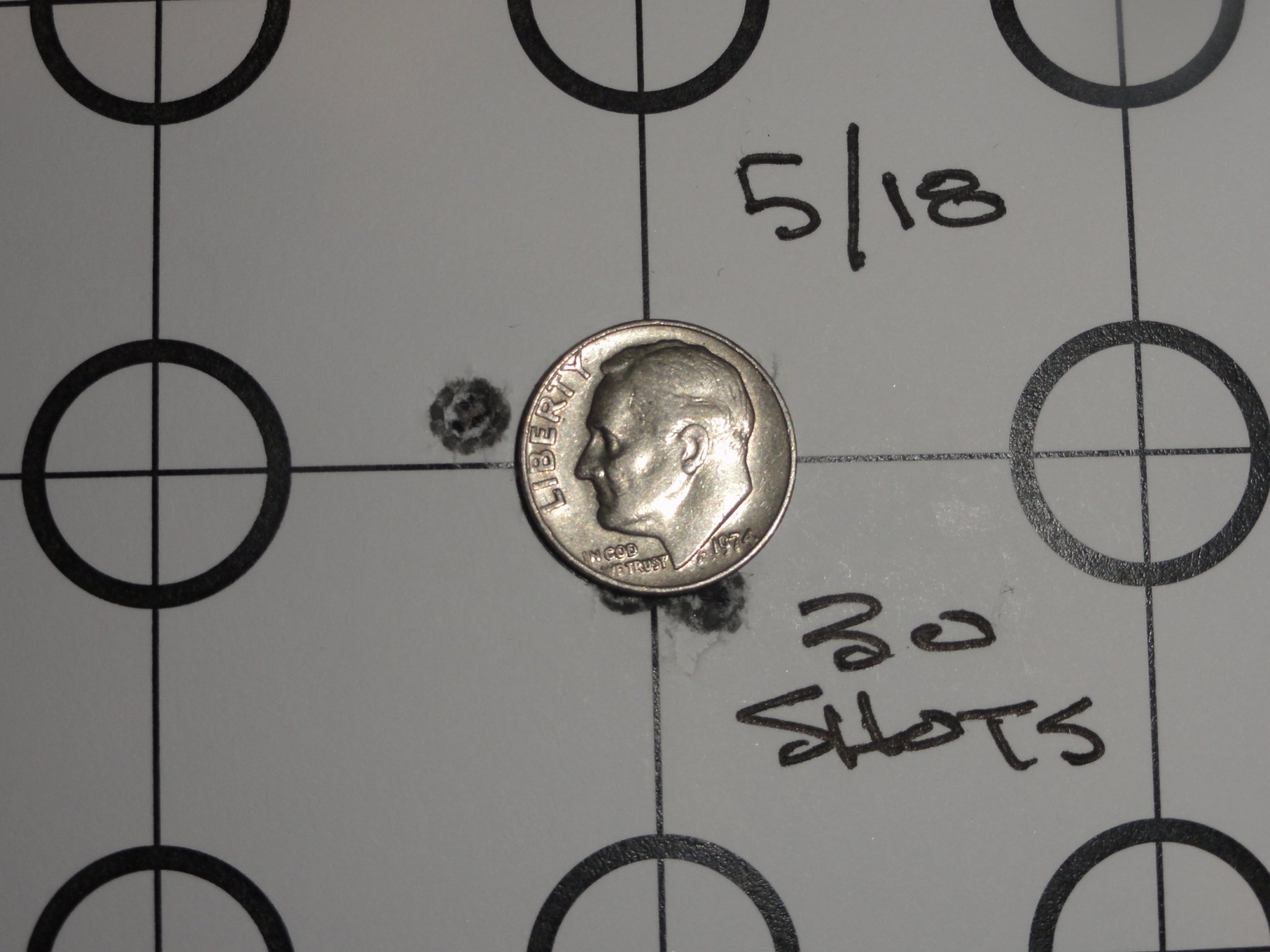

Got to put a couple hundred rounds through my 457 mtr over the weekend, had it out from 50 to 200yards, was a pleasure to shoot. I can see me putting many rounds down range with it. This is my first .22lr rifle. Can’t believe how fun they are to shoot, and can’t wait to get it out again. Once I got the windage dialed up it was almost hard to miss at 200 ?
group was from 50 yards with Aguila high velocity, wasn’t even the best group I’ve gotten with it, and also the reticle is a little thick imo for really precise shooting, but regardless I was happy with it. I’m very tempted to pull my minox ZP5 5-25 mr4 off my LR rig, I’d definitely get more use out of it on this .22 I think, I may need someone to persuade me to do so lol, I’d end up putting the Athlon on an ar15 and an Arken 4-16 on my LR setup.. decisions decisions
I want to try some better ammo also, only stuff I had on hand.
Anyone recommend some decent .22 ammo without spending a ton? Mostly plinking from 50 to 300 yards, gonna annihilate some groundhogs for a buddy farmer of mine in the spring as well.

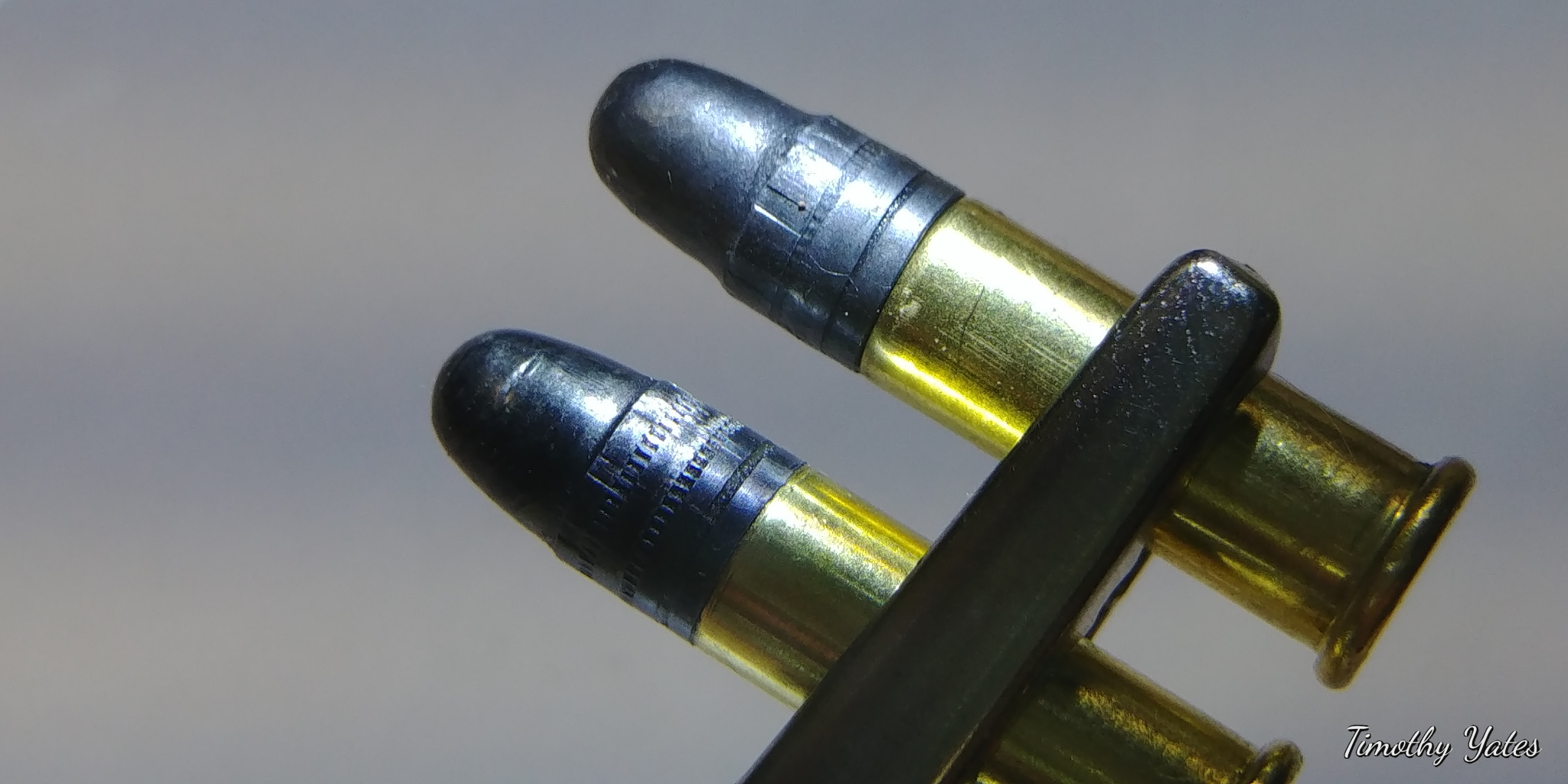

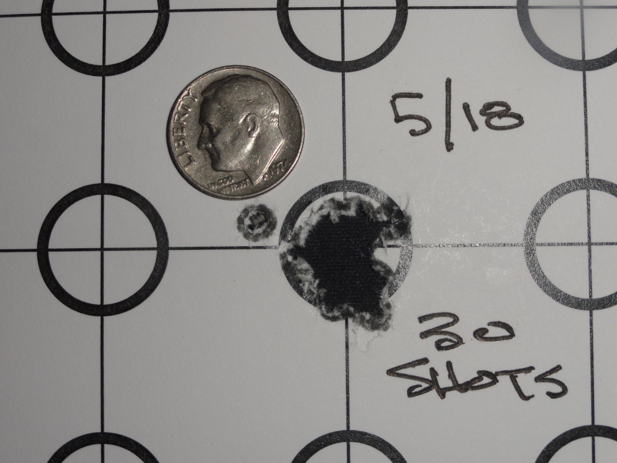

My MTR really likes just about anything that says "SK" on the box. I've done a lot of testing of different lots to find one my rifles like, and was very pleased with a particular lot of SK Std+ I picked out of a batch of five lots. Three of the five lots shot really well; so good in fact that I had to go back through and shoot another set of 10rd groups at 50yds with all five. It was still a bit of a toss-up over which one of the three best to pick, but after I'd made my choice and bought a case of it, I'm very pleased with the lot# I picked. Only regret is only buying one case of it - should've bought at least two... Testing Lapua Center-X & SK Rifle Match, I went through about a dozen different lots of each before finding ones that were worth buying in quantity. I'm set for at least another year after buying two cases of Center-X & Rifle Match, and single cases of SK LR Match & Pistol Match. When I just want to plink with my 457 American or VPT, I've still got several bricks of a poor quality lot of Wolf Match Extra from several years ago - but its accuracy is poor enough that 25-50yds is about as far as I'll shoot it - I don't mind using it for just fun offhand plinking, but that & blasting away with new CZ bbls just to get some rounds through them to get them broken in are about all it's worth using it for.
The thing that makes purchasing quantities of good lots really worthwhile is that when I come across some really good ammo, it almost always shoots equally well out of all the custom bbls I've got on the rifles I've taken the time to work with. Even the better CZ factory bbls have shot their best with the lots I've tested & bought in quantity.

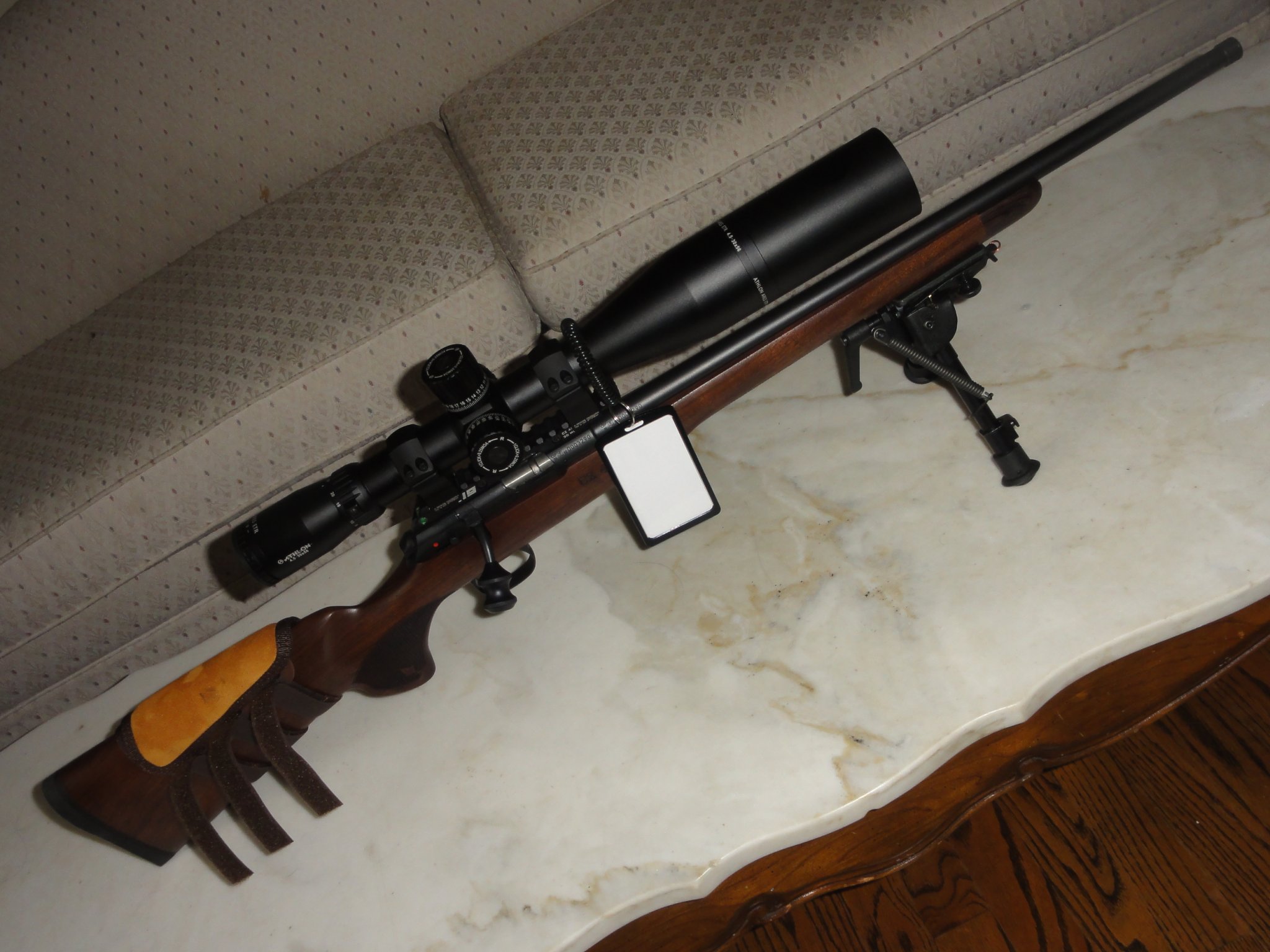

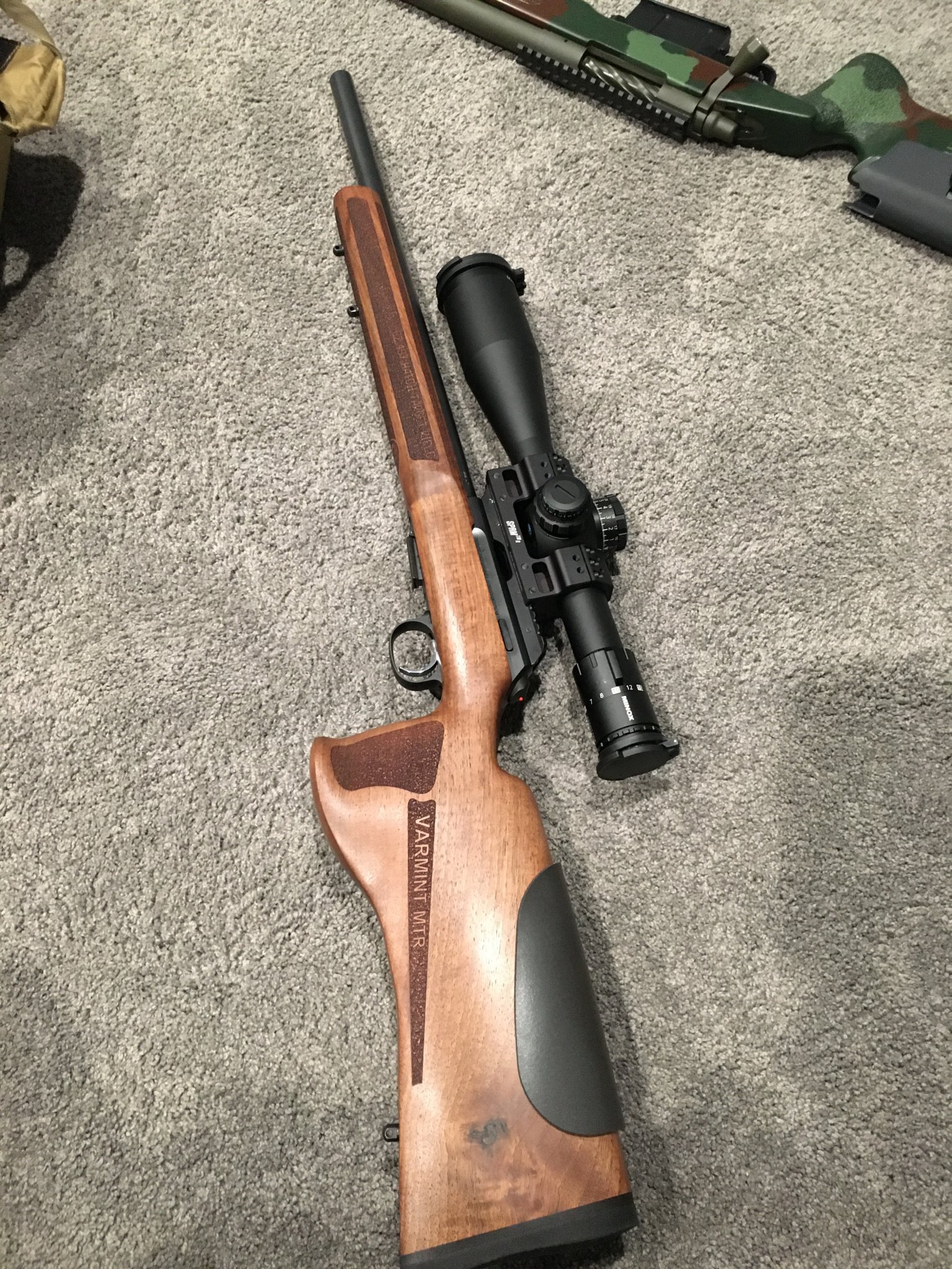

Hello Mop,

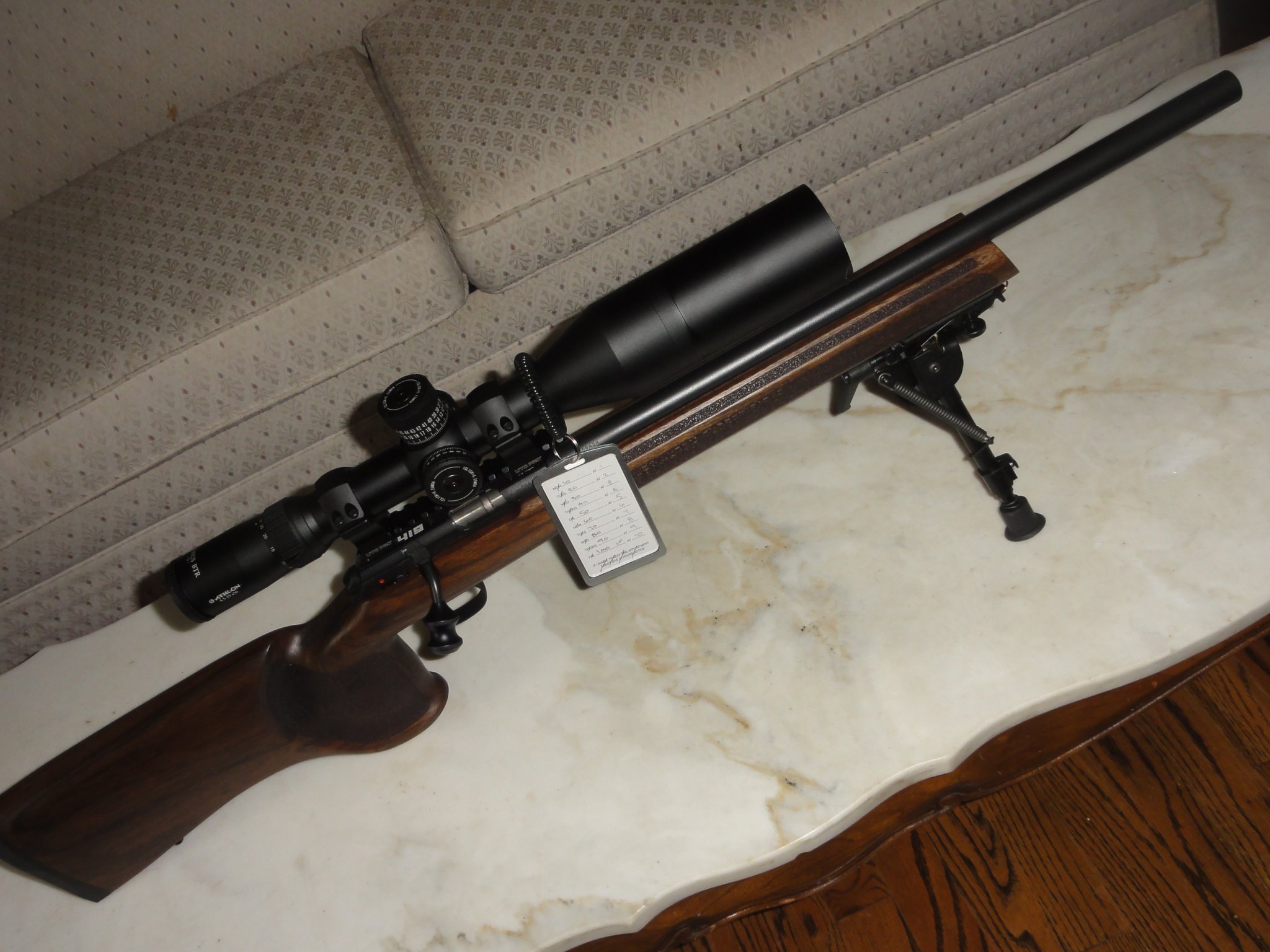

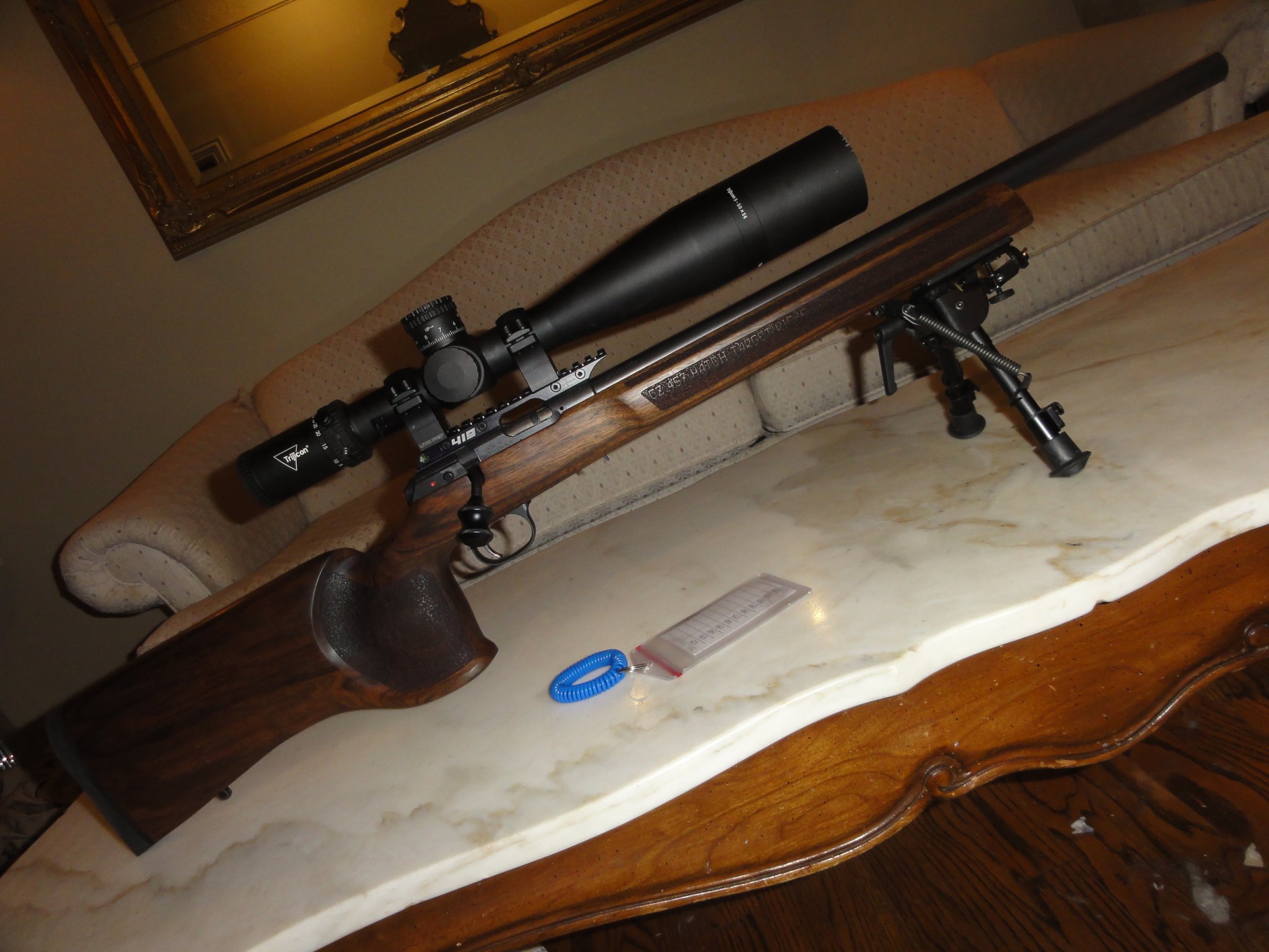

So glad to see that you have a 419 bolt knob on your gun. It is so much nicer than the stock knob. I agree with Flatland. My MTR and Royal love SK rifle match. (red box) I get my ammo from target Sports USA. I place my MTR only behind my Vudoo. The MTR is a joy to shoot. It is so nice that I bought a Trijicon 5-50x56 for her. that is the same scope that I run on my V22.
I put a Athlon Cronus on my Annie and an Ares on my Royal. So I would say yes to putting a better scope on your MTR. My target shown was shot at 64 yards with SK red box. btw... DIP has an extended mag release for your gun. It is only 2mm longer but it is aluminum, the stock unit is plastic. I would also suggest a trigger job and spring replacement.

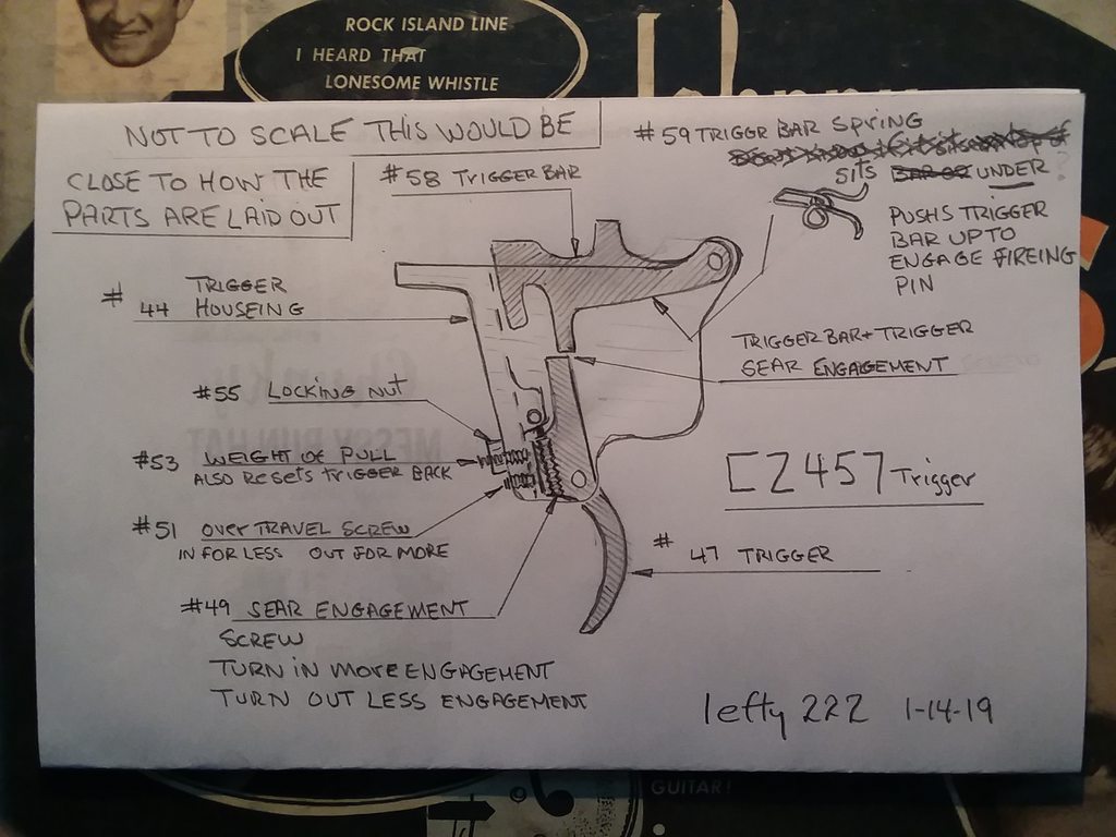

My CZ triggers are set to 10 oz. and very solid. The sketch is pretty good, though not mine. Item number 49 is backwards. Screw in decreases sear engagement. I like your check pad, who makes it? If you look at the fifth
photo just high and right of center, you can just make out my 200 yard steel.
I only wish the MTR had a threaded muzzle.
Shawn
EDIT: Target was shot at 64 yards without tuner. I snatched the trigger on the flier.

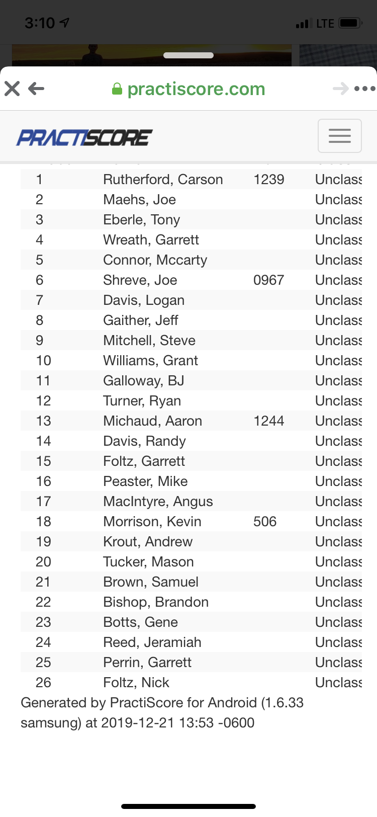

Shot my first 22 NRL match this weekend and my Cz 457 definitely didn’t hold me back any. I believe I’m truly addicted to these matches now. Haven’t had this much fun in a long time. Definitely need to practice my positional shooting. I was quite surprised with my third place finish, not bad for an old fat guy.

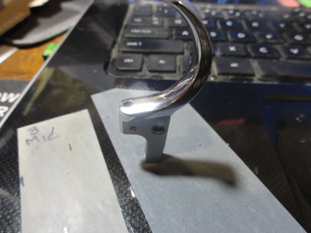

If you do the trigger, I would be happy to send you out lapping film, moly grease, silicon grease, .014 diameter and .018 diameter wire springs. It would probably take about two hours to do it but it is an easy task. The sear is easy to polish because it is such a large flat surface. It virtually keeps itself square and level.

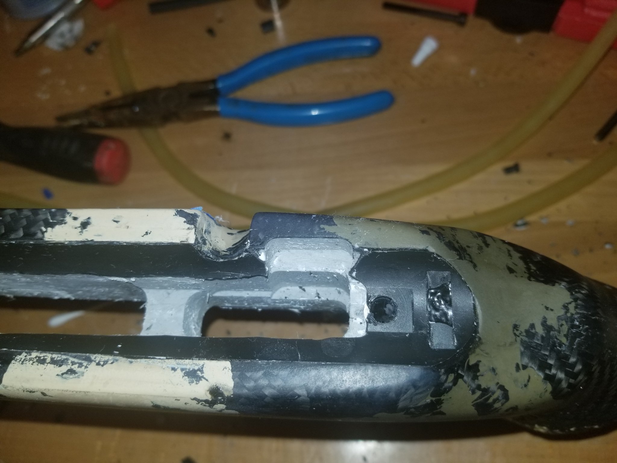

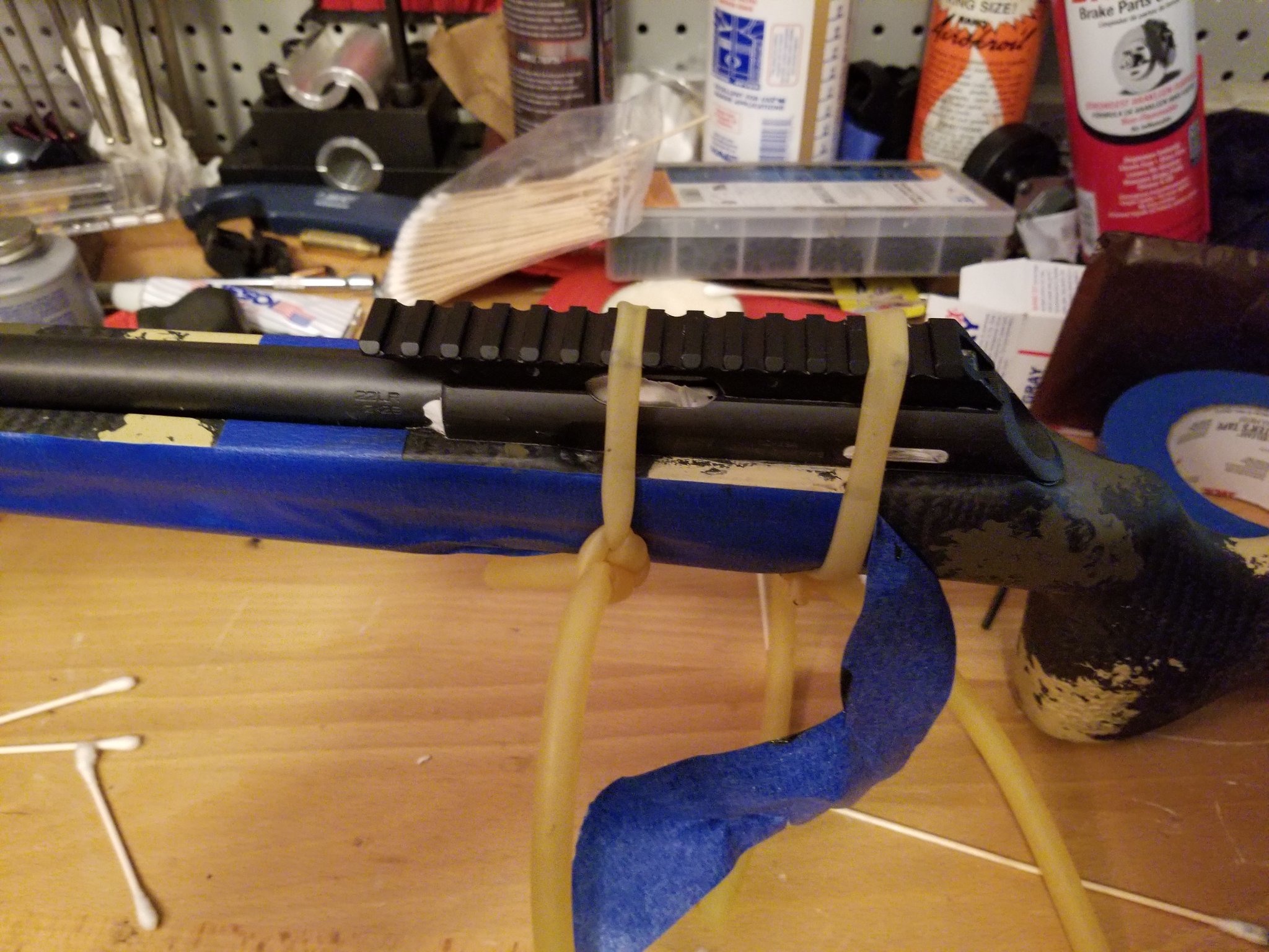

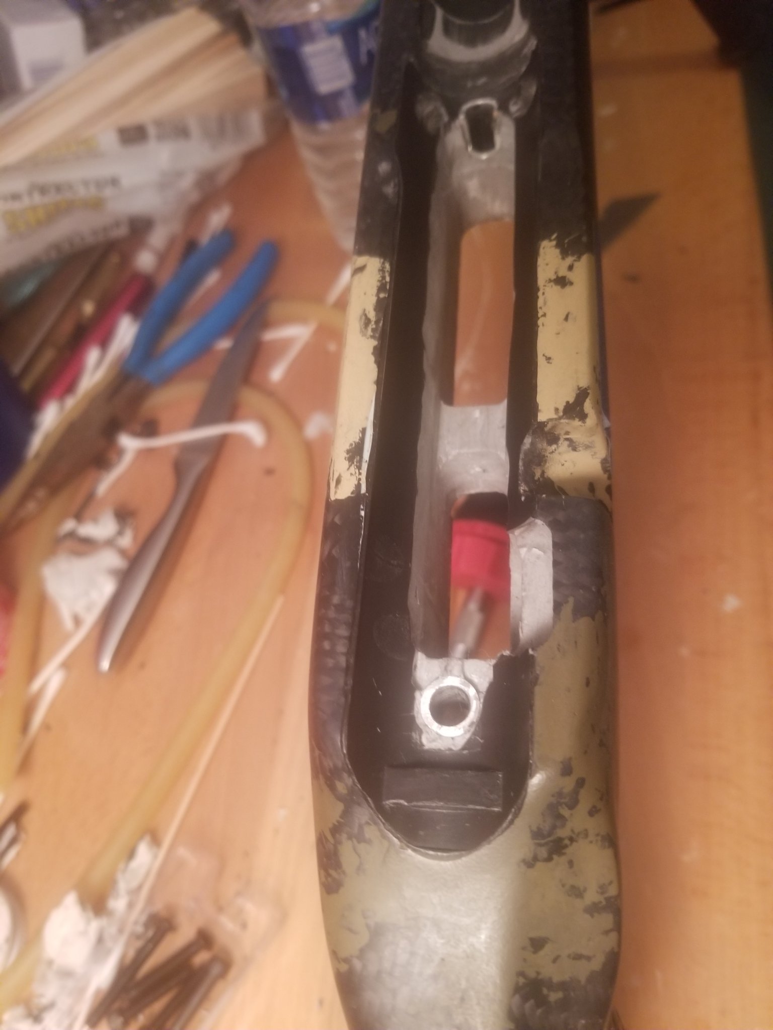

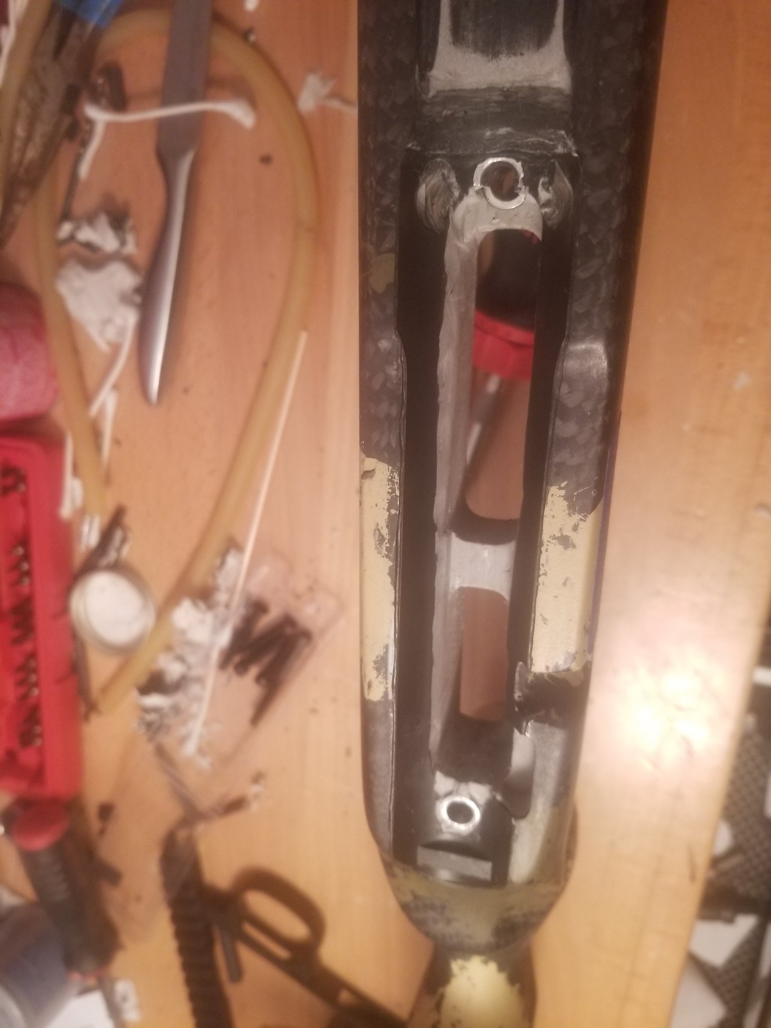

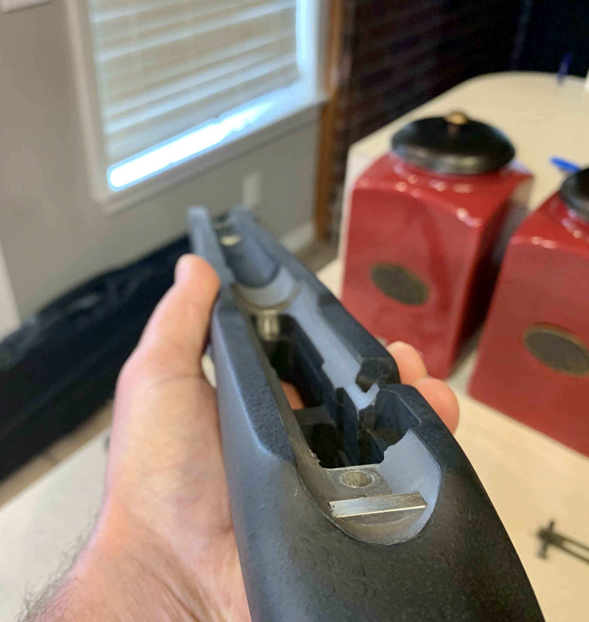

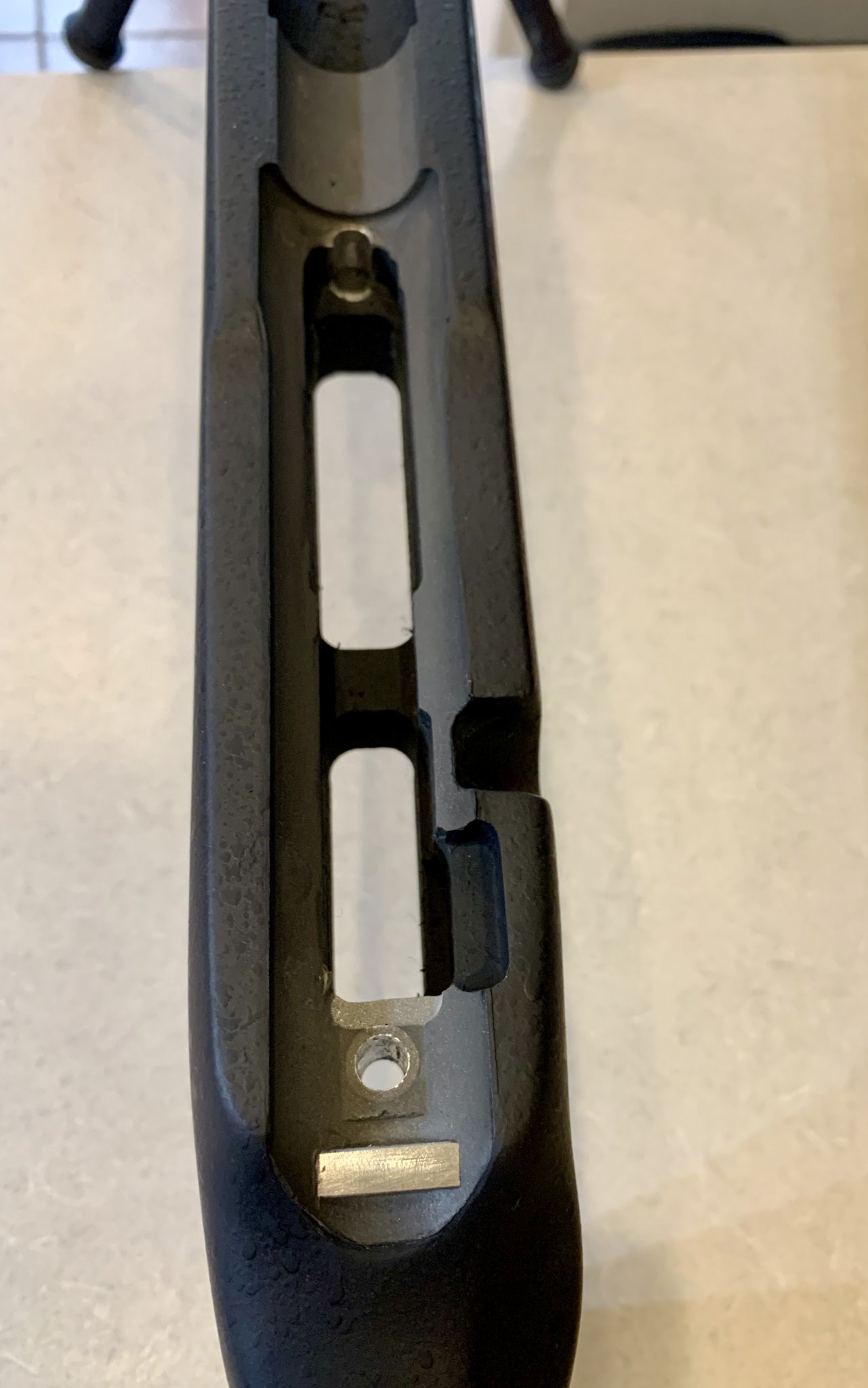

Still have to clean up everything but for some reason the back of the action didn't go down against the pillar and the recoil lug. It is raised about 1/16", I'm not sure whether to take the bedding out and redo it or shoot it and see how it does first.
Still have to clean up everything but for some reason the back of the action didn't go down against the pillar and the recoil lug. It is raised about 1/16", I'm not sure whether to take the bedding out and redo it or shoot it and see how it does first.View attachment 7211051
How do you know that you are .06 high? Above in entry #853, Dr. Glock has a great looking stock that he had bedded. If you look at the rear pillar you can see how thin his bedding material is because you can just make out the aluminum pillar color through the really thin bedding material. Also, he has a square around the pillar similar to yours. I'm just curious, it may be obvious when you have the stock in hand. Also, is using surgical tubing standard practice? I would have guessed that you would have used the action screws for the compression and also to keep the action aligned squarely in the stock. Again, just curious. I have never even read about bedding yet.
Shawn
How do you know that you are .06 high? Above in entry #853, Dr. Glock has a great looking stock that he had bedded. If you look at the rear screw post you can see how thin his bedding material is because you can just make out the aluminum screw spacer. Also, he has a square around the action screw similar to yours. I'm just curious, it may be obvious when you have the stock in hand. Also, is using surgical tubing standard practice? I would have guessed that you would have used the action screws at nearly full torque for the compression and also to keep the action aligned squarely in the stock. Again, just curious. I have never even read about bedding yet.
Shawn
His is done perfectly. It's obvious in hand and I scraped a little away from the pillar to confirm. From the research I did, most recommend studs and using tubing or I have seen zip ties used. The theory is tightening the screws can induce stress. Not sure where I went wrong but it is bothering me. I thought it went well until I popped it loose. I know the recoil isn't an issue with a 22 so it will probably be ok. I'm going to try to shoot tomorrow to see how it shoots and go from there unless someone suggests otherwise.
So it sounds like they are using headless studs to keep the stock and action square to each other. I have seen many wood working applications using latex tubing for clamping things together while gluing them up, like chairs. So that makes total sense. I have never felt the need to do a bedding job but I do have a Ruger RPRR that may benefit from it. Some people are using HVAC foil tape for that gun and that doesn't feel right to me.
Best of luck
Reactions: Bradu
Bedding a rifle to stock should be a science not an art. Since there are a lot of different opinions an how to do it, I will give you mine. I use custom made studs to locate the receiver to the stock. The studs need to fit the attaching holes snugly, . I then locate the receiver where I want it to be after the bedding is done by using painters (blue) tape, applying three wrapped areas on the barrel. I want it not touching anything, you can check the fit before applying the bedding compound by using modeling clay near the screw holes to see the clearance. I do not use any pressure on the receiver while the compound is setting up. I do hold the barrel in place with rubber bands available from Brownells.
Reactions: Bradu
Best of luck
I ordered machine screws and cut the heads off, then I used heat shrink to have a snug fit into the pillars after screwing them into the action. This second attempt looks much better, only issue I had was the rear pillar didn't appear to have been glued in place so it came up with the action when I separated the stock. Looks like a minor fix but I will post some pictures after I get everything cleaned up. Pretty happy with the way it turned out other than that.
Not the best pictures but it turned out better. The back pillar pulled out some so it chipped out around there. I will get better pictures when it's daylight out. The basement is too dark and the flash didn't make it any better.

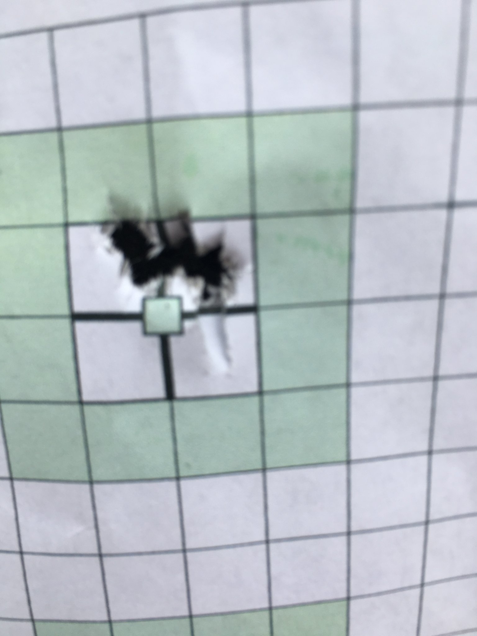

After lurking in this group for awhile, I wanted a new squirrel/groundhog gun. Finally got all the pieces for my 457 .17hmr build, and was busy over the weekend. The MPA chassis and bolt knob showed up on Friday, and as soon as I unboxed it, sprayed the etching primer, and stencils and laid down the Krylon. Had the barrel threaded for a 1/2-28, and waiting for the Form 1 to be approved. I haven't touched the factory trigger, it breaks clean, and I like it just how it is. I topped it with a BScar rail and a PST Gen II 5-25. I know its not an AMG, but Vortex doesn't include a super sweet sticker with the PST, and I had it lying around from my AMG on my .300wm build. Hopefully the rain will hold off this weekend and can put some rounds through it.
I'm pretty happy for being cold and shooting the rifle for the second time. Both are 5 shot groups at 50 meters without the bullet diameter subtracted. Once it warms up I will play with ammo and see what the gun likes. I was really happy at 200 yards on steel, had a couple 3 shot groups that were 1.5"-2". I don't know if I was just lucky or how repeatable they will be but overall I'm very pleased with this rifle. 300 is challenging with the wind gusting. I was shooting lapua center x today.

The quick summary: It shoots great. .5moa at 50 yds is possible with SK Red ammo. Of five 5 shot groups I'll get 1 group under .5moa, 3 at around .6-.7 and one group right around 1moa. For 5 five shot groups at 50 yds, the average is .6moa. I'm happy. The only other ammo I've shot is CCI Std Vel and Green Tag, both of which shot really bad (surprisingly).

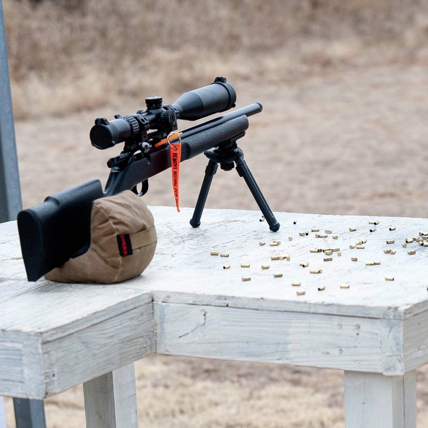

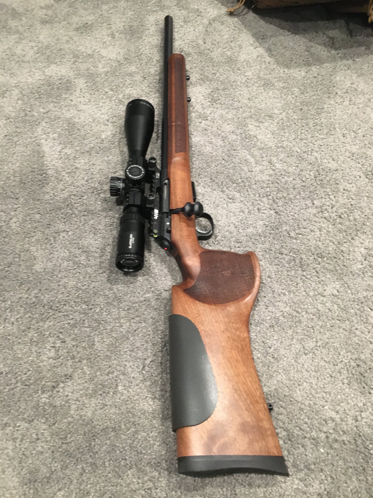

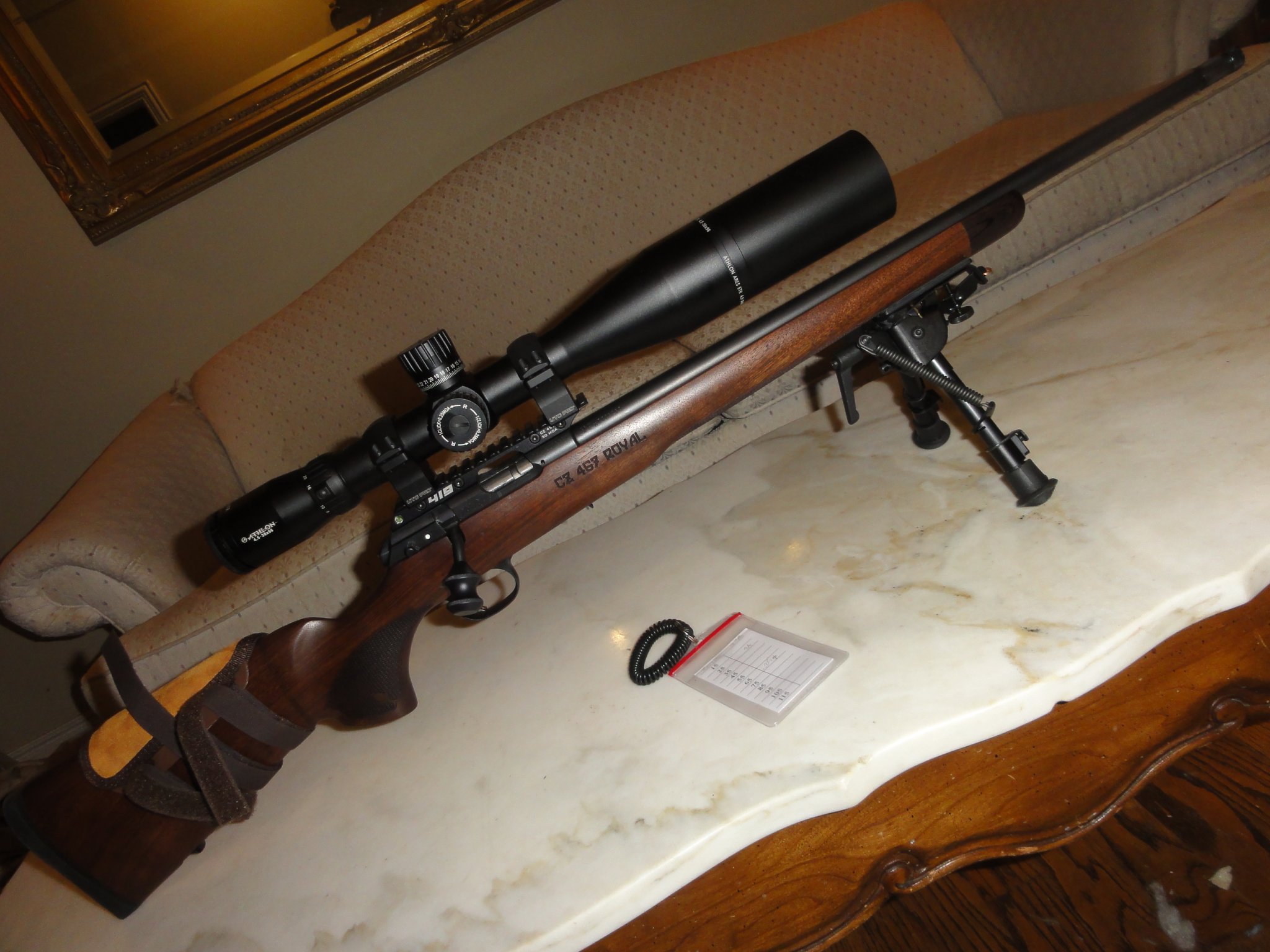

My NRL22 base class CZ 457 ProVarmint with Swampfox Patriot scope, magpul bipod and wiebad bag. A killer little rig.
Hello ACO, Good looking rig. May I suggest the AREA 419 bolt knob. It extends the lever arm making it much nicer to cycle the bolt. I just picked up the CZ 457 At-One today and it's trigger is set to 14 oz.
I have had good luck with SK rifle match. What type of ammo are you using?
Shawn
