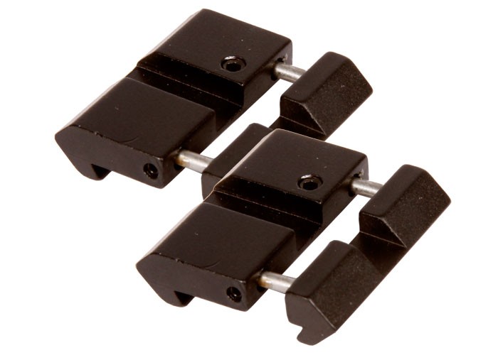

I have three 457s myself and I would have liked to go with cheaper Bscar or DIP rails but they use set screws to push against the receiver. I spoke with Bob at DIP and he suggested that I put some number 8 lead shot under the set screws to prevent damage to the gun. I just picked up a Sako Quad Range on Monday and I need a rail for it as well. To avoid damage, I just ordered the 419 rail for the Sako because of the way it clamps onto the dove tail.
Personally I find the 419 built in level useless. I really just wanted to mention to you that you may consider putting some shot under those set screws.
EDIT: I just found this .50" longer magazine release from Anarchy Outdoors. The other extended mag releases are only about .09" longer and hardly worth doing. It also helps me locate and insert my 10 round mags.
It's only about 20.00$ I would think it would be a must have if you have a chassis mounted 457 with the deep mag well.

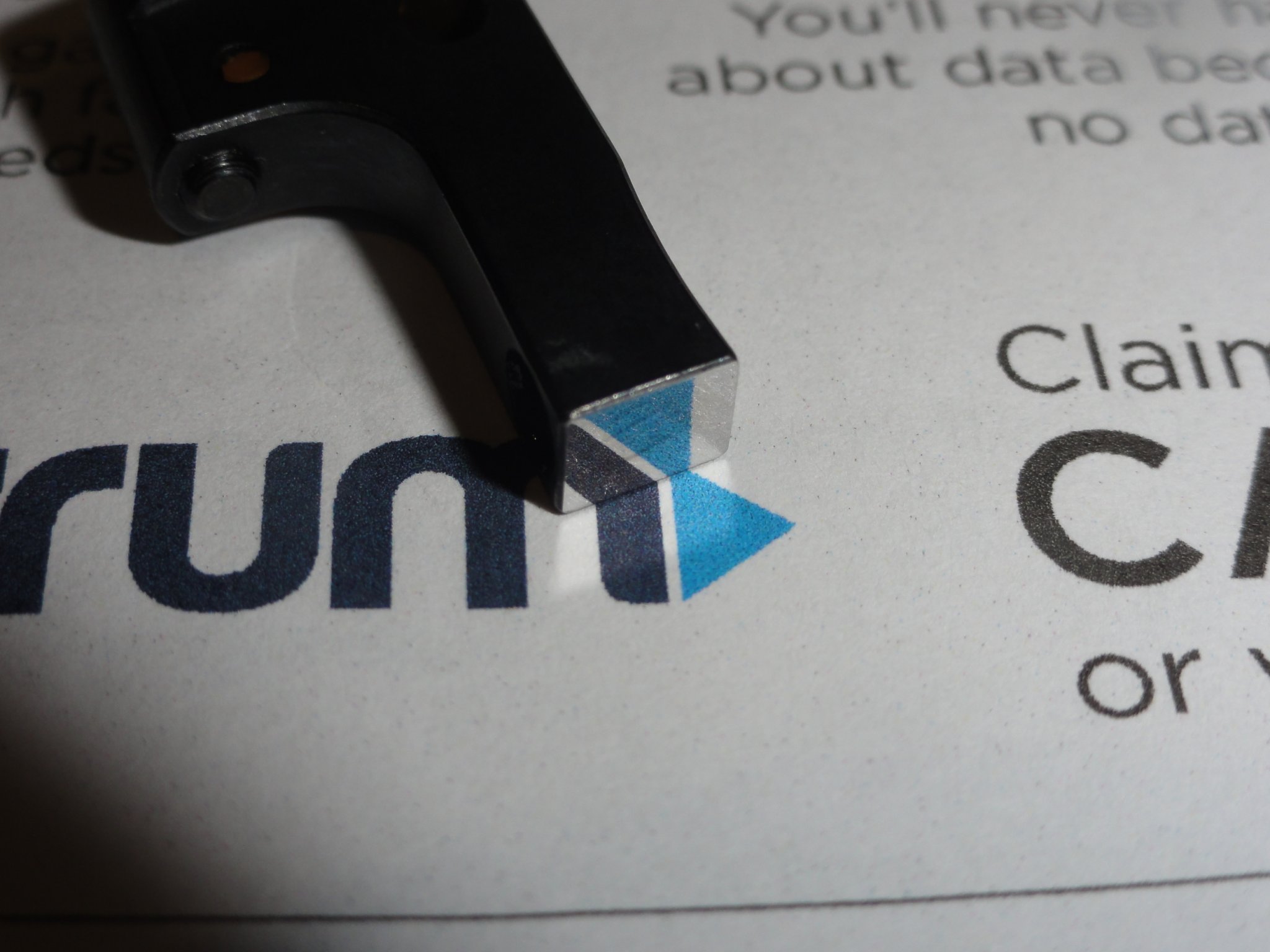

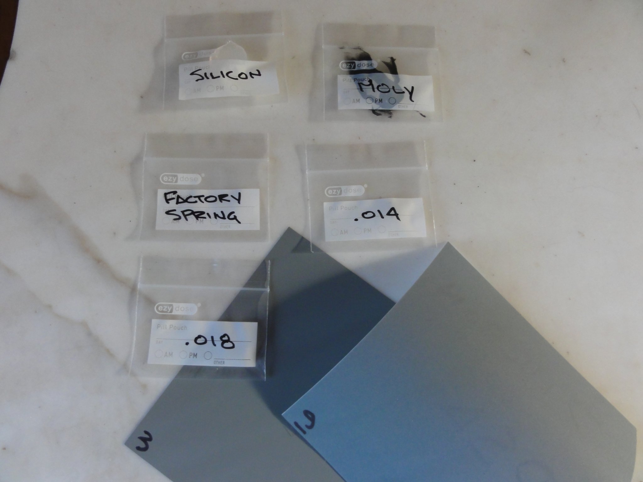

Hey Ballistic,

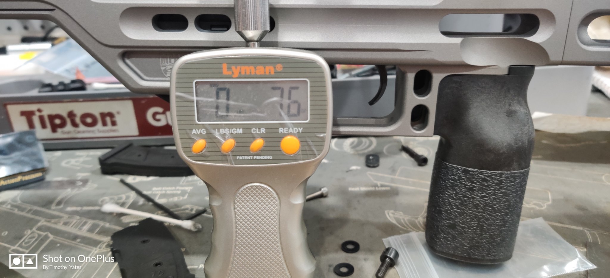

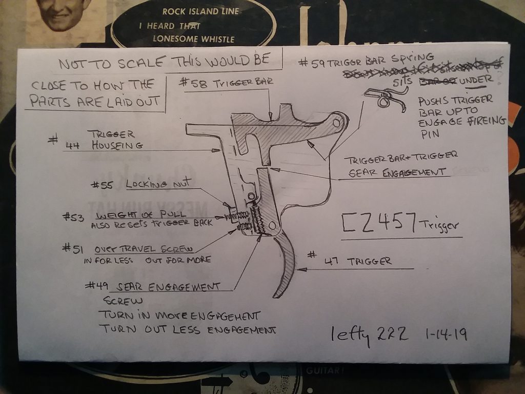

After you shoot your 457 a bit, you may want to lighten the trigger. It is a simple job and it costs nearly zero dollars and I would be happy to supply you with the springs, 3 and 9 micron lapping film, silicon grease and moly grease. All you need really do is lap the trigger blade sear, replace the trigger spring and make some adjustments.
BTW... Lefty 222 did a pretty good job on the sketch but he got #49 backwards. Screw in provides less sear engagement.
All of the people that I have helped with their triggers have them about 10 oz. That is except the last guy. He has his at 6 oz. and totally safe.

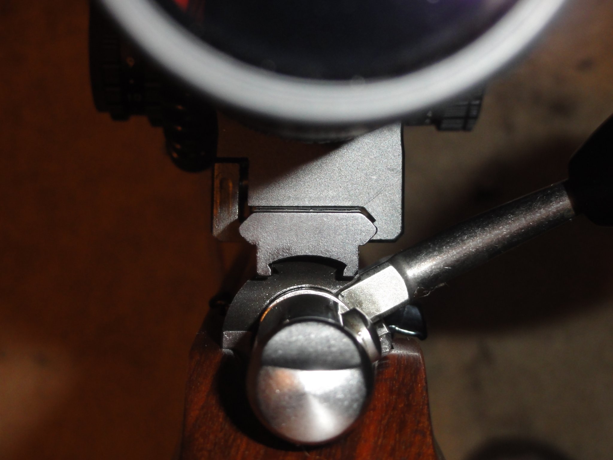

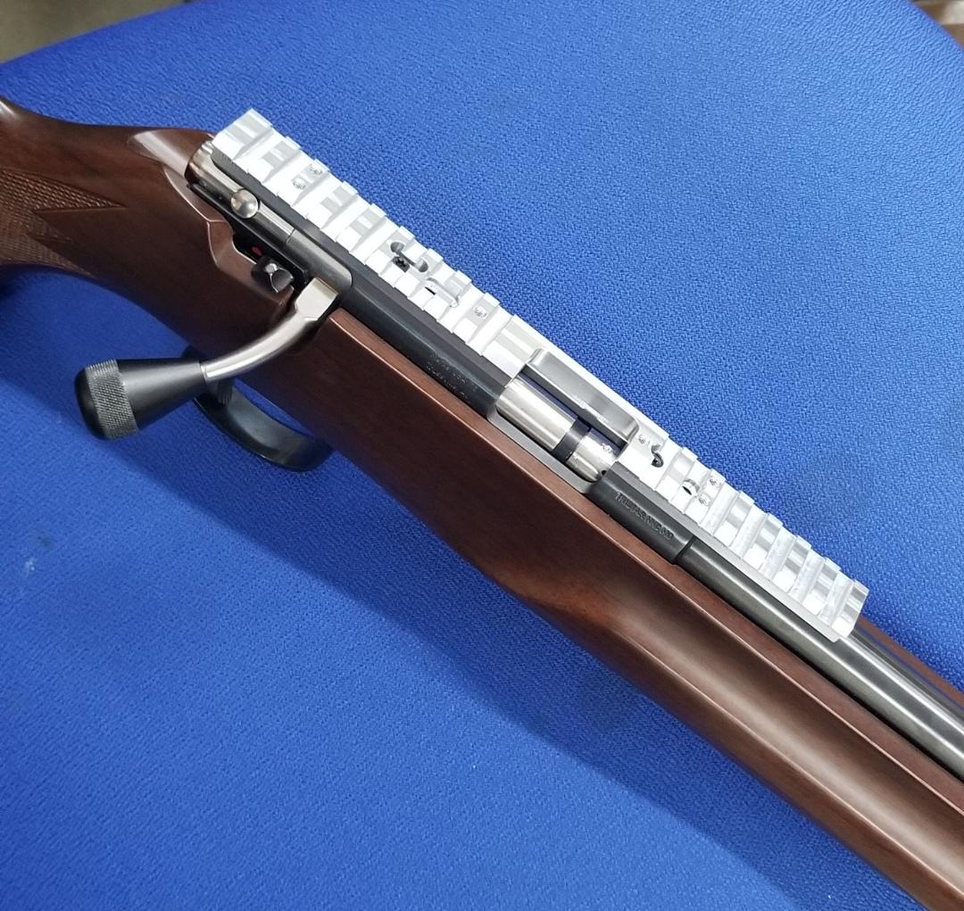

I would also recommend the AREA 419 scope rail because it clamps to the dove tail. The other rails drive set screws into the receiver and can leave divots. If you are set on using a set screw type rail, you can put number 8 lead shot in the screw holes to protect the action. Bob at DIP told me that soft tipped set screws will loosen up. I also highly recommend getting a 419 bolt knob. It improves the feel of the action a great deal.
I just ran across the Anarchy Outdoors extended magazine release. It is longer by about .50". The other extended mag releases are only about .09" longer and barely worth doing.
I'm so pleased with the CZ 457 product line as a whole, I have three different ones. I feel like your going to be really happy with your purchase as well especially with a couple mods.

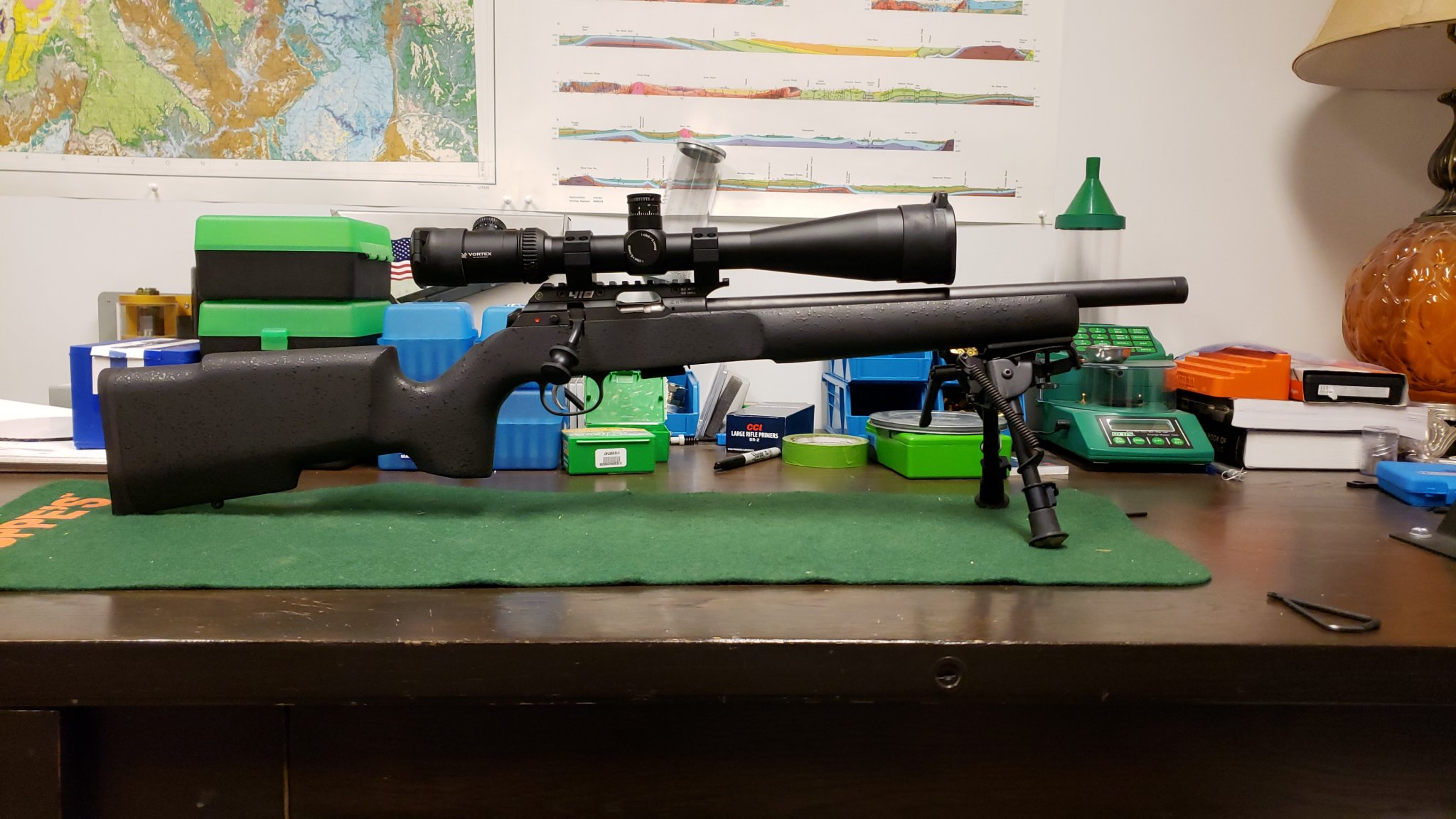

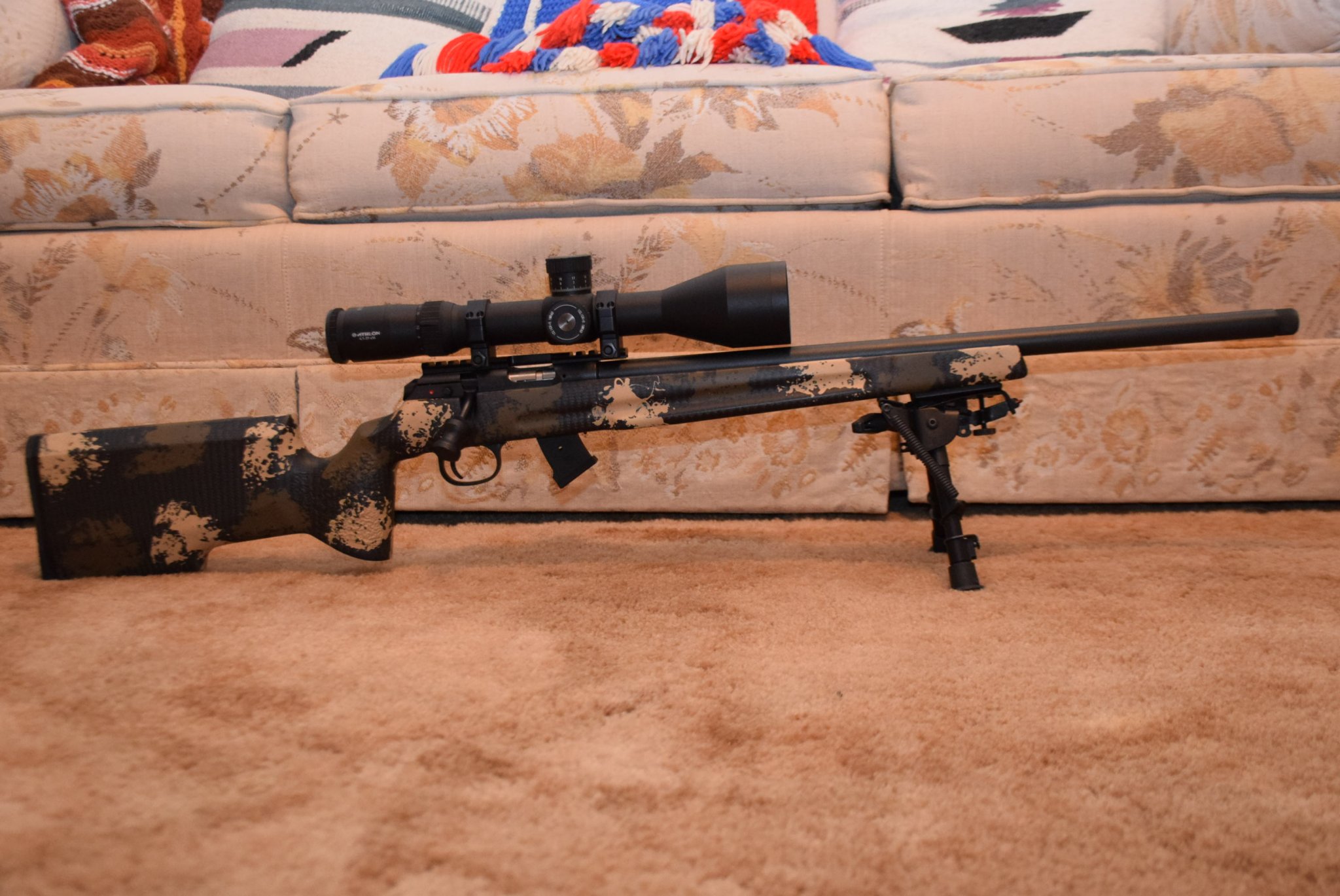

This is my VPT after re-barreling with a Shilen ratchet rifled .850" dia straight cylinder blank that I finished at 22". I used a PTG EPS match reamer, and the rifle loves a known good lot# of Center-X - it might even shoot this ammo a tiny bit better than the Krieger & Bartlein bbls on my V22s out to 200yds. Need to find the time on a day with decent conditions to compare the three rifles with this ammo at 50/100/200. I put an Athlon Cronus (older, pre-BTR) on it in TPS TSR low rings on a BScar 25 MOA rail, and really haven't felt the need for a stock pack or other means of producing a higher comb.
This is the first & so far only VPT I've seen that came with the trigger finished in the same black nitride as the action - all the others I've looked at had a polished and/or chromed trigger. I mixed about 20% tungsten in with graphite black when I CeraKoted the bbl, in an attempt to match the black nitride finish of the action. Like previous re-barrel projects of the 457, I glued this one in instead of trying to figure out how to hold the bbl to machine the grub screw seats in the tenon. In addition to being simpler, the glue-in puts no stress on either the action or bbl.

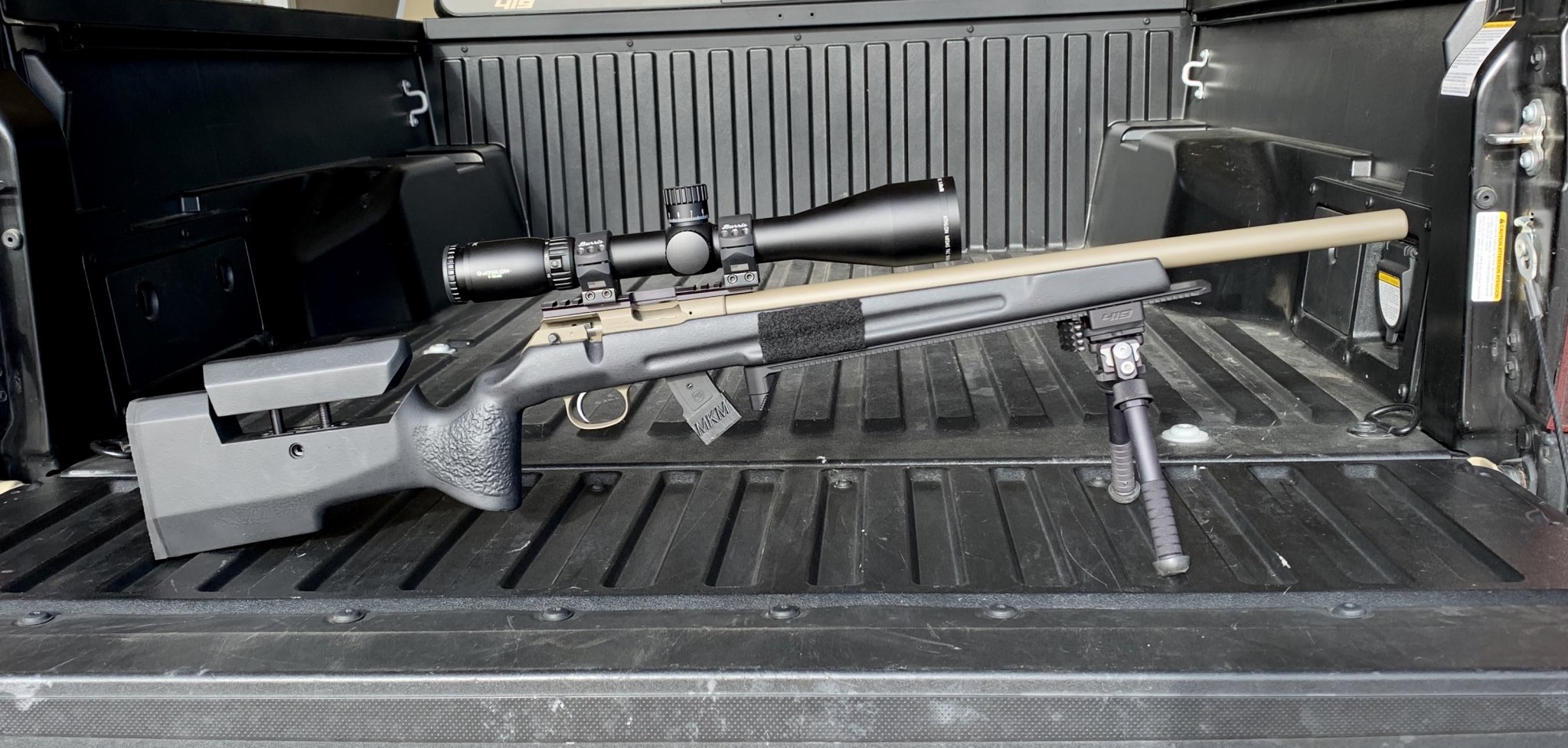

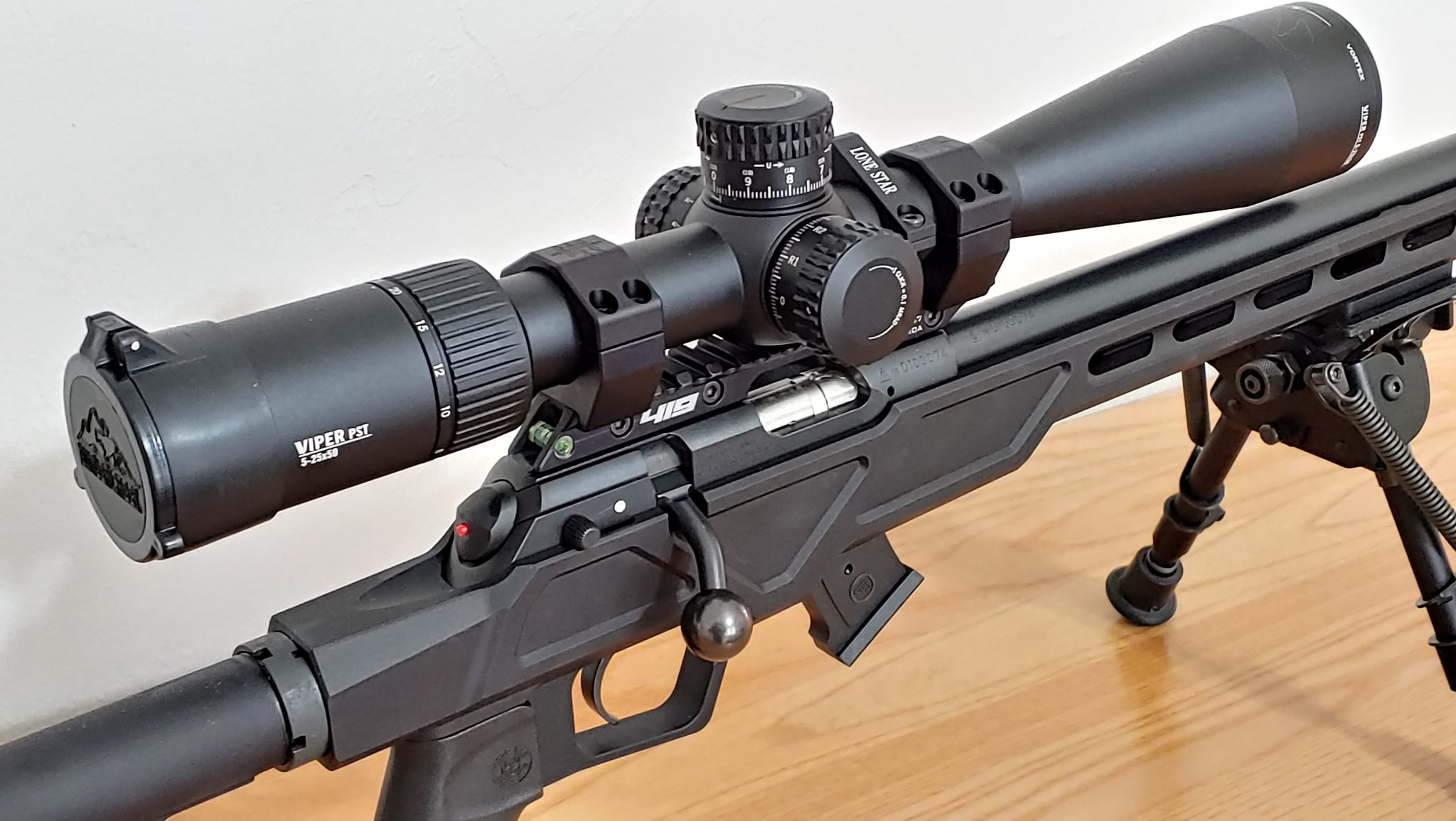

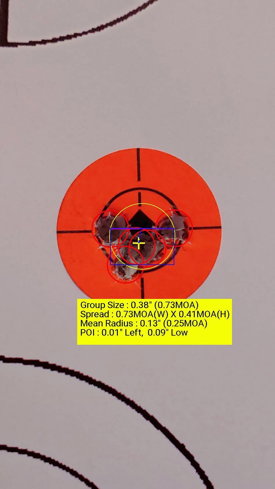

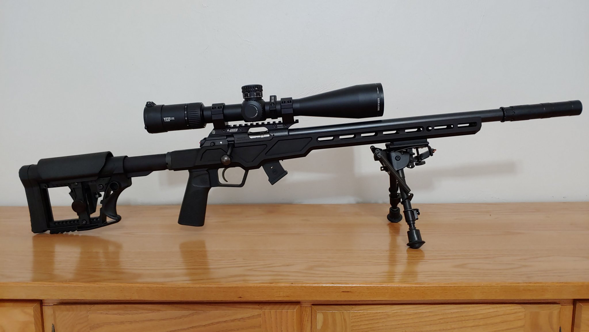

Anybody else get the precision chassis model yet? I'd put the quality of the CZ aluminum chassis up against any of the other aftermarket ones that use the AR rear.

@gozfast What ammo are you using? What height scope rings? What cant rail 30 or 15 Moa? Do you have any problems with brass bouncing off of your scope turret?
Only tried some CCI SV that I used in my RPRR. Ejection was flawless. I used a 419 30 MOA rail and Seekins 30mm low rings (.82"). That was the lowest I could find and everything had plenty of clearance without being too high. Accuracy is probably a little better because I'm shooting off a pretty wobbly table on my back porch, 50 yards. I can get out to 95 yards in my back yard but haven tried it out there yet.

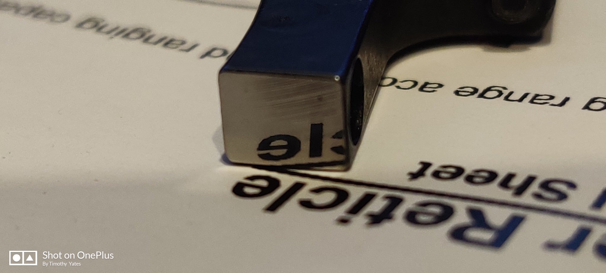

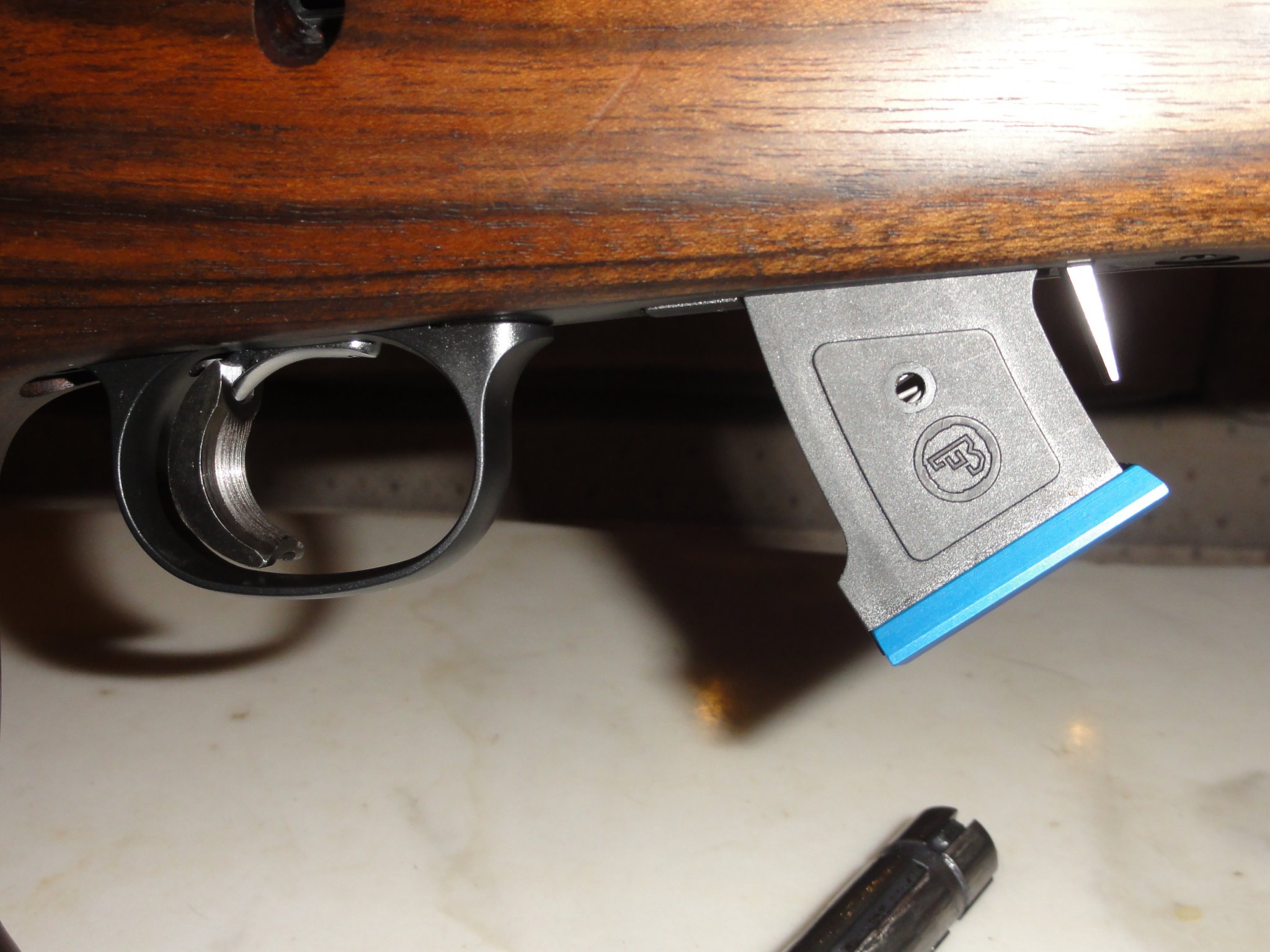

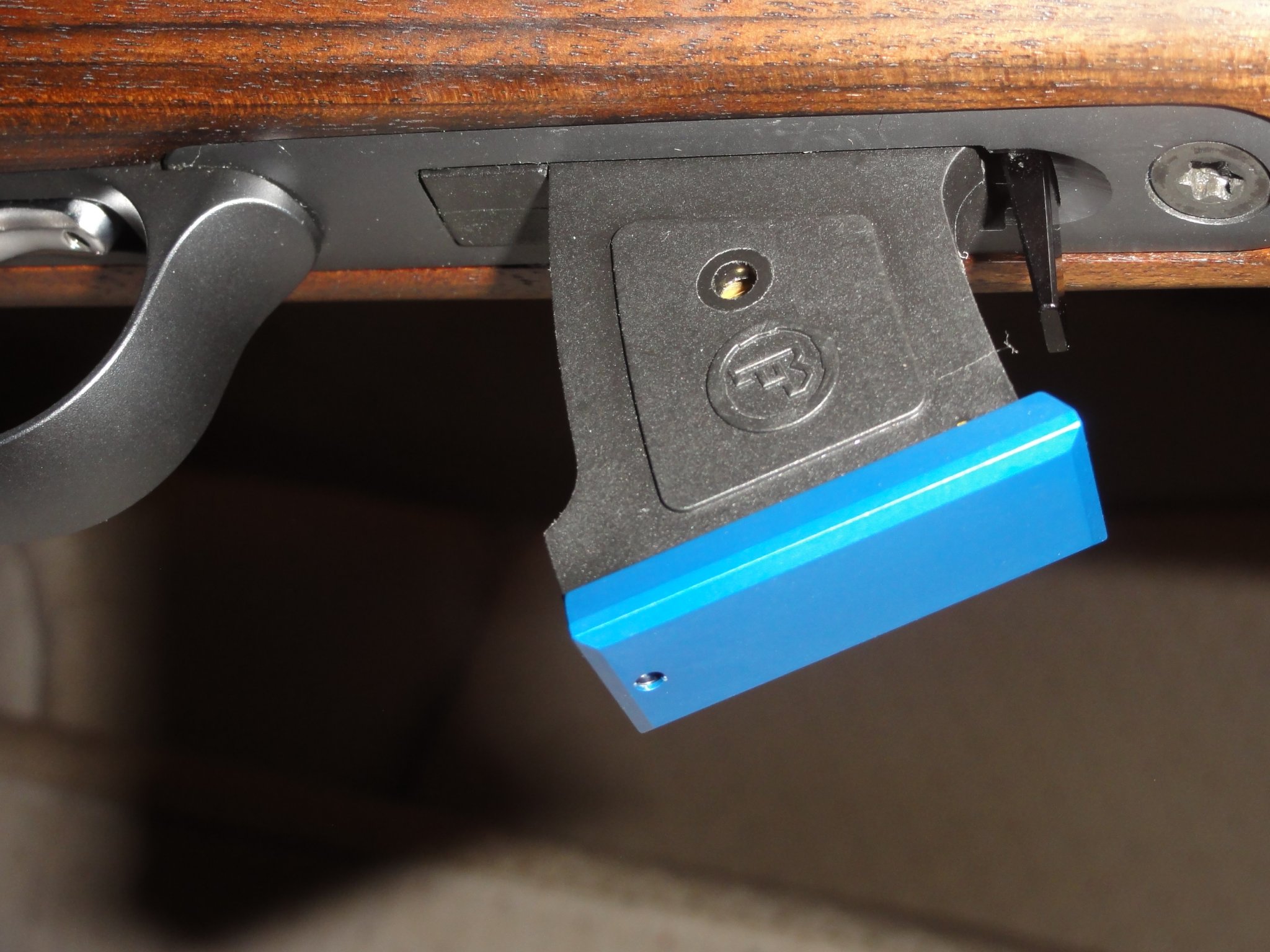

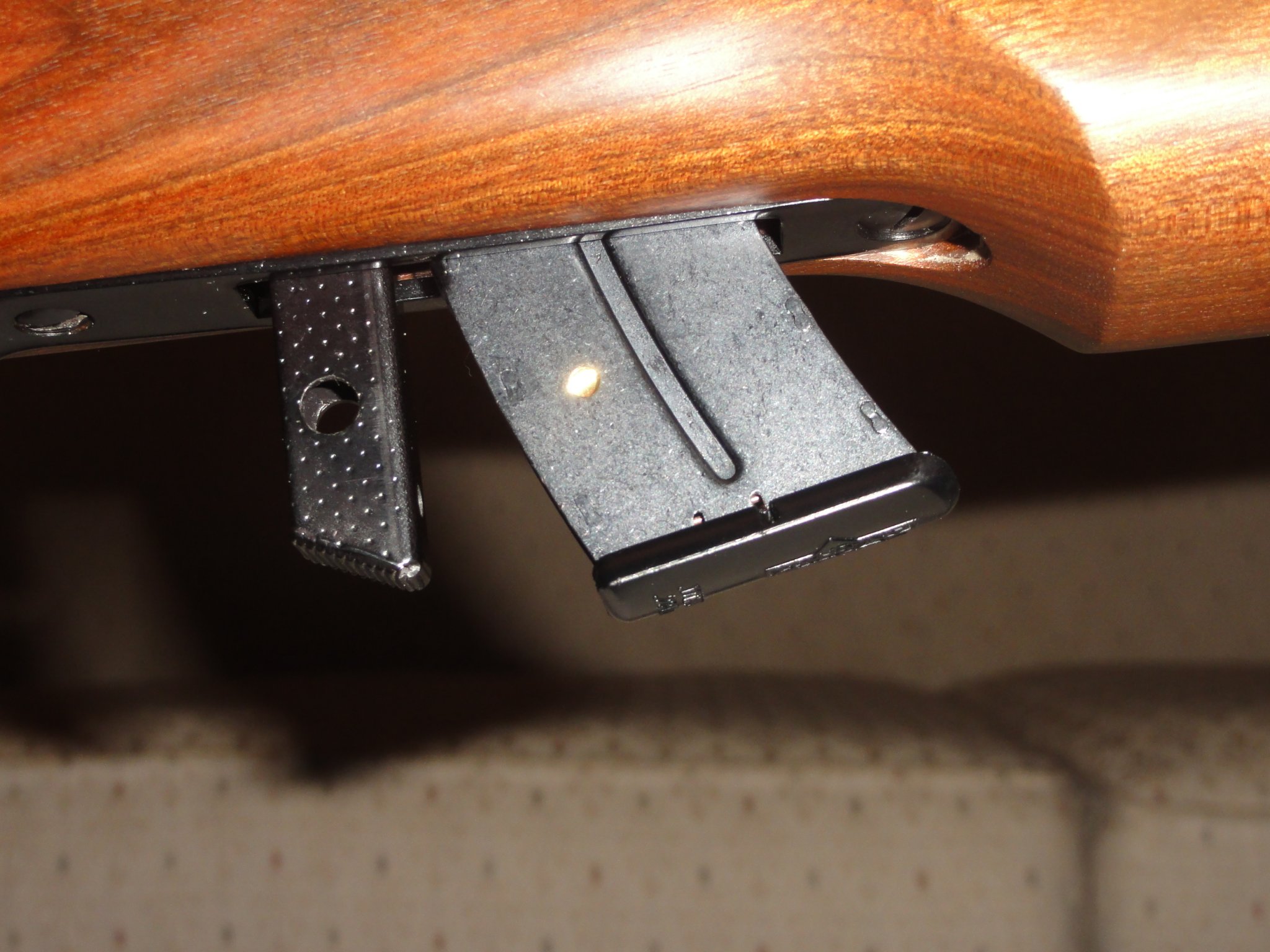

Wanted to show you all the Anarchy Outdoors extended magazine release. It sticks out .5" beyond
the stock. The DIP EMR is a very nice product but it only sticks out about .12" The new AO release guides the mag into the well and the mag drops out clear on it's own. There is no more using your fingernail to get to the release and fighting with a fairly stout spring. EDIT: I have found replacement springs but the only work on the factory or DIP release.

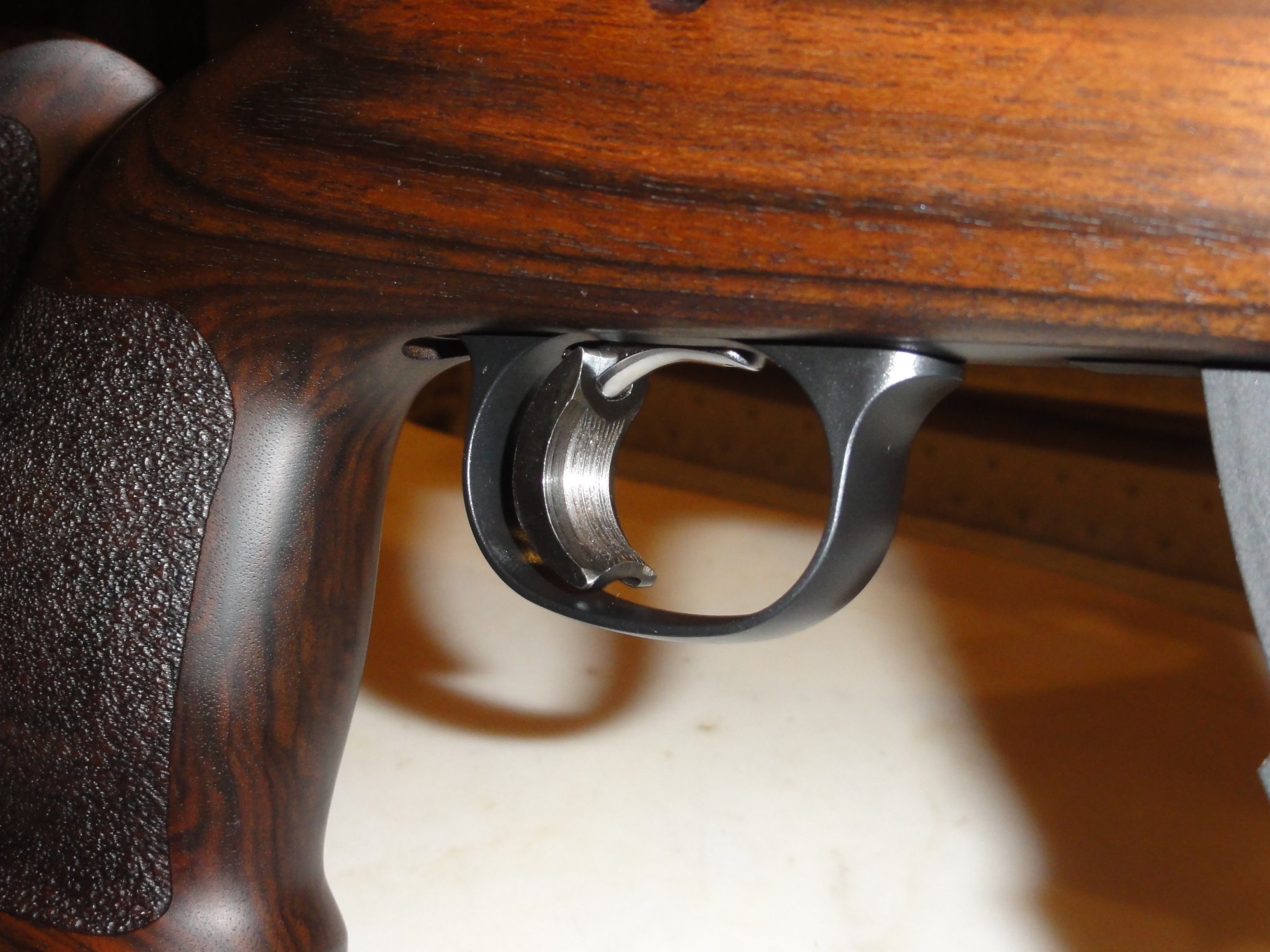

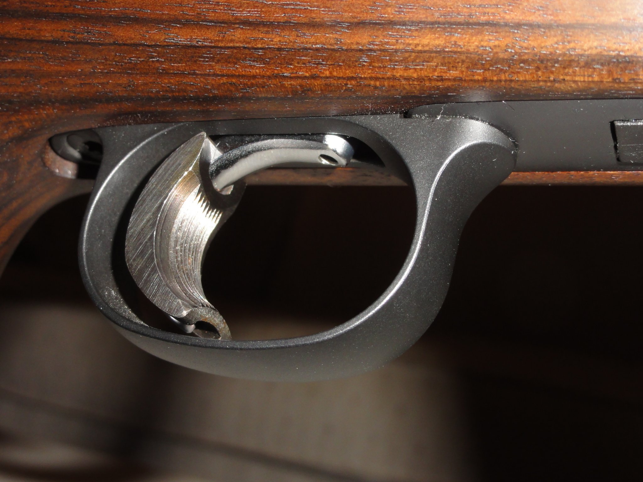

I happen to have an ACE #22 trigger shoe that I put on my MTR and it makes the trigger feel much nicer. I had already done a lap job and spring swap, so the trigger breaks clean at 10 oz. KOD did his trigger with the same .014" wire spring and his trigger breaks at 7.6 oz.

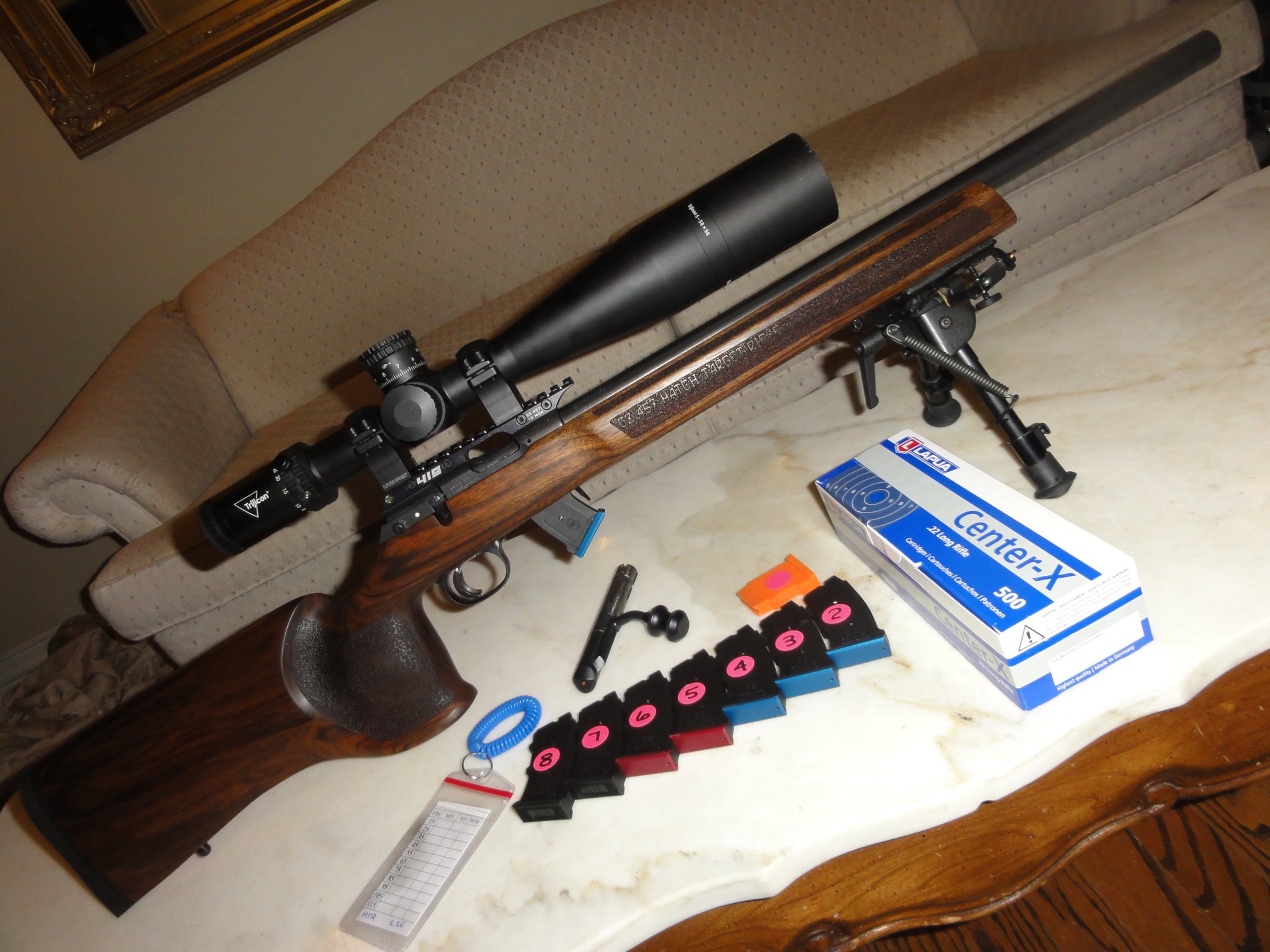

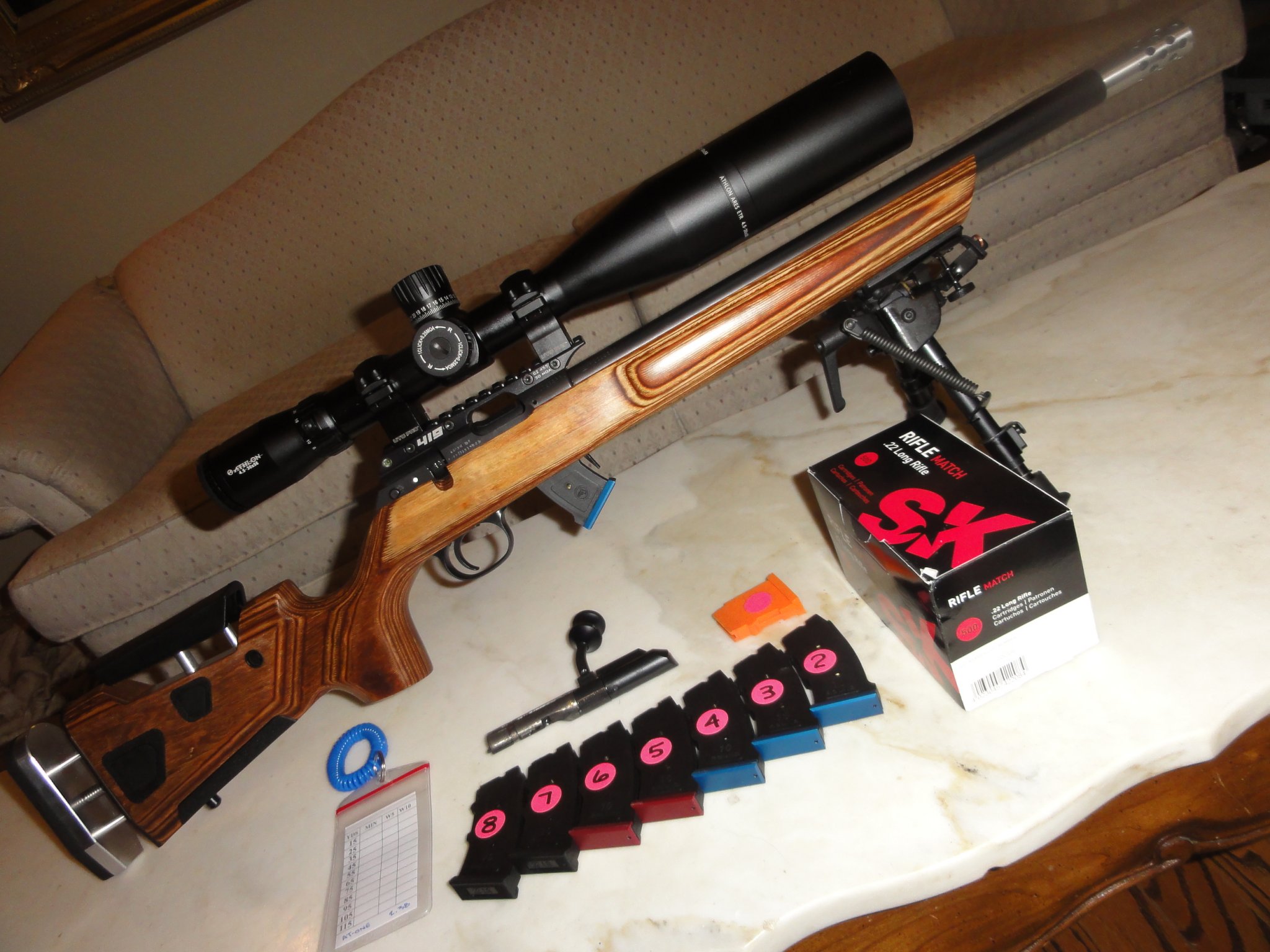

My MTR shoots so well that bought a second Trijicon 5-50x56 for her. I bought my first one for my V22 from B&H camera and they have a 30 day test drive return policy and 12 months with zero interest.
I would think that the Ext mag release would work great for you guy's putting your 457s in a chassis.
Hope this info helps.....

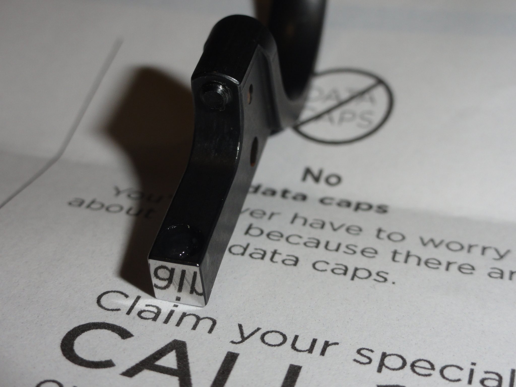

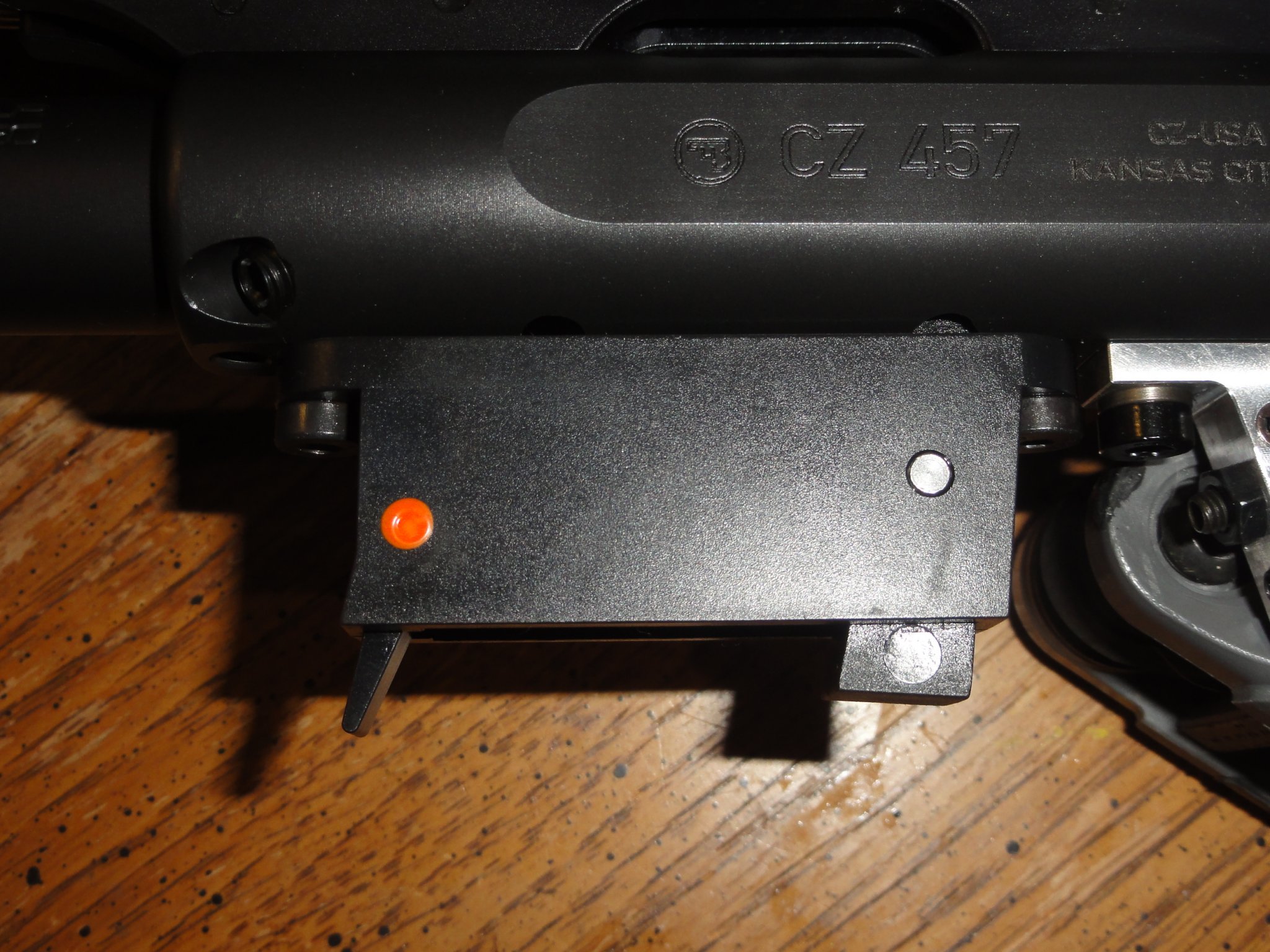

How much of a pain is the mag release install? I want to order one for all my CZ's.

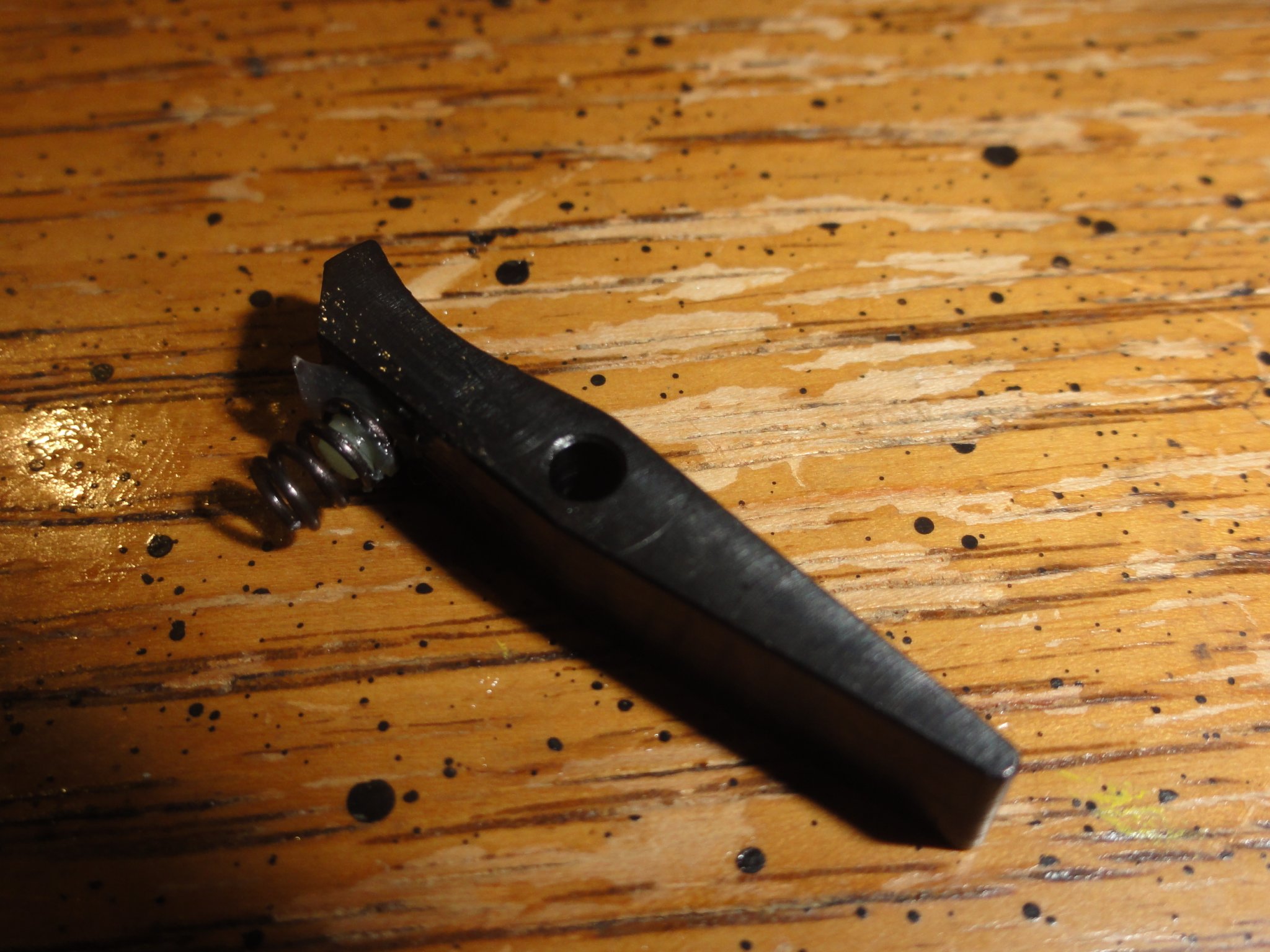

The Anarchy release is easier to install than the factory or the DIP type. The AO model has a smaller diameter spring pocket in it. Therefore the spring locks into the release instead of falling out or wondering around. You simply push out the pivot pin, remove the spring and replace the spring into the new release. If you give the spring a little twist it will squeeze into the pocket and stay put. I always put some orange finger nail polish on cross pins that have no other means of retention.
The release shown is my first DIP type that is only .080" longer than standard. I have used silicon grease to temporarily retain it's spring during assembly just like the factory does. You wont need it with the AO release. Both releases cost about $20.00
It is likely the same but my description is for the 457 release. I don't own any prior models.
I would also suggest you get the 457 trigger lapping and spring kit as well. It comes with 9 and 3 micron film, .018",.014" springs and silicon and moly grease to do the job.
Did you shoot more groups that that? What were those results? That is a nice looking chassis.

I'd like to add to this. The CZ mag releases have been unchanged since the BRNO days back in the 40's, they are all the same. I know, I have these rifles and bought extended mag releases from DIP and AO.
Also the $20 kit is well worth it. I got one and took my trigger down to a ten pull average of 7.6 oz as shown on my gauge. I have pulled below 7oz before. My trigger is worth $250 IMO because it's, to be honest a perfect trigger.
Didn't shoot any more groups on paper, but I set a row of spent .22 cases out at 50 yards and was picking them off pretty easy. Lots of fun and I'm really happy with my first CZ. I'll install a lighter trigger spring and bolt knob, and I put on a vertical ERGO grip that I feel helps control a bit.

Lefty 222 did a nice job on the trigger sketch but he got #49 backwards. Tighten the screw reduces the sear engagement. It is not shown but #53 is also the centerline of the spring. That screw when turned in will increase trigger pull because the spring pre load will increase.

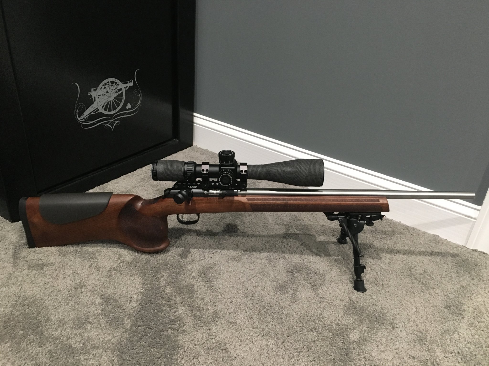

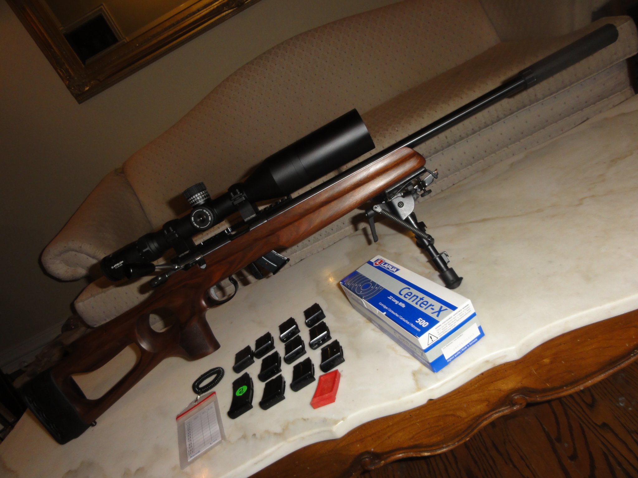

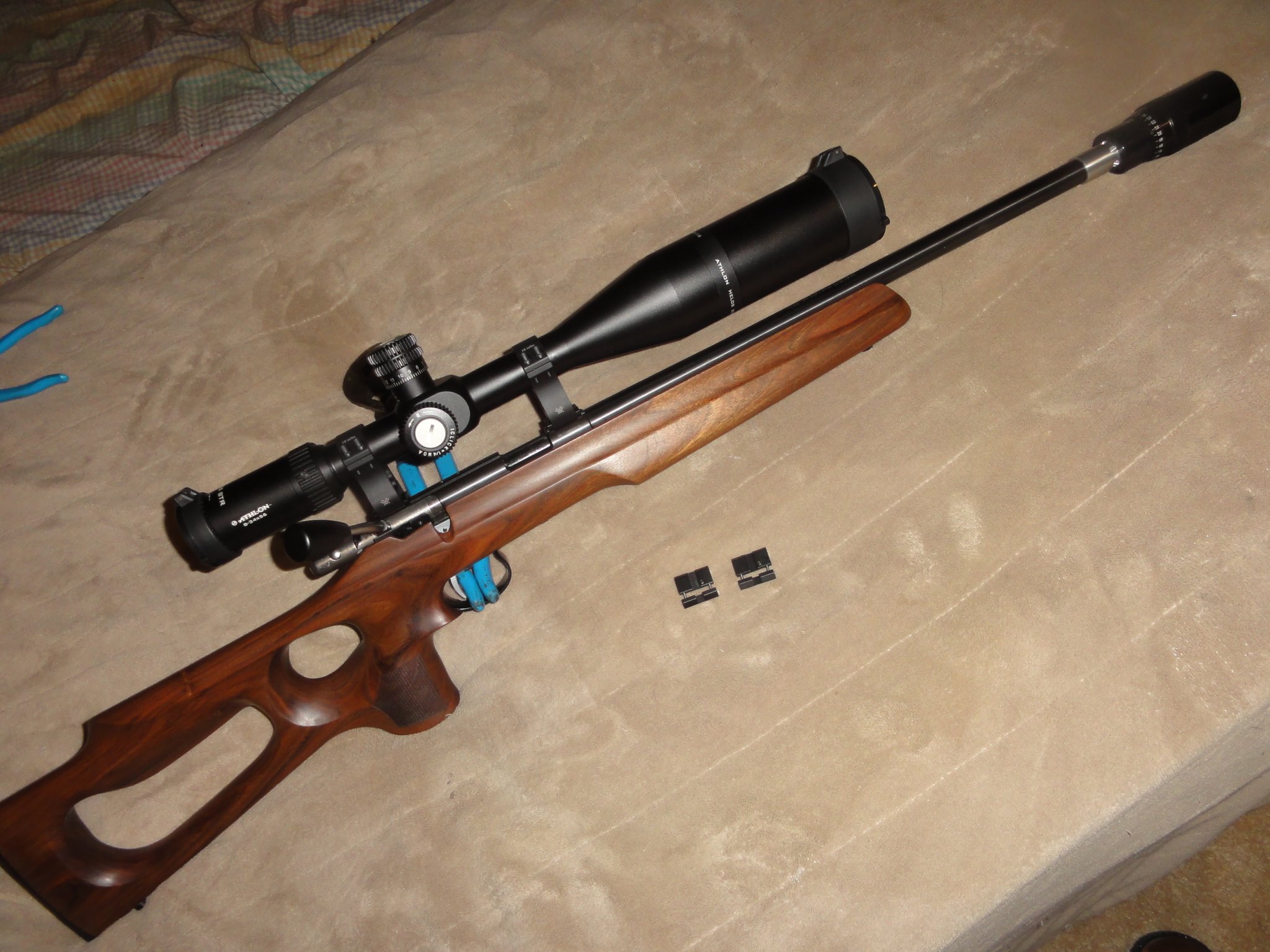

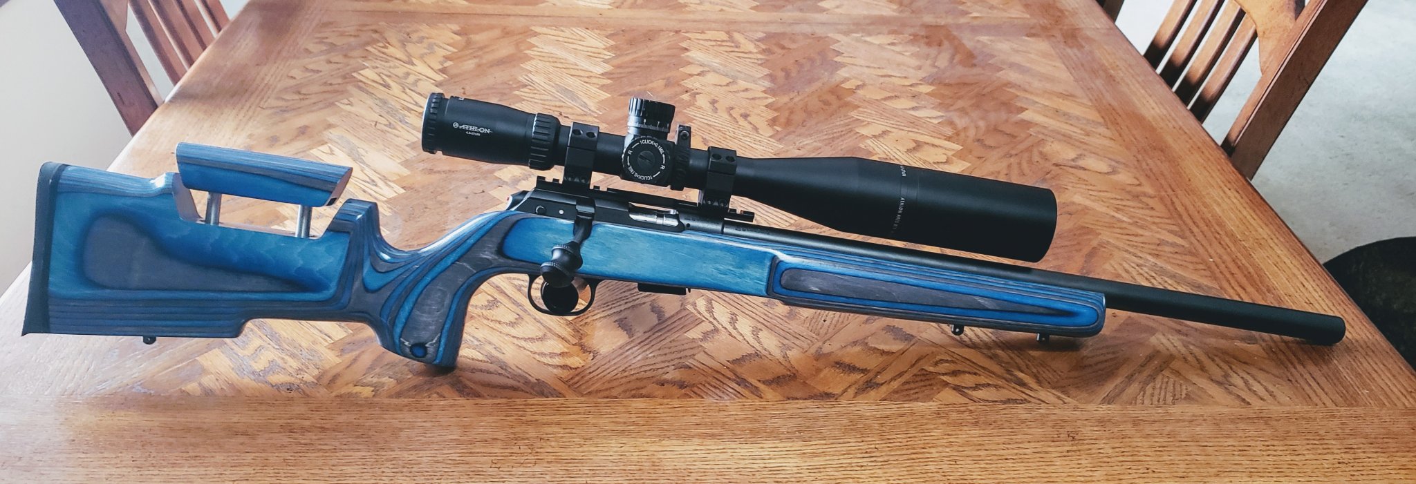

My At-One is below and the bbl. stick out is four inches from the front of the stock.
I like to shoot with my silencer so the 16" threaded bbl. suits me. I would however like a new
Boyd's in blue with all of the adjustments.
btw.... An ACE #21 or #22 trigger shoe will fit the 457 trigger blade and it feels great !!
