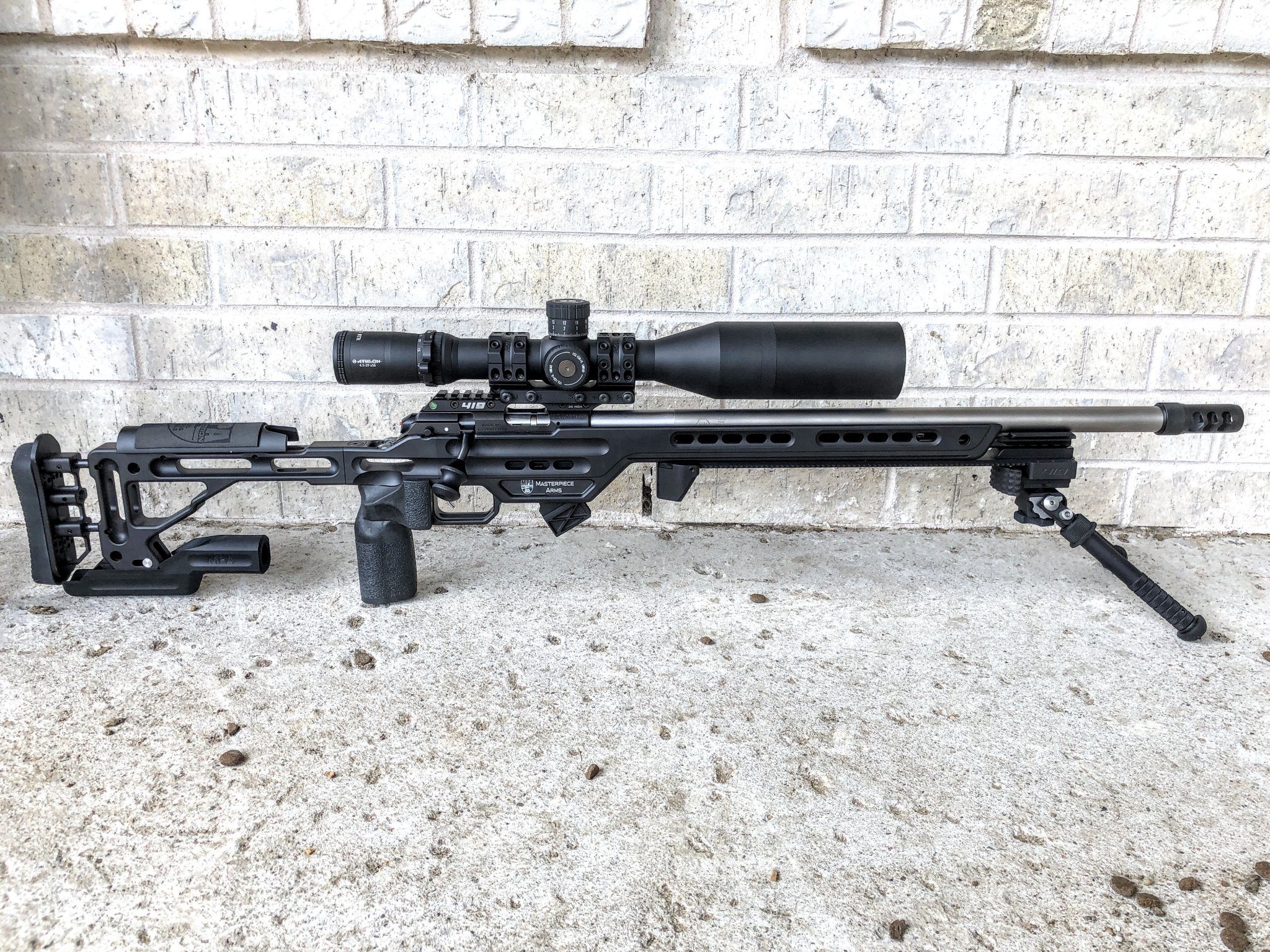

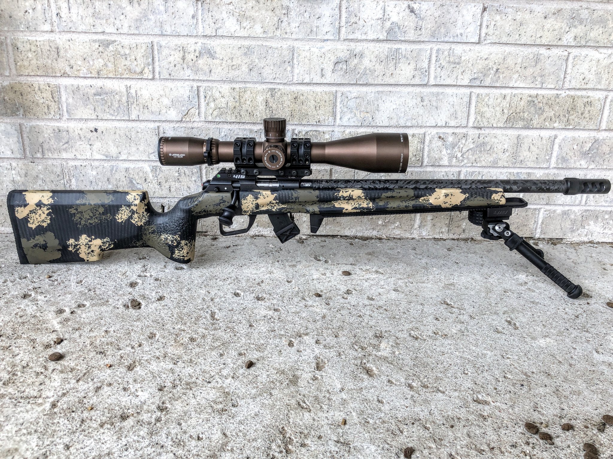

Two CZ457s.
CZ457 in a MPA Hybrid chassis, Athlon Cronus BTR in a Sphur mount, Area419 mount, hellfire brake, bolt knob, custom serielized KGMade Ticho
CZ457 Precision Trainer, Athlon ETR in Sphur mount, Area419 mount, hellfire brake and bolt knob, 18.5" Proof Research barrel
Sucks that I had a proof carbon barrel for the MPA build but the Ticho was approved before I got to put a round through it....

Two CZ457s.

Two CZ457s.
Man that 18.5 barrel looks really good.

Two CZ457s.
Love the proof/manners
So, have you shot them? Just curious, do you have a preference for the chassis or stock when shooting prone or off the bench?
I have and the chassis is easier to shoot but it gets into the way of my ear pros

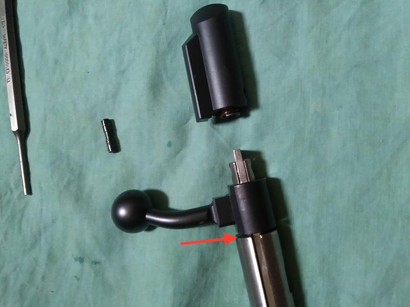

Take the bolt apart, place the shim between to two halves, sometimes you have to take a small amount off the diameter of the shim for clearance, I also lube the shim and mating surfaces real good.
Reactions: Merlin O
Just curious, why do you need to lube the mating surfaces? Just for clarification the shim would be placed where the red arrow is, correct?
Reactions: Merlin O
