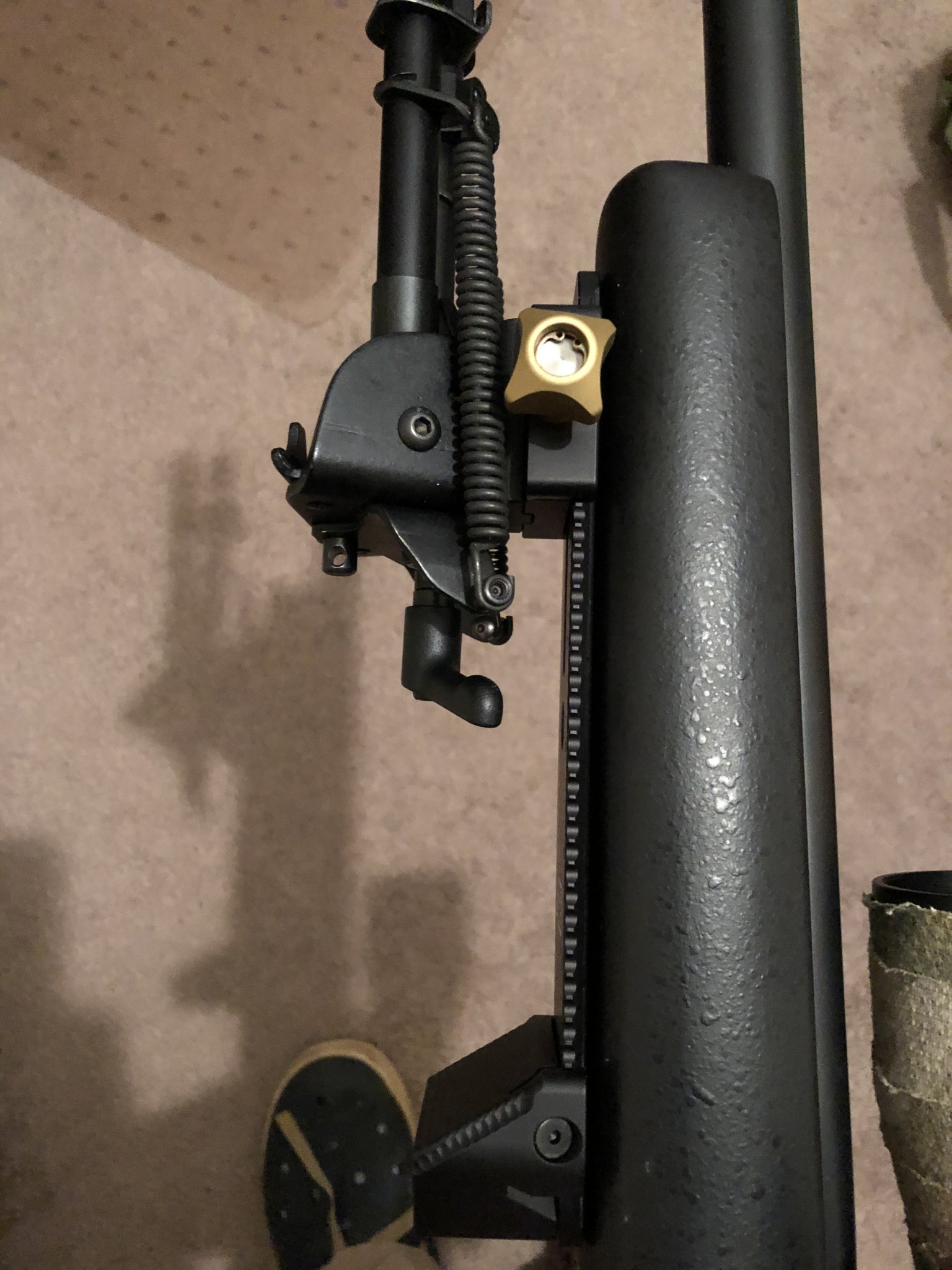

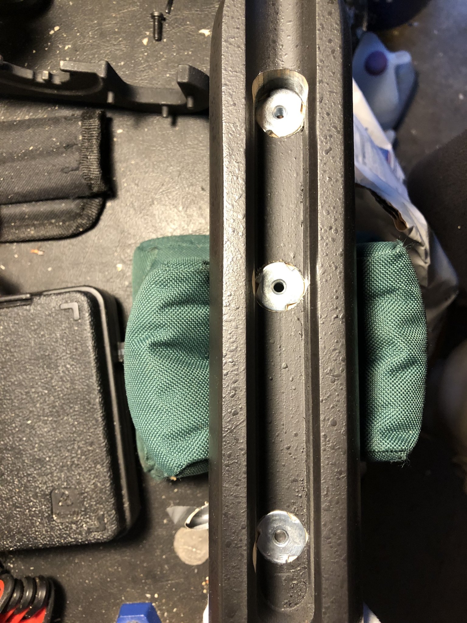

Has anyone attached the ARCA rail to a 457 pro Varmint SR 16.5 on the Boyd’s stock. Looks like a slight arch in the stock that may cause issues ... curios if anyone’s been successful with it before I start looking at swapping chassis.
I installed a 419 ARCA Rail on my 455 Manners stock and had to do a little milling on the rear of the rail to get it to sit flat on the Manners. Easy if you have a milling machine. You can use varying thickness washers at the screw points which will be functional but the look may not suit you.
Reactions: RedDawn
I did go ahead and install the 8” on the Boyd’s stock. I think I could’ve gotten away with the 10” even tho I ran out of milled area in the rear of the stock it would’ve given me a couple inches I needed on the front end :
