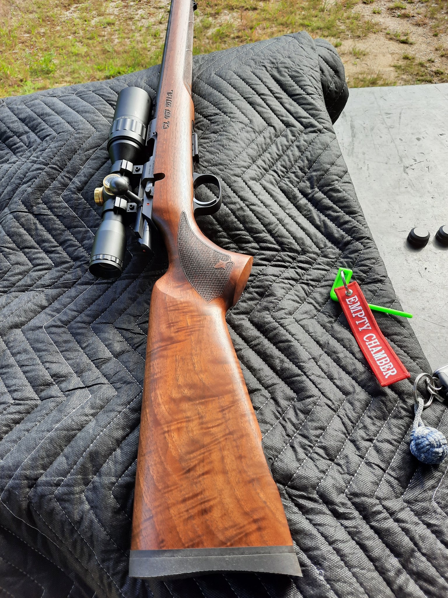

My Pro Varmint shoots very well, better then I expected, 3/4 inch or better at 50 yards( sort of wondering if I should postpone the Lilja barrel on back order) just that the stock isn't comfortable to shoot, and heavy.

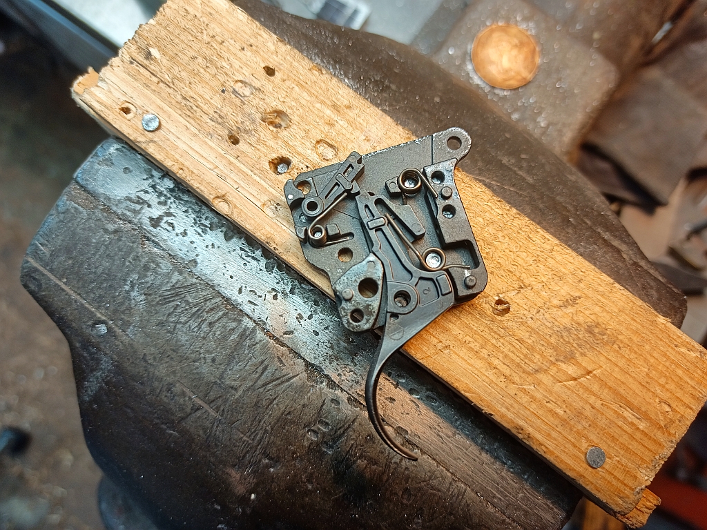

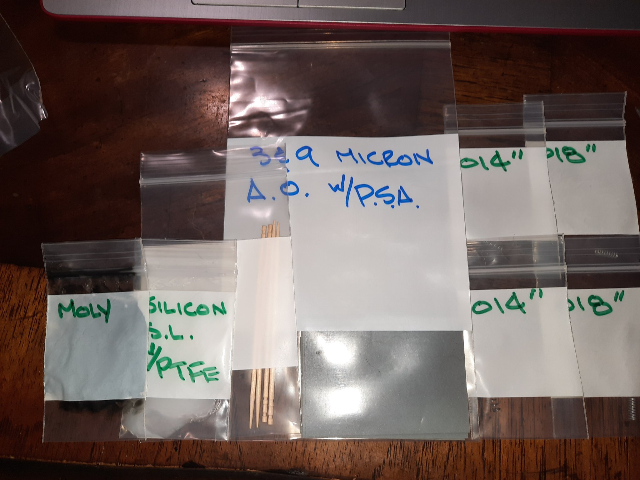

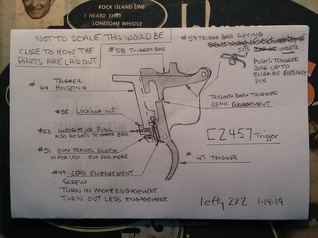

Yes... the 457 trigger mod is super simple. Replace the trigger spring with one from McMaster Carr and lap the sear with some
9 and then 3 micron AO PSA film. Take 10 seconds to sand the ends of the trigger pin down to ease it's reinsertion. Back off screw
number 53 until you only have about three threads engaged and lock it down with the hex nut.
Use some silicon grease to hold the spring in place while you guide it into the housing and align it with screw center line number 53.
Screw #49 inward until the FP drops on an empty chamber. Then back it out by say 90* for starters. You should have a short, crisp
7 oz. trigger. ( #49 is labeled backwards. Turning in reduces the sear engagement )
Lapping the chrome blade takes about 40 minutes while the black blade takes less than 10 mins.
I used to provide kits that had all of the stuff required to do 4 trigger jobs. my spring was .014" wire and the Yo-Dave wire was .018"
About half the spring rate if I recall correctly.
I'm sure I have kits laying around or am happy to give you the information if you would like it.

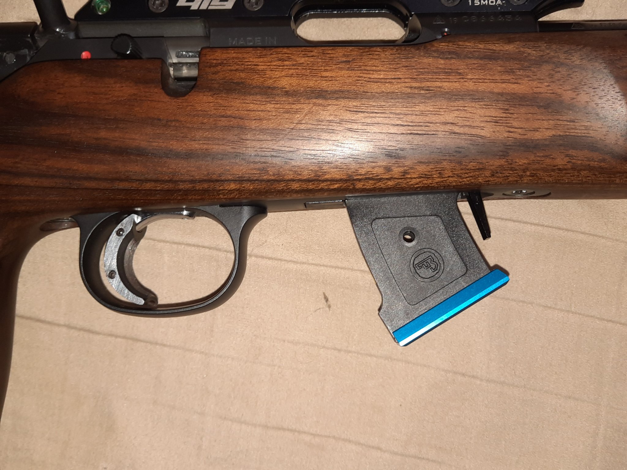

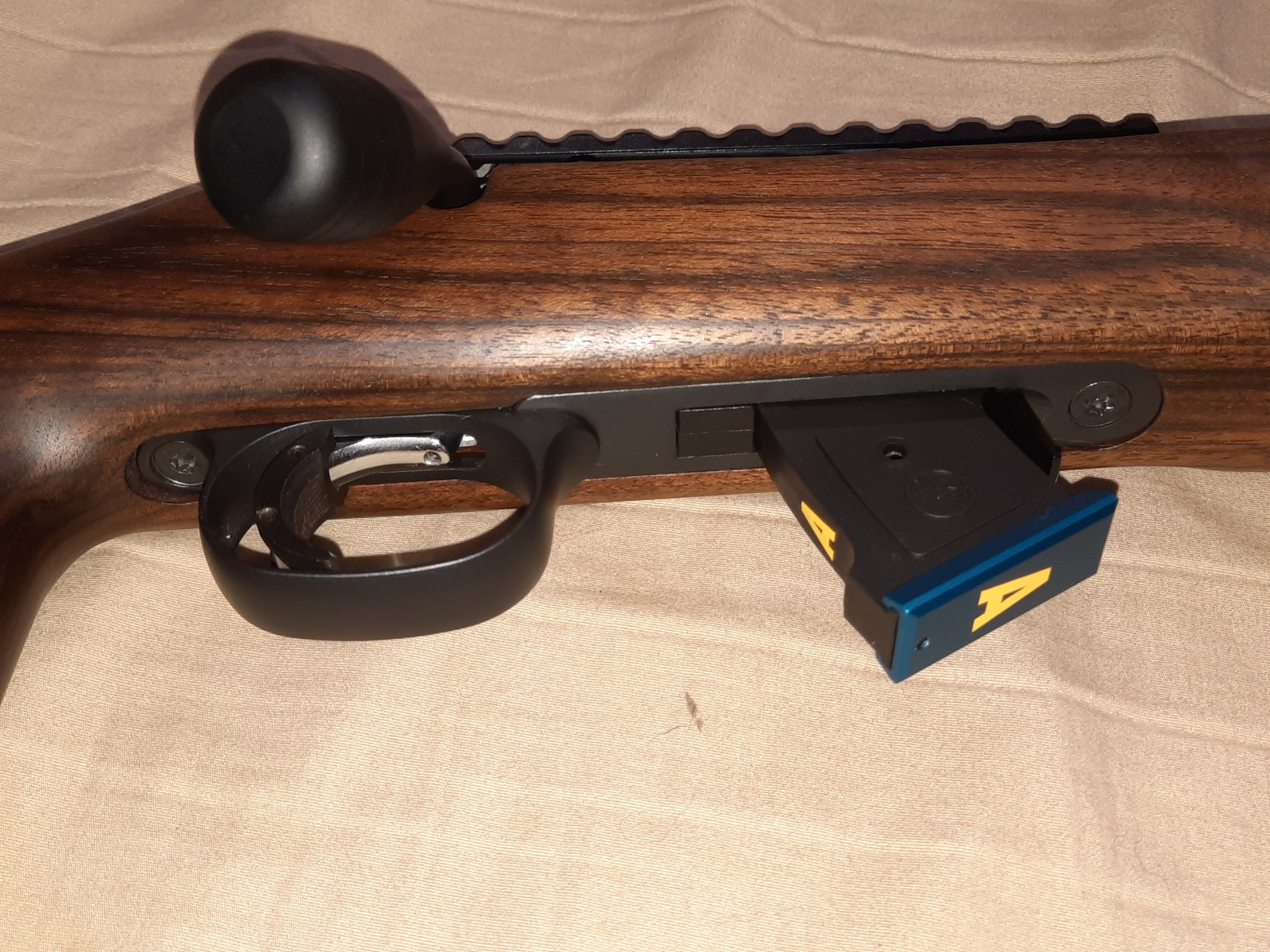

I recommend putting on a Vudoo knob and an Anarchy Outdoors extended mag release too. Even the old Flaig ACE trigger shoes

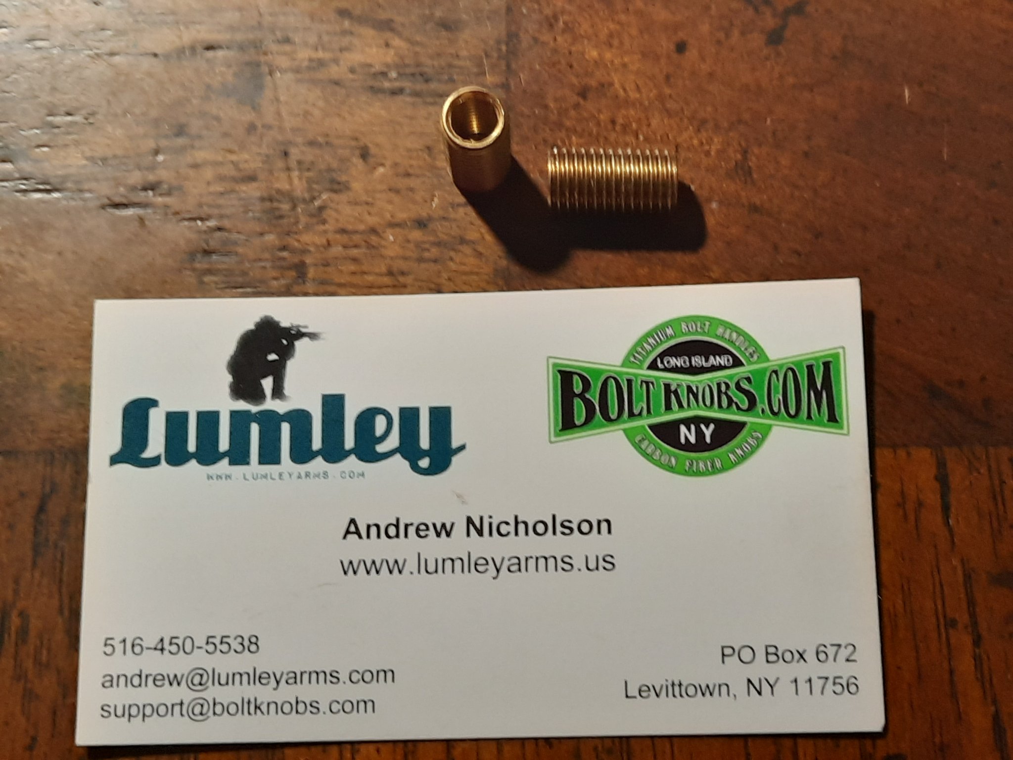

#21` and #22 work really well. It's been a long time but you may need a Lumley 5-16-24 to M6-1 thread adapter as well.

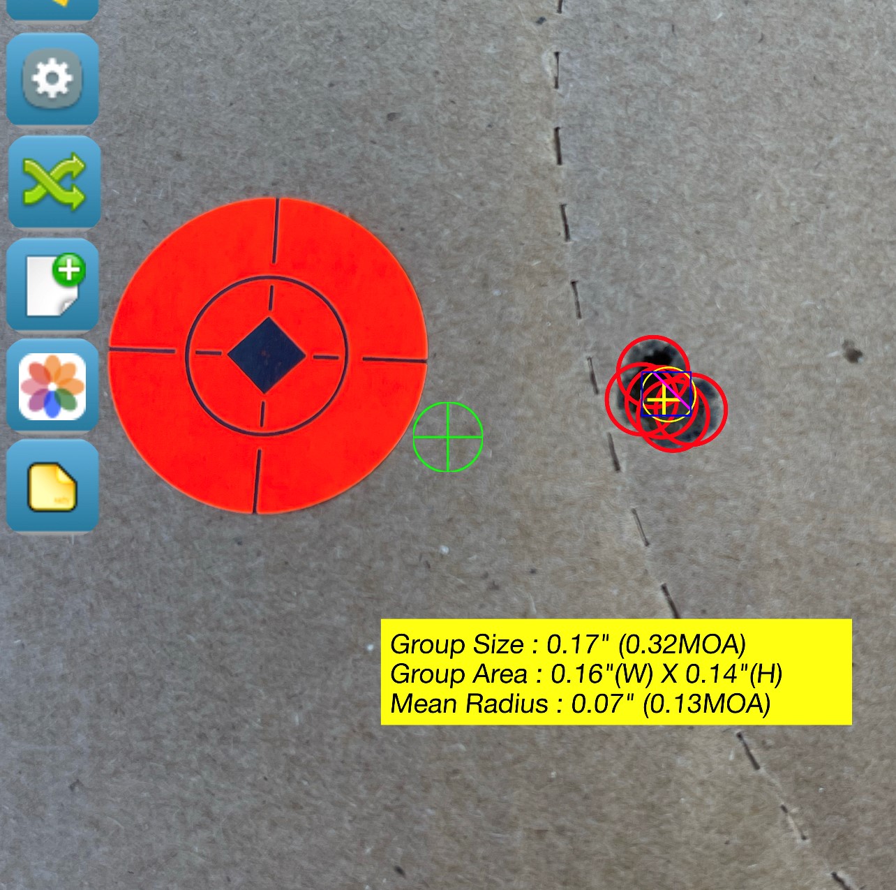

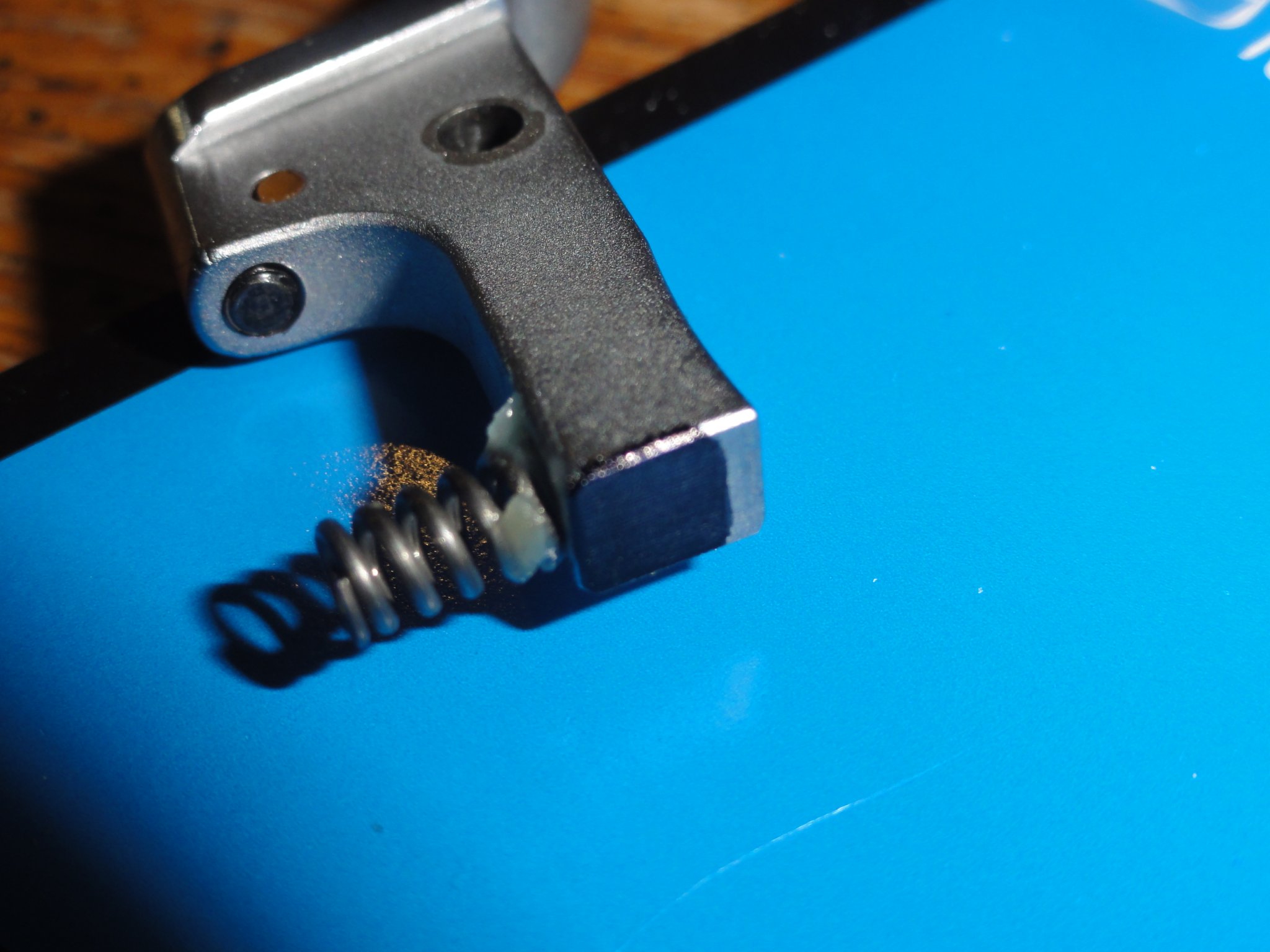

Here is the B14R trigger once opened up. Something I was not willing to do. I should clarify, I like working on
guns. I enjoy refining existing designs. I don't want to be buying all sorts of new parts for them. The published
low end for this trigger is 2 pounds 4 ounces as I recall. From the factory it's long and heavy. 20 minutes and 20
bucks makes a world of difference. Keeping all of my factory components allows me to stay in the factory class
at my LGC.

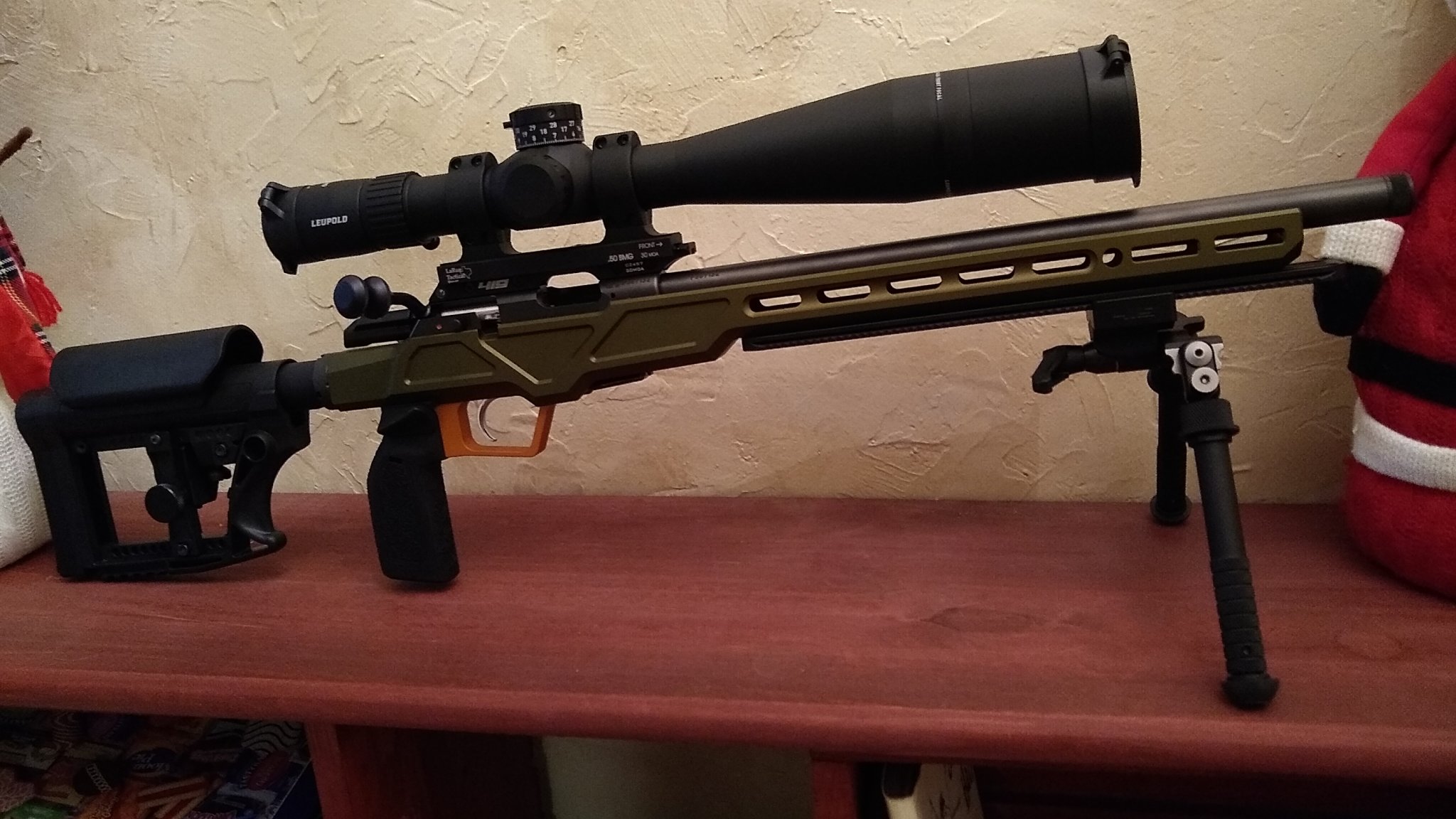

I just picked up a 457 barreled action and plan on putting it in a Krg bravo, I purchased an additional 10rd mag but didn’t realize till afterwards those may not work with the new chasis? will the 457 mags work or did I make a mistake?
The Bravo uses a AICS sized mag slot which can make guiding those small CZ mags into place an Easter egg hunt. Most report that adding the Anarchy Outdoors Mag Well Filler designed for the Bravo cures any 10 round mag issues. ( There might be issues with 5 rounders if memory serves though ) I have no experience with the 457 and Bravo myself though.
The 457s have superb triggers unlike the 452 where you either had to play with springs until you got something decent or the 455s where the same thing applied, but the set trigger pull was pretty awesome and a great shooter.
But they also respond incredibly well to a simple spring change. I struggled to get any of my 457's below the 2# mark with factory adjustments. They were very decent but not quite as low as I wanted. A $2 spring change and I'm at 15 -20 oz on 3 different rifles. ( as selected).
The KRG Bravo for the CZ457 uses the CZ factory mags. When you're on their website, be sure you are reading descriptions of the rim fire models, there are differences (for example, the tooless lop set up for rim fire is $49, the centerfield one lots more).
To your specific question, both the 5 and 10 rnd mags work fine. It is a little fiddly inserting the 5s, but I don't compete, so hasn't bothered me yet. The 10s are much easier to extract. I don't have either the extended mag release or the mag well filler, but probably will soon. I have heard (second or third hand) that with the filler you want the extended mag release, and also with the filler the 5s may be less than ideal.
If I pick them up, I'll let you know. For now, 10 rounders will work perfectly with no mods.

If you use a .014" wire diameter spring and lap the sear it's pretty easy to get your 457 trigger to the 7 oz. range.
If instead of adding a 4-40 set screw to the B14R trigger you use the heaviest 6-32 long nose spring plunger, for
$5.00 you get the adjustable sear and the 11 oz trigger.

And just because I could.... I added a 6-32 set screw in the B14R trigger for over travel too. Both my long nose spring plunger and my
over travel set screw are fairly long and have the nylon locking element. I found that using a second set screw to lock the
first would always change the sear setting a little bit.

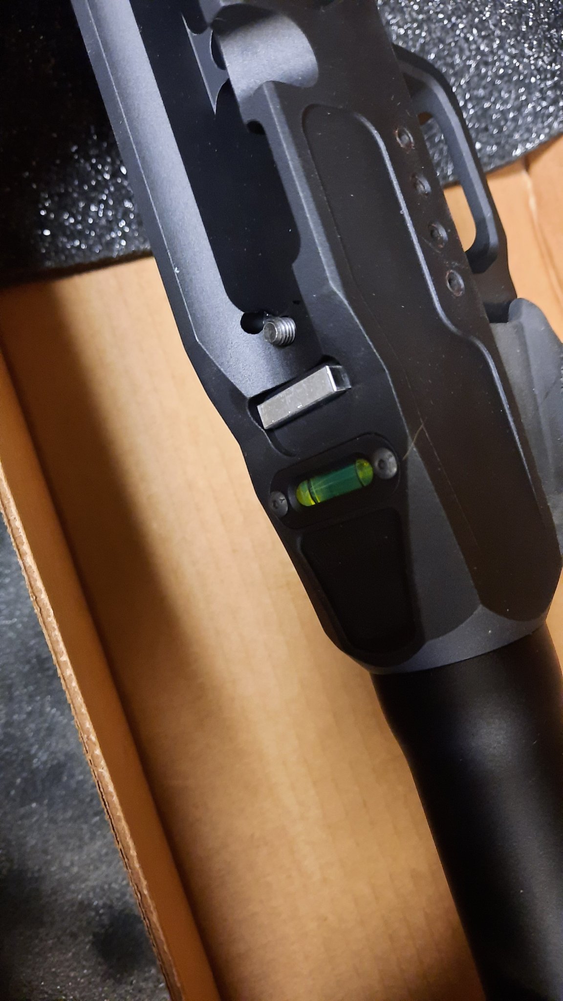

When I put my 457 action into a MDT chassis, I used the recoil lug. IIRC, it isn't really held tightly by the chassis or the action? In a stock or in a chassis, should it be bedded somehow? Seems like it should have a set screw from above or front back to lock it into place?
The lug seems to be a check item on CZ design list- Recoil Lug, Check. It doesn't seem that it adds any 'recoil' action? Is it to help keep people from crushing wooden stocks?
There is a manufacturers video out there saying to put the action into chassis loosely/untightened first. Then you bang the butt of the rifle down to set the action, recoil lug and chassis tightly (rearward) before torqueing. Vudoo and others recommend the same with other actions. Makes sense. That's what I have been doing with all my rifles including my cz's
Interesting, since I put some pretty good backward/down pressure on the barrel action when I set it in the ACC chassis. I don't think the gun rattles, so the lug must be somewhat secure.
I would agree. Nothing moves when it's all torqued down. I do think that getting the recoil lug hard against the faying surfaces of the receiver and stock (in the direction of recoil) is a good precaution though.
Interestingly enough, the XLR chassis I bought came with it's own 457 recoil lug. It fits so tight , it had to be snapped in! Really getting tempted to keep it and start another 457 build! :unsure:

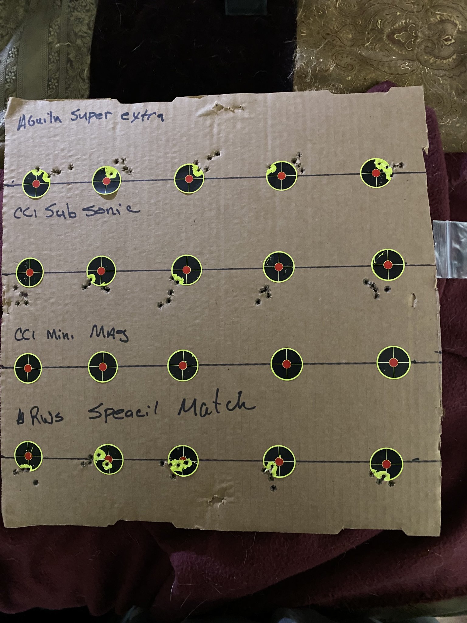

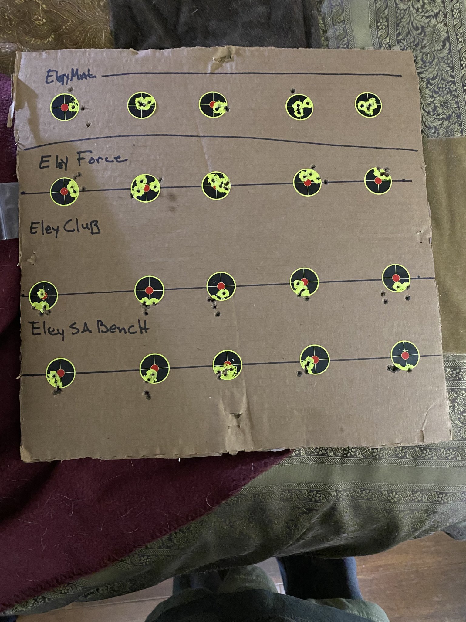

I used a micrometer to measure my 457 receiver for setting the depth for my Lilja barrel. I can't remember the shim combination, but setting the headspace to 0.040 solved the extraction problem I was having with it set at 0.043. Looking at a post I made on Rimfire Central I think I used a shim combination for .006. RWS variants work fine, but it was a little hard closing the bolt with Eley Club.
My Lilja shims are now .003 for maybe .039 or .040 HS. Eley or RWS, thats it. My other one .043 with Bartlien for everything else.

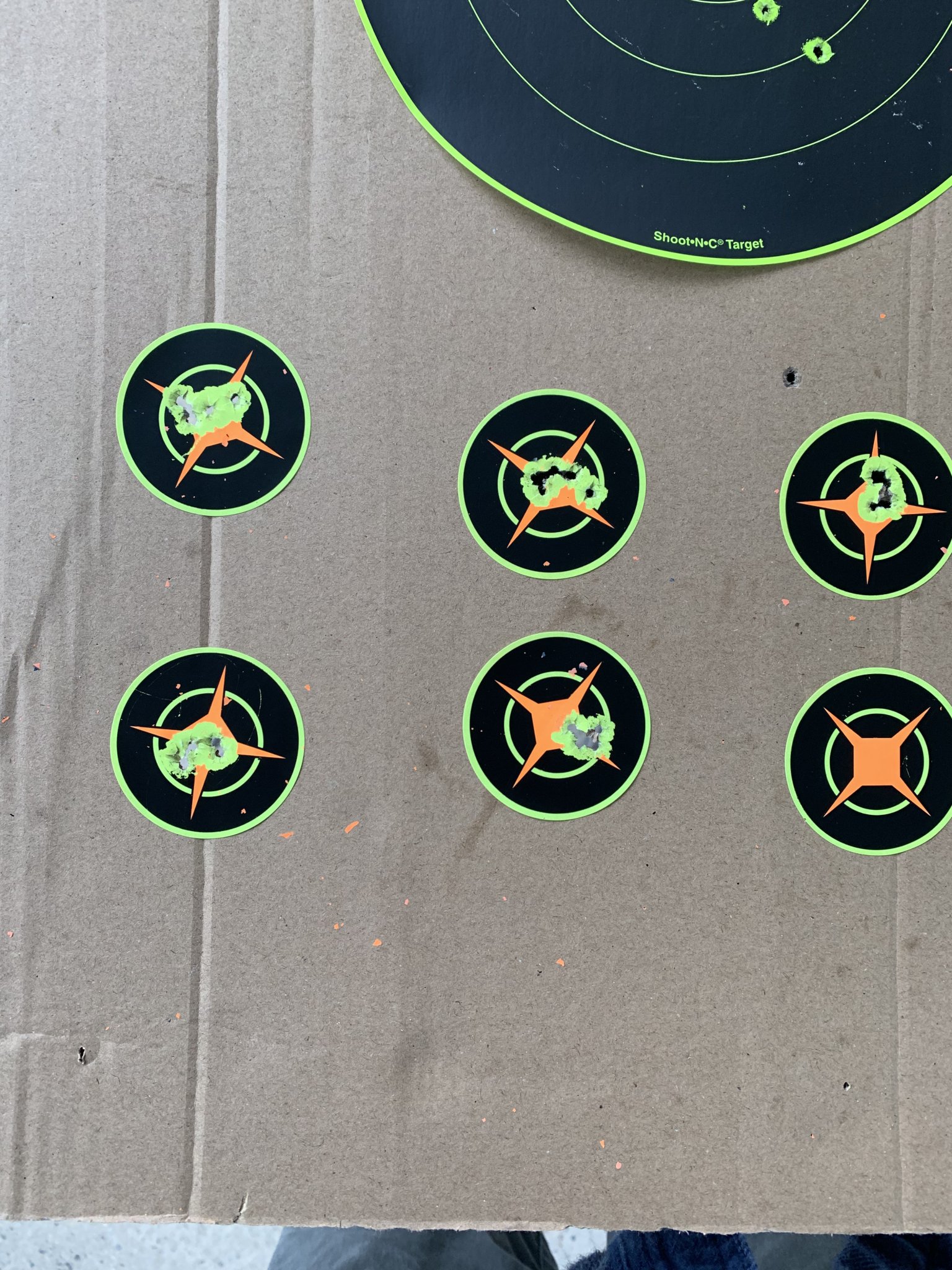

Busting my 457 cherry tomorrow. I've been shooting my wife's Savage MKII BTVS with Athlon Ares BTR 4.5-27. It's a good little rig but left me wanting something a bit better.

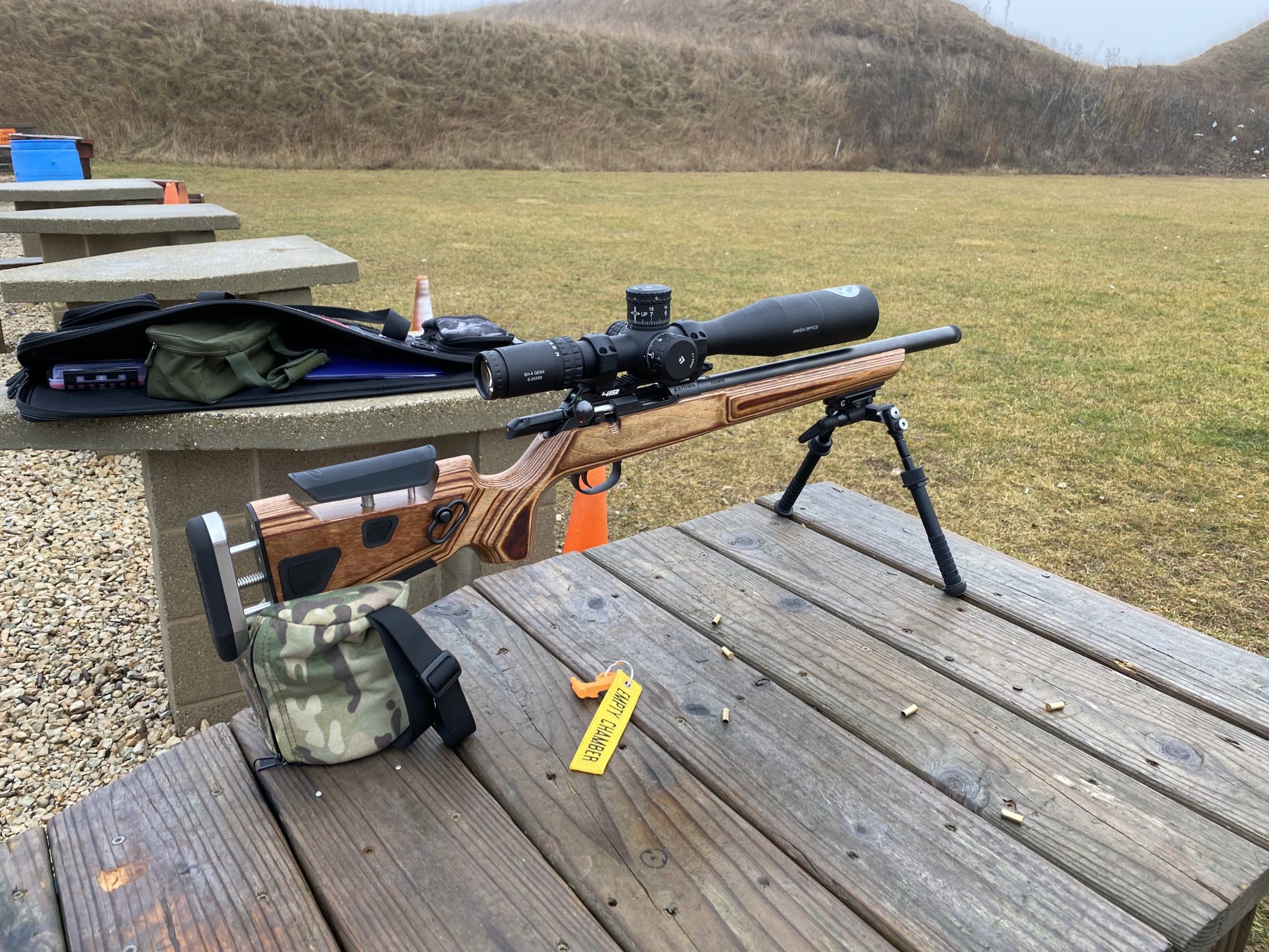

Got a new CZ 457 VPC MTR. Installed MKM Adaptive Grip w/ thumbrest, Area 419 30 MOA base, 12" universal Arcalock rail, clamp, bolt knob and an Atlas CAL bipod. Did an aluminum tape bedding job on the stock and it's topped off by a 7-35 Leupold MK5 w/Tremor 3 on a LaRue 50 BMG QD mount w/ additional 30 MOA.
Tomorrow will be a full day of ammo testing and data gathering. Can't wait.

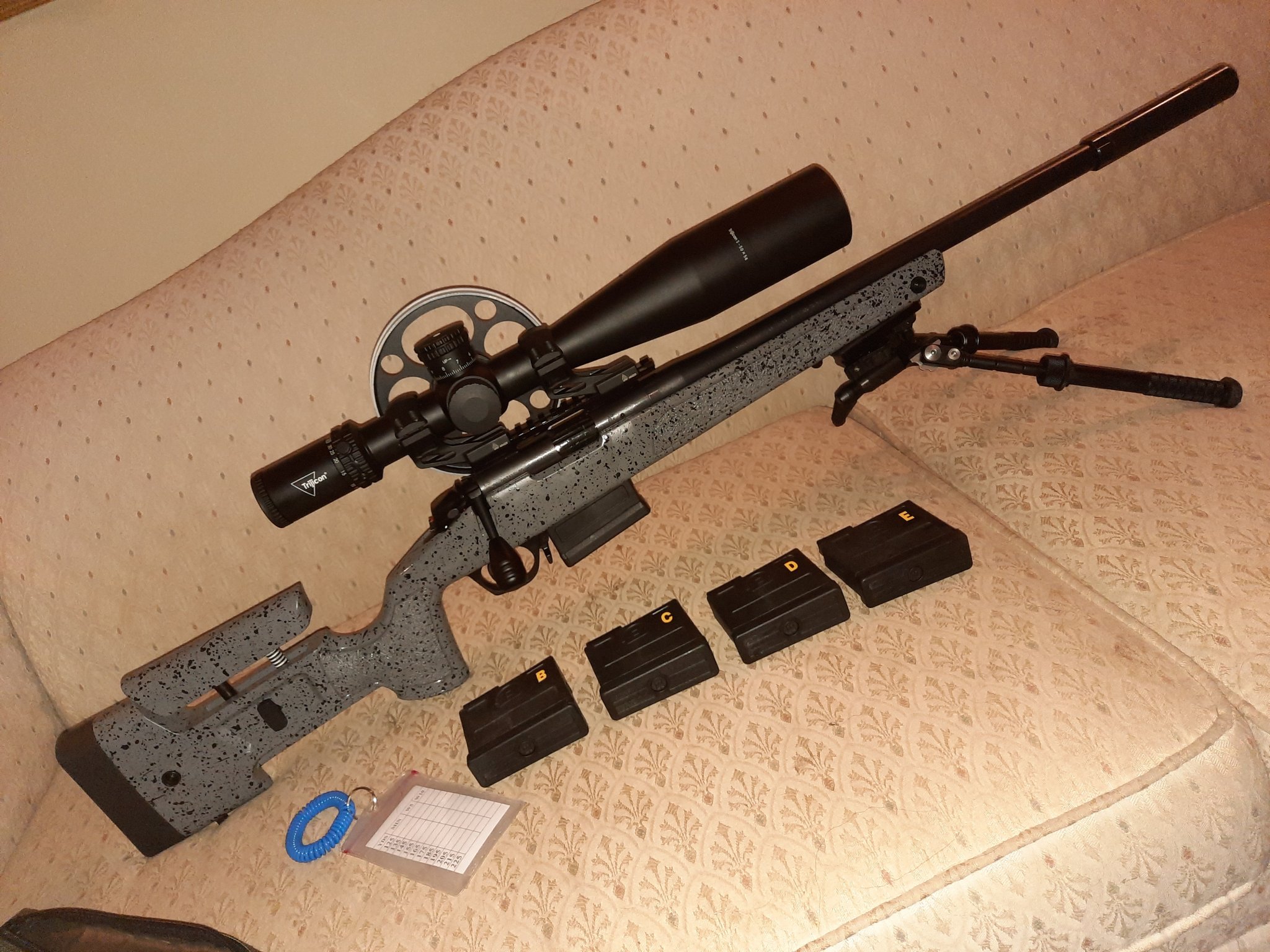

So I broke down and set up some trainers for Christmas presents (pro varmint and AT1 16”). 2.2 was doing ammo testing at 25m yesterday and just as he finished a fly started walking up the edge of the paper, a bet was made, I lost…but I’m still pretty dang happy.
For shooting middle of the road ammo on hand I’ve been very impressed. They were playing “HORSE” at 100m on some ~2.5 MOA targets and the games went pretty long, finally had to tell them no more prone.

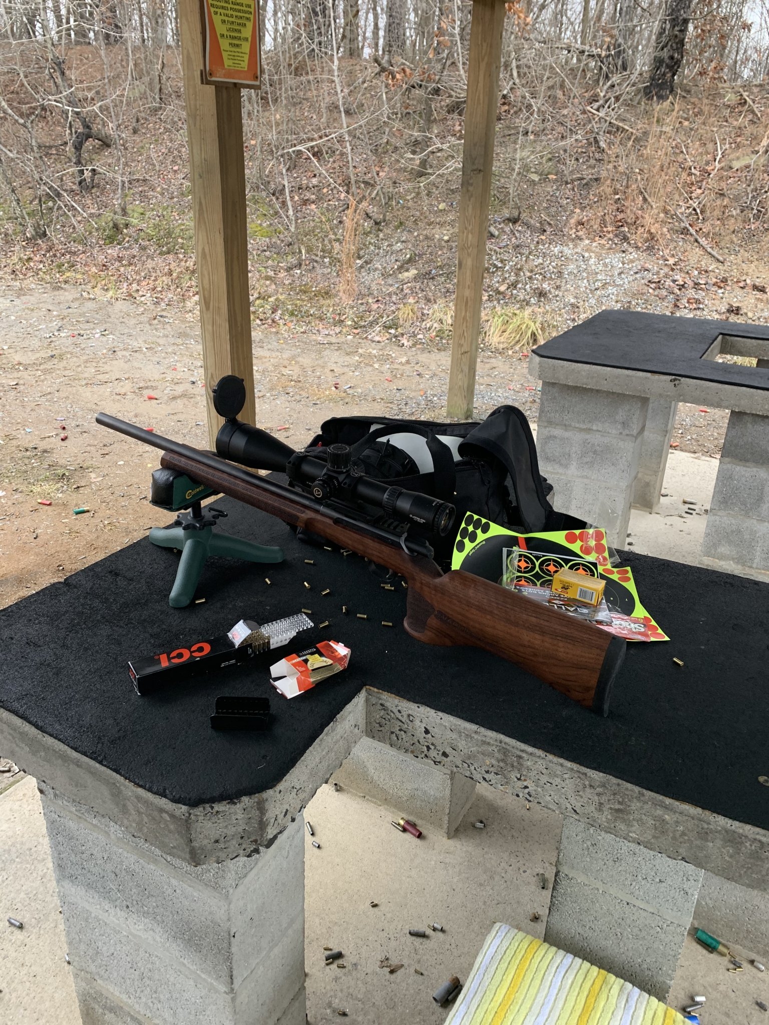

I got my self a CZ457 AT-ONE 16.5" barrel - for Christmas with Arken SH4 6-24x50 GEN2(MILS) Atlas bi-pod.. Did some ammo testing yesterday @ 50yds. of Eley Match, Eley Force, Eley Club , Eley semi-auto bench, Aguila Super-extra, CCI sub-sonic and RWS Special Match. wind was about 2 -5 mph, damp with some fog around 35 degrees with some sprinkles of rain here and there... Be back out, weather permitting to test the Wolf Extra Match..
Reactions: MPD280
After installation of a Lilja .22 WMR barrel the bolt on my CZ 457 is very hard to close. I have checked and rechecked everything that I can think of, any ideas other than shipping to Lilja? They have been very helpful in the past but hate to bother them if there is something stupid I'm missing.
It’s sexy for sure. Their wood quality is pretty incredible.
I don't know for sure but I believe that CZ reserves some upper level wood for the Royal model. They don't all look like the picture but I can say mine has some really nice figure and color throughout..
Bolt is hard to close without a round in the chamber? I would suggest you have someone else read the instructions and redo/check your math and see if you both arrive at the same figure for your shims.
No shims needed. When I didn't find shims and didn't unpack the barrel personally I thought that the shims were thrown away with packing but contacted Lilja to purchase them and was told that Lilja .22 WMR barrels don't use shims, chamber is cut to exact SAMMI specs, only their .22LR barrels use shims. Hence my post, I didn't want to contact Lilja and sound like a dumb-ass twice.
Reactions: fredfish
I just took a short piece of 0.062 rosin core solder, formed it into a "U" the same diameter of the rim of a cartridge, stuck it to the bolt with grease, closed the bolt. The outer edge of solder will get smashed and become the thickness of the headspace. Measure carefully with calipers. Kinda sorta similar to using plastigauge, but I couldn't find my old stash of plastigauge.
The bolt recess has a big part in headspace!
I had problems with bolt guide. You had to change mags and take out shim, I'd check around there
