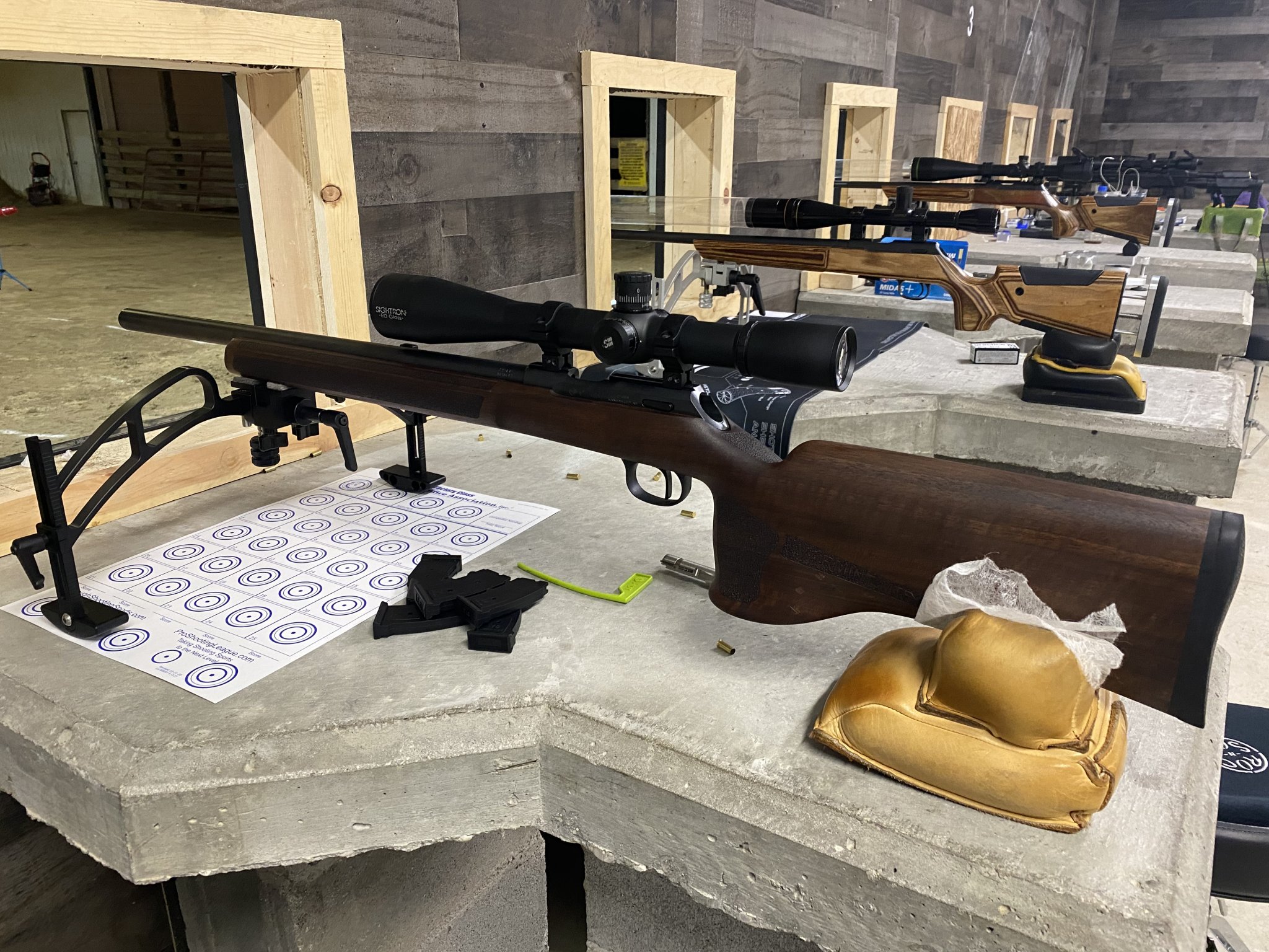

My third 457 gave a good showing the other night for a short barreled gun. ARA Factory class, 5 card match. 2440 Agg. I’m relatively new to bench rest so I was thrilled with that.
and I bought my fourth 457 at the match. There isn’t a 24” barreled 457 @1 or VPT to be had in the country so I think I scored with this used one. I would have preferred a VPT, but I wanted a longer barrel to better buck the wind.

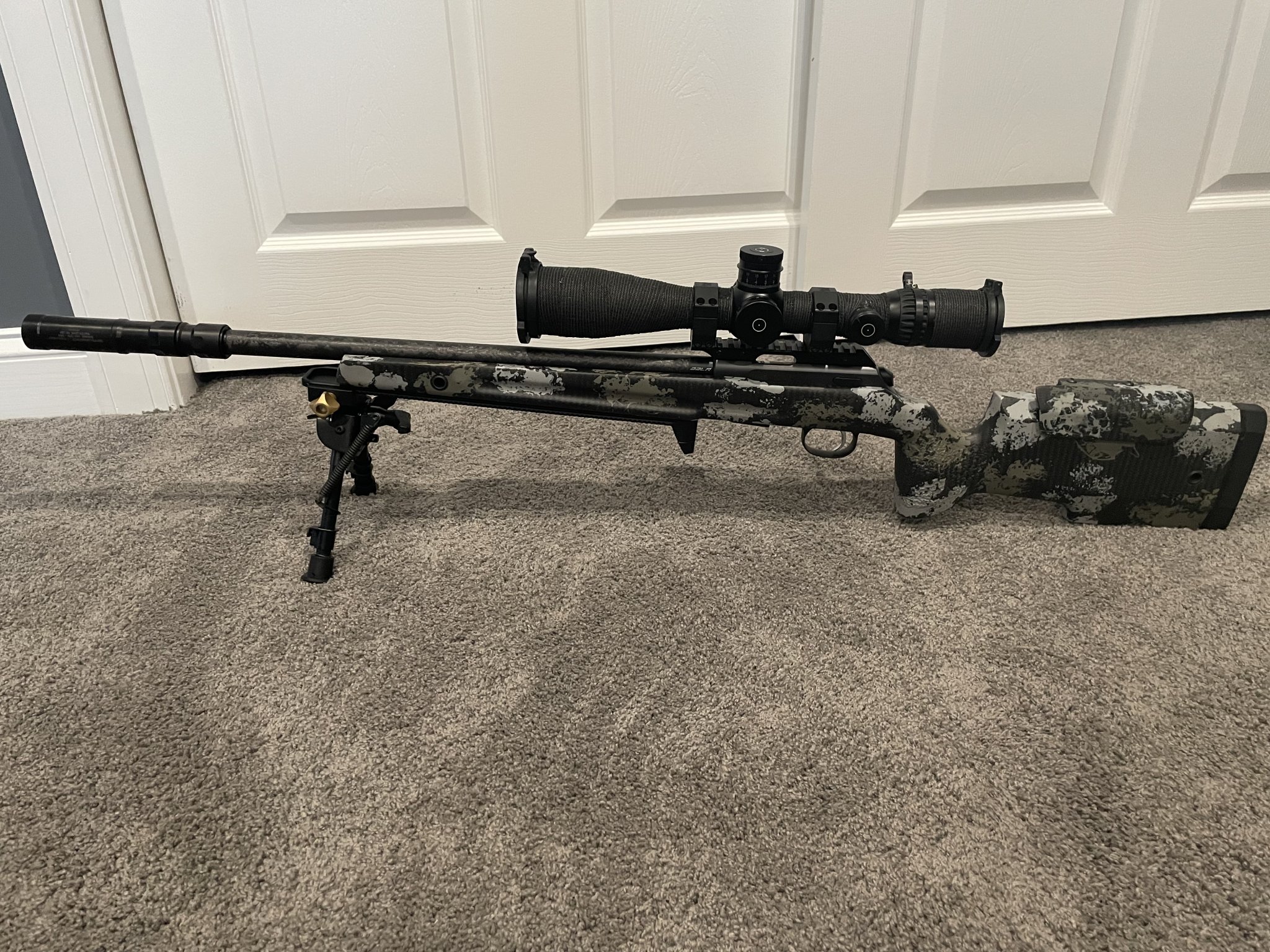

I’ve posted picture of this rifle in the past, started out as an MTR w/ a vortex gen 2 3-18. But as I’ve become more addicted to shooting it, it’s evolved. Hindsight being 20/20 I wish I would have just bought the cheapest 457 offering - as I wasn’t expecting to want to do much to it.

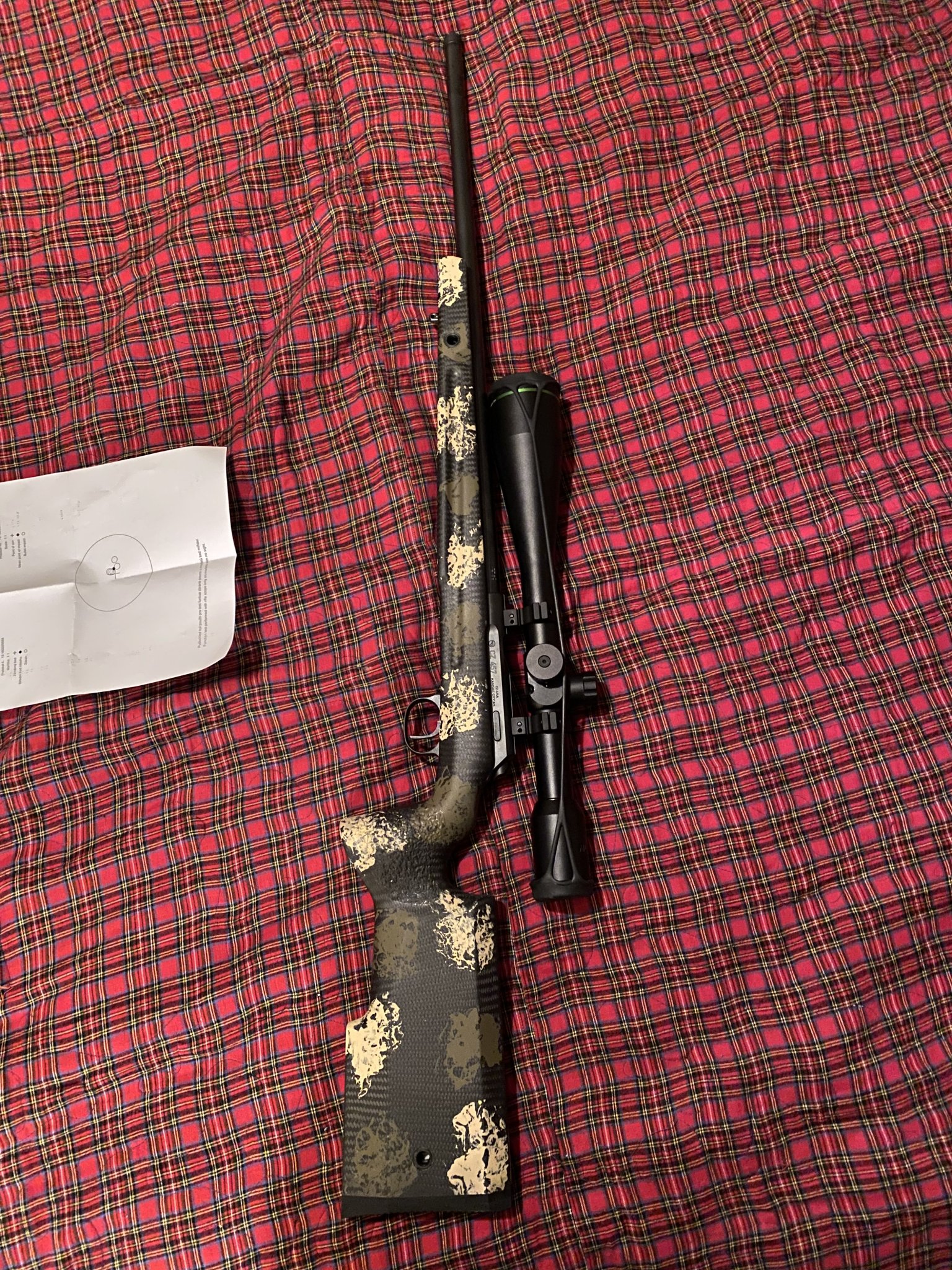

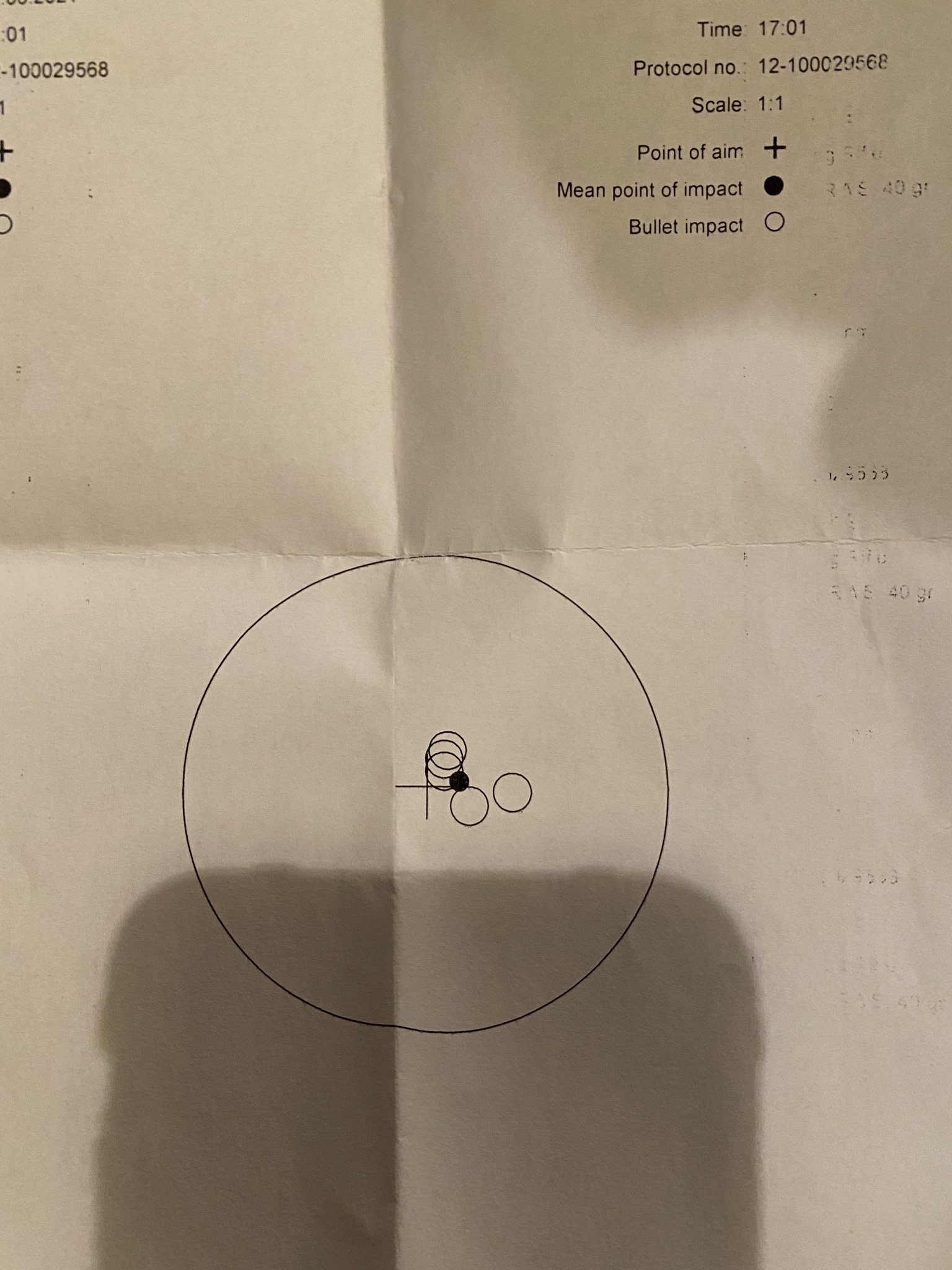

So here is my dilemma, recently received a CZ 457 Pro Varmint and show it twice in 85 degrees breezy 50 yard range with SK Rifle Match. I had sighted in at 25 and was comfortable. The 16.5 in barrel was good, didn't keep the target so no proof. Placed it in a KRG Bravo stock torqued to 35 lbs. It did well, quite well. Here is the situation though, I was able to place an order on a 20 inch Lilja barrel for the CZ. I'm wondering if I will see any real improvement over the factory barrel. Am I tempting fate screwing on the Lilja? I could have shot better; cheek weld was always off, bag to small, that guy next to me screaming etc etc etc. Thoughts?
regards,
