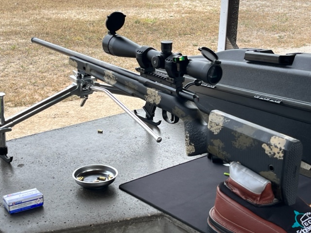

So, an update on the Lilija barrel on the CZ 457 22lr. in a KRG Bravo chassis.
Reset the barrel with .006 headspace. I used the .002 and .004 shims. Grub screws torqued to 45 in lbs. and action screws at 45 in. lbs. as well. Both these settings are factory recommended settings. Shot same lot of SK Rifle Match. It went well ! Bolt felt a bit smoother and definitely closed with only the typical new rifle bolt tightness if not a bit lighter, needing less effort to close. Unfired SK did not eject and I had to pull them out. Need to get a dowel! I had no light strikes and all fired rounds ejected fine. Tried some Ely Match and results were not as good groups were more open and I'm sure I pulled one as it was outside the square. Out of ten rounds, 2 light strikes and 1 would not extract. I am sticking to the SK match for now. As you can see, the day was awesome, 81 degrees, with a left to right breeze of 4 to 7 mph(someone there said it was, so I'm typing it)
Not happy with the failure to extract and the pickiness of the ammo, though the results were pretty good. All targets at 50 yards.
Will keep testing and I do appreciate your comments and suggestions.

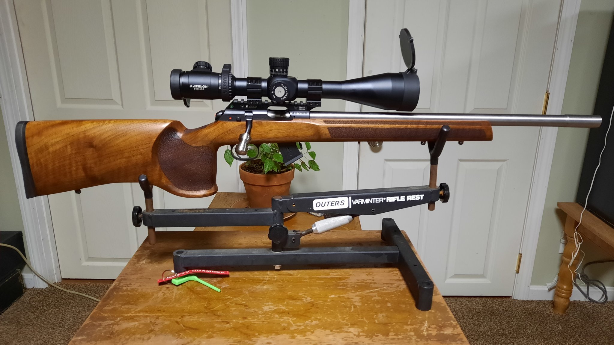

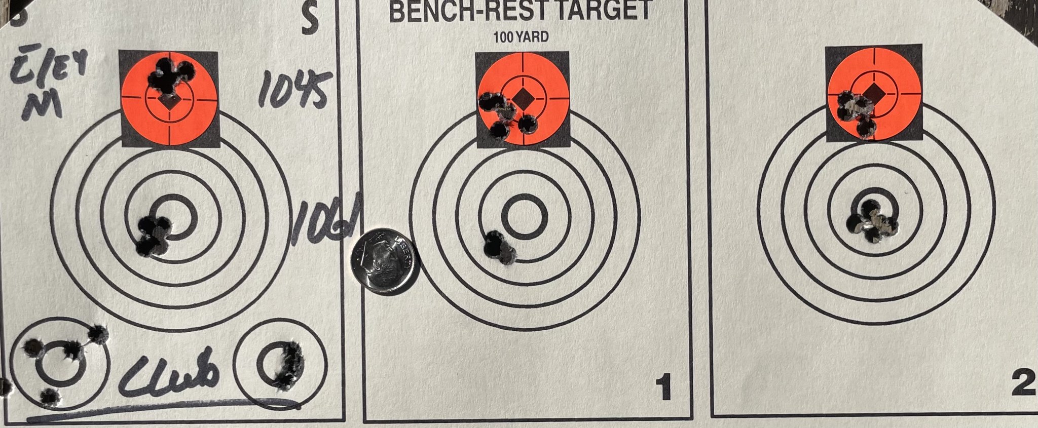

This what I am getting with my rig. - I just passed 5,000 + rounds with my Manners VPT Lilja barreled rifle that has a 0.044 HS setup. I used the 0.043 Go gauge to check the setup. I have not had any problems with the feeding or extractions after sharpening the extractor tip to get point contact to bite into the radius & re profiling the corner to clear the rim. I also reformed the extractor spring clip smaller to increase the force on the extractor.
Following Lilja's installation and barrel cleaning instructions is critical to get it right. You must clean the chamber every 100 rds and at every 200-300 rds use an old bronze brush and solvent to scrub the chamber to remove the carbon ring. A Teslong Borescope to check your work is necessary. The accuracy of Lilja is outstanding and measures up to JT's sub MOA YT videos. I use CCI SV (60%), Eley Match, Eley seim auto bench rest and some SK./ Lapua. Just started shooting 200 yds last week as the temperatures are now in the 60F. Nice, its stil in the sub MOA range! Its really a fun shooter if you keep it clean.
