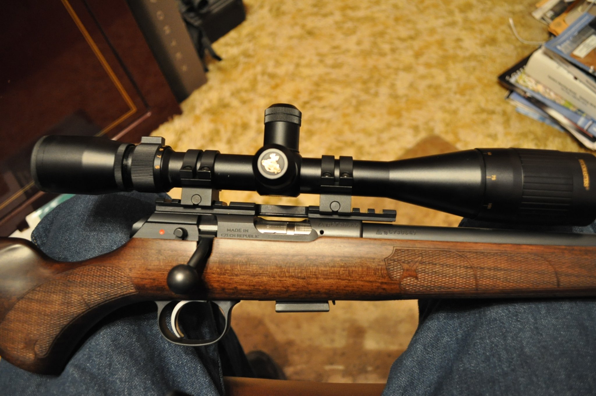

Diablo,

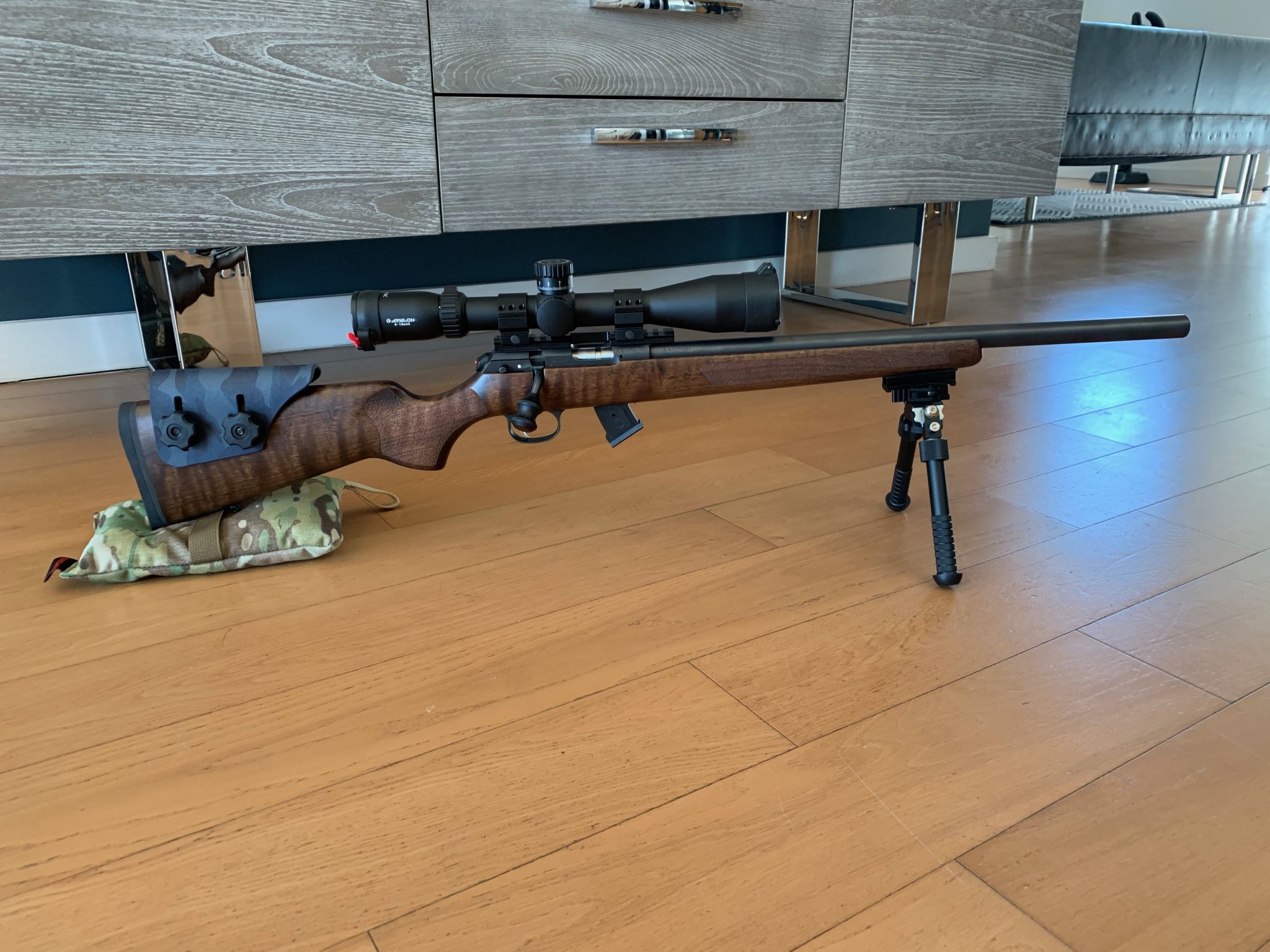

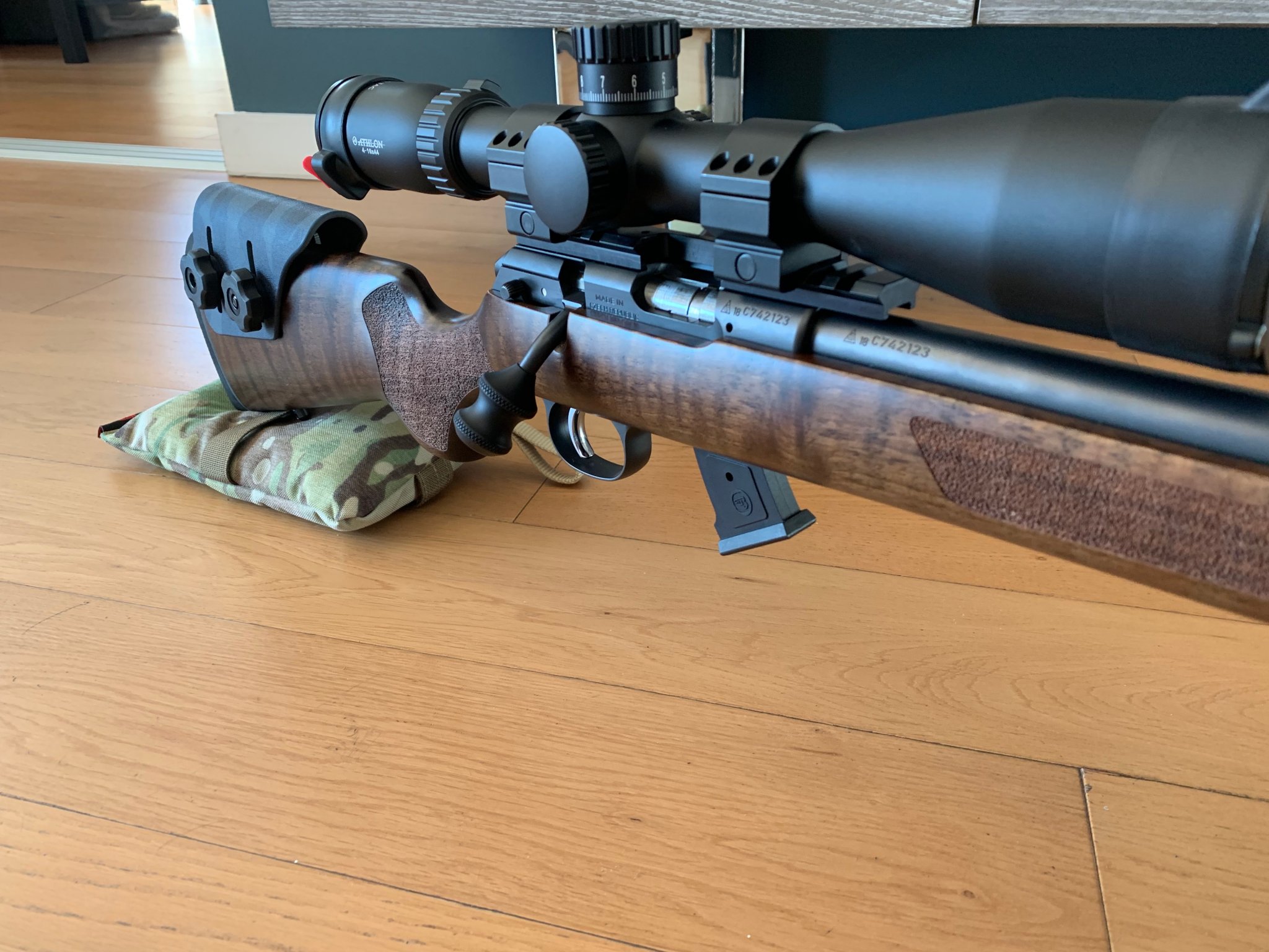

How high does that rail put your scope? Looks like its fairly high compared to the back of the stock, like the grain of the stock would hate to have to add a riser to it. Thanks..GH
I also bought a rail from Bob (BScar). I had issues with the bolt hitting my Talley Tactical rings. Emailed with Bob and he had me send him my rings and he made a new rail to fit some of the larger rings. Awesome guy to work with.
Diablo,
I had to add an adjustable cheek riser and I’m switching to an different rail mount. The rail mount is fine w the 419 and cheek riser, I just don’t like the big 419 logo and I can’t really see the bubble level, so I ordered a b scar 25 MOA rail. I’ll be selling my 419 30MOA for 70 bucks shipped if anyone wants it. I’ll post a pic later if the rifle with my cheek riser. The cheek riser radically improved my weld and ability to get a good eye box and view of the target without shadowing etc. mandatory upgrade in my opinion.

Diablo,
My 457 Varmint is set up identical to the one in your pic. I'm in the same boat with my Area 419 base, but I'm not willing to use a riser or mess with my stock. The 419 is a solid way to mount a scope, just too high for me.

@fastdiablo. Thanks for the reply.
Judging from your pics, with my 50mm objetive and Vortex defender obj cap my Seekins lows (.82) most likely will not work and Seekins med (same as your lows) would be pushing it. Looks like I'm going to have to give the Seekins Med High (.92) rings a try. In the end, I'm not really losing much height switching from the 419 rail. I might just have to wait for KRG to release a Bravo for the 457.

sounds like you're on the right track with the rings. i'll be interested to hear if you can get a good cheek weld with this stock. i was wayy below and my sight picture /eye box was unusable. I have a T1x at my FFL right now so will be trying the Bravo on that rifle..
as for the bolt knob, i wrapped some bicycle tube around it and twisted it off with pliers. was pretty easy. i used locktite to put the new one on.

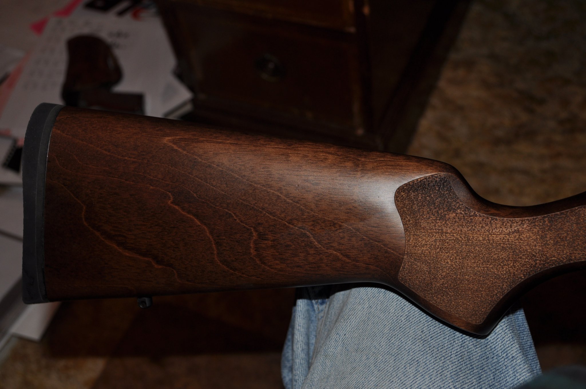

@flatland1 agreed, the stock is absolutely beautiful. the finish work and grain are incredible for an inexpensive rifle, and the pics don't do it justice. it was either get a riser or toss it altogether. taking it out again tomorrow to try a few brands of ammo. i'll try and do some groups for the forum.

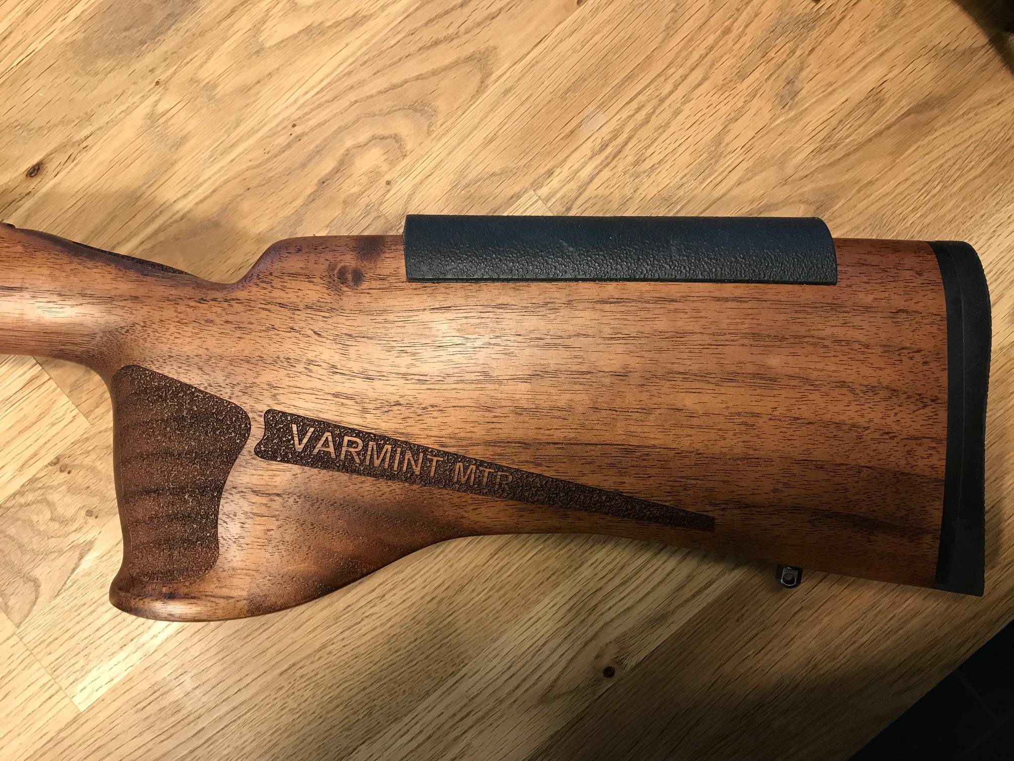

I’m new to the forum so I hope I’m doing this right. I’m also new to shooting. Here’s my new CZ 457 Varmint MTR with a Tract 22 Fire 3-9x40 scope. My first effort at 40 yards gave me the pictured target. You can cover the five shots with a dime. It’s really cold here so this is the longest distance I can try until it warms up.

Jeez Coldrolled - the wood in your MTR stock looks NICE! I'm still gonna pull the trigger on one of these MTRs if any of the wholesale distributors I have accounts with ever get any more of them in stock. I realize getting a stock as nice as yours is kind of like buying a lottery ticket (and it appears you hit the jackpot!), and I have no choice when it comes to getting one bought online from a distributor, but I guess I'll take my chances. That target is nothing to sneeze at either, especially out of a brand new bbl & fired by someone who considers himself a newbie....

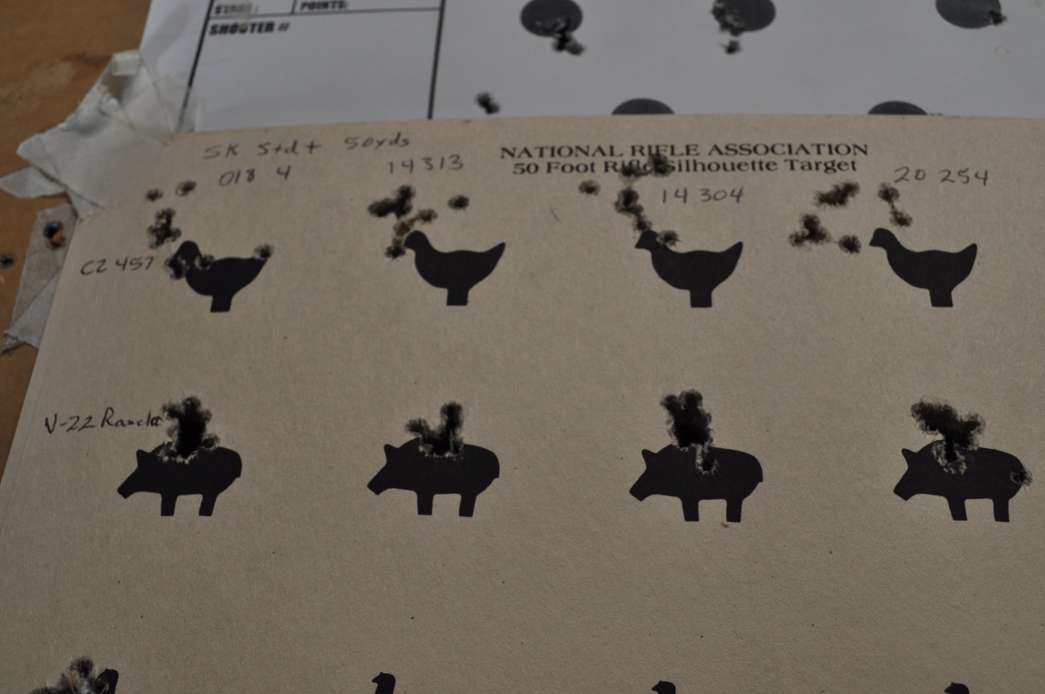

I took my CZ457 American & V-22 Ranch carbine out a few days ago to compare 10rd groups while testing three new lots of SK Std+ at 50yds. The conditions weren't bad - a little cool at 42F, but light winds & good light with no clouds. I shot off a portable bench, using a large, heavy Doggone Good Bag & rear bag. The 1st targets were shot last week, and after finding that one of the test lots was superior to the others, I took both these rifles out yesterday to do some shooting with the selected lot, as well as SK Pistol Match, Rifle Match, and Lapua Center-X. Temp reached 60F yesterday, although there was a variable breeze out of the north. Since the 1st targets were shot, I'd pulled the 457's bbl and re-cut the crown on the muzzle, as the original was kind of sloppy/ragged. I got the bore at the muzzle dialed-in within a couple of ten thousandths, and looking at the new 11* crown after cutting it, there was a large improvement. So, I'm guessing the improvement in groups was partially due to the new crown, and partially to the warmer temps. Still need to experiment by varying the action screw torque to see if there's anything more to be gained there. Will also shoot both rifles over a chronograph next time to compare ES/SD numbers - if the V-22's spreads are significantly lower than those of the 457, then I'll look into what can be done to tune its ignition system. Lighter striker spring, maybe re-shaping the firing pin? Whatever, I'm pretty happy with the 457 - it's been 100% reliable, the trigger - once adjusted to just over 1lb - is very shootable. And the BScar 25 MOA rail & Weaver rings I used set my old Nikon Buckmaster scope low enough to allow a good cheek weld. Now if I could just find a 457 MTR with wood as nice as coldrolled's rifle has...

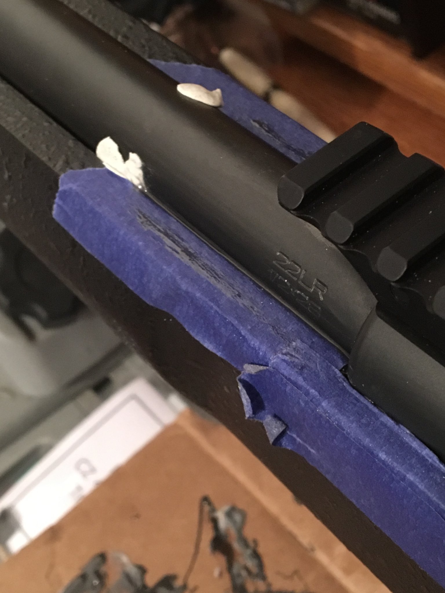

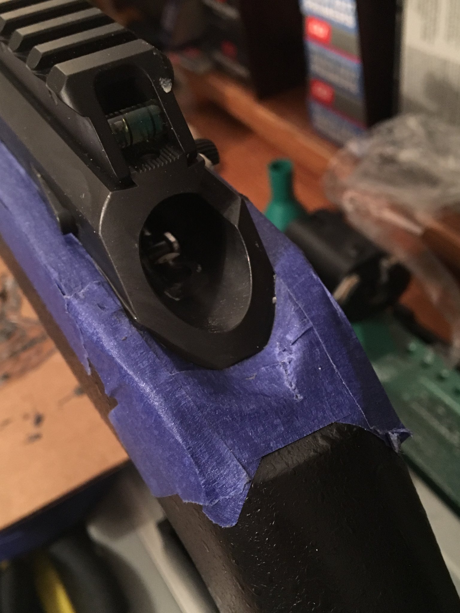

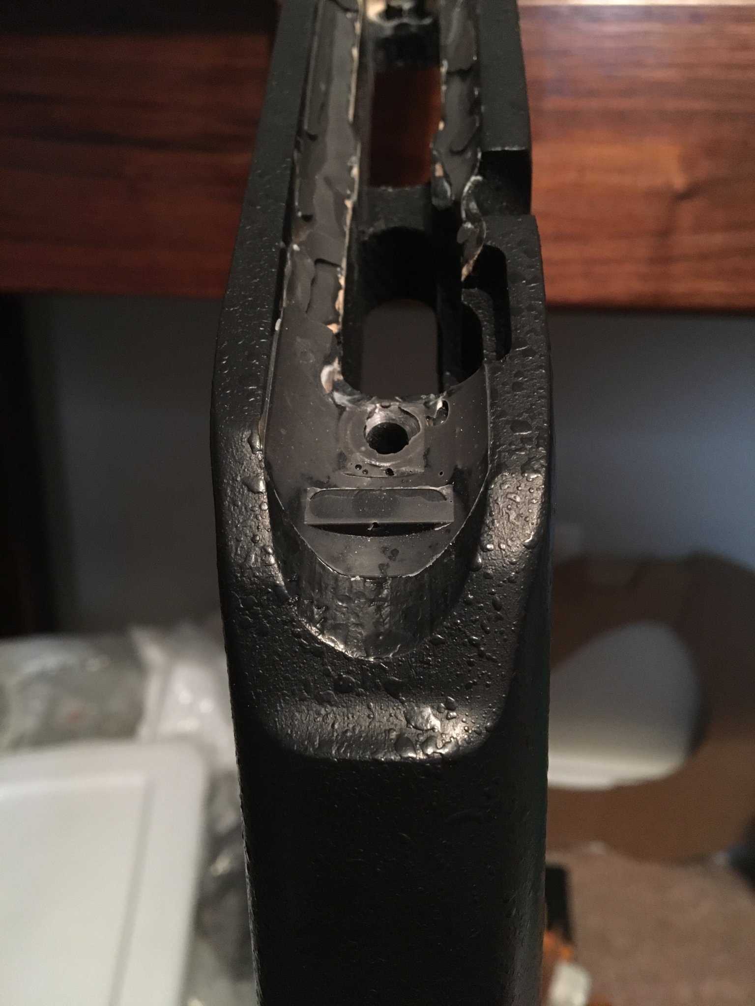

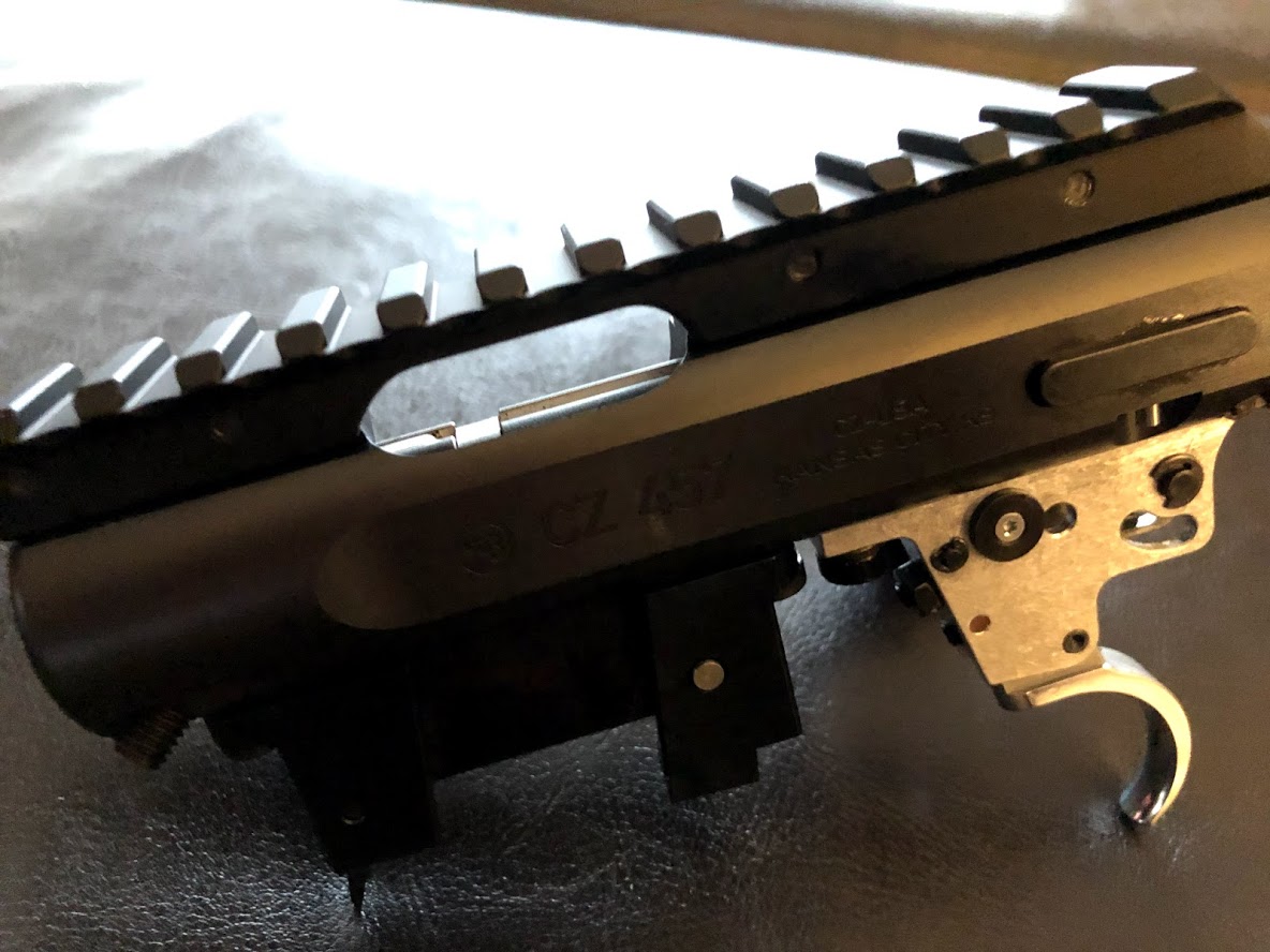

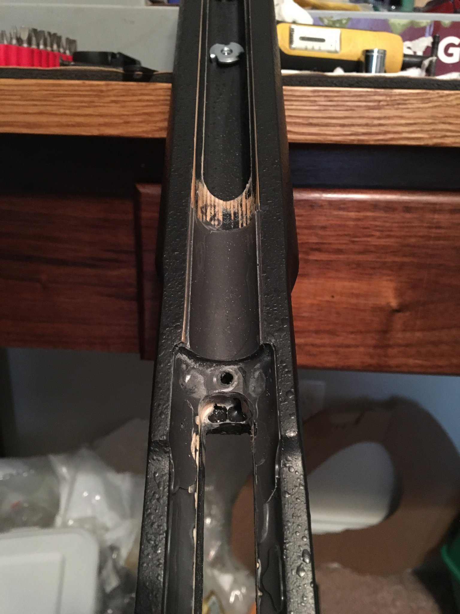

A few weeks ago, I picked up a CZ 457 Pro Varmint. So far I have been very pleased with it! The new trigger was very easy to adjust and tune. I have mine setting at 1.5lbs and it breaks like glass. Topped it with a Area 419 - 15MOA rail and a Vortex HST 6-24x50.
My first 150-200 rounds I wasn’t blown away with it. Somewhere between the 200-300 round mark it turned a corner and really started to tighten up! It seems to really like the SK Standard + and Lapua Center-X. CCI Standard Velocity, Norma and Eley Contact all did ok, but nothing to write home about.
I then got brave and decided to pillar and glass bed it. I used a piece of steel brake line for the pillars and Devcon for the bedding compound. I also bedded about two inches of the barrel, for additional support. This tightened up the groups a little, but more importantly, made them more consistent. I haven’t gotten the random fliers near as often since bedding it.

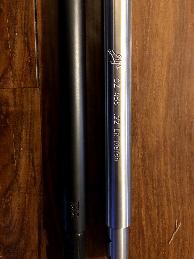

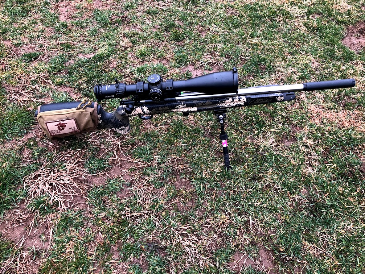

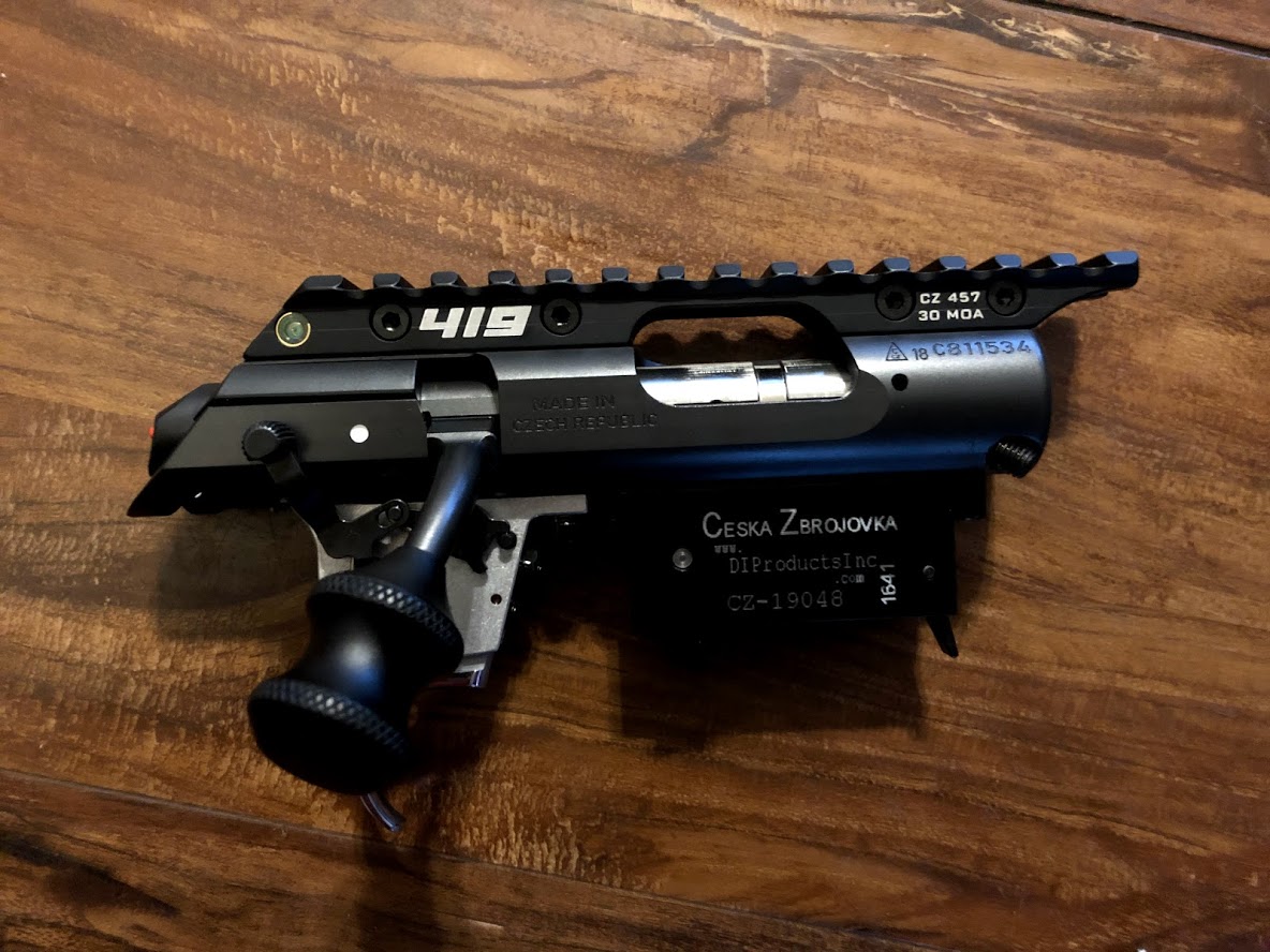

I really liked my 455 precision trainer. When I saw the 457 I had to build one up. I decided to do a quick write up for anyone on the fence about making this purchase. See pictures below.
Build specs
CZ457 Precision Trainer- Manners Elite Carbon Fiber Stock
Area 419 scope base
Area 419 Bolt handle
Area 419 Arca Rail system
Lilja .900 Strait shank 16 3/4" match barrel
D.I.P. products billet magwell
D.I.P. products extended magazine release
I expected to need to adjust the trigger as I did with the 455 when it was new. But that was not the case. The trigger breaks like glass at just under a pound right out of the box. The trigger is much nicer than the 455 triggers, you can tell CZ put some thought into this. That is saying a lot too, the 455 was the best I can recall from a factory rimfire gun.
The Area 419 parts are really well made and beautiful just to look at. The Arca rail is the older model I had lying around from another build. This was before they added the locking feature. The bolt knob is outstanding. Credit hear to CZ for threading the bolt in the first place. The small bolt knob was really annoying on the 455. I had previously used a KRG bolt knob designed for the Remington 700 and epoxied it in place.
The DIP parts are also really well made. I had these same upgrades on the 455 and for $60 I figured why not. They don't affect accuracy or performance but they do make the gun feel nicer.

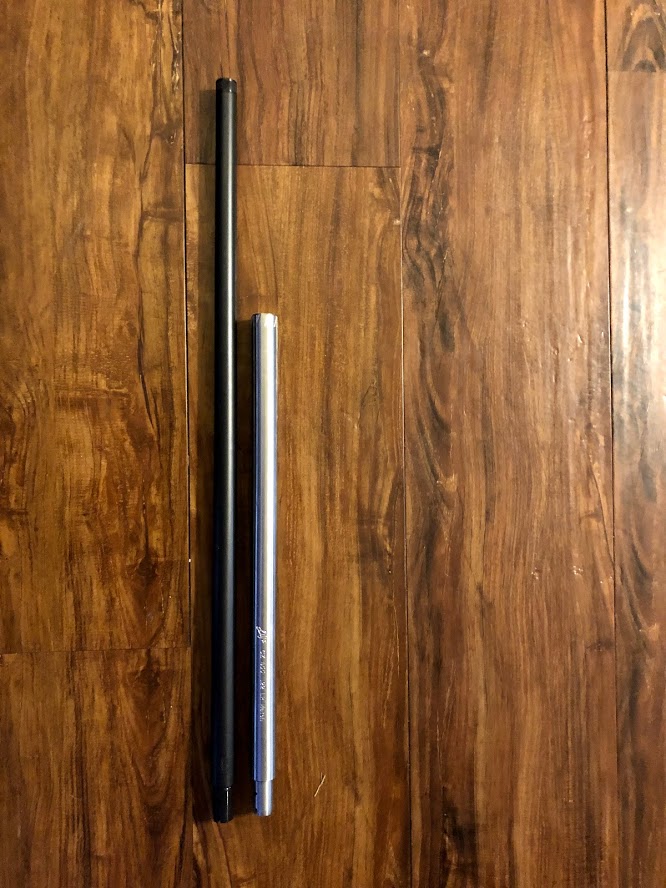

I had originally planned to "wait and see" on the Lilja barrel but I got a deal on the 457 with a 24" it was significant enough that it just made sense to buy the 24" gun and swap the barrel right away. The reason for wanting the short barrel is velocity. after about 16" 22lr starts to lose velocity to friction. The barrel install was a snap with the two set screws on the bottom of the action and lilja includes a shim kit system to achieve proper headspace. I have headspace set .001 off the lands for the Eley force 42g high-velocity ammo.
The action itself uses the same mags as the 455 and same quick barrel swap system as it did before. The trigger guard is better quality than the 455's and change from 90 deg to 60deg bolt throw is also a welcome upgrade.
I have about 200 rounds down the pipe and it is consistently achieving sub moa groups at 100 yards, right at MOA at 200, and consistently hitting a 6" plate at 400 yards.
Nothing lost in this new version of the CZ bolt action rimfire and it maintains the consistency I loved in the 455.

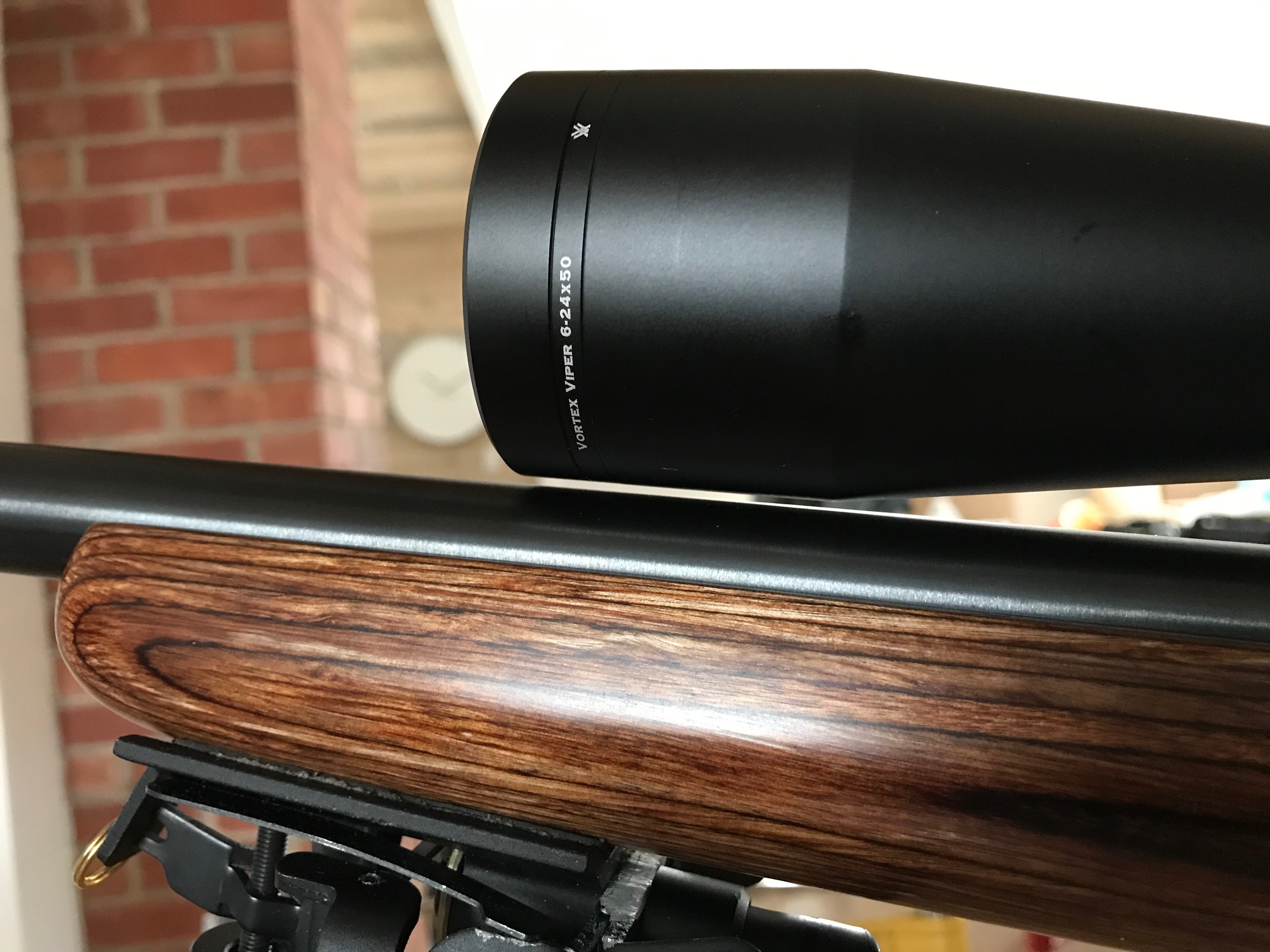

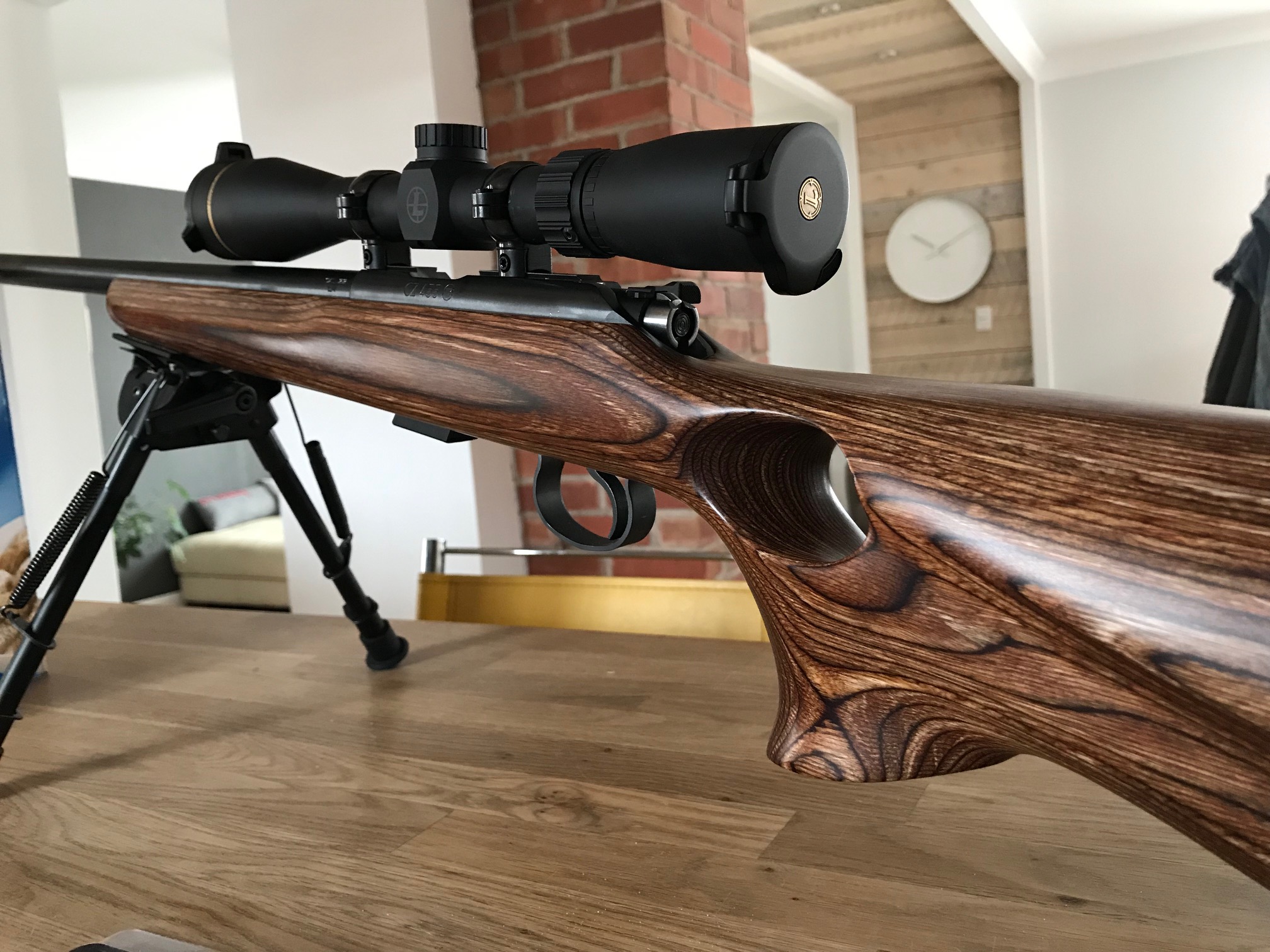

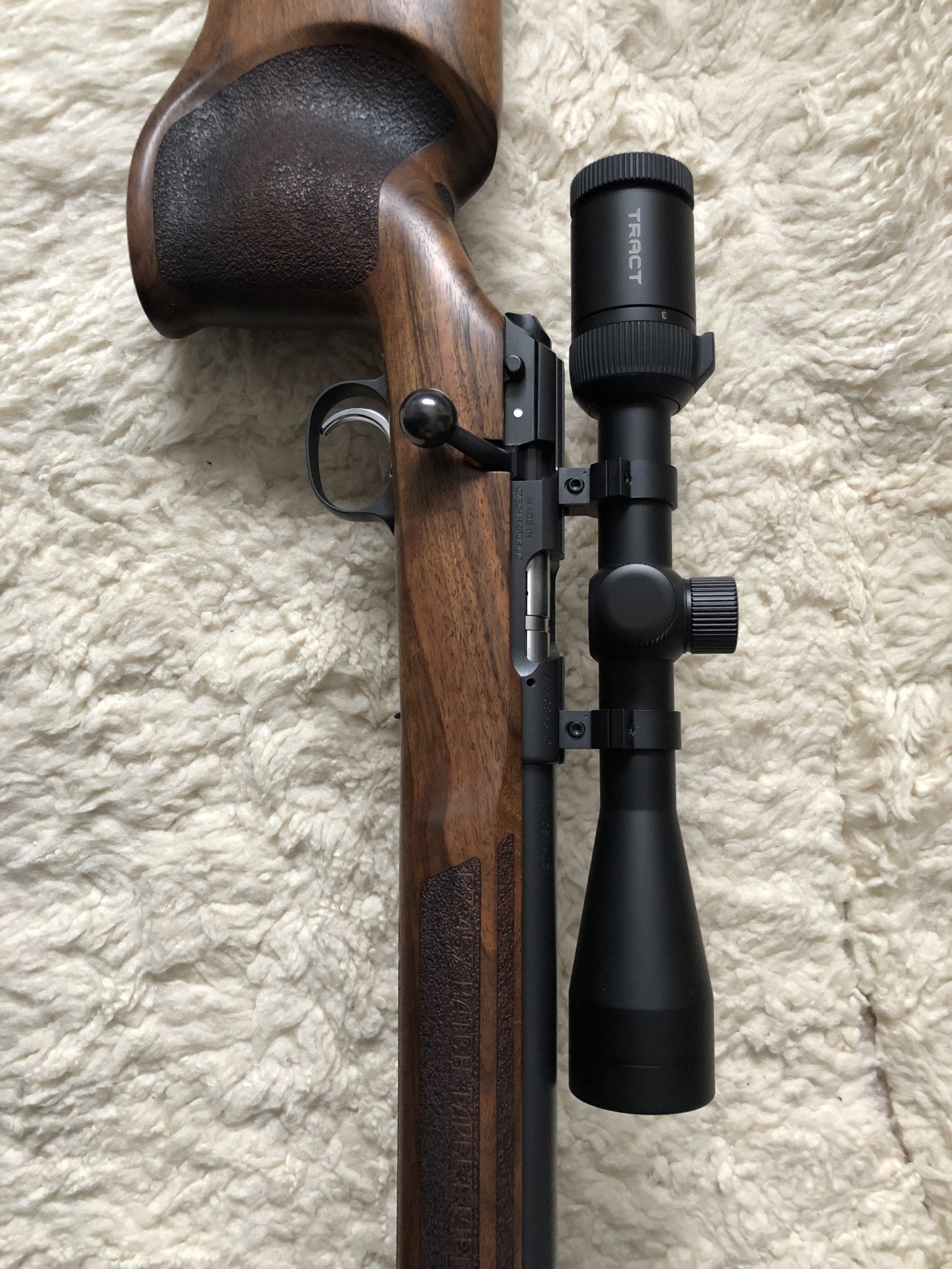

Here's some pics of my 455 varmint tumbhole with the 2 lowest rings I could find to fit my 2 scopes on, so I can avoid using a cheek riser. I though that it could help some people here with their choice of ring with the new 457.
Don't get me wrong, I'm a big fan of cheek riser. I know the importance of sight alignment while having your neck mussels completely relaxed. All my other rifles have adjustable cheek riser… It's just that tumbhole stock design that cannot receive any cheek riser properly. So, I had to find a solution with good sets of rings that would clear the objective from the barrel as well as the bolt handle from the eye piece.
This solution could be good also for those like me that do not want to drill holes in a nice piece of wood or carbon fiber stock to install an adjustable cheek riser. No offense to anyone here. This choice is personnal. I did drill holes in my savage plastic stock… but I chose a Godagrip cheek pad for my CZ 527 MTR for example.
So, here are the pics.
I hope that it will help!
Martin Kitchen

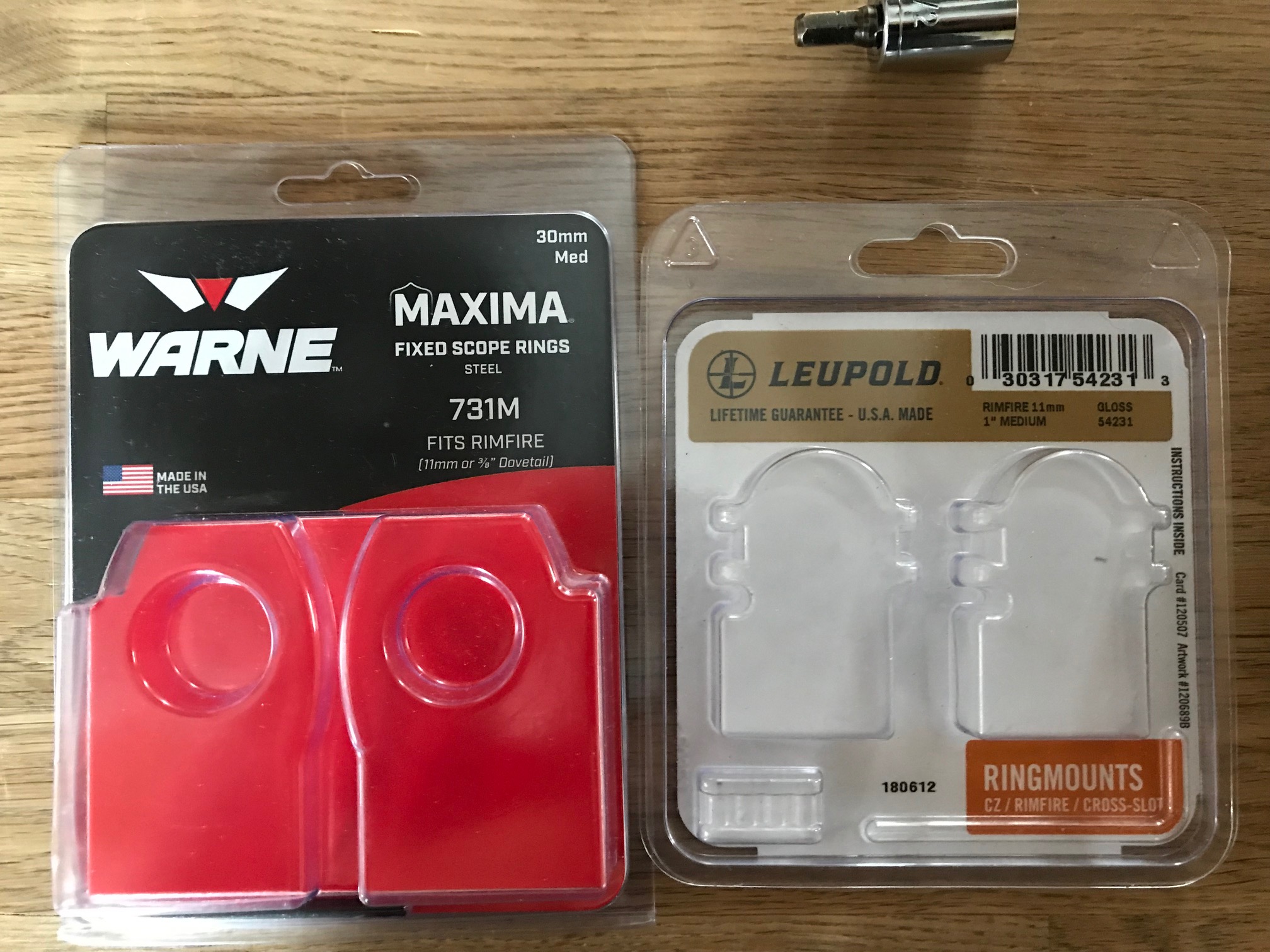

1. Leupold VX-Freedom 3-9x40mm 1'' tube + Leupold rings 1'' medium height (0.860''). Product code #54231.
The 40mm objective bell diameter is 1.830'', clearance is about .090'' from the varmint barrel and the bolt handle is not touching the scope eye piece witch is 1.555' in diameter. (almost touching!) This set up is perfect for me as far as sight picture alignment.
2. Vortex Viper HST 6-24x50mm 30mm tube + Warne rimfire 30mm rings, medium height (0.990''). Product code # 731M
The 50mm objective bell diameter is 2.26'' and almost touching the barrel with 0.045'' of clearance. Same thing with the bolt handle. The eye piece diameter is 1.745'' on the widest (zoom ring). This set up is 0.130'' higher than the previous one… so not exactly the perfect eye alignment with the scope… but this is the lowest I could put my Vortex on.
3. As you probably noticed, the bolt body of the new 457 slides in the receiver differently than the 455. As I saw on the previous pics that some posted here, we have to be carefull not going too wide with the ring clamps. Some rings won't prevent the bolt to slide properly. The width of the clamps of the 2 sets of rings I proposed here are pretty slim. I'm almost sure the new 457 bolt body/handle will clear these rings.
4. The original packages.
I know sometimes fitting everything perfectly is a bit of compromise… With these 2 set up I could not benefit from the extra 20 or 30 MOA scope adjustment that a canted picatinny scope base could offer.

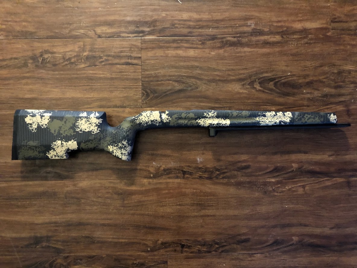

very nice build. how do you like the new manners stock? did it come pillar bedded like the rest of the 457's?
Yes, the new version is pillar bedded. Can't speak to the OPs experience, but as much as I liked the T4, the PRS is even more comfortable. I had just settled into a 455 VPT when I had the opportunity to get into a 457 VPT and the stock was one of the reasons I made the transition.
