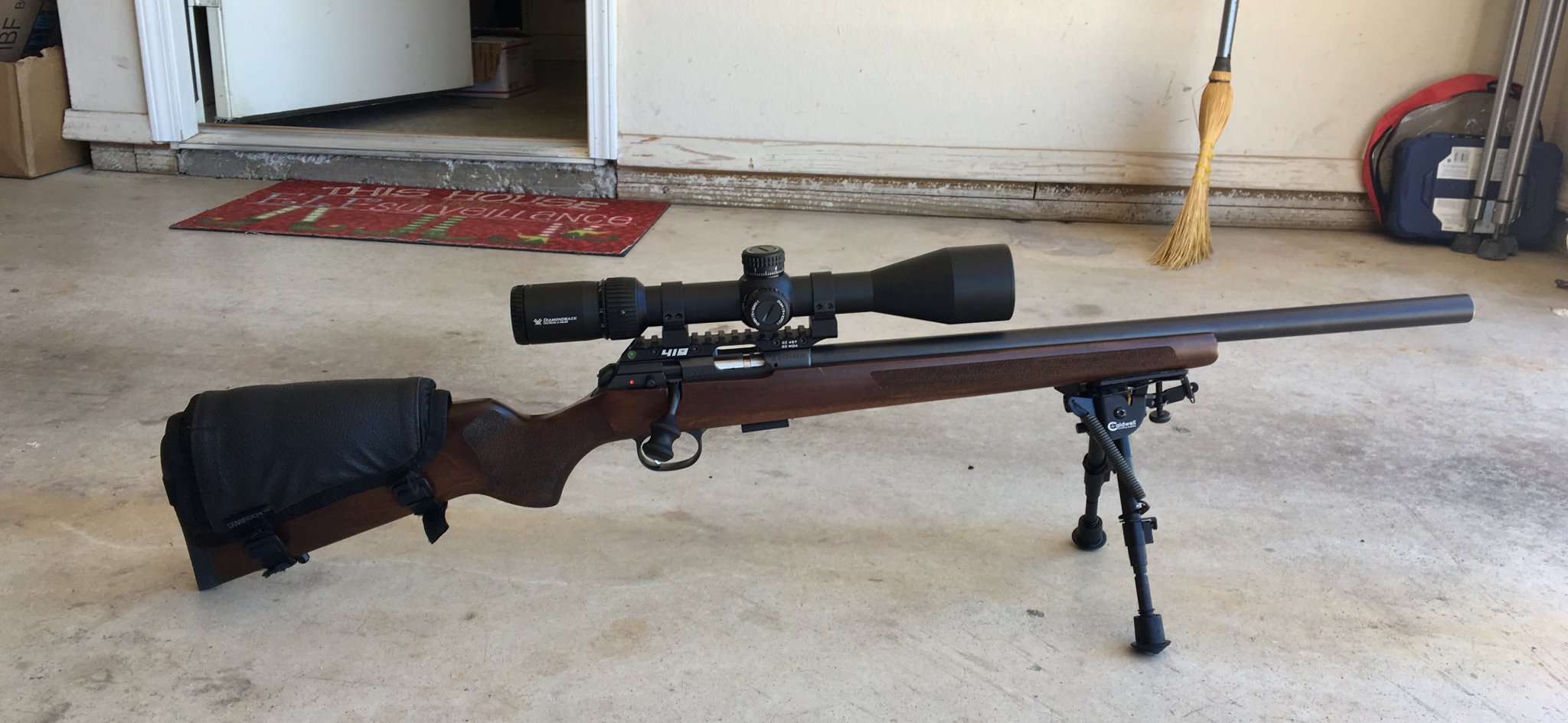

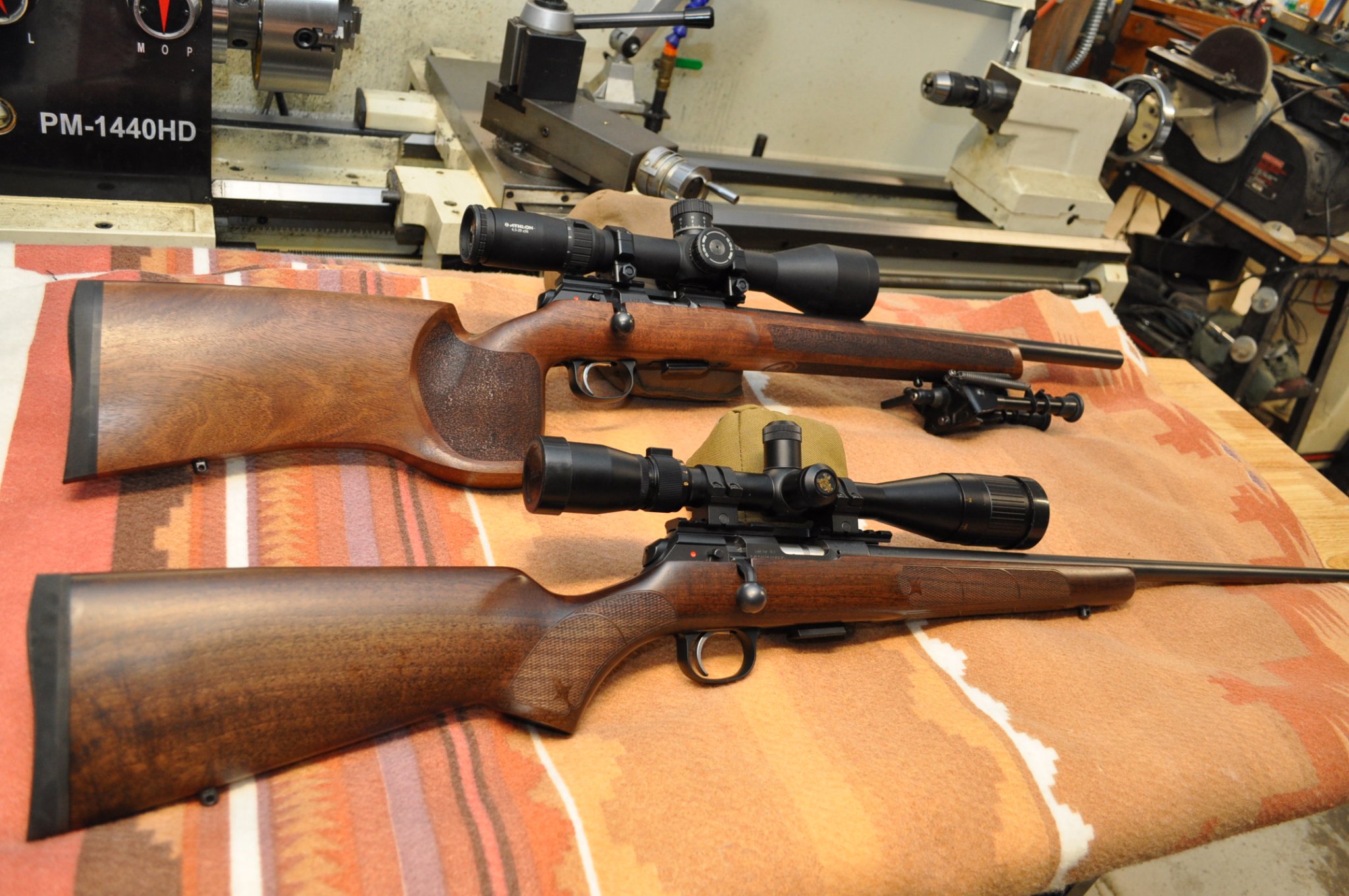

Yes, the new version is pillar bedded. Can't speak to the OPs experience, but as much as I liked the T4, the PRS is even more comfortable. I had just settled into a 455 VPT when I had the opportunity to get into a 457 VPT and the stock was one of the reasons I made the transition.
good to hear. i will be making the transition myself here soon enough
Reactions: POGPride
very nice build. how do you like the new manners stock? did it come pillar bedded like the rest of the 457's?
As mentioned above the stock is great. Yes it is pillar bedded. I really liked the T4 one the 454 but the PRS is even better.
The whole rig (455 vs 457) did lose some weight and I need to get used to that.

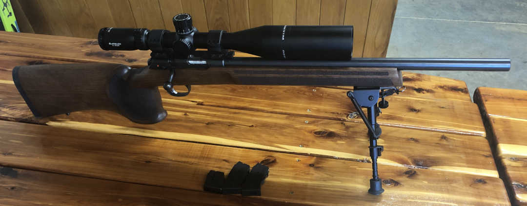

I'm very pleased with the CZ 457 MTR varmint. Installed a Leupold vx3i efr. No trigger adjustments (yet). See pics at 50 yds.

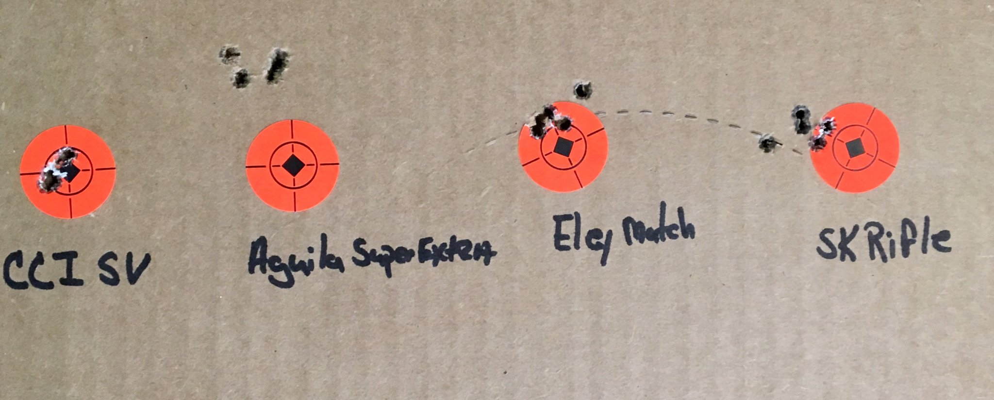

Went out today to just mostly get it on paper since conditions are less than ideal. Found a spot where I hunt that blocked a bit of the wind and shot with the wind.
All shots are 5rds at 50yds.
7062409
Saving my better ammo for a day with less winds. Was really pleased with the CCI SV.

I haven't been able to get mine out due to wind, but I really like that your barrel shot CCI well.
