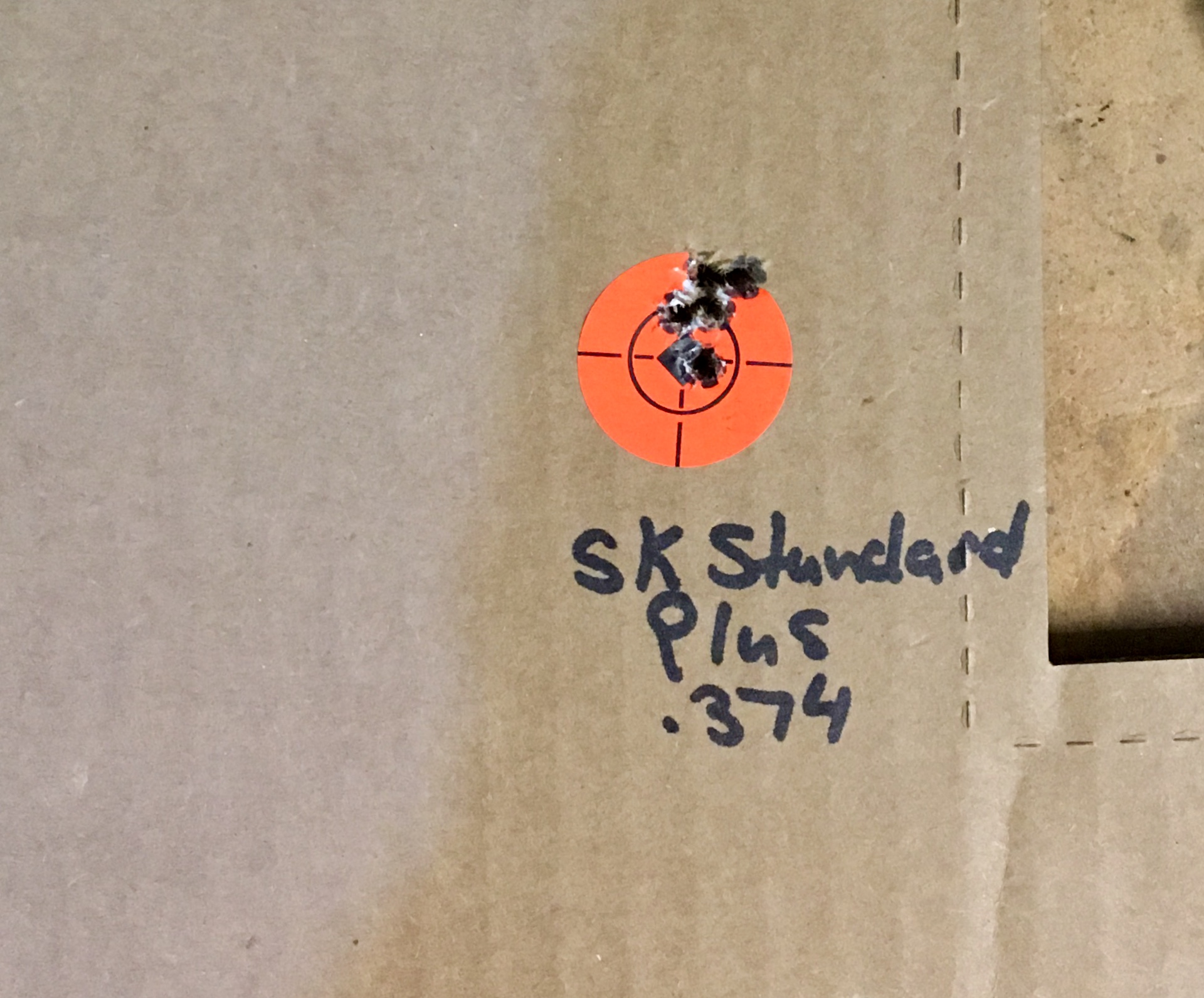

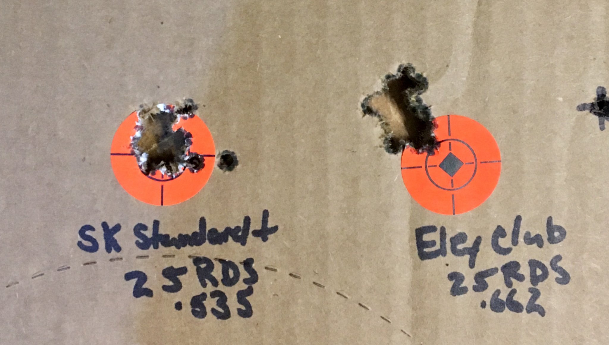

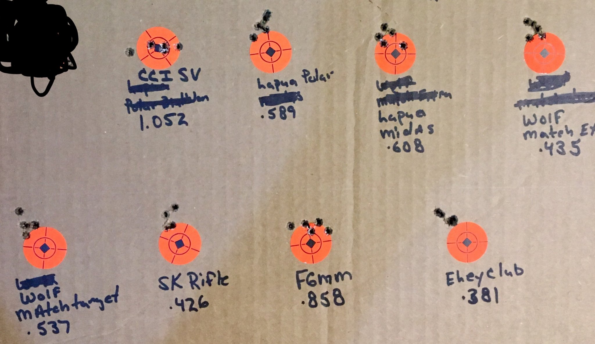

@drglock nice groups man. i have a box of CCISV that i'll have to try. my high velocity CCI didn't do too bad either. I also have the 419 bolt handle and really like it. i had the 419 30MOA scope base, but i swapped to the bscar triggers scope base. if anyone needs a 419 30MOA scope base, DM me for a cheap deal.
7063063
7063065
7063066

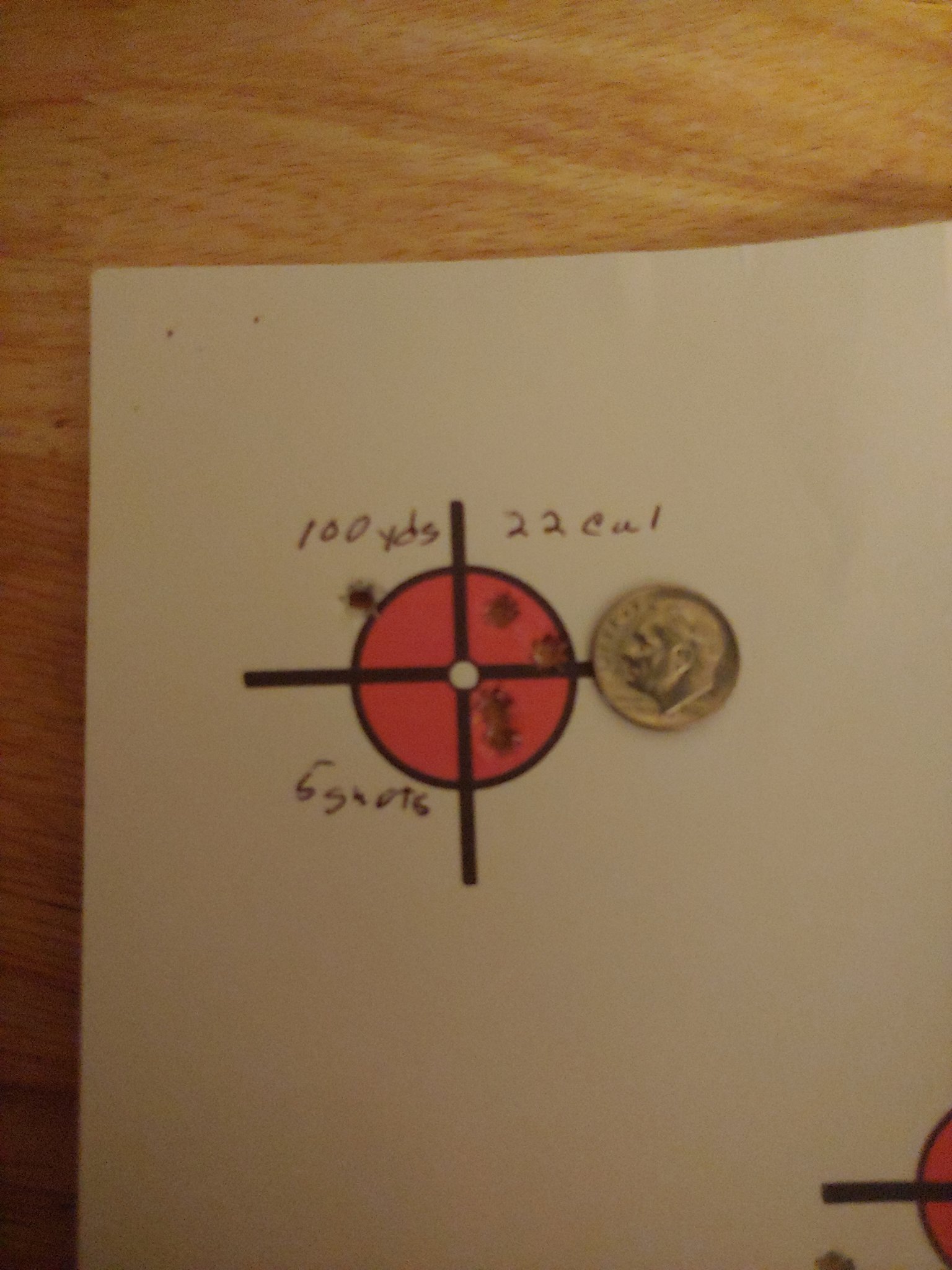

Conditions still not very good here. 16-18 mph gusts, got out of the wind the best I could and tried to catch the wind at lesser gust but still made it tough to shoot groups. This should give an indication of what these are capable of.
80 degrees
Winds 14-16ish
50 yards on all shots
Reactions: cro789

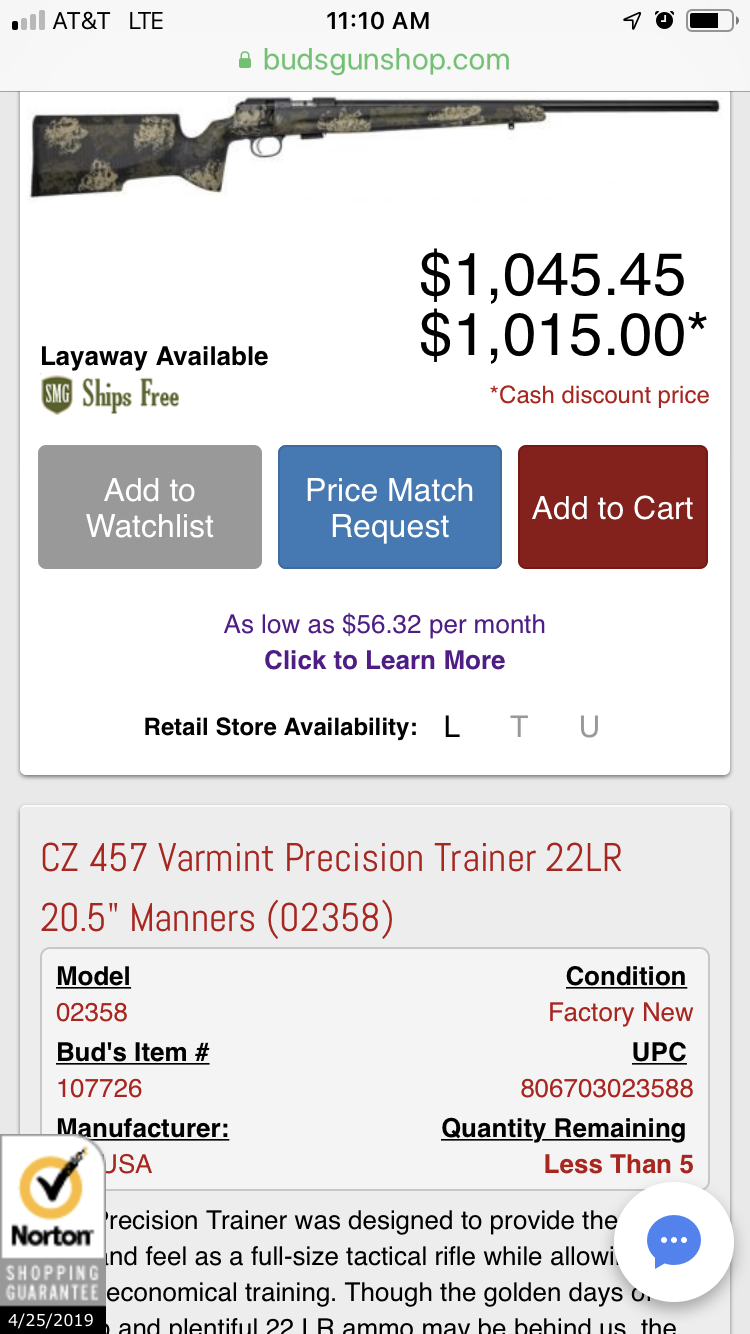

Are the Pro Varmints available anywhere yet? I've been on several "email when in stock" waitlists for months now and check aggregator sites like gun.deals now and then but I haven't seen a single one in stock for sale.
Buds gun shop web site say they have some. Says less than 5 remaining

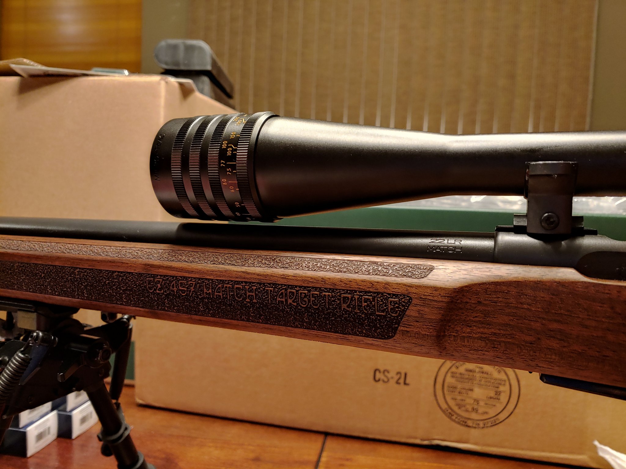

I bought a 457 Varmint. Really like it. It is stock. The adjustable trigger works great. I added a EGW 0 MOA scope mount, a Vortex Pro Series Rings and a Vortex Crossfire II scope. Still playing with different ammo. Eley Target is best so far. Neat little rifle. Shot it at 100 yards with a little wind.

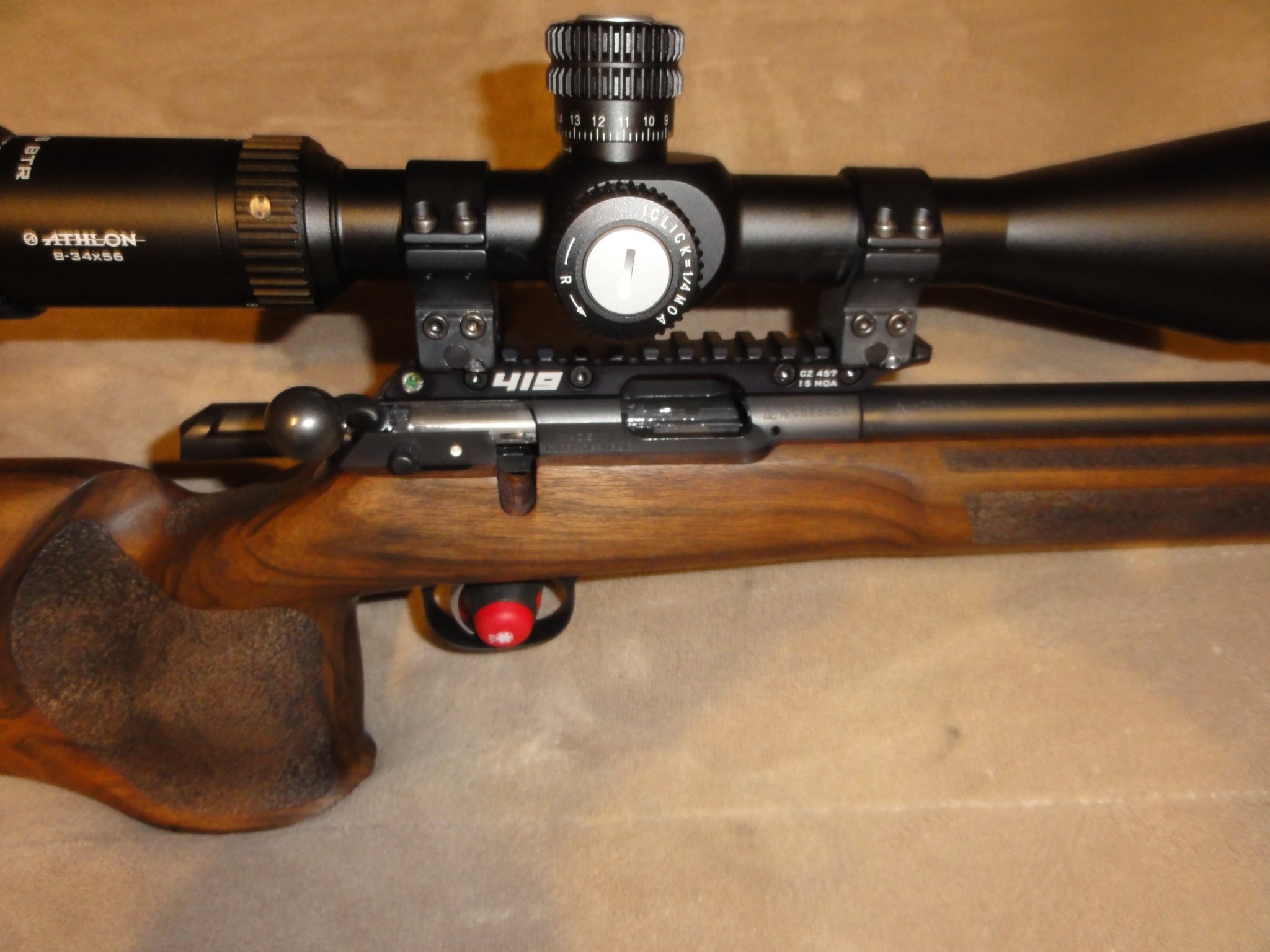

Did you get the MTR version? The factory trigger on my 457 MTR goes down to 15 oz. I put a YoDave spring kit in her and it went down to 9 oz. Because of the trigger blade, it feels like 6 oz. Be aware that the trigger pin in your rifle is very likely a press fit. Mine was scary tight until I reduced it's diameter for reinstallation. The second photo is of my RPRR. My MTR trigger feels so nice that any lapping is not necessary.

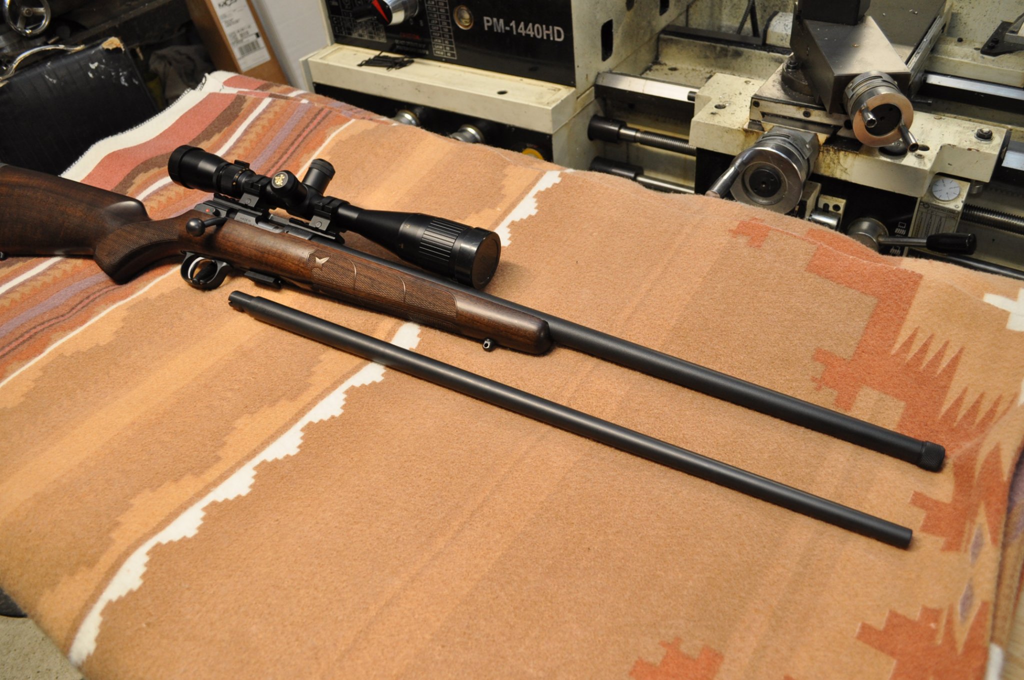

I shot my 457 American with the new Shilen select match ratchet rifled bbl that I'd contoured, fitted, and chambered last evening. I haven't cut the extractor grooves on it yet - the slotting saw I ordered for the job is supposed to be delivered today. I also wanted to test fire the bbl to see if there was any advantage to indexing it at 12:00, 3:00, 6:00, or 9:00, and was able to do so by just tightening the grub screws on the bbl at each position. But my jerry-rigged system for holding the bbl'd action in a vise on a bench was far less than ideal, and I felt the results were pretty much meaningless. So, hope to get the extractor grooves cut this afternoon, then get the bbl glued into the action - also ordered a new bottle of Loctite 609 to accomplish this. I bought a R5 contour bbl, then parted-off the 1.25" dia shank and turned the radiused neck down to .925", which resulted in a 2.5" straight shank that blended into the straight taper out to the muzzle, and after parting off an inch at the muzzle, the finished length is 23". It weighs just over 1/2lb more than the factory American 24.5" bbl., and the first few groups I shot with it at 50yds last evening were a huge improvement over the splatters that the OEM bbl shot... Will post photo of rifle & groups after I get the bbl CeraKoted. Am thinking of adding an ounce or two of CK tungsten to graphite black in an effort to match the OEM nitride finish.

Not the MTR. I used the trigger weight adjustment and the sear screw adjustment in combination. I had mine at 4 or 5 oz. I found this to be to light although a 2 foot drop test and a slam fire test did not result in the rifle firing. With rifle ready to fire {empty} adjust the sear until the trigger releases re cock then turn the screw back until you have what you want. A 1/4 to 1/2 turn can take you back to 2 lbs. I got all the info online to make these adjustments. No parts no $$$.
I need to get the trigger instructions... lol. ...... I like light triggers so the 15 oz. was to heavy for my likening. I would like my triggers as lite as possible and still be safe. It sounds like I can still squeak out some performance out of her.

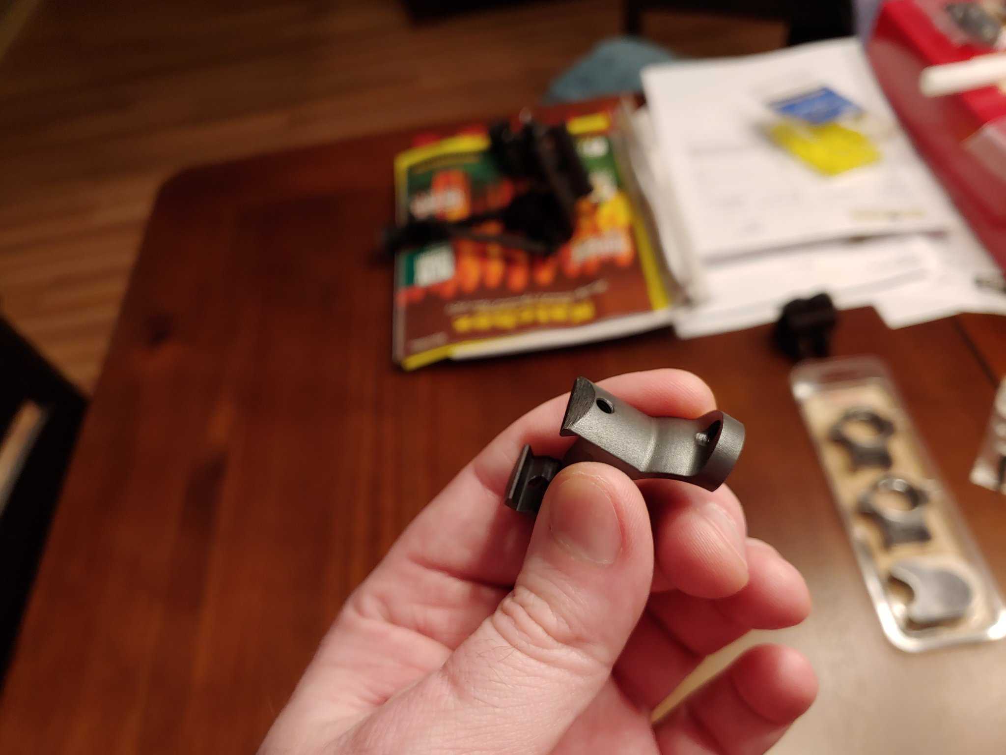

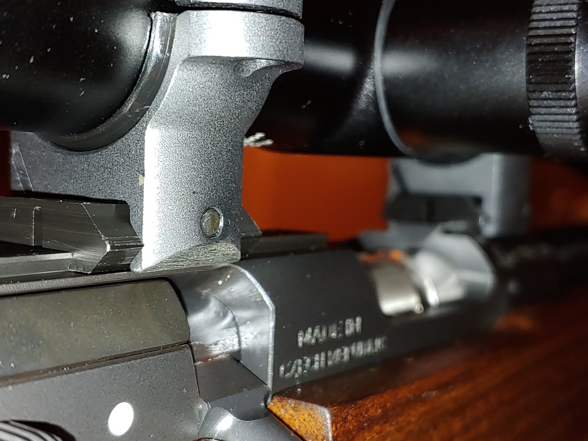

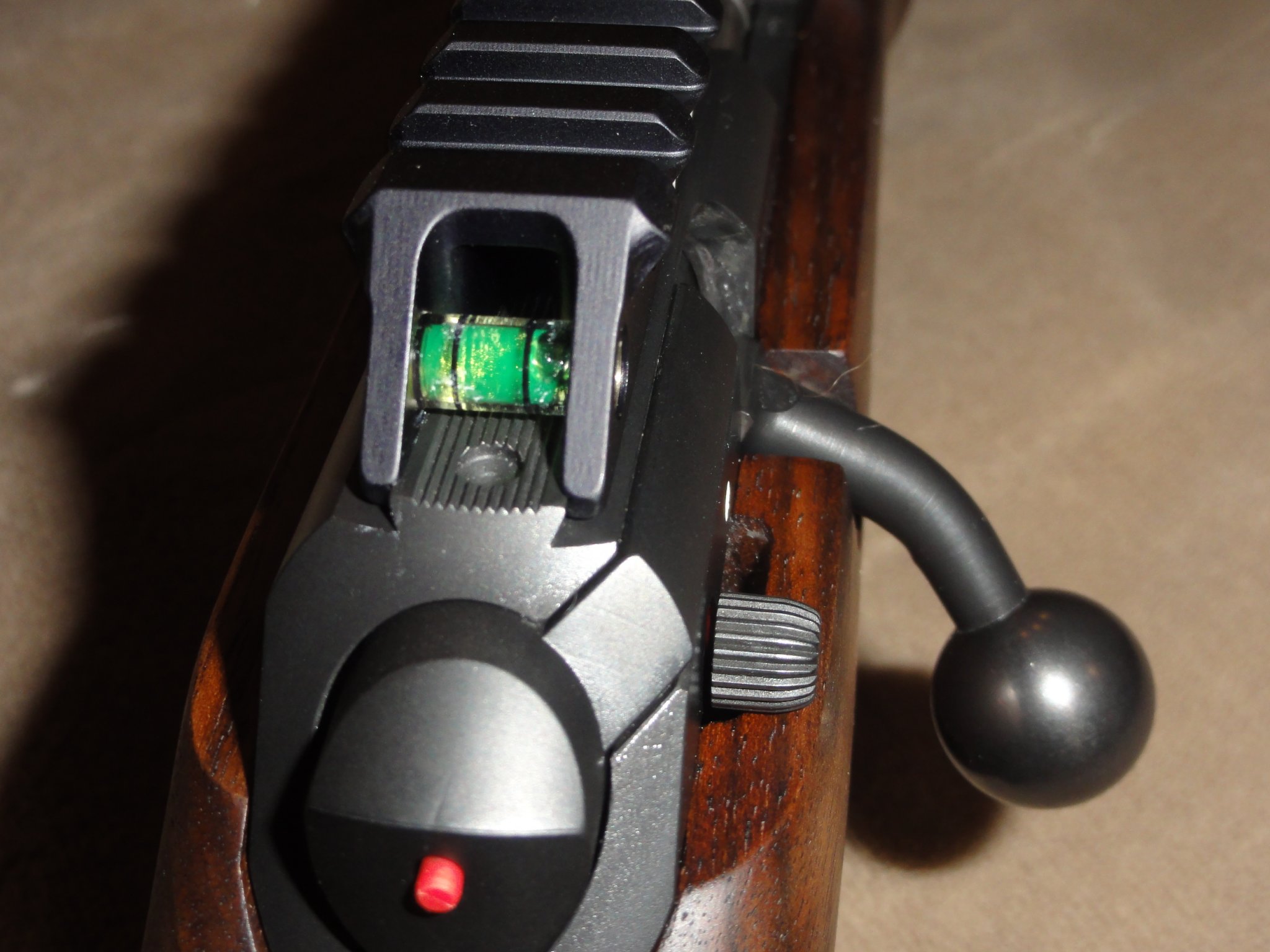

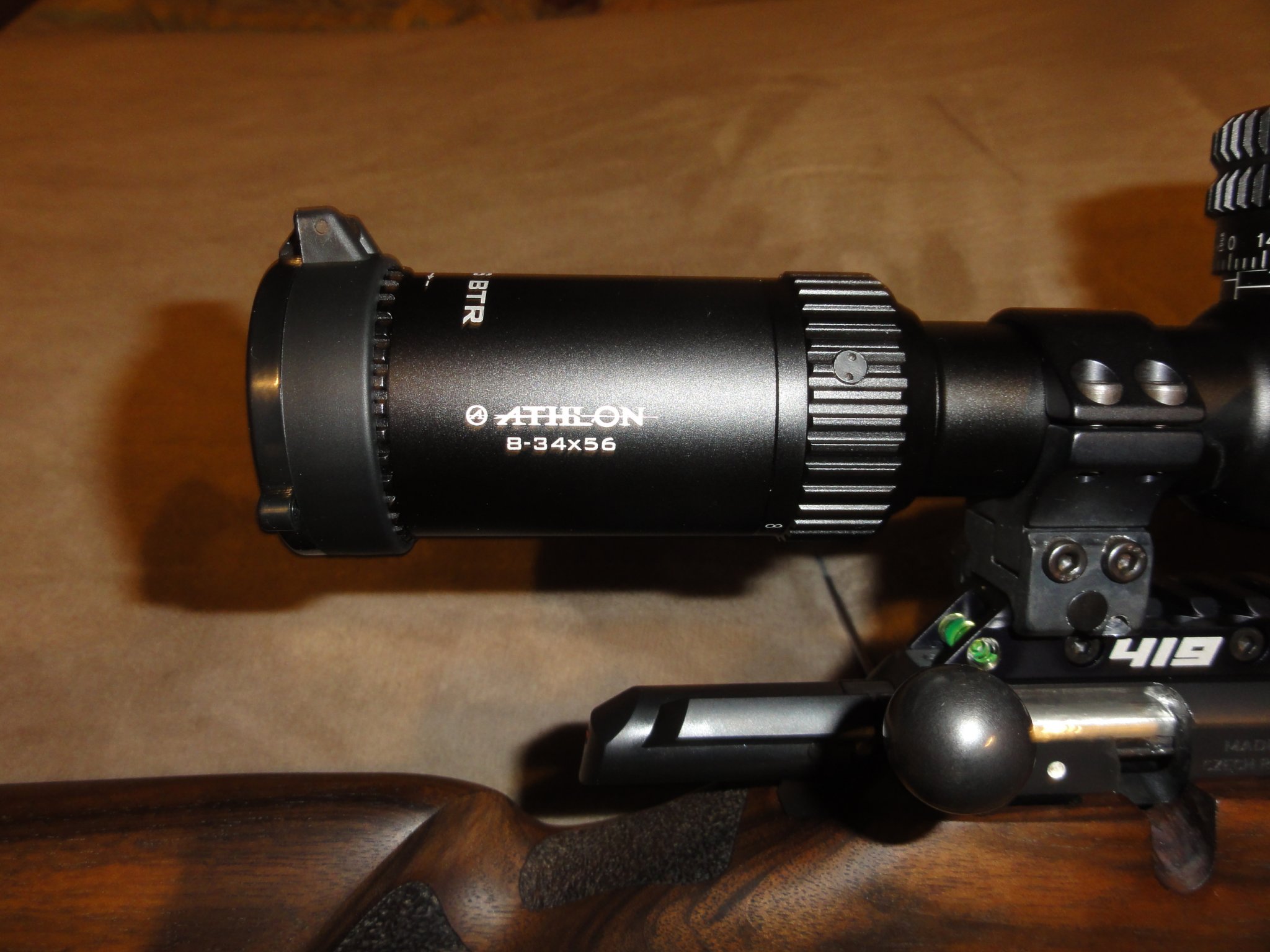

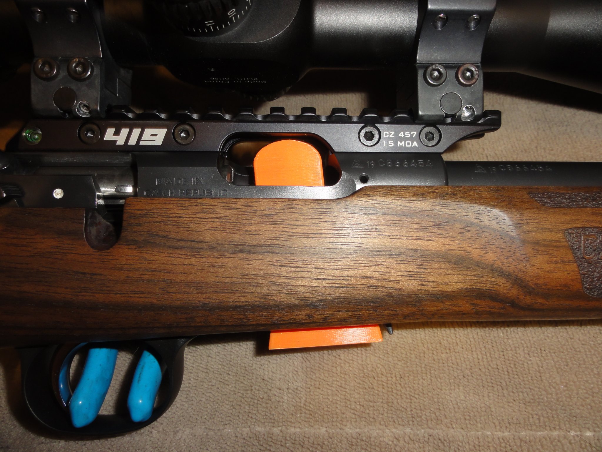

J&P adapters with Burris Zee Signature rings required a little modifying to clear the bolt. A few passes with a file to apply a bevel did the trick. A quick touch up with a Birchwood Casey bluing pen provided the perfect color match. Though, I'm pretty sure the Burris forever warranty has been forfeited.
7072848
7072849
This combo puts the scope centerline about 2 inches over the MTR stock. The objective on my T36 has about 1/8 inch clearance over the barrel.
7072850
Pay attention to the red note at the bottom of the post..
Why? I just install the 15MOA...
I too just installed a 15 MOA rail from AREA 419.

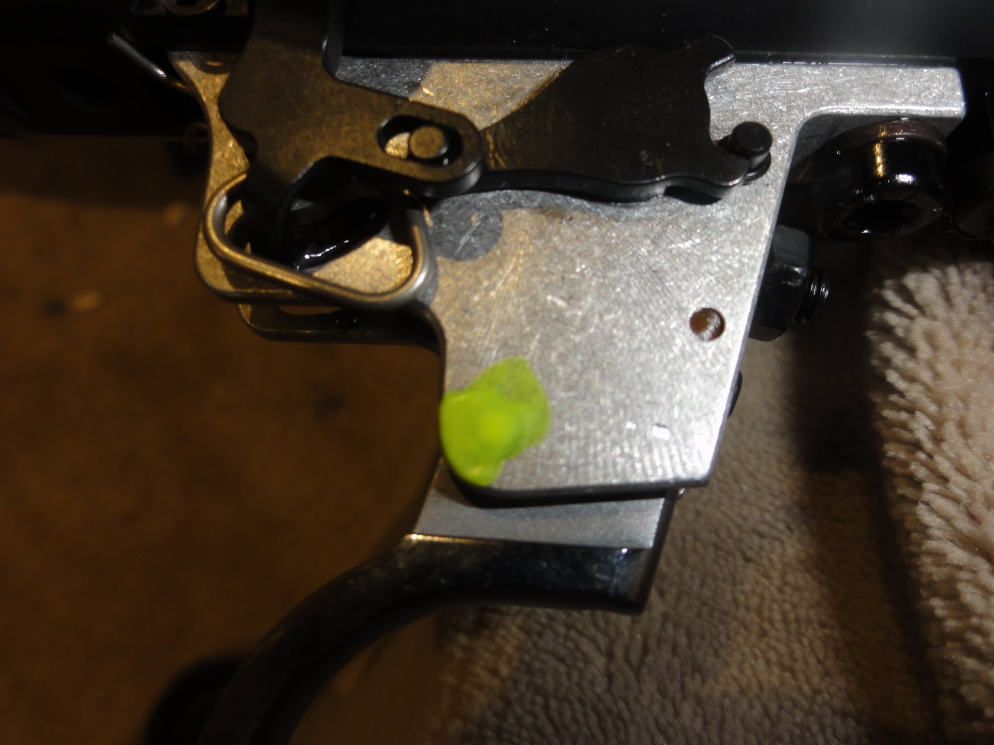

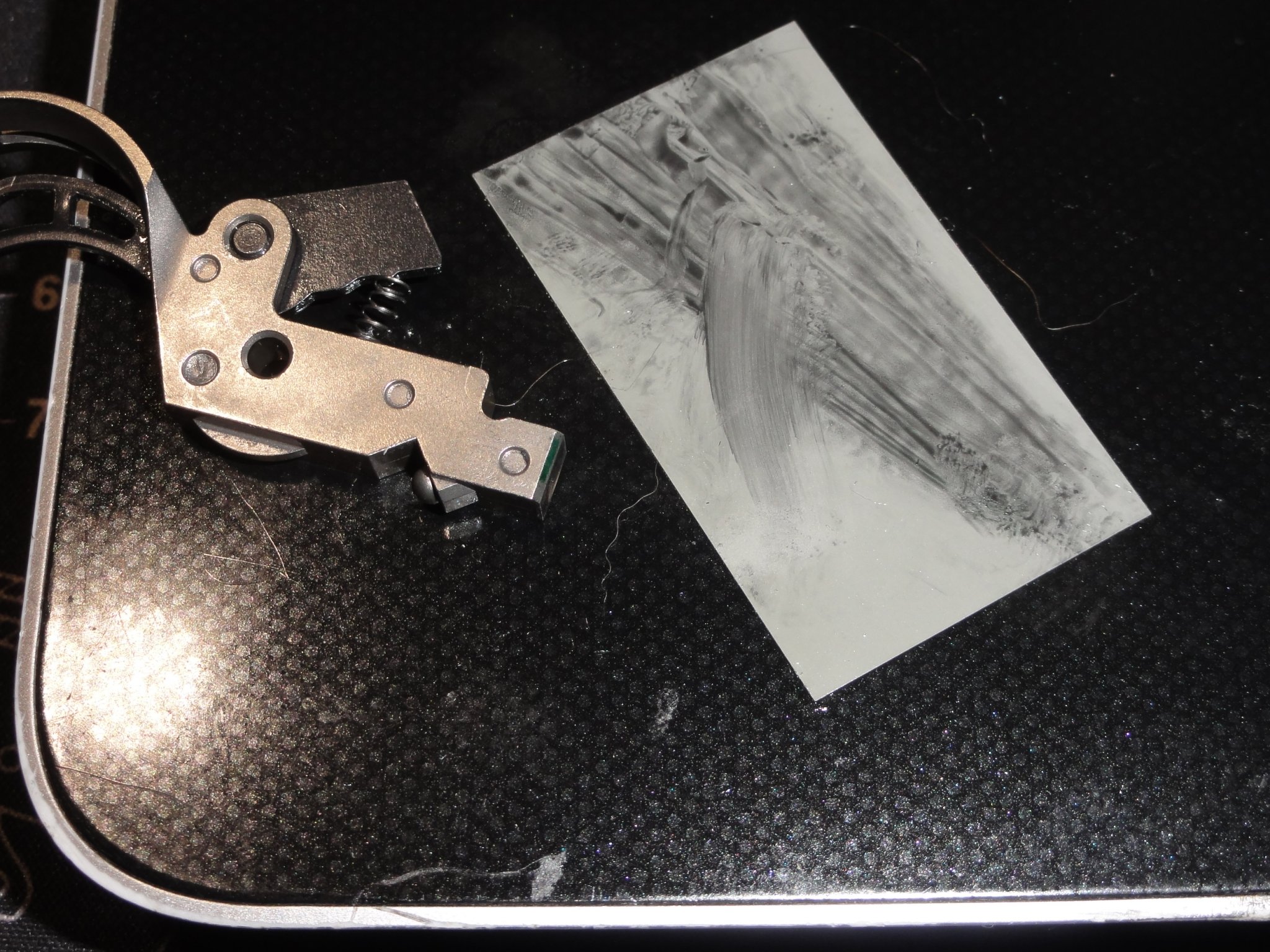

Thank you Bill.... I had the factory trigger down to 15 oz. A YODAVE trigger spring kit, I believe under 20.00 brought it down to
9 oz. With the trigger shape it feels like 6 oz. I have been told that they will go down to 4 oz. Be aware that the trigger pin is a pretty heavy press fit into the trigger. To aid in reassembly, I took a couple thousands off of it's diameter. The fingernail polish is to keep the pin from shifting. I realize that I could have staked it in place, but I work on my triggers much to often for that.
As far as stoning... I use 0.3, 1 and three micron lapping film. ( last two photo's ) Those very fine levels of lapping film force me to go slow and not get too aggressive with my trigger sears. those sears are from my RPRR. thus far, I have not seen the need for lapping my CZ 457 MTR sears. As an FYI. The Harrell tuner changes POI when adjusted by as little .10" And that is just rough testing.

Here's a photo of the 457 American that I just re-barreled with a Shilen select match ratchet rifled #5 blank. I'd considered threading the action, but decided instead to glue the bbl in - if it doesn't work out, I can always clean up the Loctite #609 & thread it later. But - at least so far - it appears to be working out. I finished the blank by cutting the extractor grooves & made the cut on the bottom of the shank for the feed tray to fit into, then de-greased, blasted, & CeraKoted the bbl & muzzle thread protector with a mix of 20ml of graphite blank and 10 ml of tungsten. The nitride finish of the 457 appears to have a slightly blue/black tone, and I thought the mix might come close to matching it. The Shilen - as I contoured it - is just over 1/2lb heavier than the OEM American bbl, even though it's an inch shorter at 23".
I had a hurried prone session with it from 50yds yesterday morning while the breeze was still fairly light, and after getting a rough zero on steel, shot some groups on paper. The one I attached is the 1st 5-shot group on paper, with SK Std+. The first four shots were touching, but I saw a weird recoil track though the scope on that fifth shot that landed on the black paster. Not terrific, unless you'd seen how the factory barrel was shooting - then it looks pretty good by comparison. I shot some 10-shot groups with SK LR Match, Flatnose Basic, Pistol Match, and Lapua Center-X; LR Match & Flatnose basic had six or seven shots all in one little hole, with the remaining 3-4 shots within 1/4". In short, it shows good promise. Afterwards, when I checked to see if the bbl was still free floated in the bbl channel, I found some contact in the last 4" or so of the forend, so a bit of sanding to remove that might just tighten up the groups. I've got to remove the bbl'd action to engrave the chamber on the bbl anyway, and to seal the sanded bbl channel with some urethane varnish; might as well get that done while it's still raining.
So this is the first Shilen bbl I've ever worked with - if it continues shooting the way the initial trials indicate, it won't be the last...
